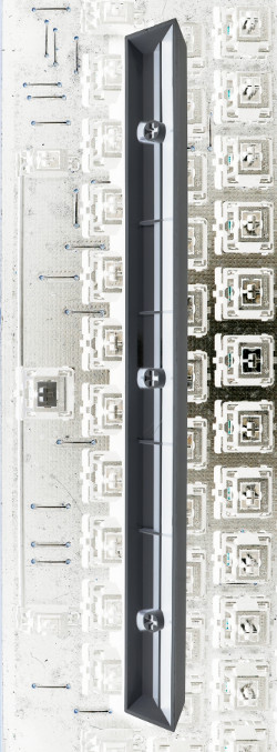

According to Cherry, 1 unit is 19.05mm, or 0.75" .
1.5 units (28mm wide, 1 center mount)
- Phantom with 7BIT layout
3 units (57mm wide, 3 mounts, 19.05mm apart)
One center mount and two extra mounts 1 unit (19.05mm) left and right of the center.
For this space bar exist molds in the Signature Plastics SA-family in form of a regular key.
4 units (76mm wide, 3 mounts, 28.5mm apart)
One center mount and two extra mounts 1.5 units (28.575mm) left and right of the center.
For this space bar exist molds in the Signature Plastics SA-family.
4.5 units (85mm wide, 3 mounts, 34.671mm apart)
One center mount and two stabiliser mounts 1.82 units (34.671mm) left and right of the center.
5.5 units (104.5mm wide, 3 mounts, 43mm apart)
One center mount and 2 mounts 2.25 units (42.8625mm) left and right of the center.
6 units (114mm wide, 3 keymounts, 57mm and 38mm apart)
Three keymounts, one middle mount 0.5 units (9.525mm) right from center, left 3 units (57.15mm) and right 2 units (38.1mm) apart from middle mount. The stabilizer center-to-center is 95mm.
mounts from left to right at
- 0.5 units
- 3.5 units
- 5.5 units
- Cherry G80-1800 with windows keys
- Cherry G80-11900 with windows keys
- Cherry G80-11908
- Cherry G80-11800 with windows keys
6 units (114mm wide, 3 keymounts, 38mm apart)
114mm wide, one center mount and two mounts 2 units (38.1mm) left and right of the center.
6 units (114mm wide, 3 keymounts, 43.5mm apart)
114mm wide, one center mount and two mounts (43.5mm, 49mm center-to-center) left and right of the center. The stabilizer center-to-center is 98mm.
6.25 units (118mm wide, 3 mounts, 50mm apart)
One center mount and 2 extra mounts 50mm left and right of the cneter.
These space bar measures are covered by the Signature Plastics Universal Space Bar.

6.25 units (118mm wide, 3 mounts, no center mount)
3 mounts, two mounts 50mm apart from center, one mount 11.9mm to the right.
Mounts from left to right at:
- 0.5 units
- 3.75 units
- 5.75 units
These space bar measures are covered by the Signature Plastics Universal Space Bars from both the DCS- and SA-family.

6.25 units (118mm wide, 3 mounts, 40mm apart)
One center mount and two mounts 2.1 units (40mm) left and right of the center
6.25 units (118mm wide, 3 mounts, 42.5 mm apart)
One center mount and two mounts 42.5 mm) left and right of the center
