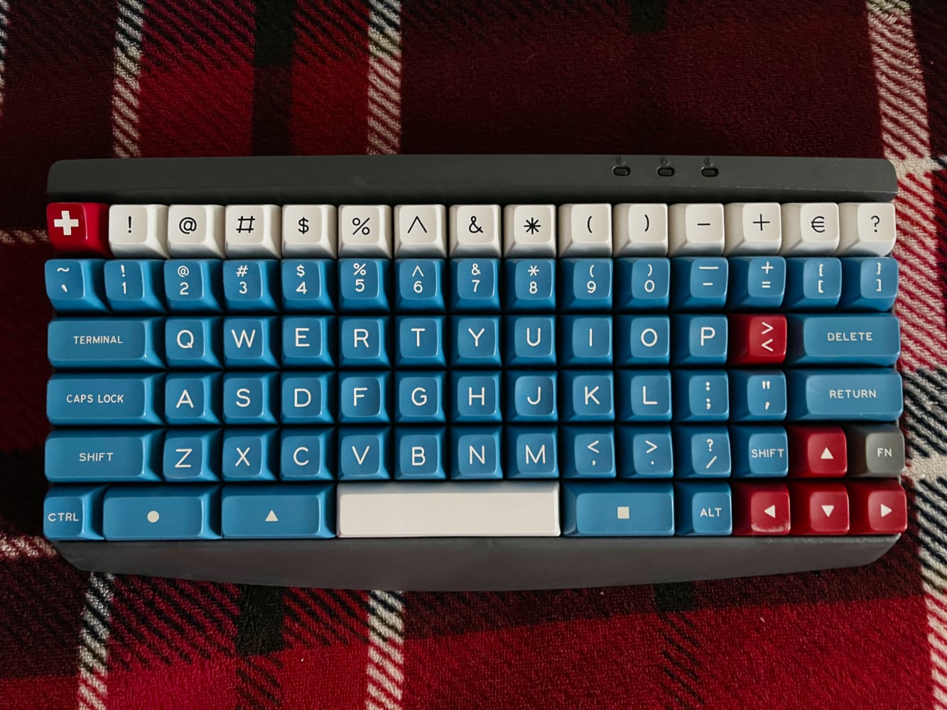

POS keys are real. Spot the single unit modifier keys. ;)
That little ortholinear matrix keyboard of mine has a simple uniform grid of switches. I wouldn't advise using 2 unit or 4 unit wide keys, if you're designing your own thing. Those keys all feel just as heavy as you'd expect with the extra switches underneath!
As for numpad keys: they have specific scancodes in the USB keyboard spec, so your computer definitely knows you're pressing numpad 7 rather than numrow 7. But here's a question: what keys do you actually need? I'd advise starting small. You can leave out whatever you want.

Sure. But they still don't stabilise right: they don't go down straight unless you press them dead centre. I wouldn't advise multi-switch caps when you're doing your own design.

vvp wrote: 26 Oct 2021, 18:13
  • LED under each switch. Easy because your keyboard is flat and you can use PCB and even surfrace mount LEDs.
Although I said I don't want to wire switches with LEDs, I am planning to wire my switch setup. I know "what's the difference?" From what I've been able to sus out, there seems to be a whole other layer of complexity to soldering in and making it work to the LED switches. I already suspect that I'm going to have trouble making this build actually work (from the controller/programming standpoint.) I don't need to muddy it up any further.
  • LEDs in a row on some side(s). You need an acrylic plate to diffuse light over the keyboard surface. "Diffusing mirror" finish on the bottom and the sides. Similar approach how LCD backlit works. There may be some tinkering where to place LEDs to get somewhat even backlit.
I had thought about something like this. I think I'm wanting to use some sort of sandwich style plastic thing for my case build-up, so that may work out to my advantage. I need some tutorial about how to go about wiring/controlling this sort of setup. I wonder if I could use chrome spray paint to give the reflective finish on the inside? I could tape off areas on the sides where I wanted the light to shine through.
On another thought...Why is it that nearly every mech KB I see, the keys are bald faced? Why does no one use a "bezel" around the key area to give it a somewhat more finished look? Do they all like that raw look? Is it something with keeping dirt out?

...And another thing....Should I be thinking about moving the legends to an off center position to give them a better chance to be lit. I'm thinking of using a pudding type keycap.
