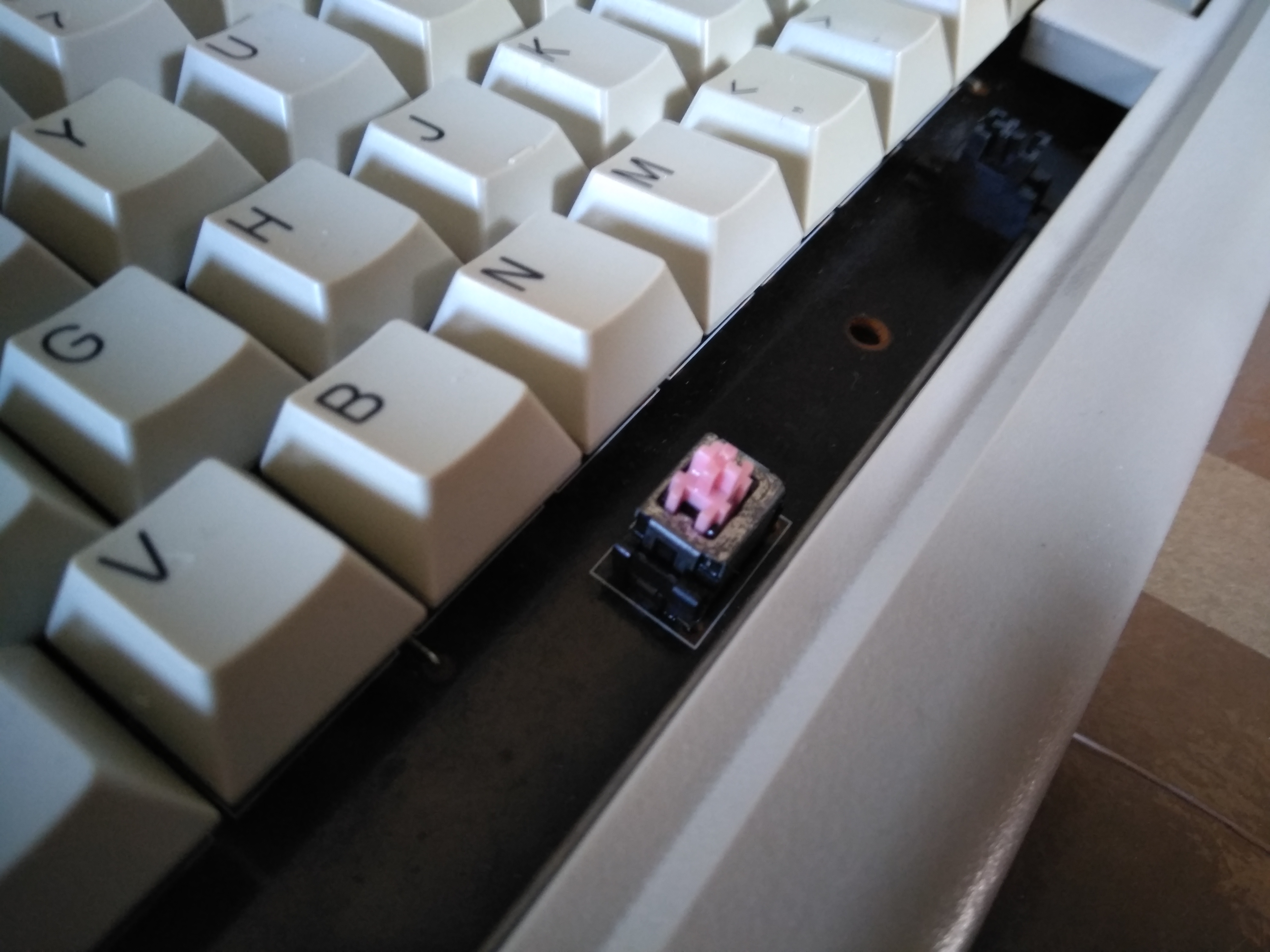

Very interesting. I was under the impression that MMM were super hard to disassemble in a non-destructive manner. How is it done? I was also doing a little investigating of my own on why exactly they bind so much. I have a loose Mitsumi Standard switch that I got from a lot on Taobao. My theory is that there is a small discrepancy between the width of the plate cutout and the width of the switch housing, causing the rails to compress against the slider. Even just squeezing my fingers together on either side of the housing caused a significant decrease in smoothness. I was considering trying to make a plateless MMM custom, to see if this solves the issue, but that is a long way in the future.

That's an interesting theory. However, my board is plateless and it still has (or now had) severe binding issues.
I have not disassembled a switch yet, but I'm willing to try.

I think what happens is that the metal of the top housing (silly choice of material!) corrodes and thus become rough and / or interacts with the plastic of the slider hence I considered WD-40 to be ideally suited as:
WD-40 isn't actually a true lubricant. WD stands for "water displacing" and its main use is as a solvent or rust dissolver. The lubricant-like properties of WD-40 come not from the substance itself, but from dissolving components. And the effect doesn't last.
WD-40 can be a good substance to start with โ€” it can help clean up rust or other grime. But depending on what you're working with, you should probably follow up WD-40 with use of a true lubricant such as one based on silicone, grease, Teflon, or graphite.
So far, I have only ever applied WD-40 to my MMMs, just spraying into and onto the switch from the top (I know...). Maybe if one went the extra mile and introduced some proper lubricant, the vestiges of binding might disappear.
I find mine to be extremely snappy tactiles now and really like their thocky sound. I have begun to wonder whether they might have slightly progressive springs in them, at least the linears, as I can type faster on them than on pretty much anything else and they do feel somewhat bouncy to me. By the way, those linears were desoldered from two numpads that came with them and then substitued into the board that came with yellow tactiles (my least favourite breed) I gave to Thorogrimm. The misalignment of the keys is simply due to shaggy soldering.
I have two Chicony 5160s with them - and the experience is much nicer in those sturdier boards. My 5160 with white tactile MMMs is one of my favourite vintage boards with regard to typing feel.
Anyway, I really do hope more people are going to look into them now thanks to Thorogrimm's effort - there is a lot to like here for tactile afficionados.
