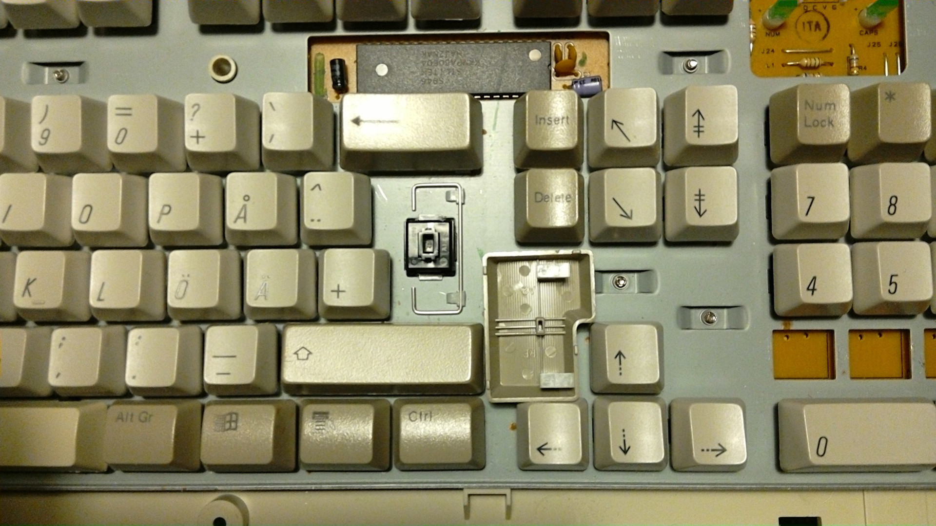

I was trying to take picture of the stabiliser on my Matias Tactile Pro in nordic ISO when - in true show of Matias ´quality´- one of the stabilisers came off. :D
After battling for 5 minutes with the slippery over-luber stabiliser, I manged to get it back in and get you a picture of it.

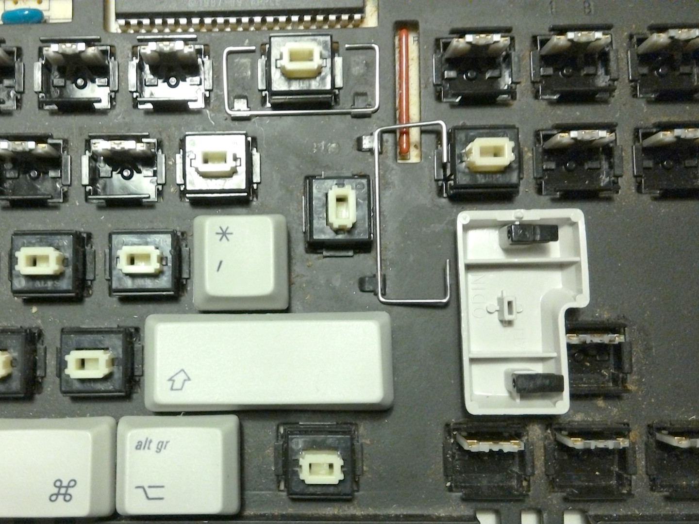

I had a (modified) Dell AT102W on the desk just now:
... because I was comparing it to the ISO AEKII. Not the Enter/Return key you want, but it has the same stabiliser.
Huh. The 0.25u narrower Apple key does fit the AT102W (with a gap) and vice versa (without the case top).
But the Matias and Dell keys are not compatible: although they are the same size and have the same type of stabiliser, the switch position is shifted 0.125u.
Besides Matias, Tai-Hao has also made Alps keycaps and Cherry MX/ISO keycaps, but I dunno about Alps/ISO keycaps.
Inserts for Costar-style keycap mounts (Cherry MX mounts), allowing you to mount a keycap with Cherry MX mount on the stabiliser to Alps snaps on the plate were shown in another thread recently.

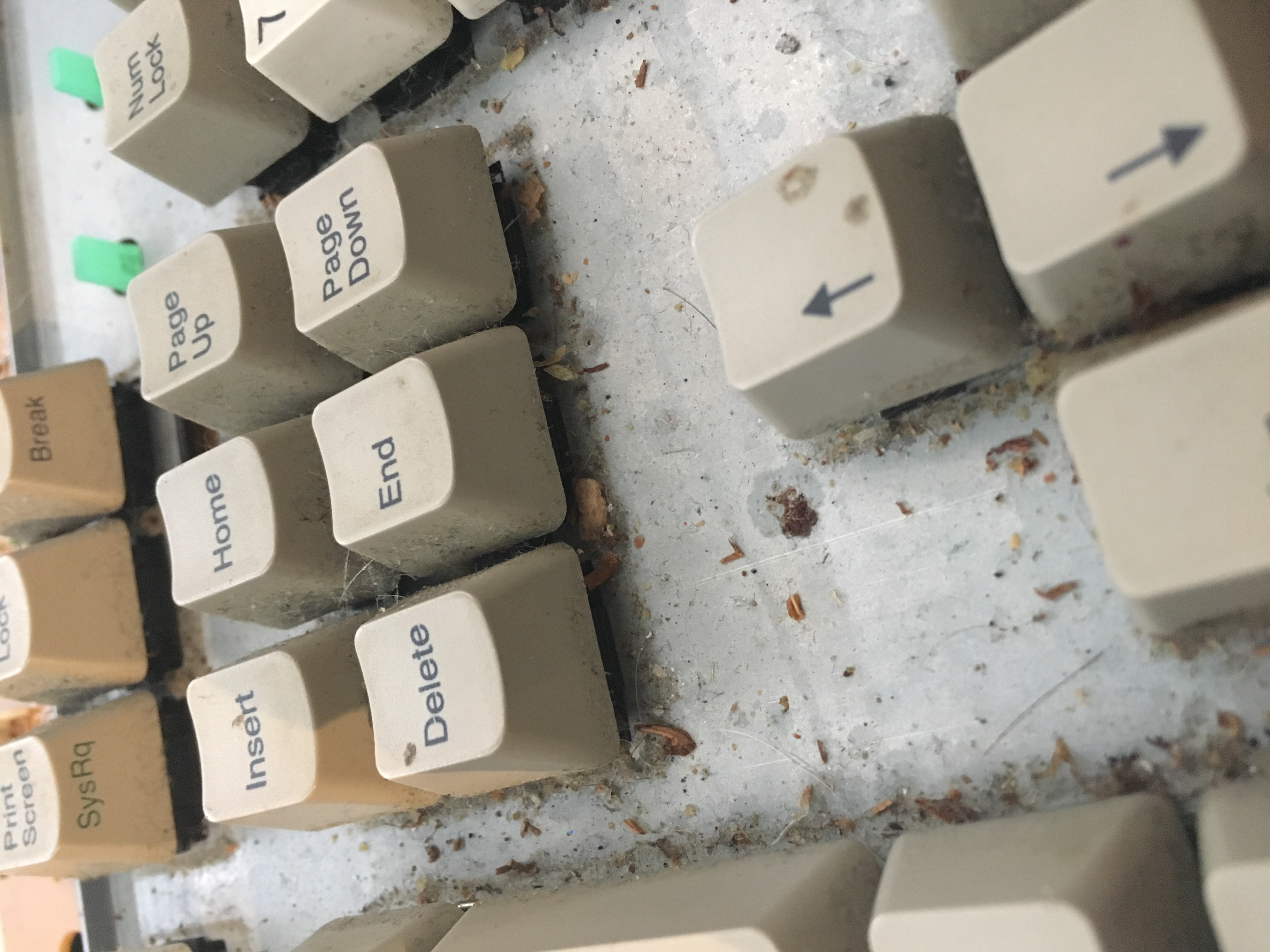

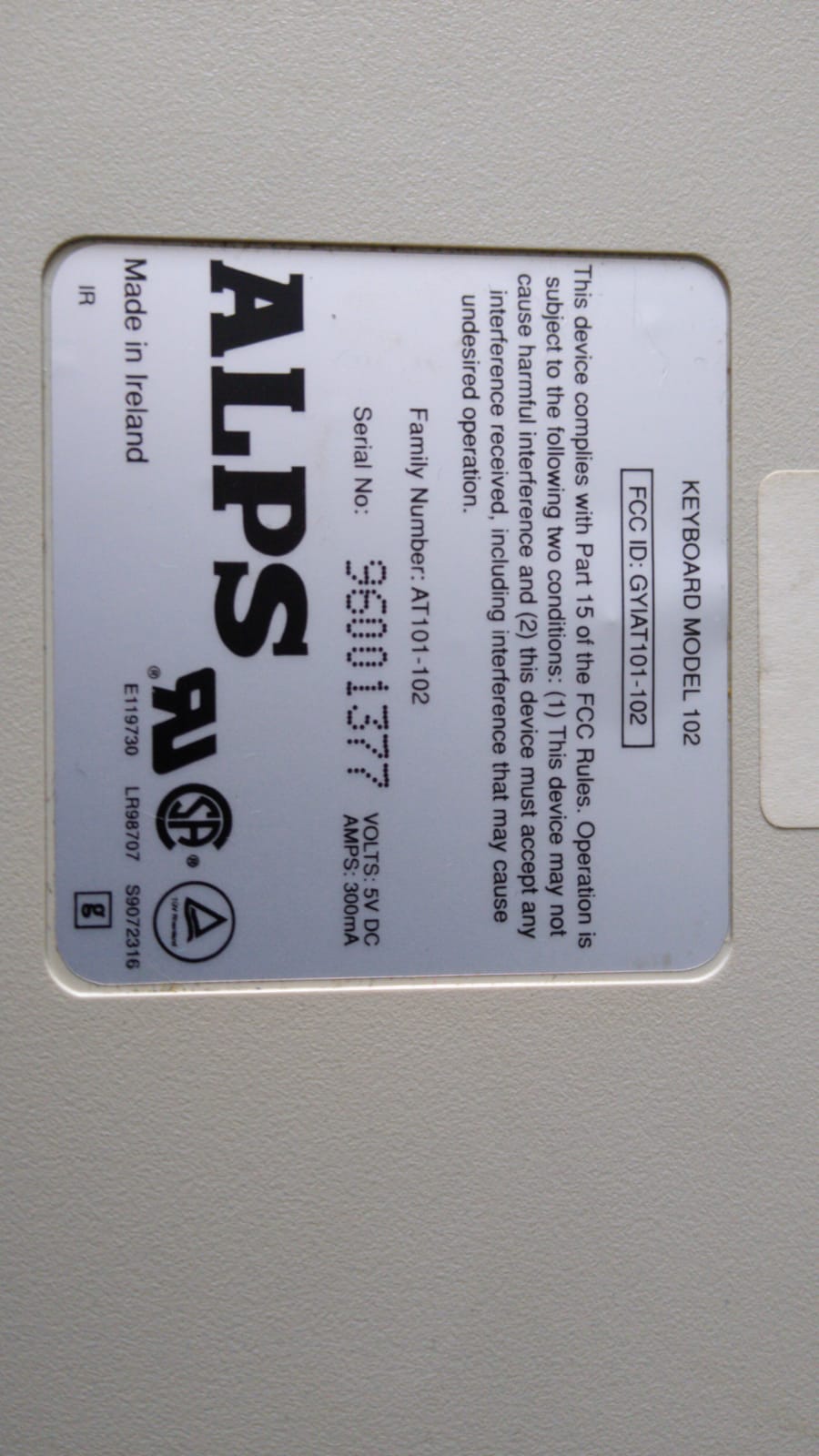

Donnelly20
03 Aug 2019, 12:51

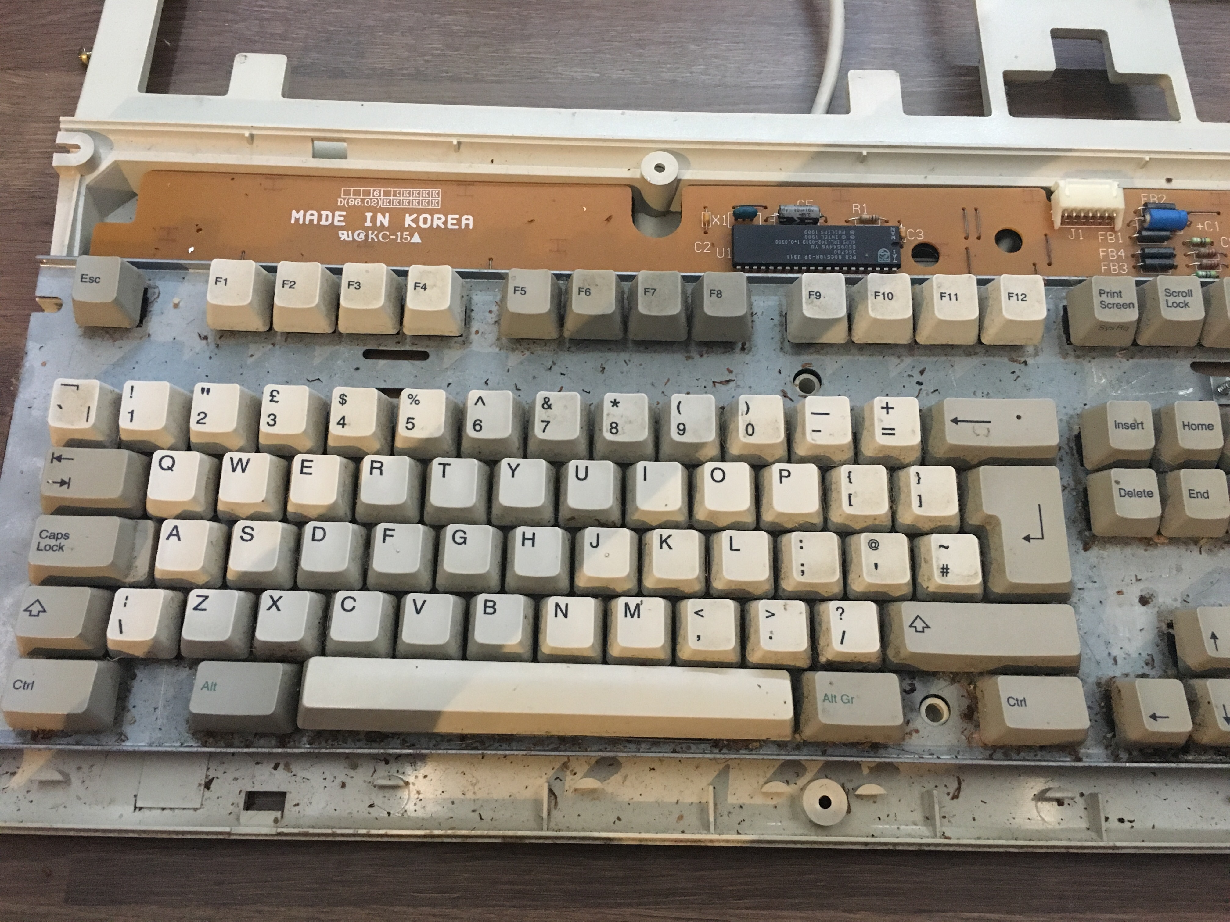

Findecanor's Picture of his AT102
My AT102 made by ALPS has the exact same stabilizer system, the board was made in Ireland so it has the UK ISO layout. It is a weird a board i have only came across one other like it but the sticker on the back was different to mine i will upload pics of my board soon.
Donnelly20
03 Aug 2019, 13:35

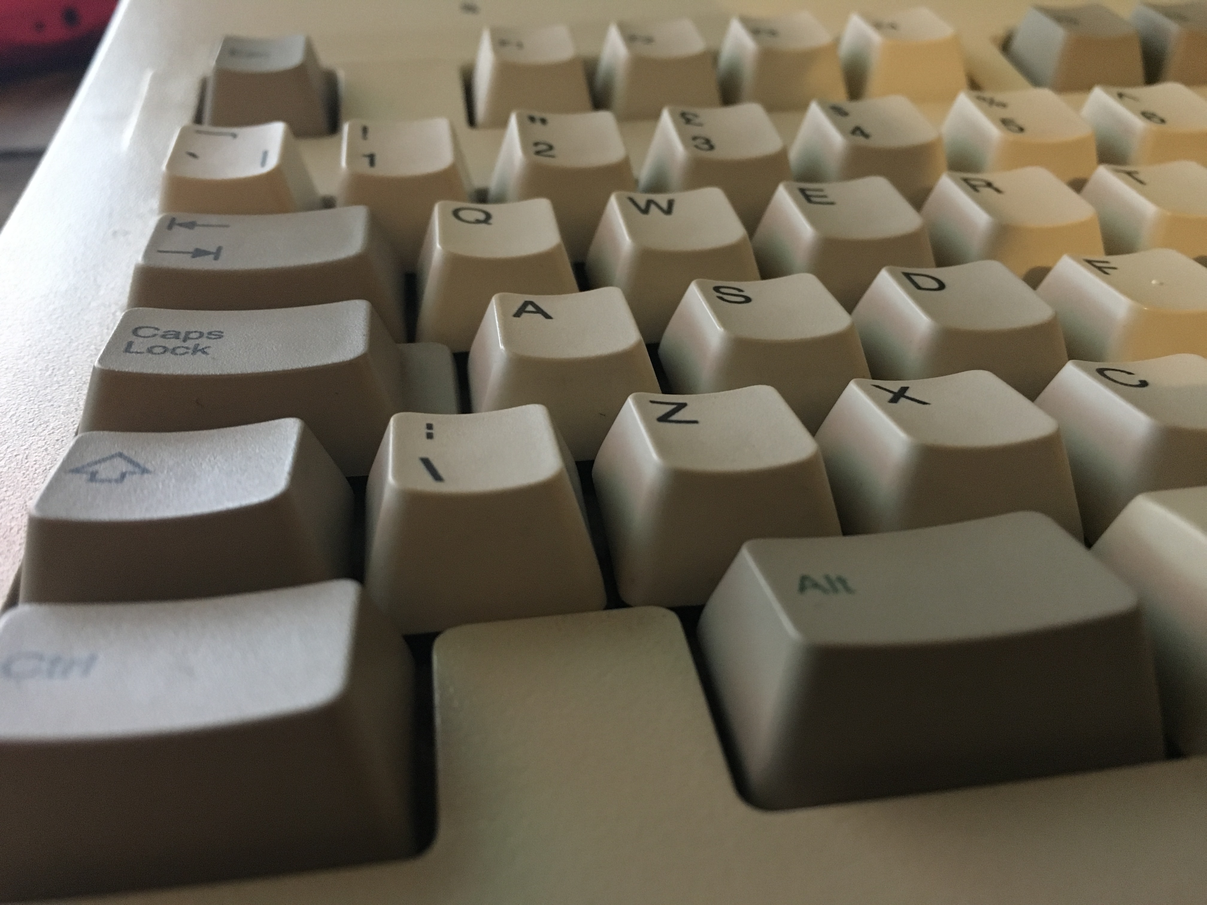

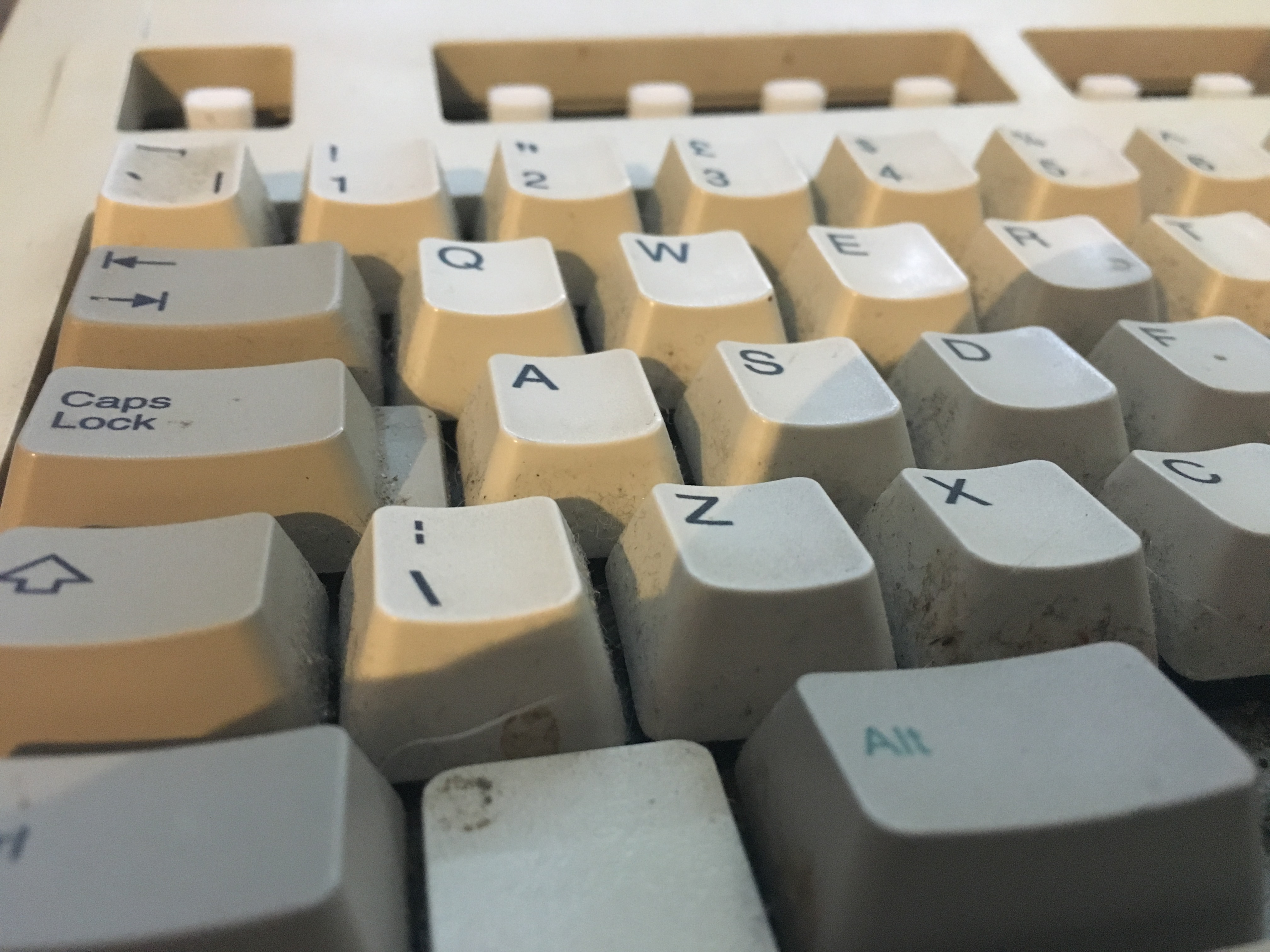

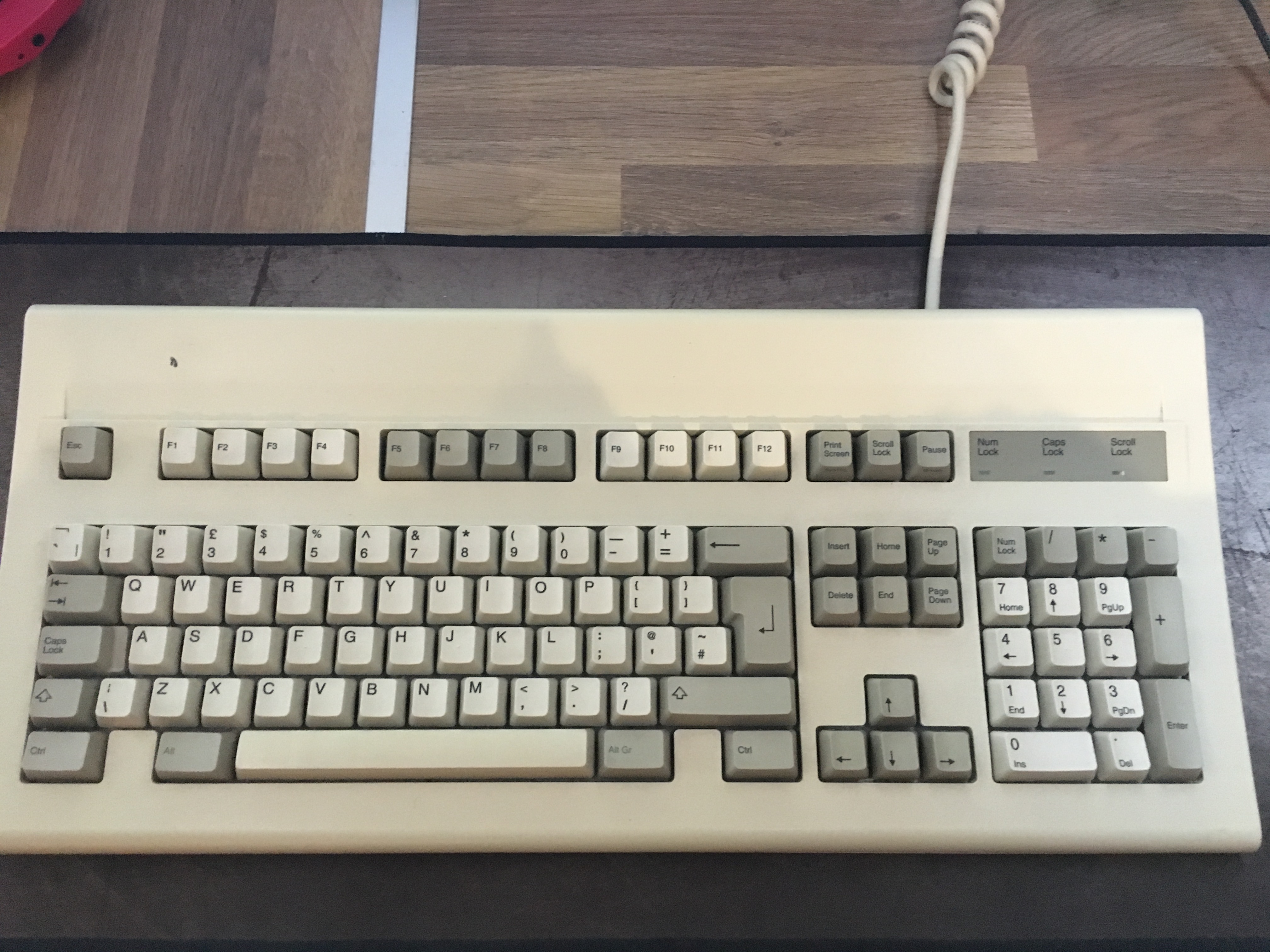

This is my ALPS made AT102, figured i through up a few pictures of what it was like when i originally got it and after i cleaned it up.
Lots of tobaco :roll:
PS- Sorry not very good at taking photo's

Assuming your "Lots of tobacco" refers to the brown gunk commonly found on those PCBs, that'd be rosin flux.
Donnelly20
04 Aug 2019, 11:38
Darkshado wrote: 04 Aug 2019, 09:08 Your image tags are pointing to something on Google Photos that apparently hasn't been setup to be linked from here. Ideally just attach directly here and place inline.
Hey thanks for that, just taught me how to upload pics eaiser :D. I uploaded it yesterday and they were fine not sure why it changed, but anyway im not sure about the rosin flux you could be right i just assumed it was tobaco cause it looked like it and the keyboard had a weird bit of a smell to it when i got it. something was spilled on it but it was definitely not water cause it smelled sweet and with a hint of living in a smokers house. Also when i inlined the photo's it rotated them for some reason.
