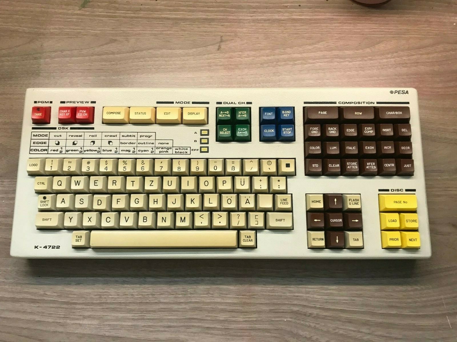

Hi, First post, go easy on me.
I got this Board on eBay for its colourful Keycaps. Its referenced once in this forum and "sort of cherry compatible" seemed worth taking the shot. Heres the link to the old post: viewtopic.php?f=2&t=18616
I want to write down everything i could dig up about this board:

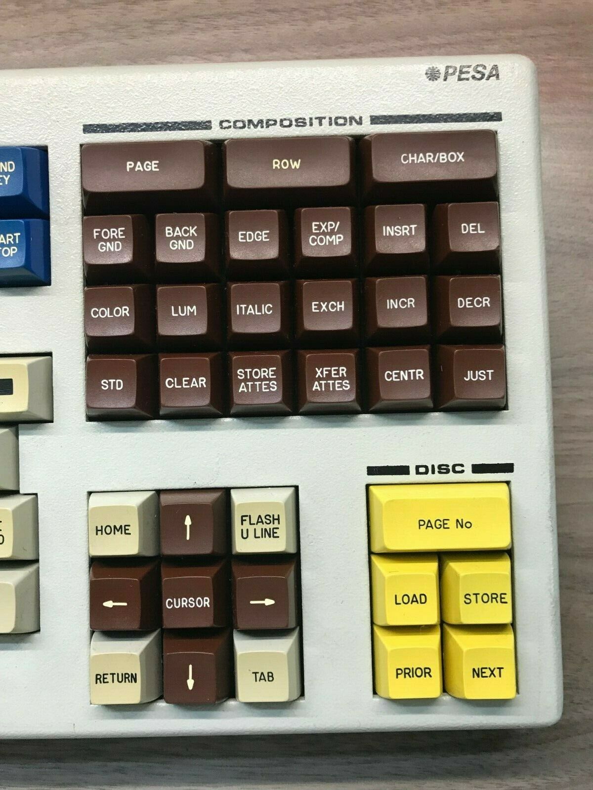

This particular one has a german layout with umlauts and ISO style num-row, however the "," and "." keys are ANSI.
The case is constructed from two welded and painted sheetmetall halves and has two small ribs on the underside to angle it slightly.

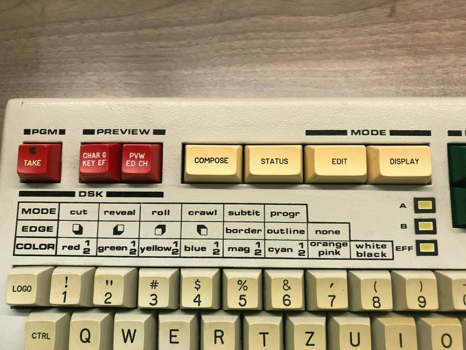

It has a fairly minimal alphanumeric block and a bunch of Function keys specific to its purpose as a Subtitle/Videotext device.

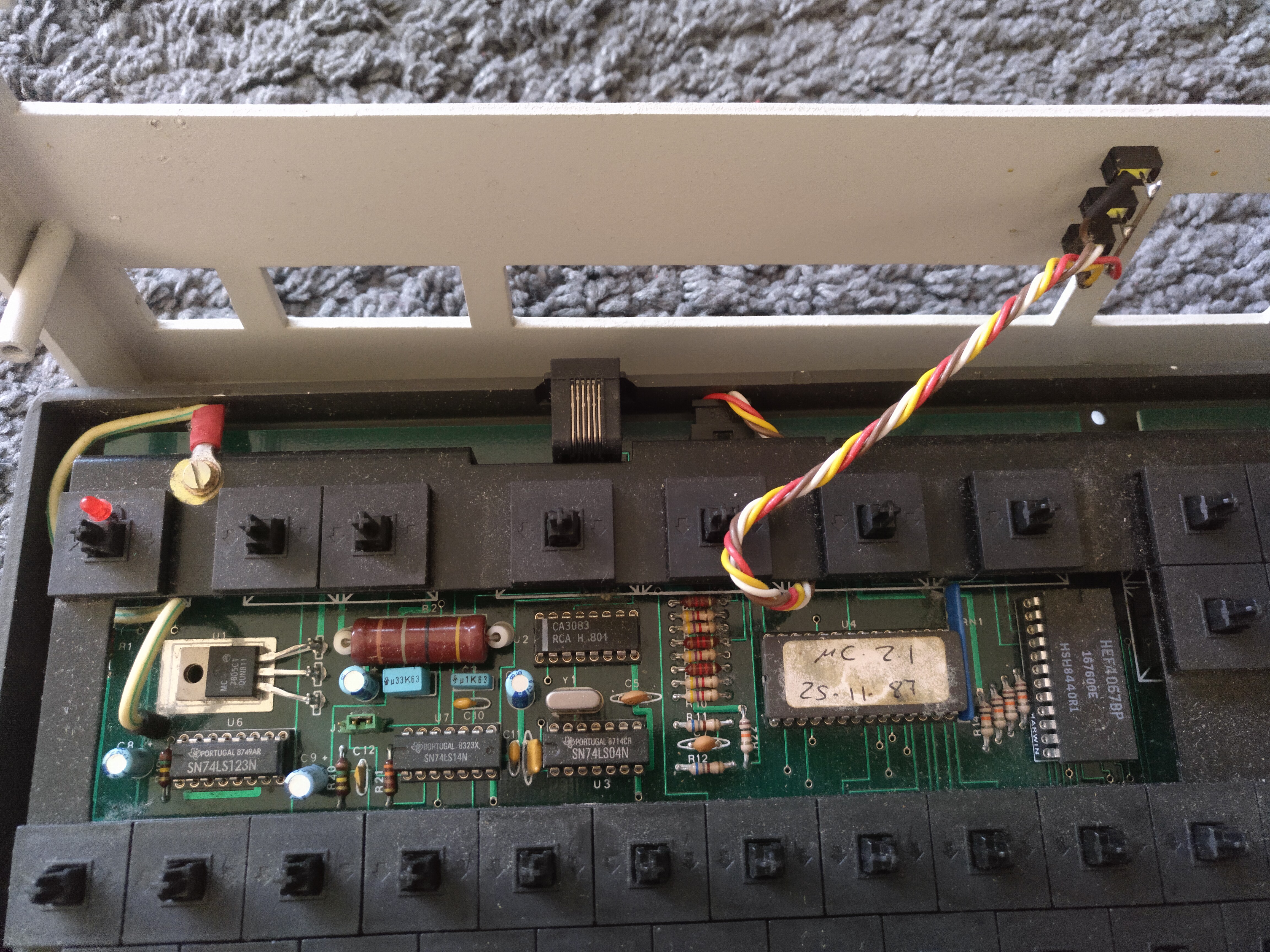

The Keyboard has a 6P6C Modular Connector socket as its only output.

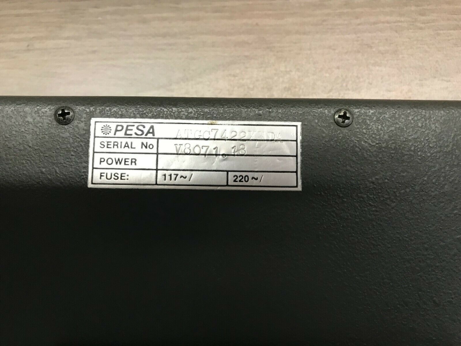

The serial number doesn't really tell us anything, a sticker on one of the microcontrollers has a handwritten date on it: 25.11.87
From a logistics point of view i can only imagine someone covering the ICs labeling during assembly, not before.

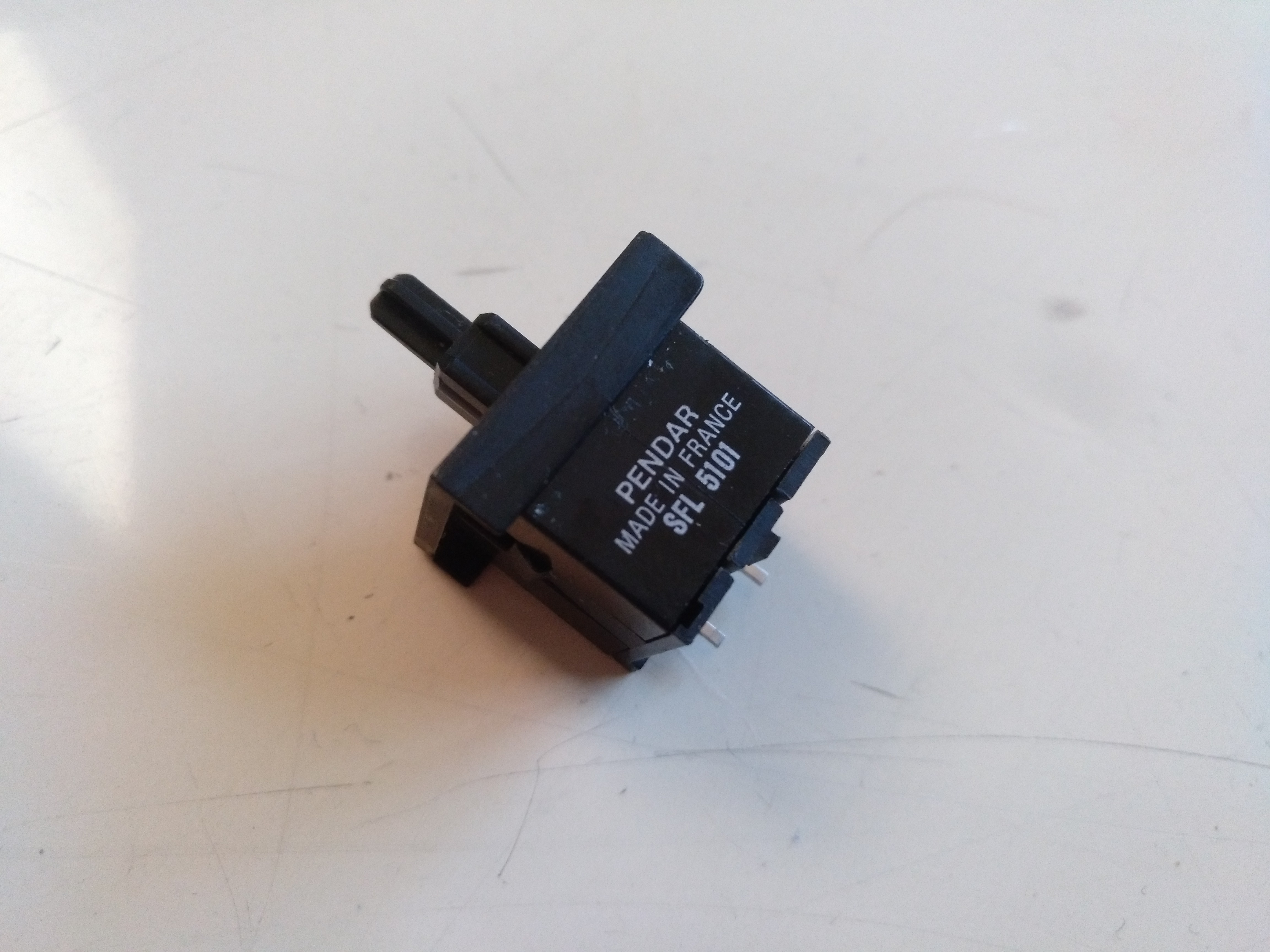

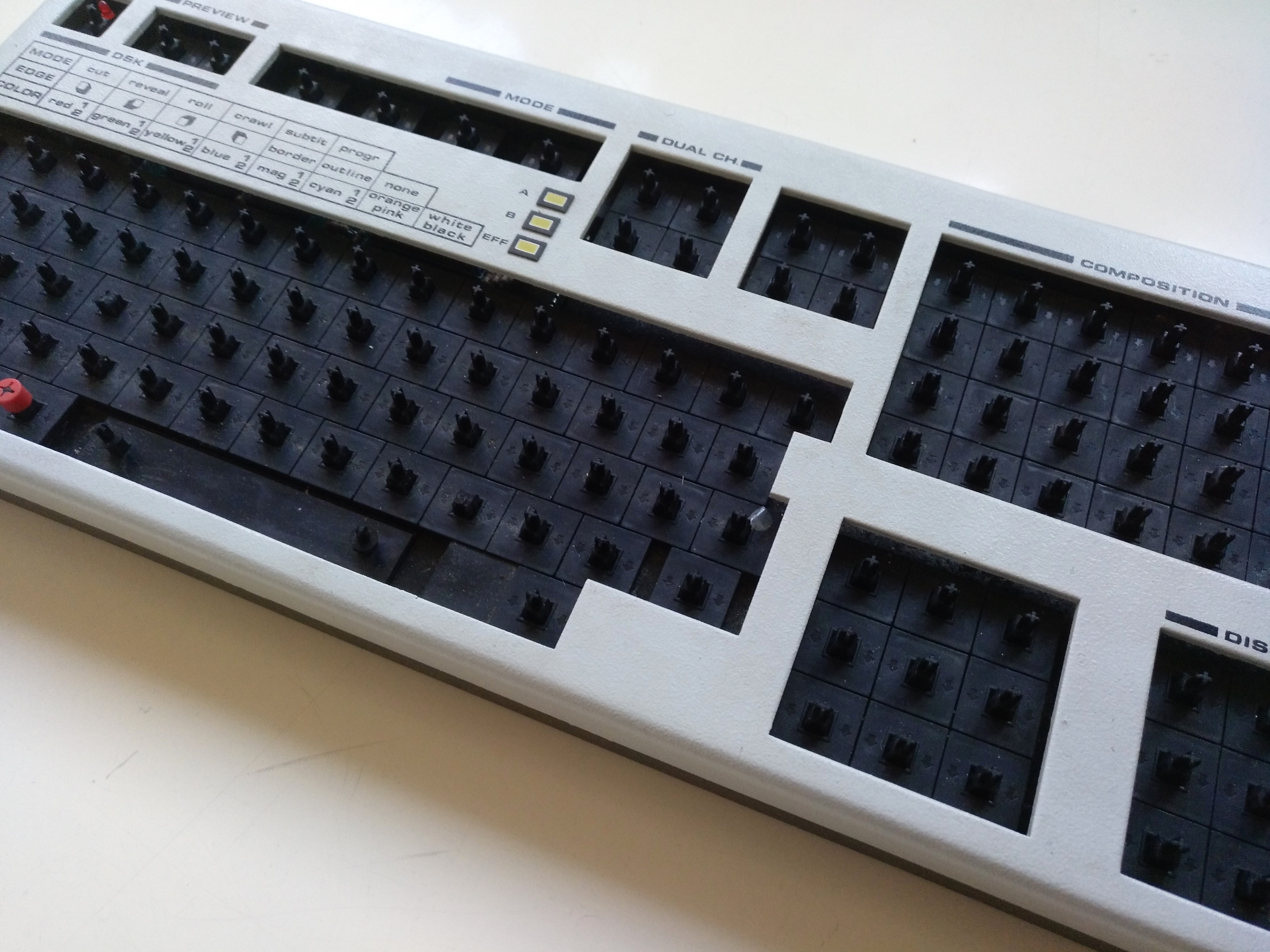

The board has an interesting spacebar setup, where the switch sits on one side, while the stablilizer itself also has a spring inside.
As assumed in the other thread, the switches are Clare/Pendar, in fact they are SFL5101, as described in this wiki article: wiki/Clare/Pendar_low_profile_reed
There is also two illuminated SIL5101.

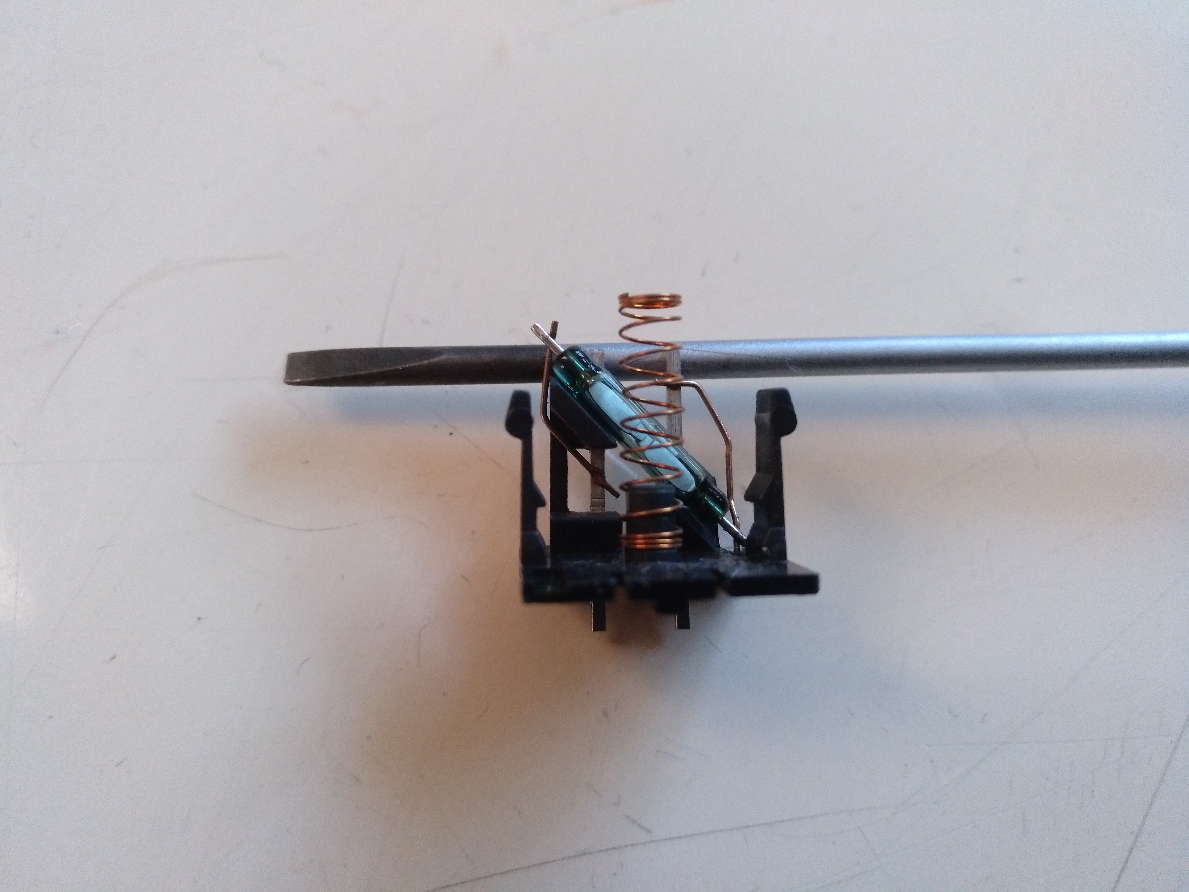

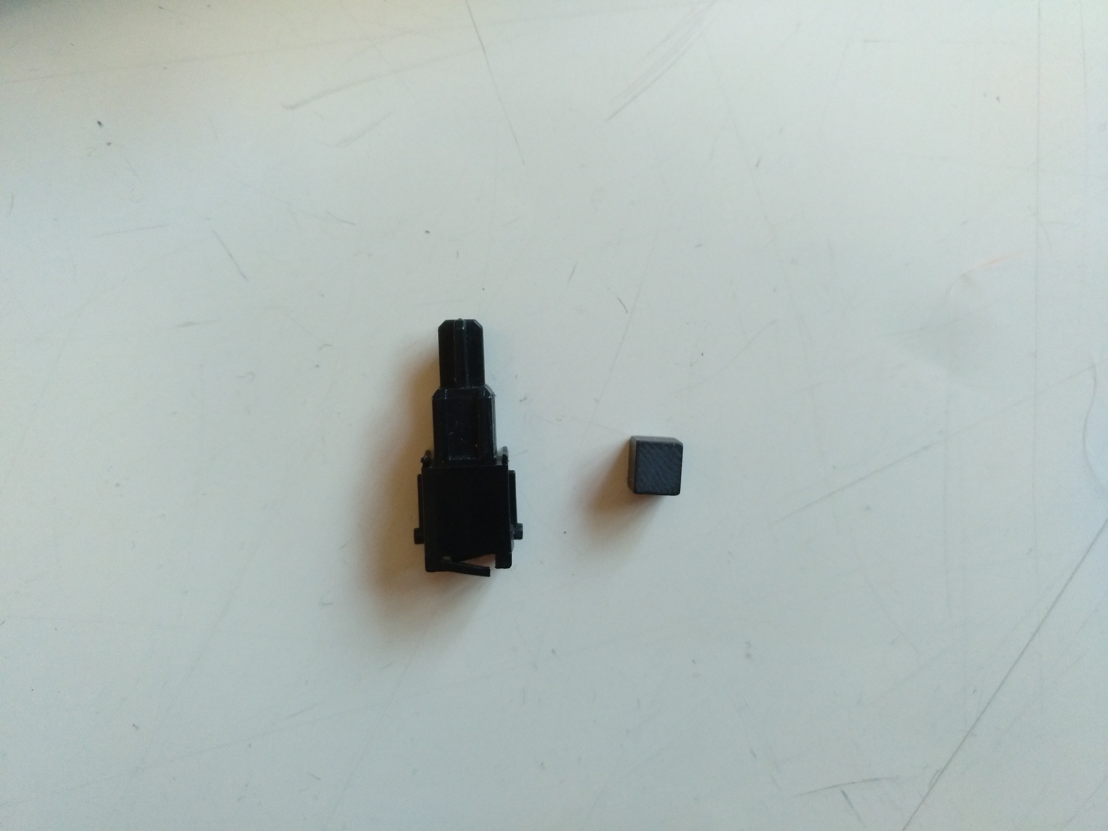

Here's a teardown of that switch:
One interesting thing to note is the free floating plastic appendix on the switch stem, whose function is presumably to dampen the switch bottoming out. It is undoubtedly the reason for the switches mushy feeling at the end of the keypress.

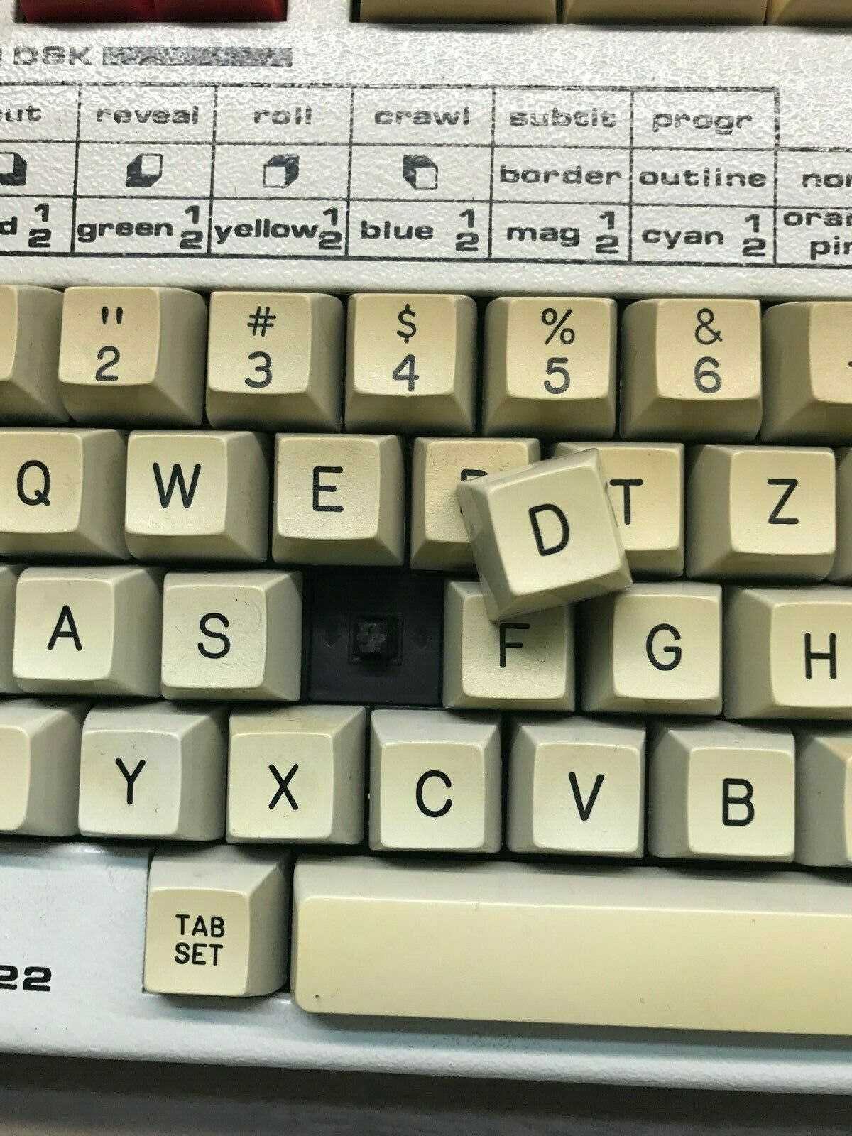

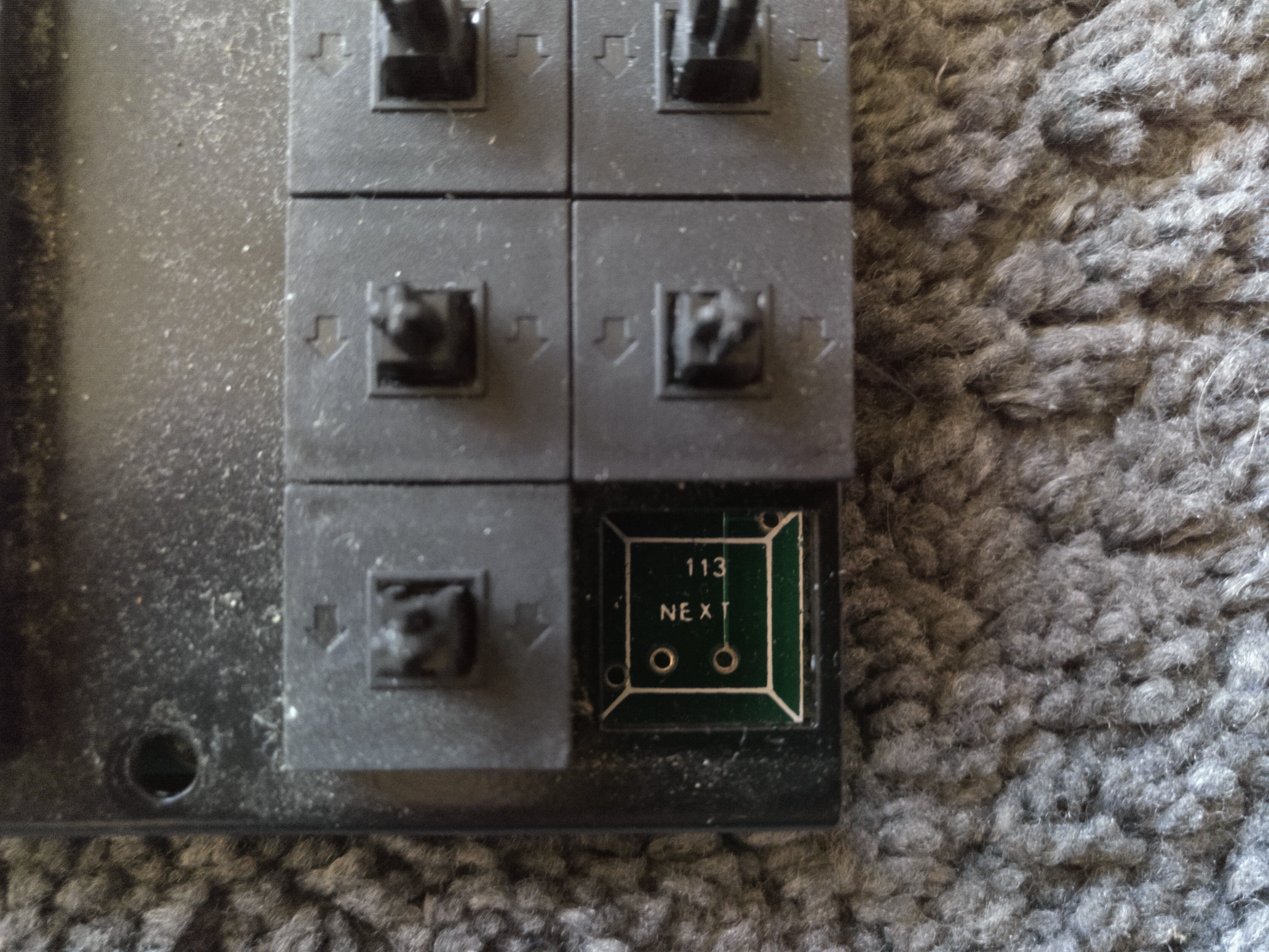

The keycaps are thick doubleshot abs (assuming from the yellowing) with the legend colour inner cup extending all the way to the bottom of the caps on most caps. On some that inner piece doesnt go s far down, which lets me assume that the molds got a redesign at some point. The distribution of older and newer style caps is random. The red keycaps stick out, in the way that the plastic looks and feels cheaper, more like modern toy abs plastic.
These Caps are in a somewhat sorry state, with some of the stems shattered. I can only repeat what has been said in the Previous post, that they are "somewhat cherry compatible". The stems sit very tight and without trimming the internal ribbing around the stem, most caps wont fully seat on a cherry style switch. That said i transferred the alphas to my planck and they look and sound swell, but i still have to fix up some of the stems and decide whether i want to take a dremel to the ribbing.

DevilZmods wrote: 22 Apr 2020, 23:34 The serial number doesn't really tell us anything, a sticker on one of the microcontrollers has a handwritten date on it: 25.11.87
On the contrary, that's probably the date the EPROM was burned, so, before assembly, but probably not terribly long before. (You can tell it's EPROM by the circular window outline.)
