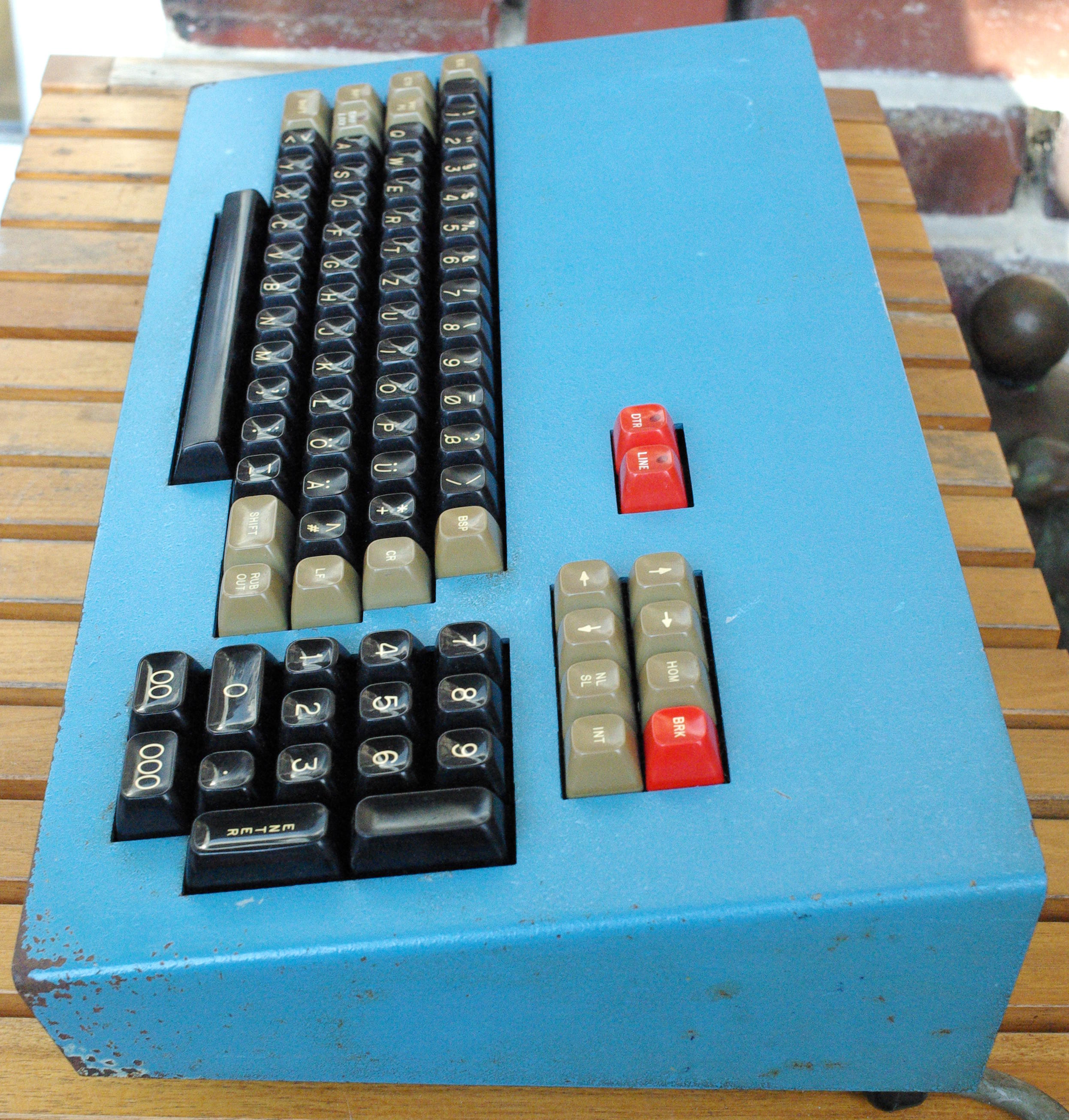

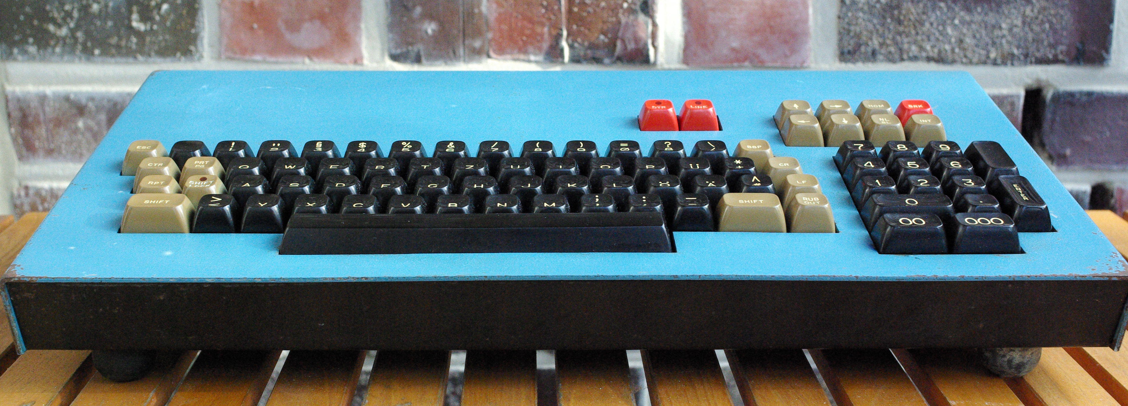

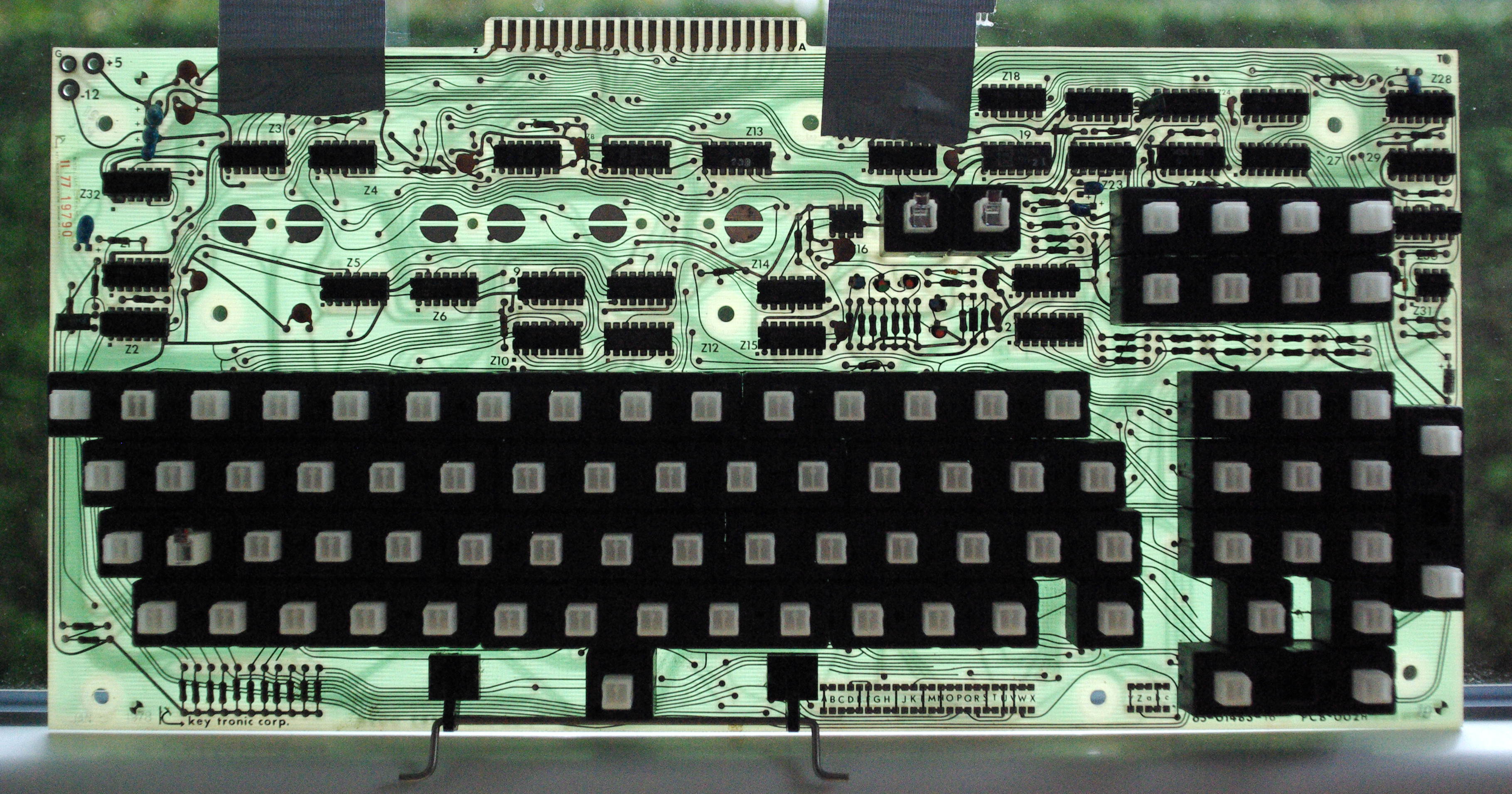

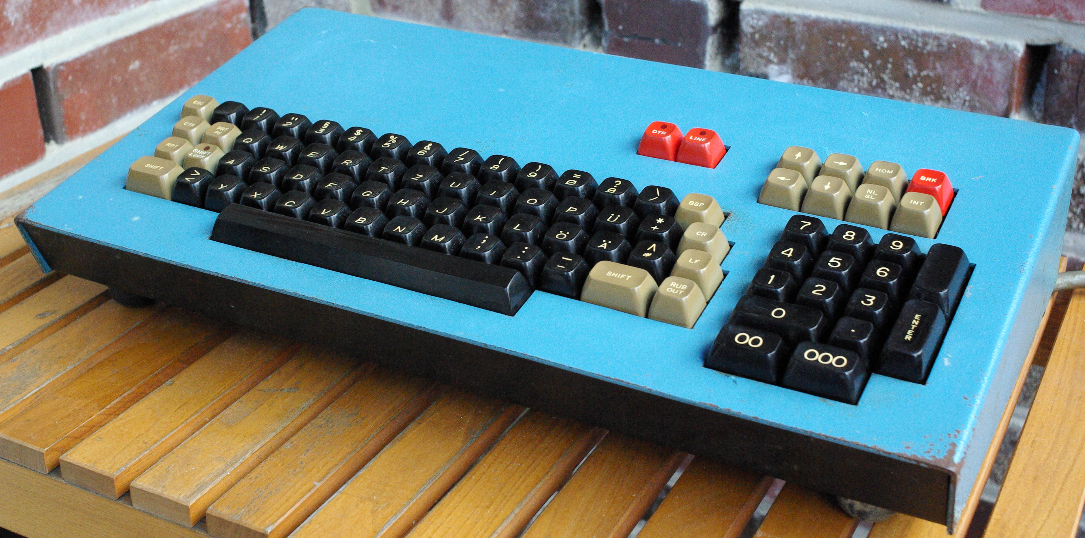

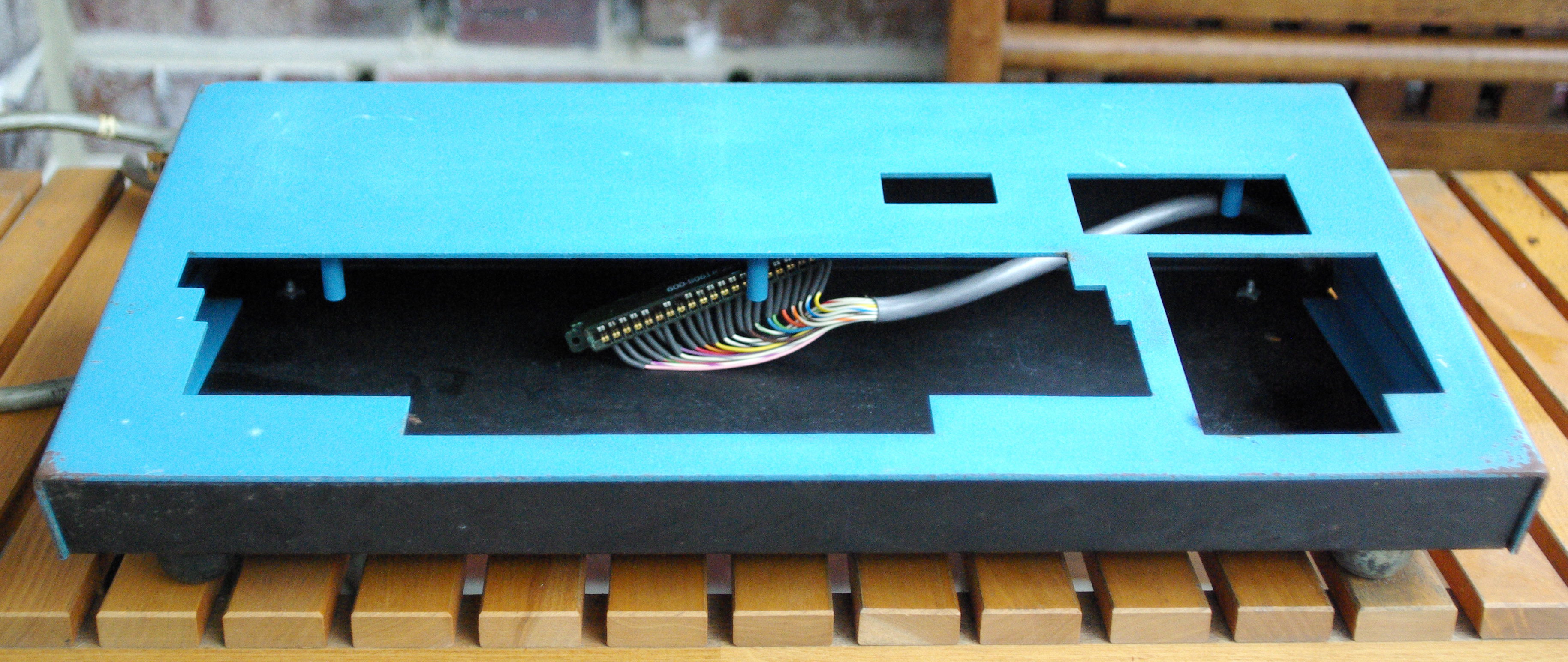

The construction of this keyboard is amongst the sturdiest and heaviest I own.

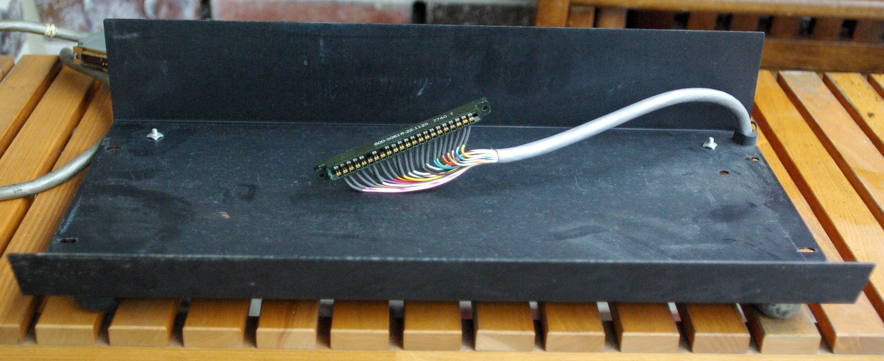

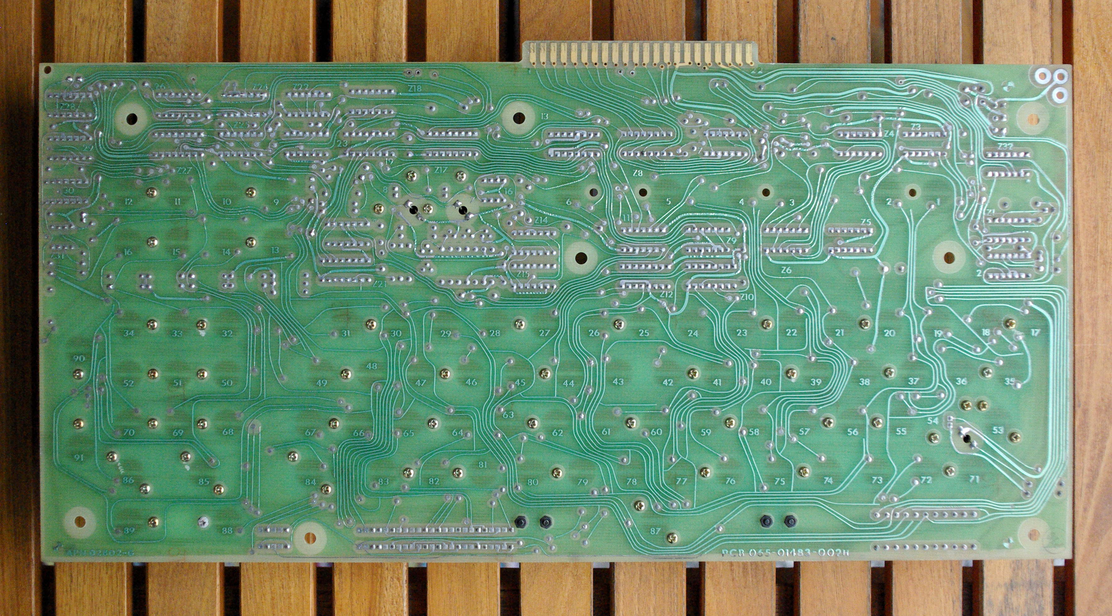

Top and bottom parts of the case are made of thick metal, there is some rust on the case. The PCB is mounted onto the top part of the case by screws at six points. Seems ridiculous to have such a heavy metal case and then have the switches PCB mounted.
At 43cm wide, 23cm depth its not really big. 7,5cm tall in the back, 4cm in the front.
This keyboard sits on big 2cm high rubber feet, not excessive at 5,4 Kilogramms!

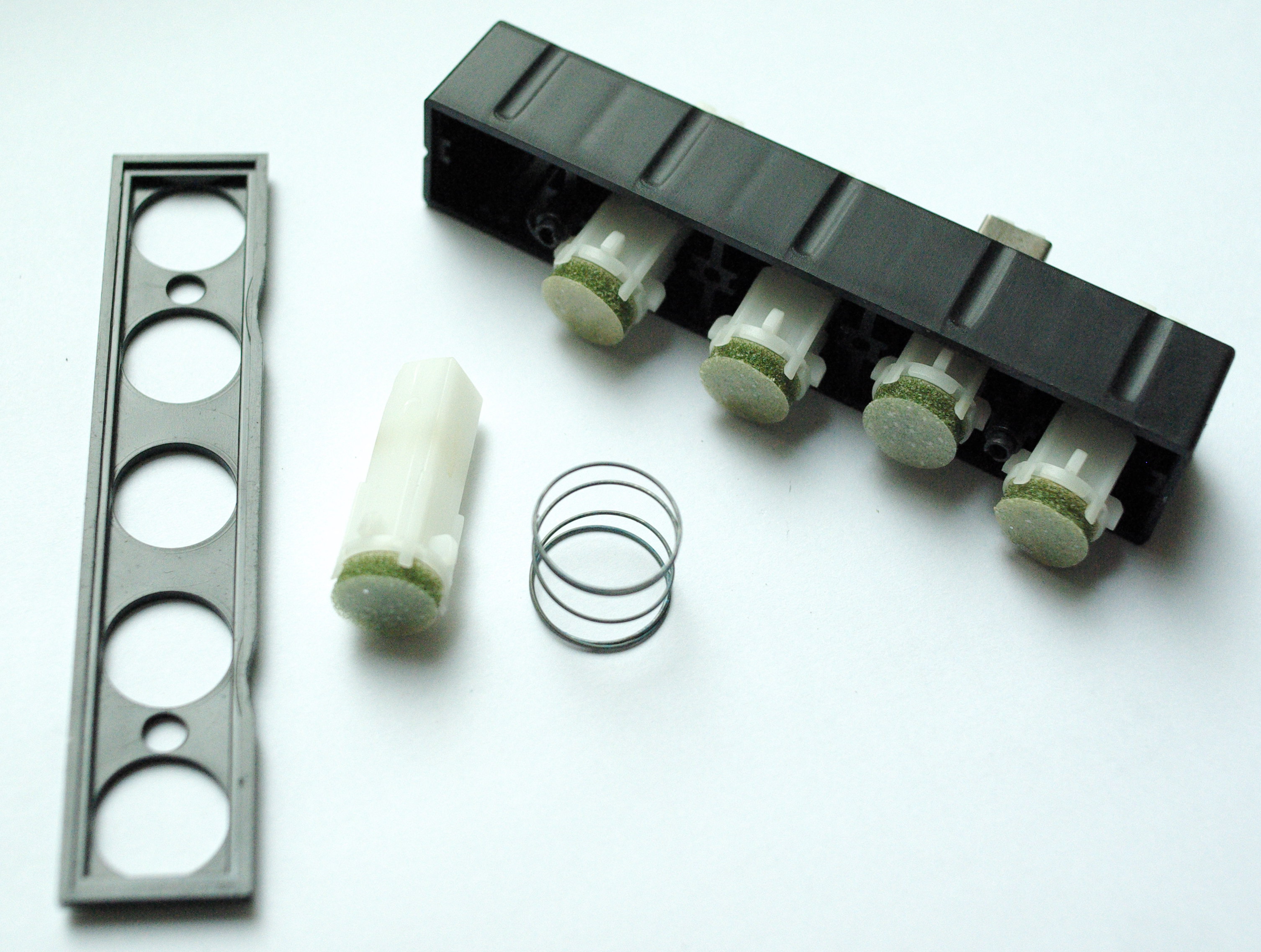

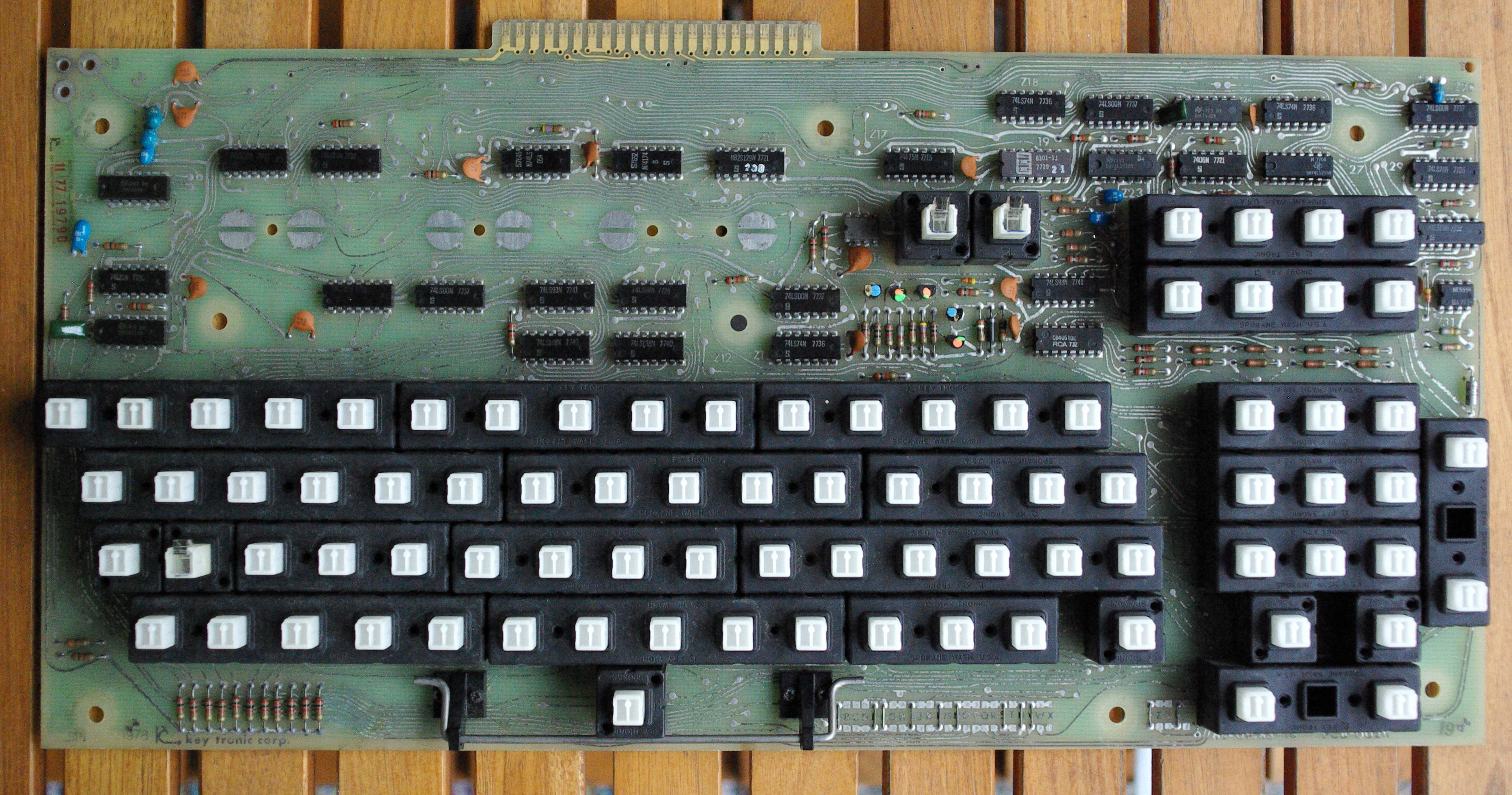

The foam and foil switches are PCB mounted.
All the swtiches can be removed by screws from the PCB.

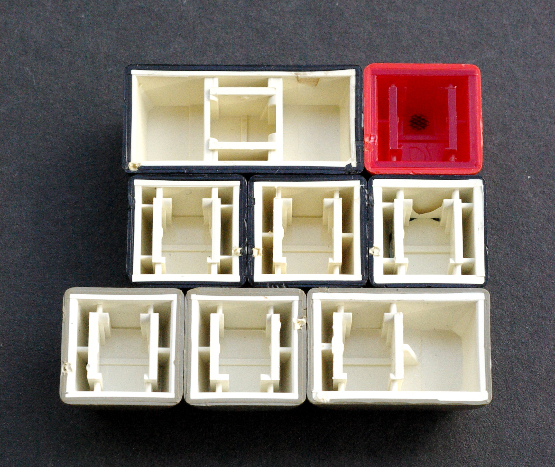

Upon opening a few switches the disintegrated foam crumbled out while others are in really good shape.As you can see the swtiches are constructed and mounted in rows of three, four and five swtiches on the PCB.

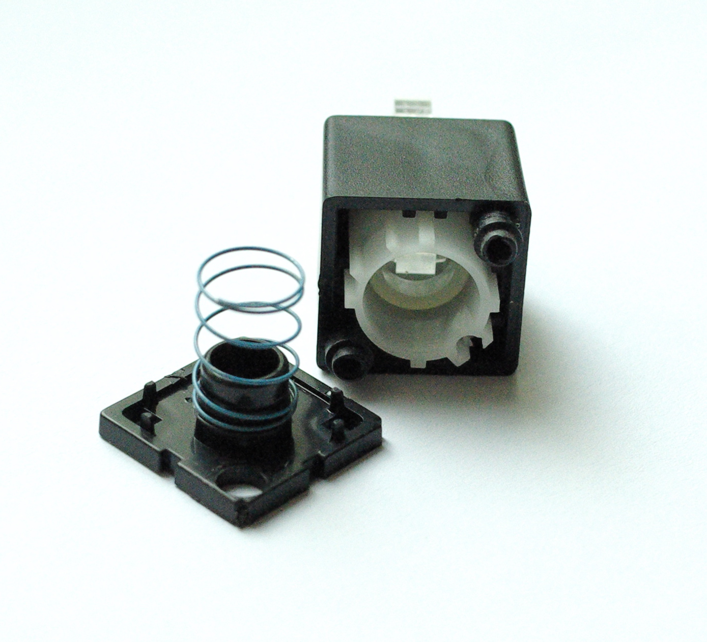

There are also single switches and LED switches. While the spring sits on top of the slider on most of the switches, the design of the LED switch is slighty different, with a smaller spring inside the switch housing instead.The switch is simple in design, linear, quite smooth with no buckling rubber sleeves or any other parts present like in other foam and foil swtiches at a travel distance of aproxx 7mm.I have not measured the actuation force which seems to vary due to corroded(?) springs.
The production date on the PCB sticker reads 11.77 while there is a small marking in the bottom left corner of the PCB reading Jan. 1978.

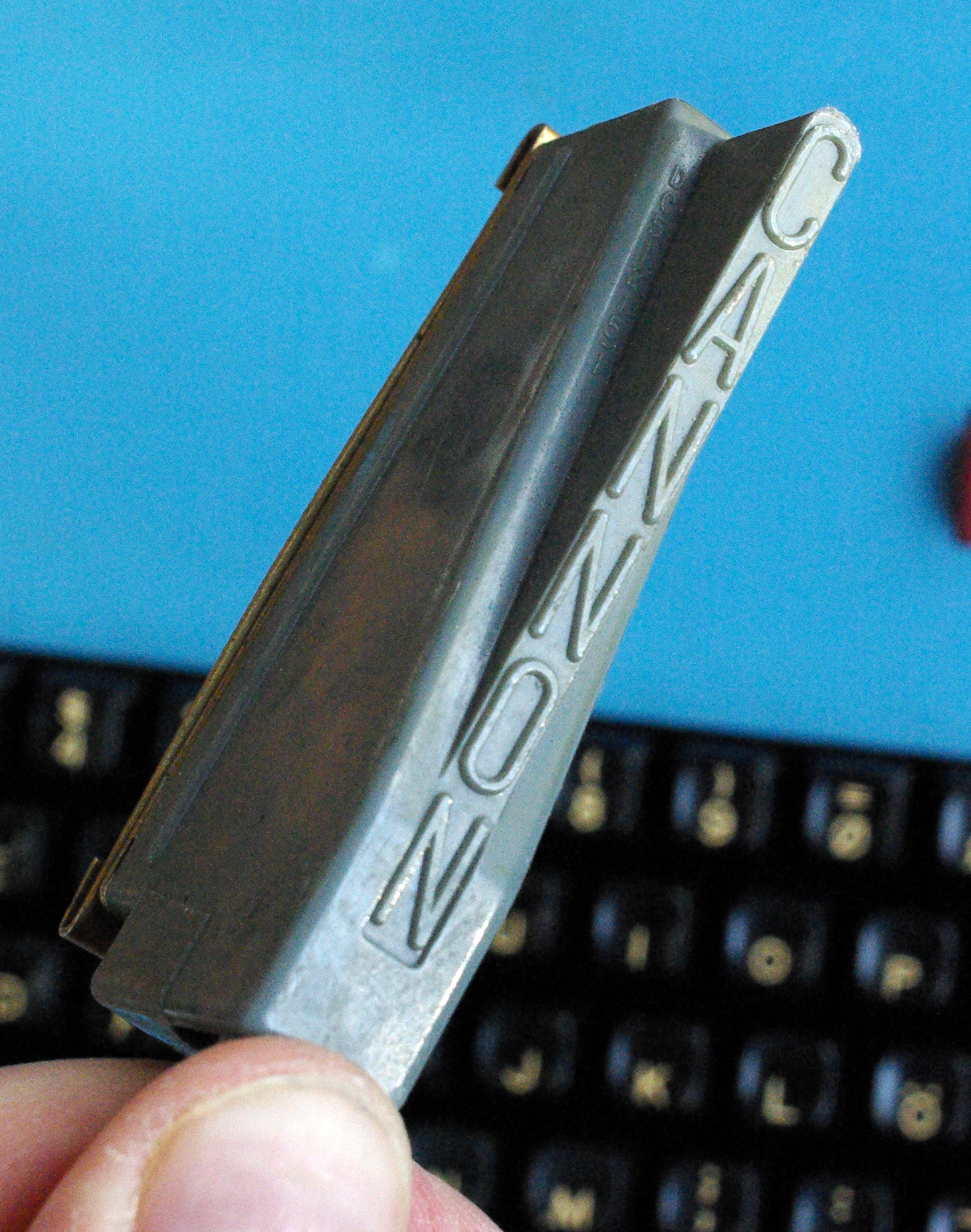

There is no branding in or on the case, the only branding being on the side of the connector reading "Cannon".

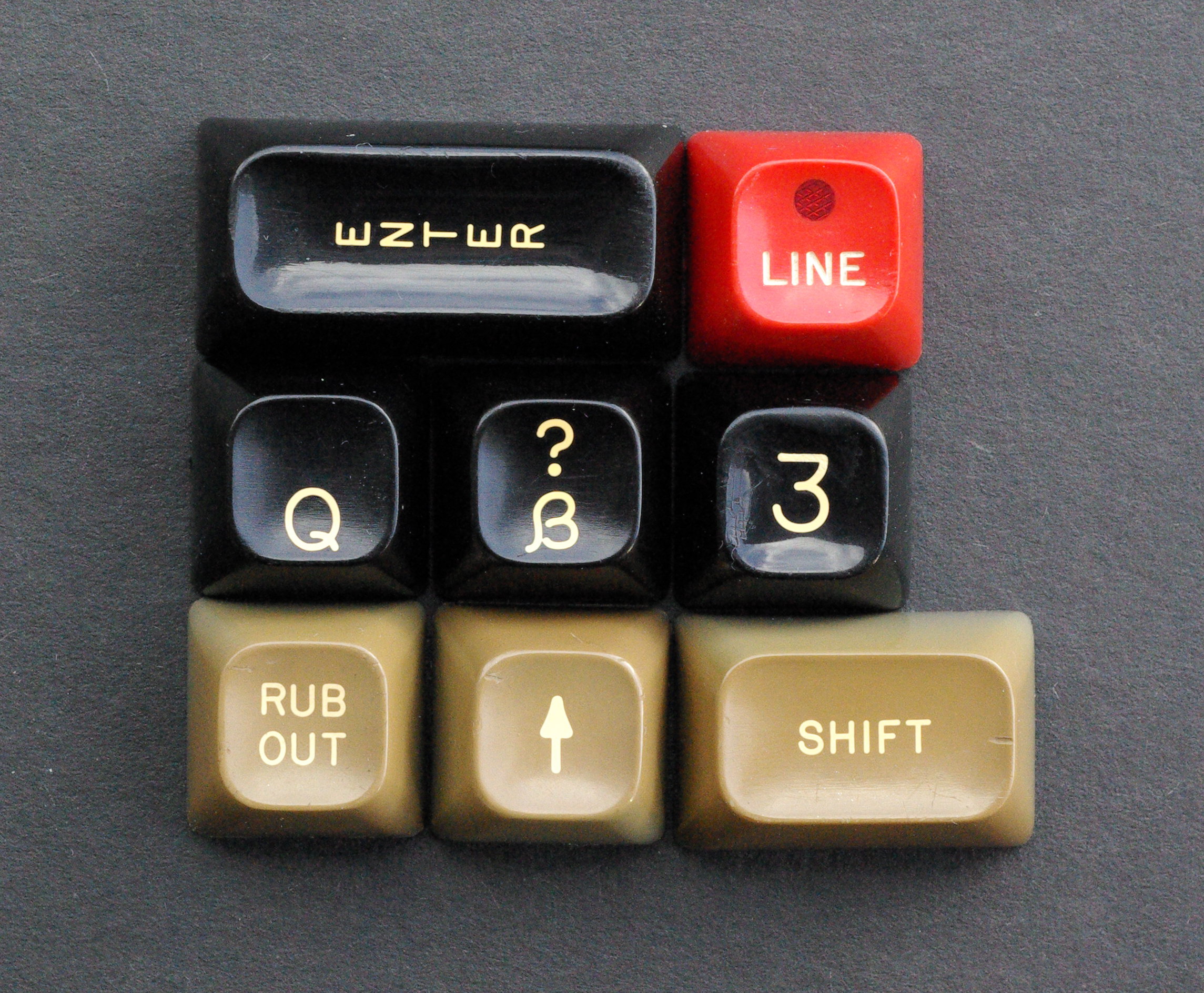

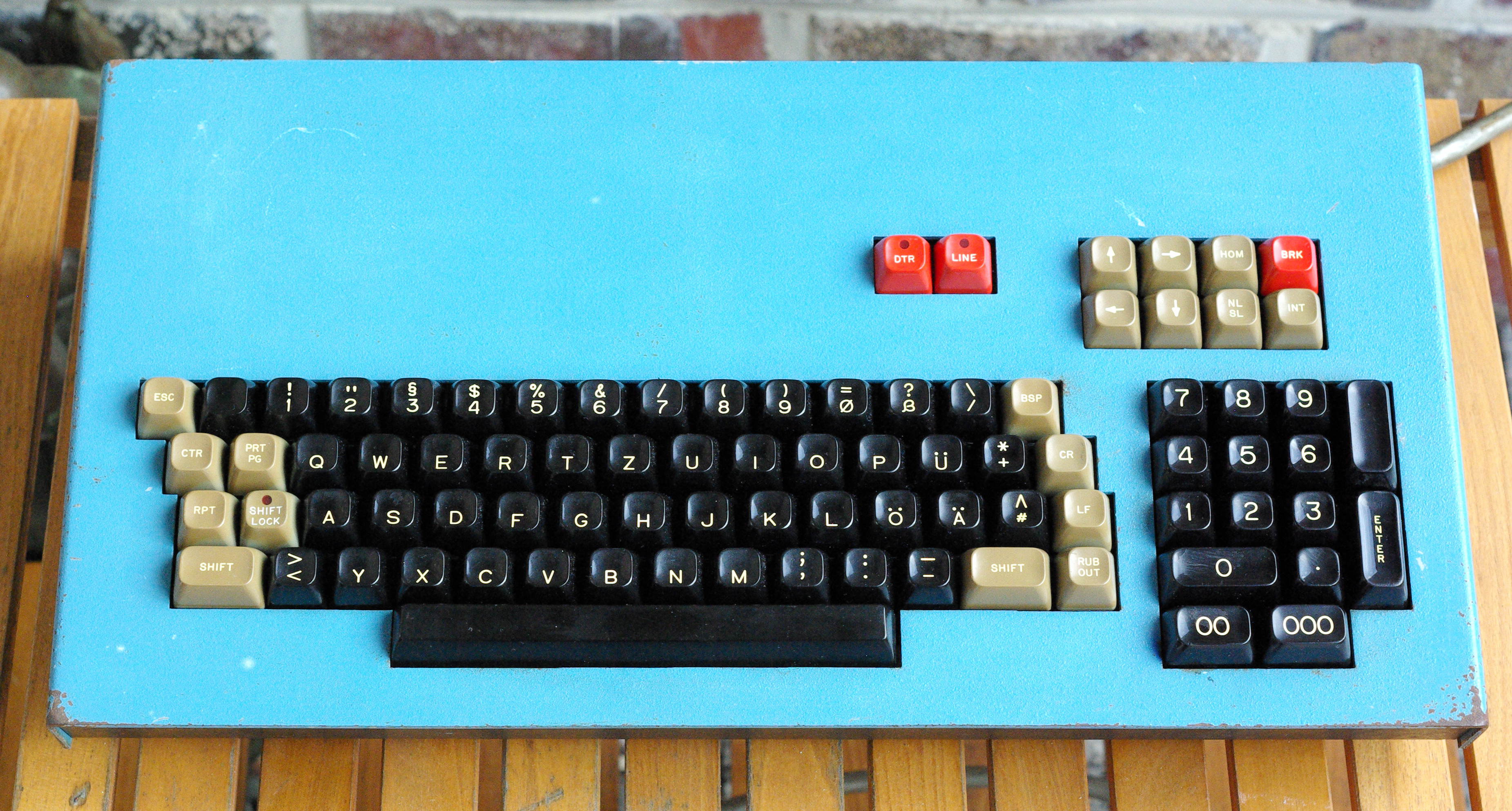

Say hello to Mr. flat top three! The keycaps are nice but cannot compete with Micro Switch.

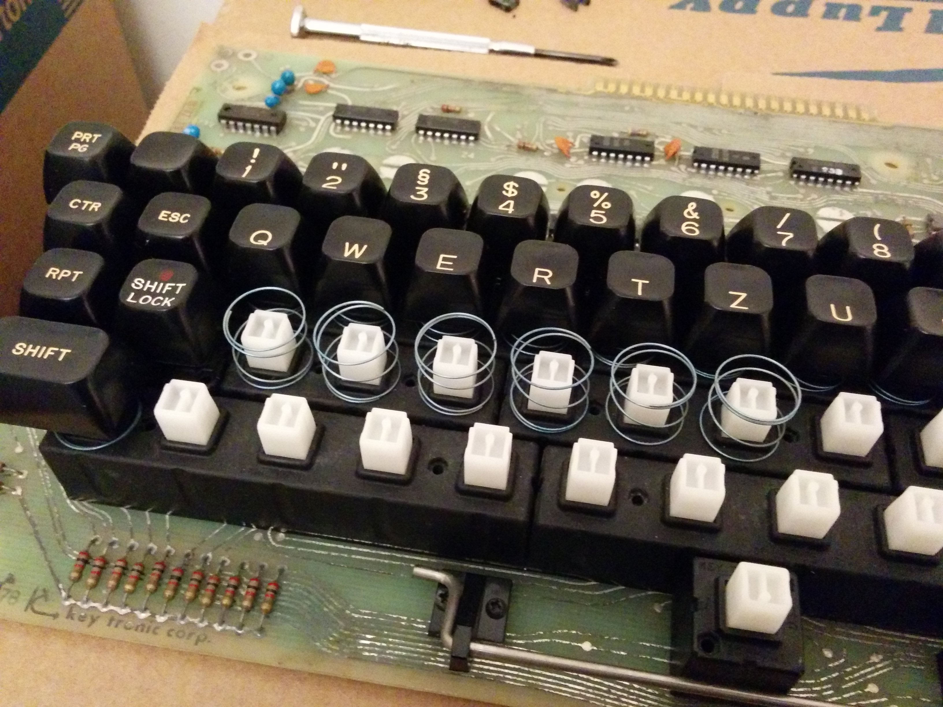

seebart wrote: I have not measured the actuation force which seems to vary due to corroded(?) springs.
Corroded springs? Possibly that's why they changed to a round slider with spring on the outside. With the spring on the outside, air can flow preventing moisture buildup. (but it's just a theory)
23 Oct 2015, 19:11
OK thanks for the infos mr_a500.I know you have some Key Tronic knowledge. The springs are on outside, on top of the slider right under the keycap. Only the LED sliders have a smaler spring inside. Still, some of the normal springs seem eroded in some way.

Oh yeah, right. I should have looked more carefully at the pictures in the thread I linked, but I was focused on your photo with the spring underneath. (Doh!)
23 Oct 2015, 19:22
No problem, added a phone pic of some of the springs. If anyone noticed a little keycap color mismatch in my pictures, I got two complete keyboards of these. The other one is from 1980 and has beige alphas and grey function keys. I mixed a little for the photoshoot.

zslane
23 Oct 2015, 19:26
Those keycaps are vintage sphericals. All vintage sphericals are special. I could stare at them for days...
23 Oct 2015, 19:29
Yes they are zslane, but my Micro Switch sphericals are nicer. These were worth cleaning though. ;)
