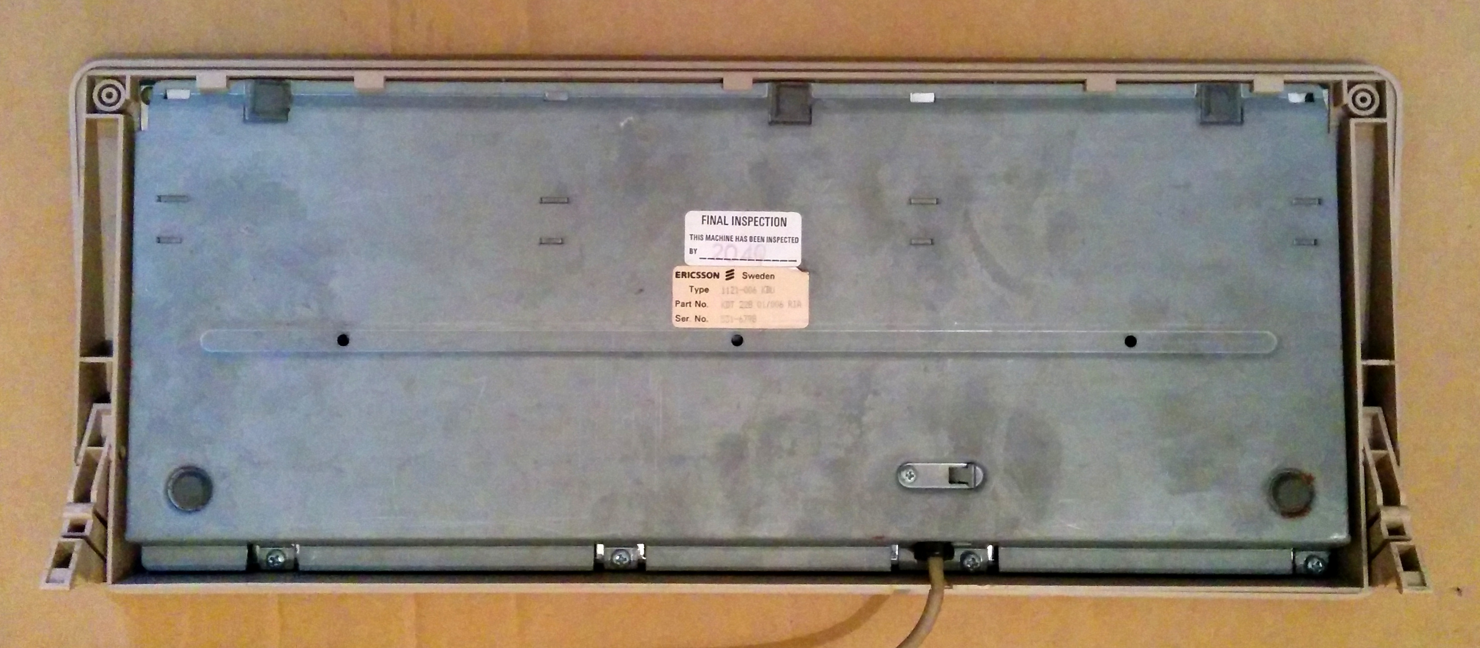

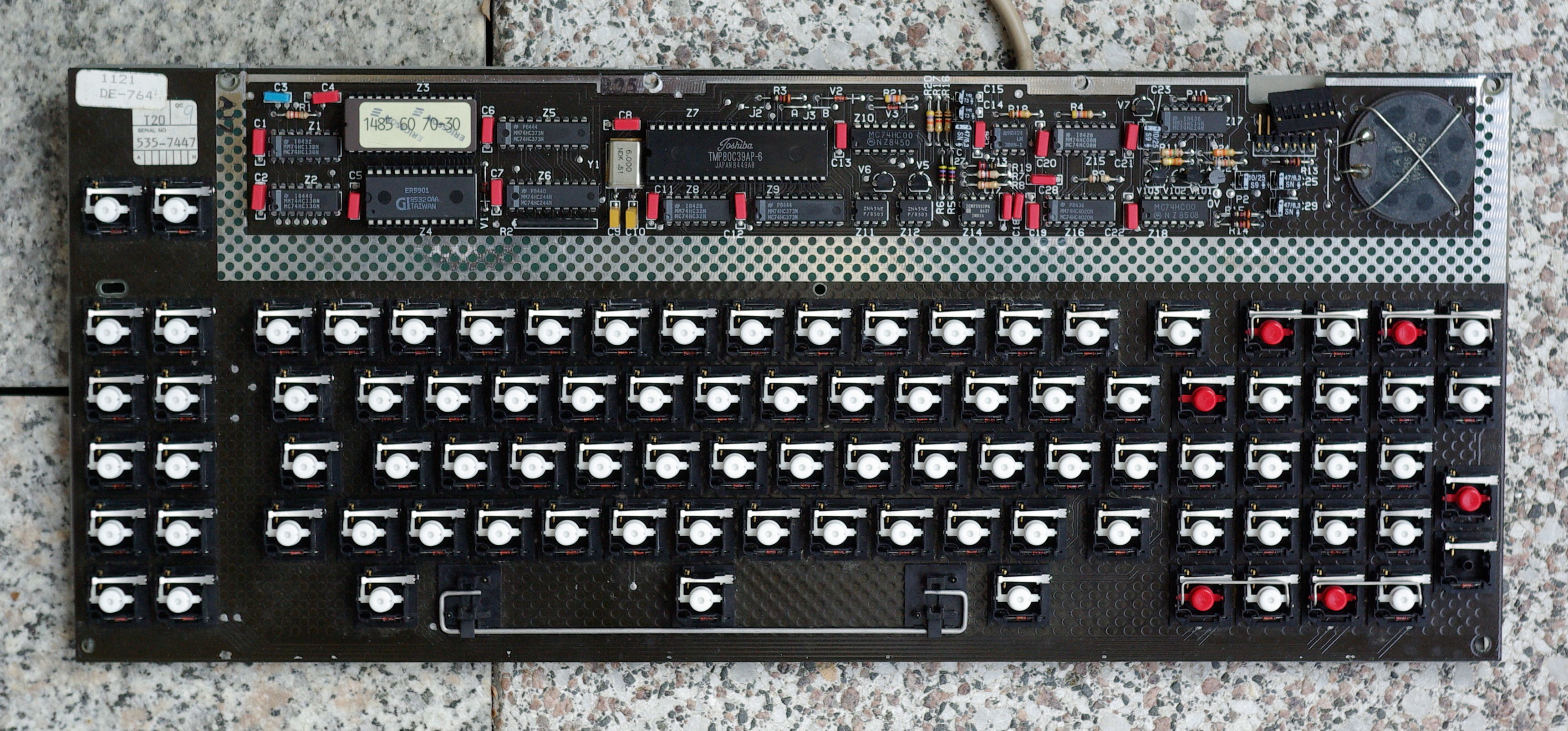

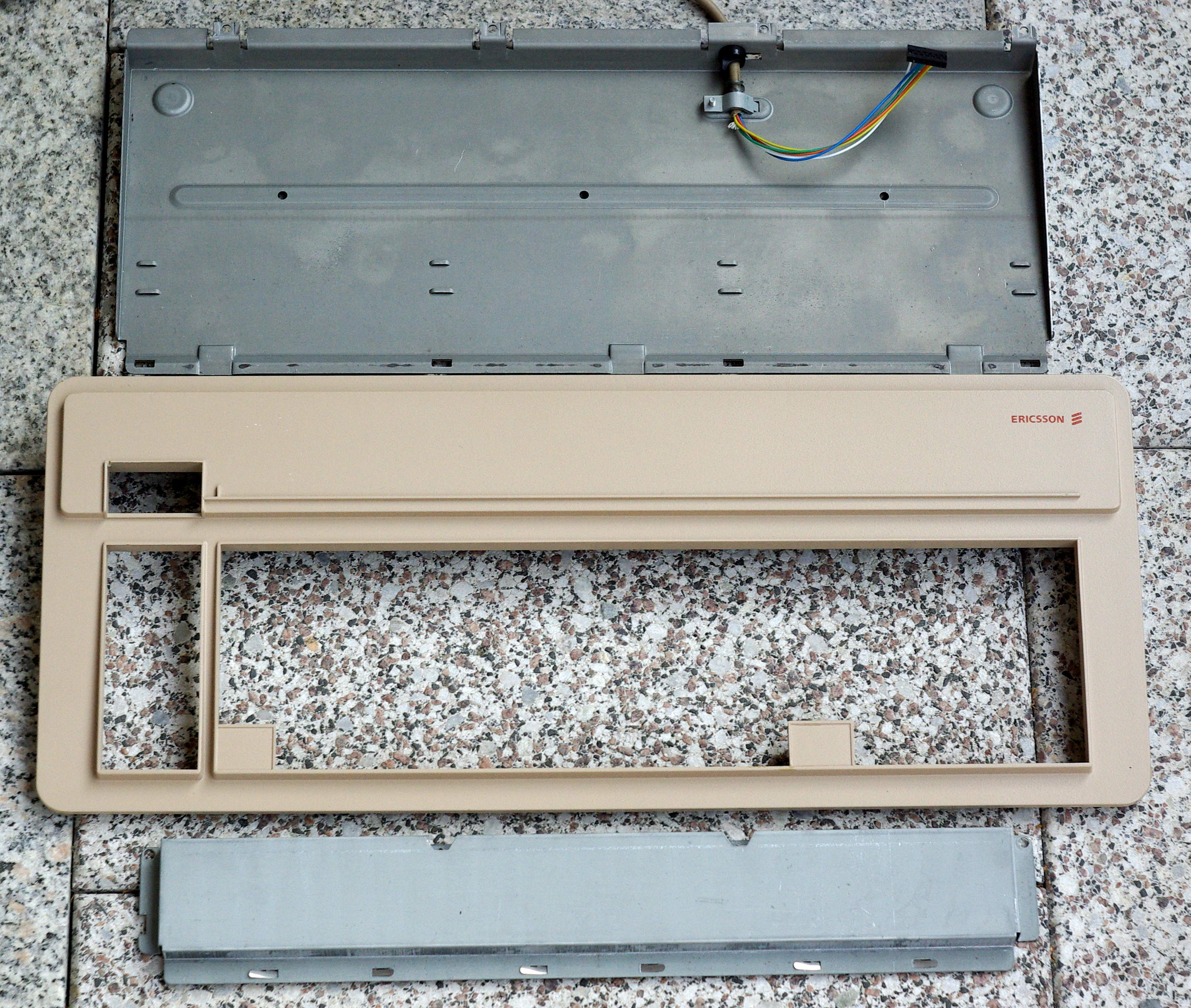

We've had this keyboard before here at DT, these do not show up that often. This Ericsson terminal keyboard uses the Ericsson RMD 973 linear PCB mounted switch. I found two similair keyboards online that were part of the Ericsson Portable PC and and the Ericsson 8088. I cannot see a production date anywhere that makes sense to me.
Ericsson 1121 back.jpg (925.85 KiB) Viewed 3124 times

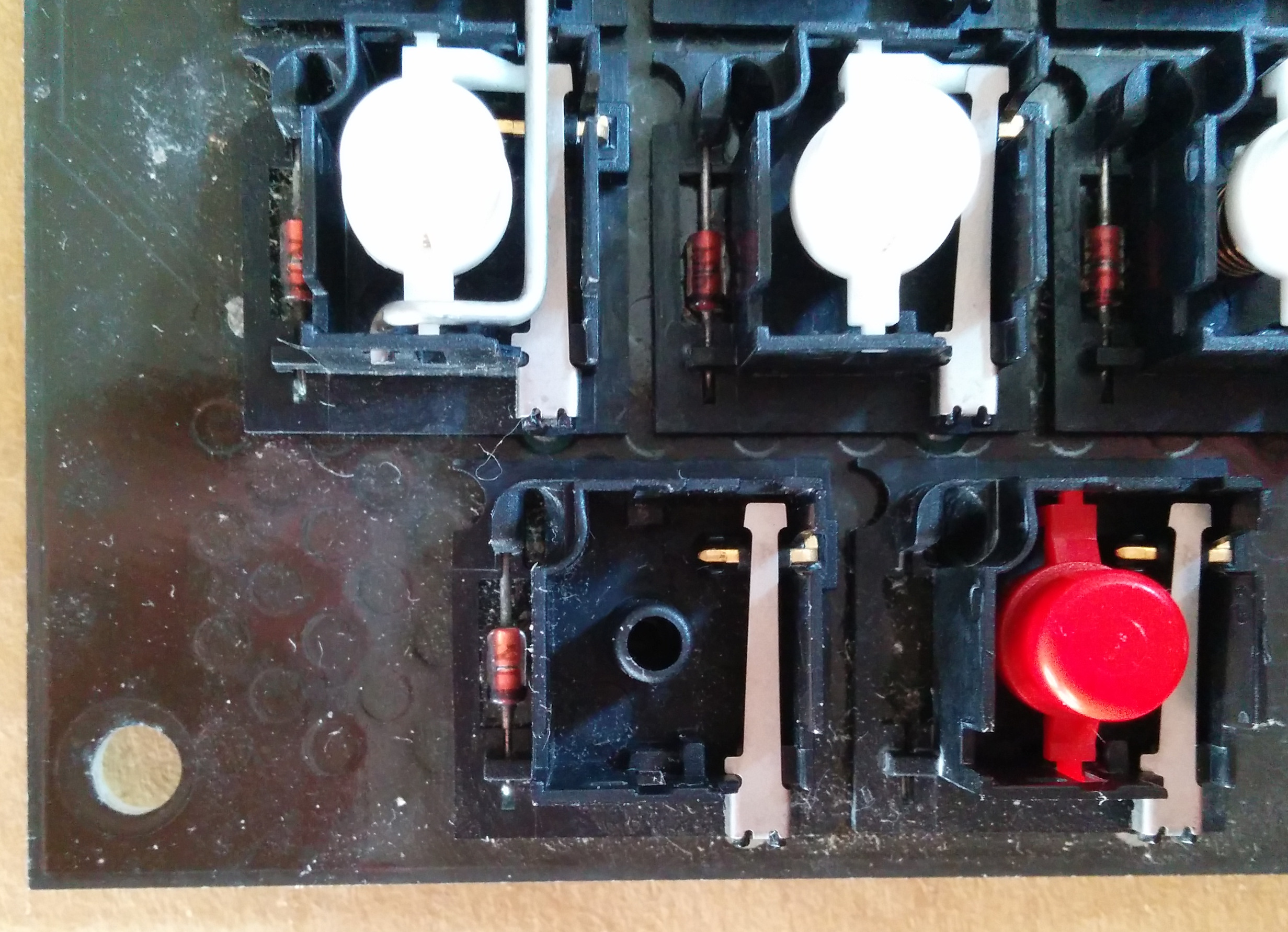

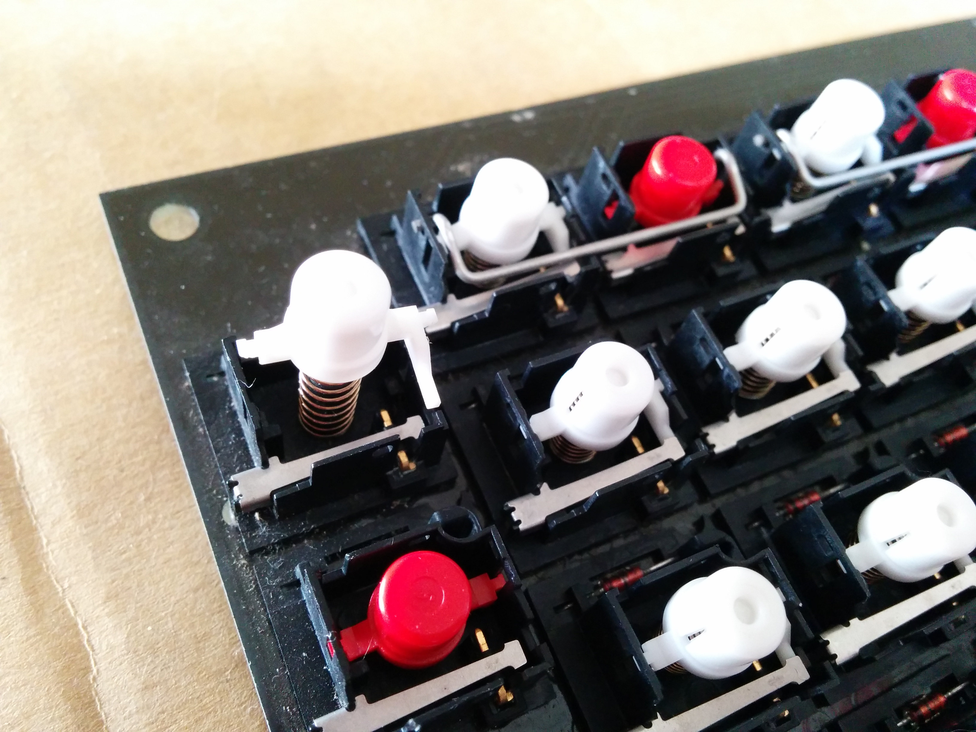

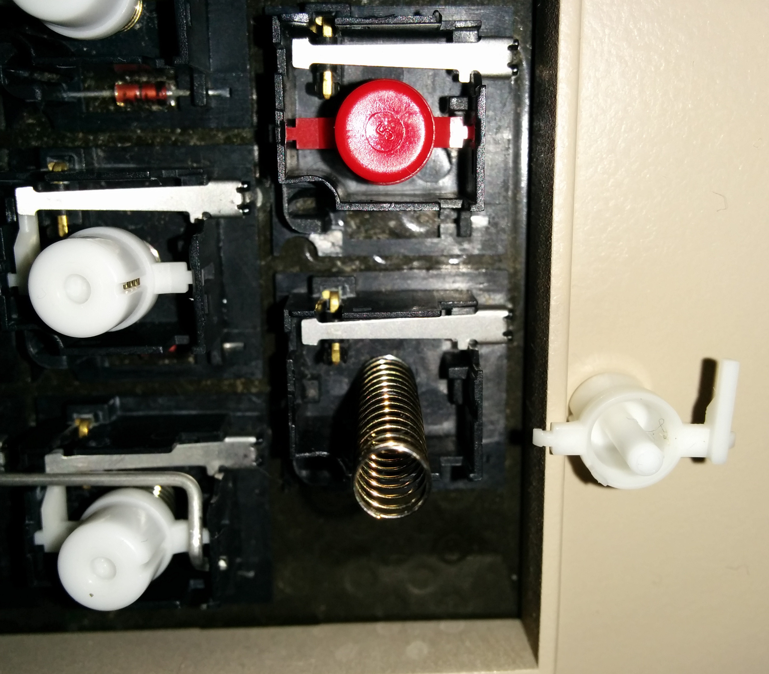

The Ericsson RMD 973 switch works in that the bottom part of the white slider sits on a spring inside a duct in the center of the switch floor. When the switch is pressed the horizontal bar on the white slider presses the horizontal metal contact leaf upward.
The actual movement of the bottom of the slider in the duct therefore has nothing to do with the actual switch mechanism other than the movement. The white slider is held in position in two little vertical recesses on either side of the switch housing. I hope you can see all this in my pictures.
Ericsson RMD 973 series open.jpg (932.35 KiB) Viewed 3124 times
Ericsson RMD 973 series spring.jpg (936.35 KiB) Viewed 3124 times
Ericsson RMD 973 series bare.jpg (933.9 KiB) Viewed 3124 times
On my personal switch smoothness scale this Ericsson RMD 973 switch can compete with 1985 MX blacks or NMB HI-TEK linears. Not shabby at all. There is no tactile feedback.

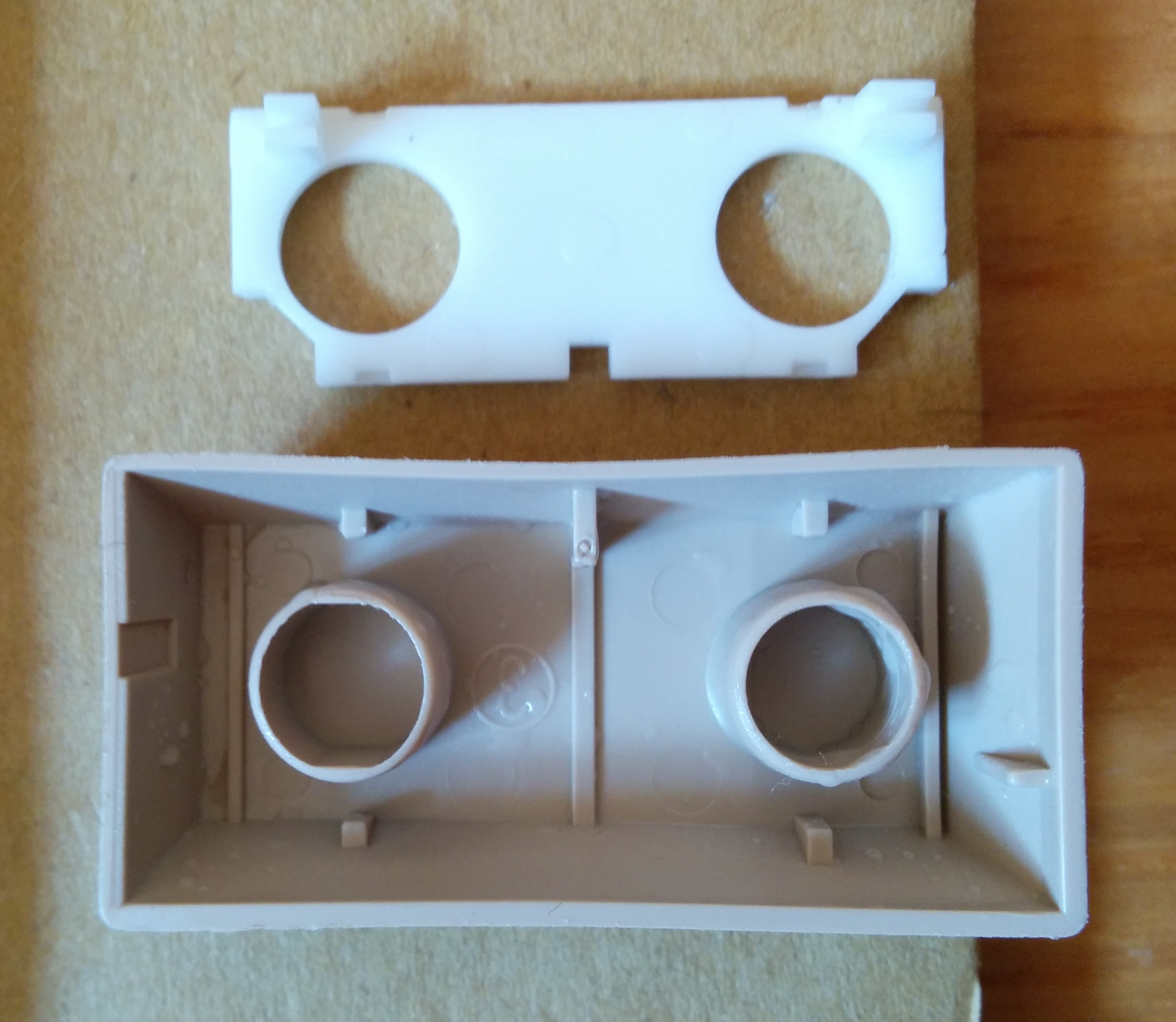

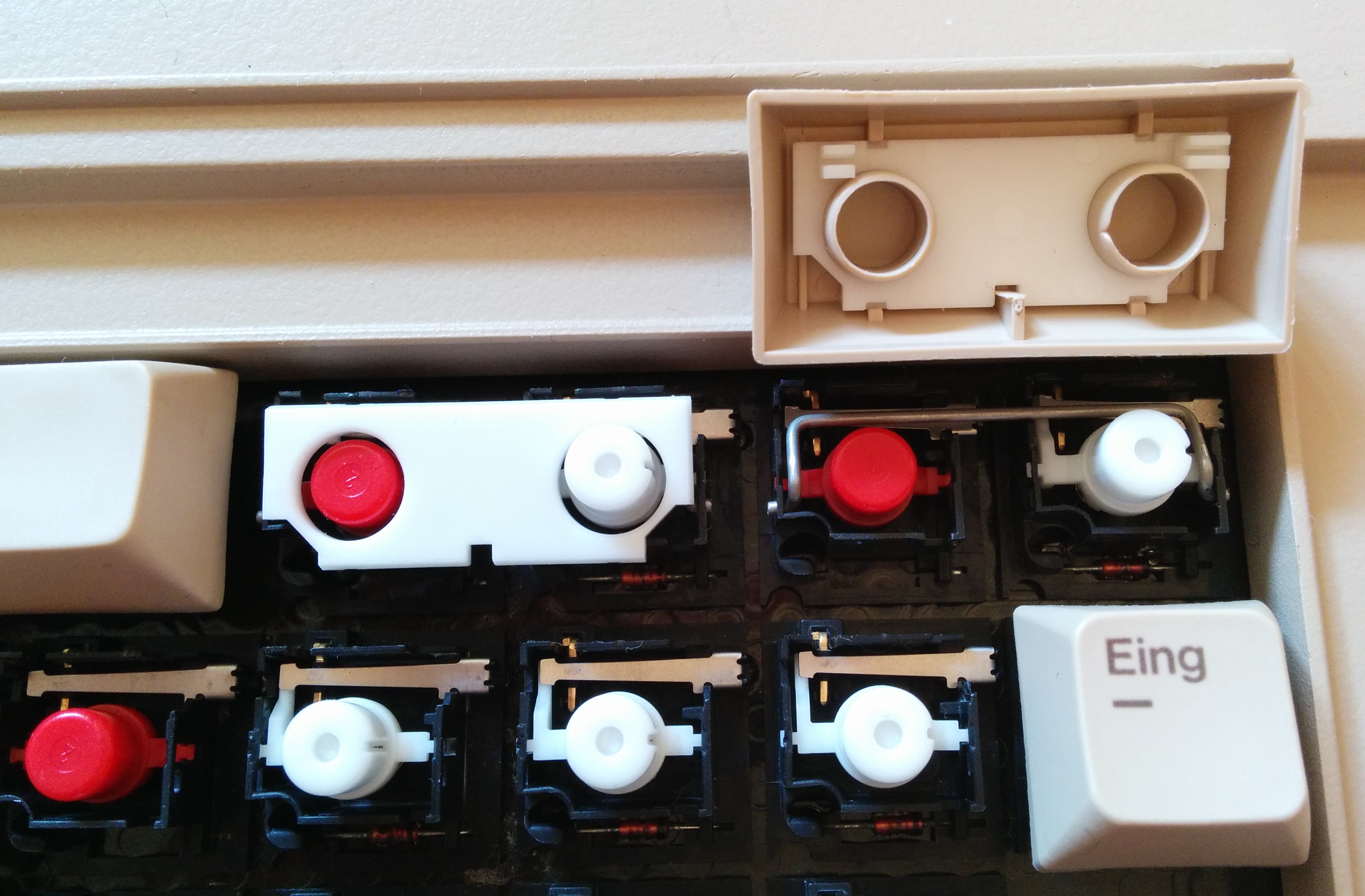

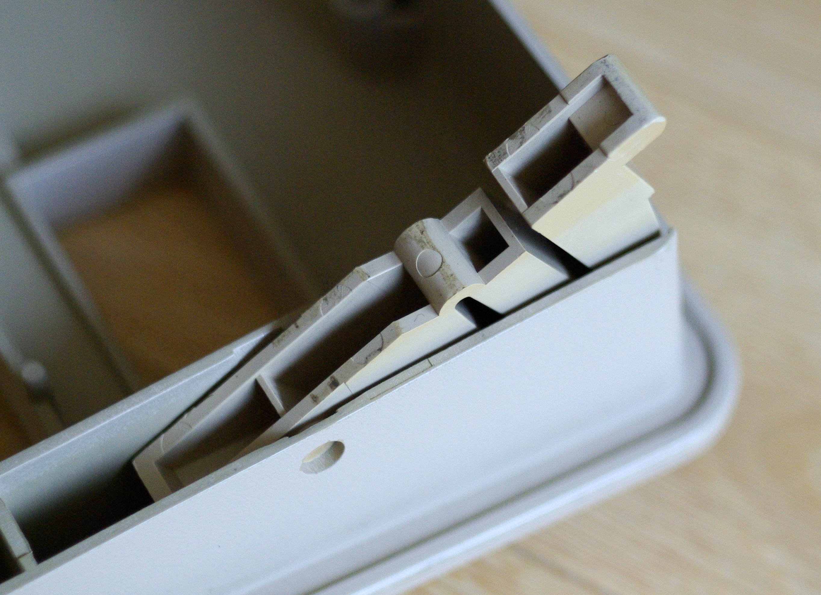

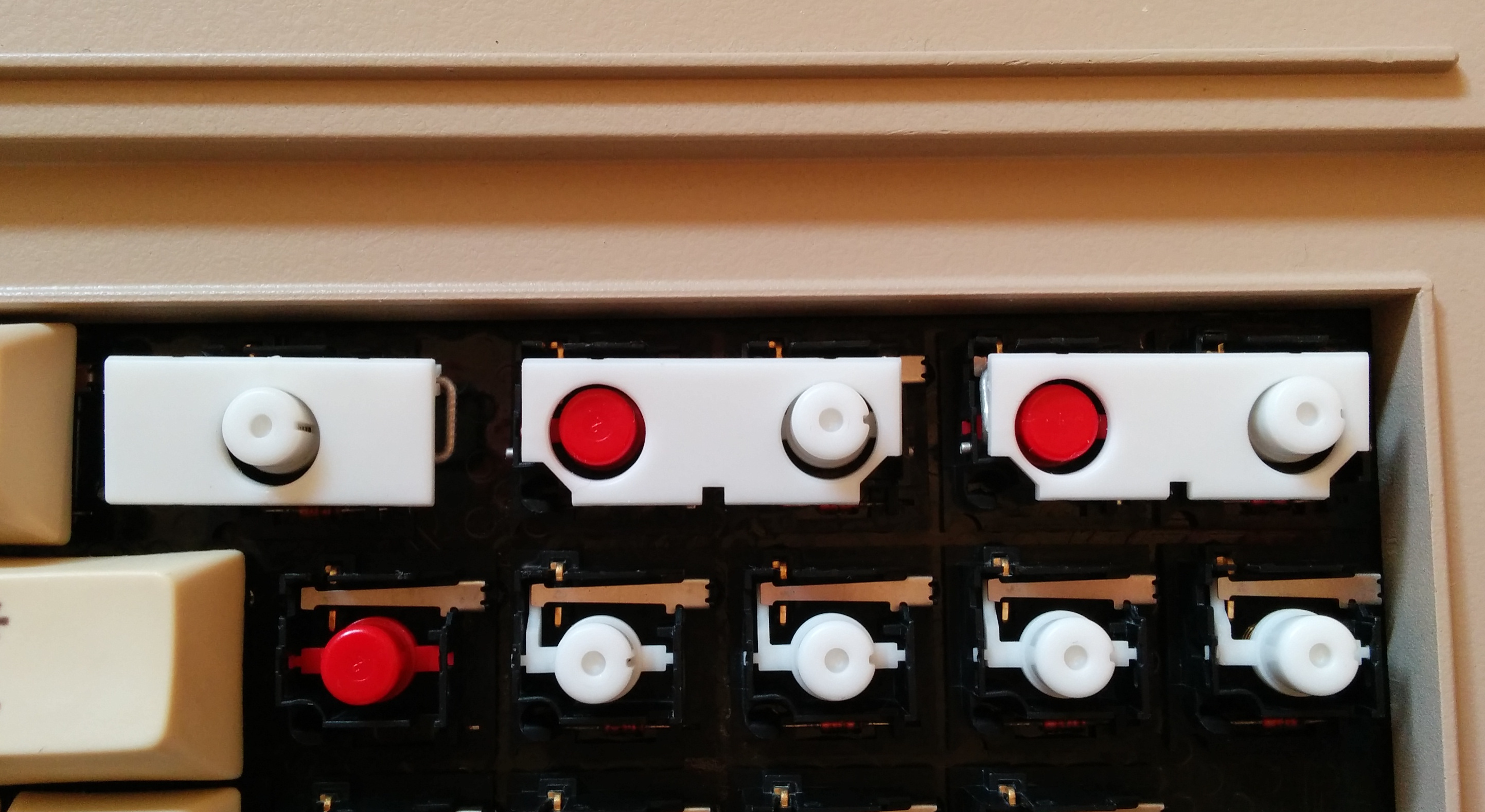

Key stabilization is interesting, the metal bars hook into the switch housing and snap into plastic plates that snap into the top inside of the keycap for the larger keys.
Ericsson RMD 973 series stabilizers.jpg (908.16 KiB) Viewed 3124 times
Ericsson 1121series stabilizers.jpg (907.72 KiB) Viewed 3124 times

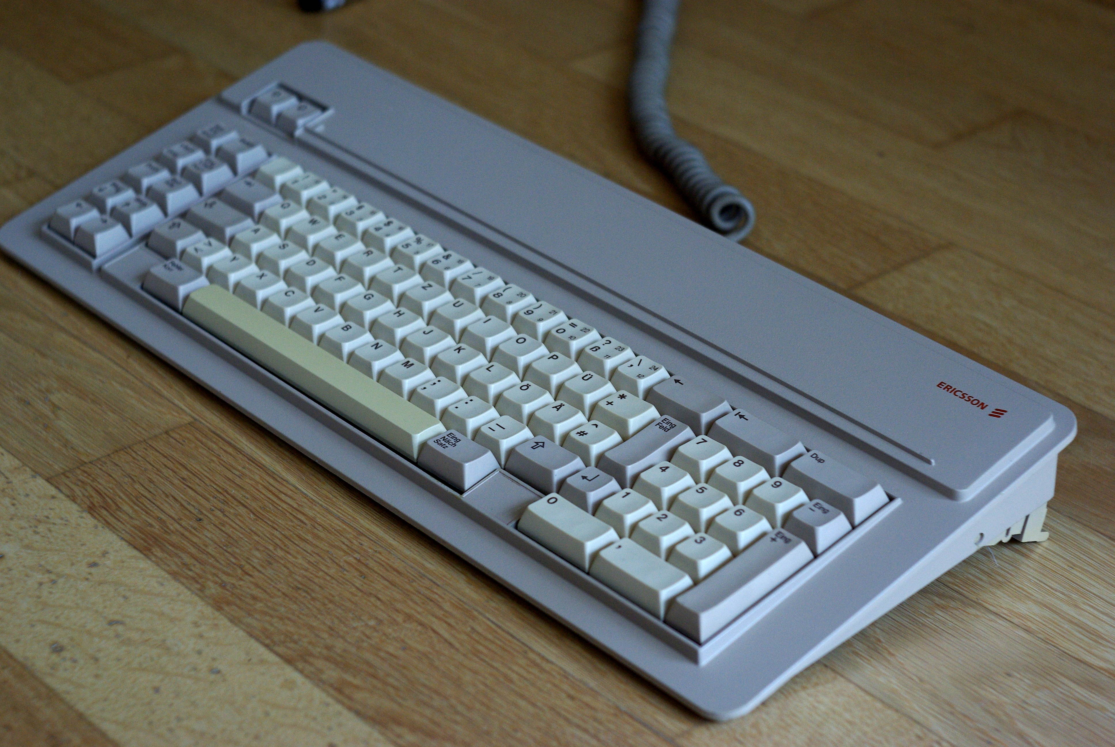

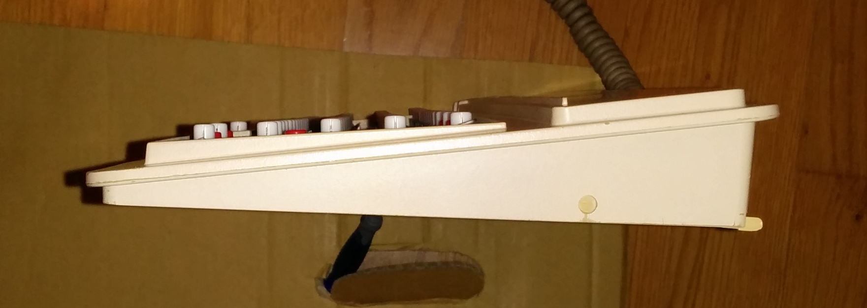

The whole keyboard is pretty low-profile with some very sturdy "drop down feet".
Ericsson 1121 profile.jpg (501.56 KiB) Viewed 3124 times

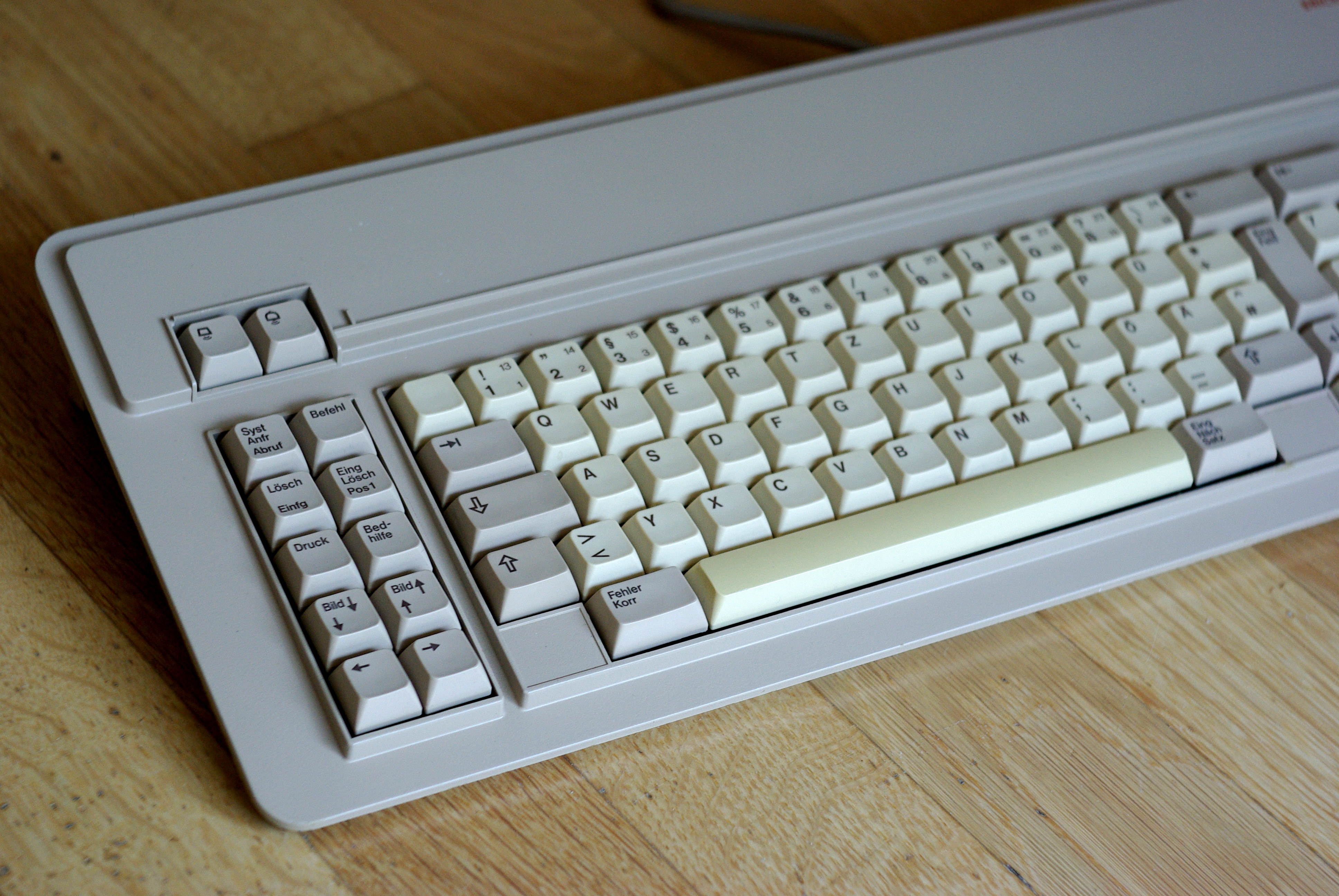

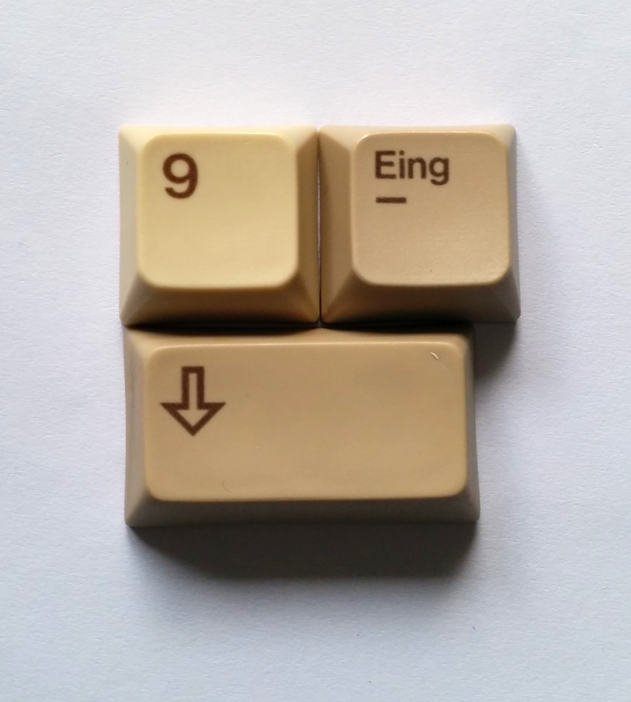

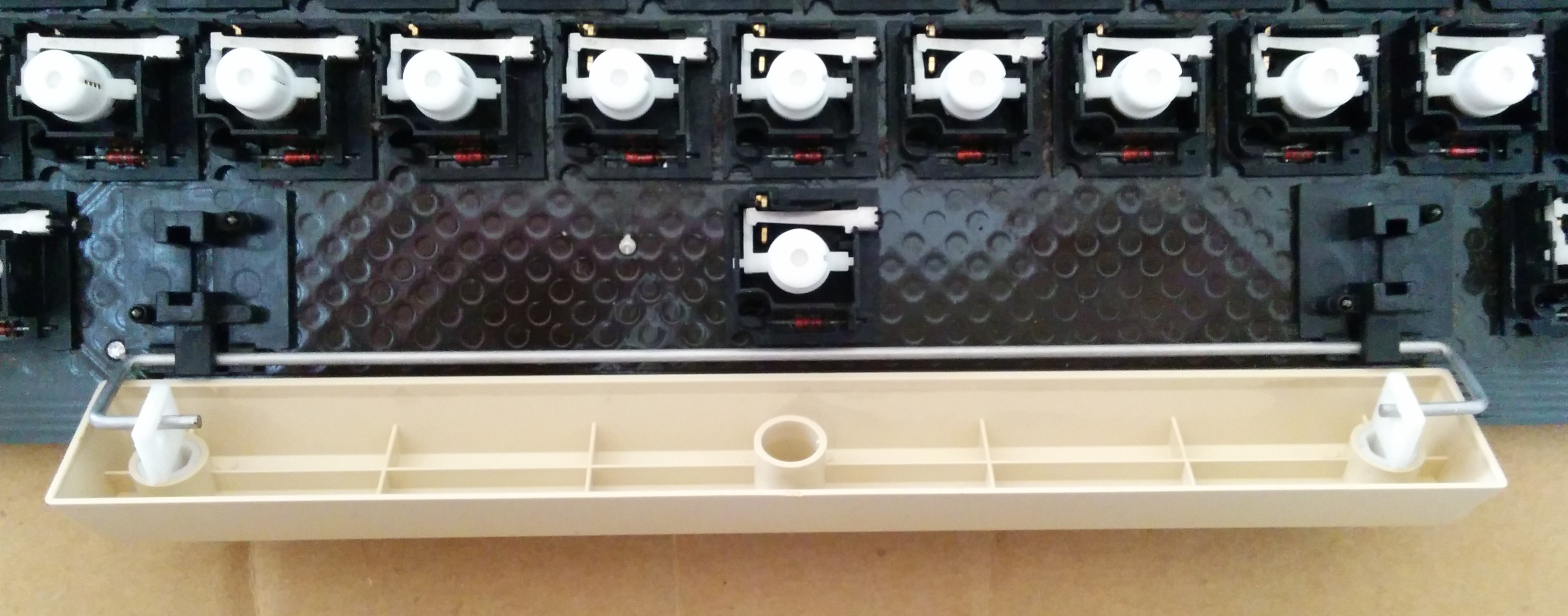

pyrelink, I'd say this is the most effective key-stablilization solution I have ever seen. Hit the key anywhere and you still get super conform keypress, I don't feel those little plastic plates inside the keycap. Of course this involves more parts also. Now for the spacebar Ericsson had to go the regualr way:
The printing on the keycaps is less than desirable but the brownish color is nice:

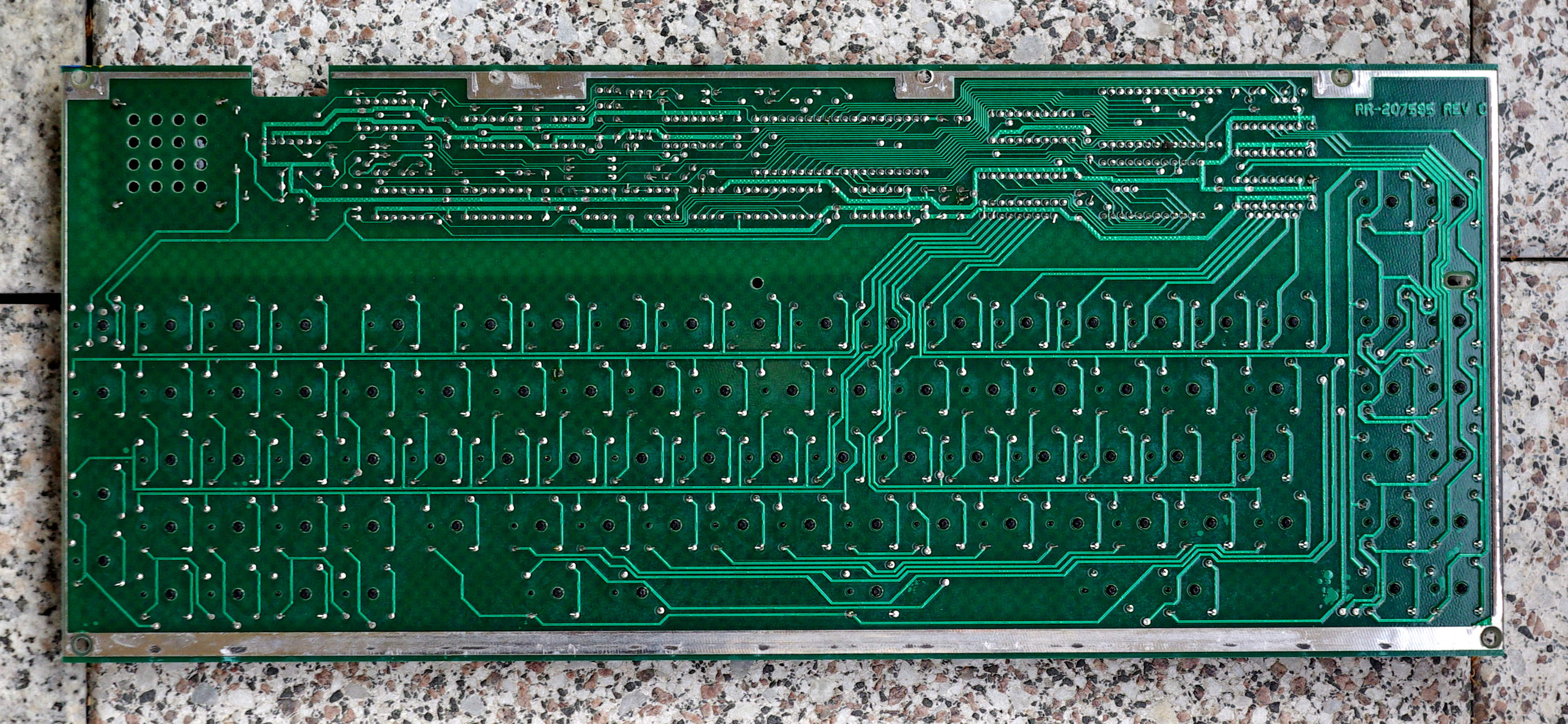

Ugh, forgot the PCB shot:
Ericsson 1121 PCB.JPG (969.54 KiB) Viewed 3005 times
Like I said I only managed to find similair Ericsson keyboards online, not this exact terminal version.

The plastic-peg-in-plastic-cylinder slider design looks pretty well shielded from dust, and assuming the plastic parts have reasonably low enough friction, probably also does a good job of keeping the switch stable / preventing binding from off-axis presses.
