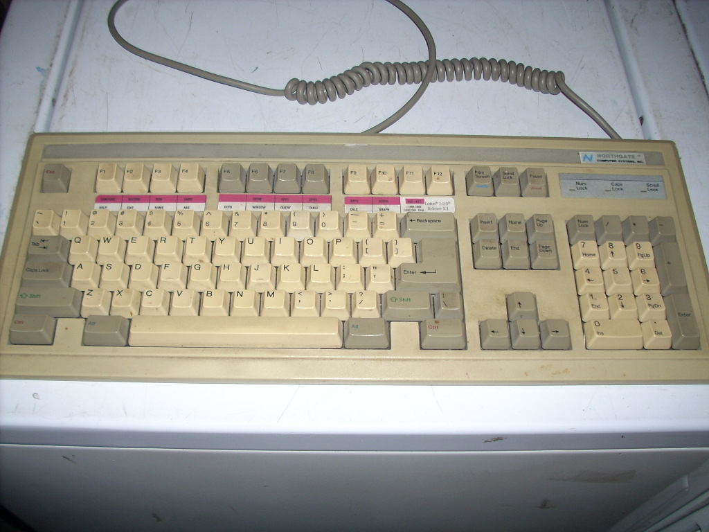

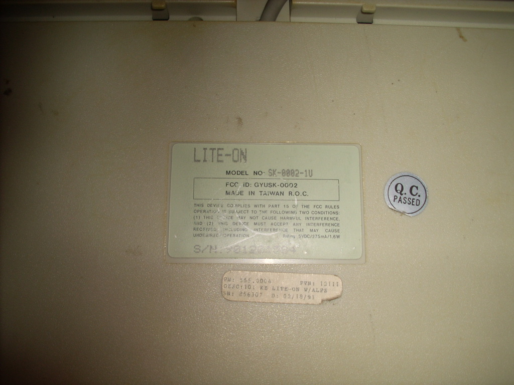

Just found an interesting (to me, at least) Northgate keyboard, $8 on ebay. This is not an Omnikey, but instead probably an OEM board that came with a system. It's really a Lite-On SK-0002-1U (Silitek), but with a small Northgate logo. Otherwise nothing special. Badly but evenly yellowed, double shot caps, white Alps SKCM switches, gratuitous Lotus 1-2-3 stickers, seems to be in decent shape otherwise.
Most interesting is the paper label on the back, with a Northgate (5xx,xxxx) model number, a different serial number, and date. This is a smaller paper label than the ones on the Omnikeys, but otherwise very similar.
<<<Speculation Alert!!!>>> Were these paper labels added by Northgate? Would this explain why the dates on the Omnikeys don't exactly correspond to the switch type? Is this why many Northgate keyboards have two serial numbers--one from the manufacturer, and one from Northgate?

I'm more intrigued by the bizarre model number: SK-0002-1U.
(What is 1U anyway — 101 US?)
I didn't realise Lite-On had bought Silitek that early on, and model 0002 as late as 1991? Strange.
But then, there's cherry-jade's 1984 Dah Yang keyboard … I had no idea Dah Yang went back that far either.

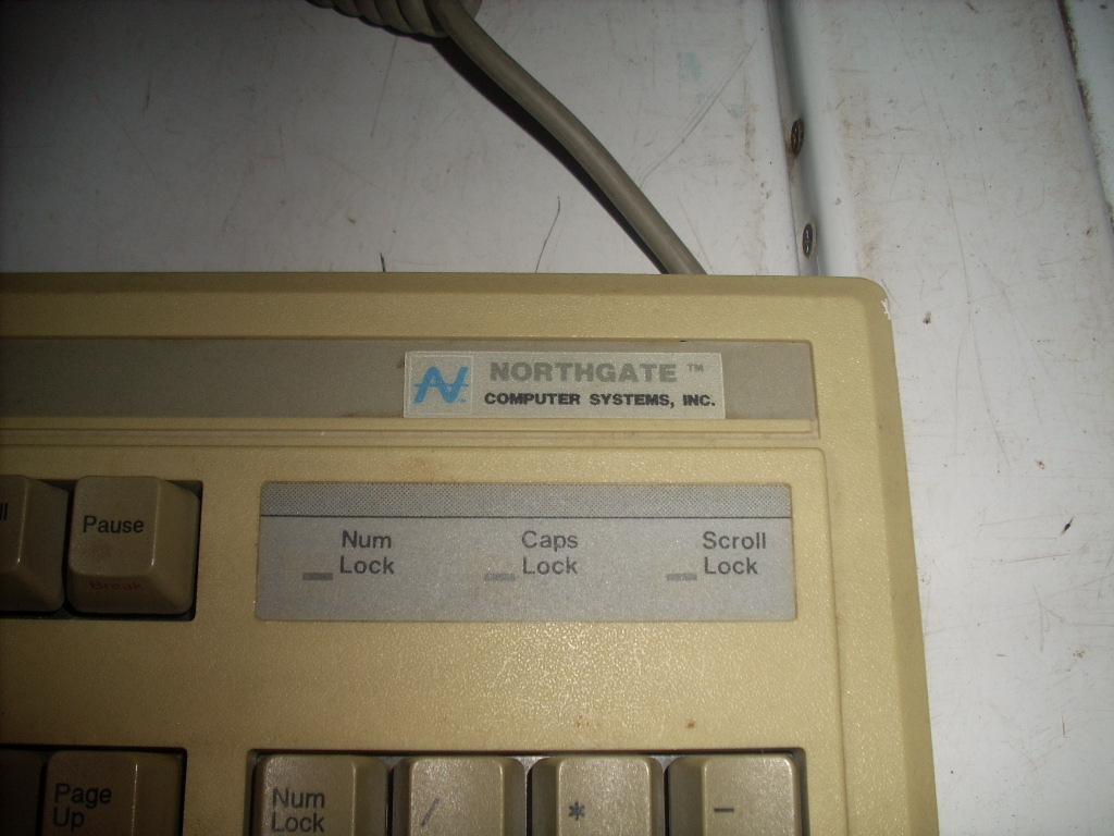

I wonder if there's another logo under where Northgate put theirs. It does appear that Northgate bought and re-badged a stock product. If this was made for Northgate, would their name appear on the label on the back (like with the Win keyboard)?

I double checked the model number, and it's indeed 0002 on mine (slashed zeroes, not the letter O). The FCC on mine and Sandy's are both 0002 (again zeroes). Interesting that the model number would have a number on one version and a letter on another. I'll compare my PC board to Sandy's to see if there's any internal difference.Daniel Beardsmore wrote: I'm wondering now if the serial number starts with the year of manufacture — the examples so far are close enough.

The stripe with the Northgate logo is a snap-in plastic insert, like the ones on Focus and Northgate Omnikey boards. I slipped it out and carefully peeled back the Northgate enough to see a blue "L" under there, no doubt Lite On. No way to know if Silitek or Northgate did the rebranding, but whomever it was they didn't put much effort into it. Lite On keyboards were available as a retail item, so for all we know Northgate could have bought them at the corner computer store and stuck their name on them. Unlikely, but remotely possible. In twenty-some years of playing with Alps and Northgate keyboards this is the only time I've ever seen one rebranded by Northgate this way. Of course the stripe or logo would have been easily removed or lost.
I believe the serial number does reflect the year of manufacture. I've found several examples online, all from 90 to 93 so far.

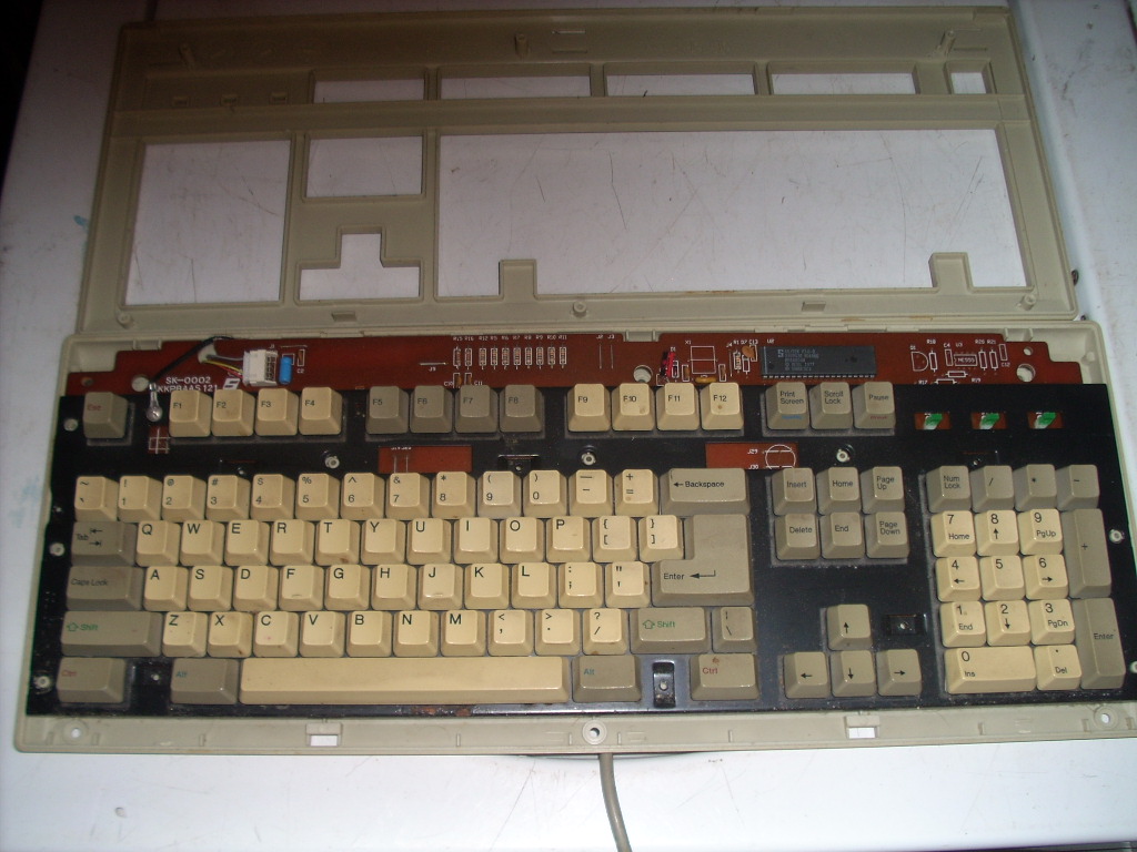

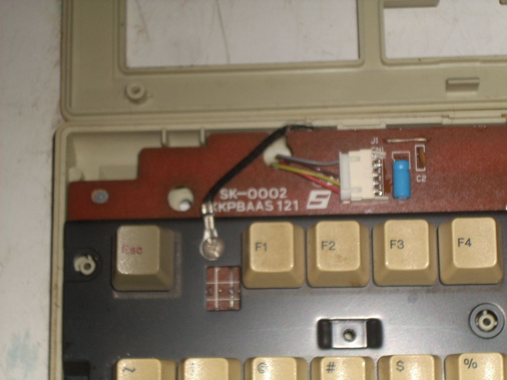

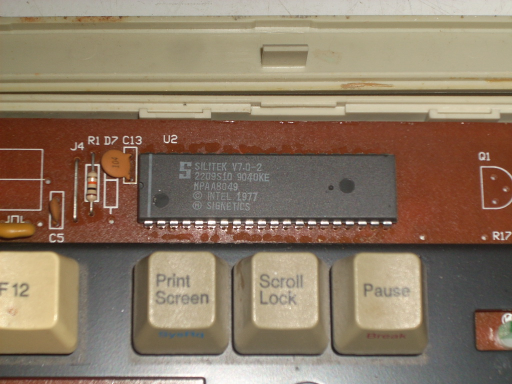

Opened 'er up, no real surprises inside. Mold date 11/25/1990. Silitek on the controller chip. SK-0002 legend on the pc board. The board itself looks like the one on Sandy's site.Polecat wrote:
Anyone opening one of these up should be careful not to break the locking tabs on the case. These are similar to the tabs on a Focus FK-2001, but they are across the top edge instead of the bottom. Once the two snaps at the bottom are unlocked and the board turned rightside-up the front edge of the upper case can be hinged up until it's free of the lower case.

Interesting — that PCB code is very similar to the "PBAA5036" code from the SK-4100R-1U.
