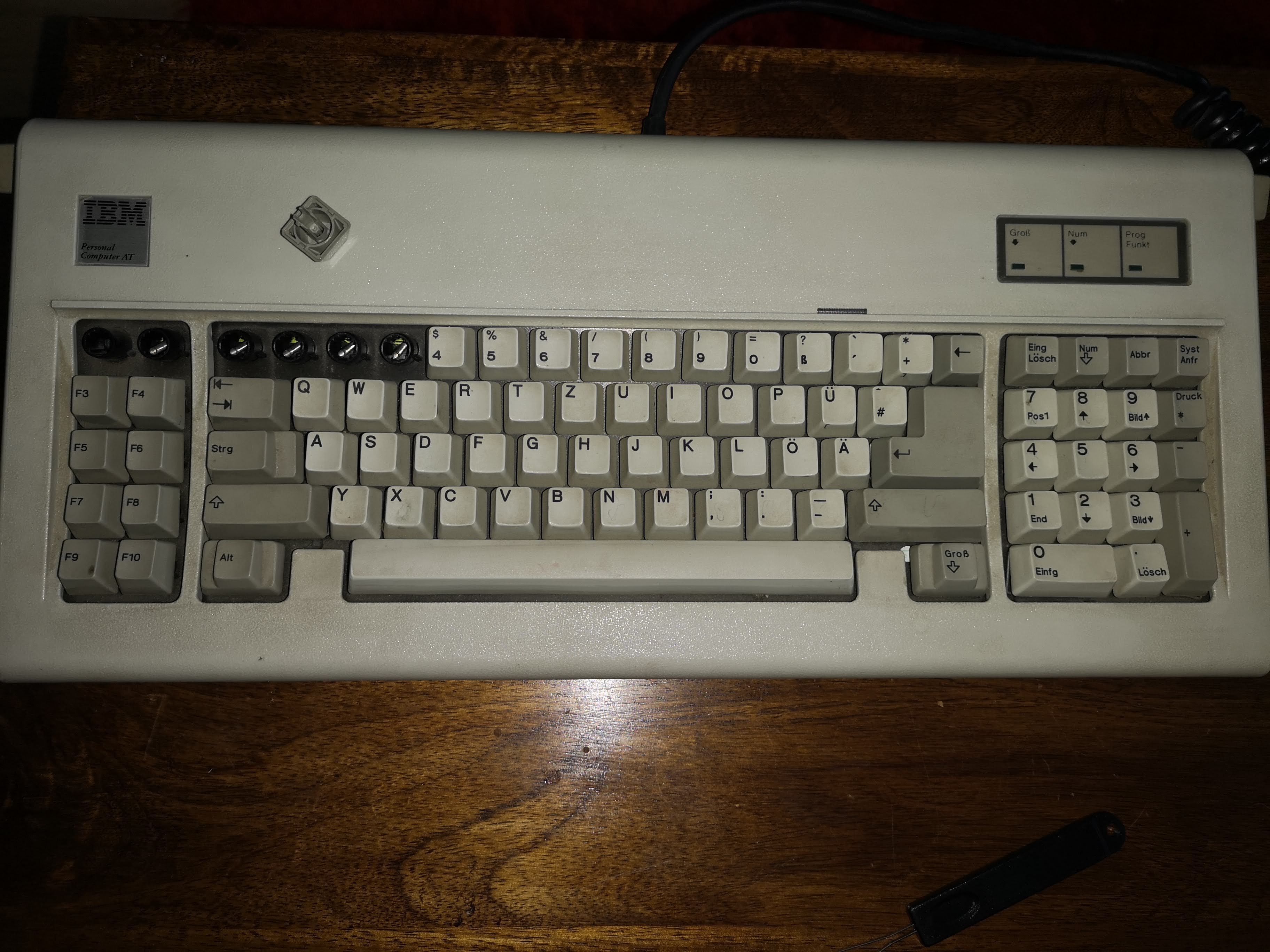

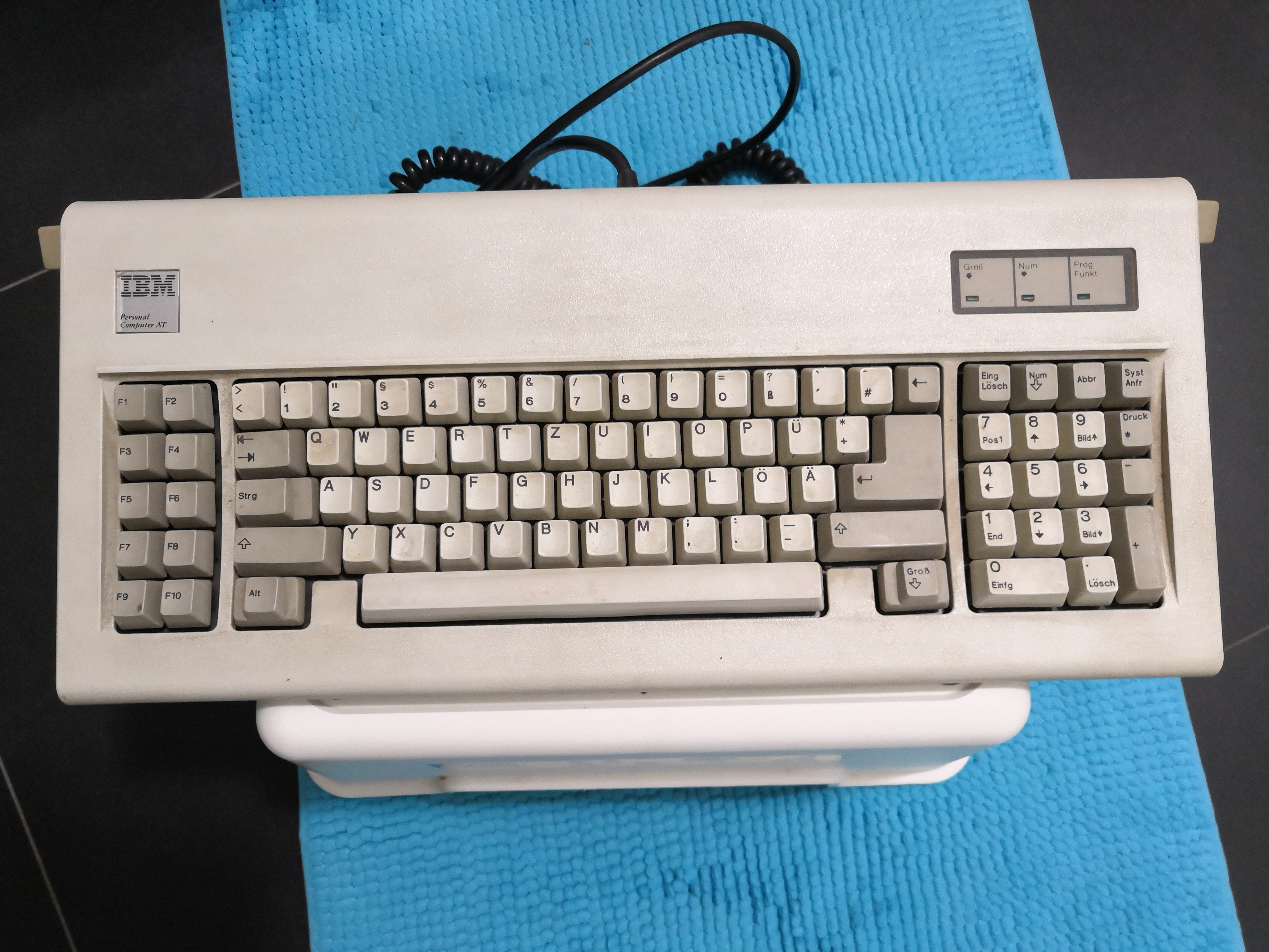

Hello everyone Here is my 1984 IBM Model F AT Keyboard restoration log hope you find it helpful.
How the keyboard Looked when I first got it

Very nice. Those AT's in German layout are super rare it seems and yours seems to be in excellent condition.

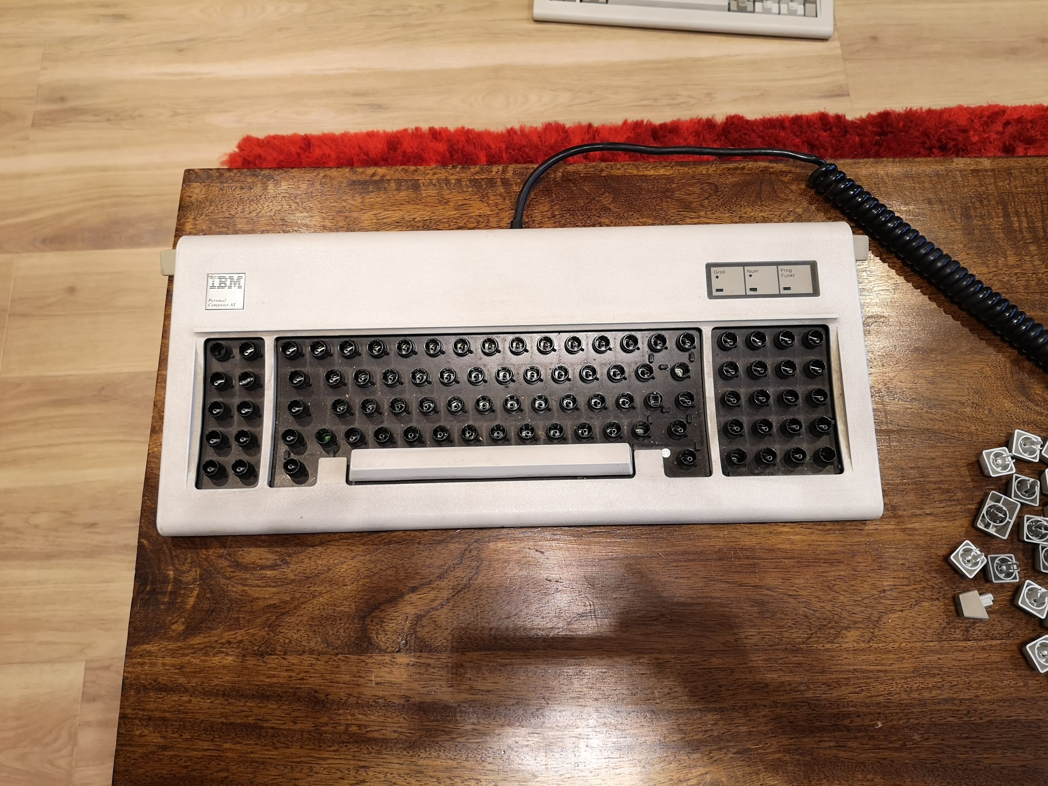

All Key caps removed ready for ISO key caps.
- IMG_20190220_170149.jpg (1.9 MiB) Viewed 9197 times

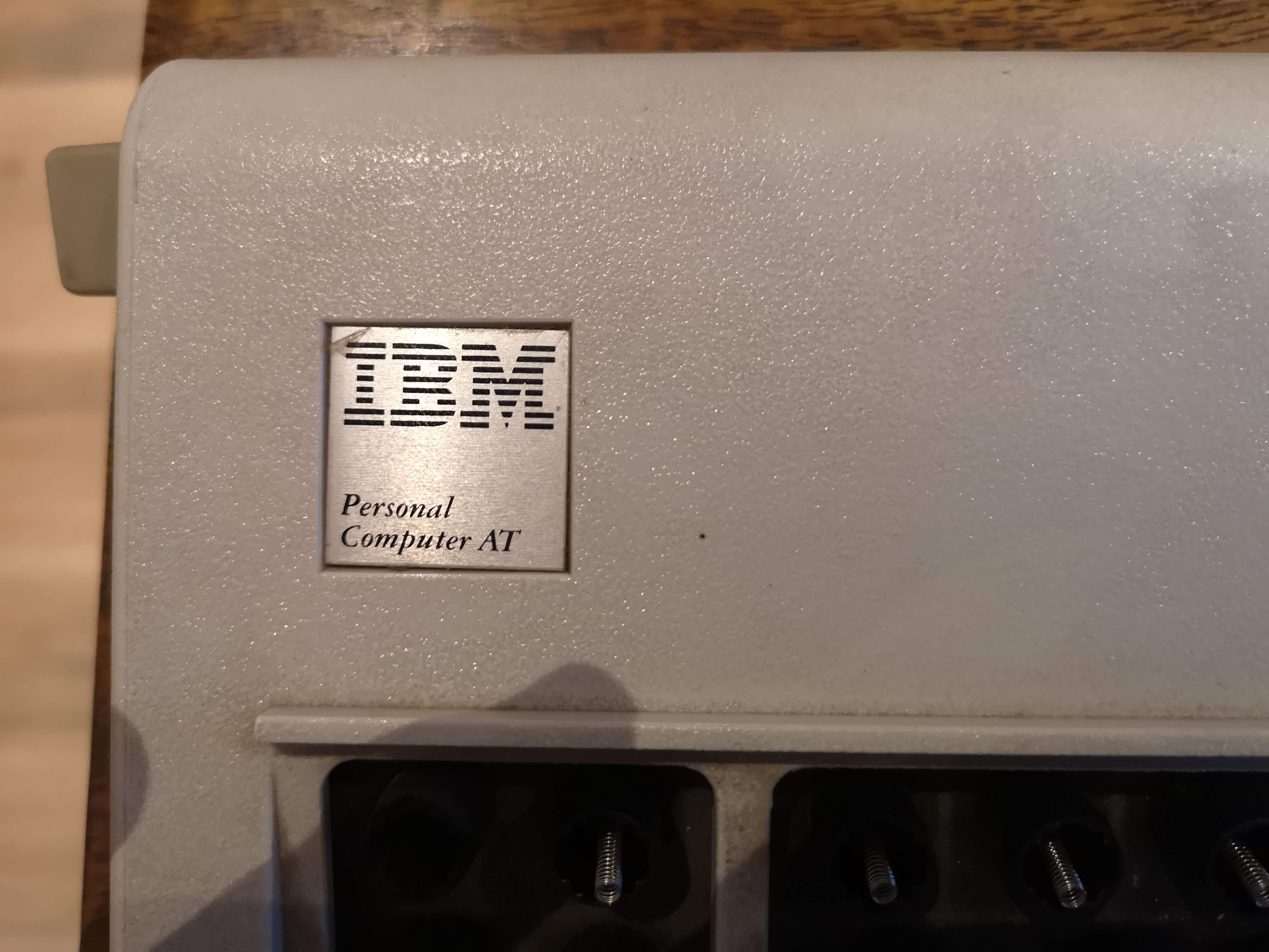

Image of the IBM logo IT EVEN HAS THE ORIGINAL PLASTIC WRAP STILL ON IT.
- IMG_20190220_170200.jpg (404.47 KiB) Viewed 9195 times

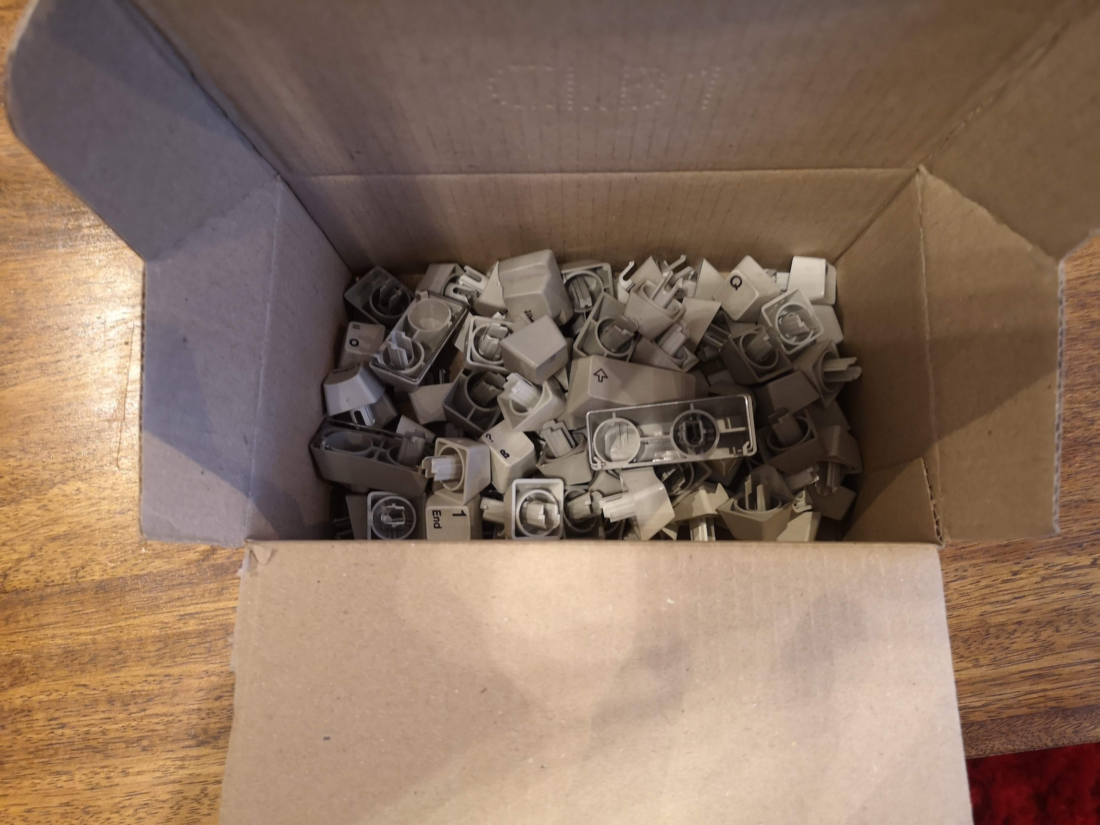

All old key caps.
- IMG_20190220_170520.jpg (417.64 KiB) Viewed 9192 times

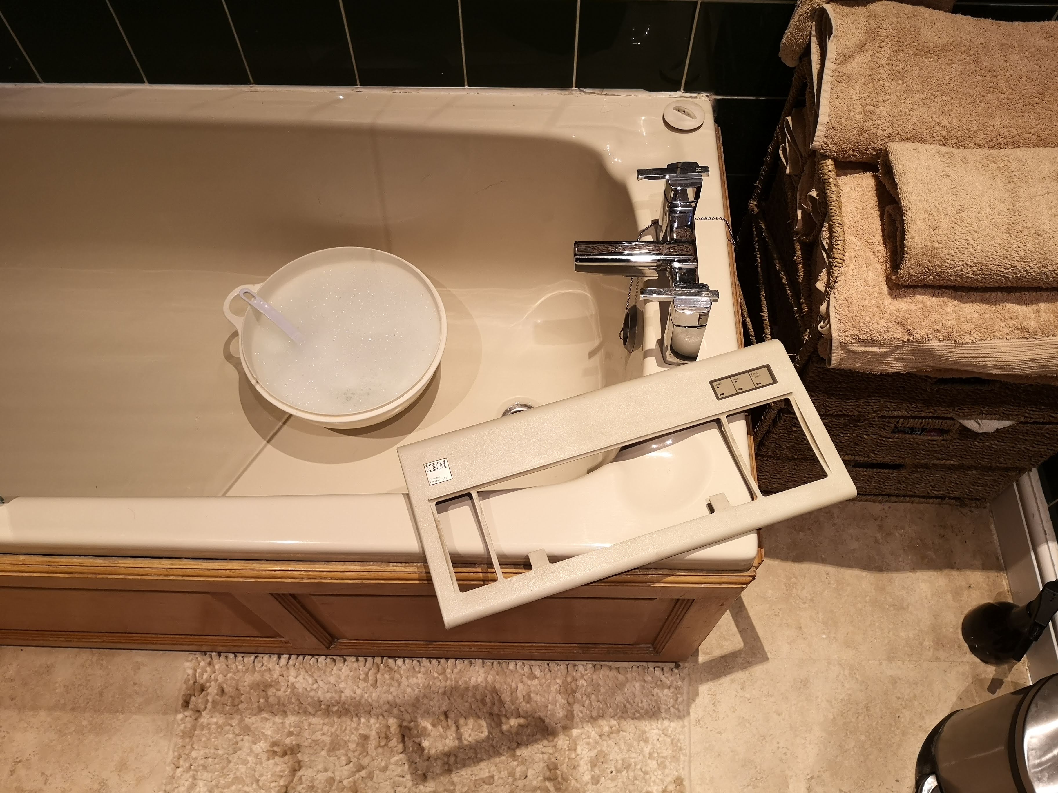

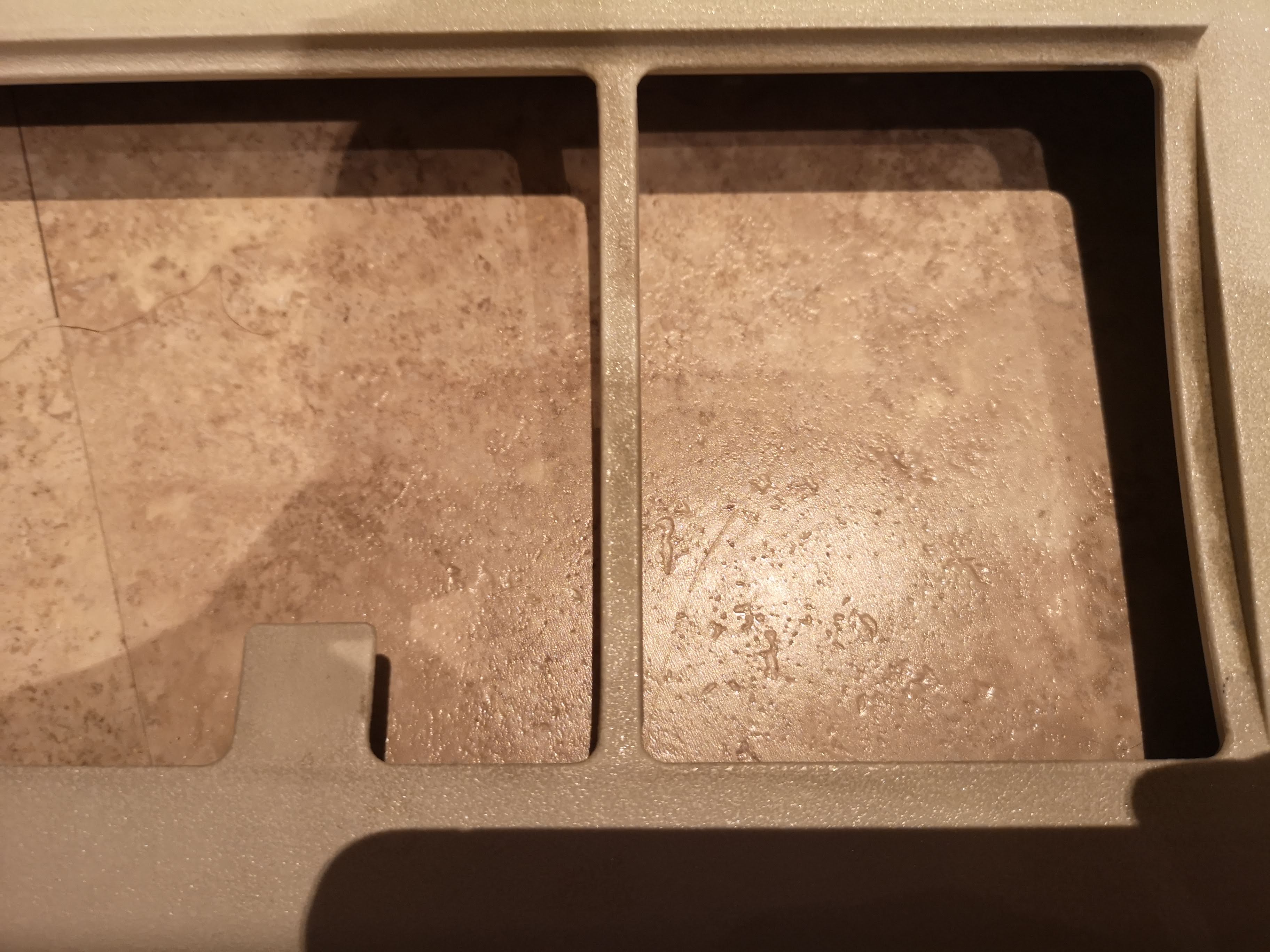

Image of top case before being cleaned.
- IMG_20190220_173927.jpg (766.86 KiB) Viewed 9192 times
Fkazim
- Location: United Kingdom
- Main keyboard: Modded IBM Model F AT
- Main mouse: Mionix Naos 8200
- Favorite switch: Capacitive Buckling Springs
Close up of the dirt on the top case.
- IMG_20190220_173937.jpg (767.76 KiB) Viewed 9185 times

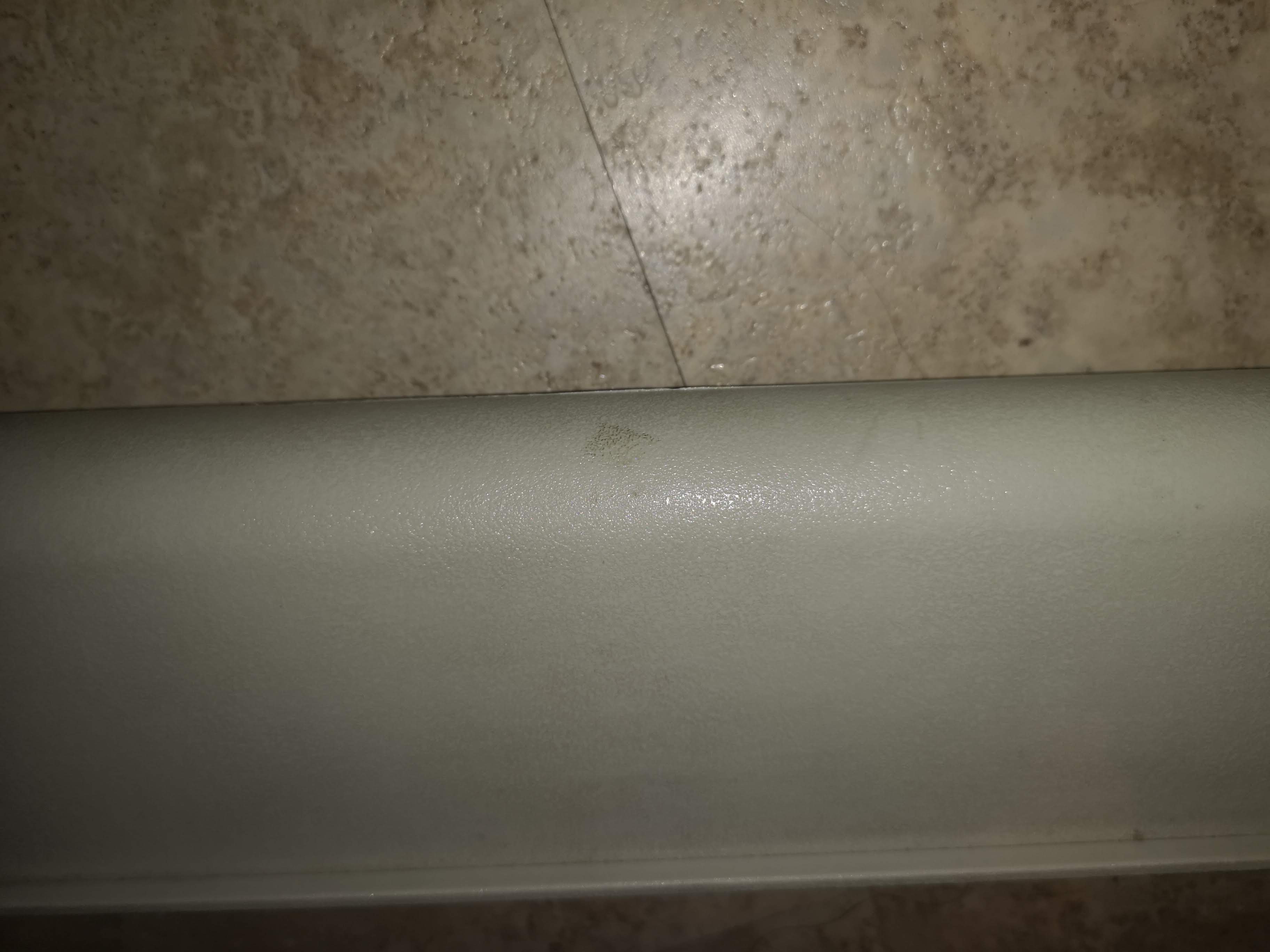

More dirt on the top case.
- IMG_20190220_173950.jpg (284.2 KiB) Viewed 9186 times

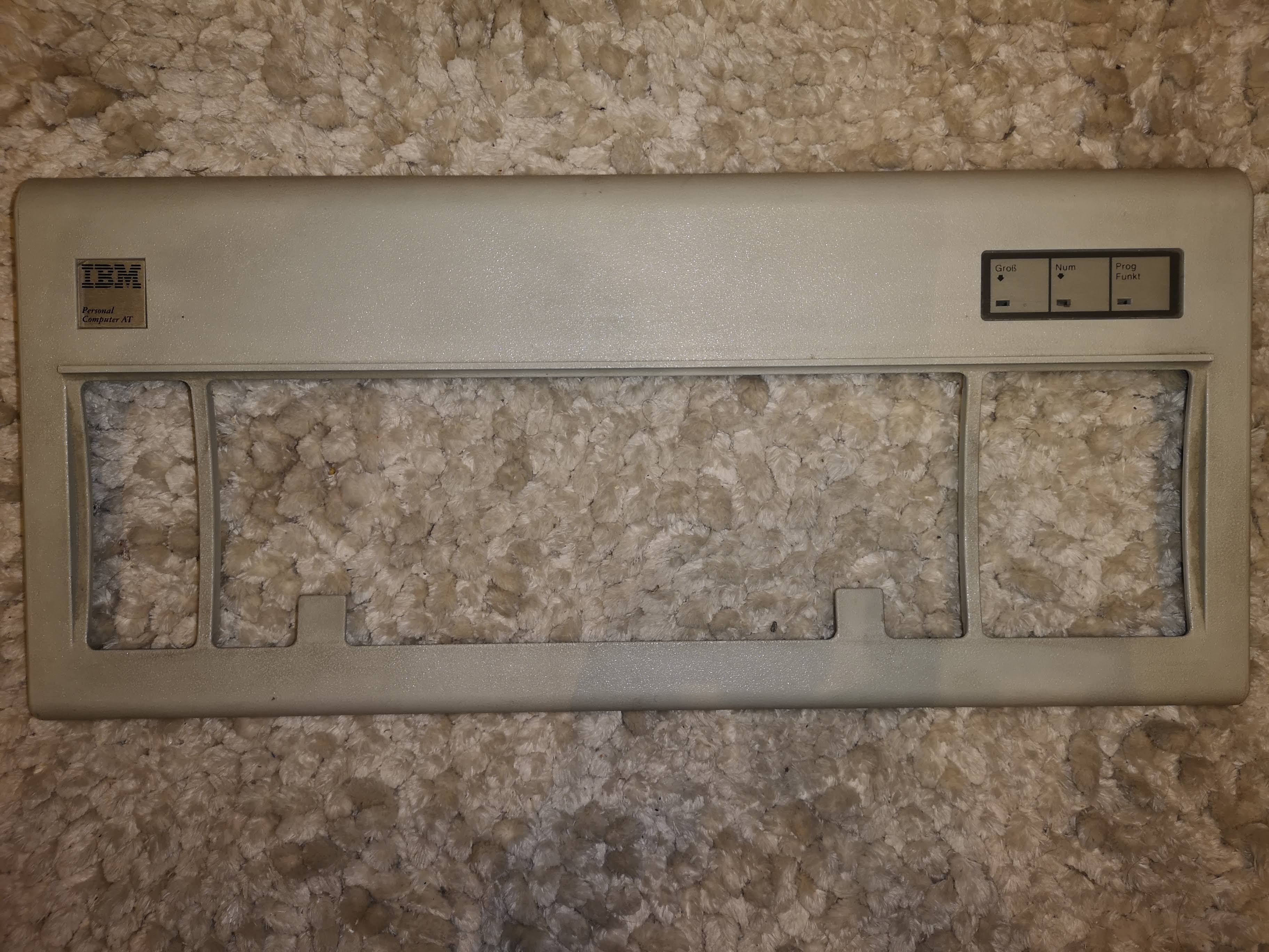

Getting ready to clean the top case.
- IMG_20190220_174024.jpg (968.99 KiB) Viewed 9181 times

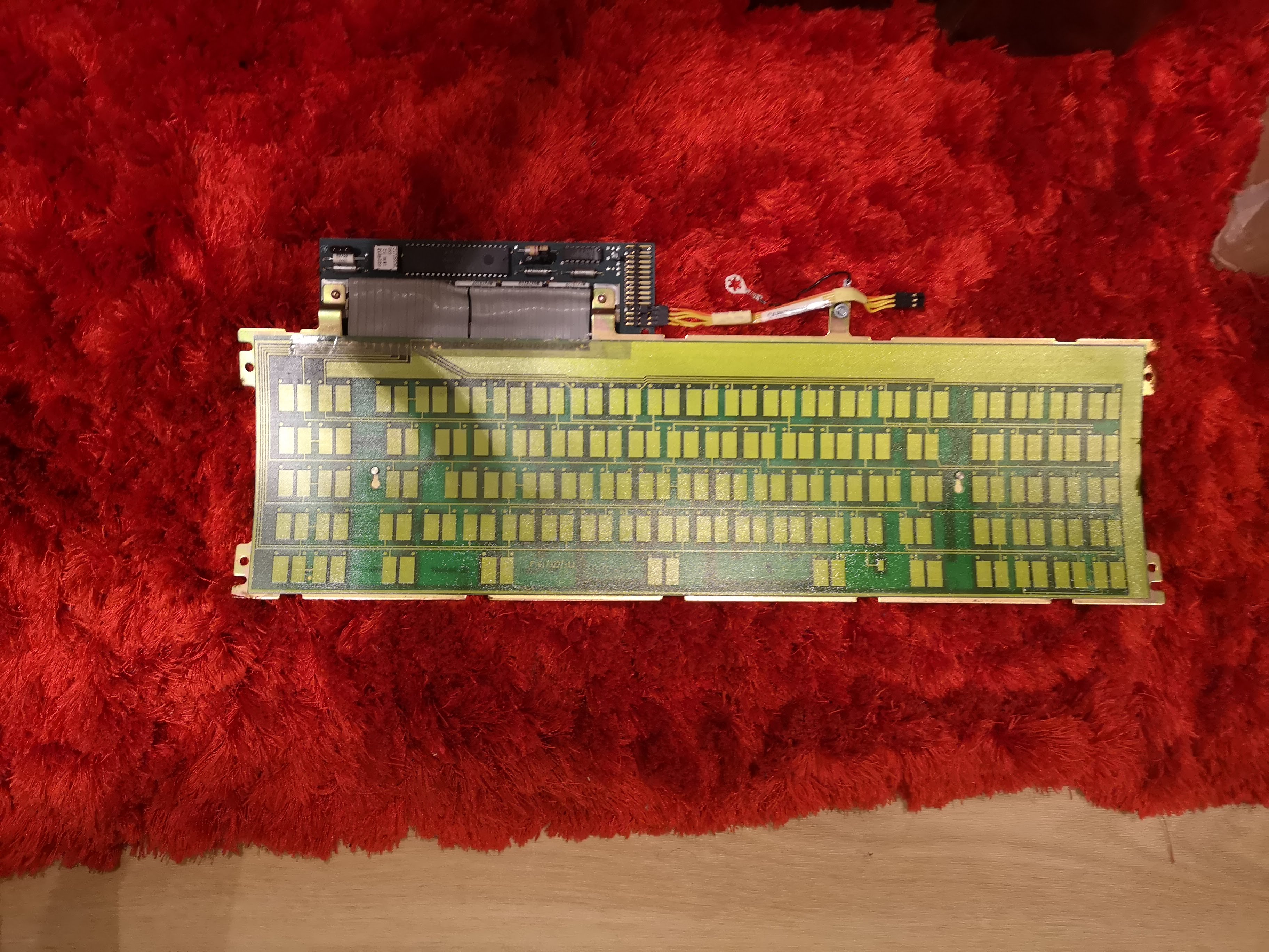

Image of the capacitive sensing board for the keys.
- IMG_20190220_190342.jpg (1.54 MiB) Viewed 9179 times

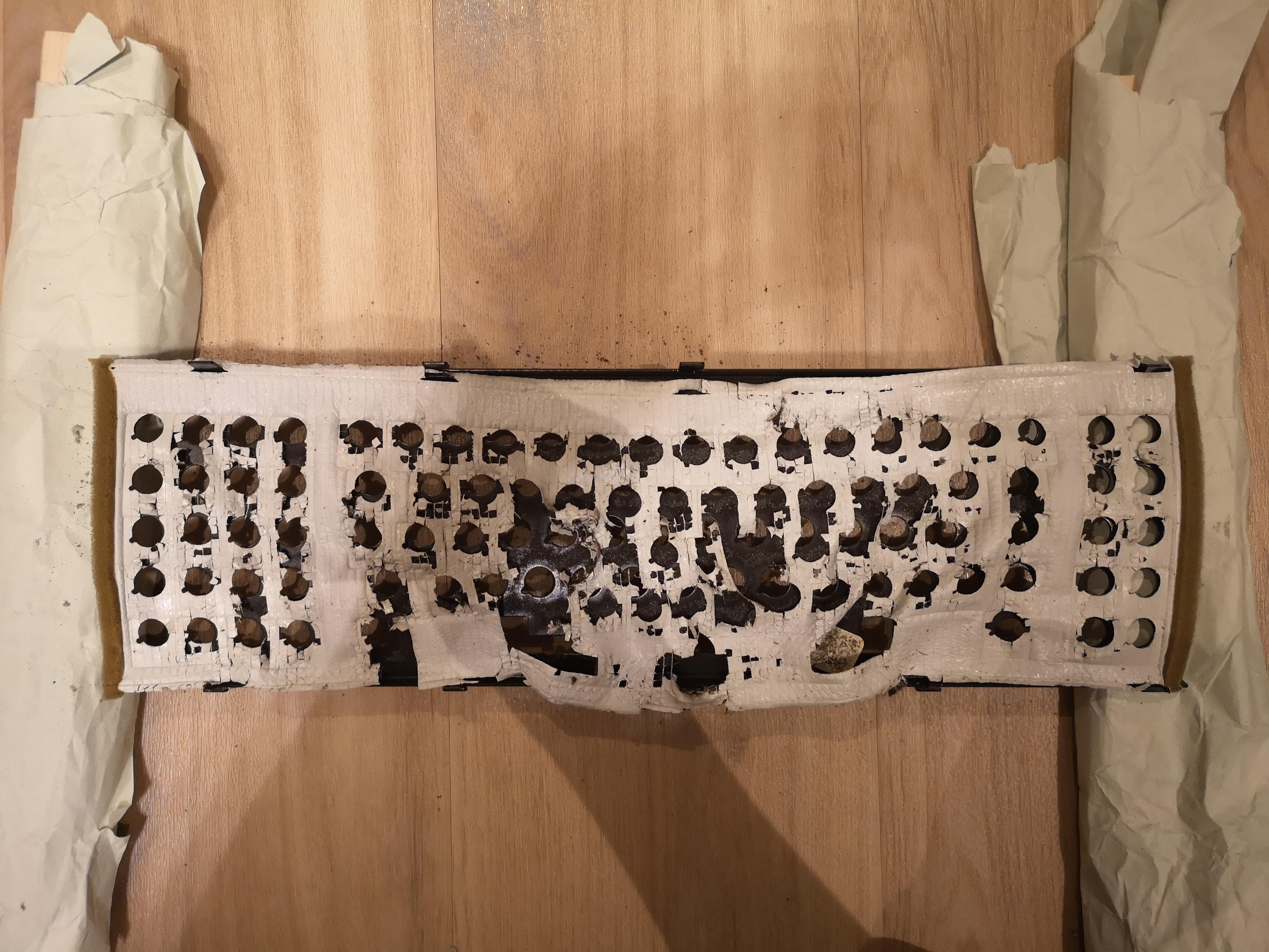

Image of the foam which appears in good condition but it is not as you will see in the next image.
- IMG_20190220_190602.jpg (1.04 MiB) Viewed 9176 times

All key barrels removed at this point I knew it needed new foam.
- IMG_20190221_224633.jpg (1 MiB) Viewed 9169 times

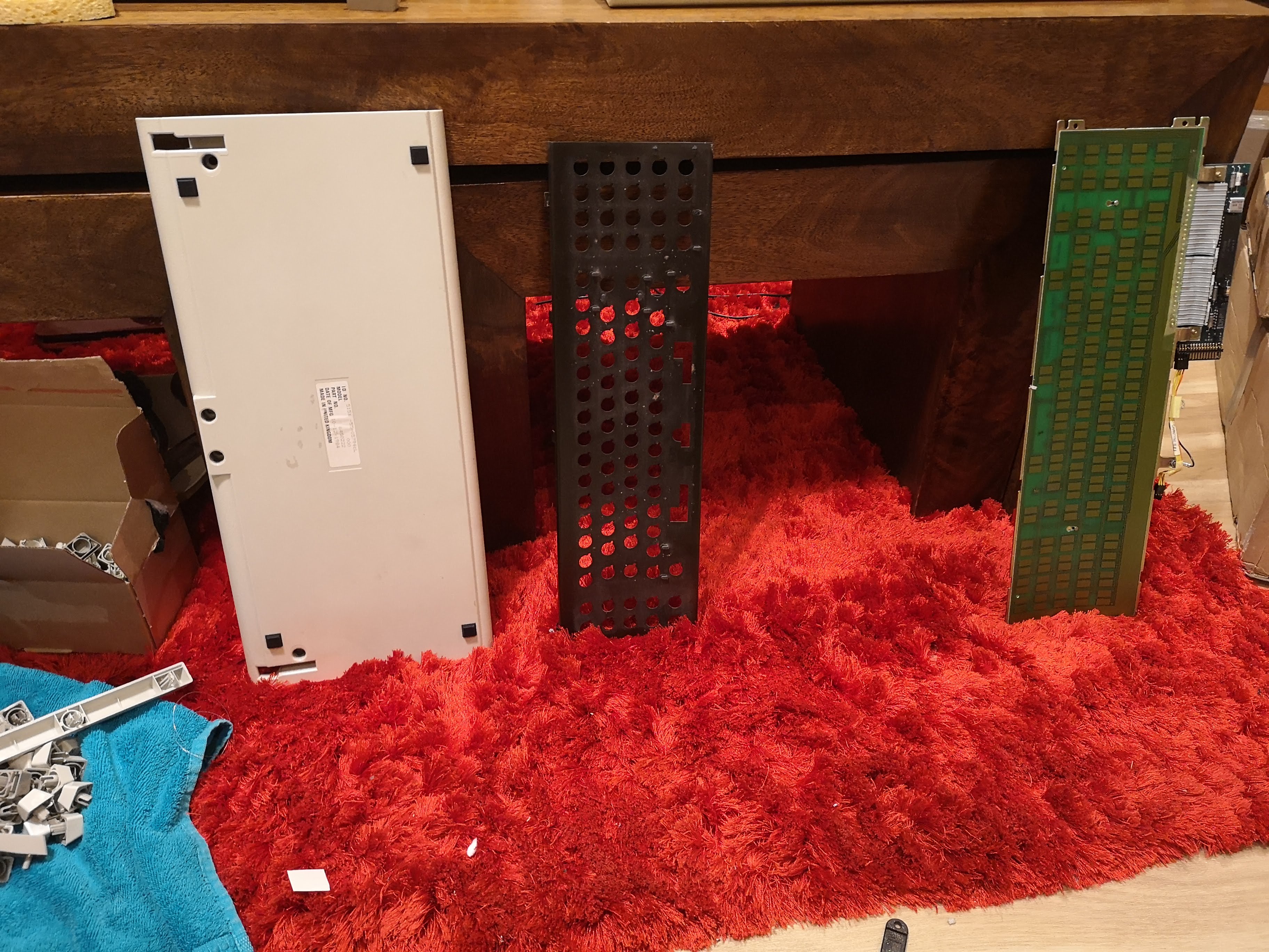

All keyboard parts disassembled.
- IMG_20190221_225851_1.jpg (1.79 MiB) Viewed 9168 times

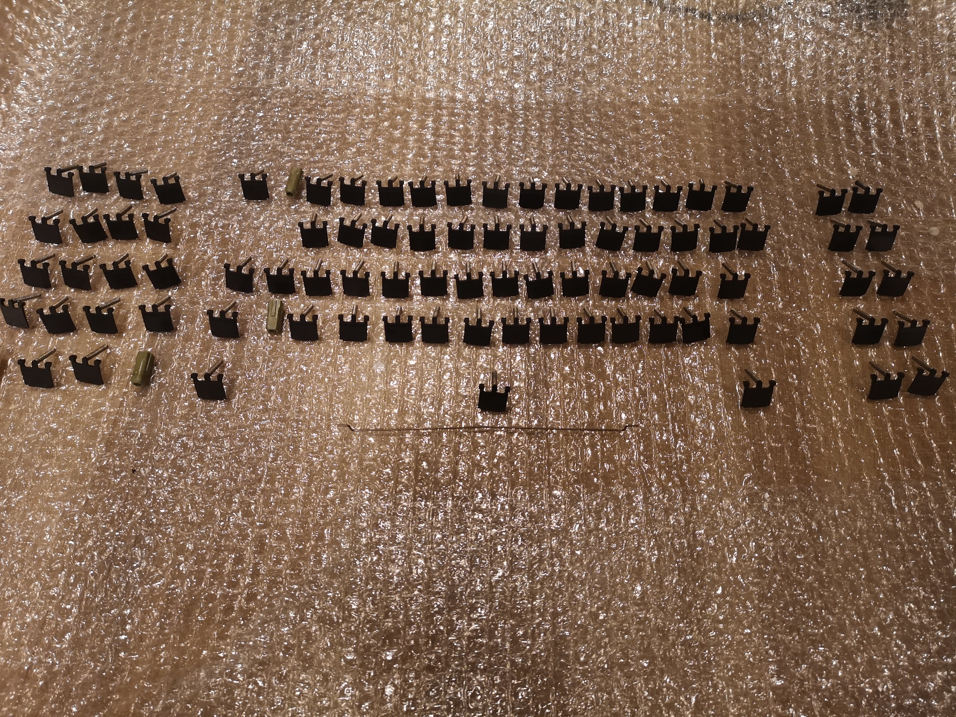

Image of all the buckling spring assemblies.
- IMG_20190221_225858.jpg (2.33 MiB) Viewed 9163 times

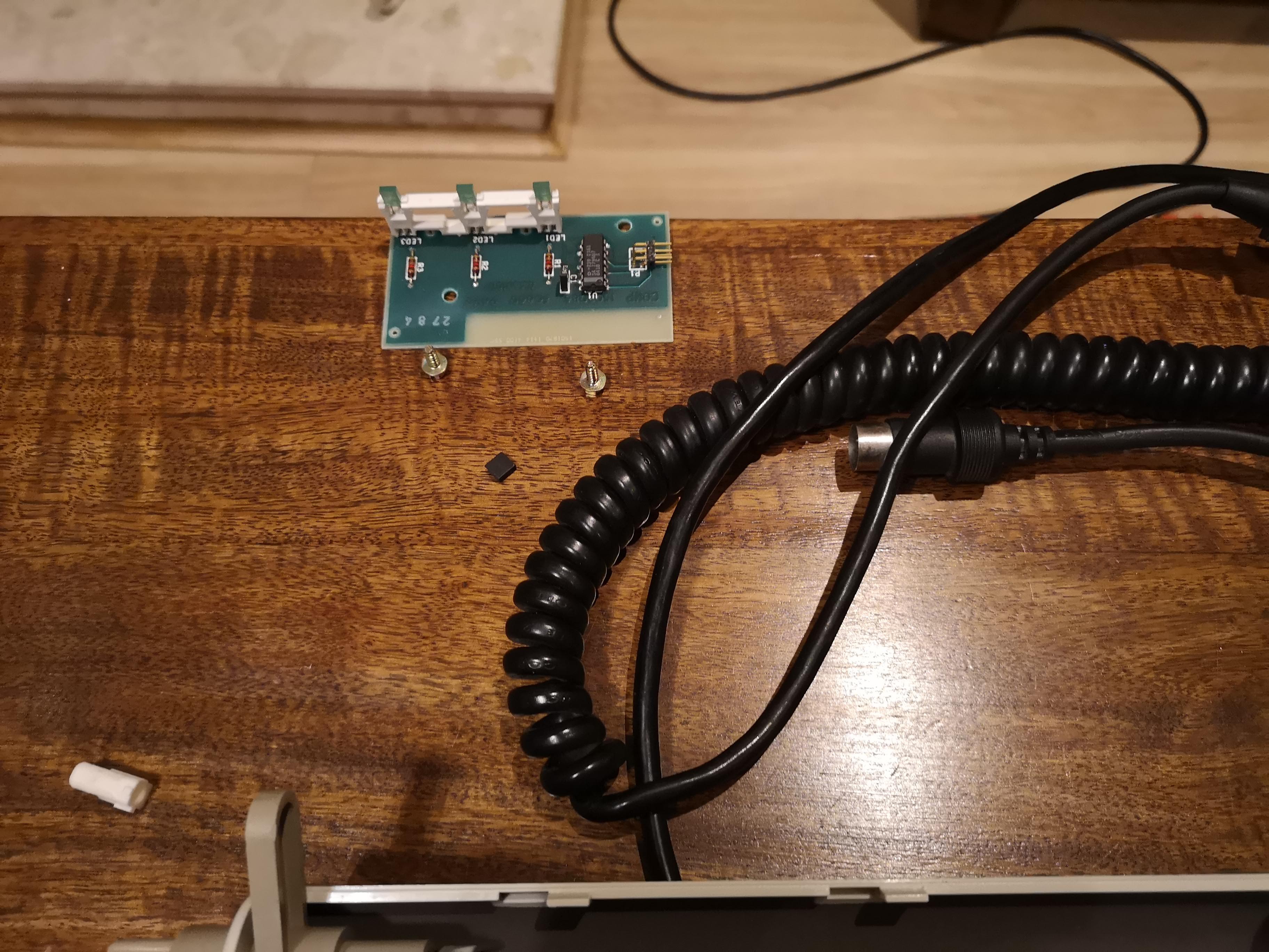

Image of the lock light circuit board.
- IMG_20190221_225920.jpg (1.07 MiB) Viewed 9161 times

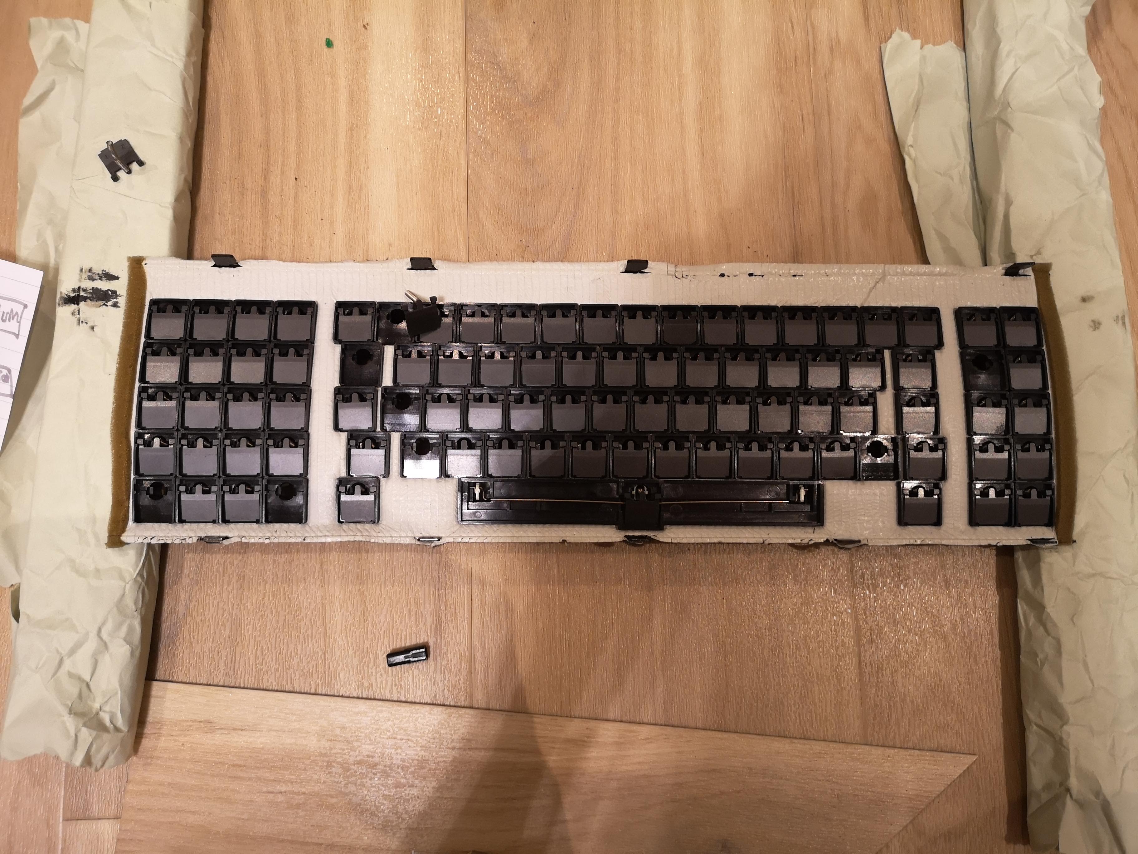

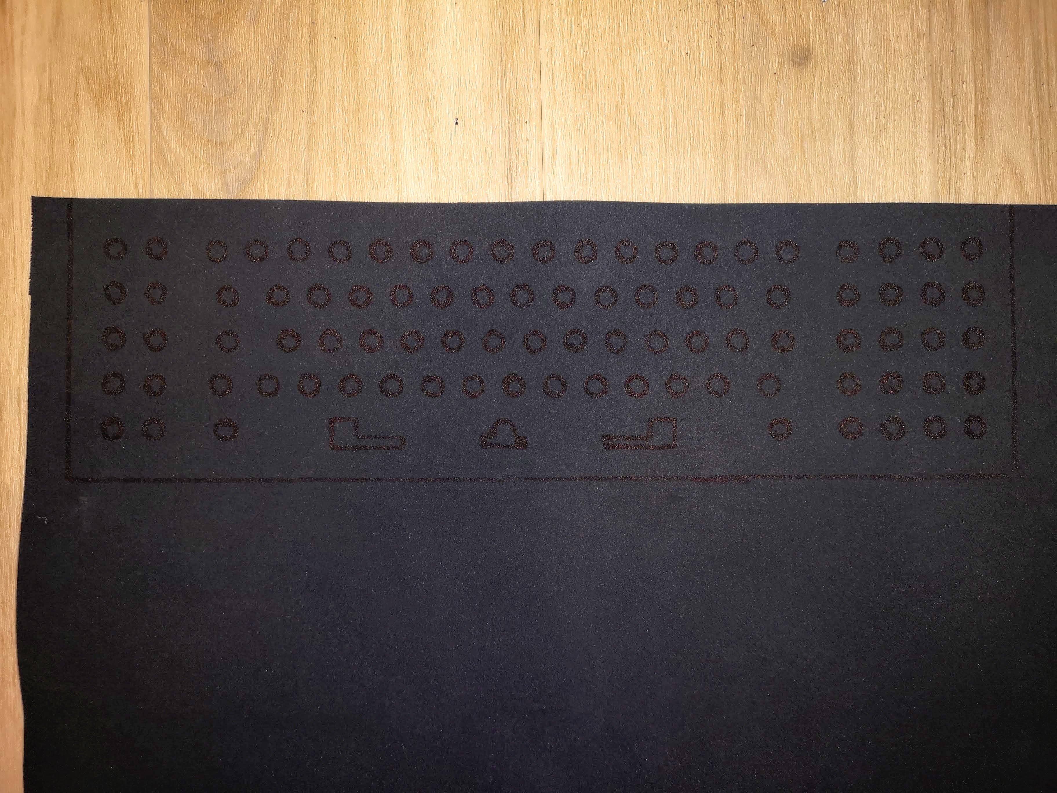

New 3mm foam traced ready to be cut to shape.
- IMG_20190222_010417.jpg (1.49 MiB) Viewed 9156 times

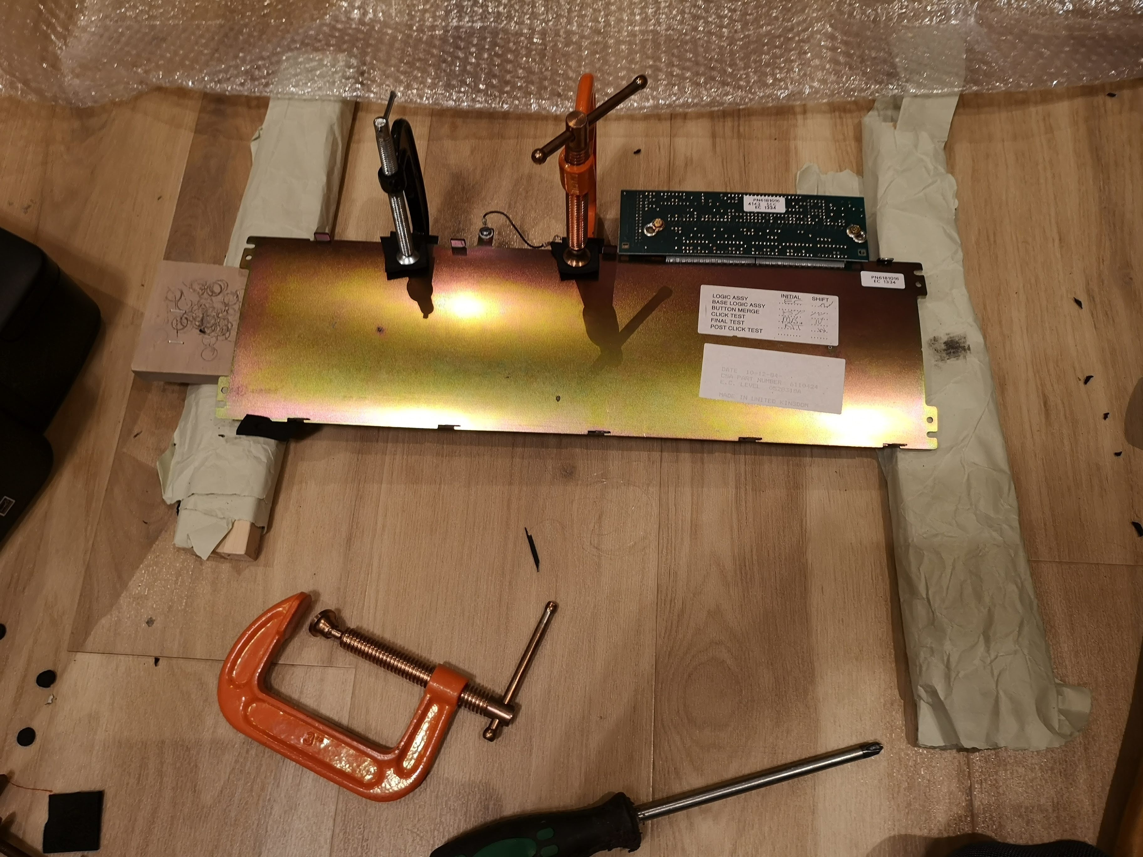

New foam in and a tip to anyone doing this use lots of clamps when reassembling.
- IMG_20190222_220602.jpg (1.71 MiB) Viewed 9155 times
Fkazim
New foam installed and also space bar lightened by bending the wire stabiliser outwards and then using fishing line to hold the buckling spring in place while reassembling the keyboard.

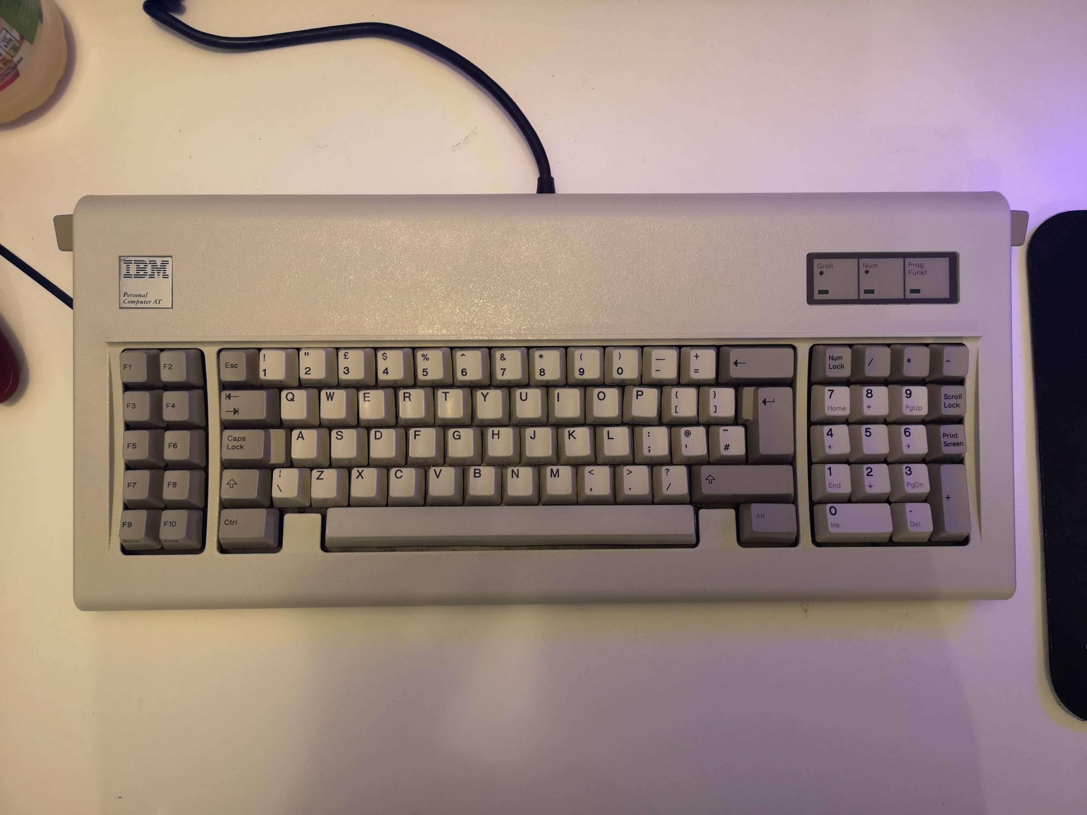

Image of the completed keyboard Let me know what you think.
- IMG_20190223_181603.jpg (353.42 KiB) Viewed 9148 times

The Manufacture label on the back of the keyboard.
- IMG_20190302_160908.jpg (155.18 KiB) Viewed 9128 times

I wouldn't be able to resist peeling that plastic off of the badge.
