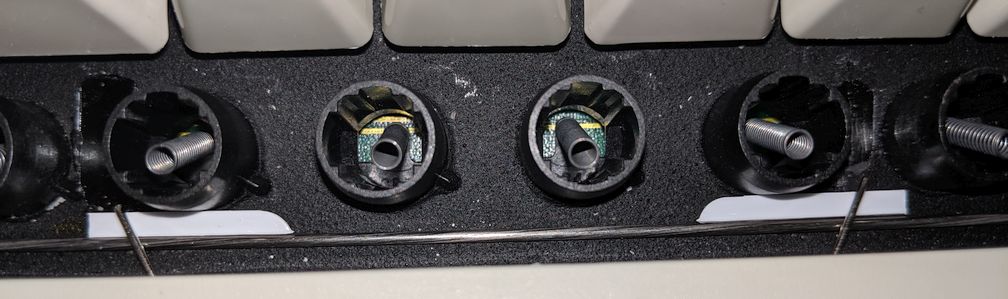

Hello everyone,
I tried a few different approaches to stabilize the Model M spacebar installed on my extra modifiers modded F AT but never got it quite right: thickness would interfere with key travel, washers wouldn't stay down, no yaw control, bad adhesion between epoxy and plastic, etc.

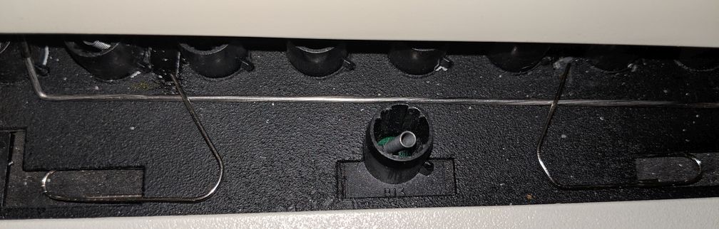

Recently, I had another idea: paperclips. Behold, the "clippy" mod:
I'm using a thinner stabilizer wire with "sleeves" made from stainless tubing on the corners clipping in.
There was still a problem with yaw control, which I solved with these shims simply jammed in place:
(I might try longer, ever so slightly narrower pieces but these work if placed properly.)
