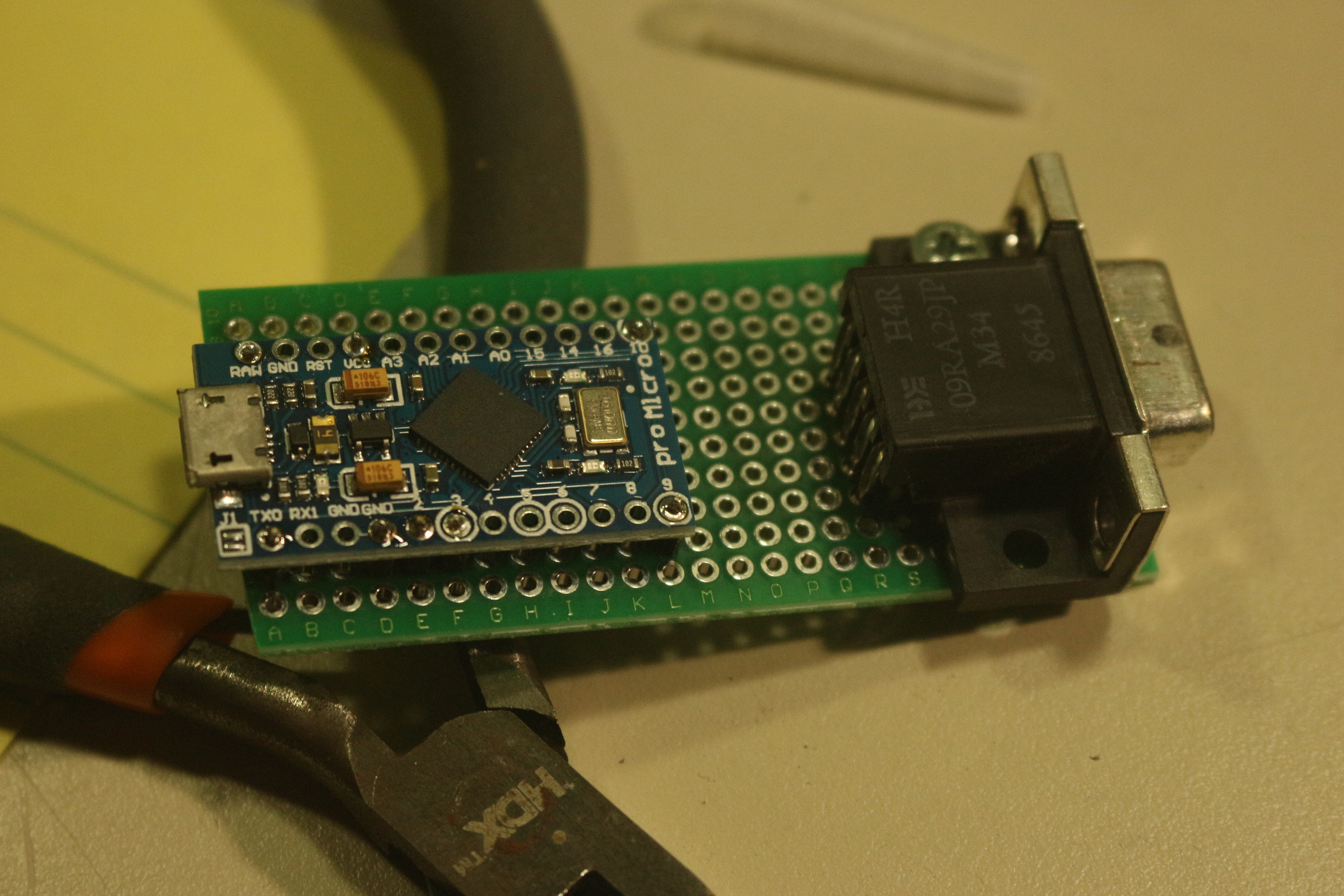

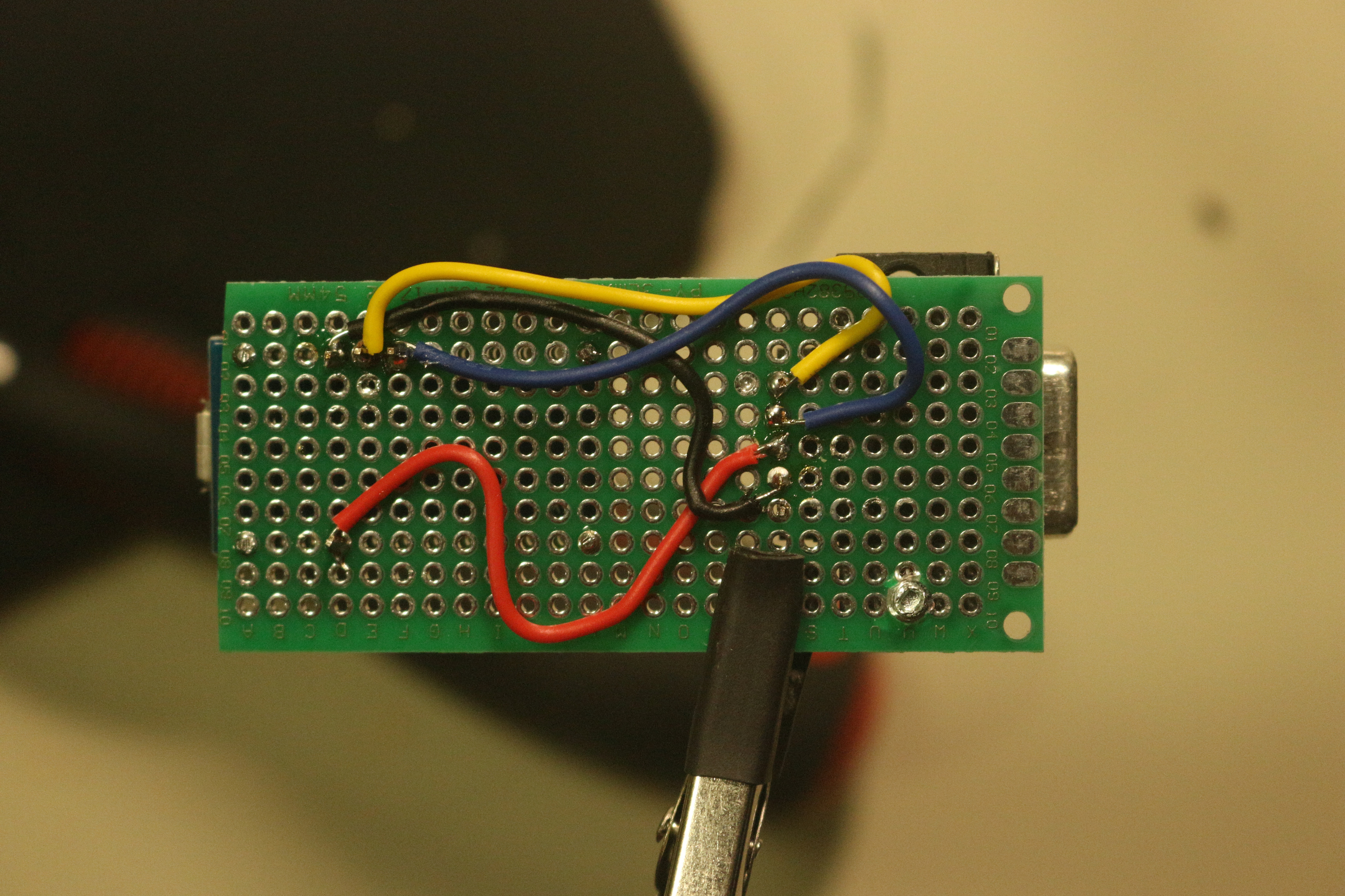

  9. Create the External Adapter:
    Ok, now you have to solder 4 cables to the Arduino Pro Micro and then to the DB9 female. Here's the Pinout:
  10. If you are a perfectionist like me, buy some heat-shrink tubes (tubos termocontraibles en Español) of diferent sizes. The smaller to the cables that go from the Arduino to the DB9 female and a bigger to cover all of the Arduino.
    And the final result:
