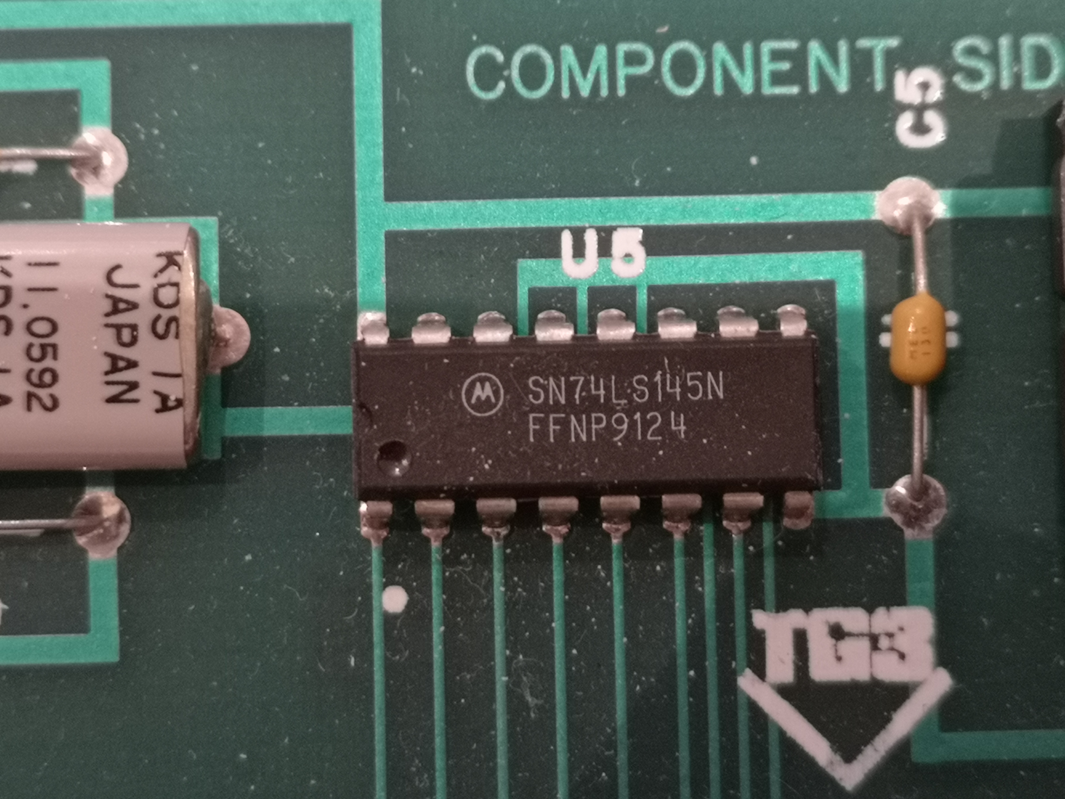

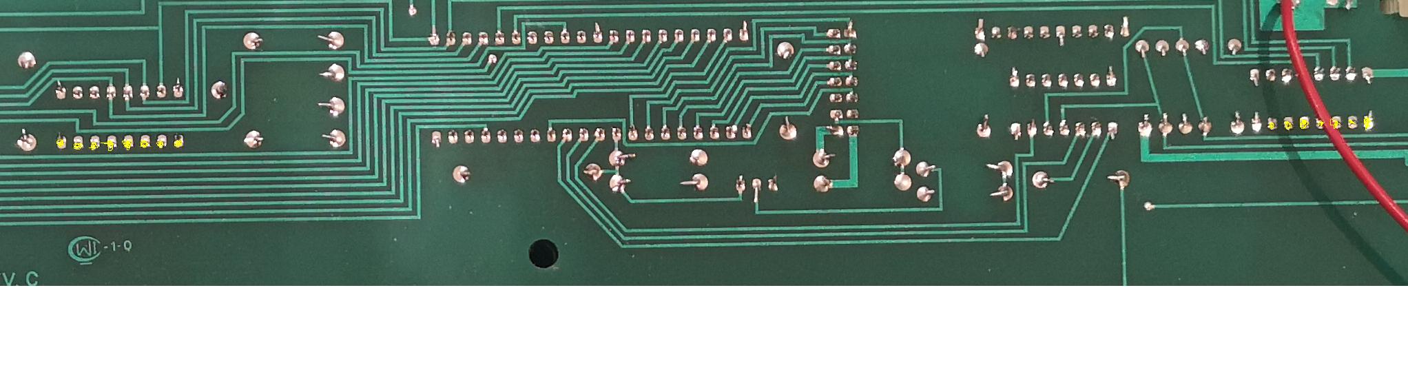

by Anakey
I would say that socketed chip would be the display program as you can see from the underside of the board and would make sense being removable and easily flashed when upgrading the software. T think before starting to remove chips etc it is best to first establish the pins that are for the matrix. Given that as shown in the underside there are no obvious traces connecting the rows/columns to the circuitry on top then these traces must be on the top of the pcb as i doubt this is a multi layer pcb.
download/file.php?id=56170
In this image, you can see traces going down disappearing below the plate, there is a similar chip on the other side of the controller. I believe these are shift registers which are designed to expand the IO of the controller and are probably where the matrix is.
Shift Register pins.JPG (136.88 KiB) Viewed 10972 times
The same pins on the underside of the pcb coloured yellow can then be used along with a multimeter on continuity to then work out the switch matrix. Number the shift register pins as you see fit (remembering that the order will be reversed on the top side of the pcb) then set the multimeter to continuity. Place one probe on the switch pin, then run the other probe along the shift register pins until you hear a beep then write down that pin 1 of that switch goes to pin x of the shift register. As the matrix has diodes you would want to measure from the diode to the shift register and that would be the other pin of the switch. What you should then get is the switch matrix which can then be used later to wire up the teensy, assuming that you do not find an easier non destructive way of converting it first. Though if you are needing to change the functionality of the keys then you would probably need the controller replacement anyway to enable programming.

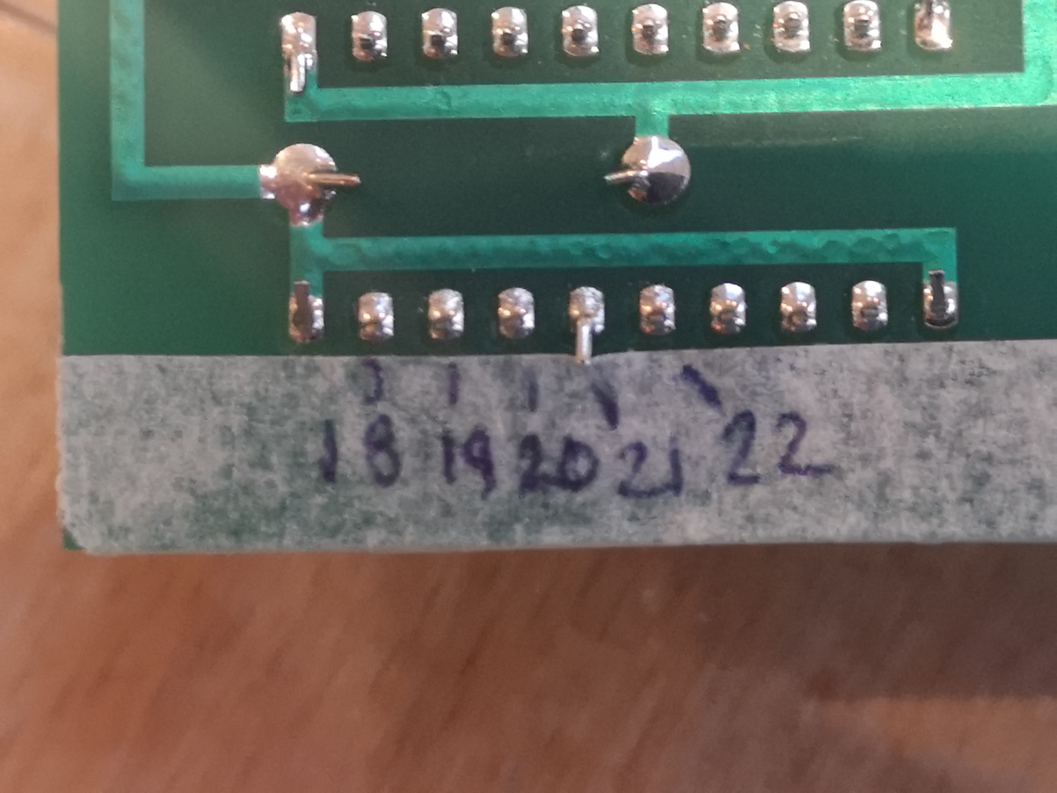

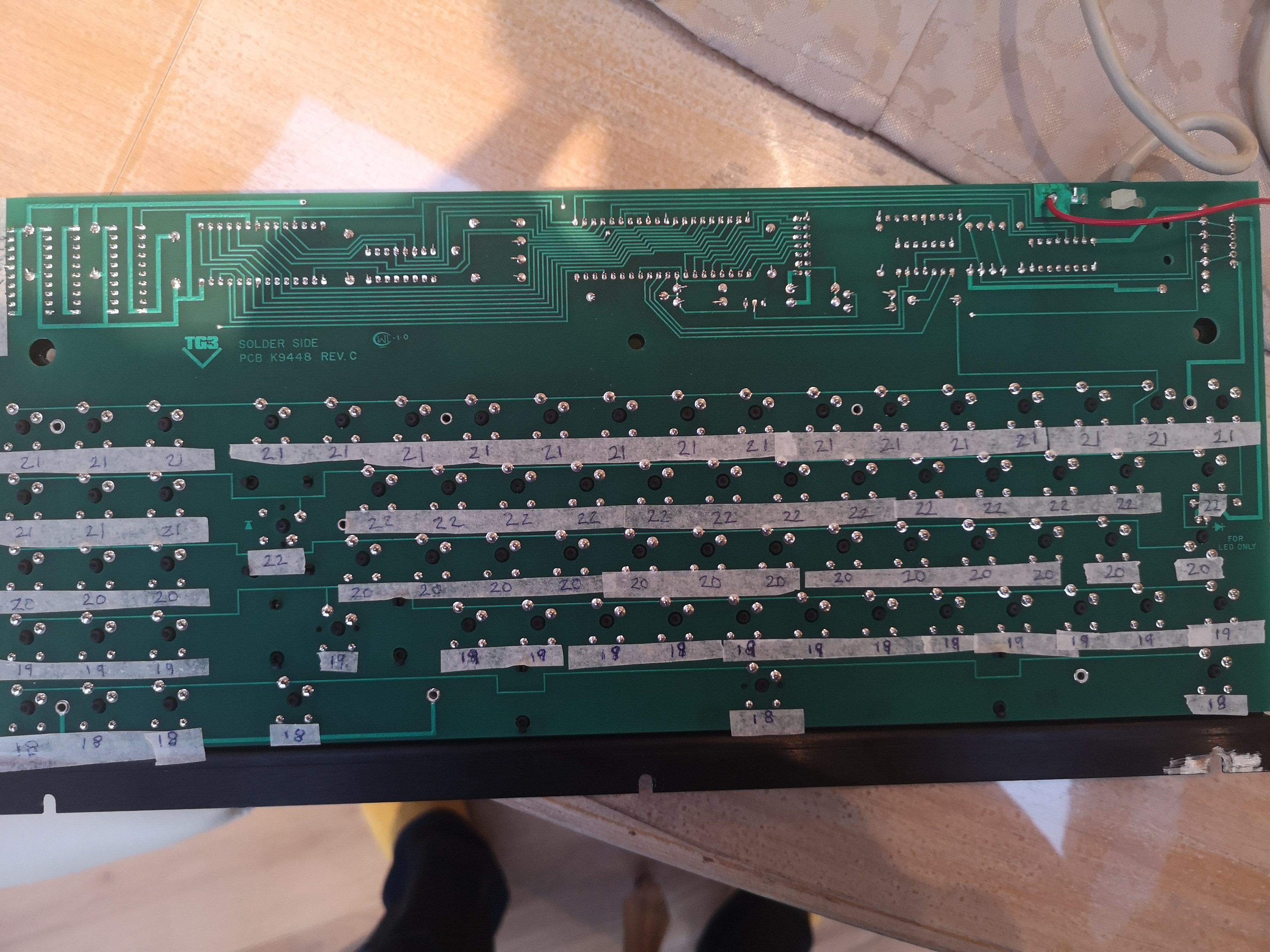

Posted: 23 Sep 2019, 19:16
by Fkazim
I have fully mapped the key matrix of the key communications keyboard sorry about going from 18 to 22 for the pins. It is because I thought there were other pins involved but either way we can still determine the key matrix. Please let me know if this helps in converterting the keyboard and what firmware I would use on the pro micro.
Thanks.
Re: Key Communications keyboard USB converting help.
Posted: 23 Sep 2019, 19:34
by swampangel
You've mapped the rows. There will be another set of (more) pins representing the columns.
You can look at the back and see traces going across that form the row. The adjacent pins will form the columns.
The yellow line is a row. The red circles are *examples* of the pins you will have to map to form the columns.
