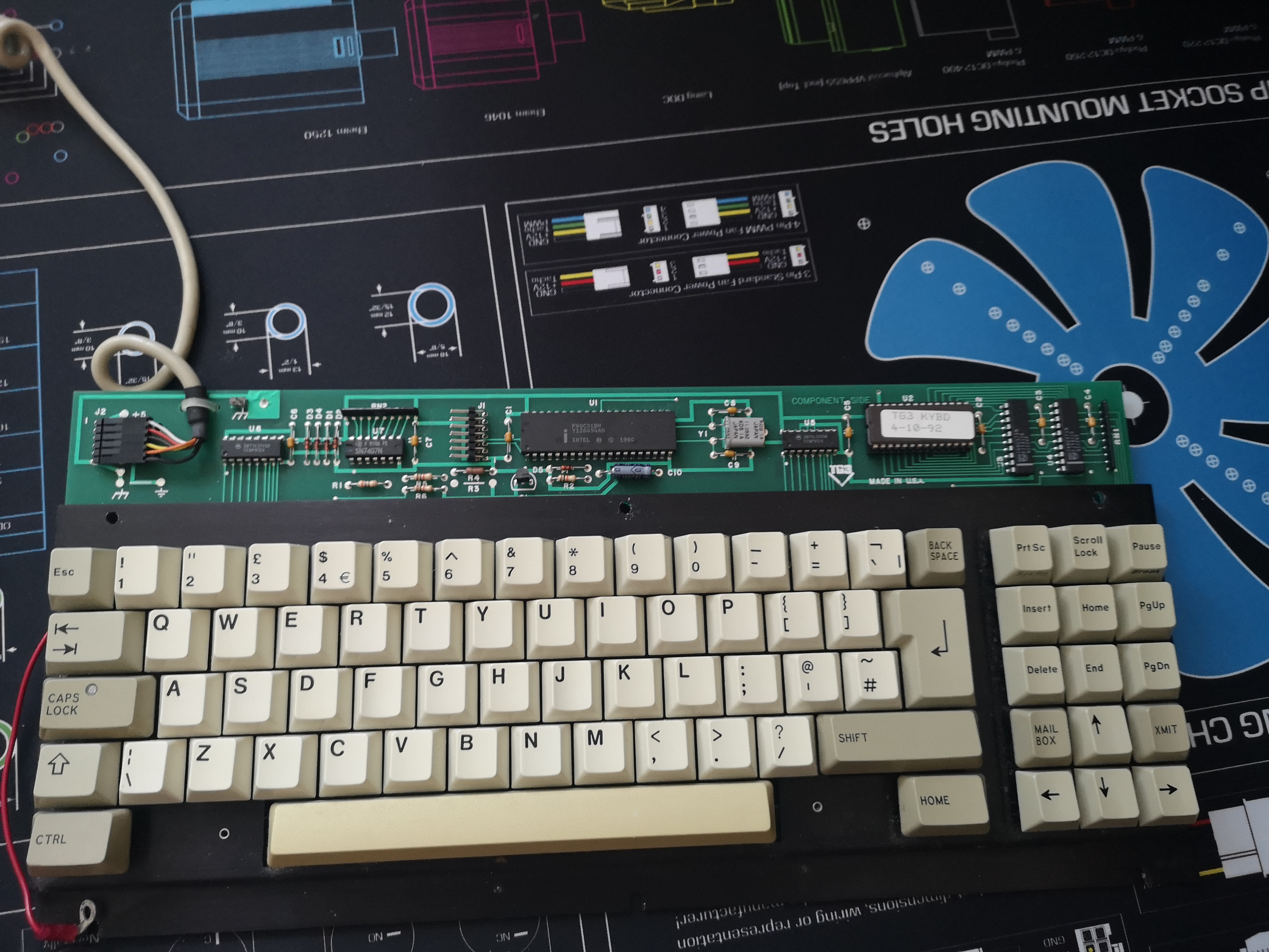

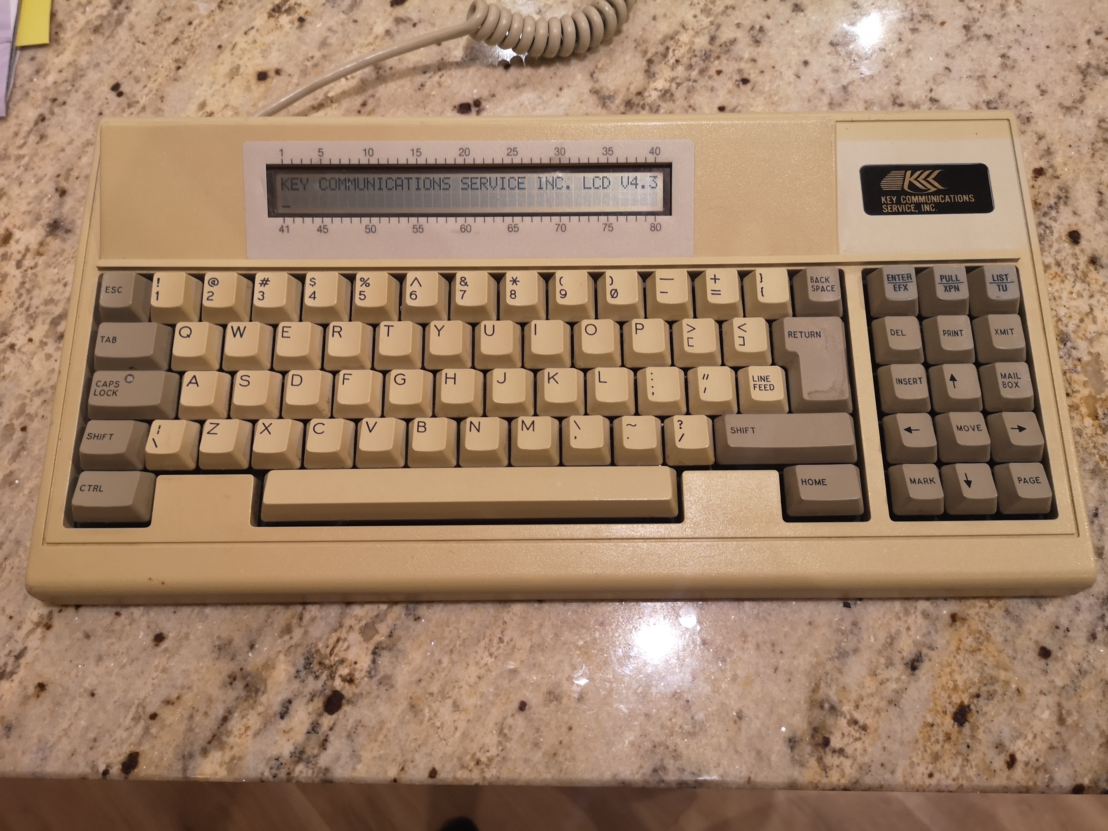

So I recently picked up this Vintage Cherry MX Black unsaver looking keyboard with an LCD screen. The keyboard is built really well with thick metal and thick plastic nice ABS doubleshot keycaps. Anyway the keyboard has an standard 5 pin DIN connector tried to plug it into a active converter all I got was the LCD screen came on and displayed KEY COMMUNICATIONS INC. LCD V4.3 and the caps lock key lights up when pressed but does not actually toggle the caps lock on the computer.
I would really like to get this keyboard working and also get the LCD functioning. If anyone has any ideas how I might go about this it would be much appreciated.
Thanks.
Below is some images of the keyboard.
Thanks.
- 15682466707077284015484646036609.jpg (2.42 MiB) Viewed 11523 times
- 15682465744387673372329831673366.jpg (2.64 MiB) Viewed 11523 times

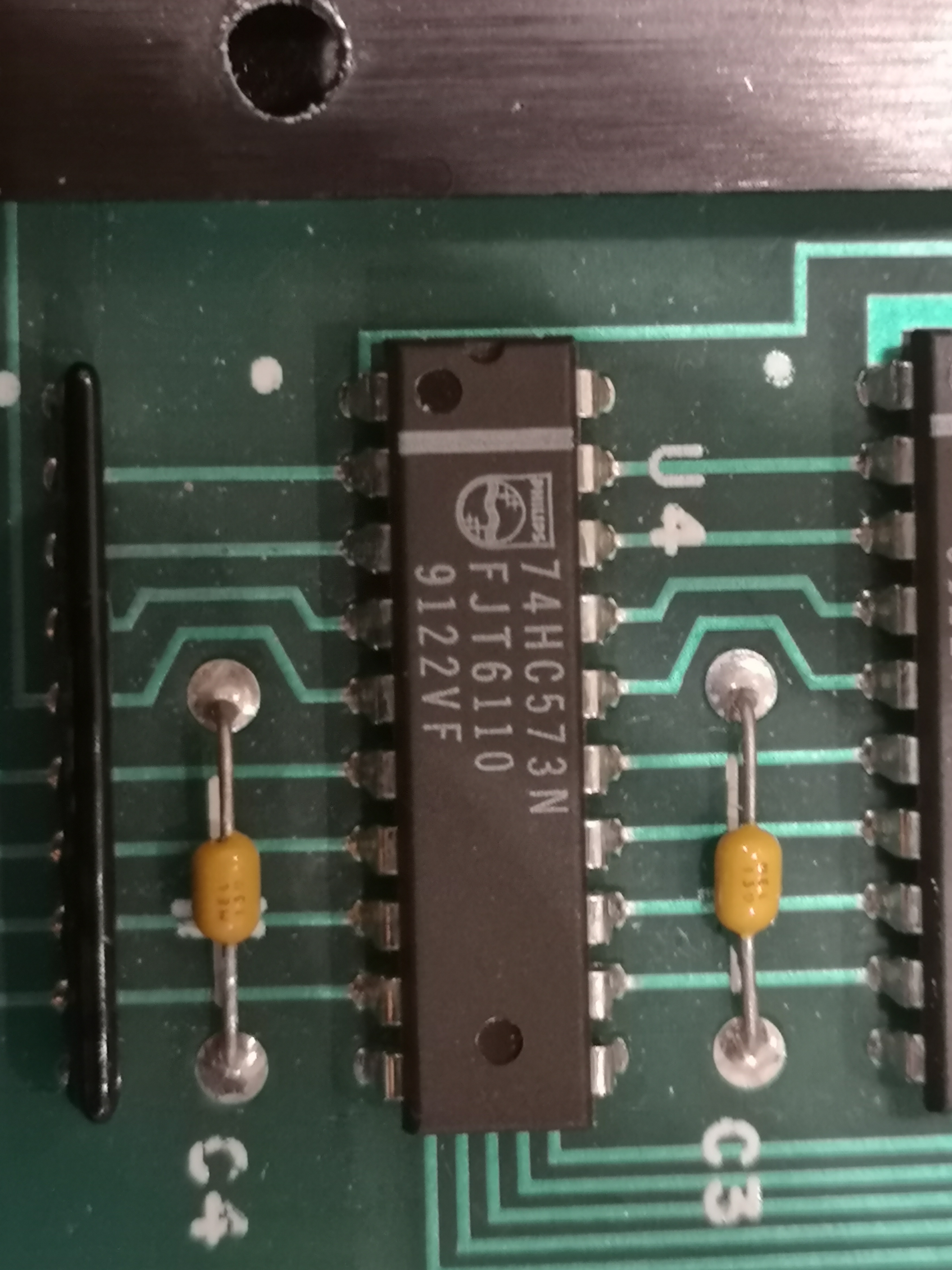

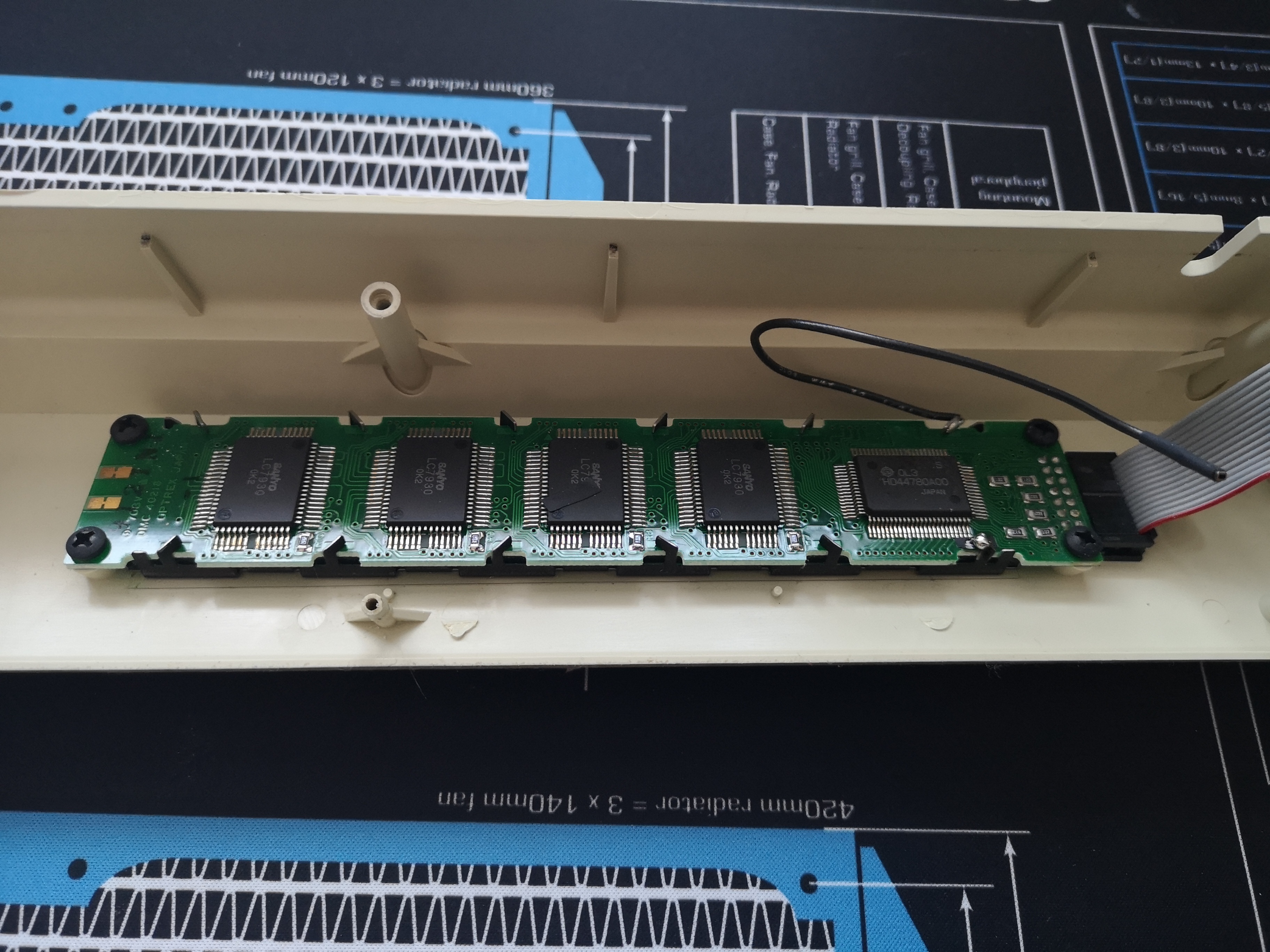

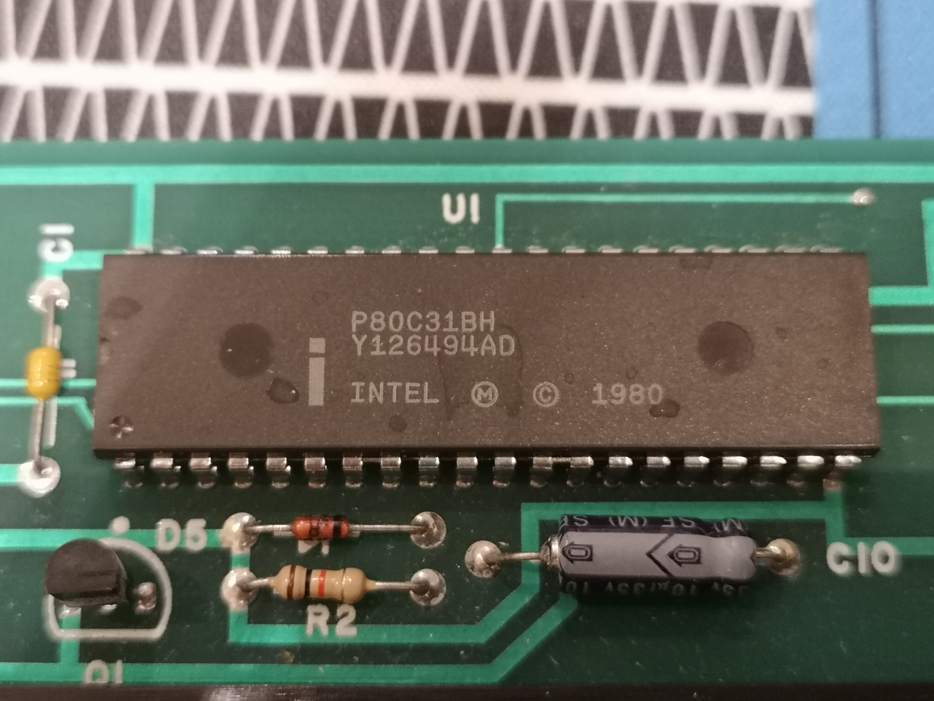

Here are the pictures of the main controller and the LCD display any ideas about what any of it is because I am lost.
Any help as always is much appreciated.
- 15683940384206228501388491435731.jpg (2.56 MiB) Viewed 11335 times
- 15683940078894883284355142932006.jpg (2.67 MiB) Viewed 11335 times

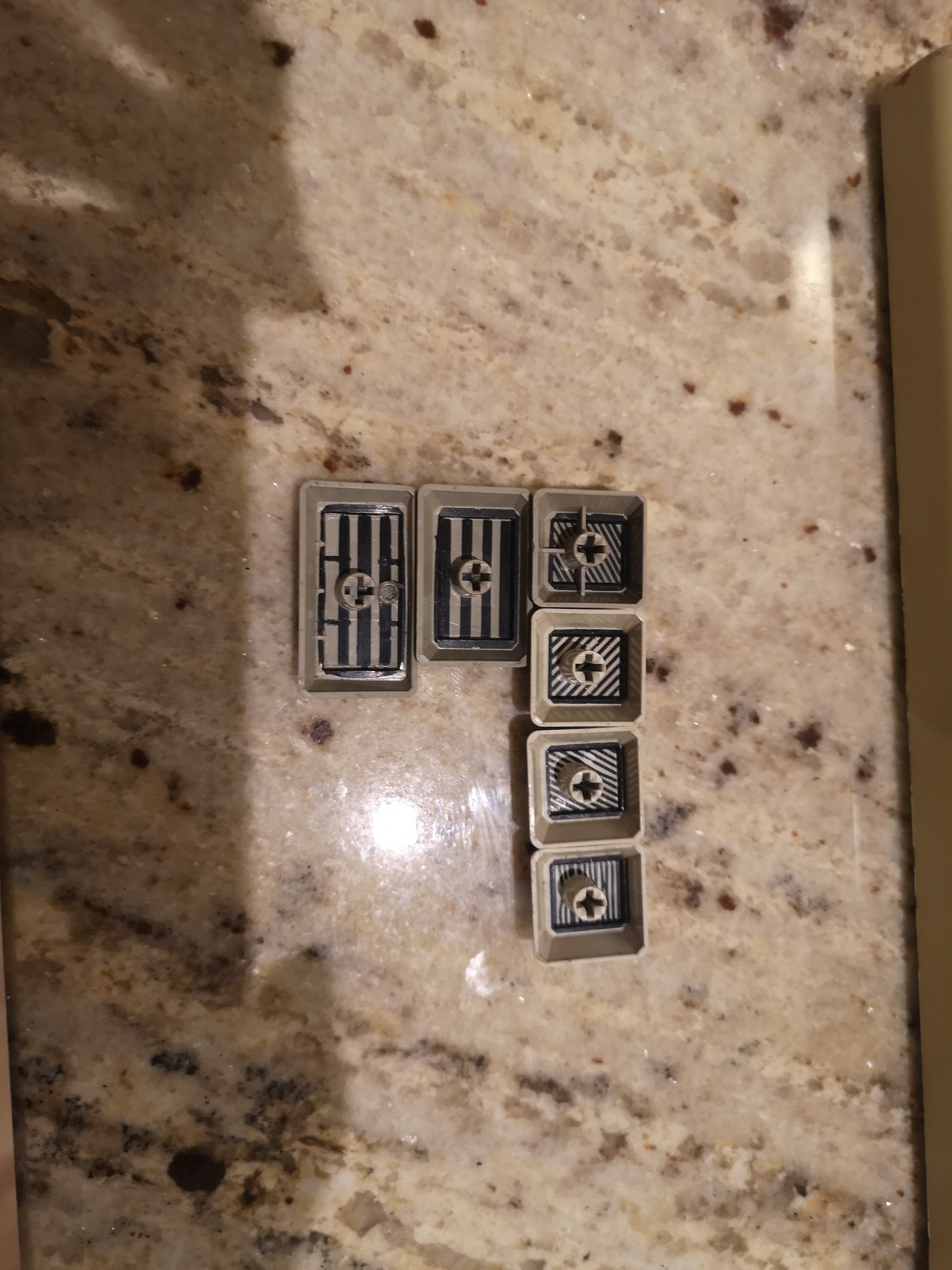

Key Tronic and DCS legends do have a very similar style, but there's an easy way to tell them apart. Look at the 3. Key Tronic's font gives it a flat top, whereas on DCS it has a round top.Chyros wrote: 12 Sep 2019, 09:52 That's bizarre. If I'd had to guess, I would've reckoned that was a Key Tronic for sure Oo . Cool keyboard though!![]()

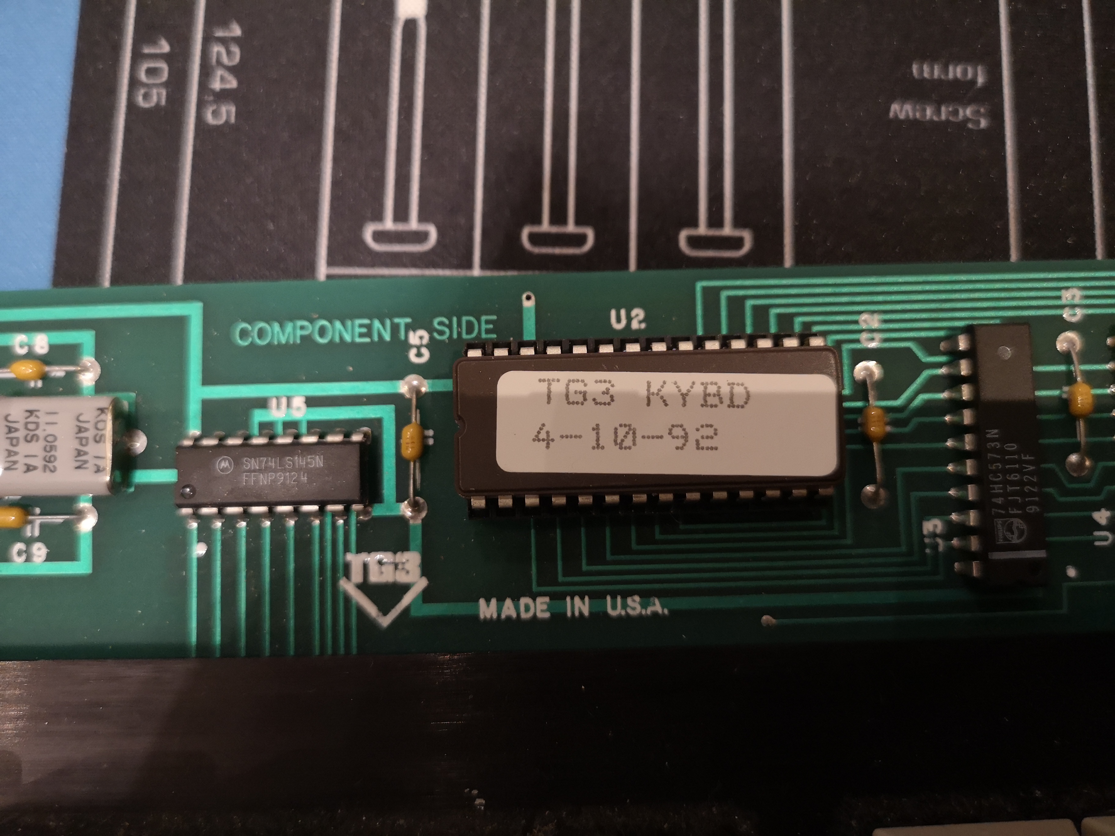

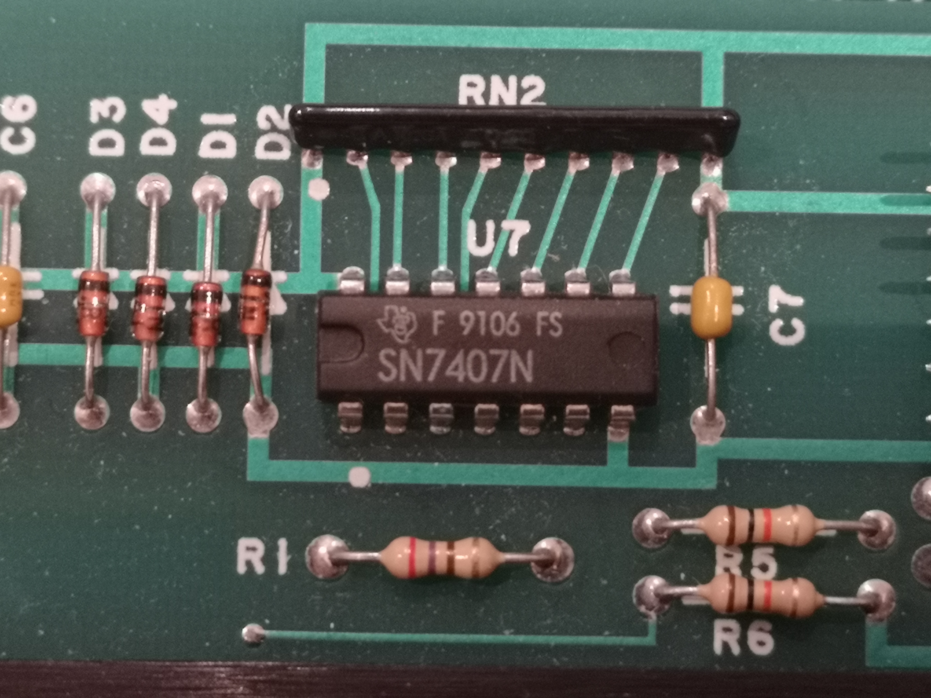

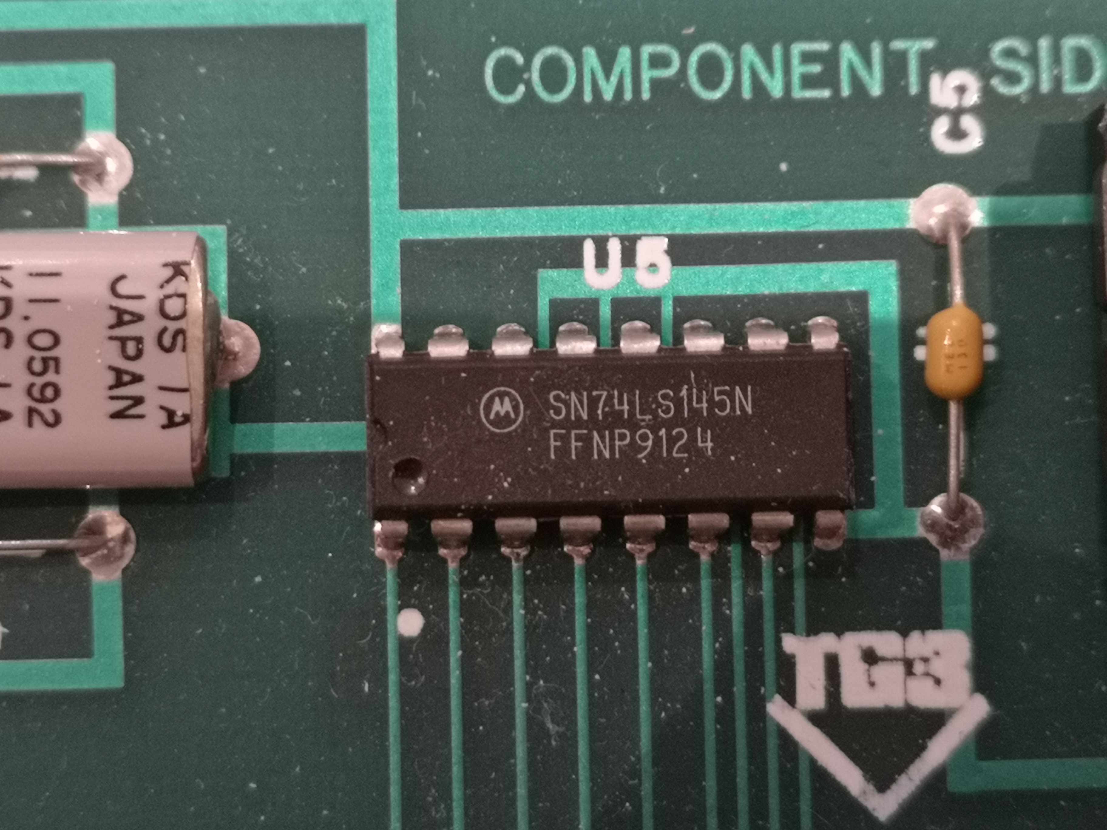

Below are the pictures of the chips on the controller let me know if it helps.
- IMG_20190916_164126.jpg (2.35 MiB) Viewed 11036 times
- IMG_20190916_164720.jpg (2.31 MiB) Viewed 11036 times
- IMG_20190916_164038.jpg (1.57 MiB) Viewed 11036 times
- IMG_20190916_164000.jpg (1.95 MiB) Viewed 11036 times
- IMG_20190916_163950.jpg (2.11 MiB) Viewed 11036 times

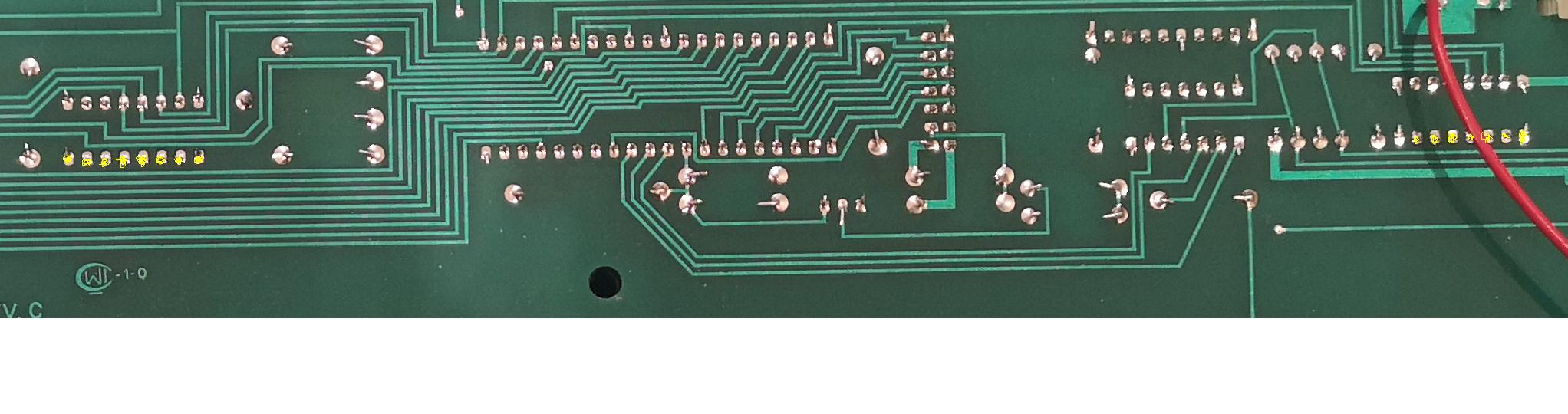

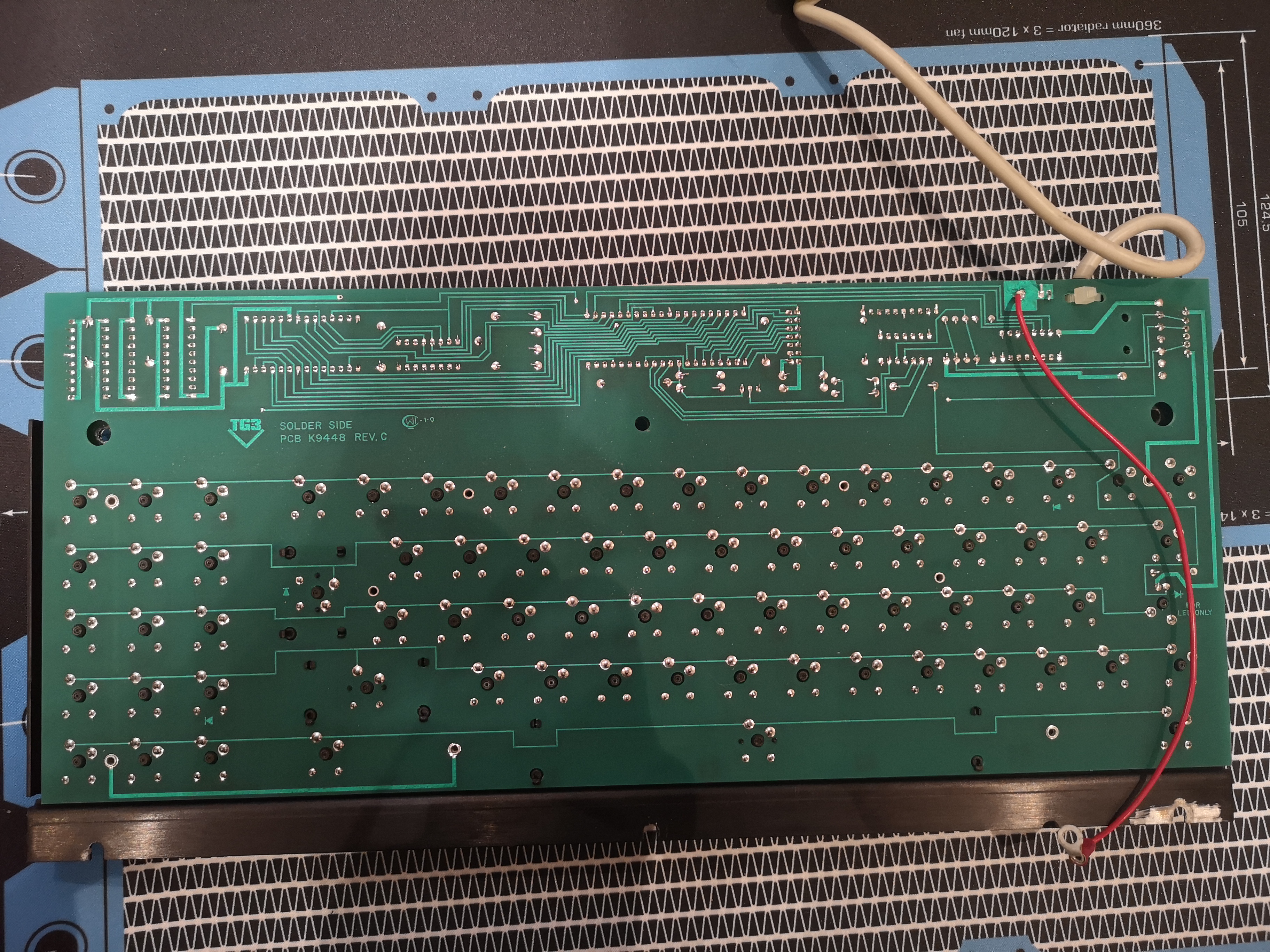

Here is a picture of the back of the PCB and traces problem I see is the original controller is not detachable as it is on the same PCB as the switches please help.
- 15689093068332321768394326105921.jpg (3.86 MiB) Viewed 10916 times
- Muirium
- µ
- DT Pro Member: µ
It's not an easy conversion. I bet that Intel chip, up top, is the controller and needs pulled out. The idea is to replace it with a Teensy++ or the like, and program that with TMK or whatever, with the matrix all worked out. As for the display? Beyond me.
I'd suggest handing this one off to someone with experience at this sort of thing. Or earn your chops by controller swapping some other, simpler boards, first.

I would say that socketed chip would be the display program as you can see from the underside of the board and would make sense being removable and easily flashed when upgrading the software. T think before starting to remove chips etc it is best to first establish the pins that are for the matrix. Given that as shown in the underside there are no obvious traces connecting the rows/columns to the circuitry on top then these traces must be on the top of the pcb as i doubt this is a multi layer pcb.
download/file.php?id=56170
In this image, you can see traces going down disappearing below the plate, there is a similar chip on the other side of the controller. I believe these are shift registers which are designed to expand the IO of the controller and are probably where the matrix is. The same pins on the underside of the pcb coloured yellow can then be used along with a multimeter on continuity to then work out the switch matrix. Number the shift register pins as you see fit (remembering that the order will be reversed on the top side of the pcb) then set the multimeter to continuity. Place one probe on the switch pin, then run the other probe along the shift register pins until you hear a beep then write down that pin 1 of that switch goes to pin x of the shift register. As the matrix has diodes you would want to measure from the diode to the shift register and that would be the other pin of the switch. What you should then get is the switch matrix which can then be used later to wire up the teensy, assuming that you do not find an easier non destructive way of converting it first. Though if you are needing to change the functionality of the keys then you would probably need the controller replacement anyway to enable programming.

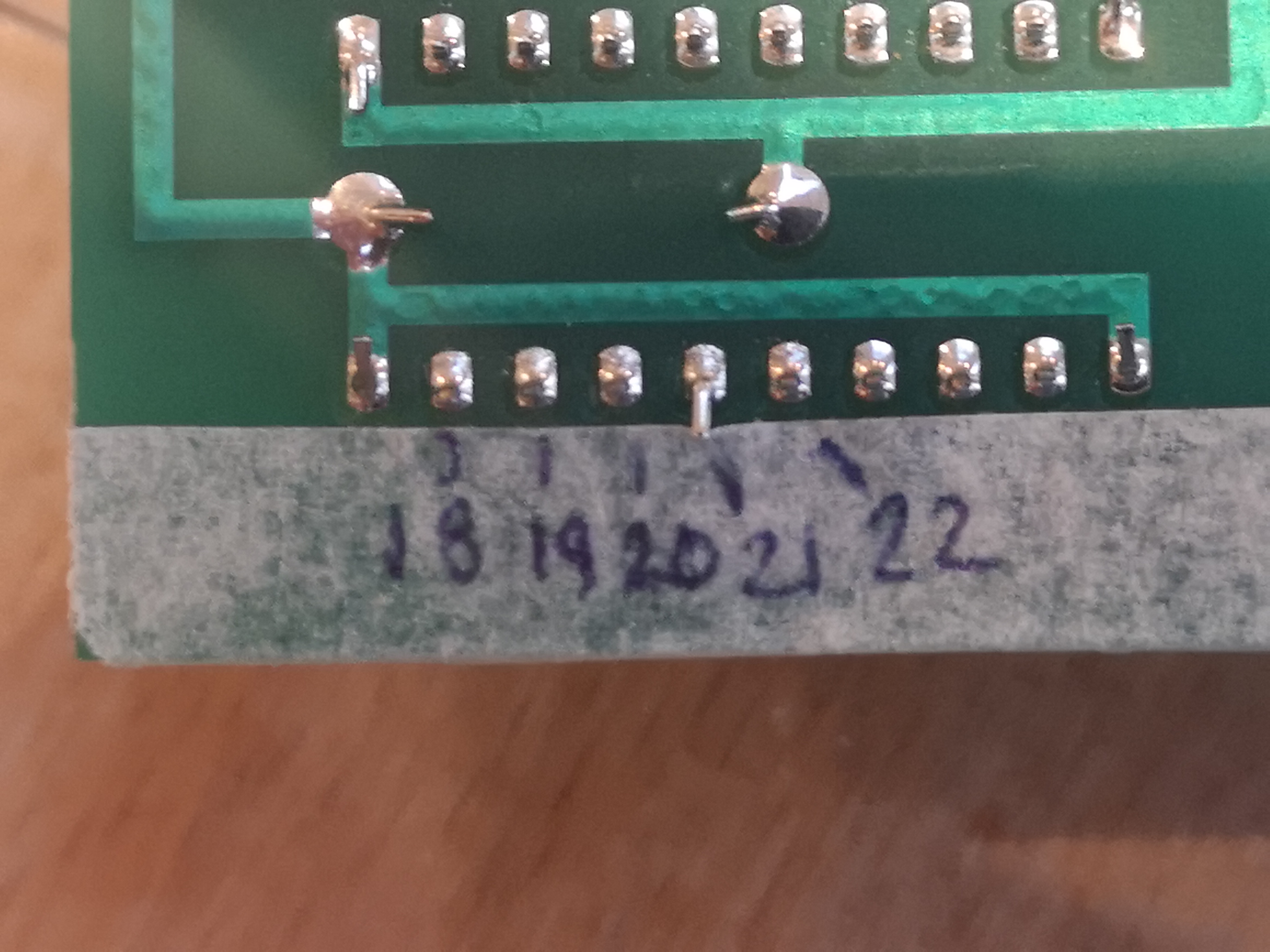

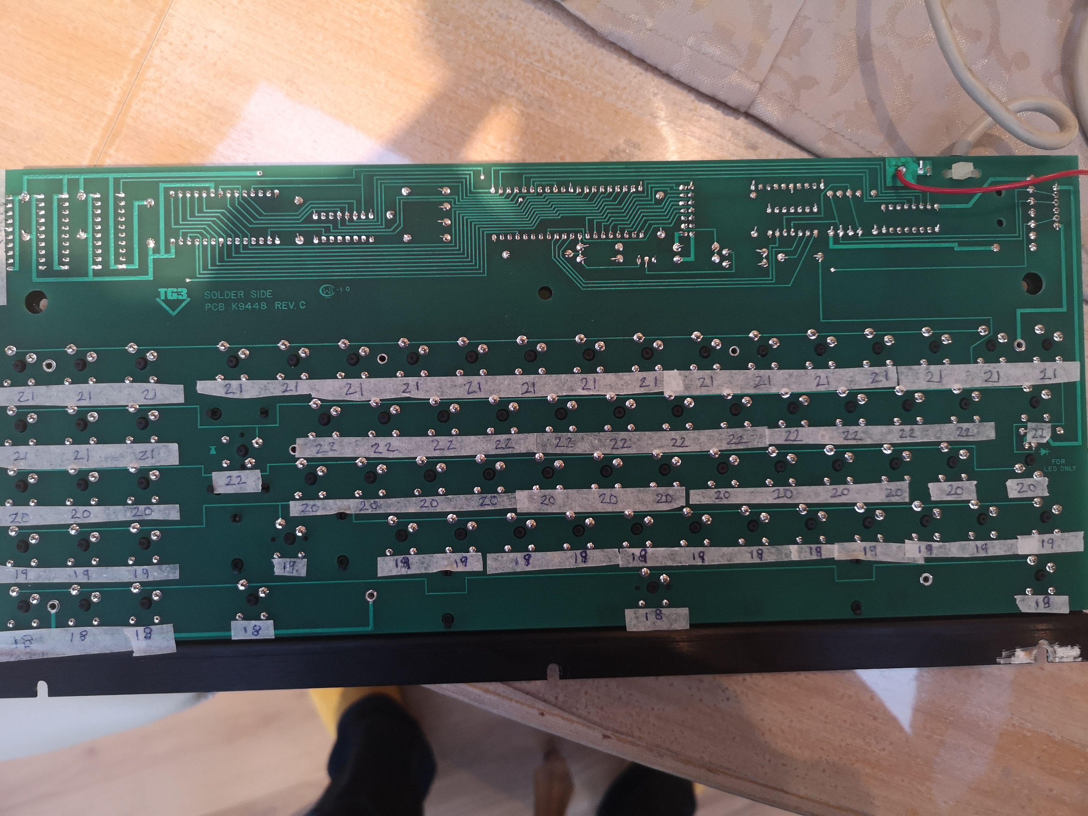

I have fully mapped the key matrix of the key communications keyboard sorry about going from 18 to 22 for the pins. It is because I thought there were other pins involved but either way we can still determine the key matrix. Please let me know if this helps in converterting the keyboard and what firmware I would use on the pro micro.
Thanks.
Thanks.
- swampangel
- Location: Canada
- Main keyboard: Northgate Omnikey 101
You've mapped the rows. There will be another set of (more) pins representing the columns.
You can look at the back and see traces going across that form the row. The adjacent pins will form the columns.
The yellow line is a row. The red circles are *examples* of the pins you will have to map to form the columns.
