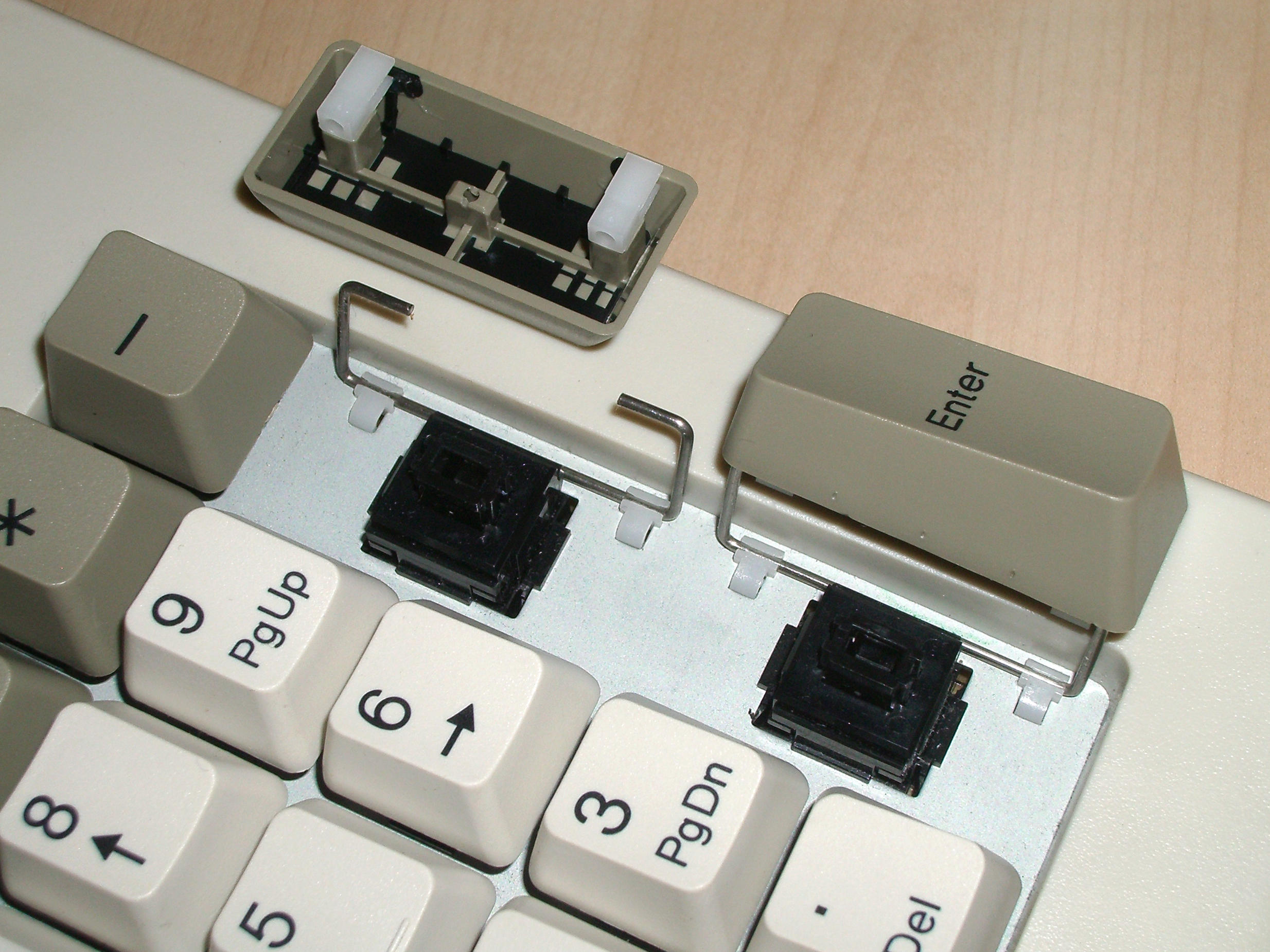

I'm not sure how this is supposed to go in.
When I pulled the space bar, the wire stabililzer and the two black pieces that connect to the plate came out. The AEK II spacebar was a LOT easier to get back in place.
I'm at an hour and I still can't figure it out. And now one of those plastic pieces fell off and is loose inside the keyboard.

Pics would help. I’m guessing you’re talking about the stabiliser clips which the wires run inside, on the plate.
As memory serves they’re quite like these ones from an Alps made Dell:
The clips are somewhat prone to popping out of the plate when the stab wire is manhandled. They squeeze back in quite easily, though. One little foot goes in, then the other. Be sure to put them in the right way around: they’re all about gripping the wire.

Crap. Looks like I may need new space bar stabilizer clips. The old ones may be broken. This is going to suck. I found one website that sells parts, but they're out of stock on that one.
apastuszak
08 Nov 2023, 22:39
Found both clips and managed to get them back in. Space bar works again! Thank God!
