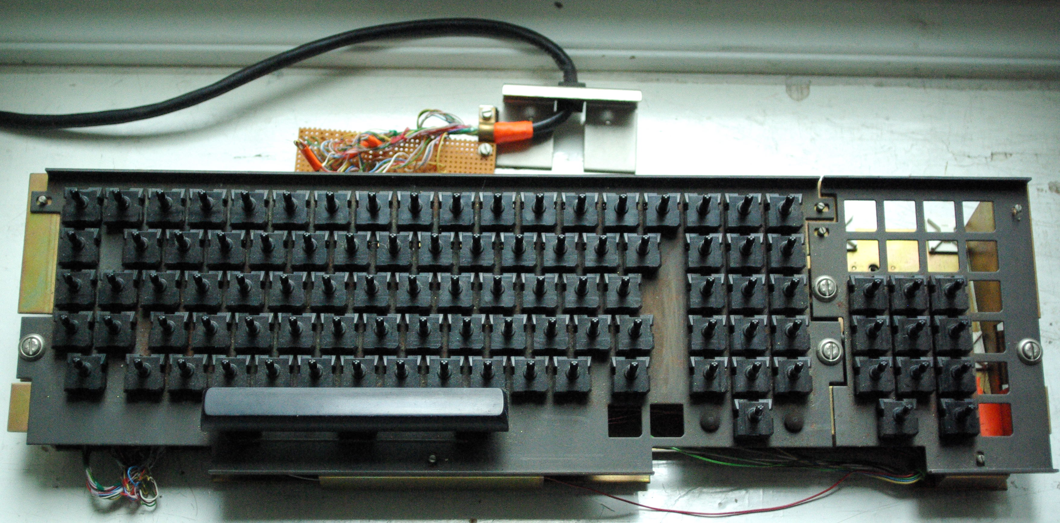

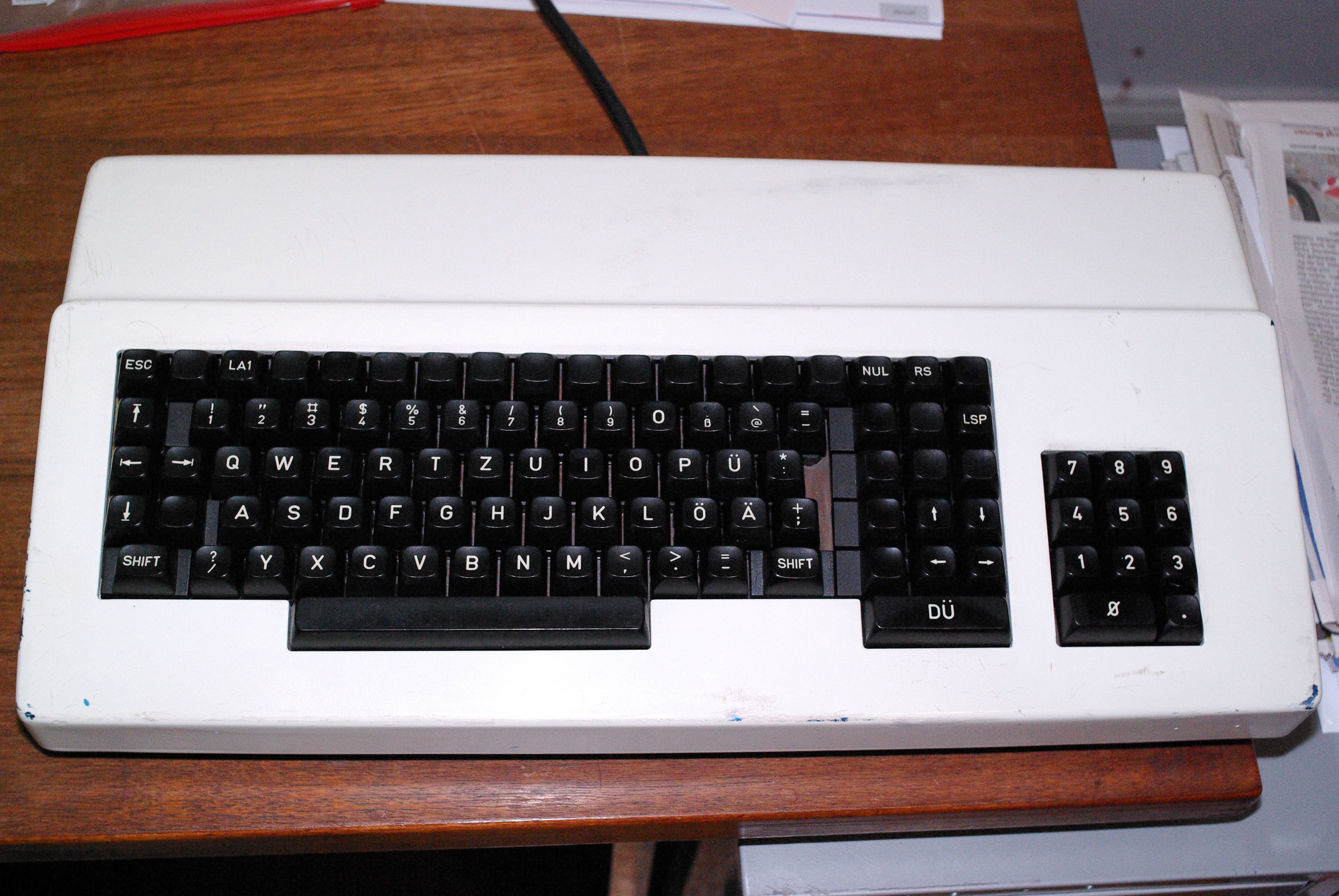

some of you might remember this odd keyboard that I bought for a couple of Euros last year. I decided to take another look at it today, specifically at the switch.
- IMGP7904.JPG (973.1 KiB) Viewed 13181 times

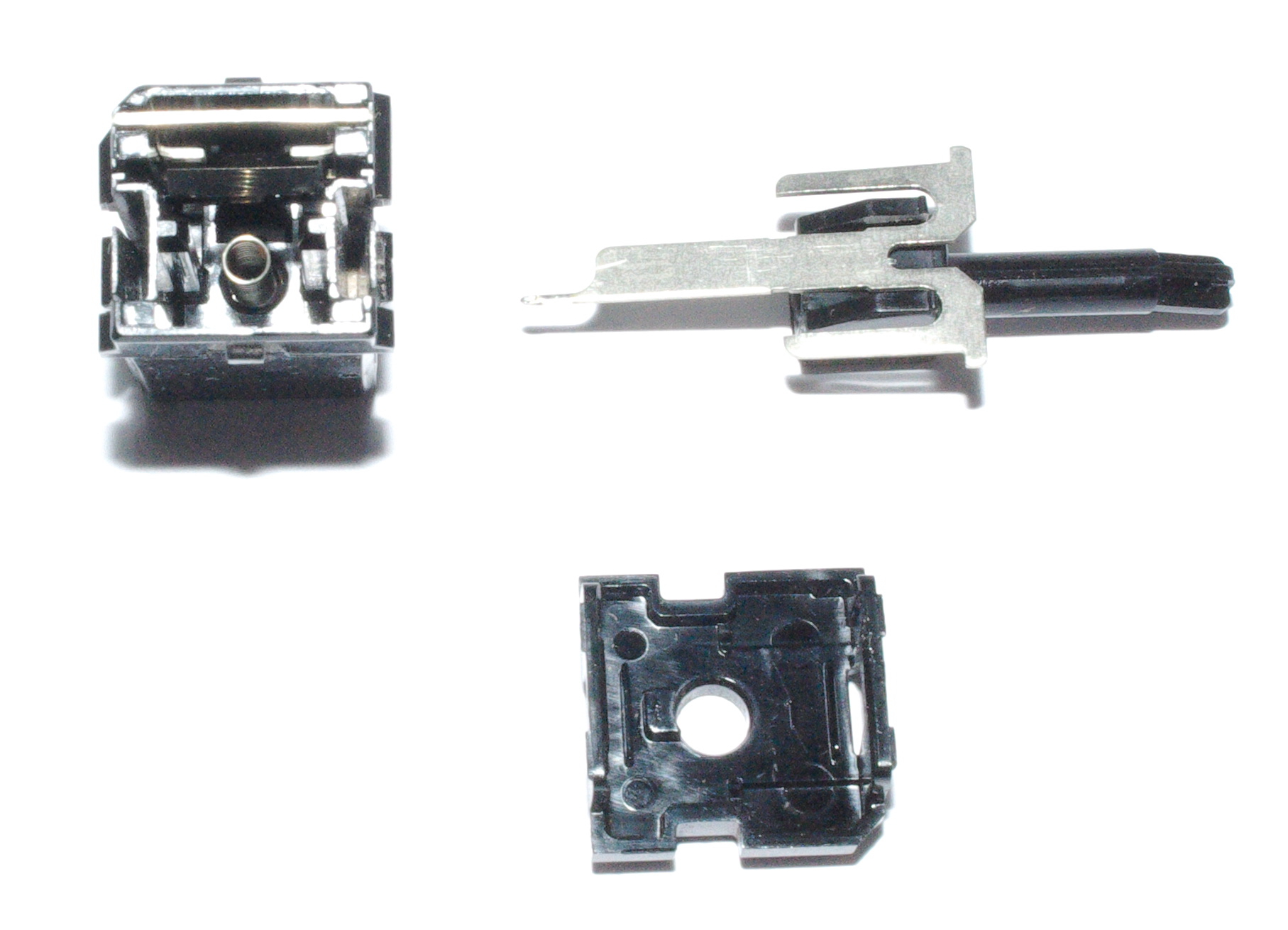

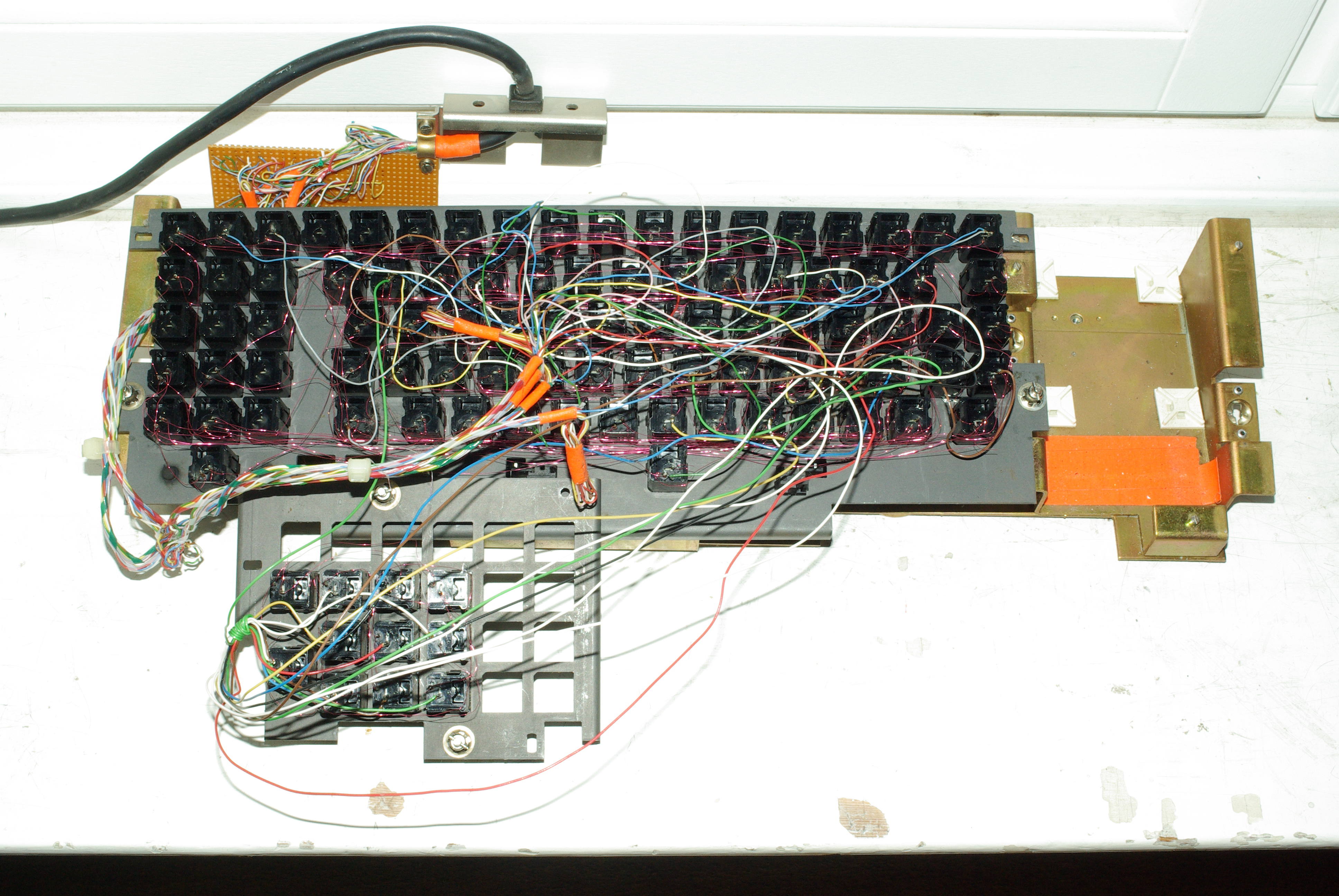

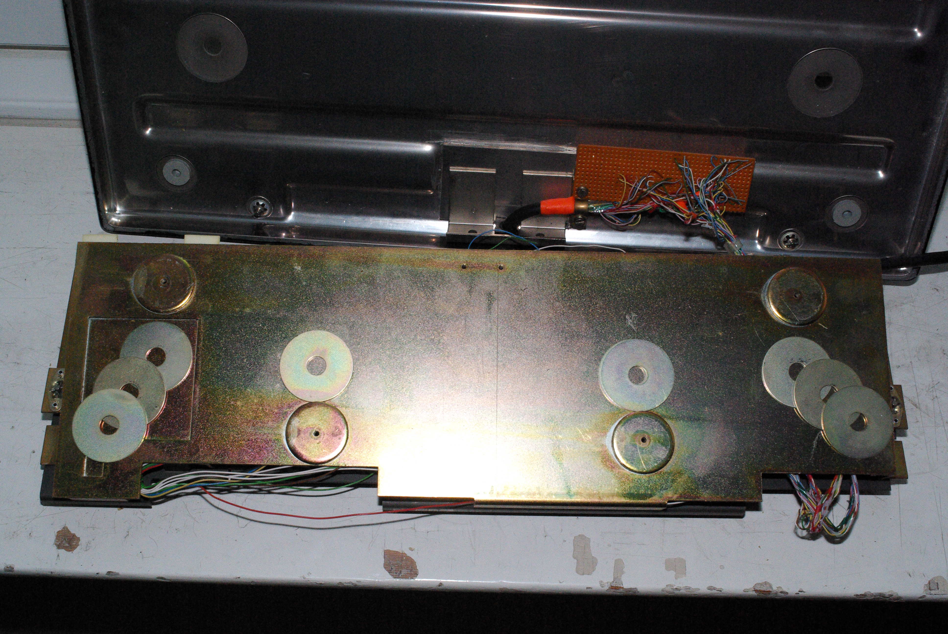

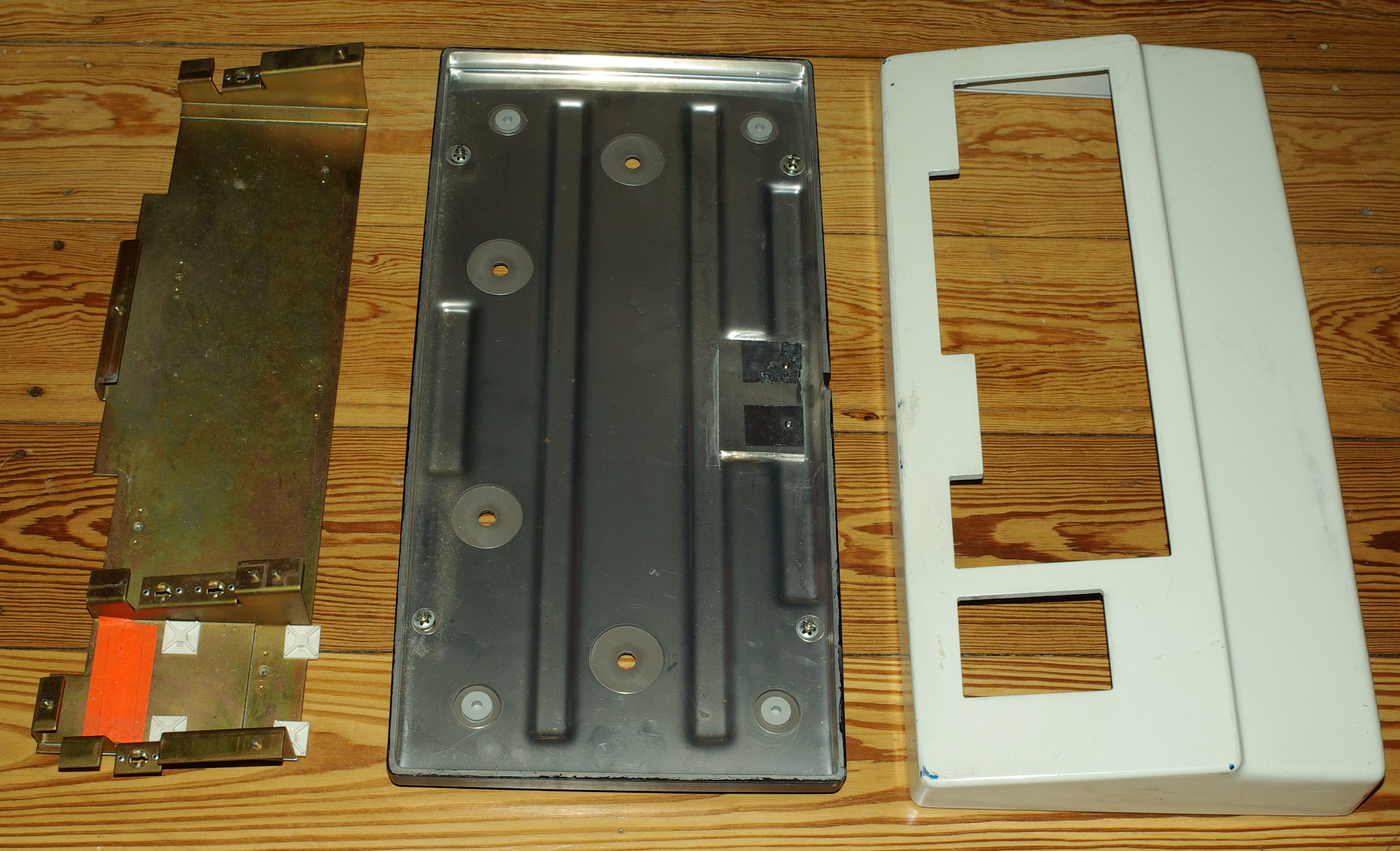

The switches are hinged on a metal plate and quite easy to remove. A few switches were not wired. I took those out for the pictures.
- IMGP7993.JPG (949 KiB) Viewed 13181 times

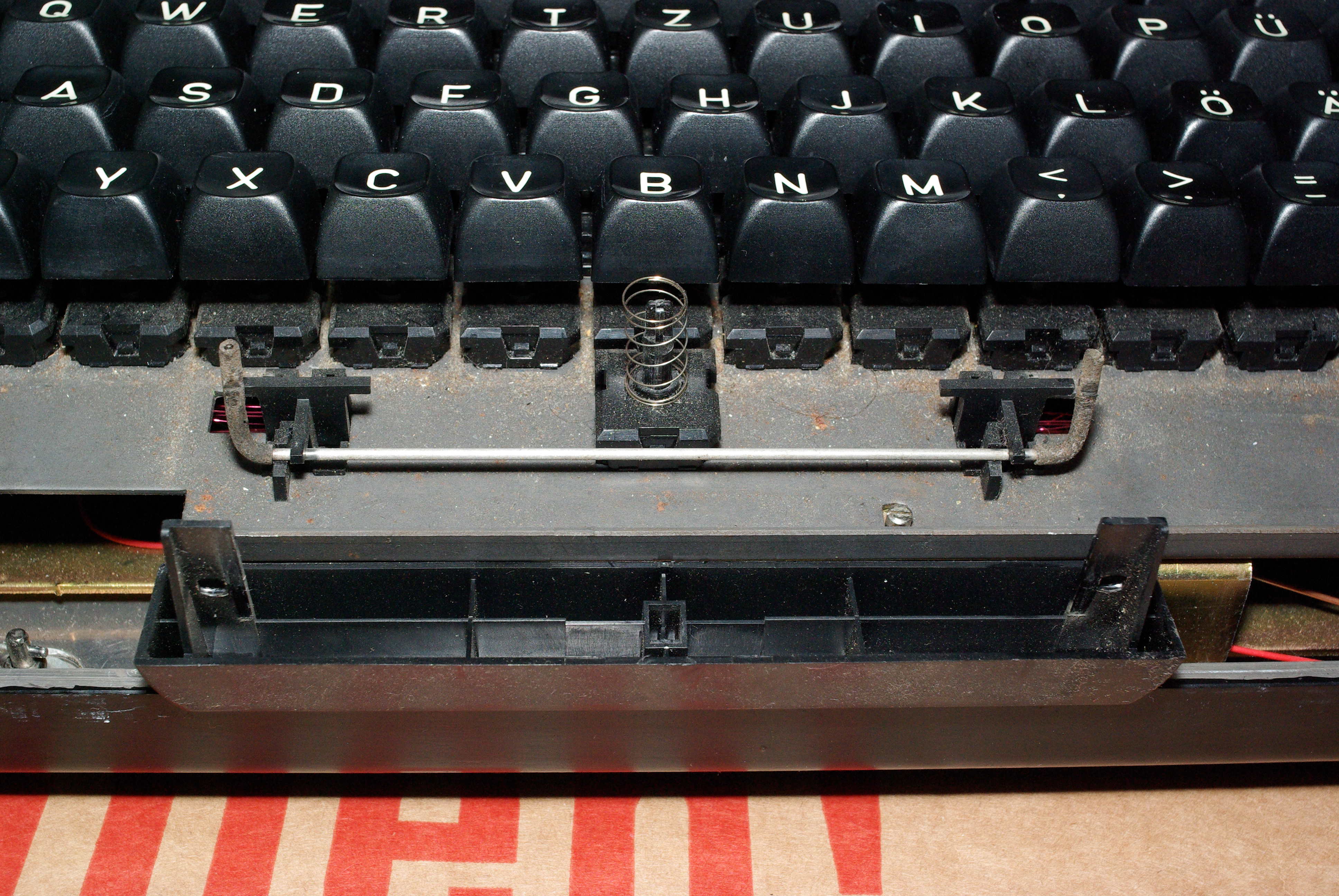

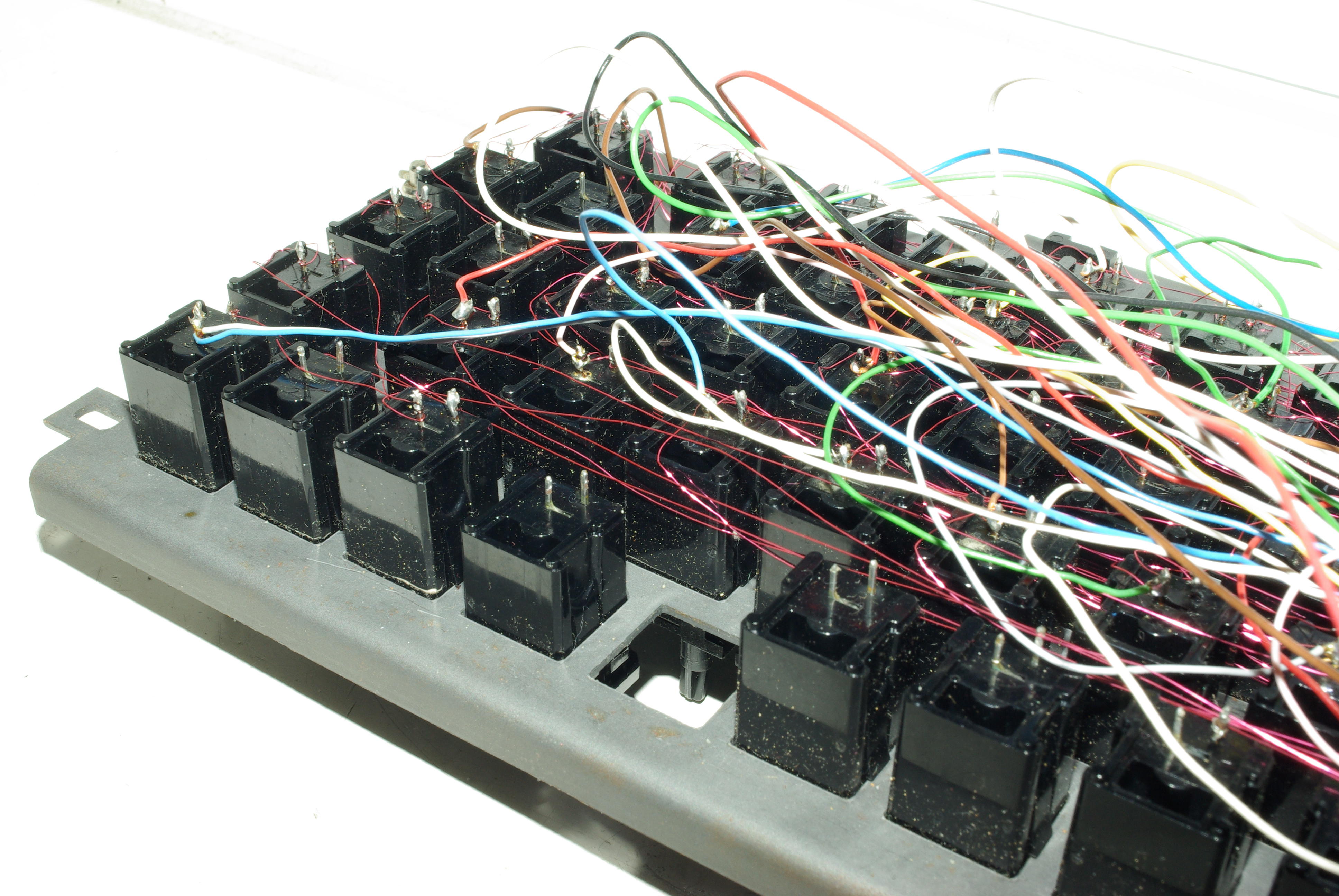

The switch itself has two clips /lashes at the top that need to be bent outward and that´s it. No soldering. Easy dissasembly much like my Micro Switch linears.

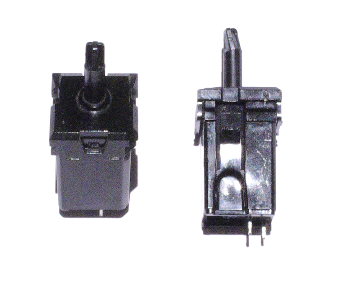

- IMGP8009.JPG (957.33 KiB) Viewed 13181 times
- IMGP7966.JPG (500.35 KiB) Viewed 13181 times
- IMGP7977.JPG (272.64 KiB) Viewed 13181 times

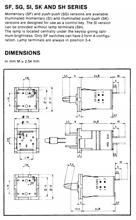

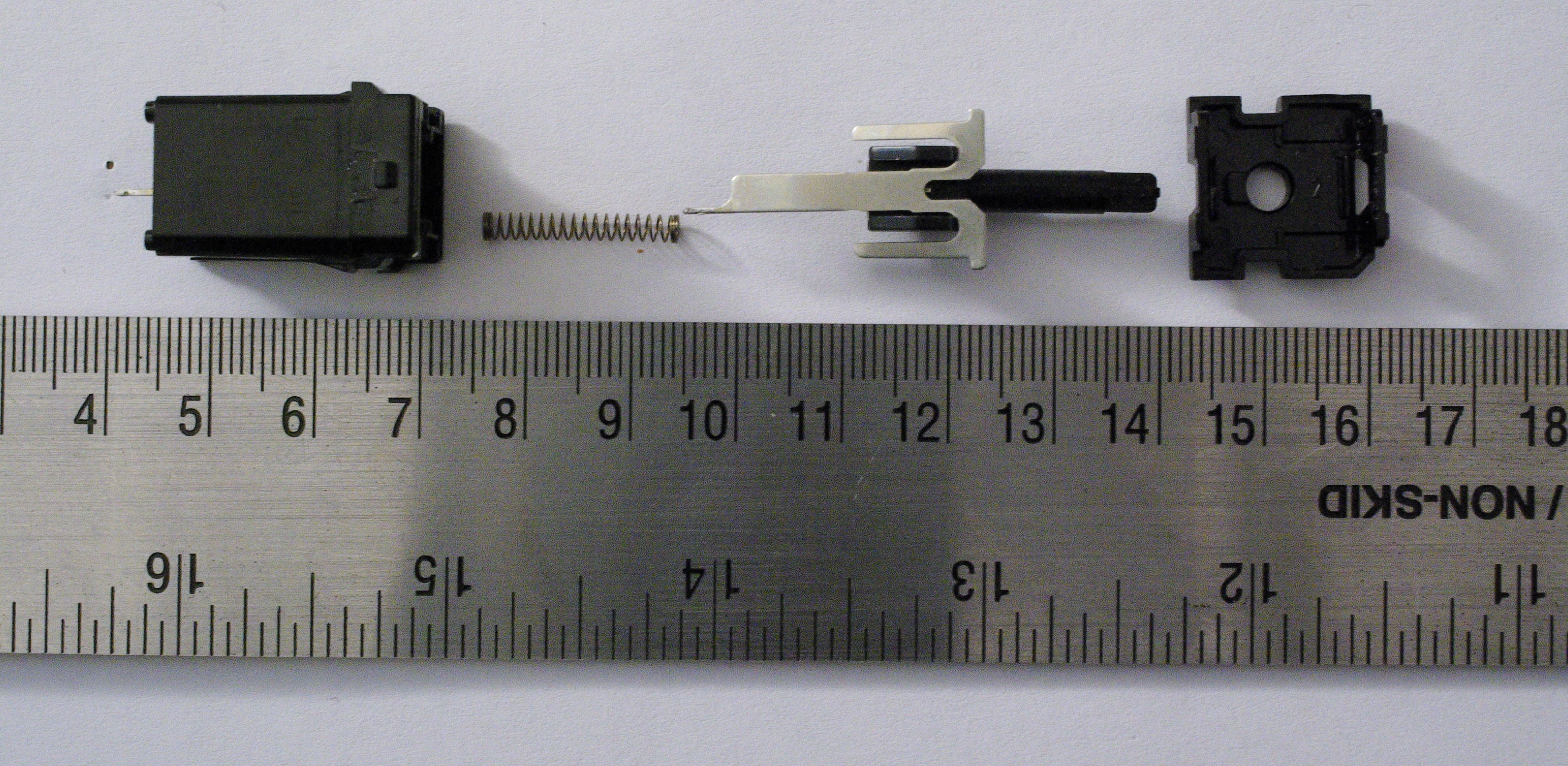

I had quite a difficult time shooting the switch. As you can see the switch consists of four parts. I lined the parts up on the picture the way the part's are assembled. The switch is clicky with a bump.I'm keen to know what we are looking at here, if any of you have an idea I'd appreciate sharing. After HaaTa posted that pdf in this thread my initial thought was it's a Clare Pendar series SF switch but that's a wild guess. The dimensions of the switch housing are quite close to those in the pdf.
