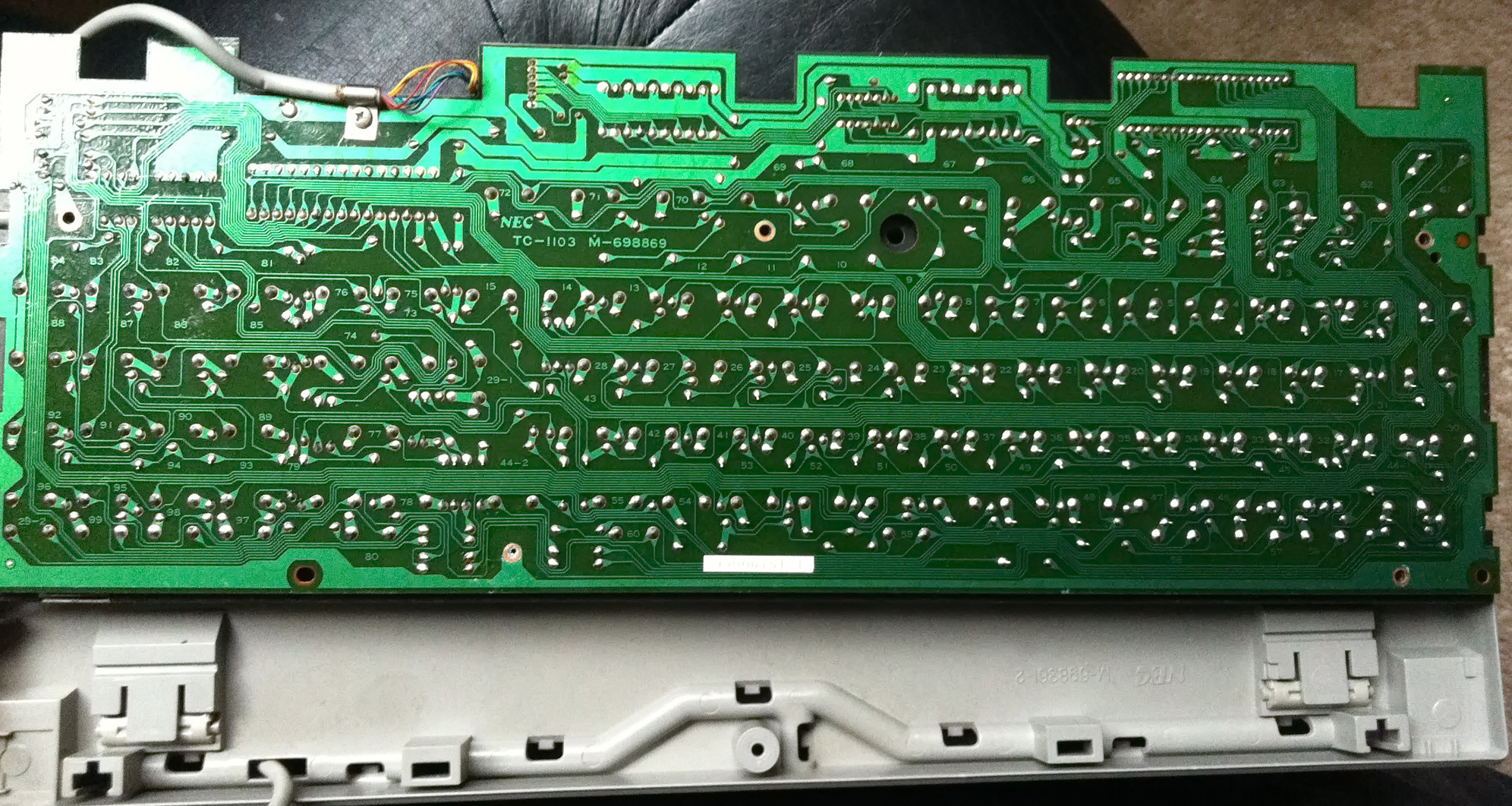

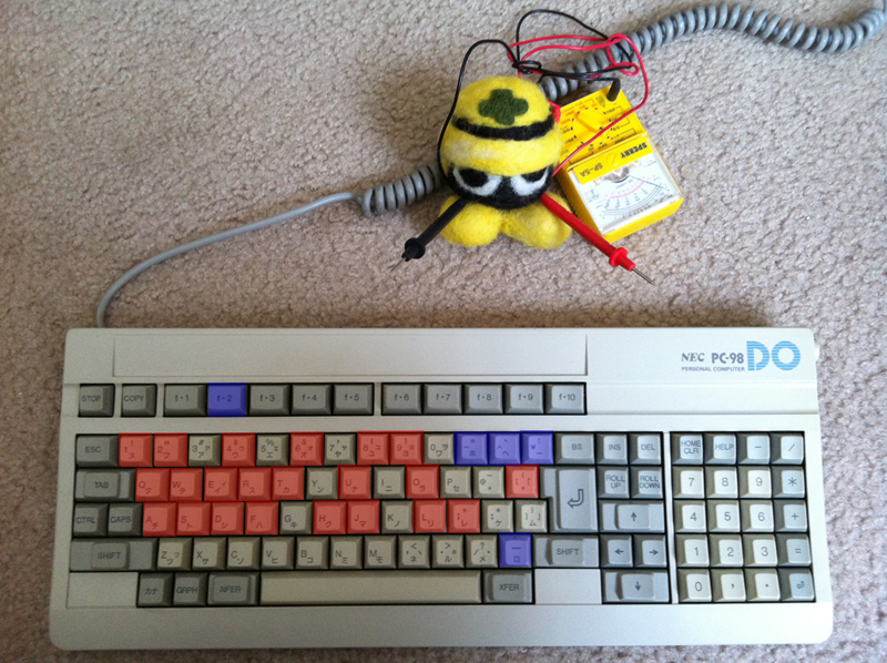

This keyboard is very similar (if not the same) as a NEC PC-9800 keyboard (I have one of these that I need to photograph as well). Except the case, additional cable and novice attempt to dye some of the keys red :cry:

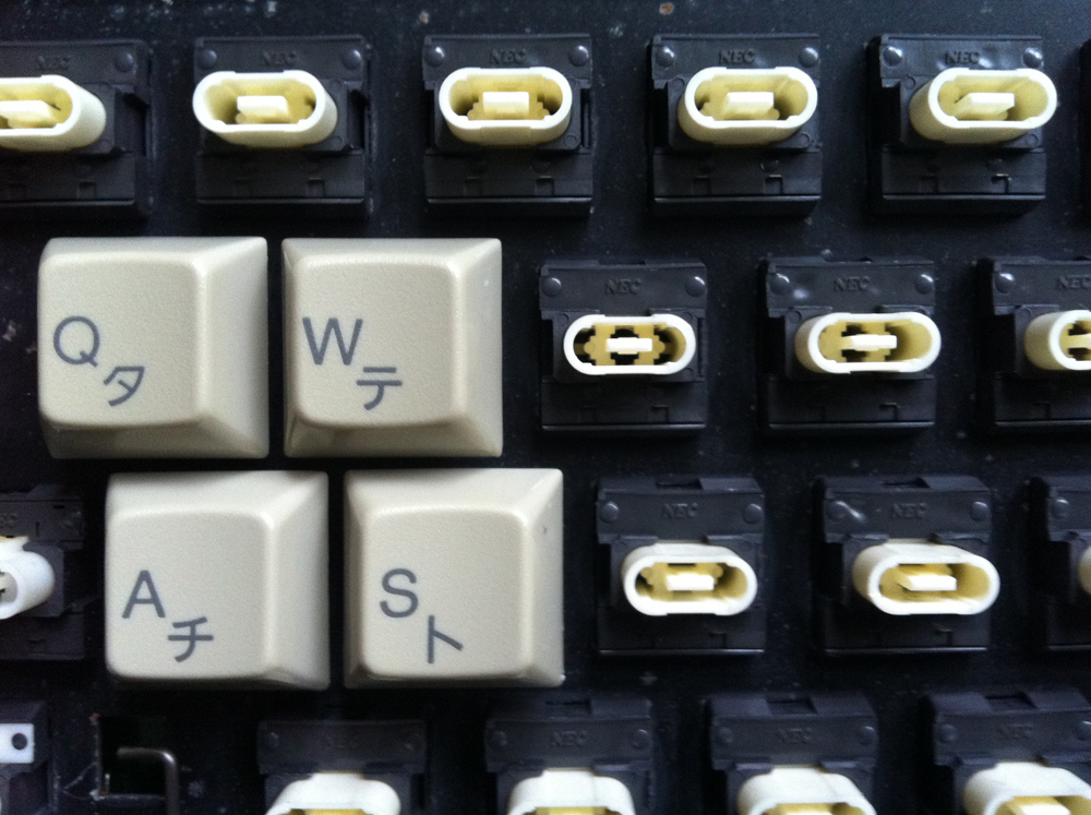

It has three different variants of the NEC switches, all linear. 300g (blue/green), 60g (white/white), 50g (white/grey).

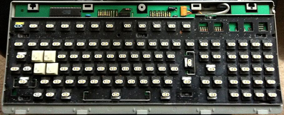

Rare to see this keyboard have many variants of NEC switch. Your keyboard is the [JP][1990.01]NEC PC-H98 Model70 keyboard.
NEC PC-98DO keyboard have the same layout and important thing is their specific switches location are the same.
The caps lock should be the (Latching)White variant if I guess right. Could you mind shot on this switch?
One thing I should explain that type of switch have the name. I correct it to:
-(Linear)Cream White
Cream white slider which is not the same with the transparent white variant. So it called cream white.
-(Linear)Blue with upper green
Blue slider which has the green plastic on the top of the upper shell.
-(Linear)Cream White with upper white
Cream White slider which has the white plastic on the top of the upper shell.

Hmm, I don't think my keyboards have a latching Capslock key.
terrycherry
22 Dec 2015, 06:40
But PC-98DO does has. The slider is different if you look at the photo carefully. You should take a look on your keyboard.
