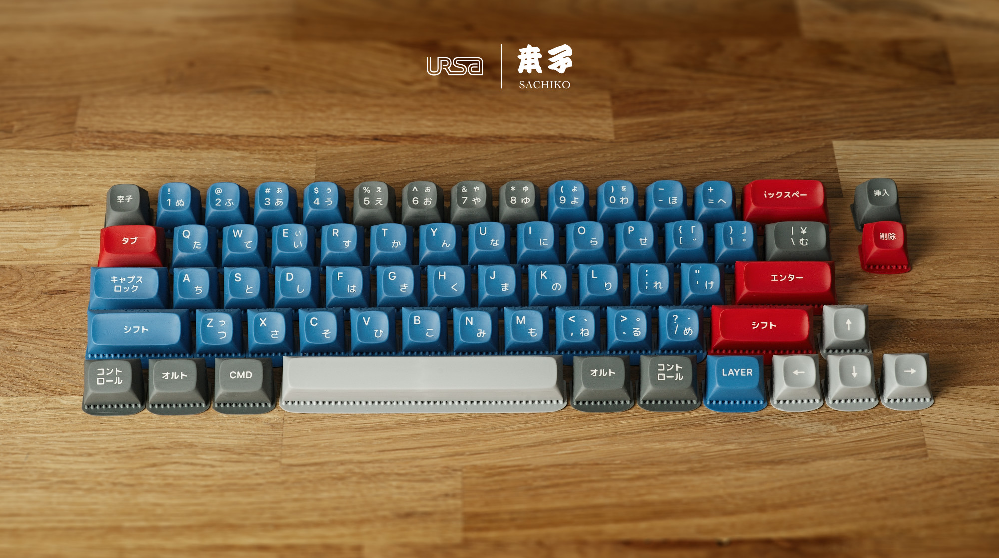

I was very inspired by this NEC keyboard and its Topre sibling, so I made some keycaps for my FC660C. I'm going to reprint the spacebar in blue at a later time.
