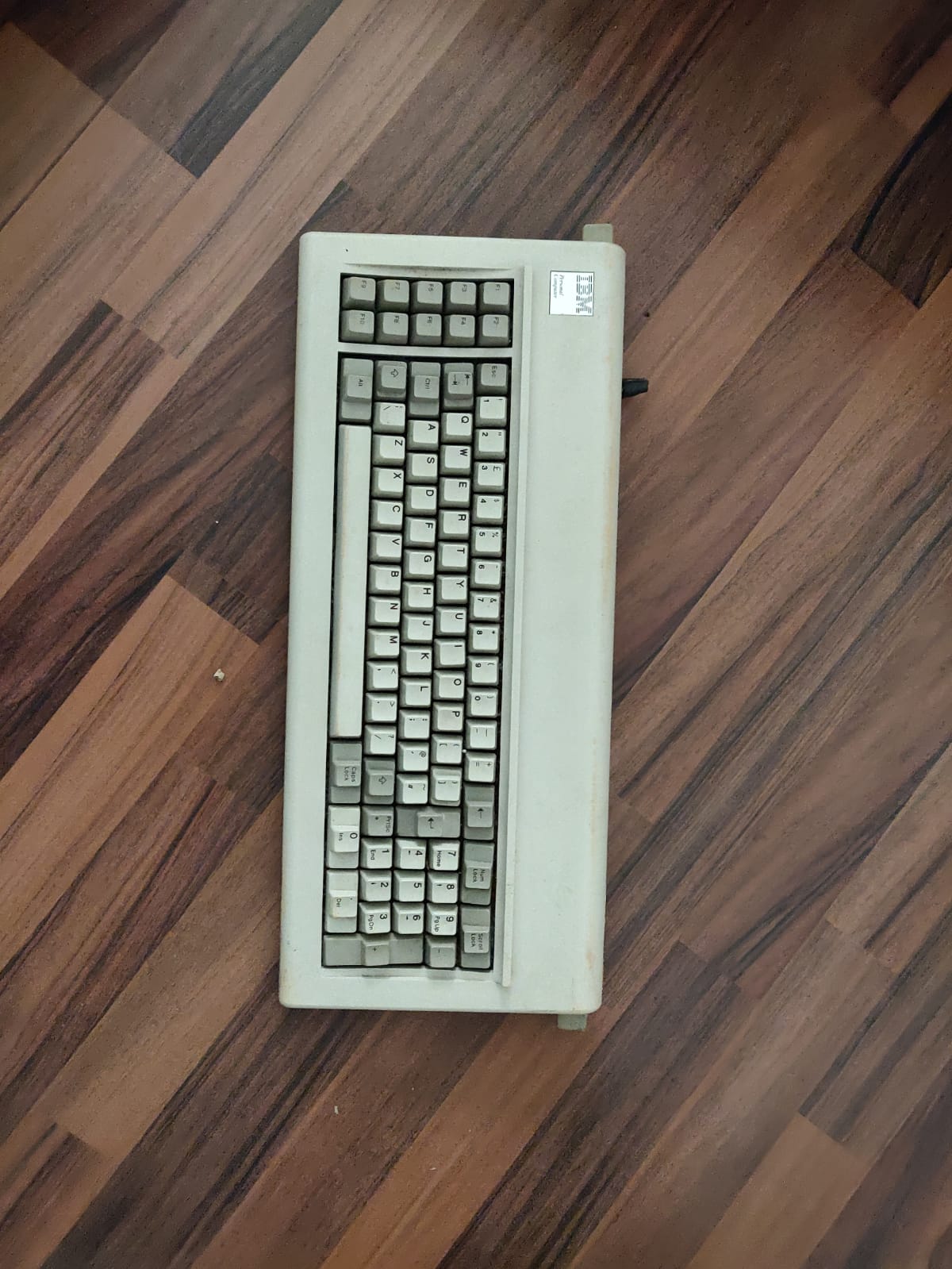

Having looked around for a few months I got lucky and recently acquired an IBM Model F XT for GBP 12.5. In fact I am typing on it right now :wink:
Here's the thing in all its glory, when it arrived...un-restored
One of the first things I did was to open it up. The label has a date of 24-12-1985! Christmas Eve of 1985!

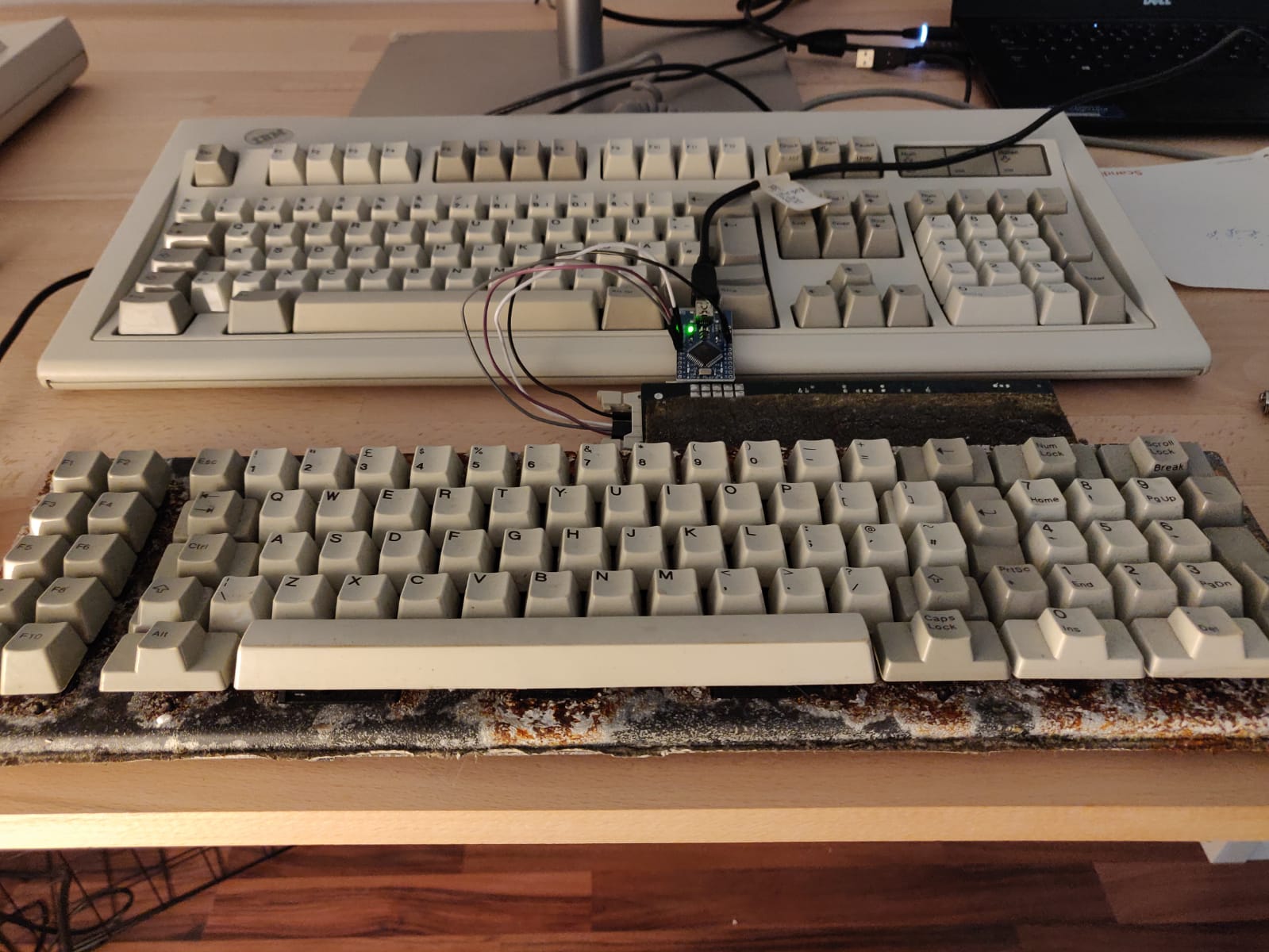

I hooked up my pro-micro and was pleased that every key worked!

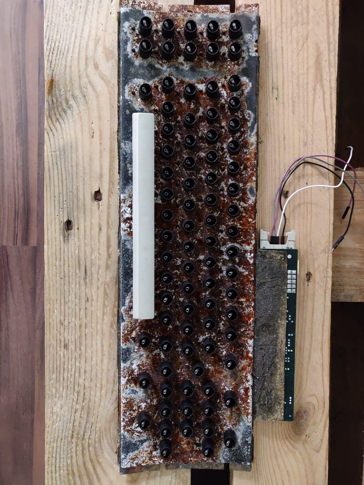

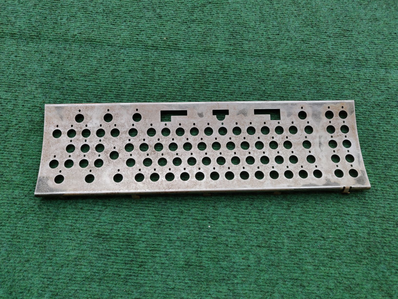

Look at all the the rust on that plate!
However, the worst hadn't come yet. I was in for a shocker when I opened it up and removed the keycaps ....
[/spoiler]
That's the worst form of rust I've seen on any piece of metal ever! That keyboard may have well been salvaged from a ship wreck in the North Sea.
What follows is a restoration post with tips and tricks on how to restore this...

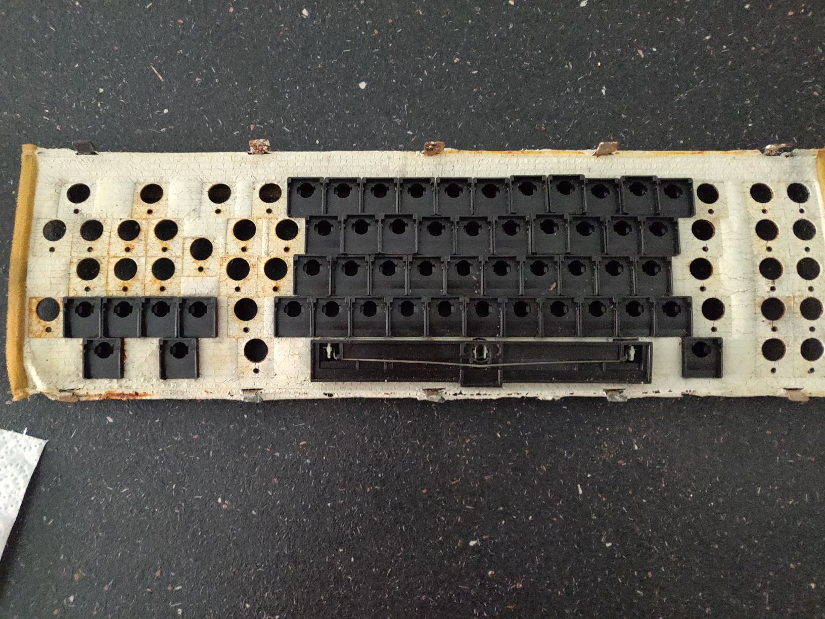

Opening up the top plate was not easy. I tried to pull it out, its impossible to get this done alone.
Being the impatient guy I am, I took a pair of pliers and pulled the lower set of clamps outwards. I don't regret the decision one bit, I personally think that may be the most fragile way to remove the top plate.
All the barrels and flippers were intact. The foam surprisingly seemed fine as well, except for the rust marks. Once I pulled out the foam it completely disintegrated. The back of the front plate was completely rusted.

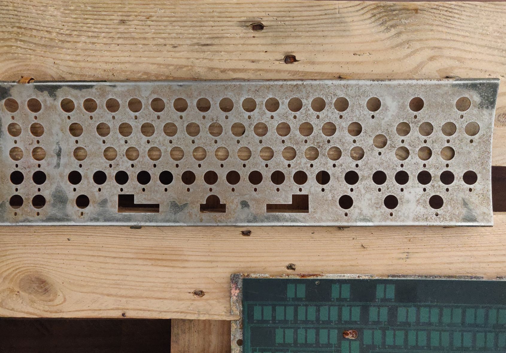

I used a highly concentrated vinegar bath for the plate and let it stay overnight. The left over residue looked like some sort of dark brown slurry. I never knew vinegar cleans so well. That's how the plate looked like just after a vinegar bath.

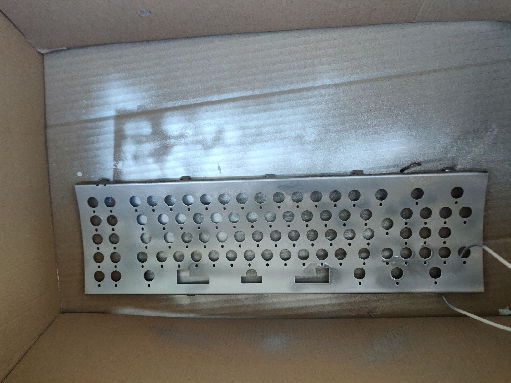

I spent 15 mins sanding it down with sandpaper. I started with a 80 grit paper and eventually finished with a 120 grit paper. I ended up with a fairly clean top plate
Time for the spray paint. I chose a silver spray paint as its neutral enough to not stand out under the keycaps.

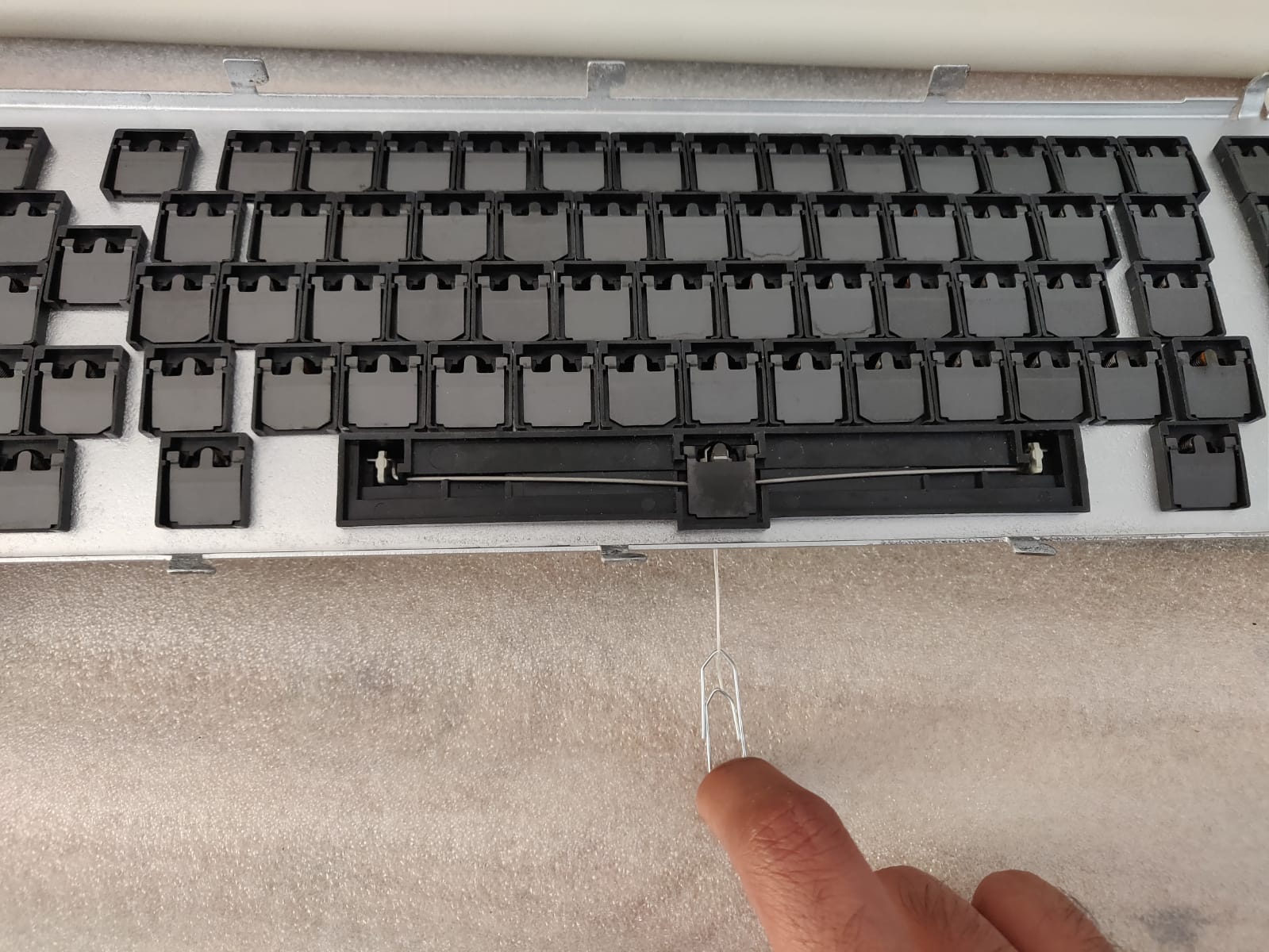

Assembly was easy, except for the flipper that will not stay put on the space-bar. The only way to get it in place is to hold it down with a loop of thread or floss. I used a loop of floss and held it down with a finger while I placed the back plate on.
Once again I used the pliers to fold back the hinges onto the plate and that completed the job.

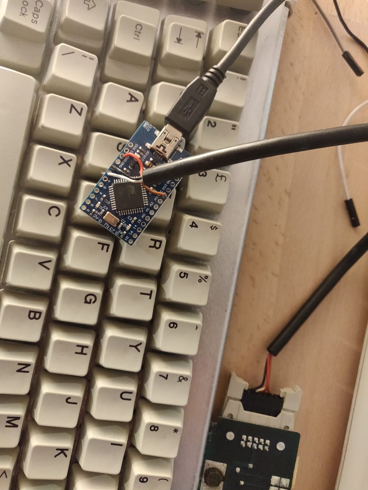

Time for a test, works perfectly! Here's the original cable cut out with the connection to a pro micro.

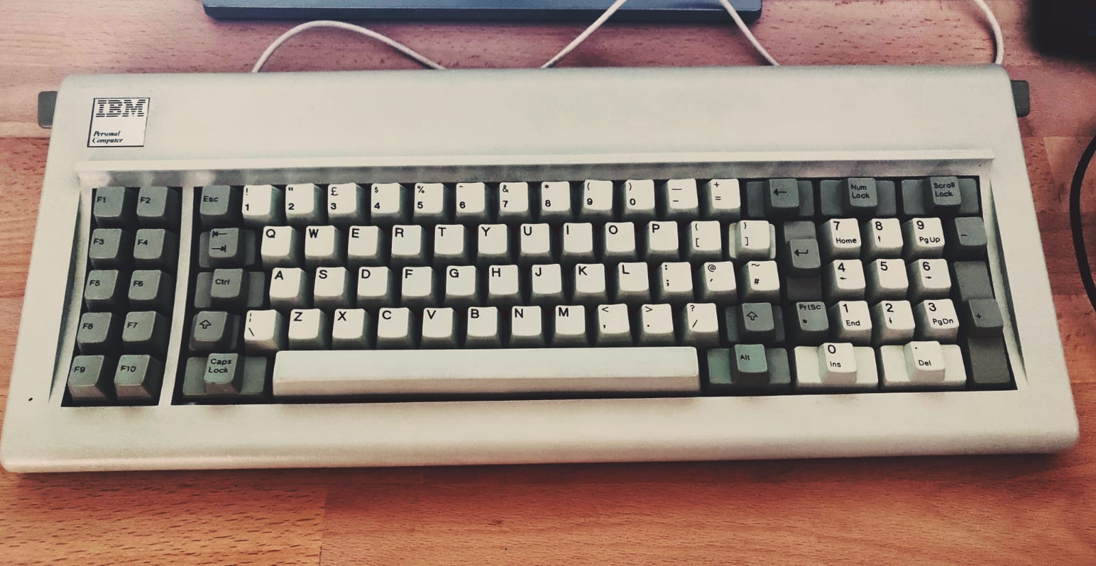

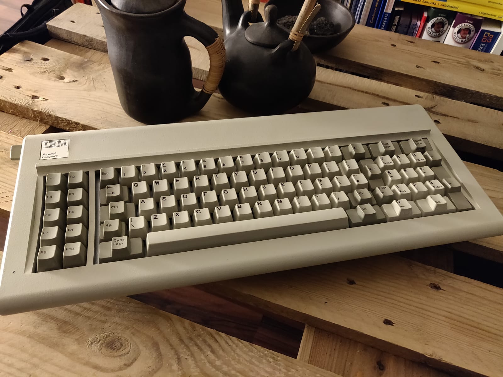

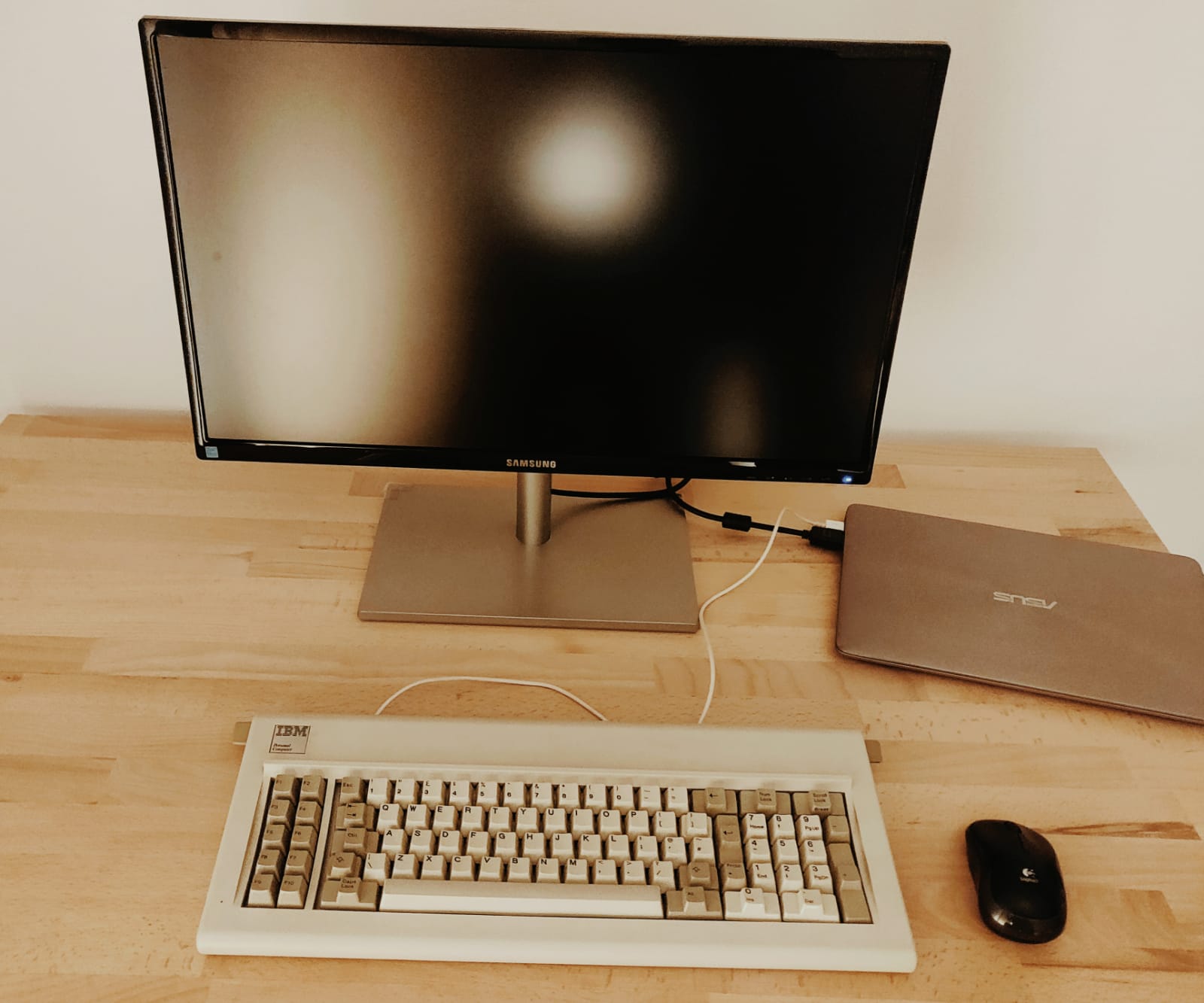

Job completed. Here's how it turned out in the end.

I used a separate Pro Micro in the end, as I gave the original connector to a friend who wanted to get a converter for his Model XT.
The new pro micro had a problem when I cased it into the shell, the culprit was that the Clock and Data cables kept shorting. It seems when I put the lid back on, it would press against the cables and my solder joint wasn't strong enough to keep the cables from shorting. A quick re-solder job and insulation with electrical tape solved the problem.

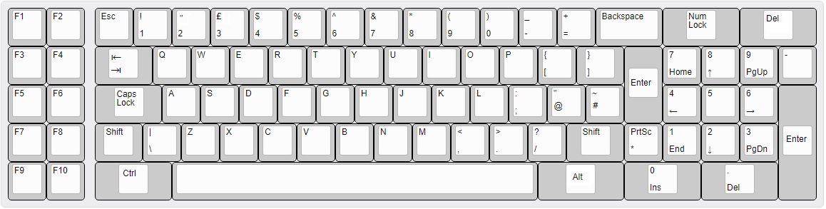

I remapped the keys to represent the modern day layout. CTRL is now CAPS, Original ALT is now CTRL, Original CAPS is now ALT, Scroll Lock is DEL and Number pad + is Enter. I will post the remap file later in the evening.
That's the layout I went with. Leave a comment if you have some suggestions.

In all I spent about 10 euros (5 for the spray paint + 5 for the Pro Micro) and 2 days in restoration (1 night for the vinegar treatment + 1 night for the spray paint to dry).

All other restorers. I read all the posts before even attempting to buy this keyboard. The floss trick to hold down the space bar has been mentioned on several forums - and is the only guaranteed way to align the flipper.

As promised, here's the remapping entries I used:
remapblock
BACKSLASH EUROPE_2
BACK_QUOTE BACKSLASH
PAD_PLUS PAD_ENTER
SCROLL_LOCK DELETE
LCTRL CAPS_LOCK
CAPS_LOCK LALT
LALT RCTRL
endblock

Just one question: why don't you map the `¬ key to the */PrtSc key below Enter?
kmnov2017
23 May 2019, 08:33
What key is `¬ ? And why would I need that ?
