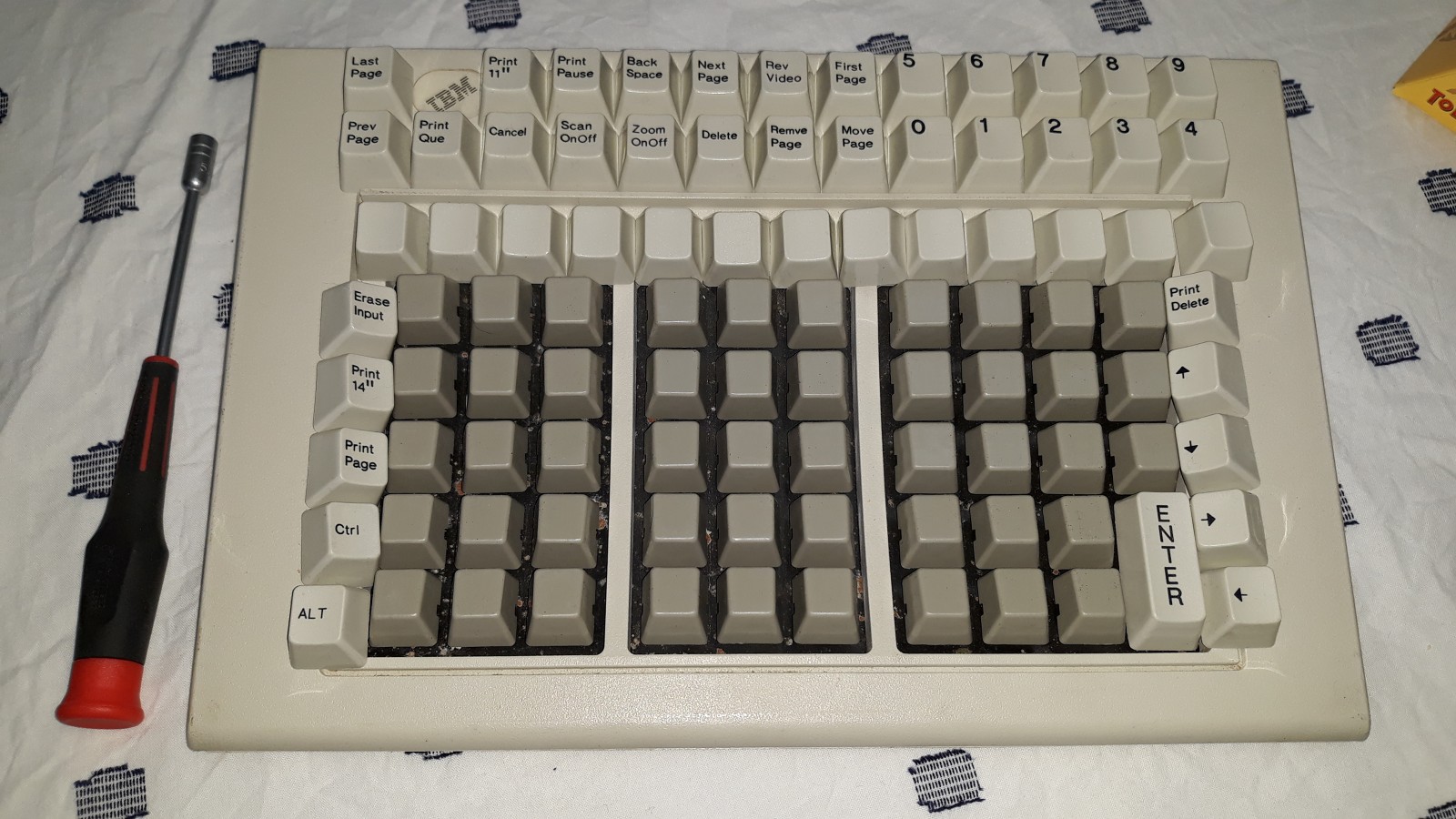

I happen to have two IBM Model M 50-keys keypads, a 1392560 (with relegendable keycaps) that I've already shown off a couple times around here (see photos-f62/an-ibm-m-keypad-that-feels-l ... 17806.html and keyboards-f2/buckling-springs-clear-key ... 17805.html) and a 1393915, with specialized-function keycaps and a 2U Enter key. This is how they looked like before being taken in for this project:
IBM Model M 50-keys keypad, P/N 1392560.

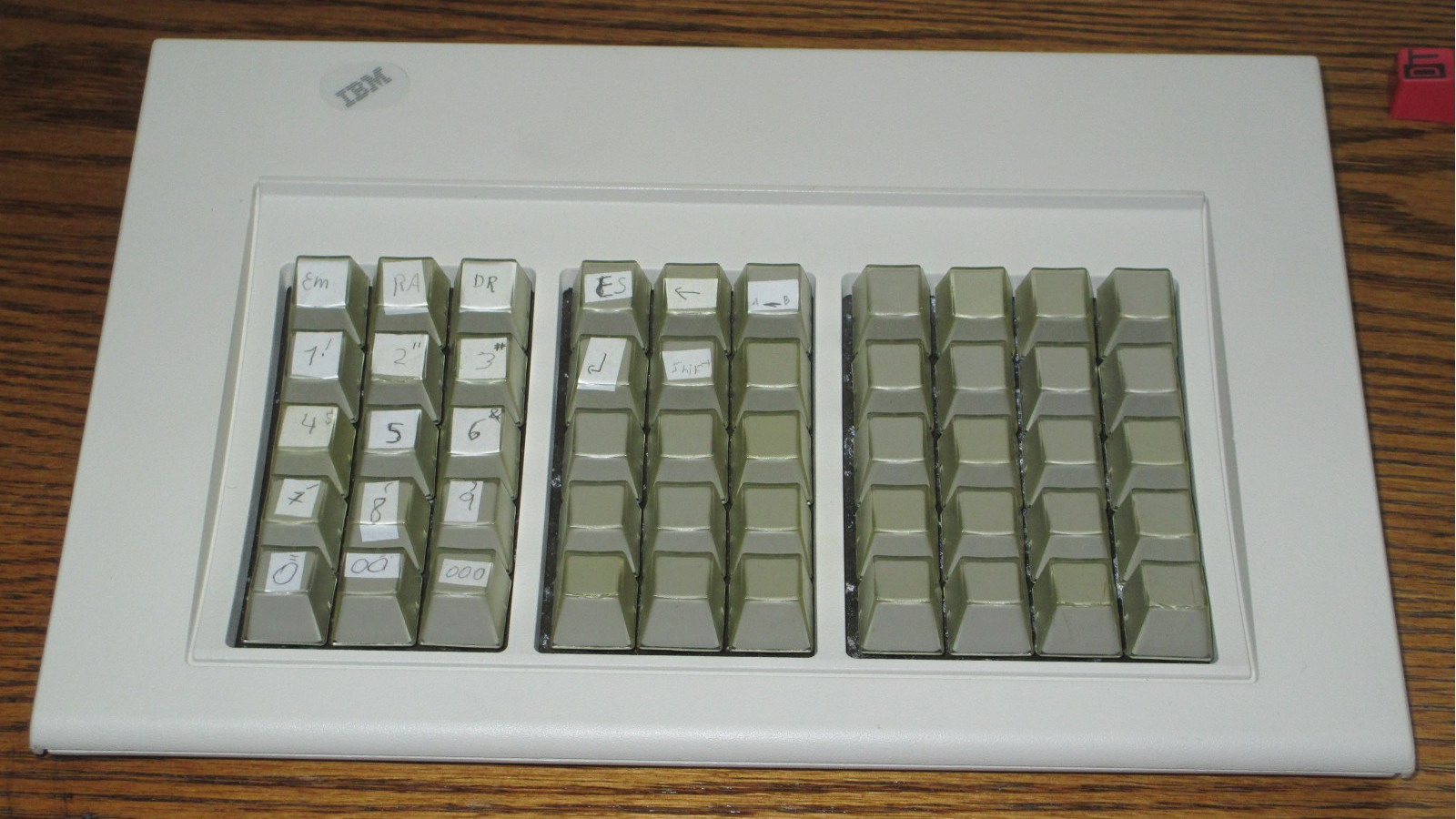

IBM Model M 50-keys keypad, P/N 1393915.
The first keypad had been assigned to my son's usage; you can see his hand-written legends on the keys he had determined an use for. The second one is shown with its keycaps taken off after a rather needed cleaning.

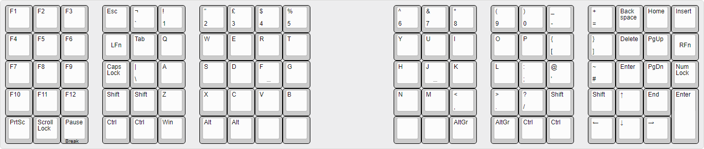

After collecting all the hardware I needed, I designed the layout for both sides of the SOLBUS. It wasn't too difficult, except that the presence of a 2U Enter key on one implied some restrictions on what I could do (opening that keypad to install the missing flipper wasn't really an option within the scope of this experiment, so I had to make do with what I had).
The SOLBUS layout (.sc files available upon request).
Main features of note:
  • The general layout imitates a normal alphanumeric block as much as possible.
  • The function keys and the PrtSrc/Scroll Lock/Pause keys are moved off to the leftmost cluster.
  • The "center" four clusters get almost all the alphanum block, including mods.
  • The rightmost cluster is pretty much a modified, 65%-like nav area. My initial intention was to have the Home/PgUp/PgDn/End keys in the rightmost column, but I couldn't do that because of the 2U Enter key; I shifted them one place to the left.
  • The above change stopped me from having the 2U ISO-like Enter key to the right of #~ and ]} — The tiny 1U Enter key in the middle wasn't too bad, as at I still had a secondary 2U Enter key at the lower right corner.
  • I reserved one key on each side for Fn keys. Their usefulness, however, is limited, as both can used be only in combination with keys on their respective keypad. In the end, I didn't bother programming them to do anything.

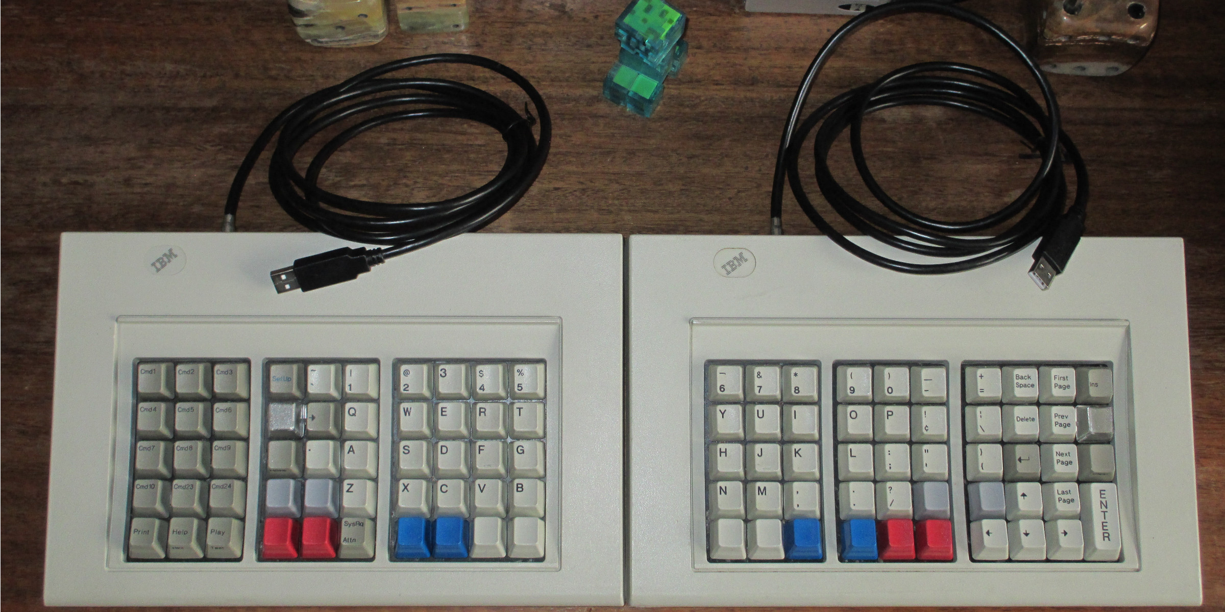

With the layout defined, I wrote the .SC files for both keypads (SOLBUS-L and SOLBUS-R), flashed the converters and then put on keycaps on each keypad. The majority of the caps came from a old set salvaged from a dead M122, while the space caps and most nav caps were taken from the 1393915's (the SOLBUS-R) preexisting stuff; colored Unicomp blanks filled in for the mods and two Fentek relegendables were used for the Fn keys. I could have used APL keycaps for maximum hipster points, but chose not to.
The SOLBUS keyboard cluster, ready for business.

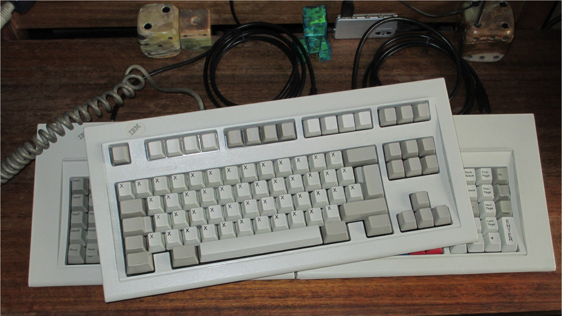

This contraption is not small! At its unsplittest, this thing is wider than a Model M SSK and even a bit wider than a full size Model M keyboard.
The SOLBUS keyboard cluster, with the XXK keyboard above it.

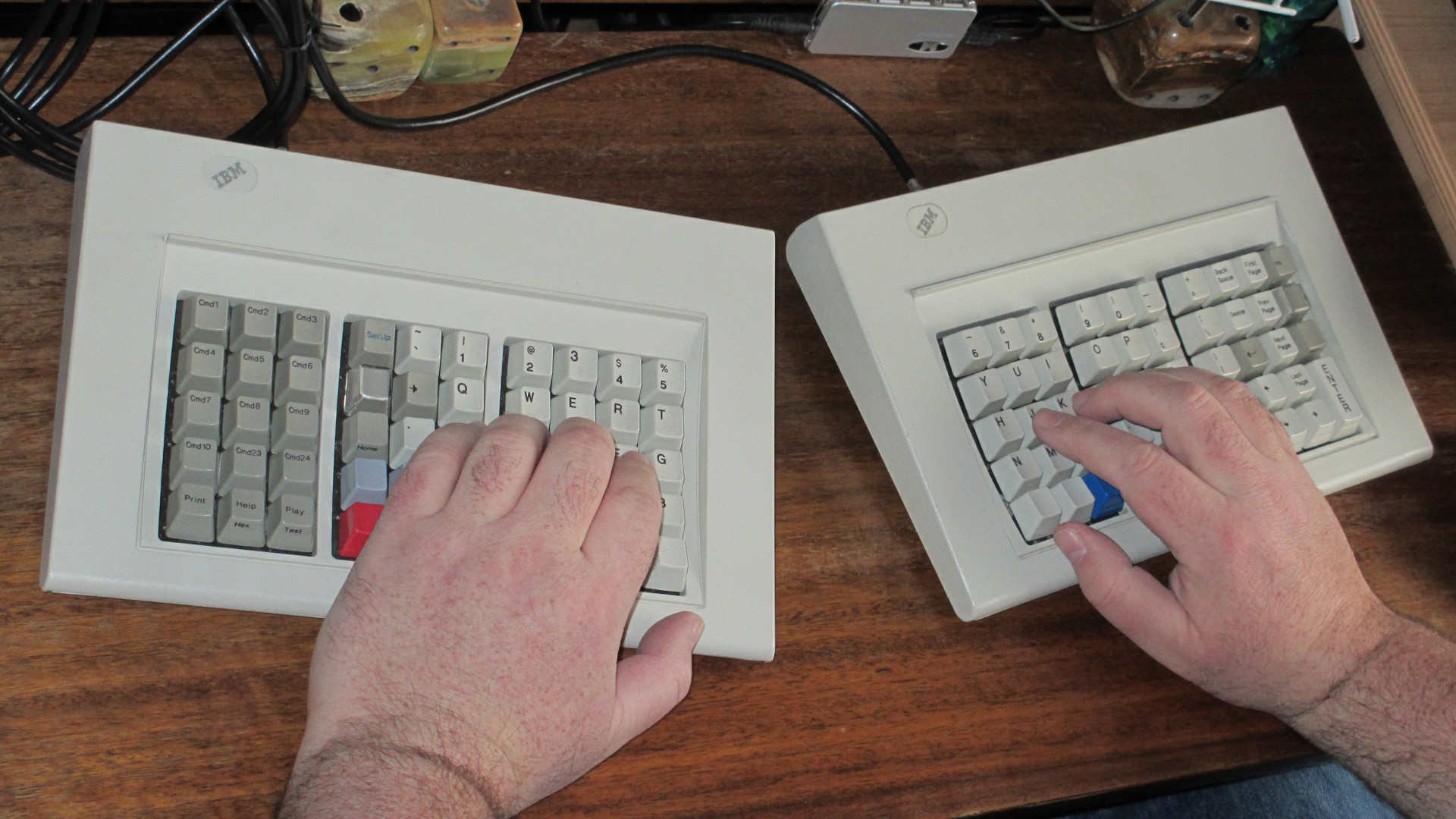

With everything ready, I tested out a few angles, settled on one, and started typing.
The SOLBUS keyboard(s) in action.
