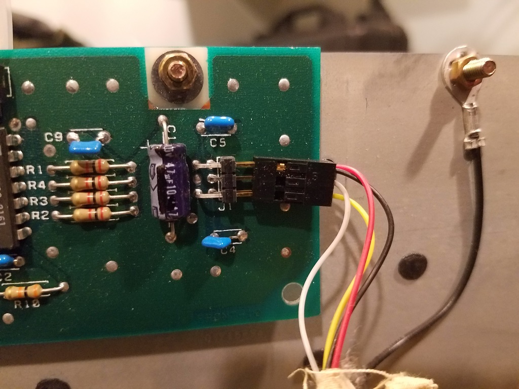

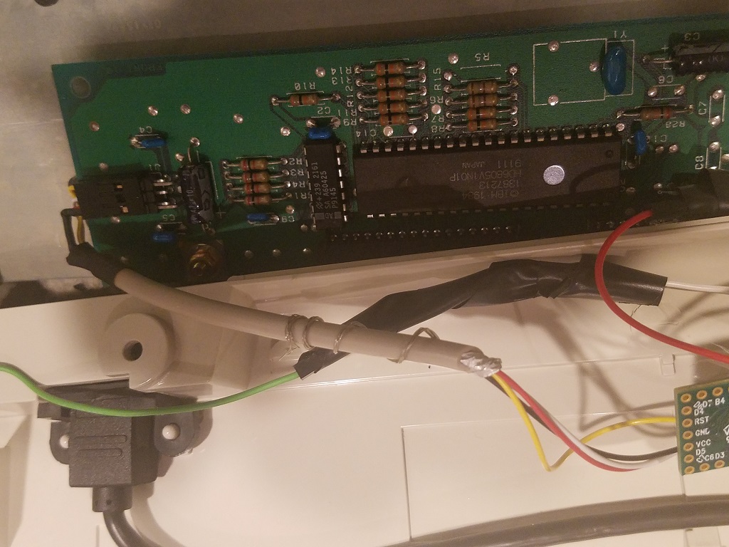

Came across an early 1992 Model M from a decommissioned AIX box. Has the ethernet type plug and no LEDs. Wanted to make this completely reversible, so I decided to pull the original cord and wire a teensy with Soarer's to a connector. The teensy then plugs into the original controller and the usb runs to a F socket where the cord exited the case. Not wanting to drill the case for LEDs, I decided to try under-key mounted LEDs run from the Soarer's.

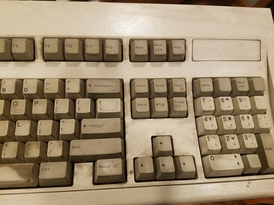

They keyboard was filthy, but not heavily used. The rivets were in good shape.

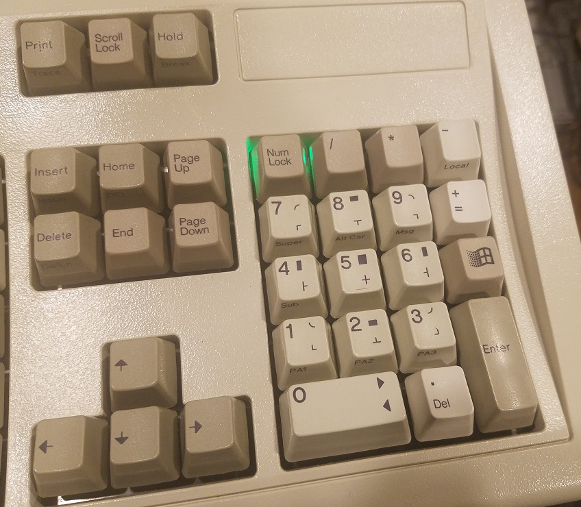

I found a suitable connector in my box of old pc parts and moved wires to match the color scheme. I had some 3mm LEDs lying around. I ran one leg to a 500 ohm resistor, then the teensy, and the other leg I grounded on the existing case screw.
Everything worked fine, but the LEDs were clumsy to run and make the case fit poorly. They looked ok when lit. I've ordered some chip type SMD LEDs to play with, which will hopefully fit and look better.

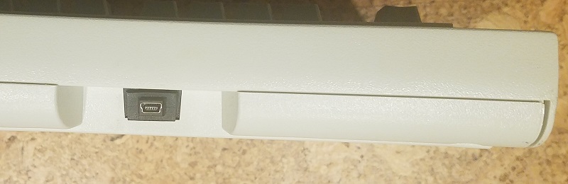

The fit was a little sloppy, but I like the mini usb socket. I got a spare cord support bracket from Unicomp when I ordered replacement keys, so I didn't have to hack the stock one.

Great work with the NumLock light!
I just wish I knew how to make the light come ON when NumLock was OFF, since I never want it off and need to know when that happens!
