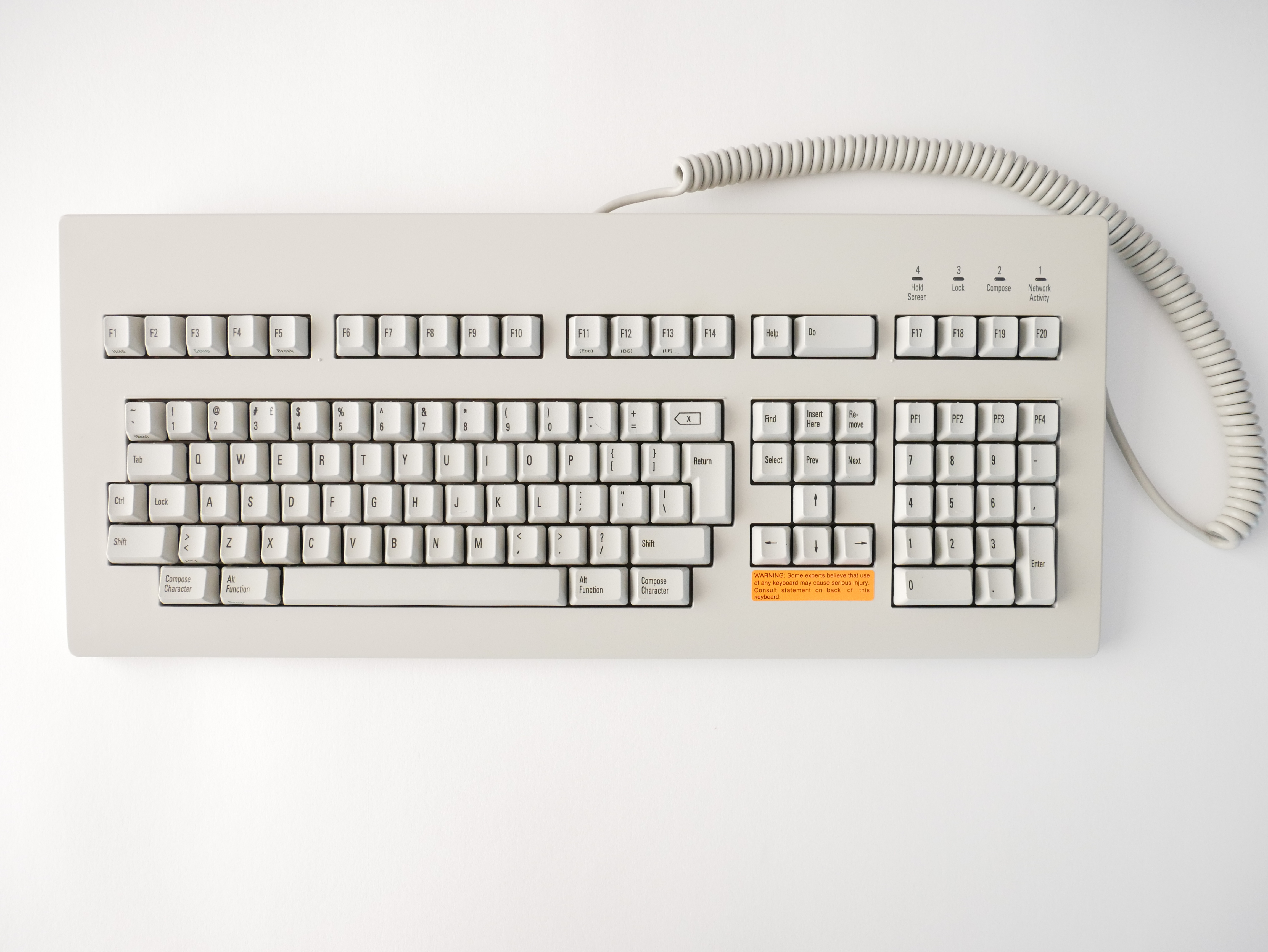

Hi All,
Back with another NCD find. This time it's a N-108LK in a DEC Style layout. This keyboard uses HI-Tek 725 Series Linear White 2 Eye switches.
Just like the other the other NCD keyboard this one is NOS(New Old Stock). Additionally, this keyboard uses white clicky switches that are now linear due to the click arm being removed.

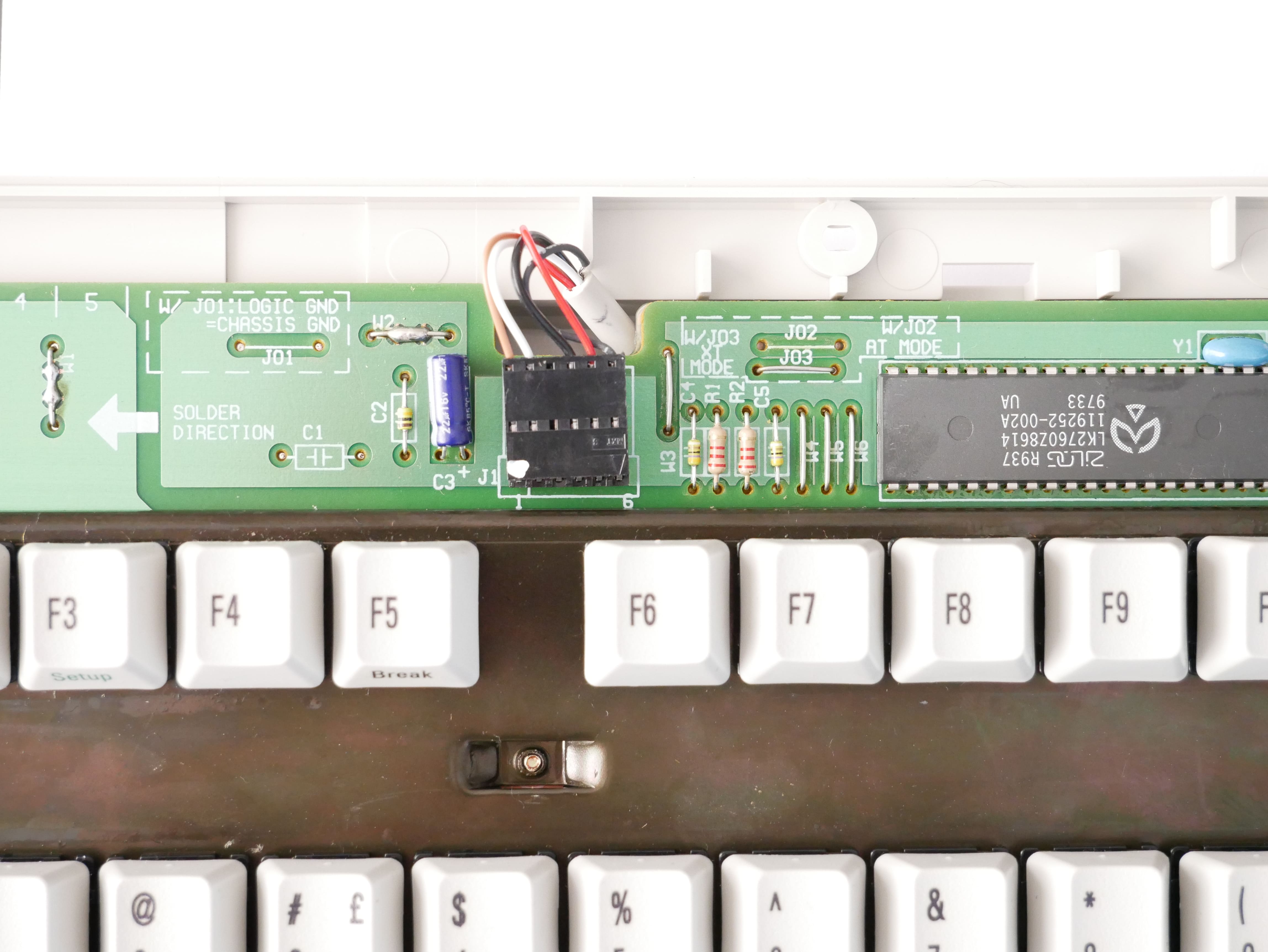

Unfortunately, when I got this keyboard and plugged it in I noticed that the keyboard was not mapped correctly and the keyboard was also not sending break codes. Also the lock lights really didn't work properly at all either.
So time for some investigate work.... I noticed that there is a jumper that set the main controller either into XT or AT and currently it was in the AT position. Rather having to remap the whole keyboard and deal with sending fake break codes I put the keyboard in to XT.
Now most of the keys are remapped properly but not all. That being said the main concern was being able to use the original cable that came with the keybaord as I'm typing this out on said keyboard.
I will post an edit with the proper remap for Soarer's converter later on once I build one with the proper remap.
