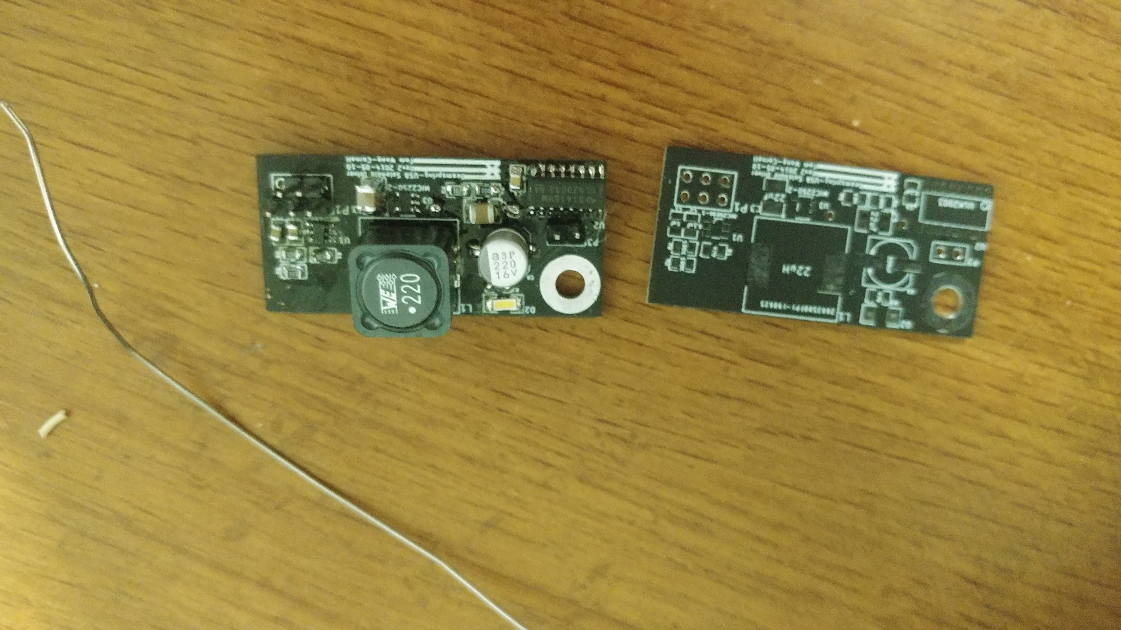

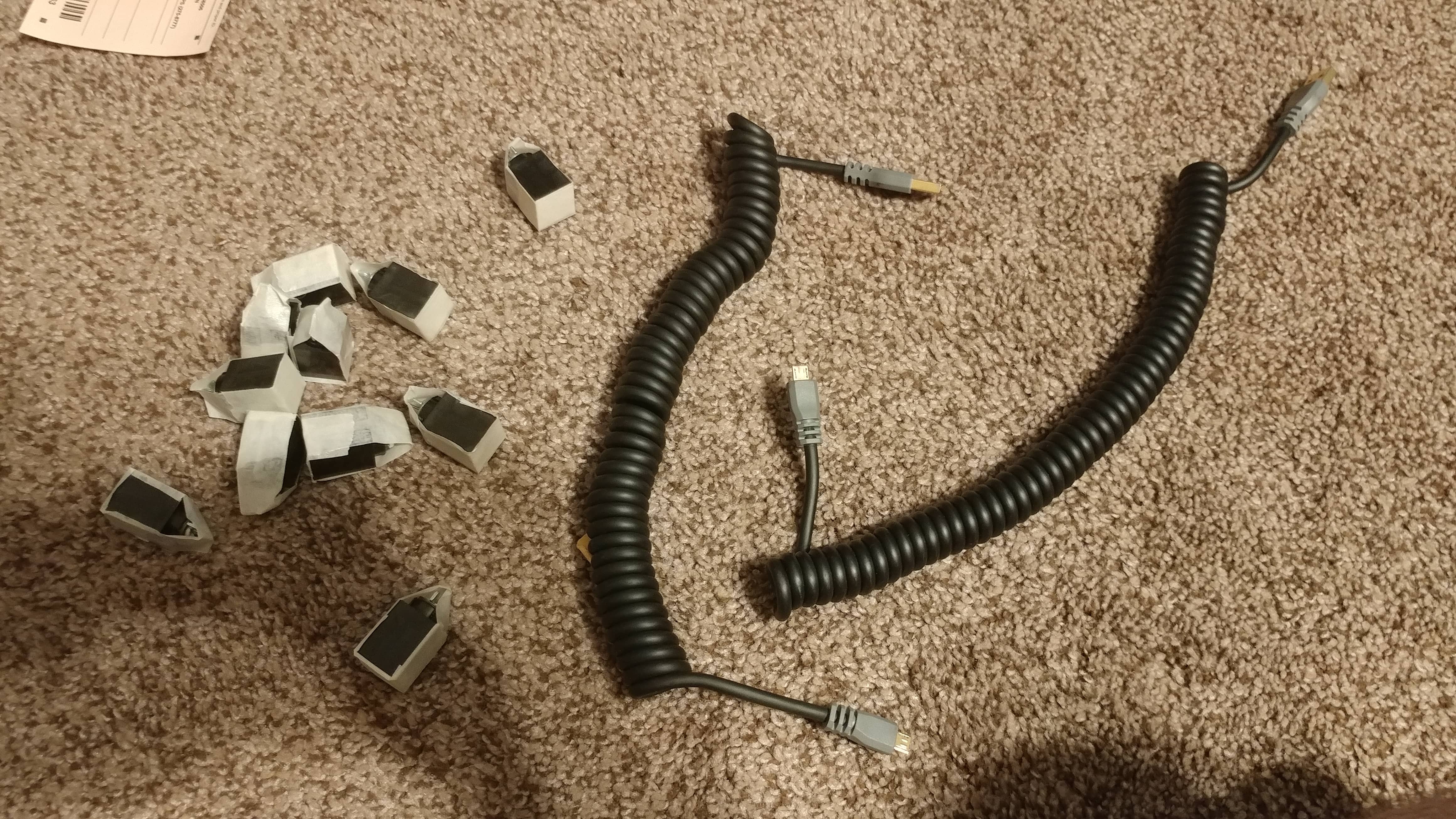

Updates: I have more parts! Everything I need to build/restore these (besides a couple of small components I need to repurchase after losing) have come in!
11 Beamspring modules, 2 thicc cables, and 3 solenoid driver PCBs.

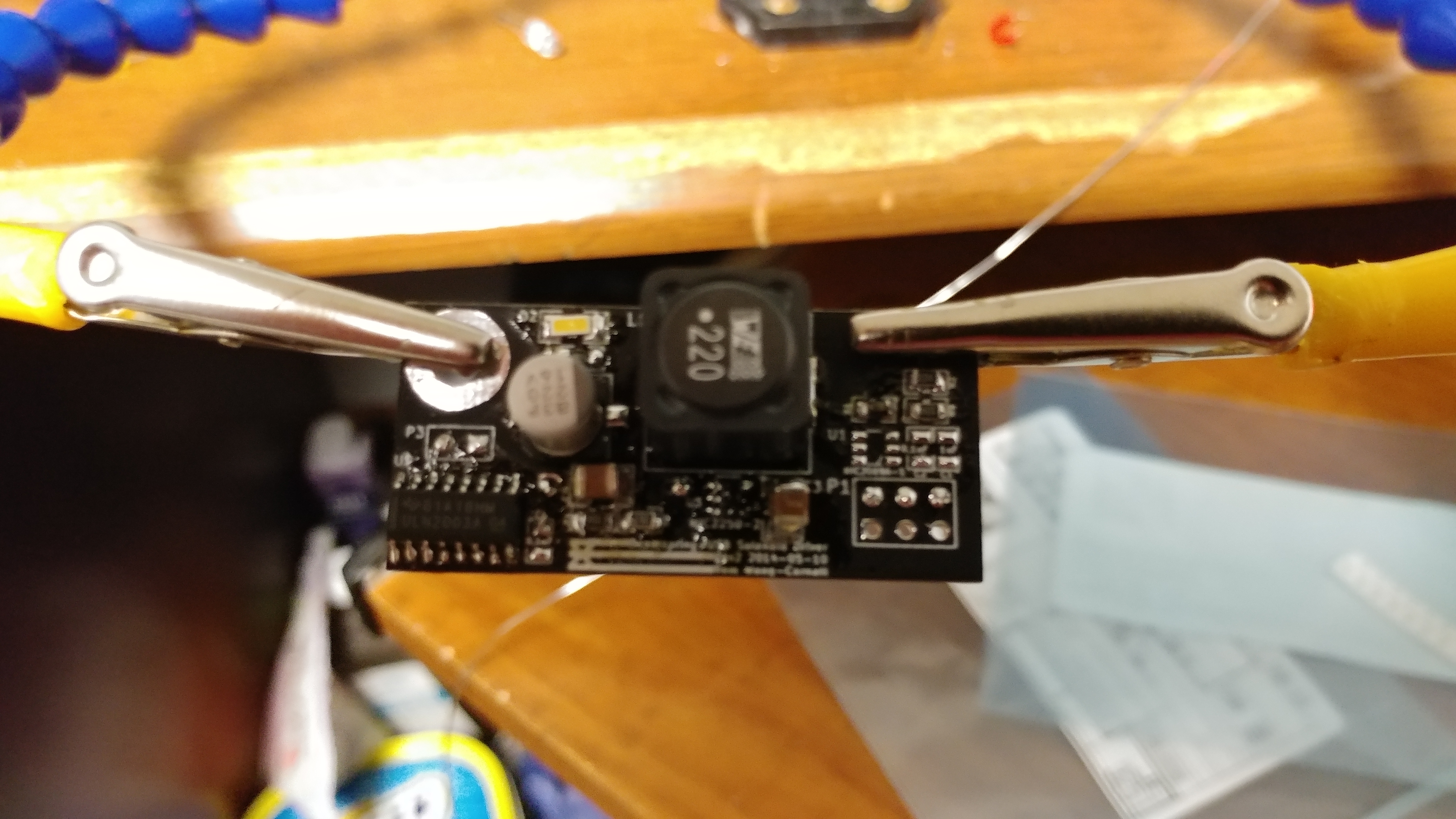

As you can see, I hand soldered one solenoid driver, still need to test. Will update when doing so.

Heyo, I have run into problems trying to get the solenoid working. It is unresponsive. I suspect it is to do with my soldering/component placement. Can I please get some high quality images of an assembled Xwhatsit solenoid driver board so I can see component orientation properly?

One of the best photos for this is this xwhatsit one.
Are you able to share a higher res photo of your board so we can see if you have any bridges/orientation? It is kind of hard to see what is going on due to blurriness
ZedTheMan
15 Sep 2019, 06:59
Heyo, thanks for the help SneakyRobb. I've resoldered a few components and replaced some others, but still no response from the driver. (It is getting 5v properly from the vcc, according to my multimeter, and the connections seem to be right as well).

Sorry for the lack of updates, I've done a few more things!
I physically restored a second one of them, (still need to solder and program controller), and I came up with a bypass for Xwhatsit solenoid adapters.
Get yourself a 9v battery, and a relay made for arduinos (make sure the switching threshold is low, within specs of the cypress max current draw.)
Used a hairdryer this time for removing the foam, a big help.
Forgot to take pictures of it before I started pulling metal stems.
