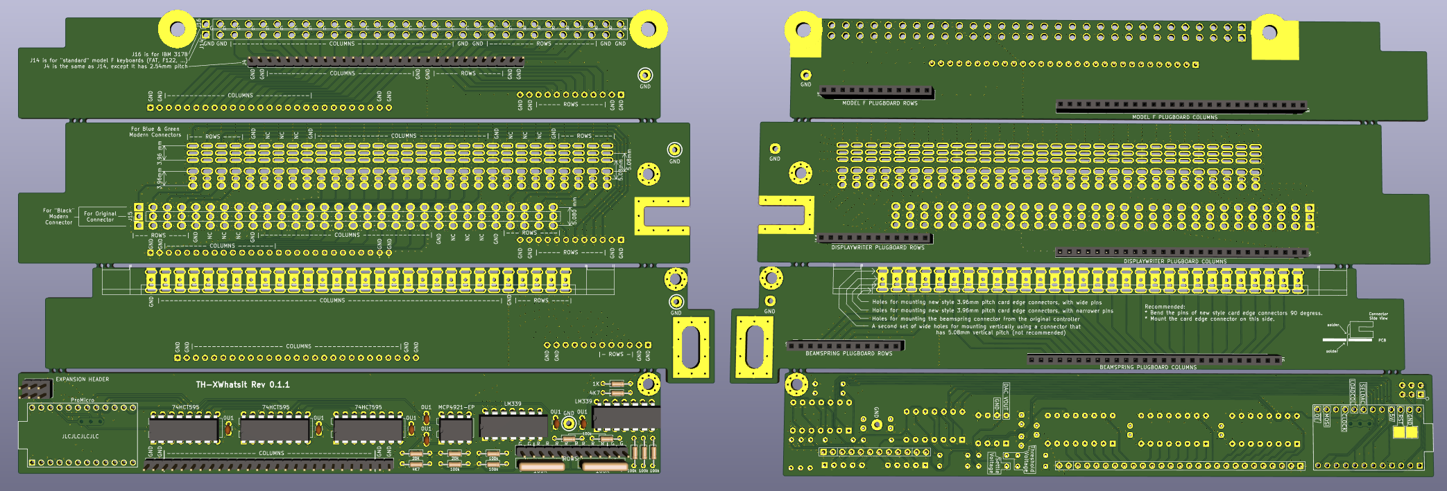

A few weeks ago I discussed this concept with user listofoptions and he is in the process of designing a through hole universal beamspring/model F controller.
Features:
1. Full compatibility with Beamspring Keyboards and Model F keyboards
2. Easy to hand solder components - all components require through hole soldering
3. Promicro as the "brain"
4. Fairly small form factor
5. Use of QMK firmware
6. Support for expansion header to wire up lock lights or solenoid
7. Optional plugboards for model F, Beamspring and Displaywriters (Purely optional, you can instead use jump cables to wire up the
controller
Link to GitHub https://github.com/listofoptions/TH-XWhatsIt
And the best of all, it will cost around 10 euros in components (including PCB and Promicro)

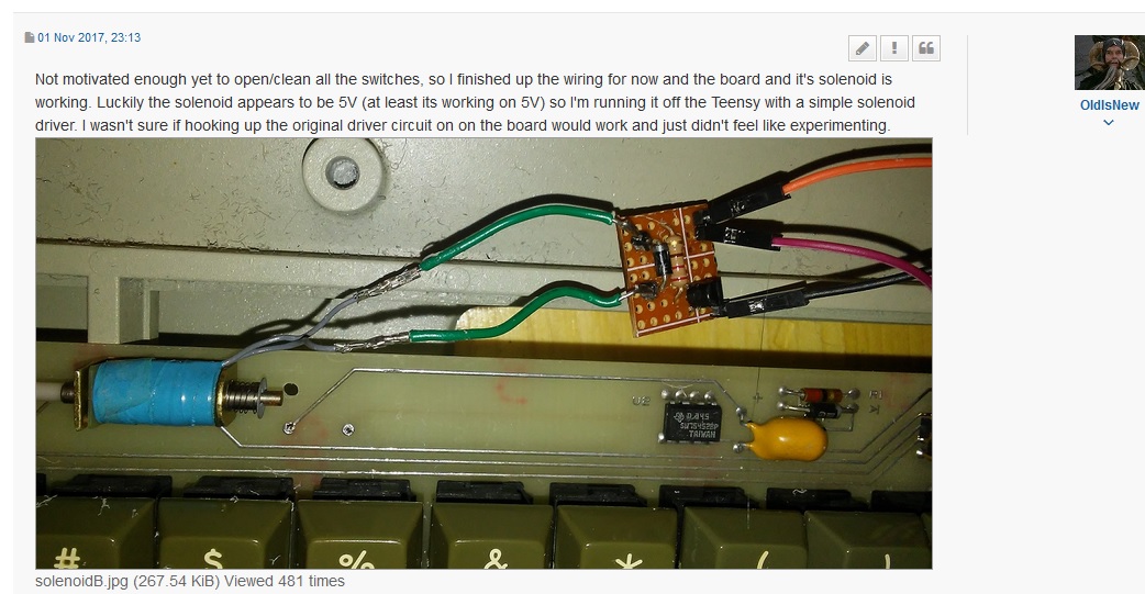

OldIsNew
09 Feb 2020, 23:57
kmnov2017 wrote: 09 Feb 2020, 22:53 A relay costs less than 1 eur and a DC DC Boost converter also costs about the same. So for just 2 euros in additional components you can drive a solenoid. If you buy a 5v solenoid, then you dont even need a boost converter - all you need is a 1 euro relay.
Yes it's pretty straight forward with a 5v solenoid - it just takes a simple circuit with one transistor, a diode and a resistor. Here's a pic of quick and dirty one i used for my Fluke 1720A board:
gravesdesk
10 Feb 2020, 13:58
Nice, would you provide a guide for building a solenoid driver and installing it to Model F XT, running by a pro micro soarer's converter and a New Model F77 (by Ellipse) running by an xwhatsit controller?
(I am not an electronics guru (a medical doctor actually) and I am having some help for soldering from the guys in medical device repair dept.)
Thanks.
zzxx53
12 Feb 2020, 00:25
gravesdesk wrote: 10 Feb 2020, 13:58 Nice, would you provide a guide for building a solenoid driver and installing it to Model F XT, running by a pro micro soarer's converter and a New Model F77 (by Ellipse) running by an xwhatsit controller?
Thanks.
Check out viewtopic.php?p=455535#p455535

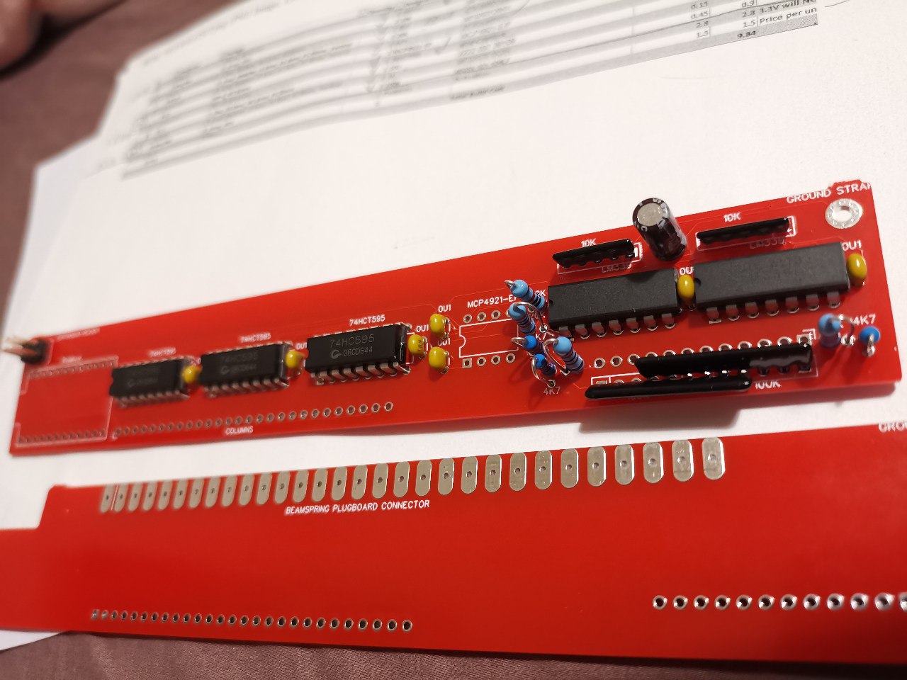

Hi All!
wanted to contribute here to this project since I think it's a great idea especially in conjunction with the porting of QMK to xwhatsit by pandrei.
Actually I would consider it the best and easiest candidate for everyone to approach the idea: TTH PCB and QMK firmware.

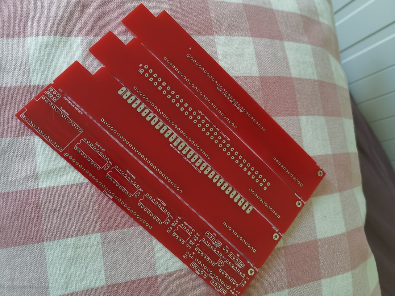

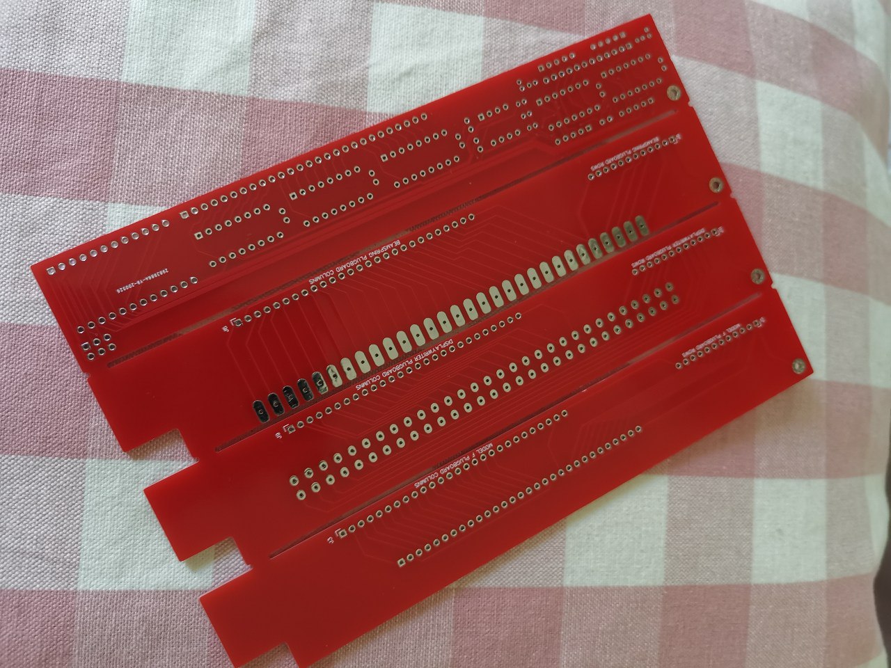

Here you can see the PCBs that I ordered from JLCPCB (arrived lightning fast):
So far my comments about the "1. Physical hardware testing" are:
- The place for resistors is too narrow, it's barely good for SMD resistors IMHO, even when using small sized resistors and putting them "upright"; this will cause most probably that the components will touch the riser plugboard. I'd plan more space for the resistors, this will be also easier for newbie solderers.. :)
- The "ROWS" pins are moved above the 100K resistors, I would have kept them like in the PCB picture in the first post.
- Also the 10uF capacitor is most likely too tall to be compatible with the plugboard, I would program space for it to be installable as "lied down".
- The 100nF capacitor located between the two LM339 is too squeezed, needs a few mm more clearance.
So currently I'm considering to install the plugboard on the backside instead for the above reasons.
But I also have a couple of questions:
- What is the reason to chose the MCP4921 DAC instead of the original 101xxx DAC that is used in xwhatsit? I think this one is more expensive and would need to imlpement a new/different protocol in the xwhatsit FW to cope with the change, but maybe there's a good reason?
- Similar question about the usage of different pins on the pro-micro if compared to the xwhatsit, but this is less of an issue to change/adapt in the xwhatsit FW of course
- I was also thinking about the 10 and 100 K resistor networks in SIP-5 format: what is the advantage a part from space? I think just using normal resistors for this is maybe easier for people to source components. Yes I had rather difficulties to source SIP-5 networks as you can see here:
- Is there a reason the traces are so thin?
- I still have to test the BS connector pad holes if they are compatible with the connector and see if diameter is ok and if the vias connect layer 1 to layer 2 for rows and cols
Other than this I updated the BOM and GERBERS on GIT for @listofoptions to check then others can also have a run in case.
That's all my comments and questions so far, for the rest I will proceed now with soldering and with working with pandrei to adapt QMK and start the FW testing then. Will report back when ready.
Kr,
tent:wq
kmnov2017
03 Jun 2020, 23:33
A few answers:
-the original xwhatsit DAC is an SMD package and we had to find a cheap through hole component
-pro micro uses a different chip than xwhatsit. The pins are different.
-when the initial components were drawn up we checked mouser, digikey and Farnell. They had all the components.
