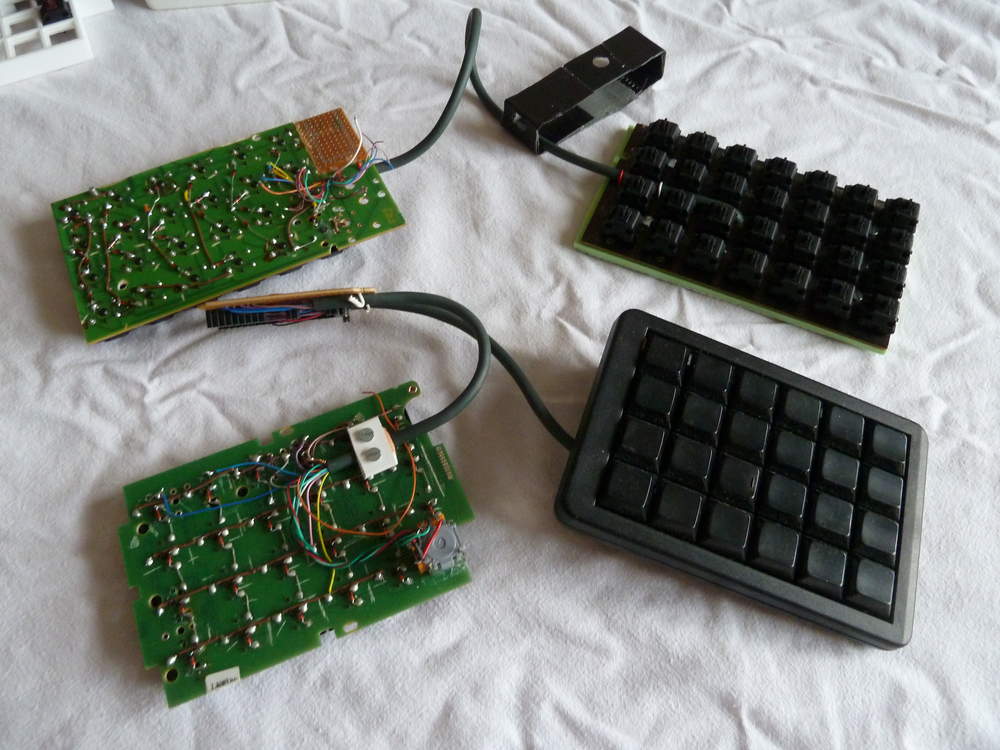

I started with two Numpads and Cherry ML switches. While I found them much better than their reputation around here had suggested, I longed for real MX keys. And the rather thick frame made using the thumbs a little awkward, but having thumbbuttons at all and especially a split keyboard was already a great improvement. Also, an analog joystick as mouse replacement did not work out for me, but by now I had bought some IBM trackpoints from old laptops I intended to use.
A second approach with sawn-off num-blocks from old some cherry keyboards with MX-blacks satisfied my tactile expectations much better, and it also turned out to be most comfortable if I tented the boards rather steeply around 45 degrees.
split numpads
split numpads

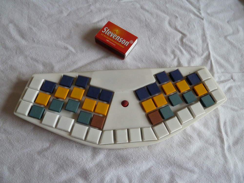

At this point, the announcement of the Truly Ergonomic had raised my interest - could having just an increased separation between both hands, paired with an angle and their column arrangement result in a equally comfortable typing? Also, carrying around the two parts connected by cable wasn't always as convenient, so I decided to design my own TE. Once again with MLs, it turned out to be quite nice - but I had taken measurements from a laptop keyboard and further shrinked the distance between the keys so I could build the casing in one part. Too small to type on for a longer time with the flat keycaps I had sintered, but a nice integrated trackpoint made it my daily driver for a few months.
ML wing-style keyboard

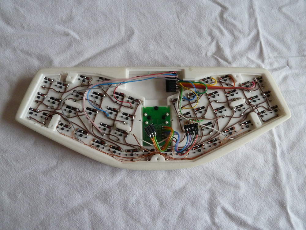

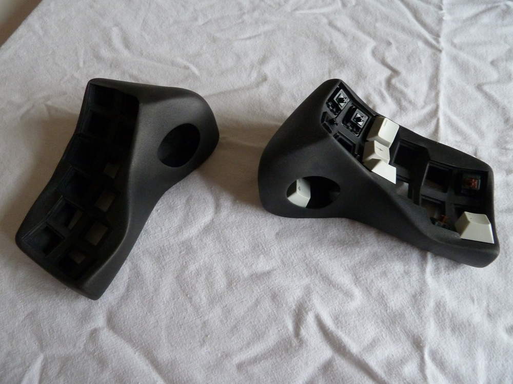

If you wondered about the case: It is laser-sintered after a custom design I created in blender, and thanks to working for one of the major manufacturers of laser-sintering machines I was able to test several versions without producing too much garbage, and also could get in-house consulting on design specialities. But with readily available services like Shapeways this technology is a viable alternative for anyone to produce individual parts for custom projects within a reasonable budget and incredible timeframe.

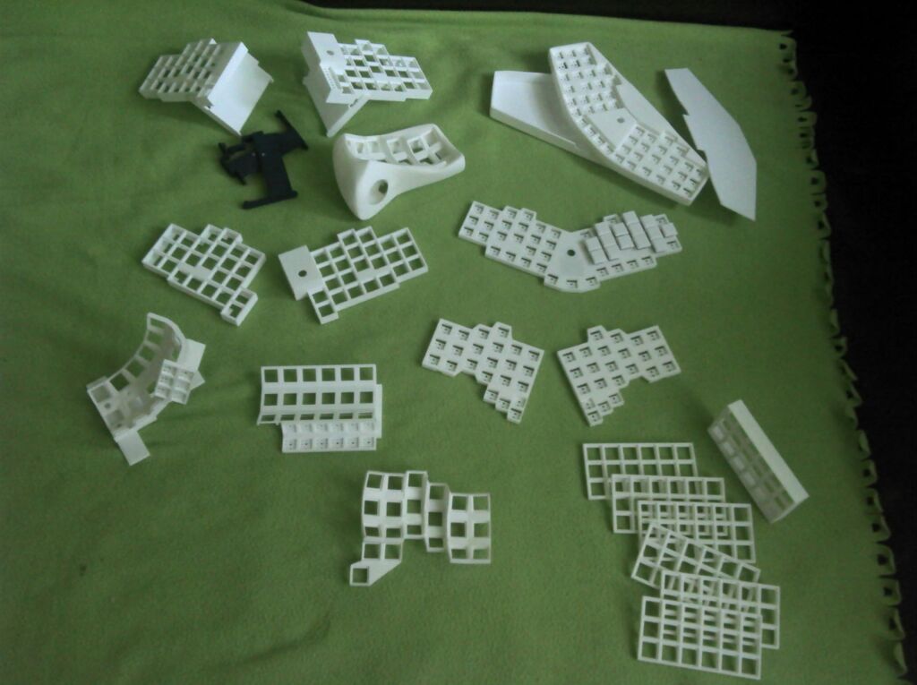

To further leverage some advantages of this technology, curved or bowl-shaped frames were designed: The straight approach wasn't as comfortable as I thought, and when my smoothed design with datahand-like thumb crevice was done I wasn't able to get any small teensy controllers (damn PS3 hackers) - by now I have one again and I intend to finish that promising arrangement sometime, but as my latest design fits me so well I don't know when that will be...
3D with straight rows

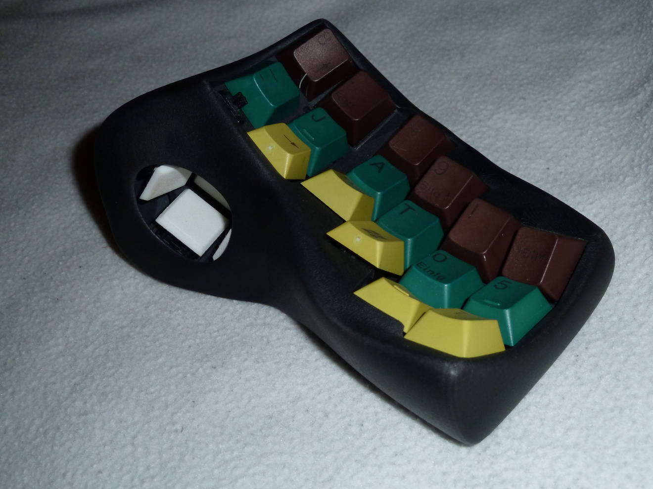

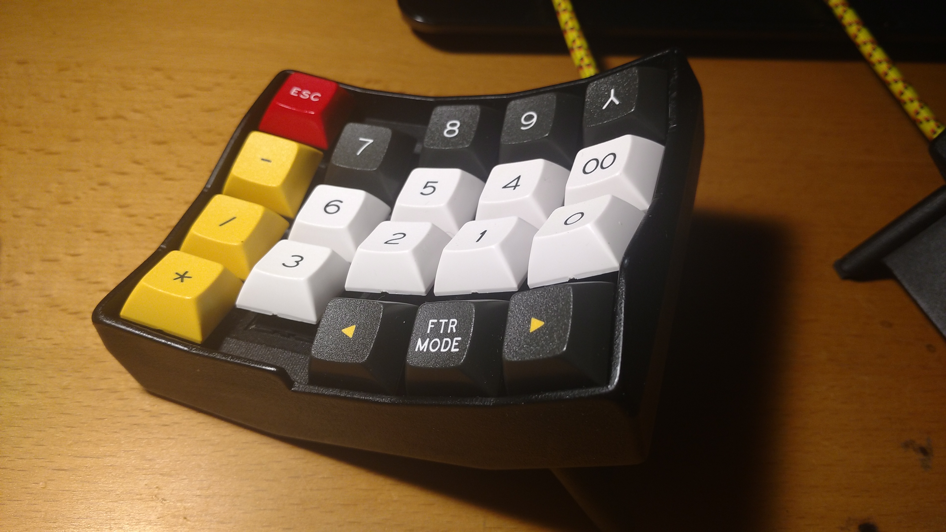

Datahand thumb meets maltron bowl

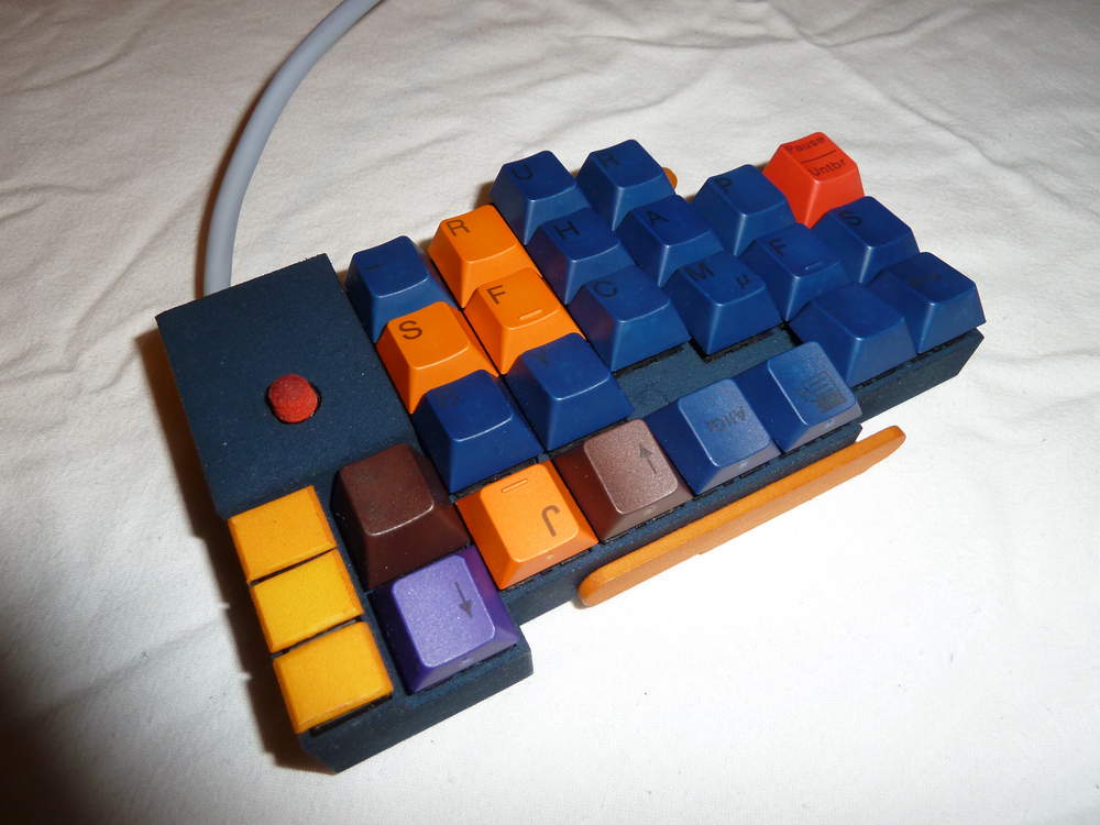

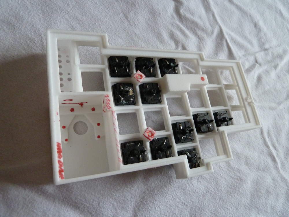

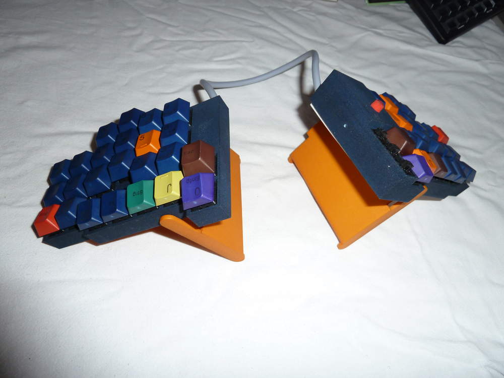

So I went back to a more minimalistic approach once again, and finally also created the missing pieces like a foldable stand, integrated trackpoint and teensy housing. When a recent thread here promised dylon dyes to be a possible colouring option I finally put up all the finishing touches (no, the colours are still WIP, will probably settle for blue with orange accents - and don't get confused about the letters, they don't mean anything, just fit by their shape in the row used...)
Prototype frame
Prototype frame

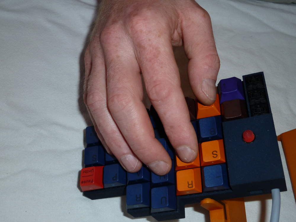

BlueCube tilted in normal position
BlueCube individually fit
BlueCube laying flat
BlueCube inside view

Super cool! How do the different forms compare with more regular keyboards?
Are the switches mounted or fastened in any other way than with the small clips?

Minskleip wrote:Super cool! How do the different forms compare with more regular keyboards?
Thanks - I am not sure I understand what you want to know exactly, but in my opinion having the flexibilty of a split keyboard is probably the most important difference as separation and tenting angle can be adjusted to individual preferences. Having thumb buttons is another great enhancement, and I also like the straight columns much better as they lead to a symmetric arrangement. From what I read in the newsgroup of AdNW others also were very content with improvements of the TECK in this regard.
No, the MLs are press-fitted very slightly into a square frame and held by their pins, too, while all my MX designs hold their switches by the sintered frame that functions as a kind of plate-mount. As the plastic structures between key-cutouts are a little flexible in my setup, this holds the keys firmly enough to be able to pull the caps without ripping out a key, but pressing a little stronger from below ejects the switch.

EDIT: I just uploaded my latest design (the BlueCube one) and it turns out to be around 50€ for all necessary parts, but without any optimization on parts arrangement and volume.
off wrote:And now I look again at the datahand/maltron/oven; it seems to me like it might be too tight to fit another switch pointing downwards from the top of that thumbwell, looks like it would interfere with the switch on the top side (one for the fingers).. but very creative&promising nonetheless.
Very well spotted, one extra point for this keen observation - and you're right, indeed: The fourth switch points backward (and is thus the least desirable to use) and the design mandates custom keycaps and switches pre-wired prior to insertion.

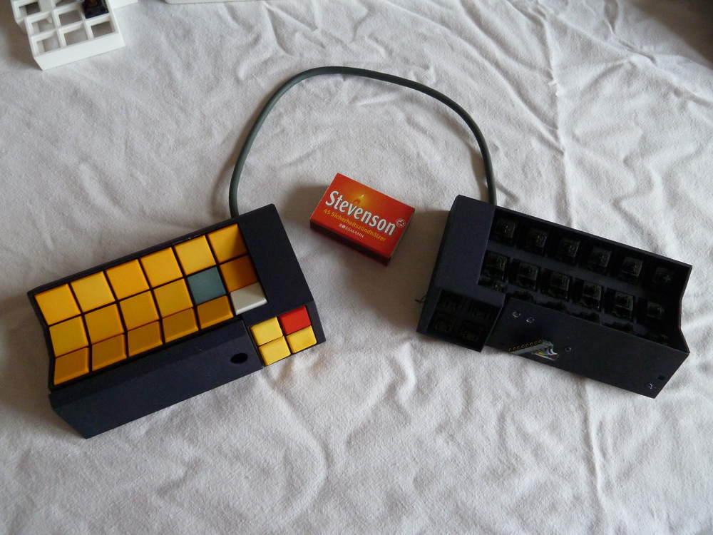

Setup with mainly standard caps
Very little space inside, but just enough...

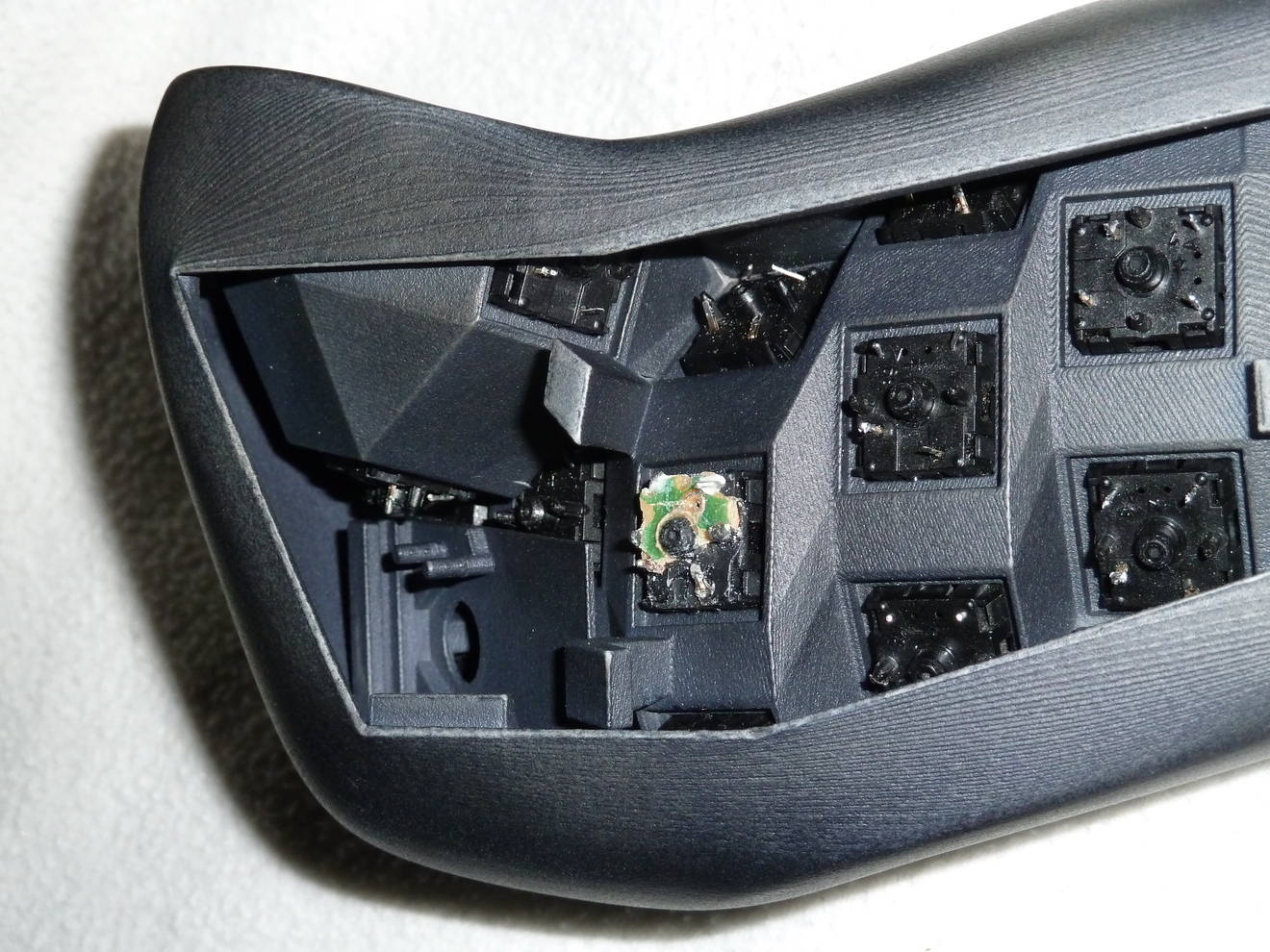

Looking at that last pic, that material really looks nice, mesmerizing patterns in the 'fabric like structure';
big difference between the inside and outside of that shell, is that due to the tumbling or purely the lasering?
I'm guessing the second due to the difference in physical shape of the walls (more geometrical vs natural), but that's a blind guess.
Speaking of which, I suddenly realise that the walls you've utilised are very thin in comparison to for example the 'Humble Hacker' keyboard, this seems like 2 milimeter.. This is getting me very curious to the physical properties, does it flex much or is that, although there, mostly countered by the reinforcing nature of the shape?
Whichever it is, seeing such thin walls migh mean that a Shapeways sollution coud turn out decently 'cheap'; I would very much appreciate it if you'd get a quote on either of your designs, do make sure you don't 'sign over' the design rights or somesuch to them in the process ;)

off wrote:... mesmerizing patterns in the 'fabric like structure', big difference between the inside and outside of that shell, is that due to the tumbling or purely the lasering?
And spot on! As the shapes are sintered in layers of 0.1mm thickness, what you correctly identified are the "stairs" approximating any not completely vertical face, and at the regular square shapes inside this leads to symmetric step sizes, while the natural curves on the outside with their variety of angles are only approximated with irregular widths.

I find it surprising that you went from bowl shaped (like Maltron and Kinesis) to a hm...do we have a word for this yet?
Let's just call it a ball shape.
So what gave you the idea to do that and how does it feel in comparison.

The main reason I ended up finalizing the flat halves was that it offers more flexibilty with tenting, compared with the bowl shapes - I still assume that the latter could be even better from an ergonomic standpoint as it minimizes finger movements further, but since the geometry is fixed any design error or wrong assumption on tenting angle or key placement will not be as easily correctable as with my current stand. In addition, as the frames are only about 14mm high production is cheaper, and the final keyboard assembly also less clumsy to carry around on a daily basis.
And after several weeks of usage the flat sides feel as natural as I ever wanted, so I guess the bowl shape might not be that much better after all.

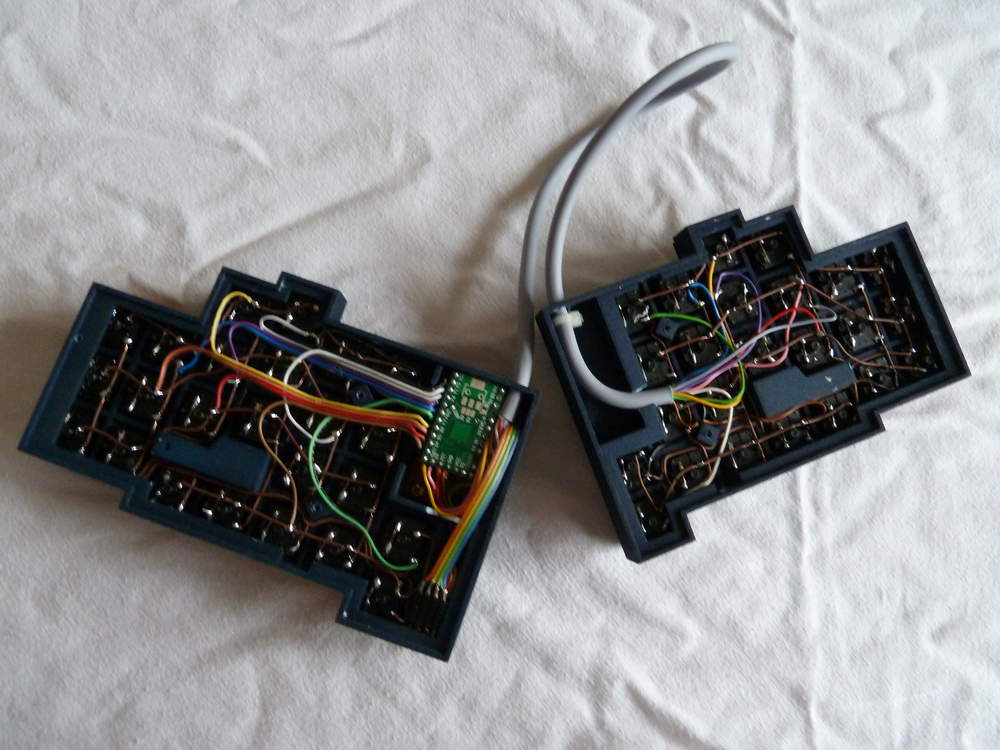

And yes, the connection was a tricky decision: I settled for a fixed 10 wire cable as I found out the variation I wanted would be little enough so I would not need to change it later on. For maximum flexibility I will try to get the current 6x4 Matrix hooked up via a shift register so I can use simple USB cables and connectors in an improved version. Or go with USB-3 or even HDMI plugs...

- Design your own mounting plate layout with any CAD-software or even Blender: For MX switches, 14x14mm² square holes in 1.5mmn thick plate fits fine. If you are getting funky in all 3 dimensions, you should simulate the keycaps also as not to get lockups on them later on.
- Integrating a case is tricky without having tested your initial design, if confident in your skills do it, otherwise delay it until later.
- Export your design in a format understood by Shapeways or any other 3D-printing service and wait until the order arrives
- In the meantime, order any of the USB-controllers tested by other fellow hackers and test if an existing library already serves your needs - humblehackers was the one I initially used, then rolled my own and by now would probably check out tmk_keyboard, which looks very mature and flexible.
- Hardware-wise, if you know how to solder and have the equipment only diodes and switches from a donor board are needed
- Put together a boring matrix, program, enjoy - see, it is that easy :mrgreen: !

Icarium wrote:How are you going to use a USB cable for the connection? I thought about that but even with shift registers you will need 4 connections for the rows, 2 for power supply and 2 for feeding the shift register. Am I missing something?
You're right - I was thinking about an IO-Port expander using the SPI protokol. I ordered a MCP 23S17 lately and will see how that goes - at least that'll be a project that should keep my workspace clean and tidy and not turn into that battlefield of tools it has become recently ;)
dox
26 Apr 2012, 18:24
Very cool projects suka! I love the look of the "datahand thumb meets maltron bowl" and the other ones too!
You may want to look into I²C for the communication between the 2 halves. ic07 on geekhack have developed the firmware that will be used for the ergoDox with a MCP23018 and from the testing I did it looks quite good!

Here are some prototypes I have built in the last two years that I am willing to share with interested parties. While some parts will not be usable for anything but informational purposes some goodies I'd like to give away include a completely finished wing case plus cover and a copy of my final split design - these should preferably go to either people that I was able to base my work on or seriously determined folks that actually want to use them.
For the remainder I can setup a Tryout Package that gets re-mailed around this group, or sent individual pieces, preferably to Germany or Europe... Hope this thread is not getting flooded now, please hold back otherwise until details settle :grin:
