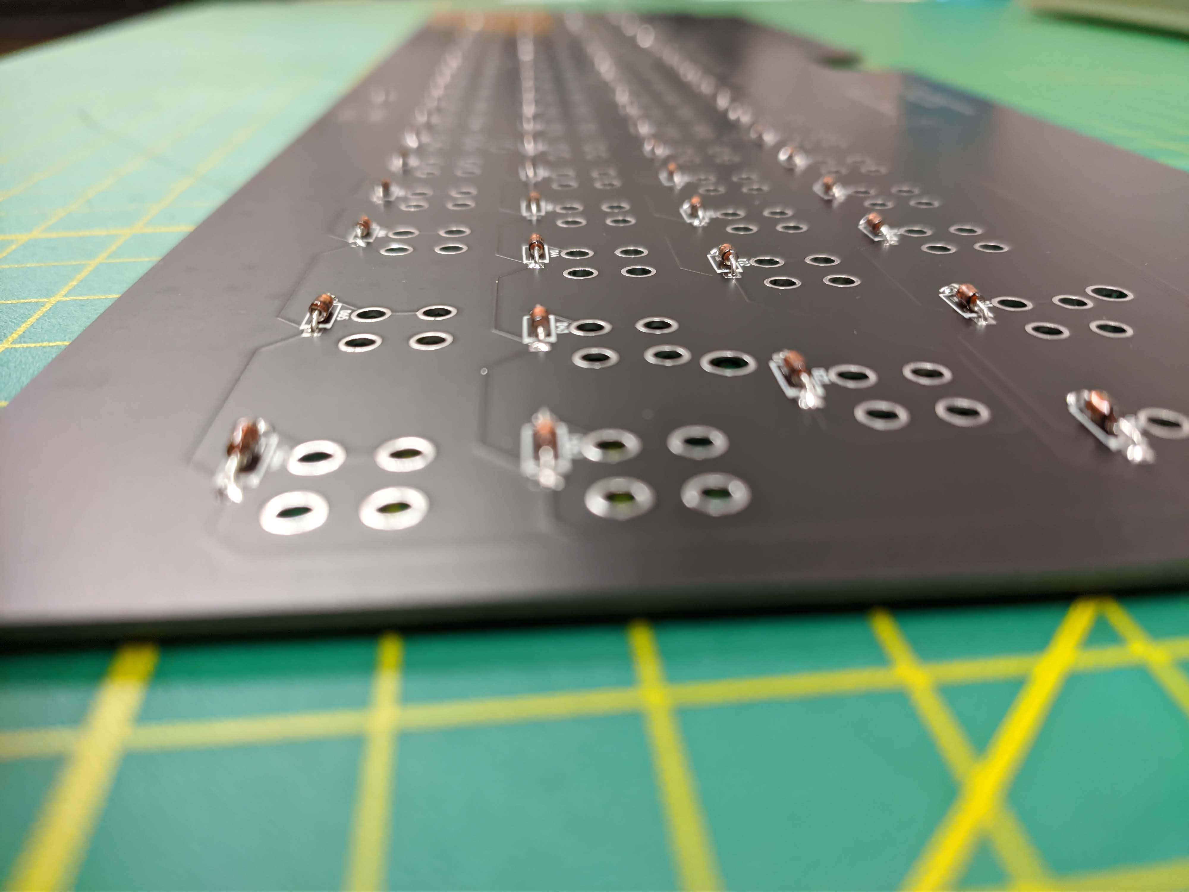

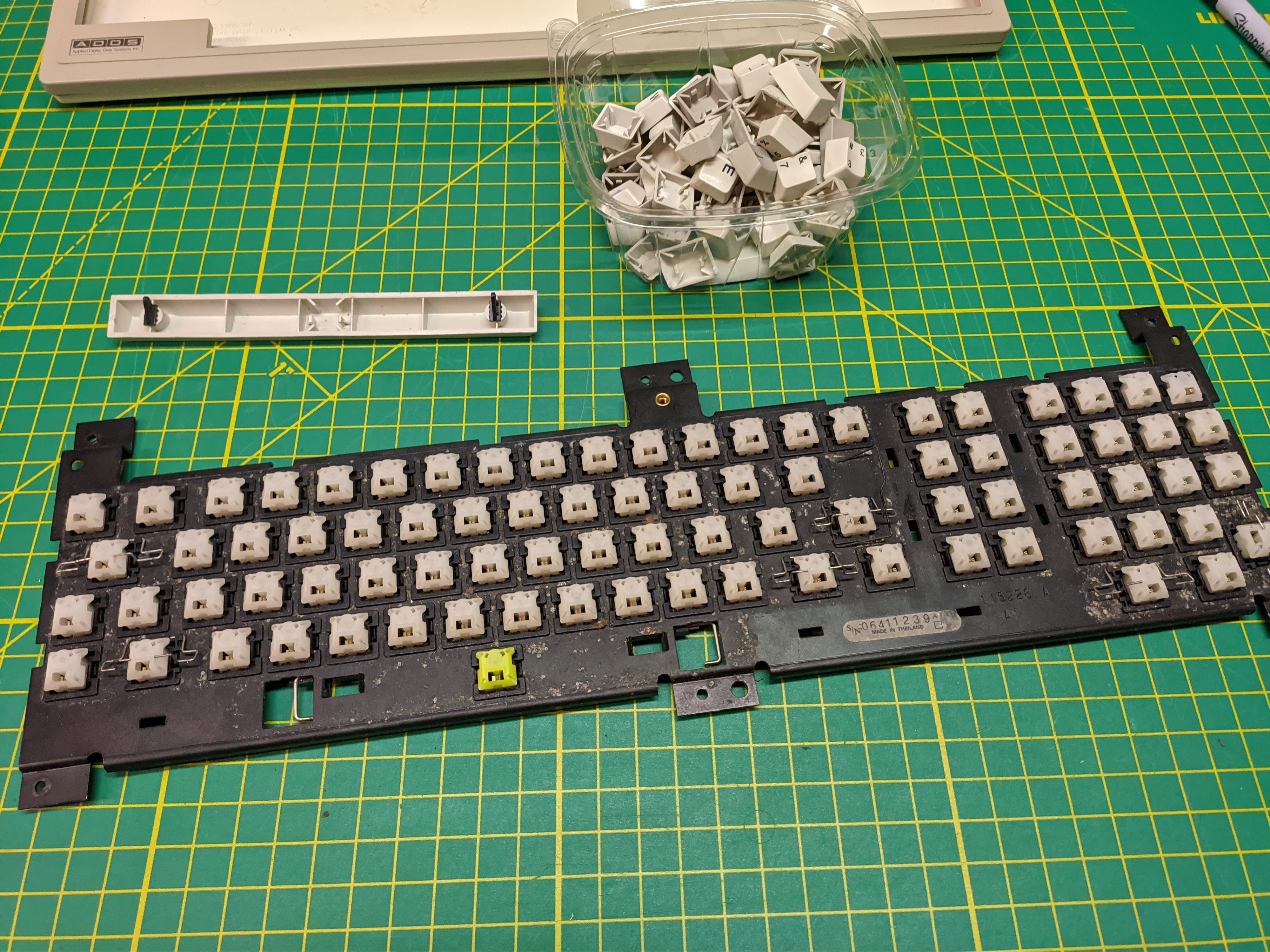

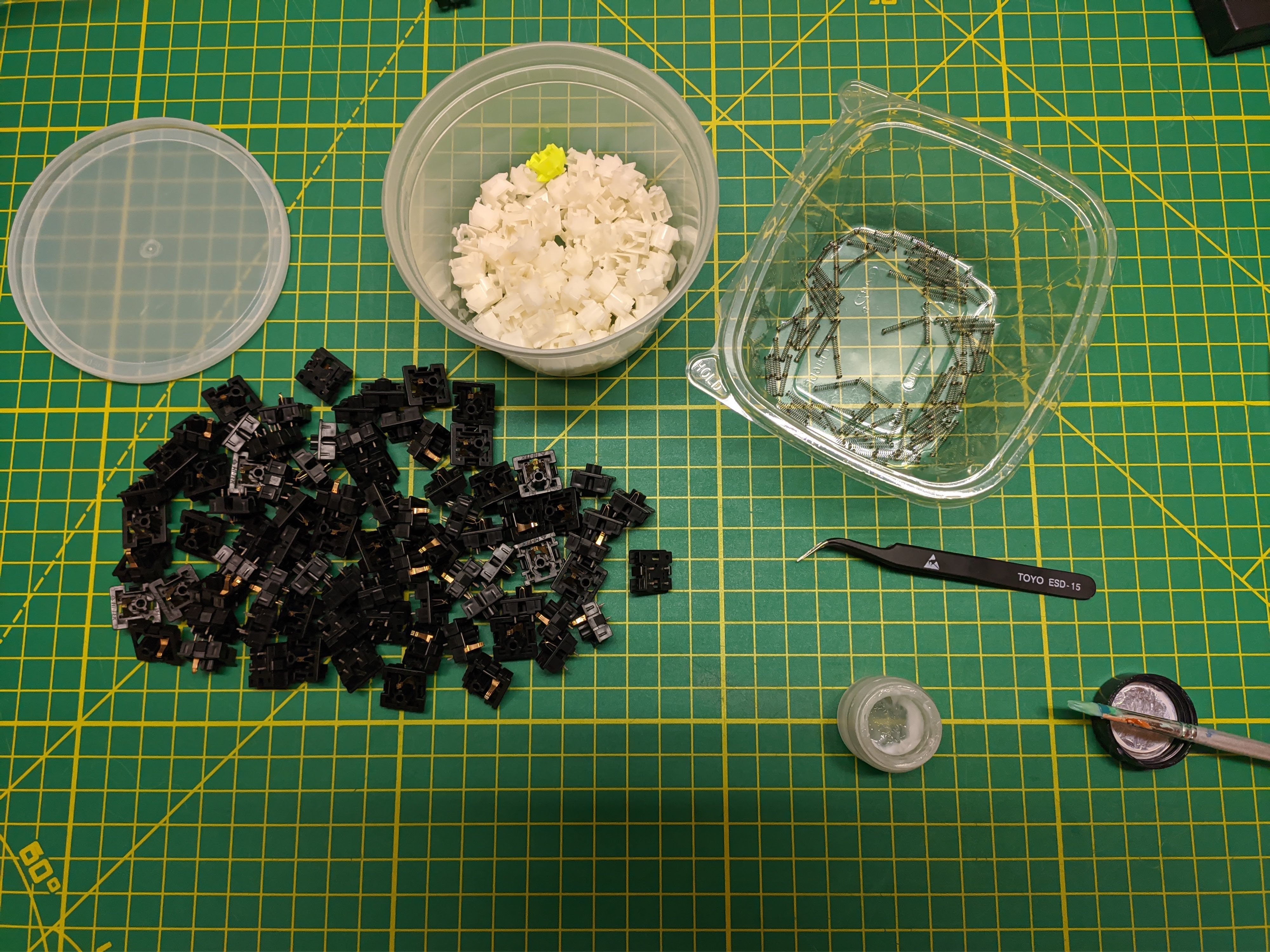

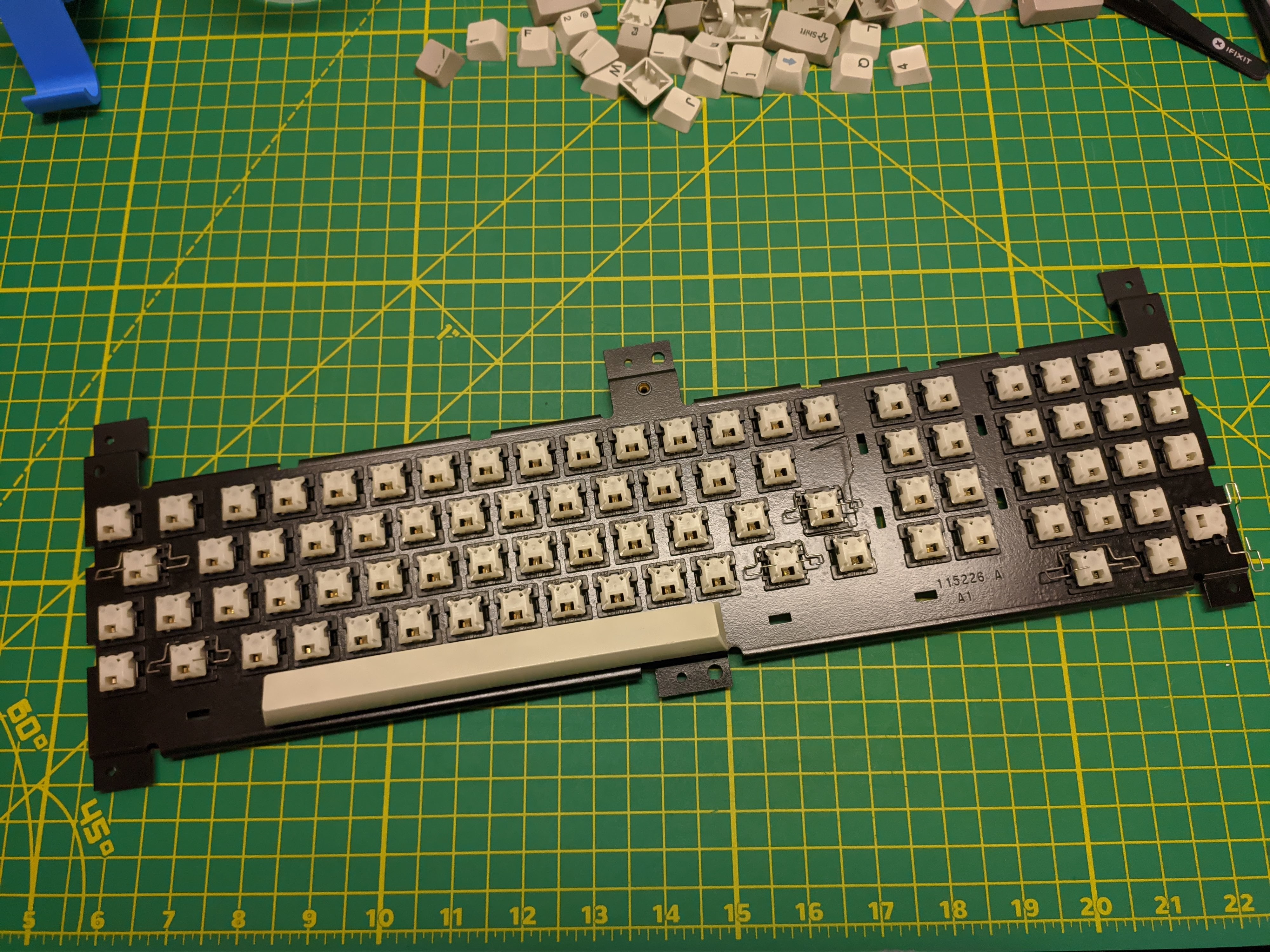

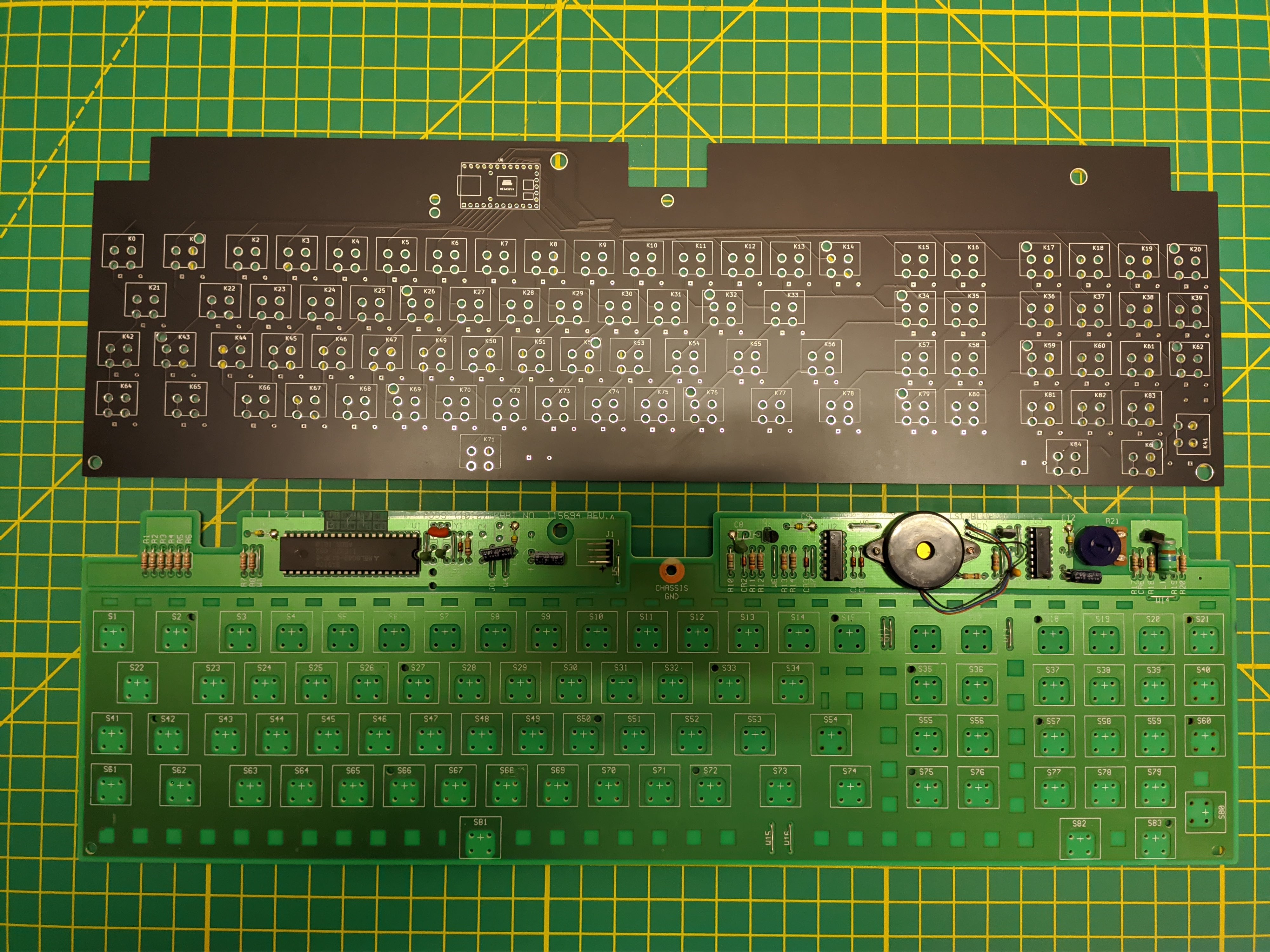

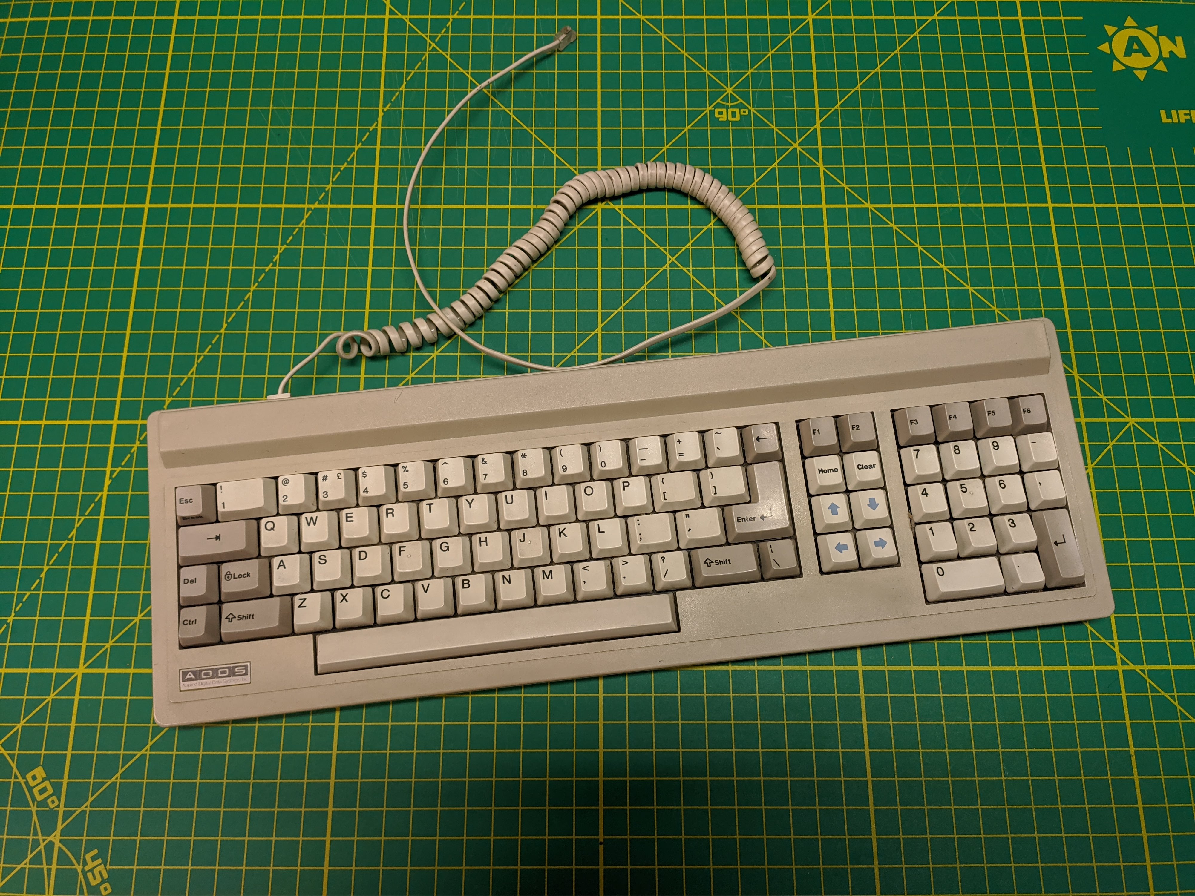

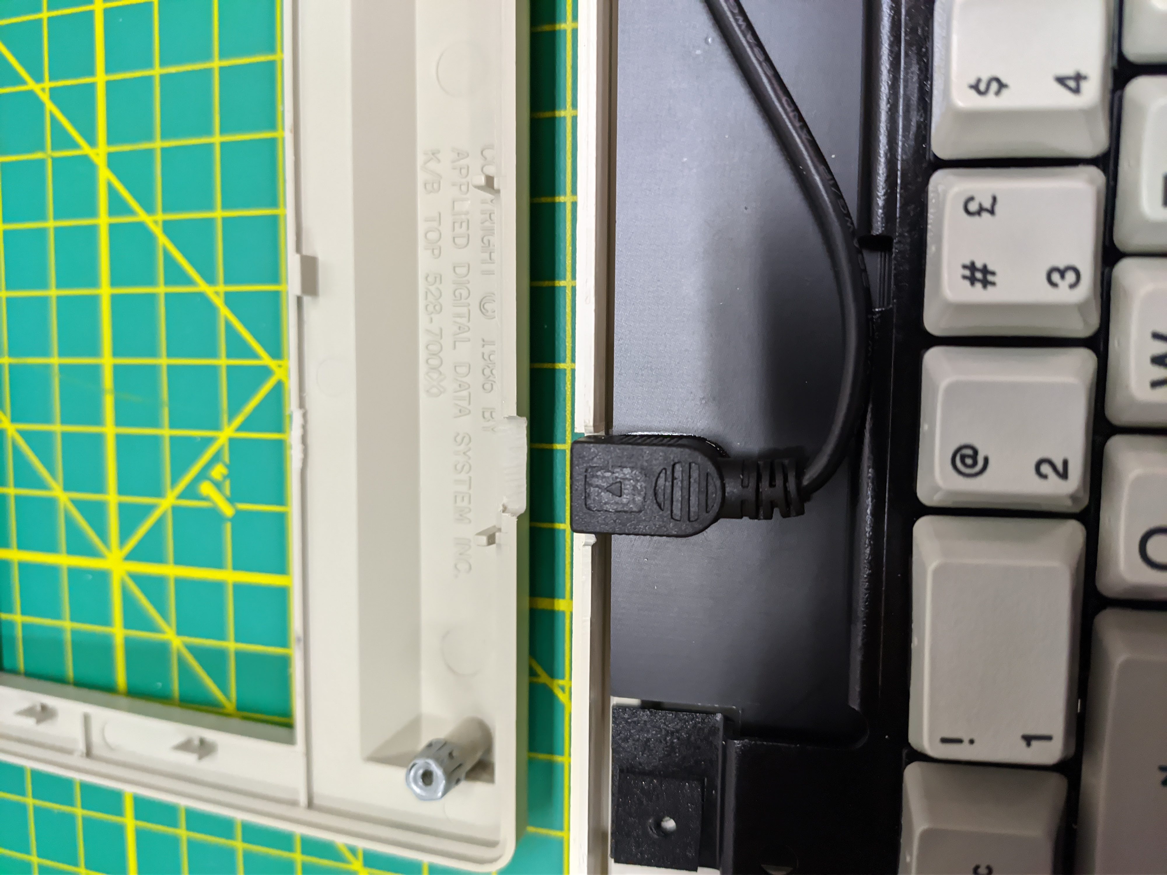

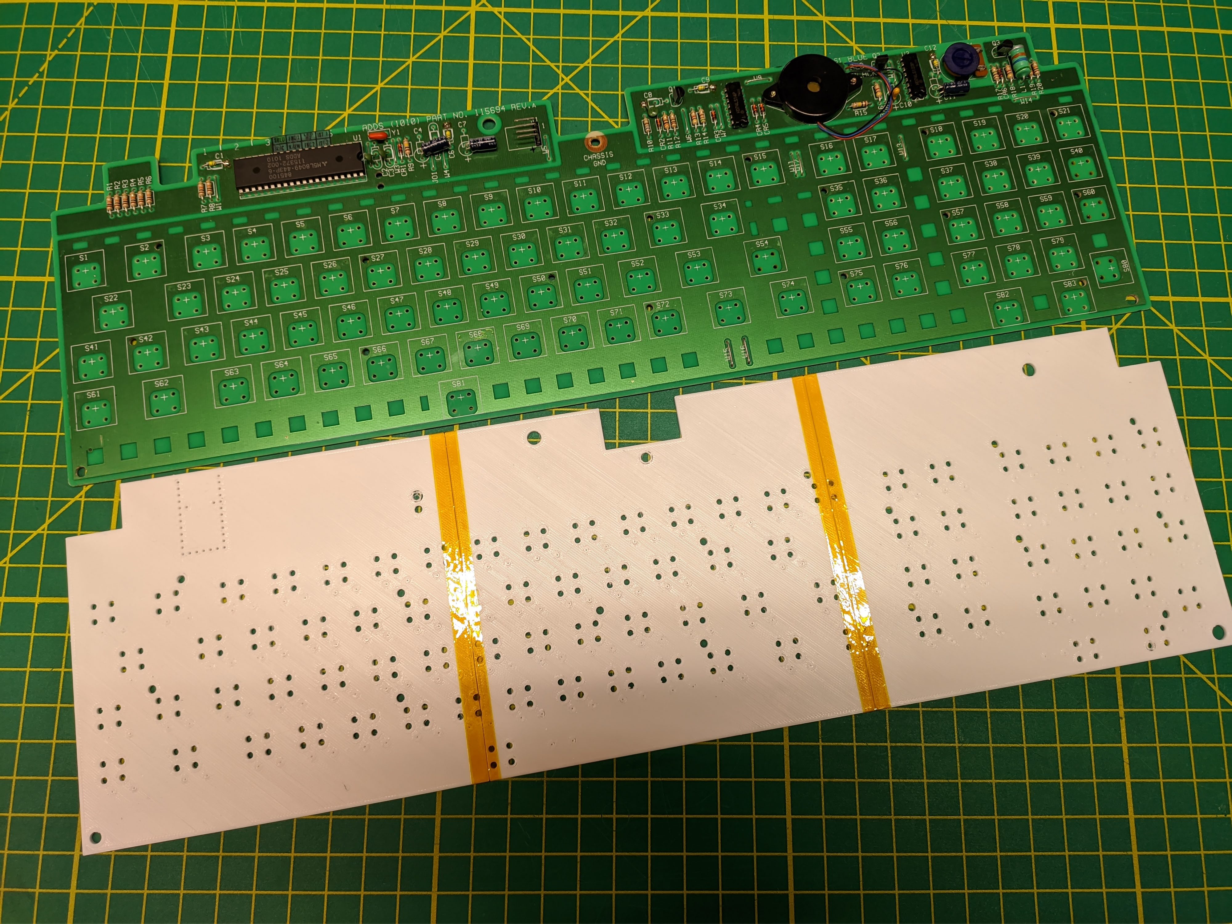

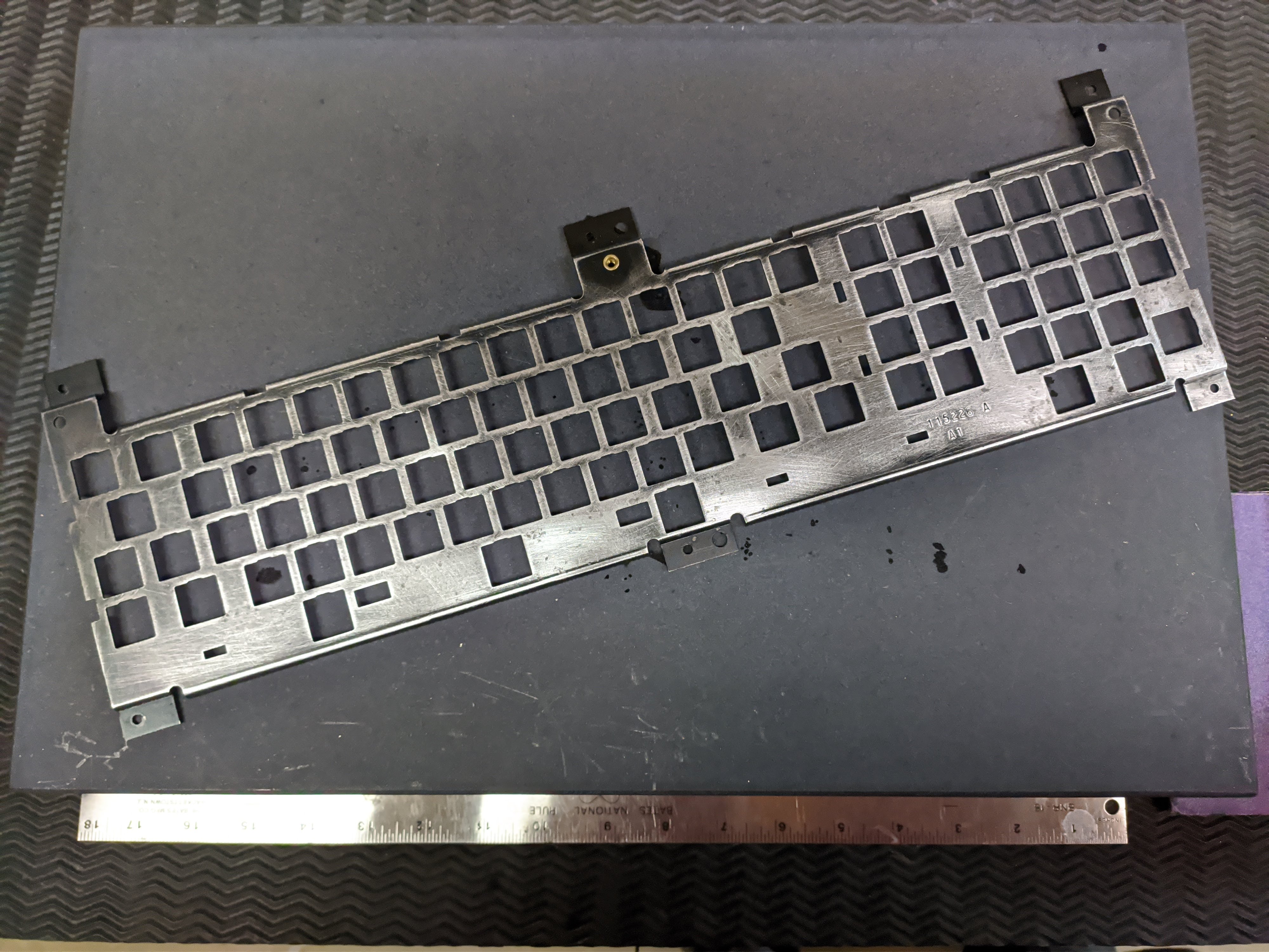

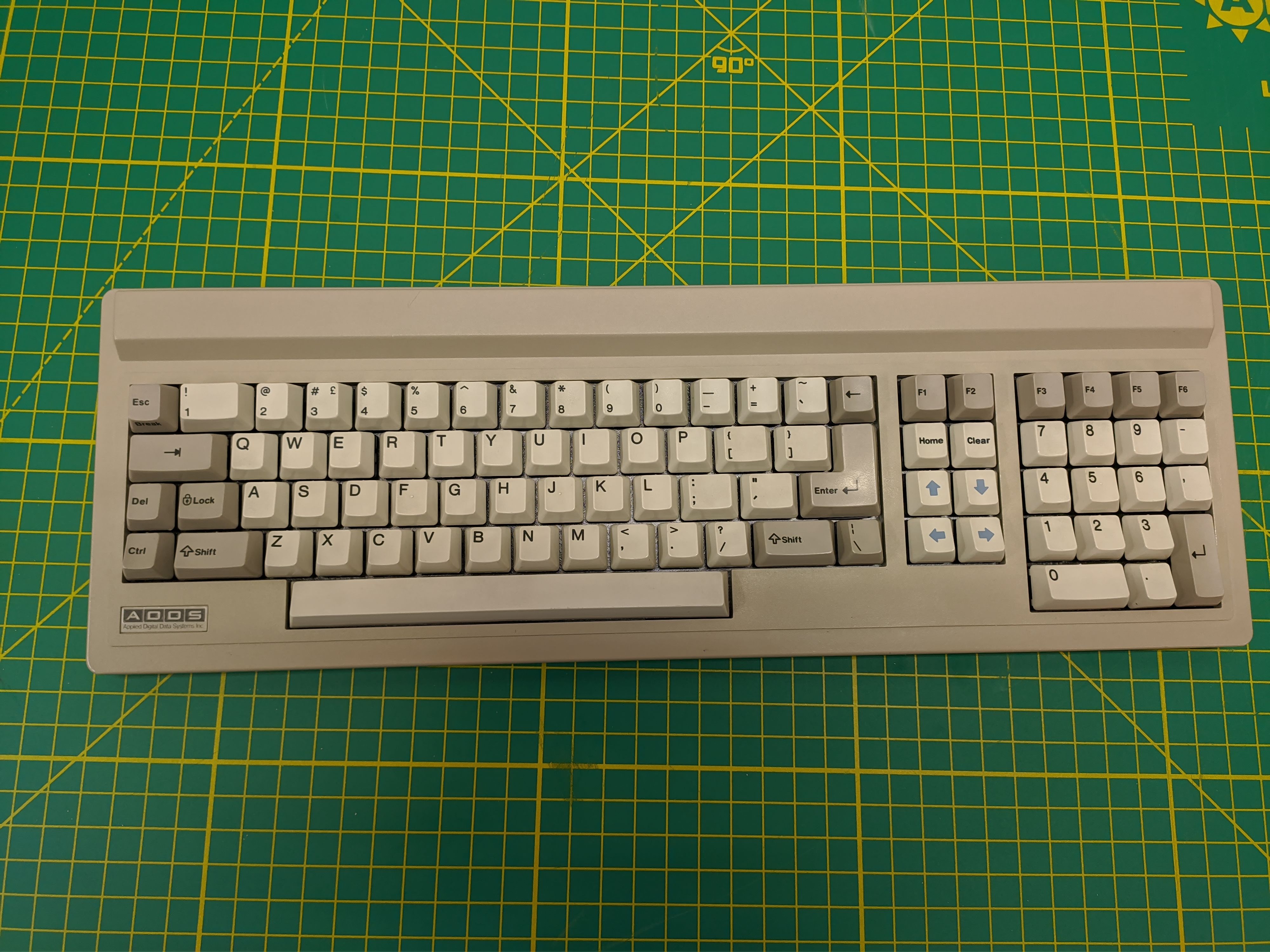

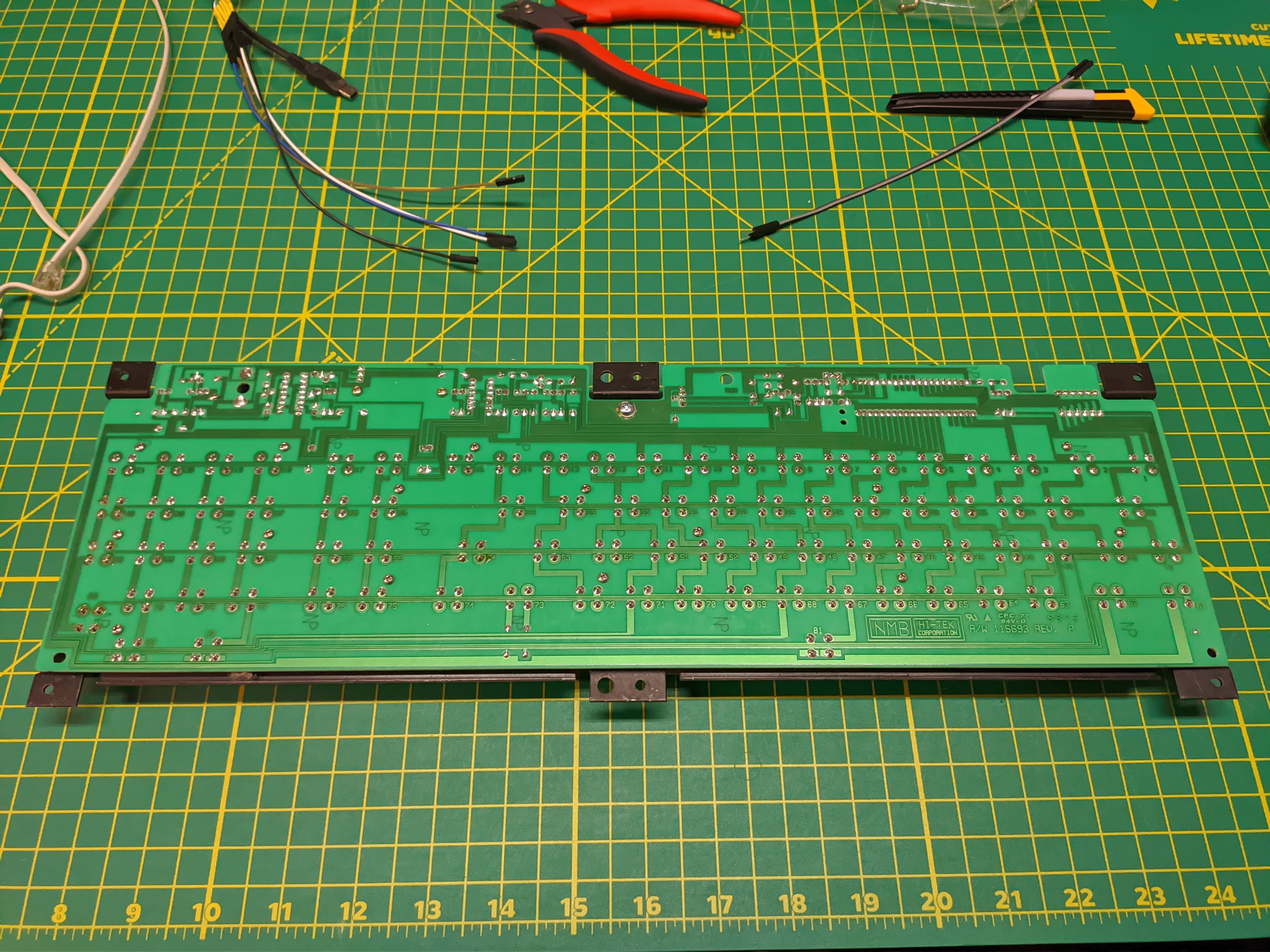

I picked up an ADDS 1010 terminal keyboard sporting some nice PBT caps and linear Space Invaders. Unfortunately it uses an alien protocol which I've had no luck figuring out. Since the PCB was only 2KRO at best I went the route of a full PCB replacement. In case it's of use to anybody, I wrote down my process throughout this project. Feel free to suggest changes since I'm no expert and I'm sure there's areas I can improve.
Guide (PDF): https://github.com/jsheradin/adds1010/b ... ide_v0.pdf
Project files: https://github.com/jsheradin/adds1010
Eye candy:
I have a few extra PCBs thanks to the minimum order quantity so PM me if you want one.
