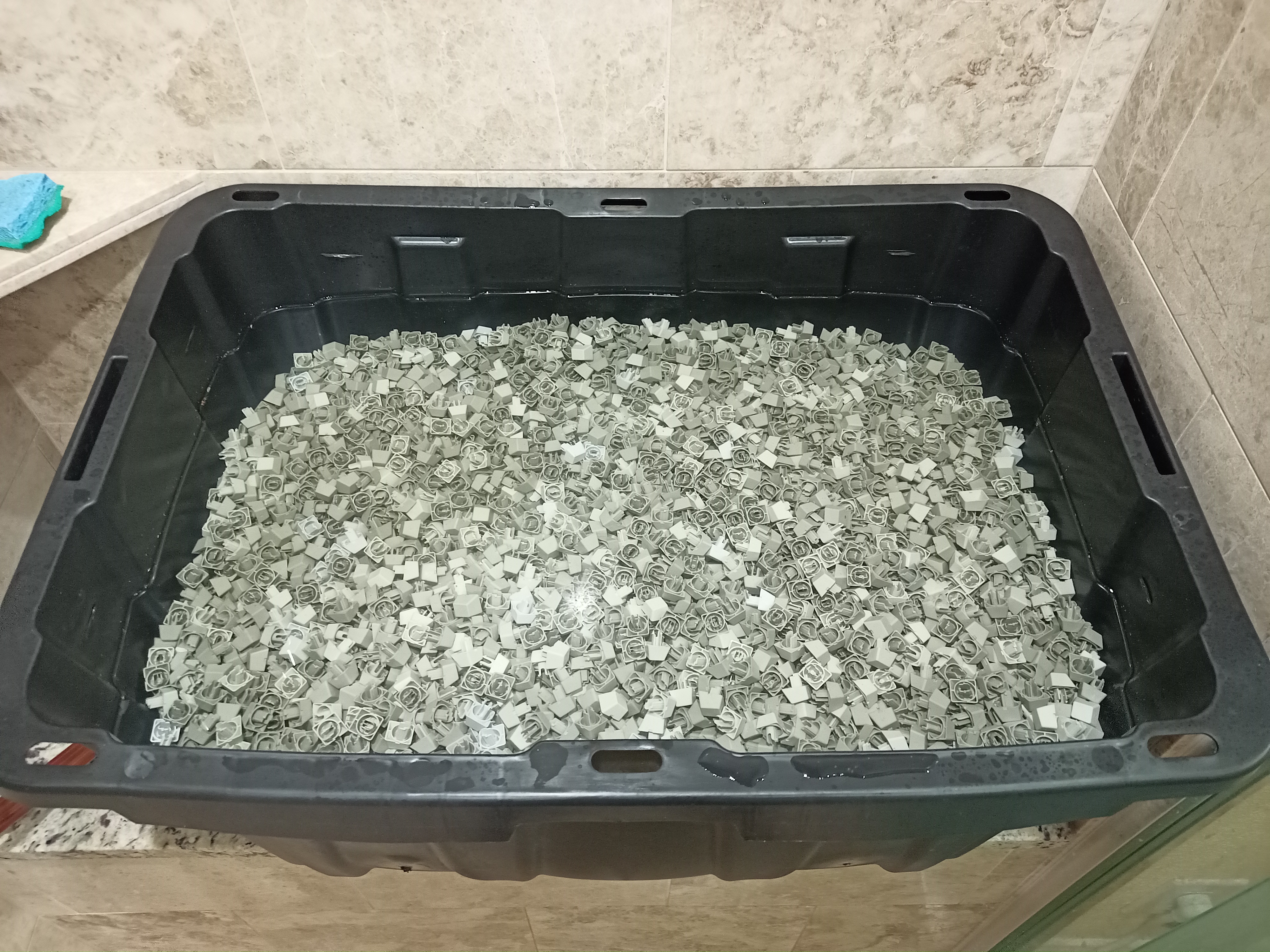

To date, our results using this dish detergent with key caps have been great. It will clean all but the truly filthiest of key caps with tar or heavily oiled grease, which then need a cursory wipe afterwards.
The real motivation for this is that it scales much better. There is less paper waste and less work when cleaning a truly huge batch of key caps...

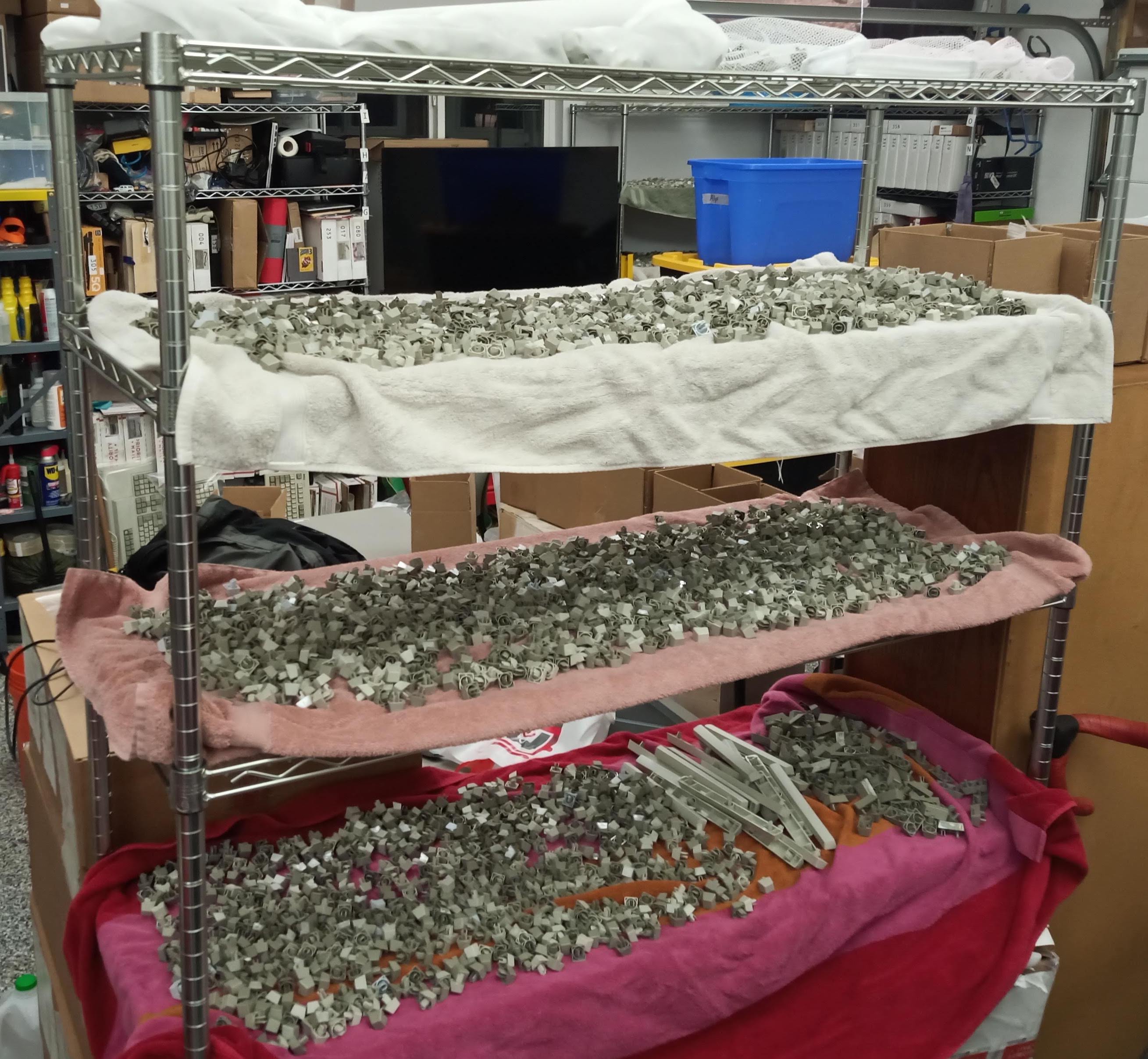

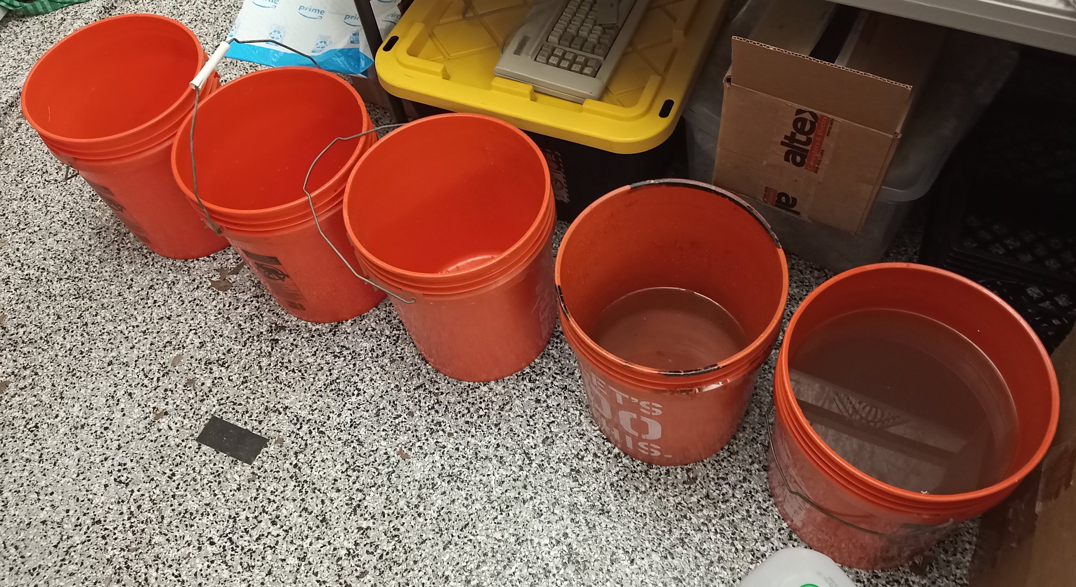

We set them to soak overnight, drain them, rinse them, then do a final rinse by bringing them through three buckets of the cleanest water you can find: distilled, deionized, or reverse osmosis. This last step is critical for removing any possible lime scale.
Then, we set them to dry on drying racks overnight, with a fan and a dehumidifier running.
