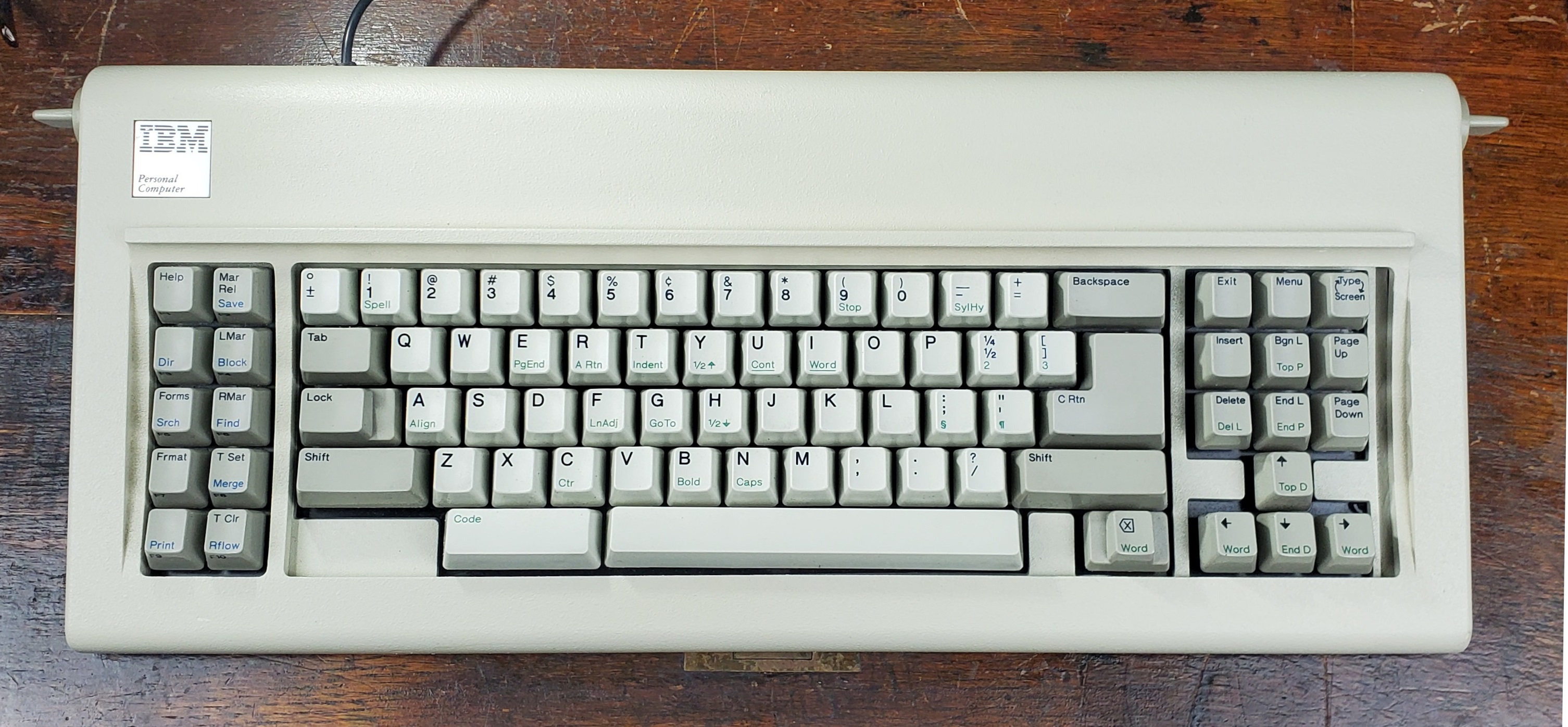

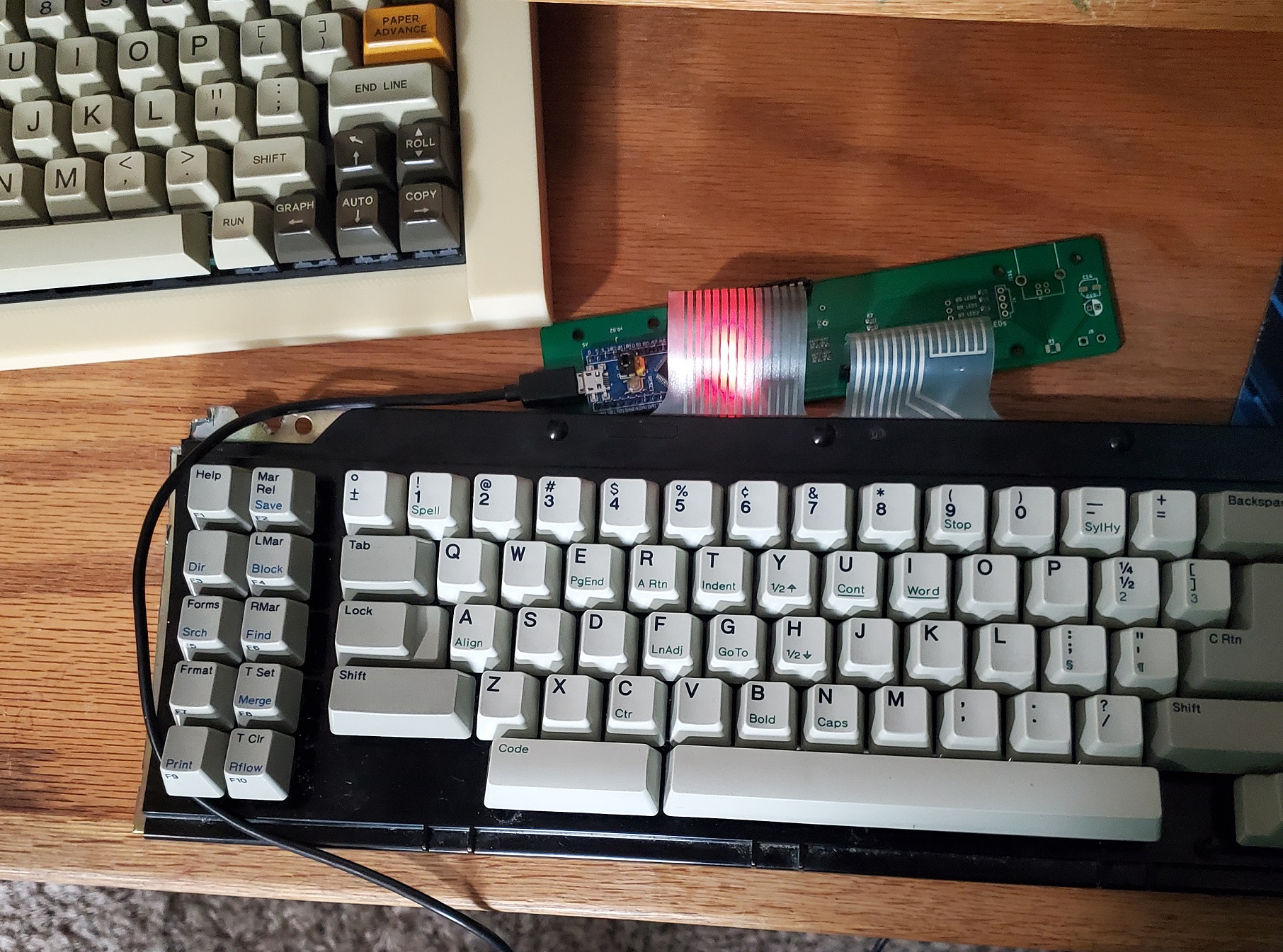

The goal was to use an extra XT case I had laying around and insert a Wheelwriter 70 assembly. I saw an interesting comment on Reddit that indicated the Wheelwriter barrel plate seemed to be able to fit inside an XT case and wanted to test that theory. The Wheelwriter layout is more usable than a XT and although not perfect, if it could be configured with QMK the 78 available keys, the Code key, and function rows to the left allow a lot of flexibility for key layout. Since I did not have the F pcb anyways this allowed me to at least use these components and has a very unique and interesting look.

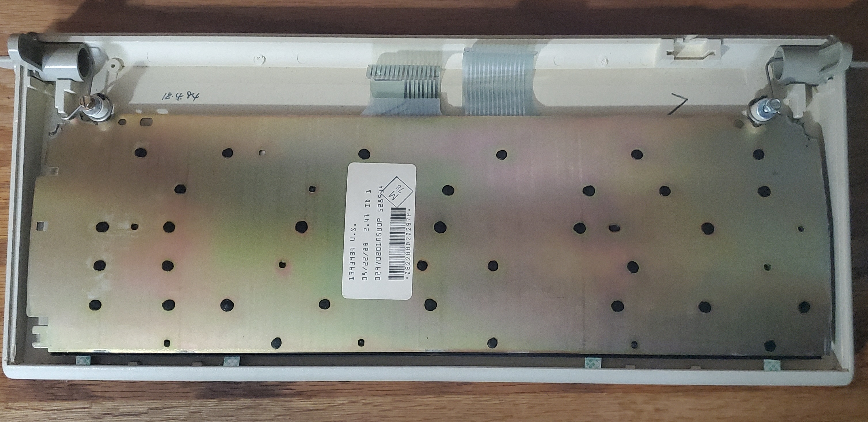

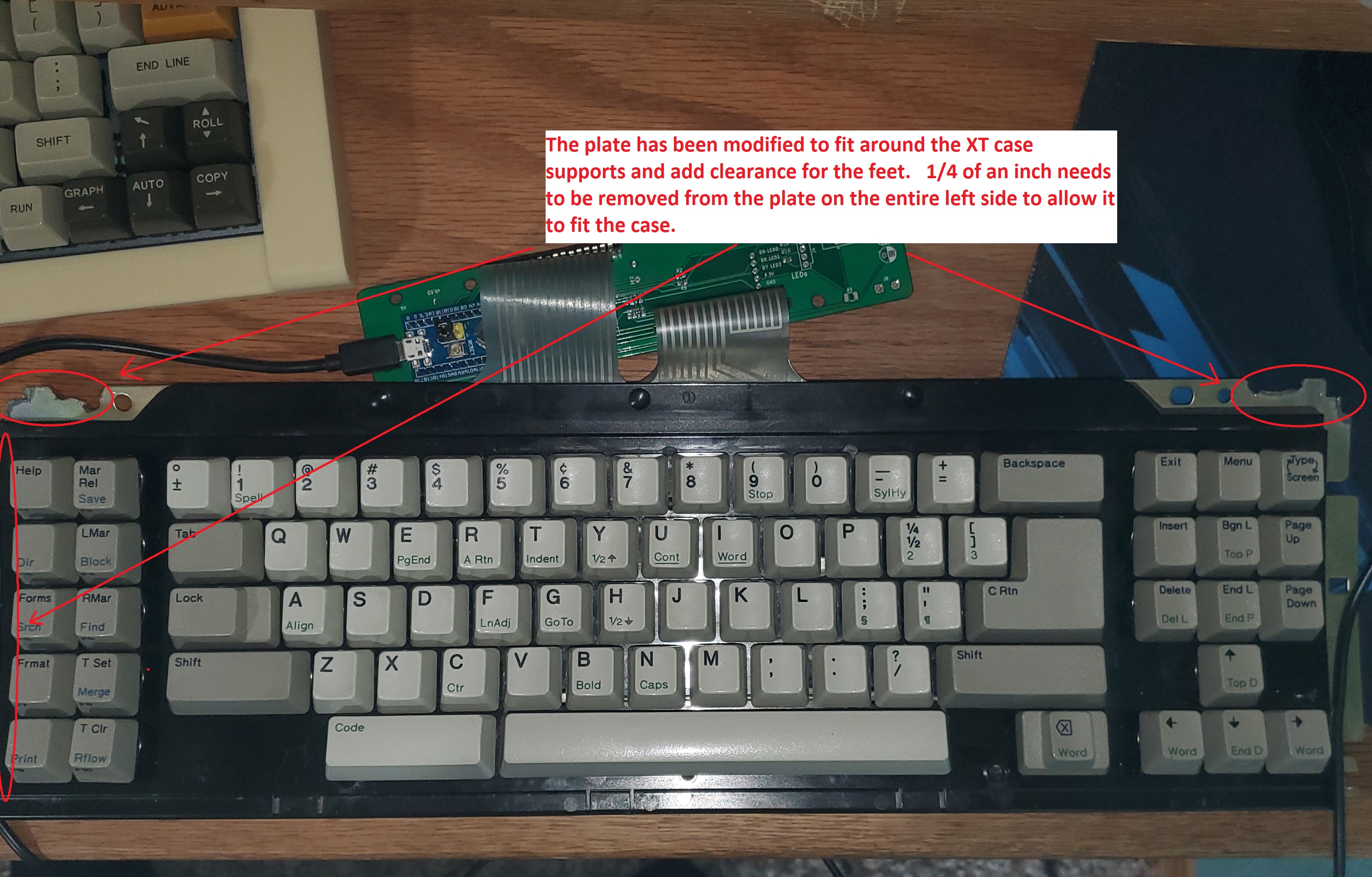

The first task was to see if I could even get the Wheelwriter keyboard assembly to fit. The Wheelwriter backplate is about 1/4-1/2 an inch too wide on the left of the function keys (looking at the barrel plate), and there was interference with the posts in the case and needed a little trimmed off the top sides to let the feet lay flat inside the case. None of this requires removal of barrel plate so it the plate can be trimmed without disassembly. This was possible with modification via grinder of the backplate. (NOTE: This is the time to consider a screw or bolt mod. I just wanted to test this out so I didnt, but using a grinder can certainly pop some rivets.)
This then fits in the case like so:
I put the keyboard, a Level1Techs MStar controller, and cable back inside and then assembled the case to make sure everything could be put together. It was tight, but they all fit and looked pretty good.

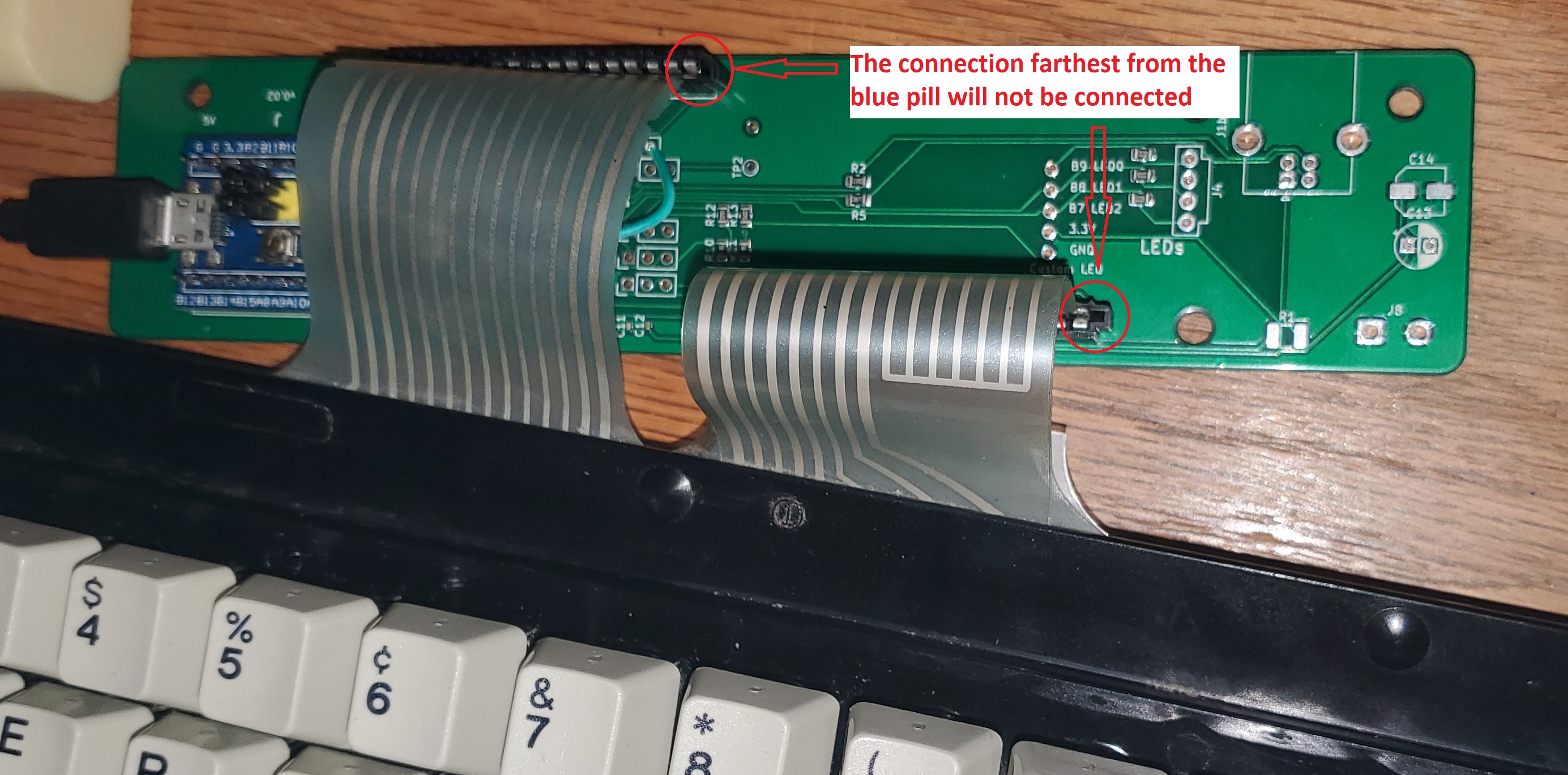

Once I realized that I could get this to work I decided to use my Level1Techs controller that I acquired for my Mini M and see if I could configure it to work with this keyboard. This actually looked like it would work well as it already had the 2x16 triomate connectors that fit the 2x15 ribbon cables on the Wheelwriter.
I assigned an 16x8 matrix in QMK and used some debugging functions to map the matrix. The following is the matrix layout for the Wheelwriter 70, in column/row pairs, other Wheelwriters may be different as they seem to use different membranes for the smaller layouts.
The QMK layout definition is the following, for the MStar this means adding the definition to Level1Techs m_star_classic.h header file:
// Keep the Wheelwriter matrix at 16 columns to maintain implementation
// consistency using the Default mappings, but cols 0 and F are not used
#define LAYOUT_wheelwriter70( \
    K4A, K4B,   K4C, K4D, K4E, K4F, K4G, K4H, K4I, K4J, K4K, K4L, K4M, K4N, K4O, K4P, K4Q,   K4R, K4S, K4T, \
    K3A, K3B,    K3C, K3D, K3E, K3F, K3G, K3H, K3I, K3J, K3K, K3L, K3M, K3N, K3O,   K3Q,     K3R, K3S, K3T, \
    K2A, K2B,    K2C,  K2D, K2E, K2F, K2G, K2H, K2I, K2J, K2K, K2L, K2M,  K2N, K2O,  K2Q,    K2R, K2S, K2T, \
    K1A, K1B,   K1C, K1D, K1E, K1F, K1G, K1H, K1I, K1J, K1K, K1L, K1M, K1N,  K1O,   K1Q,          K1S,      \
    K0A, K0B,               K0E,                    K0J,                   K0O,      K0Q,    K0R, K0S, K0T  \
/* 00 */ { KC_NO,  K0B,   K0A,   KC_NO, KC_NO, KC_NO, KC_NO, K2H,   K2I,   KC_NO, KC_NO, K2N,   K2Q,   K0S,    KC_NO,    KC_NO }, \
/* 01 */ { KC_NO,  K1A,   K1B,   KC_NO, K2D,   K2E,   K2F,   K2G,   K2J,   K2K,   K2L,   K2M,   K2R,   K2S,    KC_NO,    KC_NO }, \
/* 02 */ { KC_NO,  K4A,   K4B,   KC_NO, K4C,   KC_NO, KC_NO, K4H,   K4I,   K4O,   KC_NO, K4N,   K4Q,   K4S,    KC_NO,    KC_NO }, \
/* 03 */ { KC_NO,  K3A,   KC_NO, KC_NO, K4D,   K4E,   K4F,   K4G,   K4J,   K4K,   K4L,   K4M,   K4R,   K4T,    KC_NO,    KC_NO }, \
/* 04 */ { KC_NO,  K3B,   K3C,   KC_NO, K3D,   K3E,   K3F,   K3G,   K3J,   K3K,   K3L,   K3M,   K3R,   K3S,    KC_NO,    KC_NO }, \
/* 05 */ { KC_NO,  K2A,   K2B,   KC_NO, KC_NO, KC_NO, KC_NO, K3H,   K3I,   K3O,   KC_NO, K3N,   KC_NO, K3T,    KC_NO,    KC_NO }, \
/* 06 */ { KC_NO,  KC_NO, K2C,   K1Q,   K1E,   K1F,   K1G,   K1H,   K1K,   K1L,   K1M,   KC_NO, K1S,   K2T,    KC_NO,    KC_NO }, \
/* 07 */ { KC_NO,  K0J,   K0Q,   K1C,   KC_NO, KC_NO, KC_NO, K1I,   K1J,   KC_NO, KC_NO, K1N,   K0R,   K0T,     K0E ,    KC_NO }, \
/*           0      1      2      3      4      5      6      7      8      9      A      B      C      D       E       F     */
For testing I have this implemented in the QMK keymap file for the configuration as the following. I didn't want to do anything fancy to start just get it up and running but will add more layers and mods.
 const uint16_t PROGMEM keymaps[][MATRIX_ROWS][MATRIX_COLS] = {
  [0] = LAYOUT_wheelwriter70( /* Base layer */
  KC_F1, KC_F2,   KC_ESC,  KC_1,    KC_2,   KC_3,    KC_4,    KC_5,    KC_6,    KC_7,    KC_8,    KC_9,    KC_0,    KC_MINS, KC_EQL,  KC_NO, KC_BSPC,   KC_PSCR, KC_SLCK, KC_PAUS,
  KC_F3, KC_F4,   KC_TAB,  KC_Q,    KC_W,   KC_E,    KC_R,    KC_T,    KC_Y,    KC_U,    KC_I,    KC_O,    KC_P,    KC_LBRC, KC_RBRC,        KC_BSLS,   KC_INS,  KC_HOME, KC_PGUP,
  KC_F5, KC_F6,   KC_CLCK, KC_A,    KC_S,   KC_D,    KC_F,    KC_G,    KC_H,    KC_J,    KC_K,    KC_L,    KC_SCLN, KC_QUOT, KC_NUHS,        KC_ENT,    KC_DEL,  KC_END,  KC_PGDN,
  KC_F7, KC_F8,   KC_LSFT, KC_NUBS, KC_Z,   KC_X,    KC_C,    KC_V,    KC_B,    KC_N,    KC_M,    KC_COMM, KC_DOT,  KC_SLSH, KC_NO,          KC_RSFT,            KC_UP,
  KC_F9, KC_F10,                    KC_LCTL,                           KC_SPACE,                                      KC_RCTL,                 KC_RALT,   KC_LEFT, KC_DOWN, KC_RGHT
The connectors on the wheelwriter membrane are 15 traces but column 0 on the column connector is not connected. So the matrix actually starts at column 1. Only 8 traces are used on the row connector, rows 0-7. Because the membrane connectors are 15 wide you have to leave the position farthest from the blue pill as the empty position in the triomate.

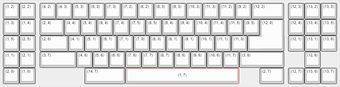

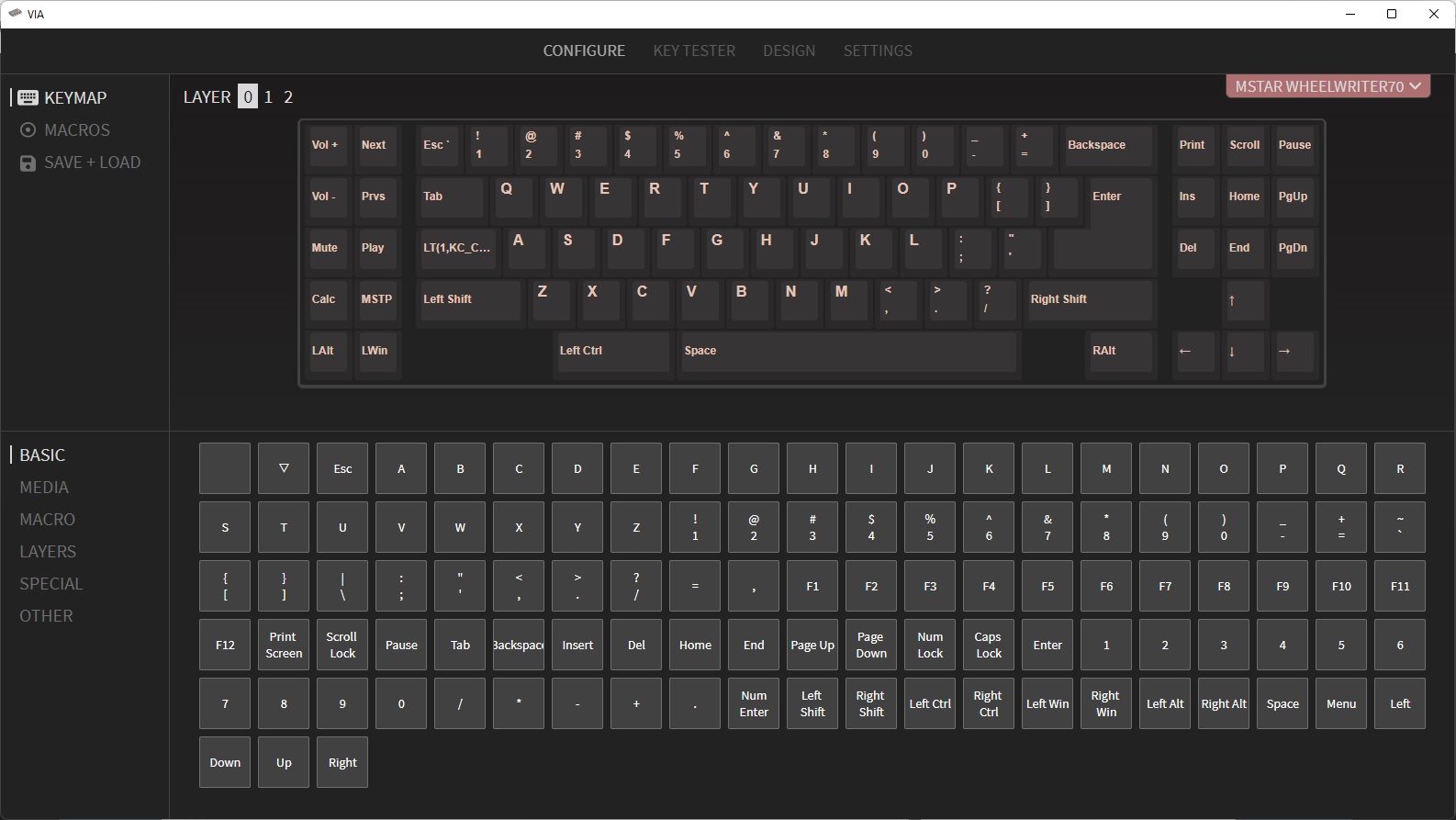

[UPDATE]
I have been able to get this to compile with the VIA toolkit and allow dynamic update of layout. You have to build a layout file below to load into the Design Tab, using the "Use V2 definitions" option enabled. You can then go to the Configure Tab to modify the mapping. The "vendorId" and "productId" in this file need to match the values in the QMK build with VIA enabled. I was only allowed to build with 3 layers due to a constraint in the compiler for the STM32. The pairs in the text are row, col mappings of the matrix to the key in KLE layout format. FYI the row, col layout was very annoying as I had already documented my matrix in col, row format, so I had to go and swap all the pairs around in my KLE file...
  "name": "MStar Wheelwriter70",
  "vendorId": "0xFEED",
  "productId": "0xB155",
  "lighting": "none",
  "matrix": { "rows": 8, "cols": 16 },
  "layouts": {
    "keymap": [
				"2,1",
				"2,2",
				  "x": 0.25
				"2,4 ",
				"3,4 ",
				"3,5 ",
				"3,6 ",
				"3,7 ",
				"2,7 ",
				"2,8 ",
				"3,8 ",
				"3,9 ",
				"3,10",
				"3,11",
				"2,11",
				"2,9 ",
				  "w": 2
				"2,12",
				  "x": 0.25
				"3,12",
				"2,13",
				"3,13"
				"3,1",
				"4,1",
				  "x": 0.25,
				  "w": 1.5
				"4,2 ",
				"4,4 ",
				"4,5 ",
				"4,6 ",
				"4,7 ",
				"5,7 ",
				"5,8 ",
				"4,8 ",
				"4,9 ",
				"4,10",
				"4,11",
				"5,11",
				"5,9 ",
				  "w": 1.5,
				  "h": 2,
				  "w2": 2.25,
				  "h2": 1,
				  "x2": -0.75,
				  "y2": 1
				"0,12",
				  "x": 0.25
				"4,12",
				"4,13",
				"5,13"
				"5,1",
				"5,2",
				  "x": 0.25,
				  "w": 1.75
				"6,2 ",
				"1,4 ",
				"1,5 ",
				"1,6 ",
				"1,7 ",
				"0,7 ",
				"0,8 ",
				"1,8 ",
				"1,9 ",
				"1,10",
				"1,11",
				"0,11",
				  "x": 2.5
				"1,12",
				"1,13",
				"6,13"
				"1,1",
				"1,2",
				  "x": 0.25,
				  "w": 2.25
				"7,3 ",
				"6,4 ",
				"6,5 ",
				"6,6 ",
				"6,7 ",
				"7,7 ",
				"7,8 ",
				"6,8 ",
				"6,9 ",
				"6,10",
				"7,11",
				  "w": 2.75
				"6,3",
				  "x": 1.25
				"6,12"
				"0,2",
				"0,1",
				  "x": 3,
				  "w": 2.5
				"7,14",
				  "w": 7
				"7,1",
				  "x": 1.25,
				  "w": 1.5
				"7,2",
				  "x": 0.25
				"7,12",
				"0,13",
				"7,13"

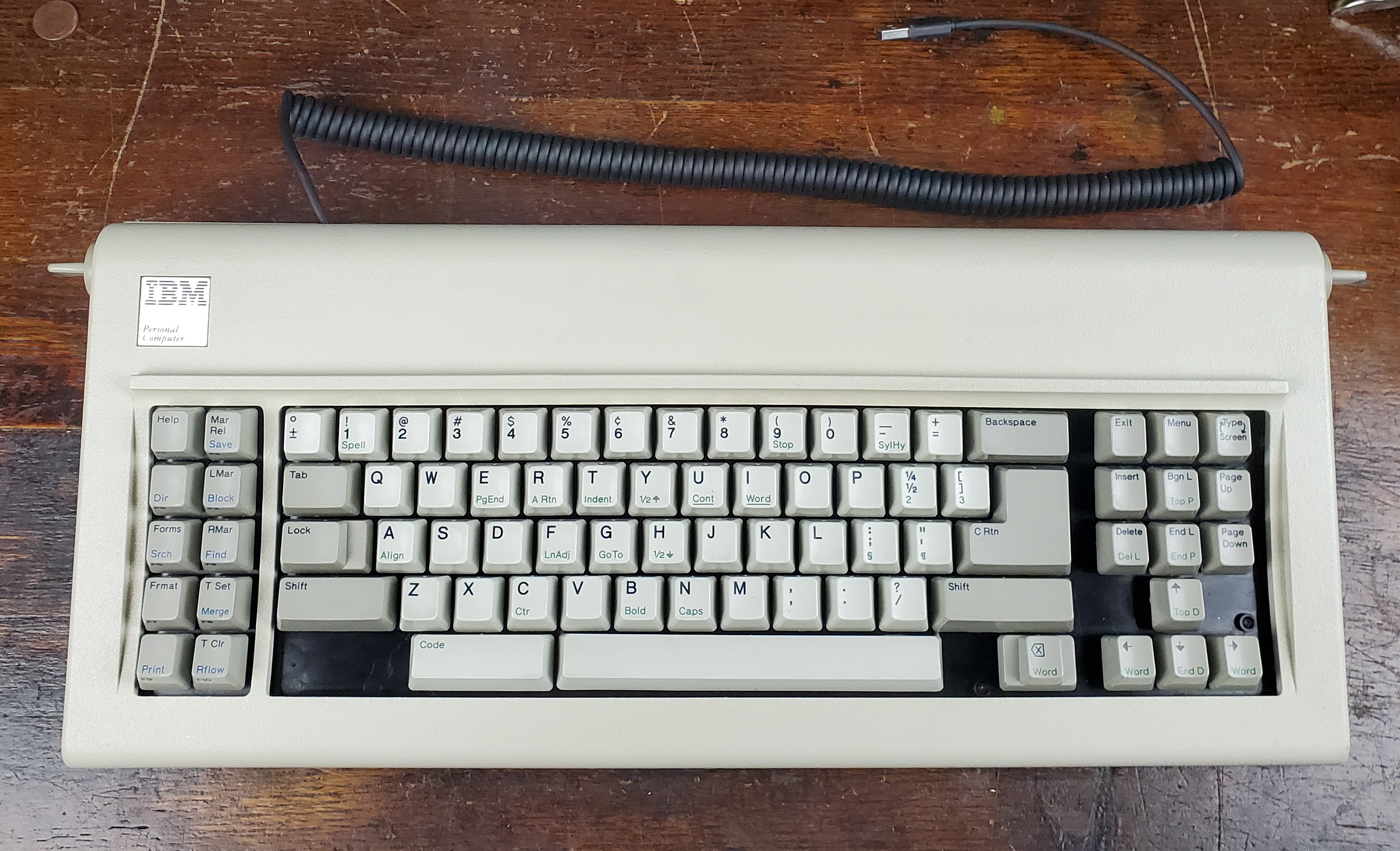

Putting it all together. The controller is tight fit and needed some electrical tape protection to ensure that it does not short against the case base or plate. I also wound a couple of layers of electrical tape around the cable to pinch it as a cable stop at the back, this worked very well and actually looked good. Once crammed in there I can run the usb cable out the back and connect it up and it stays pretty tight.
After cutting the Wheelwriter cover to fit over the barrel plate and inside the case we finally have something that looks like it might have come from the factory. When trimming the Wheelwriter cover remember to leave extra space (1/4in) to the right of the nav cluster as the case has a little extra gap there. Here is how it turned out....
As I mentioned in my post is this probably not my best idea, but it was a fun and a learning effort for me using QMK. I suspect not many will have a spare XT case and a Wheelwriter assembly but hopefully this is helpful for others in using QMK and the MStar controller.

guidemetothelight wrote: 25 Apr 2023, 14:27 Any advice / stuff you wish you had done differently ?
I was in too much of a hurry to get it all together but I wish I screw/bolt modded it, I would have really liked to add the ISO position flippers, but you already have an ISO Wheelwriter so I think you have all positions available already.
The main thing I did wrong was to forget to initially cut out room on the plate for the feet to fold in properly. I cracked one a bit trying to close the case the first time. Luckily the crack was inside, was not visible and was fixable. You can see what I finally did in pics with the notch cut on each side to let the feet go all the way down.
Most of the stuff I didn't document was fitting that keyboard assembly to get it centered. If you take a close look at this download/file.php?id=76054 you can see I am resting the cut outs on the case supports around the feet springs. Also note there is some foam tape at the front of the case to keep the bottom aligned and stop movement.
Centering the thing was alot of trial and error. The cutout on the plate for the case support is the main way to position the keyboard assembly. If you cut or measure slowly to get those post cutouts in the right spot and the right size it will help keep the keyboard assembly aligned that really helps. Try to work to get the back of the assembly to use the case supports to get the proper back alignment. Mine are a little off center and a little deep and wide so I have to wiggle the keyboard to center as I tighten the case, although it does allow me to fiddle a bit with the final alignment.
Using a dremel with a cutting head I also notched some "fingers" at the bottom of the inside the case (where the foam tape is) to position and drop the keyboard assembly in front, which I think I had to do to fit the cover. I might take a pic of that sometime to show that, and it should still be compatible with the original assembly if I ever get one. The case pressure fits the keyboard assembly to secure it as there is a bump on the lower case. You dont want too much pressure there either as it might stress the rivets, but I have not had any problems.
Also there is a gap on the arrow cluster side and the cluster sits a little further from the side. If you cut the Wheelwriter cover to use as a plate remember to leave room on that side to cover all the way. Also, also... I used electrical table to create a cablestop when running the cable out the back which pressure fits the cable when the case is closed.
