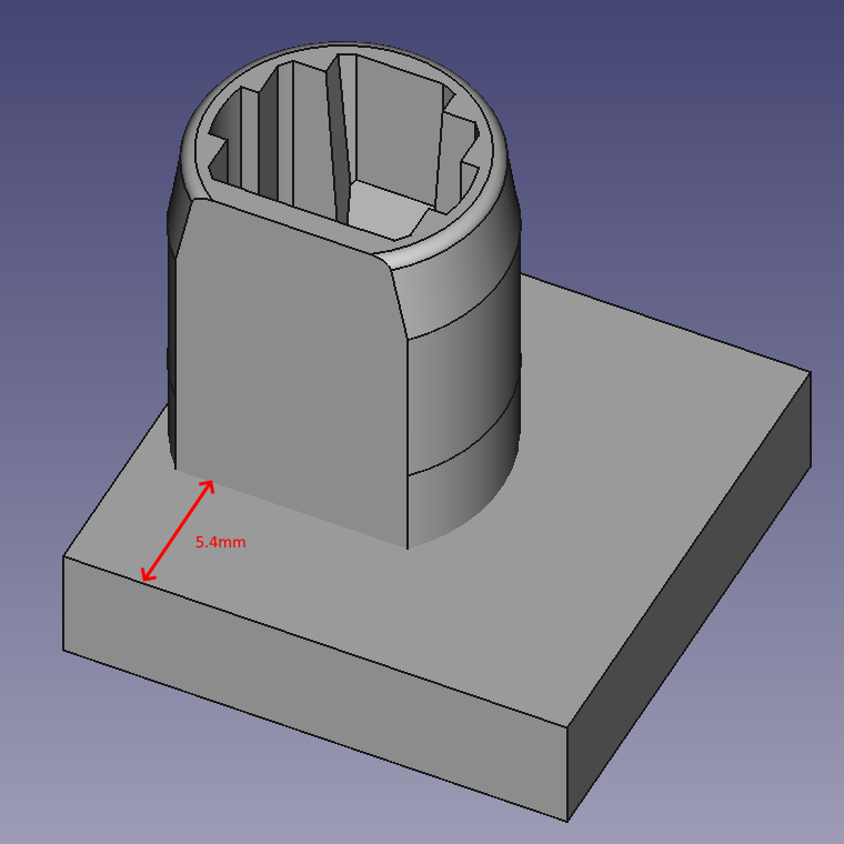

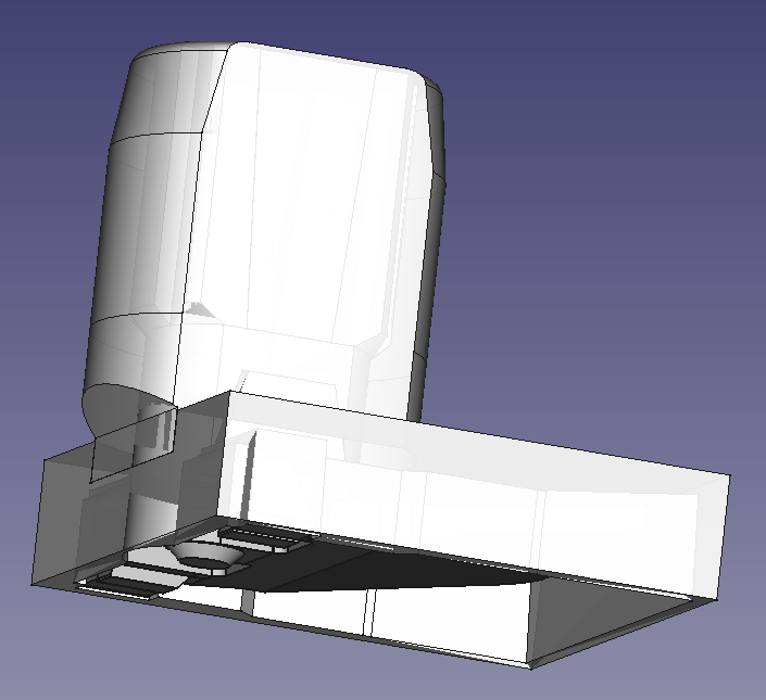

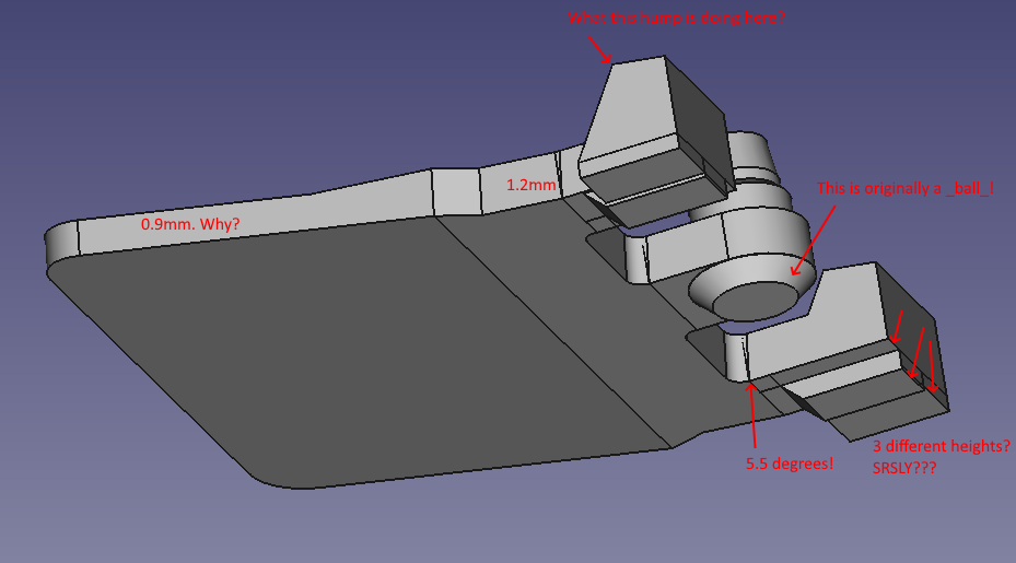

So, with heaps of free time, I embarked on modelling model F key assembly in FreeCAD.
And let me tell you, model F mold makers were showing off. A LOT. Parting lines in _really_ weird places (they mostly make sense, but, like, **weird**), _huge_ chamfers inside the barrel (different lengths, too!), complete lack of taper anywhere inside the barrel or on outsides of the stem (the force to push the part off the mold must have been HUGE!), seemingly 3-part mold for the stem (key outer shape, key inner shape + stem outer shape, stem inner shape) with key needing to flex when pushed off the inner key shape (it flexes every time you pull it from the keyboard anyway - but when it's pushed off the mold it's still hot!), round edges, square edges, fancy chamfers..

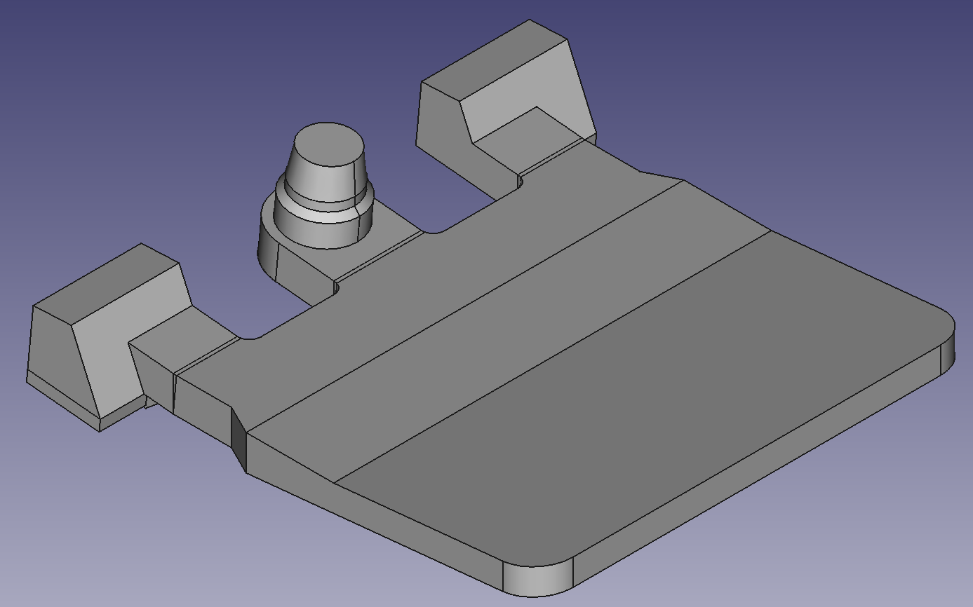

But IBM outdid itself on the flipper.

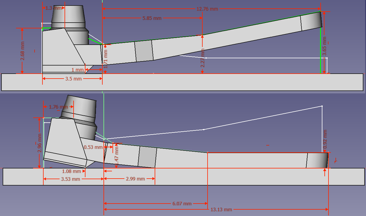

The flipper is strangely baroque: One can easily notice it's bent once - but really it's bent _twice_. The first bend is easy 1:10 slope. Sure, it's joined in a weird way by the thicker middle plate, but e-z, no worries. But then the supporting part - legs and the spring holder - are also bent up, 5.5 degrees. No more, no less. Why wouldn't they be content with just a single bend? It's certainly doable. And the pivot point for that bend is in a kinda weird place, too - not on the cutout line, but where the rounded parts of the cutout end.
Then the legs themselves. The bottom part has 3(!) different heights! M kinda fixed that by extending the "ski" up to the edges - but they still kept the middle cutout for some reason. Were they worried about material use? Weight? Aesthetics? Or were they just flexing?
Also this bump on top of the leg. It has a weird slope which makes no sense. Yeah, it's parallel to the ground when the flipper is down, and it seems to be ~2.75mm in height (which is about the height of the flipper cavity), and when the flipper is up it's top is ~2.75mm from the ground too - but why molding it that way, when the spring is firmly pressing on the flipper from above at rest? M just has constant 3.4mm height of the flipper cavity and it's totally fine, after all. What is it? Belt-and-suspenders?
Then there's this ball under the spring holder which floats full 0.1mm above the ground plane, so it doesn't even touch anything. Is it there to limit holder's deformation if somebody presses on the spring too firmly? It doesn't have to be a ball - flipper pivots way forward of spring holder, holder just lifts off vertically, even it was a cylinder nobody would care..

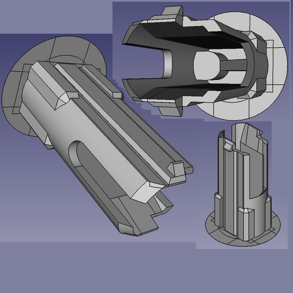

But yeah, I found a lot of interesting details on the stem. Like key stabilizers on the top increasing stabilization while key goes down plus stem itself stabilizing at the bottom by the ring (there's visible effort to minimize the contact area so the key doesn't bind!). Or the spring guides on the sides of the spring holder.

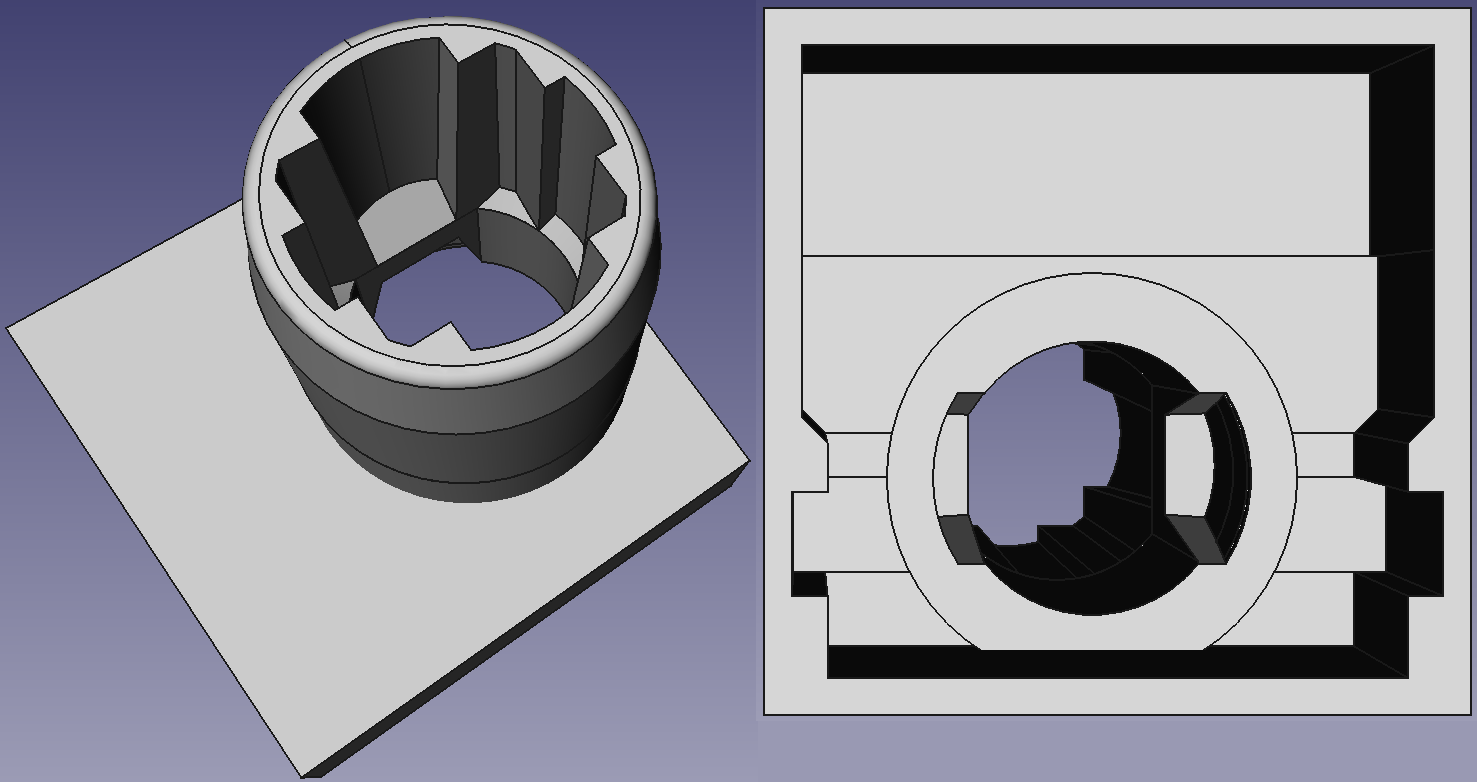

Those with sharper eyes may notice that the barrel base is square and enclosed. Yeah, if I ever shamble to production with this - those will be 19x19mm buckling spring modules with LEDs and MX mount (and couple other things like flipping to the side instead of down). Designed for flat 1.5mm plate, so that COTS plate stabilizers can be reused. Hopefully, they'll support 5mm key travel :)

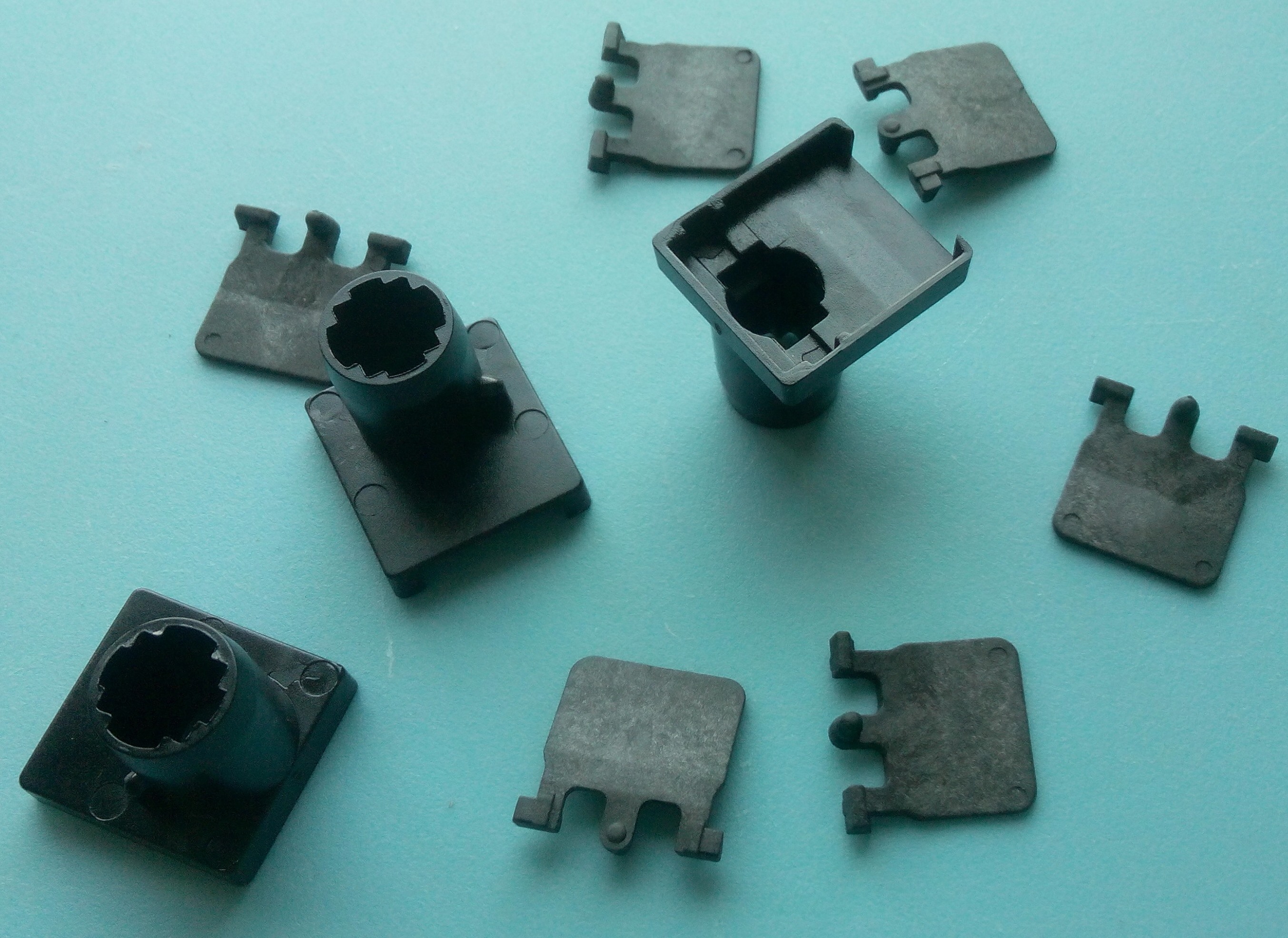

It would be interesting to compare those to the "New Model F" parts.
DMA
13 May 2023, 05:28
AndyJ wrote: 13 May 2023, 01:26 It would be interesting to compare those to the "New Model F" parts.
From download/file.php?id=24323 - flippers look OK-ish, but barrels.. my god, those are real ugly and shoddy AF.

I found a place for a pretty huge LED (like, 3528 will fit with a lot of space to spare) without sacrificing stem compatibility.

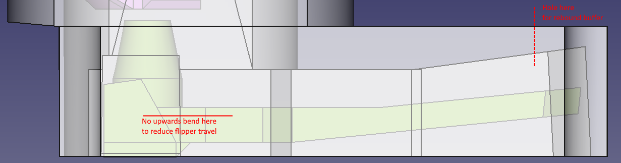

Also, flipper will have to be shortened by ~2mm, although there's still a trick up my sleeve to reuse 2mm of space at the back of the key, beyond the pivot point of the flipper.
For lulz and shine, I'll try to make the barrels from polycarbonate.
Of course, due to LED-lighted keys flipping to the left and being MX-mount (or ALPS, doesn't matter - although my understanding is MX keycaps have a lot more variety to them), original keys will have to have a different plate: cutouts rotated 90 degrees CCW and more key cutouts for F-style stabilizers. PCB will have to be different, too - but if you want to reuse your F keys - flat or curved - it's doable.

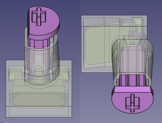

DMA
15 May 2023, 02:15
Accurate model allows for more than just reproduction. It allows to look inside with precision not really achievable at home otherwise.
Here's flipper at rest and pressed down. It's clearly visible that whole 4mm from the pivot point can be freely used for routing, because flipper doesn't touch the PCB there.

Okay, now I see what you’re up to. Or so I think.
I’d be wary about that little channel, though. Tolerances are real. You know how jiggly these flippers can be when inside a keyboard. There’s quite a bit of rotational play on show in every opened F.
DMA
15 May 2023, 16:06
Muirium wrote: 15 May 2023, 14:29 Okay, now I see what you’re up to. Or so I think.
It can't be too jiggly. It just looks that way due to huge 0.5mm clearance between barrel and flipper. The worrying part, tolerance-wise, is the upper stabilizers (you need to look into keycap to even see them). There is a proof that tolerances aren't too tight - Ellipse's barrels, judging from the photos, are _really_ shoddy quality, and yet they work OK.

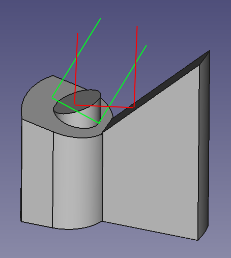

DMA
16 May 2023, 00:23
Actually, one can just shift the barrel 1.8mm to the side, and everything will fit into 19x19mm module. Yeah, sure, it looks a bit weird - but it won't be visible when assembled.
That 30 degree cut is there not to lose the bent plate compatibility. Although, now that I remembered that bent plate needs 21mm row height, it could just be a straight cut. :)

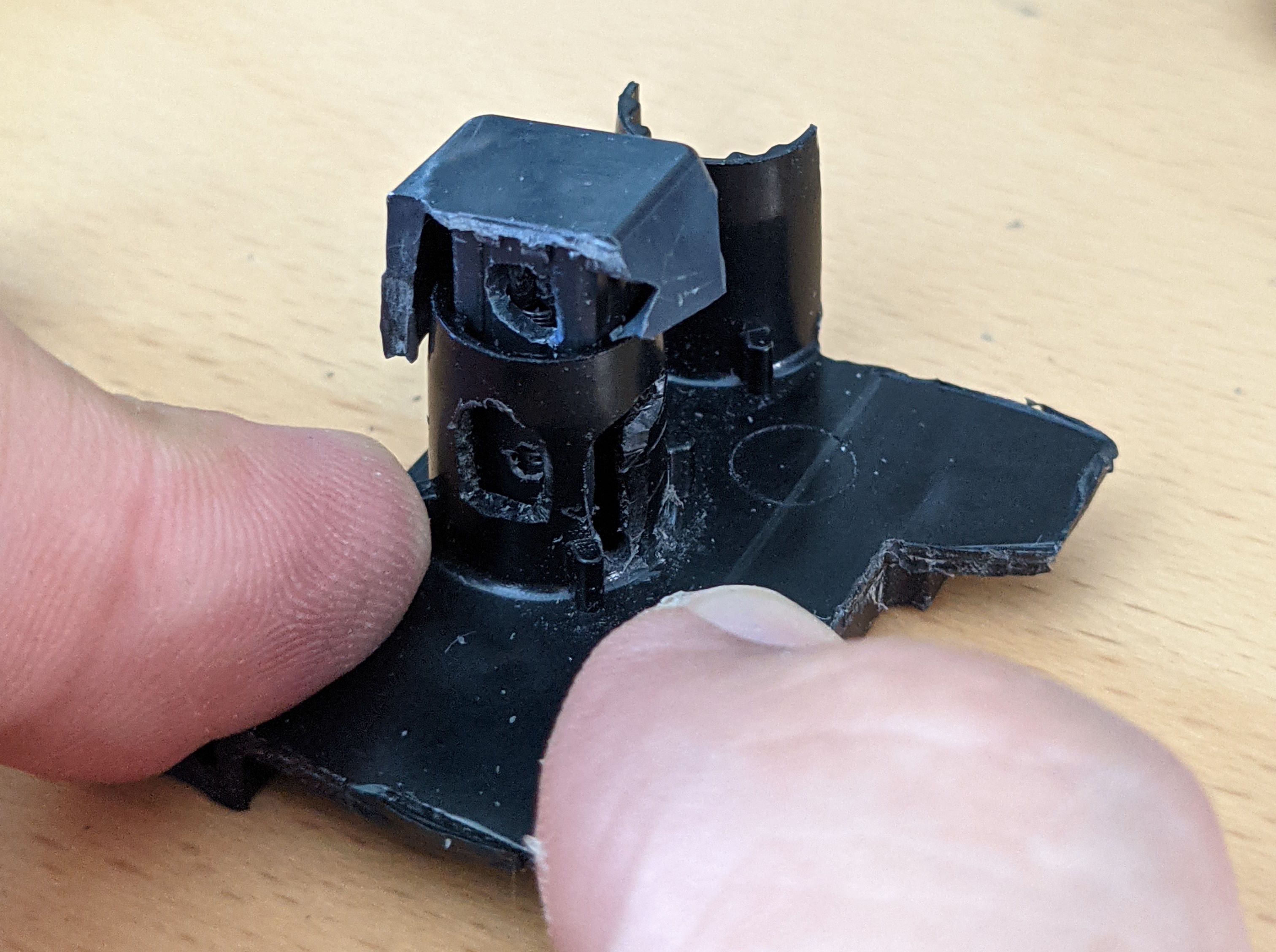

DMA
17 May 2023, 01:51
I figured out why unicomp keys are so bitchy about placement. Some surgery was involved (don't worry, it's the worst quality unicomp key from my collection - I can't bring myself to destroying a single-piece one.)
The root cause is a spring not seating properly: instead of being tilted to 13 degrees by the sloped plate (green outline) it sits almost vertically (red outline), and the magic of "catastrophic spring buckling" doesn't happen without that additional nudge.
Turns out, that small nub on the spring stand is there not to prevent the spring from curling - it's there to nudge the spring onto the sloped plate: the key on the photo has that nub completely removed and yet, if you manage to set spring up in a correct manner, everything works perfectly fine.
That nub's shape is pretty complex - what you see on the model is wrong. I'll try to fix the issue once and for all - seems doable.

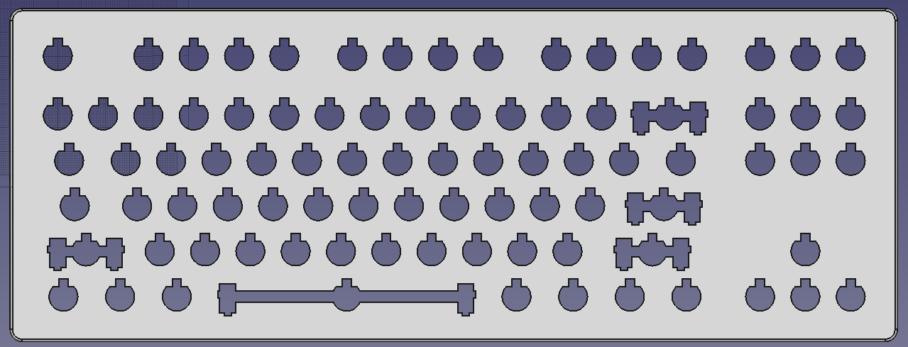

DMA
23 May 2023, 07:28
LOL TANKS.
Stabilizers are actually a bit complicated - plate-mounted stabs are 5 mm deep, so those cuts will have to go thru the LED PCB and foam - which have to be thicc enough to keep those stabs away from the barrels.
But it's doable.
I know, I know, 2U stabs should have wider wire slots - but I don't want to make those wider than absolutely necessary (which is 4.6mm - 2U stab has the same legs as the space bar one, so it should fit).

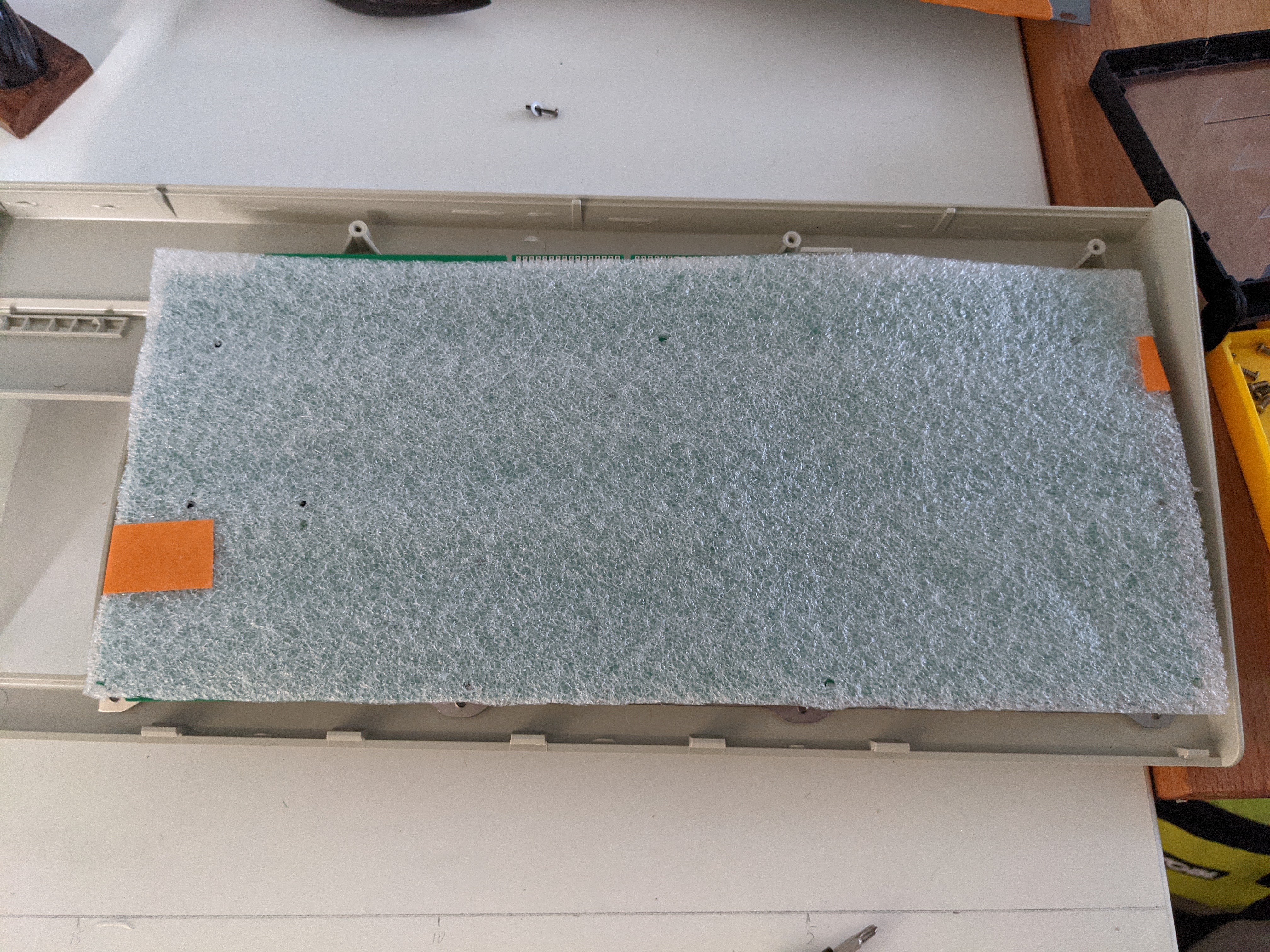

DMA
25 May 2023, 00:05
So, I disassembled my F"SSK" and put random 2.5mm closed-cell polyethylene packing foam under the PCB like this
didn't seem to affect things much - although it does _somewhat_: https://youtu.be/w1DxK8ovW9U
That video is unnecessary long, but if it's less than 1 minute, youtube makes a "short" out of it :(
Try to guess which keys have a blob of silicone on the underside of the barrel. There are 4, and they are pretty easy to spot. Strange thing, however, is that sound level meter app doesn't seem to be able to take those apart AT ALL (shows around 66dB press, around 70dB release). I'll try to find a better microphone, record sounds and do FFT on them to see if it's something to do with sound spectrum emitted.
NOTE: the F122 has no foam - this might affect sound a bit, especially the rebound (keypress - no so much, because the flipper strikes the PCB which is rigidly mounted to the bottom plate, so the energy is freely transmitted, no dampening at all)
You may notice that some of the modded keys are quieter on the keypress than others. That's because some of the blobs are large enough to press the flipper partway down from it's resting position, so it has less space to accelerate in. So the flippers can be molded to be a bit (actually, A LOT) lower in the resting state (in the picture below just the upwards bend of the flipper body is removed, to illustrate the concept. The flipper body will also need to be modified to allow it to rest flat against the PCB.)
