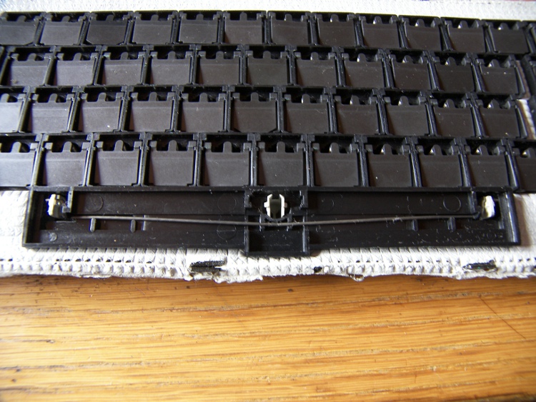

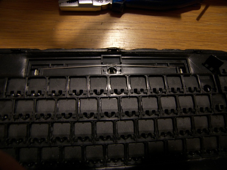

Here is how my spacebar looks on the inside (the space bar side is obviously facing away from me). You can see why you can't safely remove the space bar: there's a spring / stabilizer on the inside!
Space bar stabilizer, model F AT
Take a close look at that spacebar. As it turns out, the spacebar doesn't use a simple stabilizer, rather it has a second long spring to push it back up (picture taken on another occasion) :
Space bar stabilizer, model F XT
This large spring is the target of this mod.

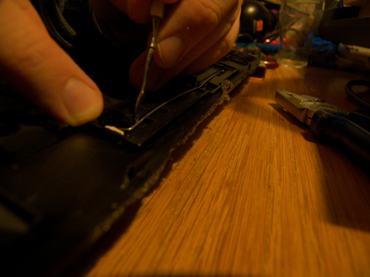

To get it loose, your best option is to take a flat-headed screwdriver or other prying implement to release the spring from a notch in the black plastic (you can see where it is locked when you push the spacebar cap up and down). As soon as the spring is out of this notch, it will pop up allowing you to push the end out of the notch in the space bar keycap. Removing the complete spring should now be easy: carefully lift the free end until you can free the other end from the black plastic support and keycap.
Nudging out the stabilizer

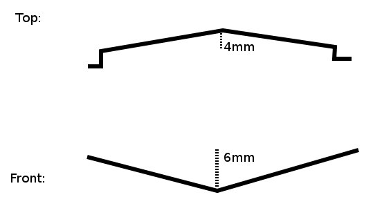

There it is. You may have noticed that the spring is bent like a V when looked at from the top or the front. If you measure the distance from the middle to the ends when looking at it from the front, it measures 6mm. My spring was bent until this distance was only 3mm, giving a nice 60g of force for the spacebar. Here are the dimensions of what I believe to be an unmodified spring:
Stabilizer spring dimensions

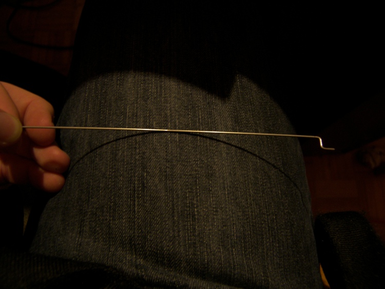

Now the trick: hold it on your thigh like I did in the picture below: keep the bend at the end horizontal when you hold it between your fingers and make sure the middle of the spring points down and away from you. Now push the ends straight down for about 3-5cm, the spring might curl a little around your leg.
Hold the spring in front of you and check that the spring is flatter but not completely flat. That should have bent the spring in such a way that it exerts less force.
Bending technique
Bending technique

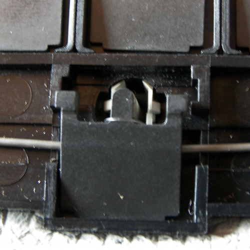

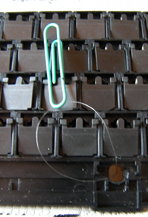

  • Get some thin fishing wir,e or some other strong wire with low-friction. Also grab a wide popsicle stick or a piece of cardboard. I used one meter, the exact length depends on how easily you can fasten the wire to the stick.
  • Remove the spacebar keycap and its hammer (this should be easy as we haven't inserted the stabilizer yet).
  • Thread a loop of wire through the spacebar barrel. Pull it until you can reach the top row of the keyboard.
  • Put on the spacebar keycap and attach the stabilizer spring in the next section. Check that the two strands of wire are passing through the hollow part of the keycap!

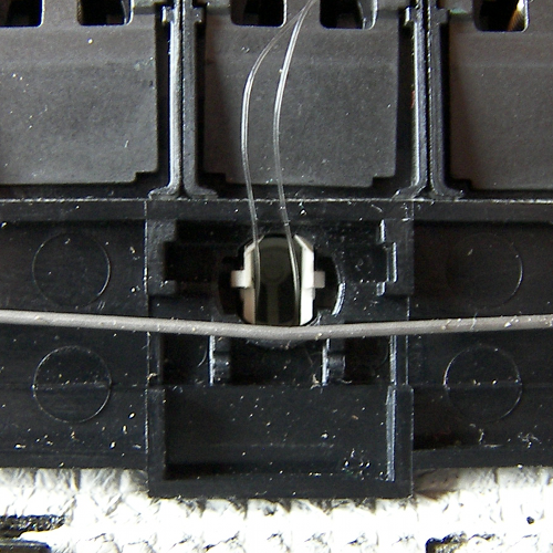

  • Now put the hammer's "heel" with the spring through the loop. (Make sure not to get the spring caught in the wire!)
  • Carefully pull the strands away from the keyboard to tighten the loop. The hammer will be pulled close to the barrel until it snaps into place.
  • Roll the ends of the strands on the popsicle stick or whatever you chose. Keep on rolling until you reach the front plate and give it one last tug to pull everything together. You need to make sure the spooled wire keeps the hammer spring compressed!
  • Now assemble the keyboard as instructed below. The hammer should remain in its place allowing you to push the plates together.
  • Once the plates are properly locked, turn the keyboard barrels-up and unroll the wire from the popsicle stick. Now gently start pulling one end and after a little while you should have removed the wire altogether. If it snags you might have to open up the plates again.
  • Press the spacebar a few times. If it still clicks, you did everything properly.

Step 3:
Wire looped through the hole, paperclip to keep it in place

Step 5:
Loop around heel of the hammer, ready to be pulled in
The first time you try this technique it might be as fiddly as just squishing the thing together. The main difference is that the hammer should remain in its place for as long as the wire keeps the spring compressed. If you just try to press the plates together without this trick, the spring might buckle when you put on the top plate and squash the hammer between the top plate and some other piece of plastic, forcing you to start all over again.
You can of course use something else than fishing wire. Another member, skcheng, used floss made from Teflon for an even better effect (it is after all one of the slickest solid materials).
