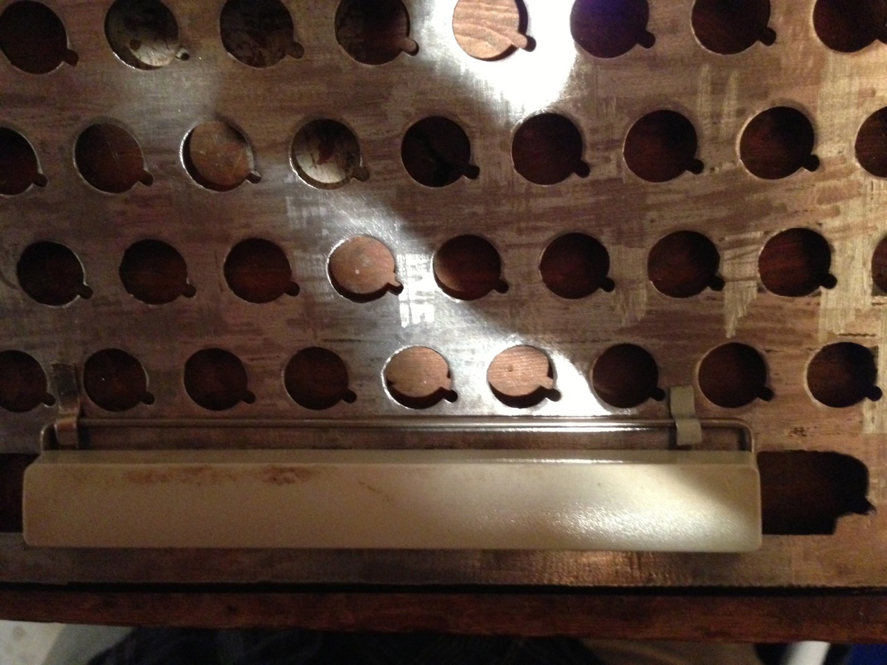

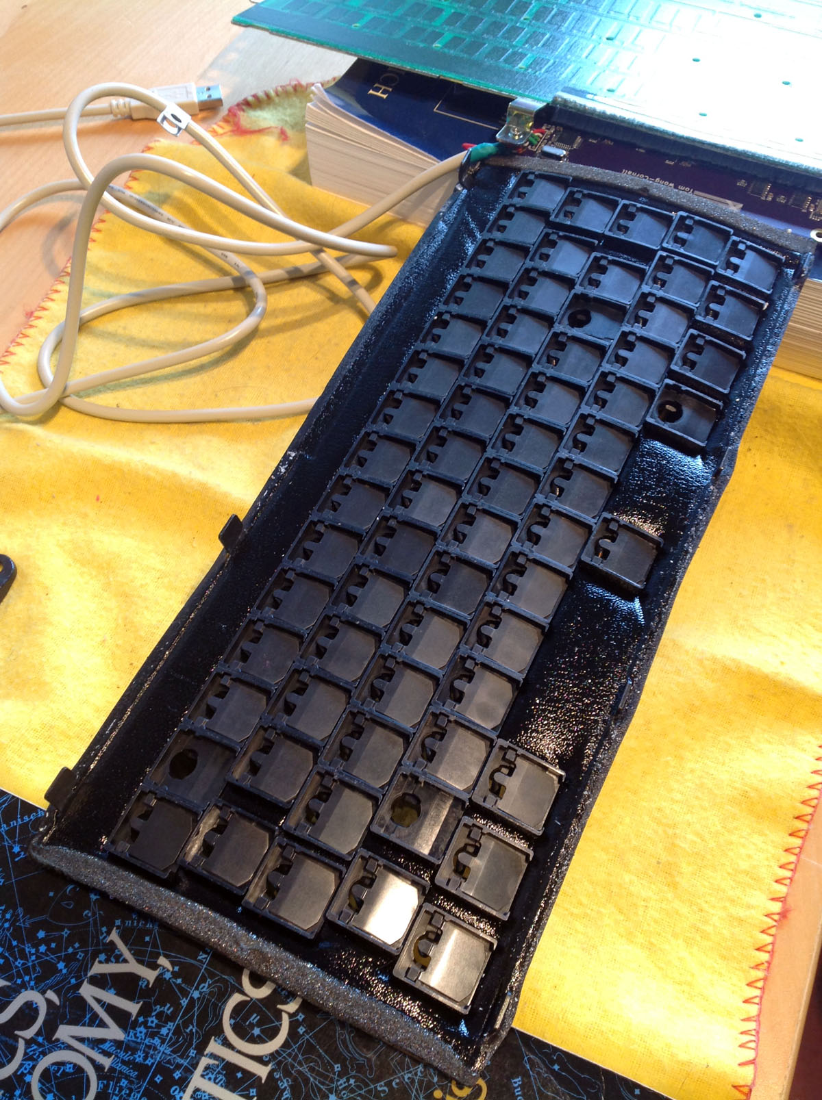

Problem #1: Broken Space Bar Stab
The Kishsaver uses pretty simple stabs: wire hooks on the caps and slides into fixed plastic clips on the surface of the barrel plate. There's actually enough clips on the plate for 5 stabs, only 3 of which are in use on my standard config-Kishsaver: BACKSPACE, right SHIFT, and of course the SPACE Bar. All 10 mounts are in fine shape except this one…
Space Bar Stab.JPG (609.64 KiB) Viewed 18018 times
That snapped right-side stab means my space bar is only stabilised on its right half. When you press the left, the off-axis forces are routed towards that opposite clip, which isn't there.
Any ideas how to give this guy a new top so it works again?

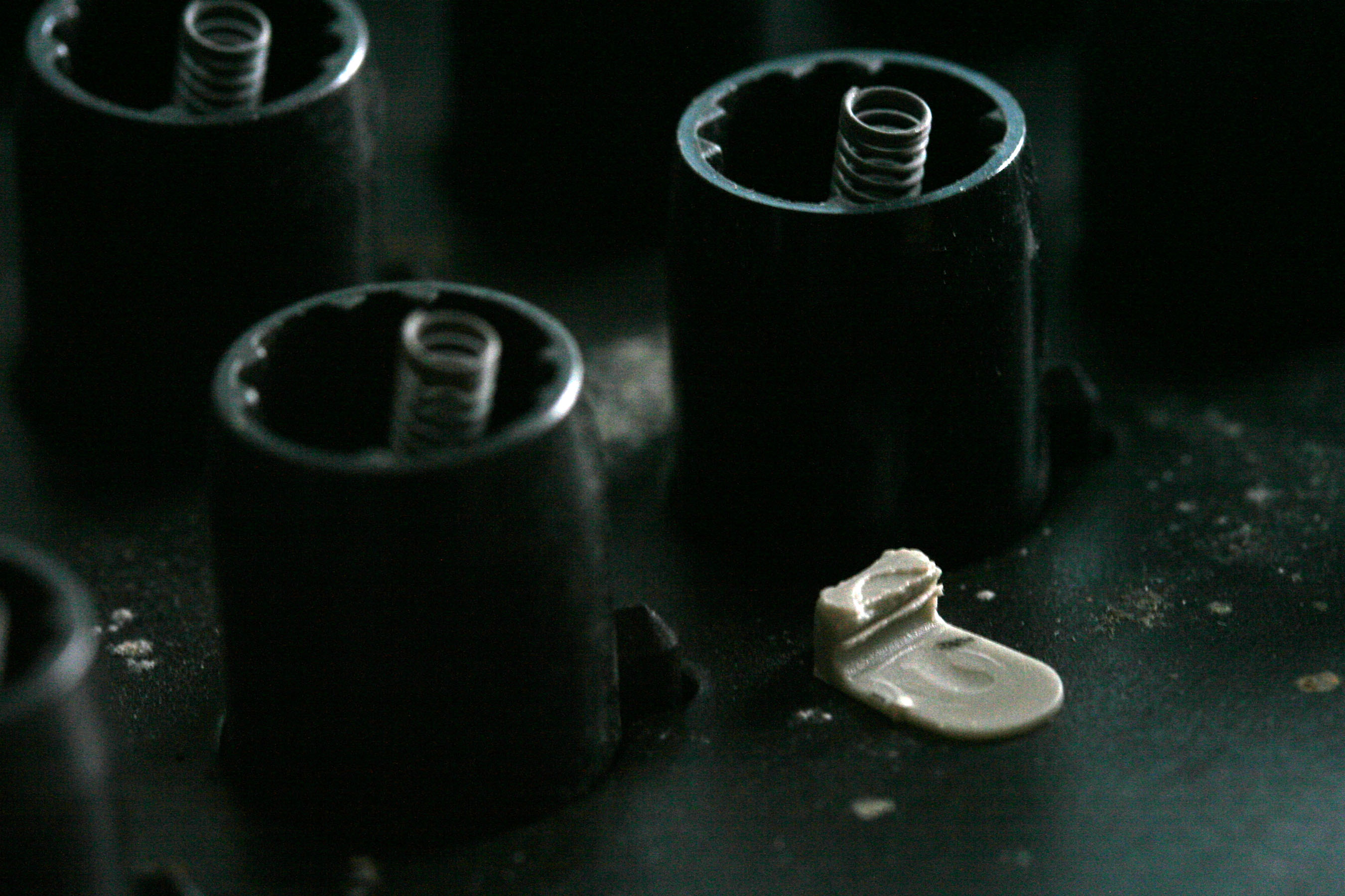

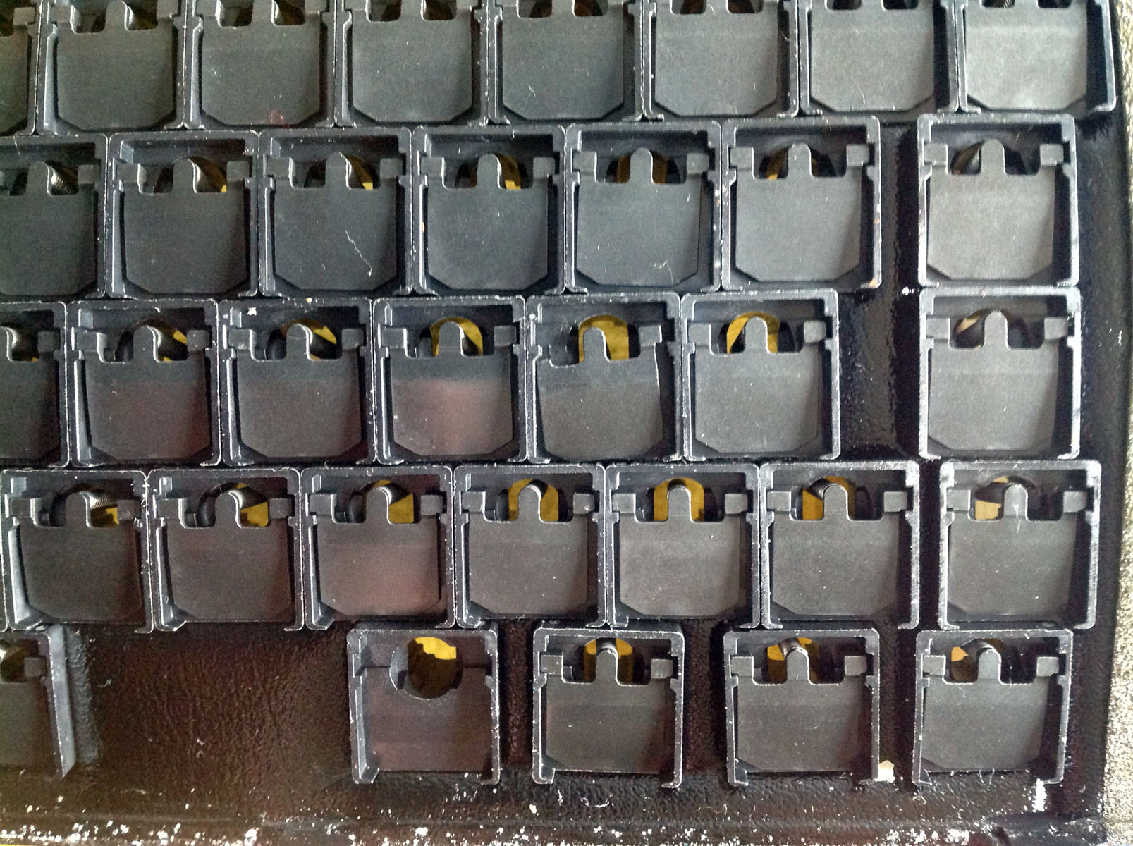

Problem #2: Dodgy Flipper
The S key doesn't work. I've explored the problem a few different ways including a good chopsticking (which fixed another key) and all that's left is taking the plates apart to have a proper look at that flipper. I suspect it's broken and I need to replace it.

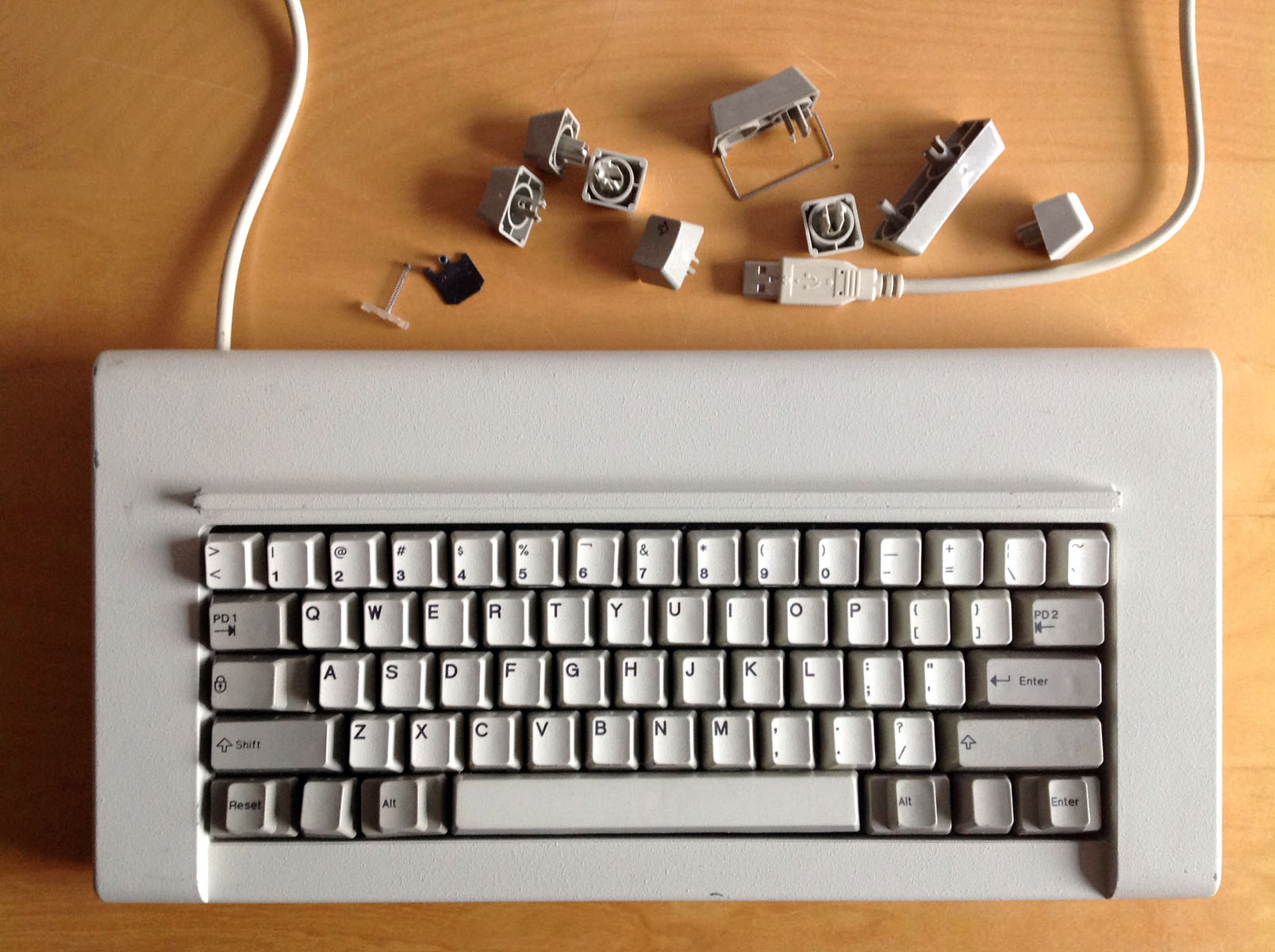

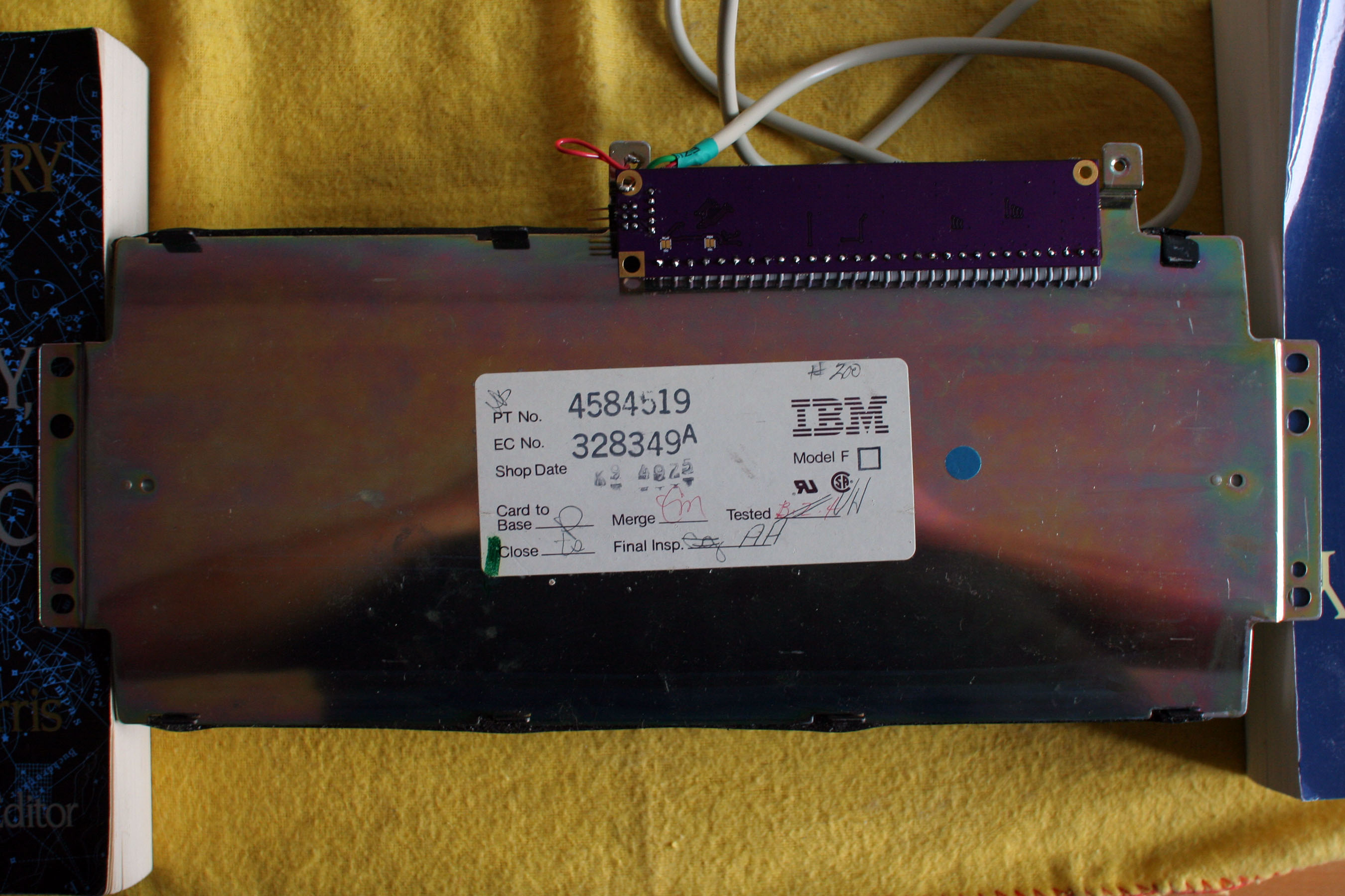

I've never been inside the metal heart of a Model F before. Has anyone some tips on taking a Kishsaver apart? Here's the overview:
I've taken the caps off (including the space bar, which is much better behaved than on an XT) and I've had a very cautious fumble around to feel if there's any slack in the plates. Nothing obvious though. Guess it's time to address these fellows:

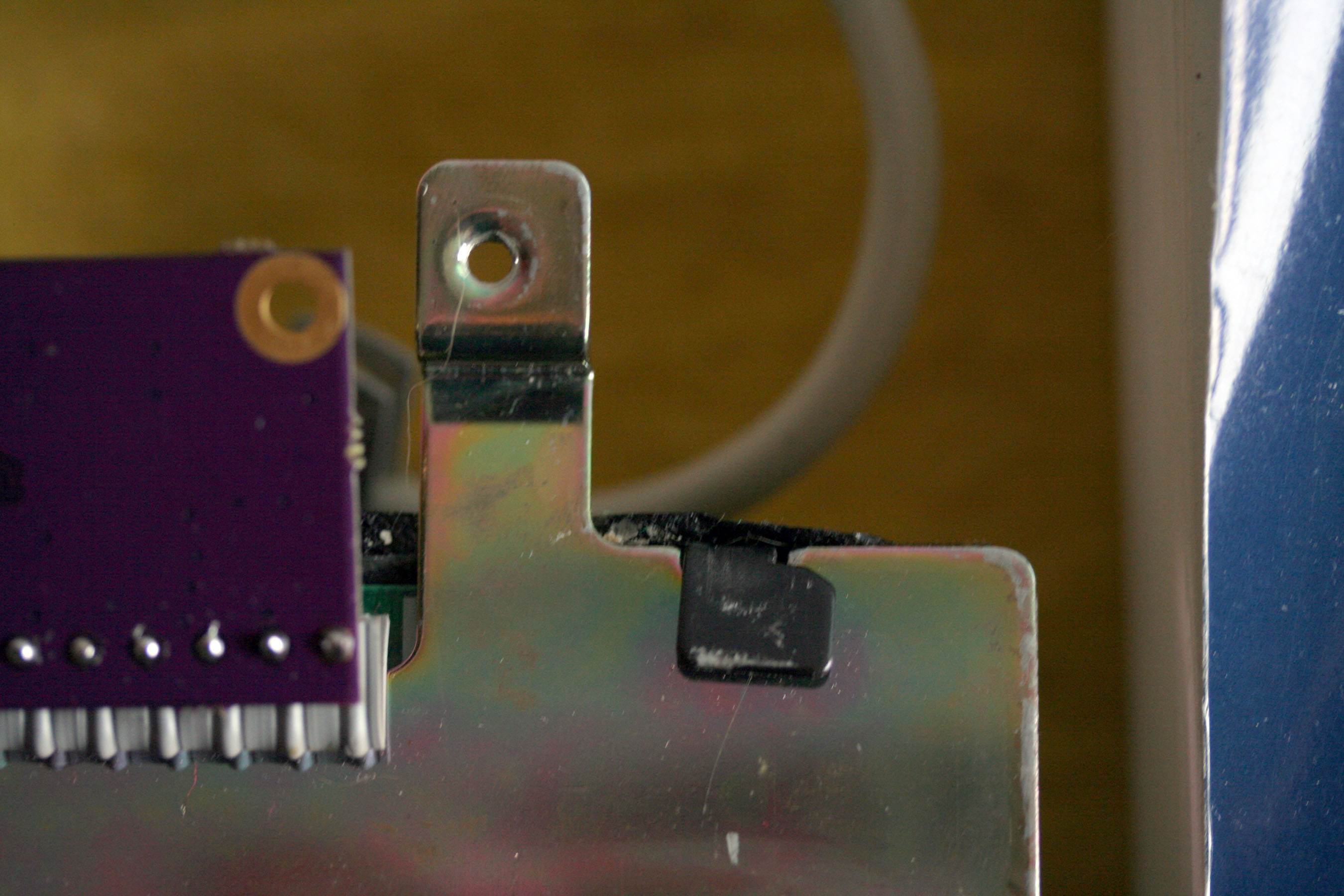

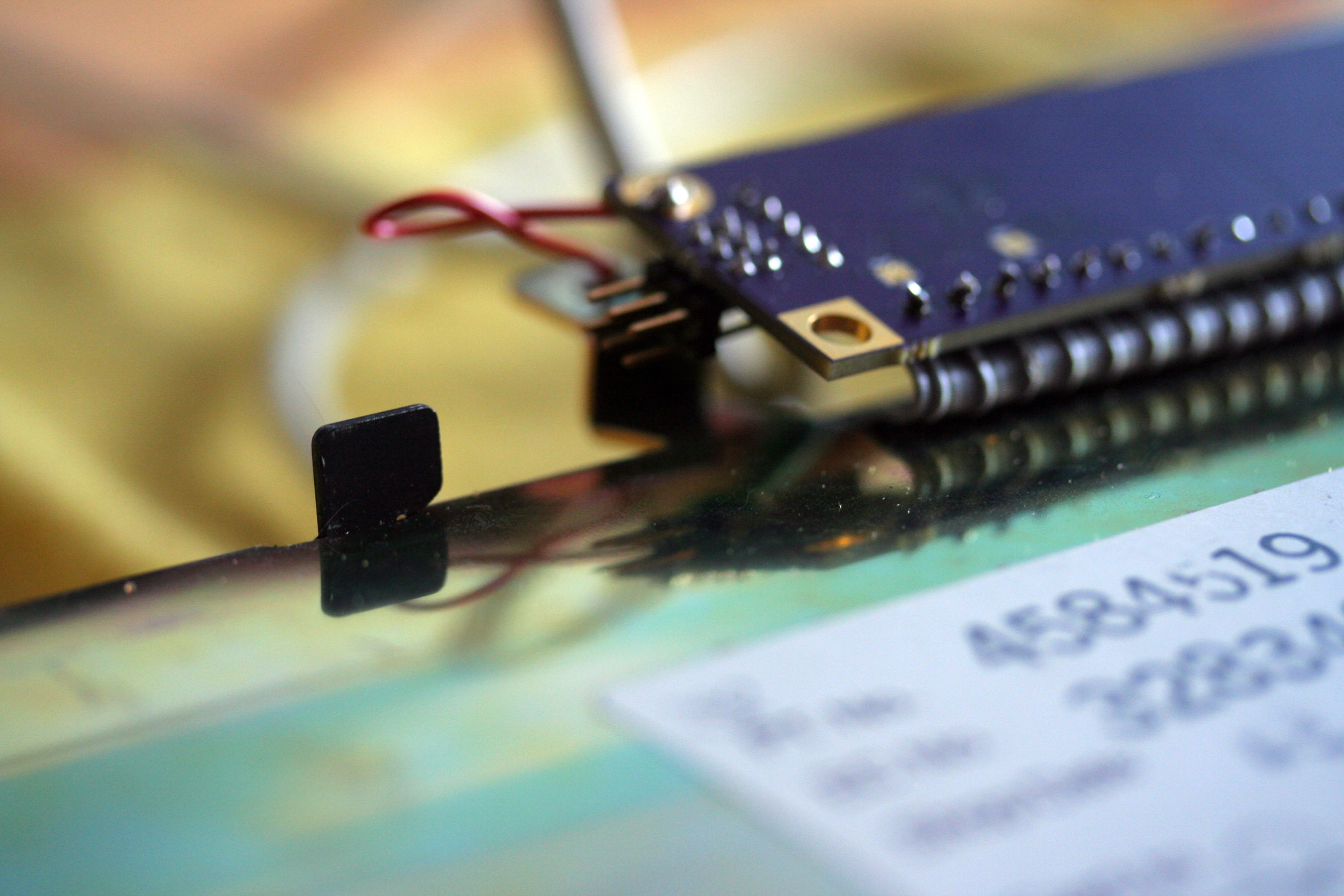

Bottom Clip.JPG (427.45 KiB) Viewed 18018 times
Top Clip.JPG (463.85 KiB) Viewed 18018 times
There are 7 clips (4 along the bottom edge and 3 along the top) and this one in the top right is different, as it's bent over.
Corner Clip.JPG (519.1 KiB) Viewed 18018 times
Corner Clip Elevation.JPG (395.03 KiB) Viewed 18018 times
I'm guessing I pull that clip up straight, like the others. Then what? I've read of clamps and other scaries! But not enough explicit detail to have confidence in what I'm doing here myself.

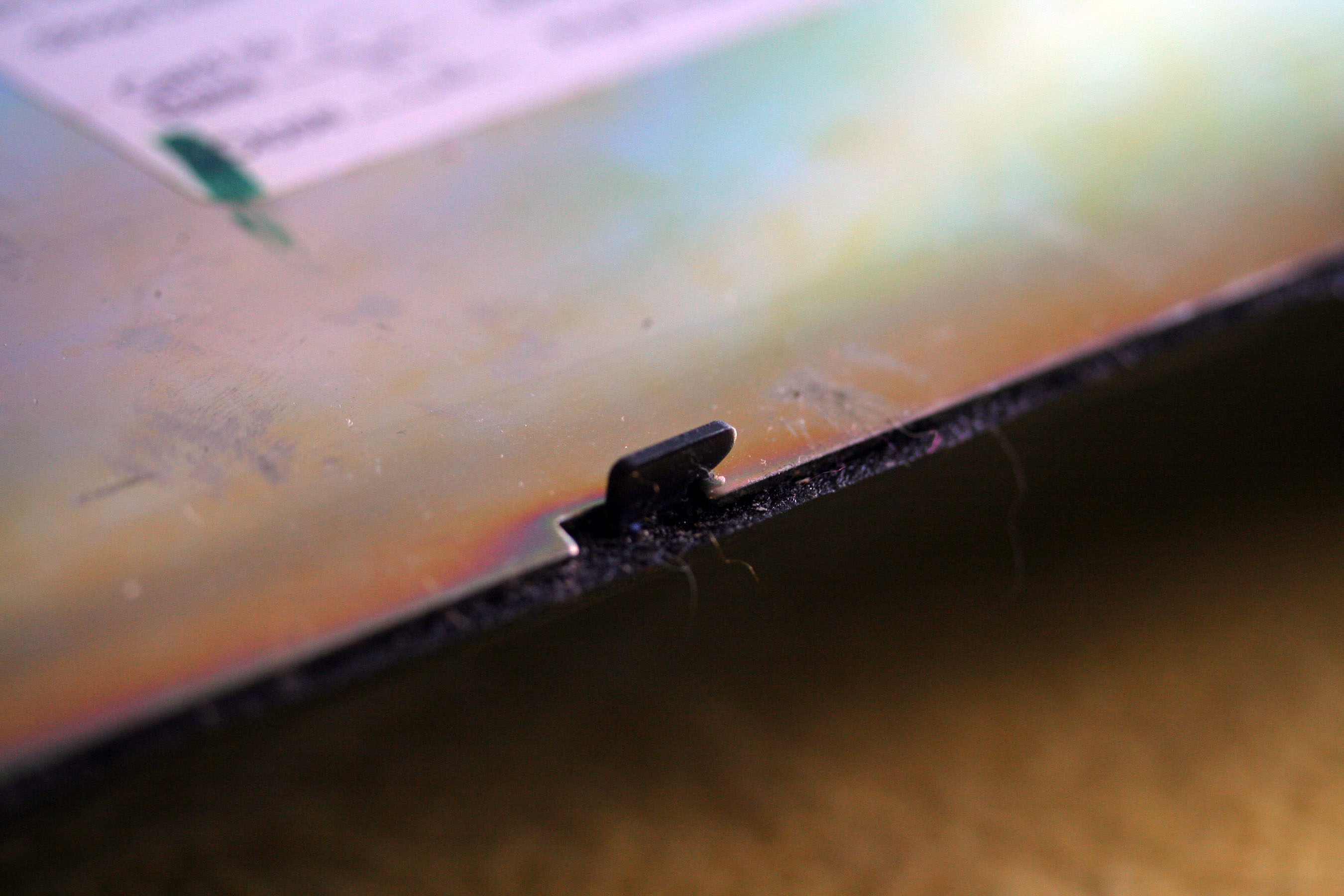

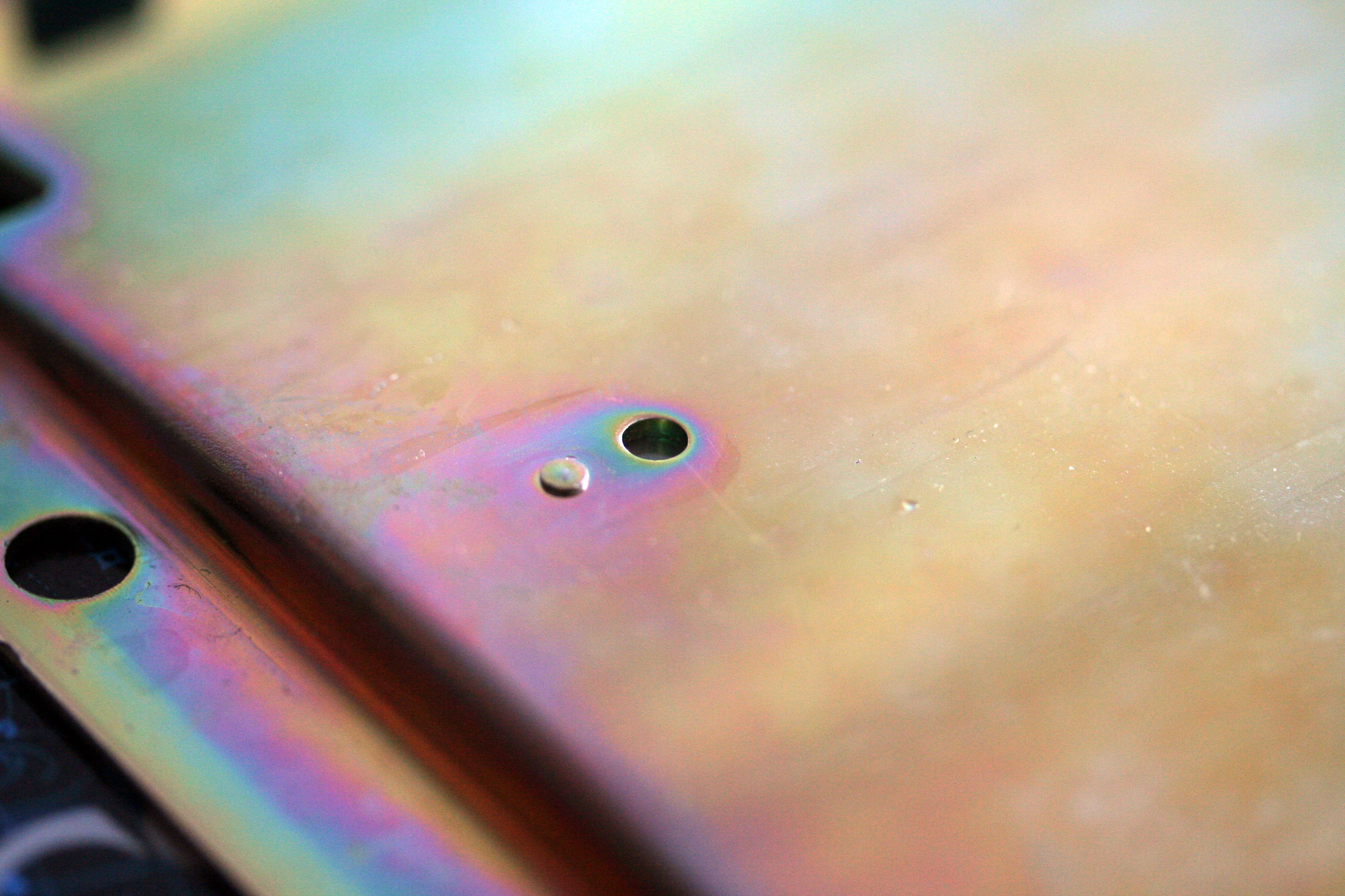

Then there's the pair of these:
Mystery Hole.JPG (595.32 KiB) Viewed 18018 times
Hmm… even the little blue label on the back of the plate makes me worry now. Halp!
rindorbrot
19 May 2014, 18:02
Muirium wrote:
Yes, straighten it up.
Then you can slide the whole barrel plate assembly to the side and the board is opened ;)
19 May 2014, 18:49

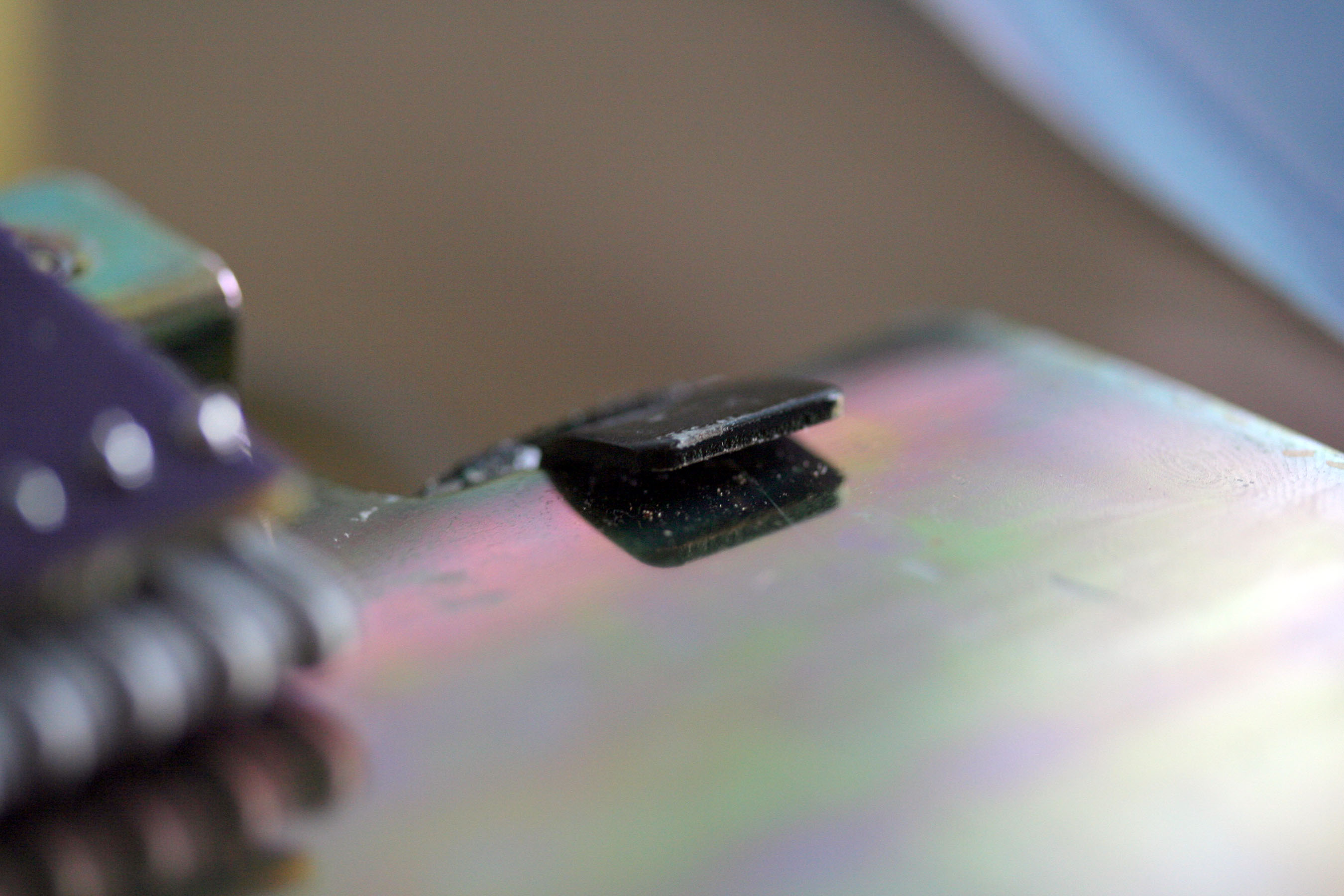

Thanks for the nudge: it really was as simple as all that! And now that I'm inside, I can see the problem. Exactly as I thought: the flipper under S is missing a leg. I'll swap it for backslash for now, but could really use a fix or replacement.

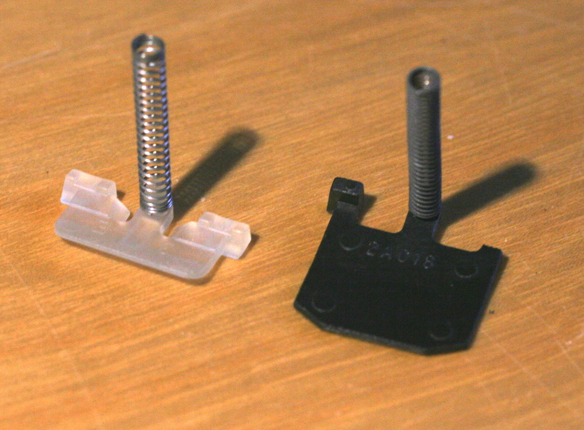

Capacitive buckling springs require the carbon infused flippies, which are different from the ones used in Ms. The only known source, unfortunately, is parts from other boards, whether through a board that is too far gone (yet to see one of those..) or one where there's a spare from ANSIfication, perhaps.
19 May 2014, 19:55
Correct. Here's my broken Kishy flippy, beside one of my Model M spares:

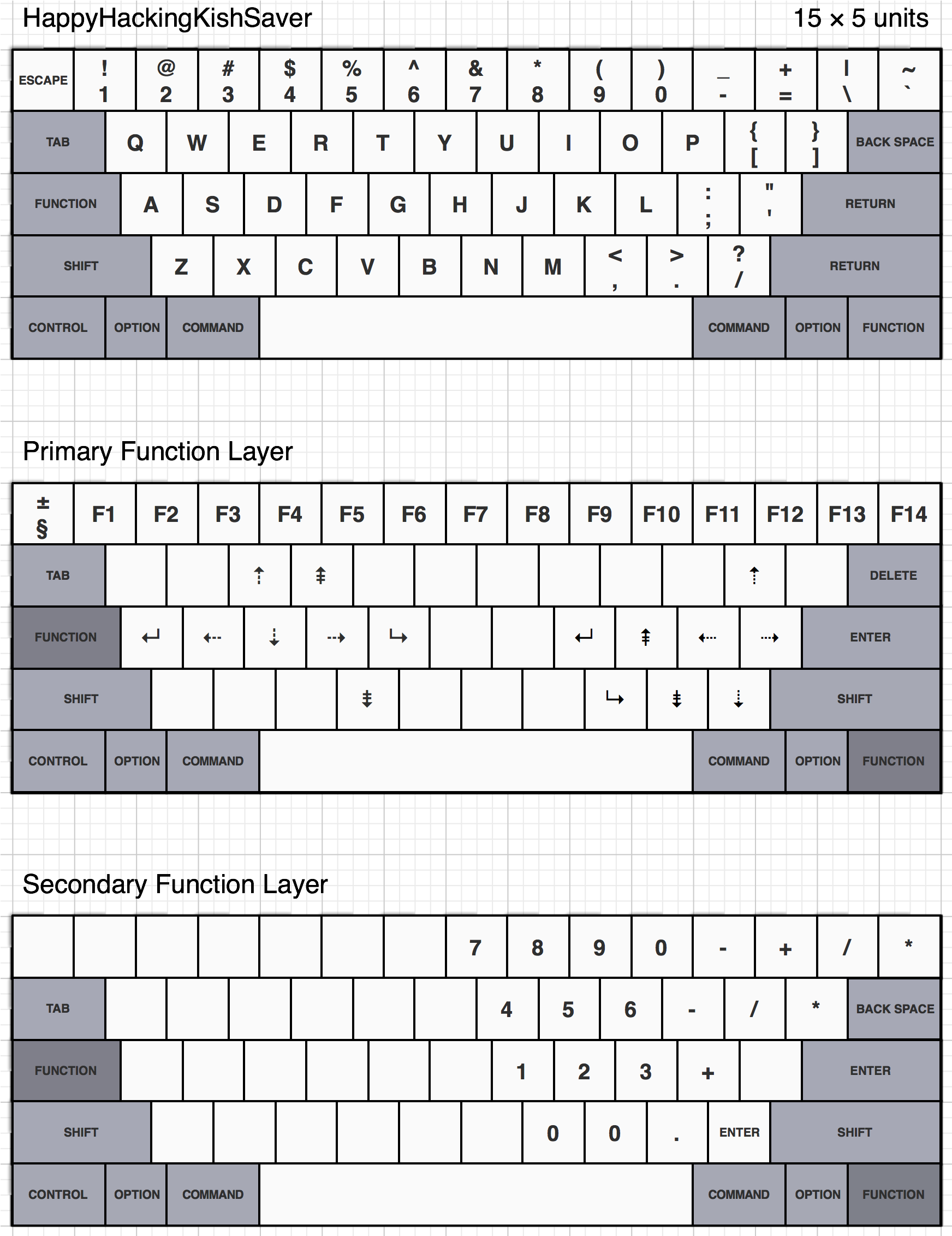

Meanwhile, I took out the dodgy flipper, did some rearranging, scrounged some caps from an ANSI Model M, and I have quite a nice layout now. Fully working so long as you don't hit space left of centre (which I don't typically anyway). Pics in a bit!
20 May 2014, 00:35
Tada!
Meet the Happy Hacking Kishsaver. Symmetric, 60%, capacitative buckling spring. Now my favourite keyboard of all!
Besides for the half-stabilised space bar – which I'm still keen to fix – it's working just fantastic! Xwhatsit's controller is superb, and these additional Model M caps have opened up quite the layout. Here's what I'm up to:
I could use a layer lock for that integrated number pad mode.
The only thing between me and true HHKB mania is the right shift key. IBM split those 2.75 units the other way around instead. In fact, here are all the options:

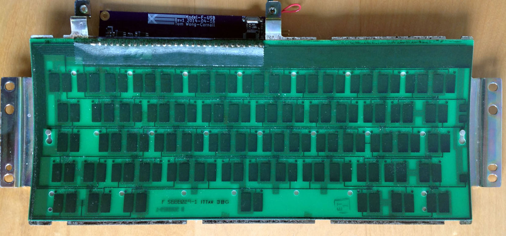

Bare PCB.jpeg (202.5 KiB) Viewed 17908 times
I swapped around flip plates so I could split the backspace key and go HHKB style instead. Fortunately, the Kishsaver even has a passable 1.5u Delete cap (PD2).
Now that I've been inside both a Model M and a Model F, I've got to say the F is superior on every front. Bolt modding is a ton of work compared to sliding this little guy open and closed. Here was what awaited me inside after barely any effort at all:

It didn't take long to find the S key…
Dodgy Flipper.jpeg (381.58 KiB) Viewed 17908 times
Going HHKB style means I lose one key over all, and so every other flipper is in use and working fine. I'd still like a spare, of course, so fixing advice for my failed one is still welcome.
