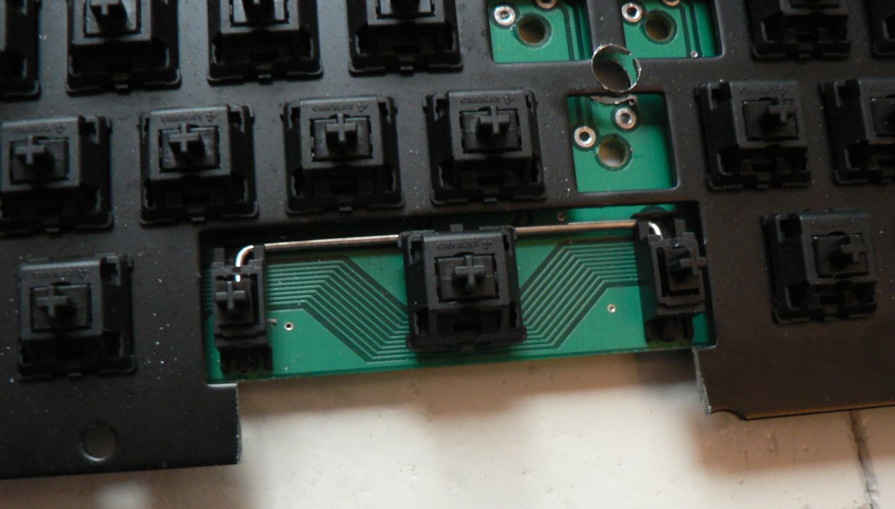

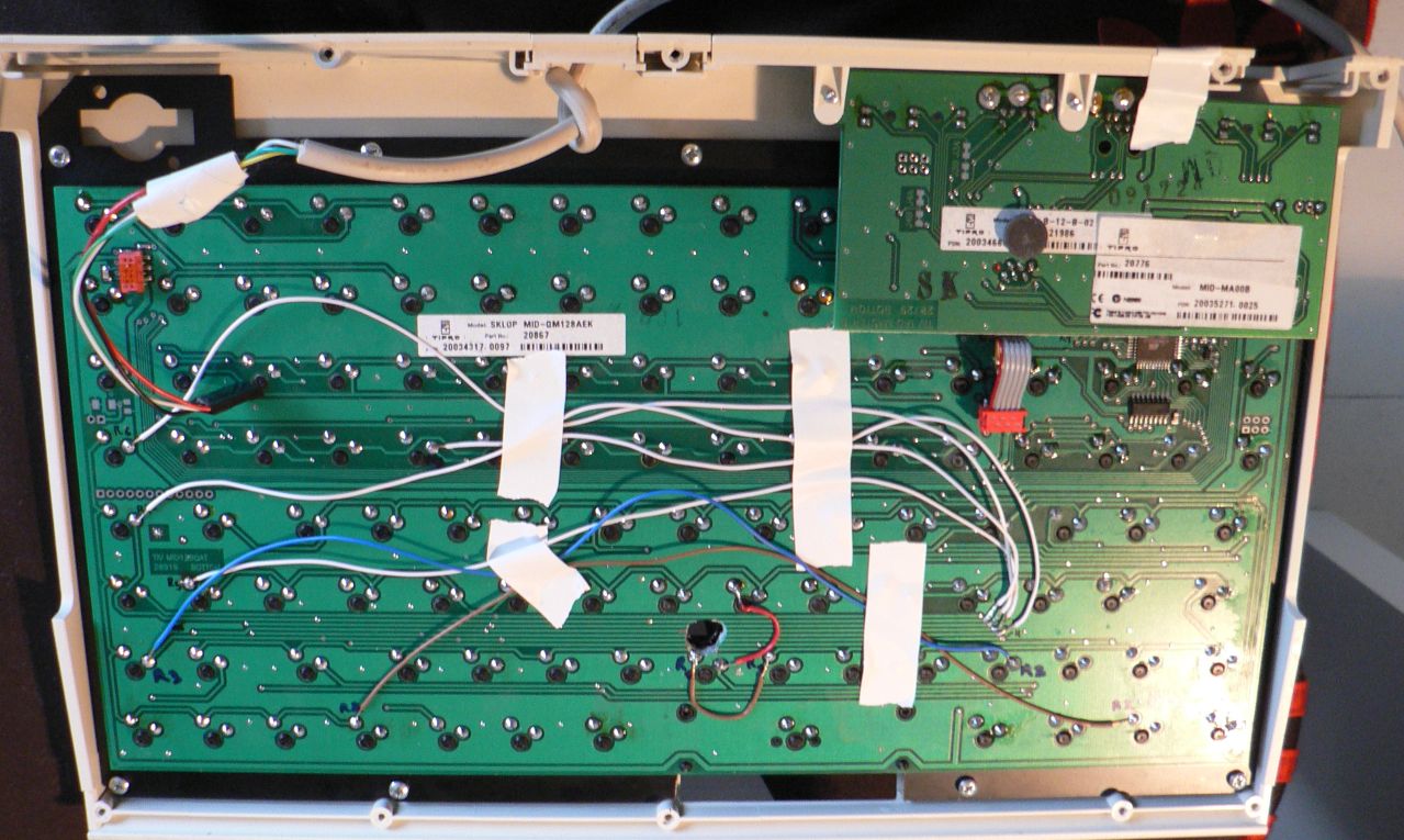

First, the result for the thumbnail at the mainpage: ;)
Is there a better place for cutting as much as possible lines?
pcb solder points.jpg (178.96 KiB) Viewed 15022 times

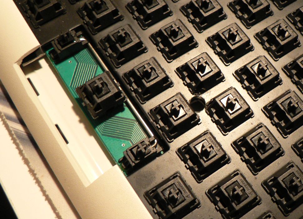

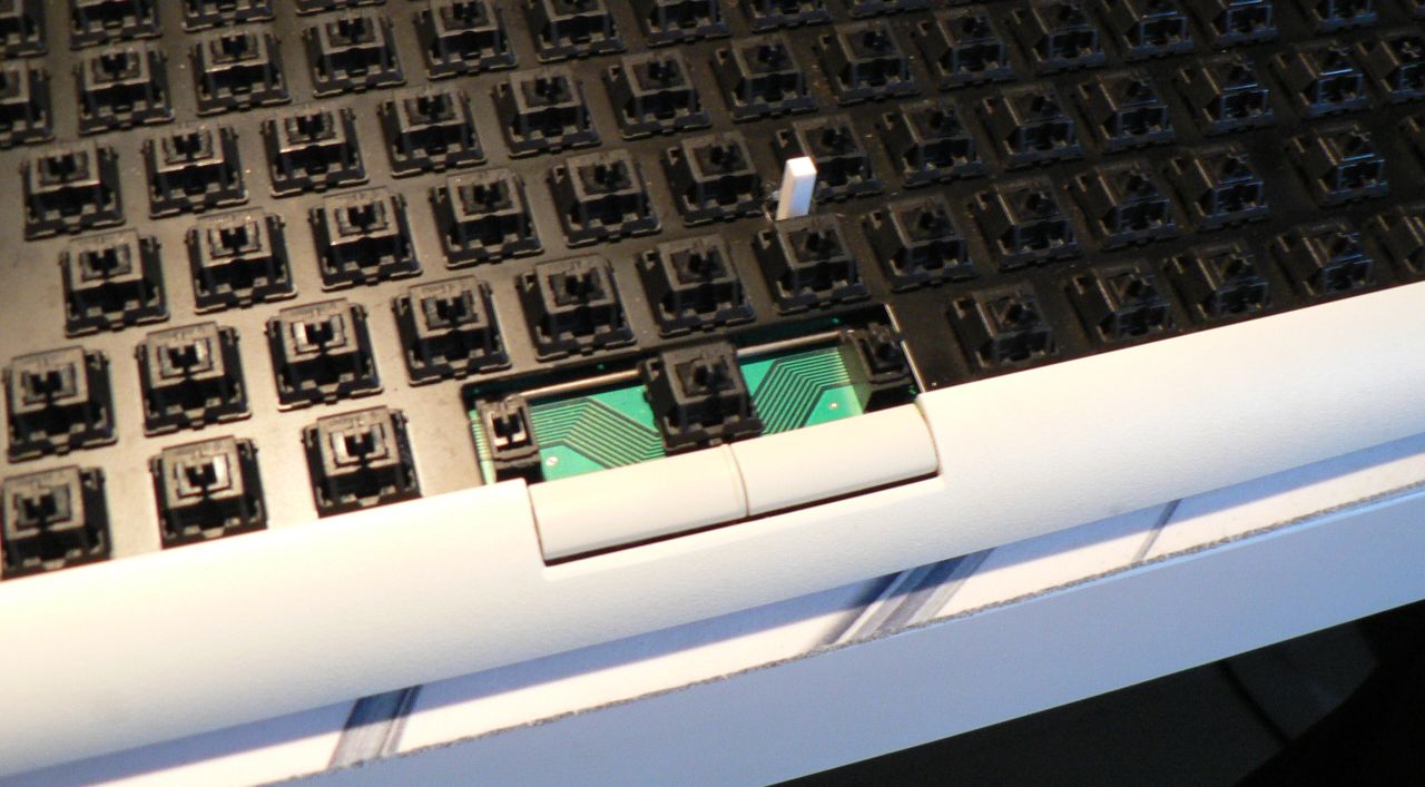

I wanted to keep the little side wings from the buttons. They keep the buttons down.

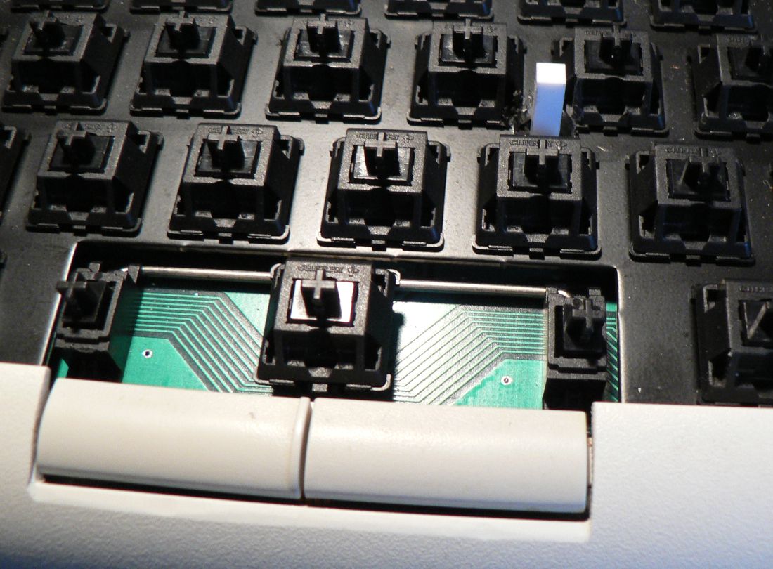

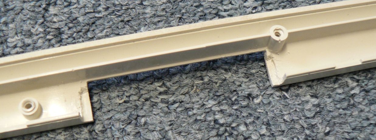

So i have to make place for the buttons and their wings (plastic scratching):
housing top - buttons holes.jpg (116.63 KiB) Viewed 15022 times
cut the iron.jpg (94.53 KiB) Viewed 15022 times

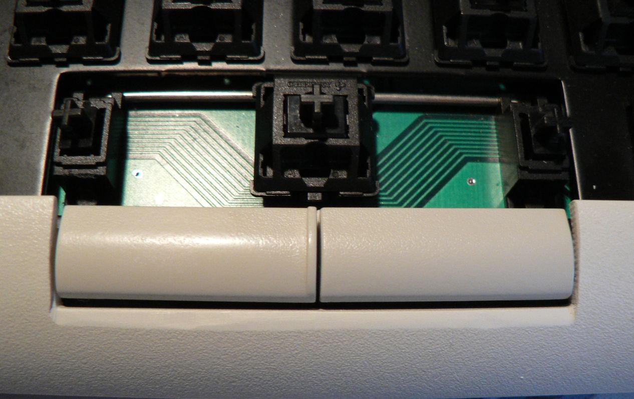

The holes:
tp and mousebuttons hole.jpg (140.95 KiB) Viewed 15022 times
The housing fits a little the mousebottuns so i kept them:

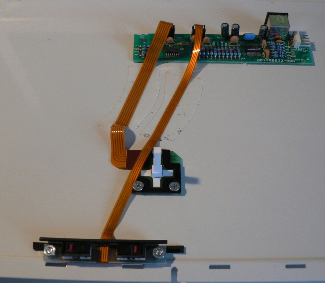

Searching the right fixpoint for the trackpoint:
tp mounting.jpg (74.47 KiB) Viewed 15022 times

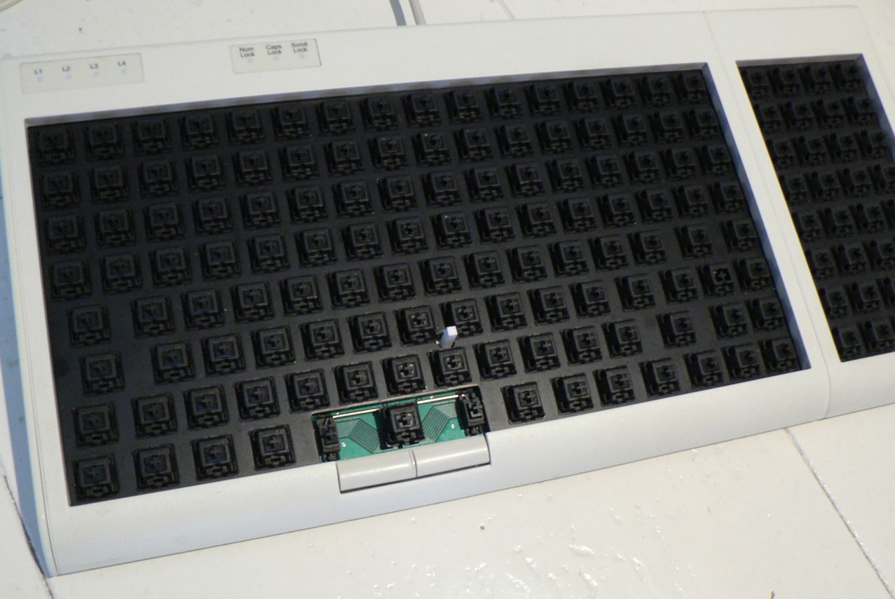

It's getting hot:
tp and mousebuttons.jpg (139.47 KiB) Viewed 15022 times
The PCB's from Tipro have tracelines on both sides! I knew this already from insert a touchpad.
Either way it's not easy with plate mounted switches ;)
I hope you enjoy the pics, thanks for watching.

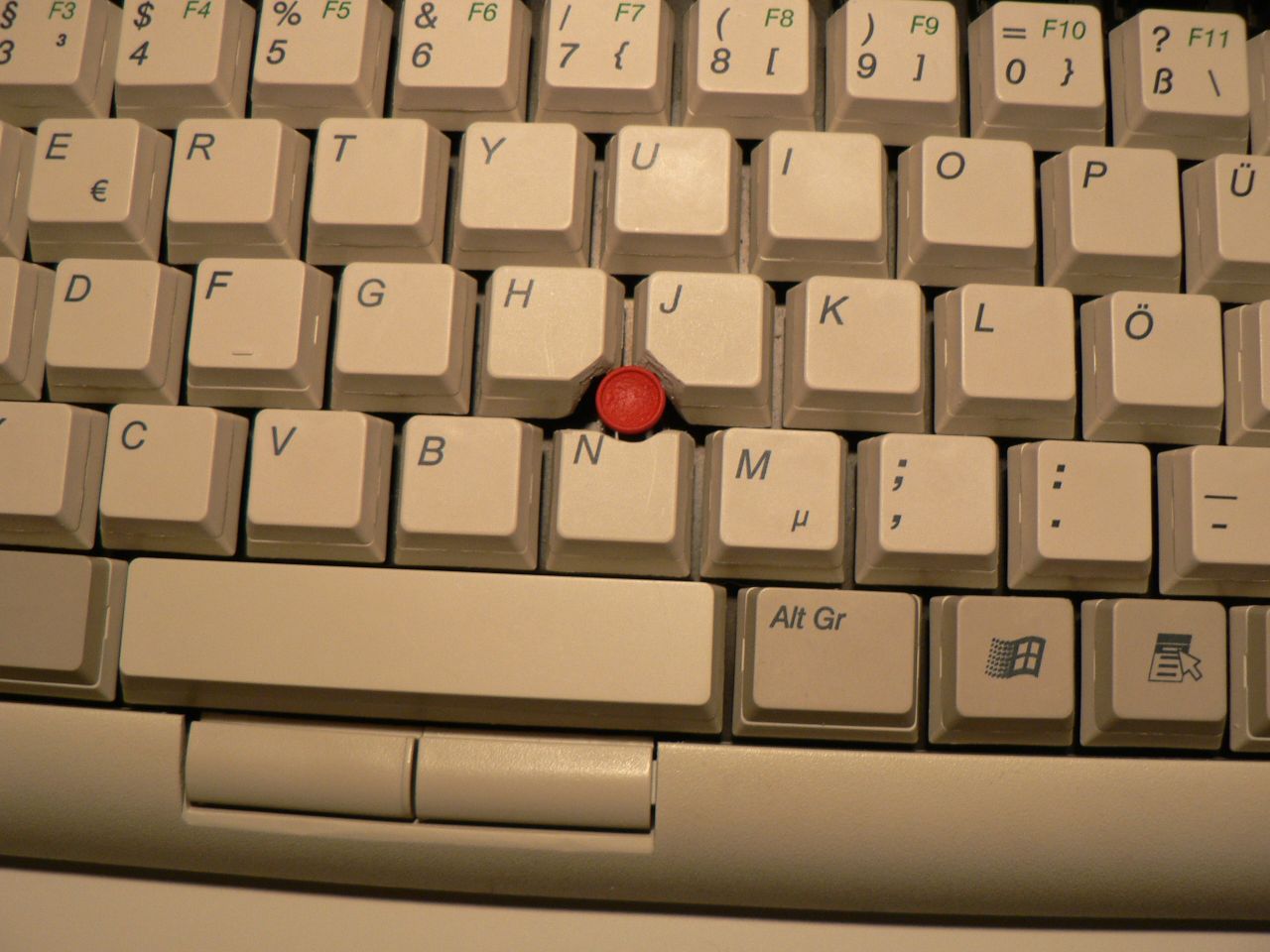

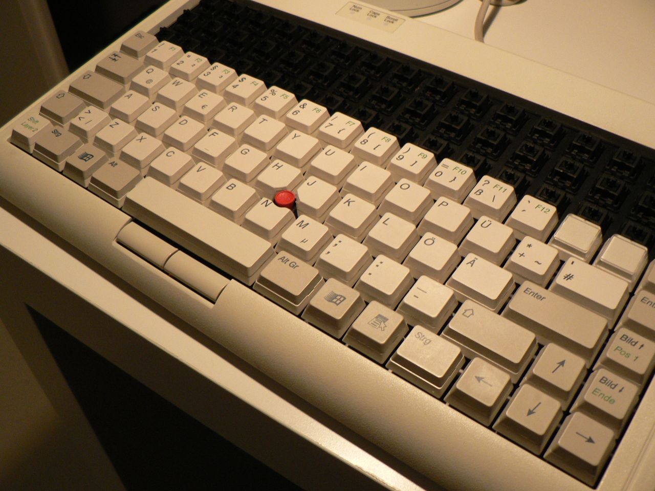

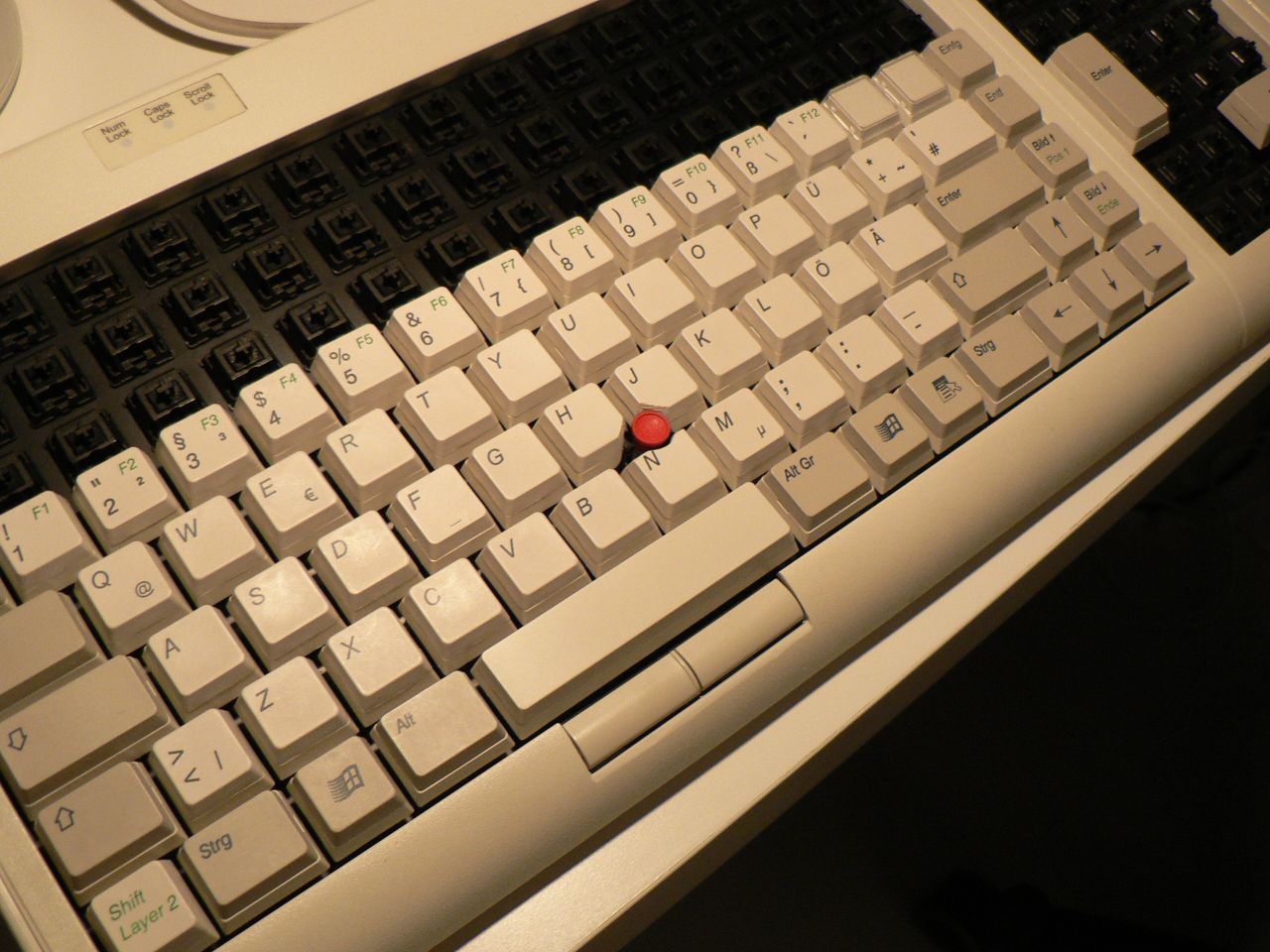

some more impressions
Unfortunately the Tipro 2 piece caps are not the best to cut/file...
Of course i will change the layout 2 ANSI.

How do you feel when you type H and N key? no problem?
I also always use trackpoint with my right index finger, that position of nub looks like easier for right handed.

04 Dec 2012, 11:48
hasu wrote:Greate job!
After a while i could say something about the usage. It' s good to have the TP between H, J and N. It's fine, because the nubble has the same hight as the caps. The optic feels a bit different. A few times i pusched my keyboard to the left "more in the middle". But the middle isn't here the TP is. ;)
Since the TP is there, i don't want to move my hands anywhere. So i put the arrow keys to JIKL 2nd layer.
Now i could live without a scrollwheel. "Scrolling" with I and K is good.
I want to put HOME and END also near by. I think about 8 for HOME and , for END 2nd layer.
Alternative 3rd layer I and K.
I changed also the bottom row to: CTRL, ALT, Layer3, Layer2, SPACE, Layer2, Layer3,ALTGR, Backspace
But Backspace is also set to SPACE 2nd Layer.
I'm also pleased with the TP buttons positions. In my next mod, i will try to put 2 or 3 MX switches as TP buttons down under the spacebar. Have to check the space there once again.
Otherwise as to my last mod for a working keyboard (2 time 96 matrix layout with touhpad) i feel confident in about 1 hour. It's my new daily driver at work, although i did not changed the switches from black to blue.

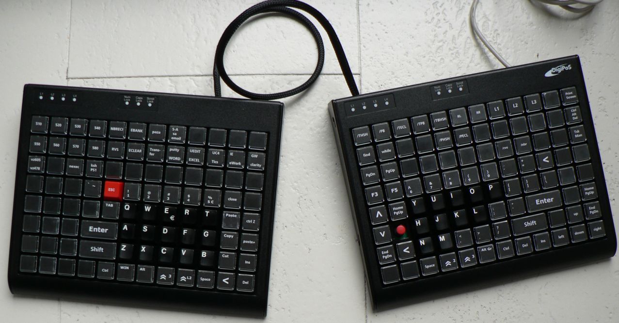

09 Mar 2013, 13:46
2x 96 Tipro w/ Trackpoint.
The TP is in a increased hole of a switch mount.
2x96 matrix w tp.jpg (128.43 KiB) Viewed 14412 times
The mouse buttons are the two switches in the lower left of the right hand modul.
Hope you enjoy the pic.
