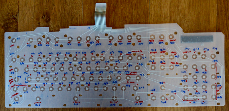

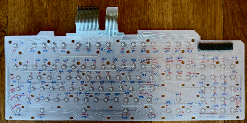

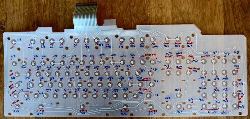

Posted: 04 Feb 2015, 15:43
by idollar
I did this some weeks ago, before putting together one of my Ms ...
I wanted to put the output into a matrix format. I will do it.
It may be useful. I have only seen a SSK matrix "decoded" in the DT.
I have contrasted and saturated the images.
The resolution is also reduced drastically. If needed I could post a better version of these.
