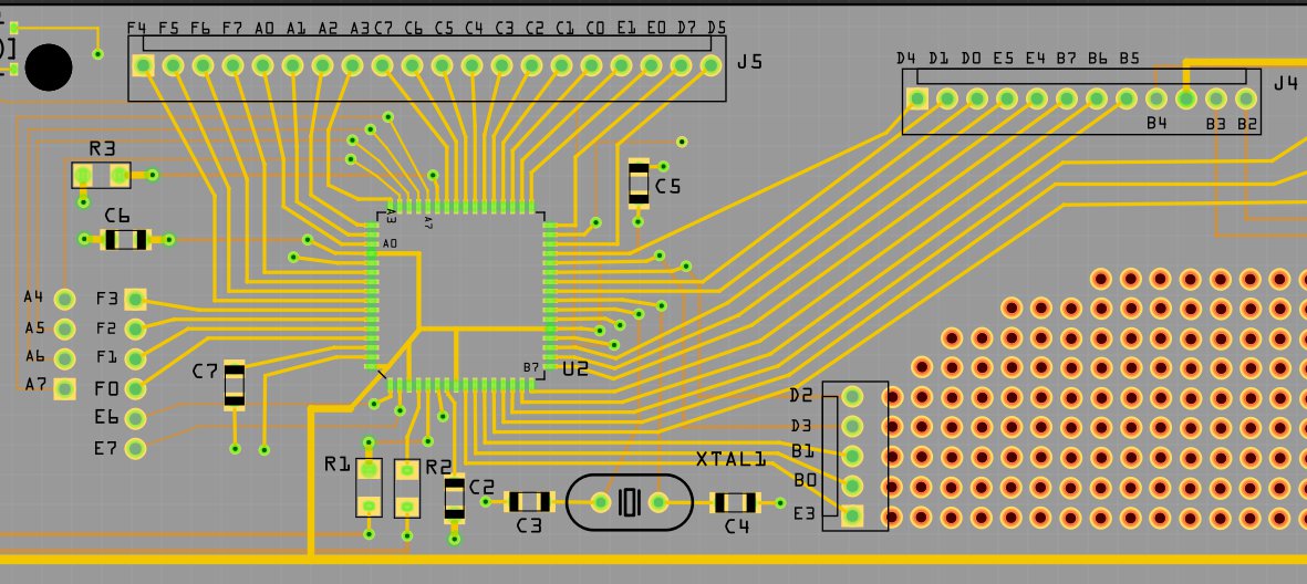

Hi ya'll! I'm like a cat when it comes to forums - I come around when I want attention or I have something I want to leave in your shoe. So here's a little something and it isn't dead. ^_^
I'm still working out small details and would like some input/ideas/see if anyone catches a silly mistake I've made. I know there have been other similar projects but they seem to have fizzled out or didn't have what I was wanting. Anyhoo, here's what we have: AT90USB1286 (Soarer's Controller/TMK/homebrew firmware), FFC connector pins for the various revisions (early with separate LED connector, later Lexmark era with LED traces integrated into the circuit membrane, SSK, 122 key, etc.), reset button next to USB connector (it will be a right angle button even though the picture shows a flat one), access to unused I/O ports and a little breadboard area for fiddling/expansion, and a right angle ground terminal for the plate. Since I enjoy soldering by hand I went with 1206 SMD's and the TQFP64.
I still need to add in the drill holes for mounting to the steel plate, and when used in those applications the ribbon connectors can be soldered to the other side. Also need a drill hole to accommodate the later M's with the smaller controller (there's the little foot-nub in the case that would interfere with its size). I'm thinking about putting in pads for a Mini USB connector since there seems to be space for the sake of personal preference. I prefer the sturdy USB-B, but I know other people like the mini. I don't have a Wheelwriter board, but since IBM was pretty consistent, it probably fits as well.
The exception at this point is the M13. Yes it would fit, but no Trackpoint provisions. Which leads me to a side question: can TMK firmware as a converter (not controller) handle PS/2 inputs for keyboard and mouse simultaneously? I remember reading it was problematic but haven't looked into it much since then.
When it's finalized I'll make available the design files. This is my first time designing a PCB and I'm using Fritzing to do so.
Ideas/suggestions/requests?

YES! That is a very interesting project, I'd be interested in buying a PCB and helping with the software.
I'm bluetoothing my SSK at the moment based on a Teensy++ (same AVR chip you are using) controller with TMK software, a Bluefruit EZkey and a little LiPo loader circuit. What I'm doing is partly quite similar to this, but I didn't think of making a custom PCB for that yet. That would be most welcome though!
Fortunately, this Atmel chip has LOTS of pins... To speak to a bluetooth chip (or other interesting peripherals on the breadboard part) it would be nice if D2 and D3 (AVR UART RX and TX) would be free and available on the breadboard area, as well as maybe one or two free ADC pins and a few digital SPIO pins. In my experimenting at the moment, I'm using D2 and D3 for UART RX/TX, three outputs for bluetooth pairing, bluetooth reset and a battery on/off LED respectively, and 2 digital inputs for sensing status of a battery on/off switch and Bluetooth, and an analog input for sensing battery voltage. So 8 pins all in all, in addition to voltage and ground.
Another idea you could steal from the teensy would be the possibility to use a MCP1825 voltage regulator to let the controller run on 3.3 V. (https://www.pjrc.com/teensy/3volt.html) This saves about half of the power that the AVR chip needs (https://www.pjrc.com/teensy/low_power.html), and I don't think the Model M matrix will have a problem with that at all. You can see how they did it in the schematic: https://www.pjrc.com/teensy/schematic.html

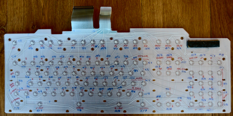

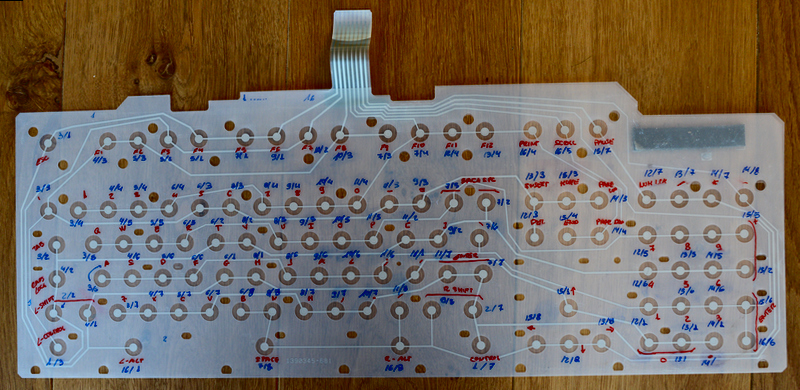

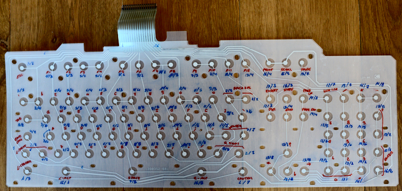

I did this some weeks ago, before putting together one of my Ms ...
I wanted to put the output into a matrix format. I will do it.
It may be useful. I have only seen a SSK matrix "decoded" in the DT.
I have contrasted and saturated the images.
The resolution is also reduced drastically. If needed I could post a better version of these.

Okie dokie, I made a few changes. D2 and D3 are now free, as well as F0-F3. It looks like I can move the crystal to where the free port jumpers are on the left side, and move most of those to the breadboard area. Question is, what should I leave where it is?
I'm curious about the LiPo circuit, can you give me some more info? I'm sure I can add in traces and pads over there...
Is it possible at that point to use it as a wired AND bluetooth keyboard? I'll work on placing the voltage regulator, shouldn't be a big deal.

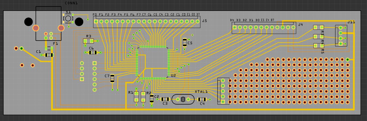

Parallel won't work, but it loooooks like I have enough space to put pads in for a Micro right above the holes for the USB-B. Can anyone recommend a specific high quality connector brand/model I can plan for?idollar wrote:Question: why don't you put in pads for Mini and USB-B and direct soldering of the cable all in parallel ? The user could decide which one to mount. The top left side of the PCB should have space for all if they are not mounted at the same time.I'm thinking about putting in pads for a Mini USB connector since there seems to be space for the sake of personal preference. I prefer the sturdy USB-B, but I know other people like the mini. I don't have a Wheelwriter board, but since IBM was pretty consistent, it probably fits as well.
Just an idea ...

Could you leave a set of through holes for the 4 USB lines, for those of us who like to string up our own socket on the keyboard chassis? That'd be mighty convenient! If so, labels please!
The standard names and numbering are here:
http://pinouts.ws/usb-pinout.html

Can and will do!Muirium wrote: Could you leave a set of through holes for the 4 USB lines, for those of us who like to string up our own socket on the keyboard chassis? That'd be mighty convenient! If so, labels please!
Going to need this little provision for terminal boards anyhoo.
