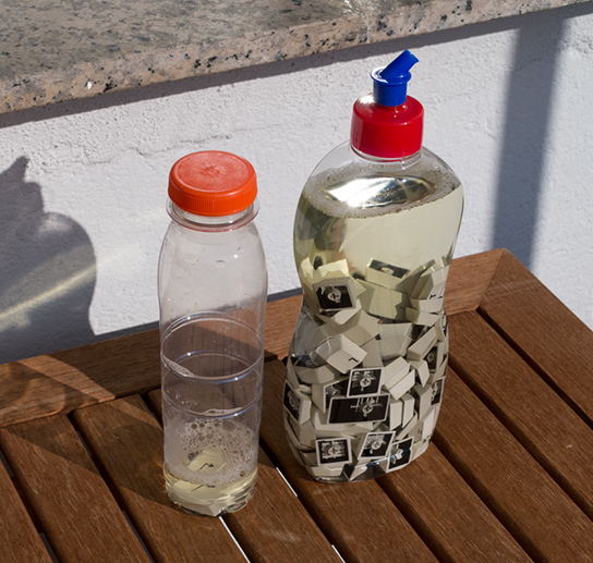

Jmneuv
06 Jun 2013, 09:08
Finally my attempt is underway.
Managed to get my oxi powder solution clear this time by doing 2 things:
.used distilled water at ~80°C (we have a fair amount of lime in the tap water)
.ground the powder finer on a piece of paper with a tool handle (just a quick pass)
this also helped to dissolve it pretty much instantly
(was too stingy to buy liquid vanish)

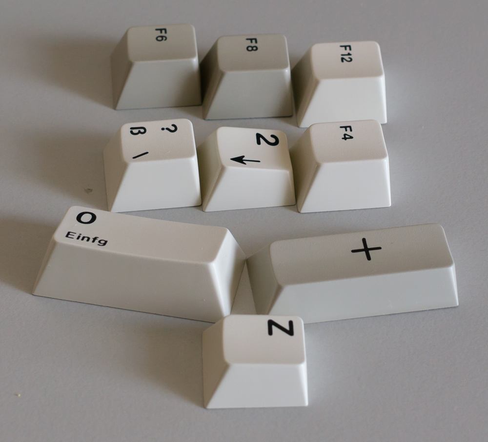

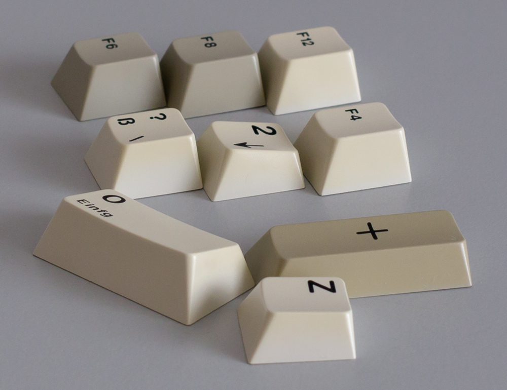

Jmneuv
07 Jun 2013, 15:20
Retr0bright is good for you!
.. after 2 mornings (~4 hours) in the plastic bottle in direct sunlight (and the rest of the first days in the shade).
First day removed the yellowing, 2nd was for good measure.
