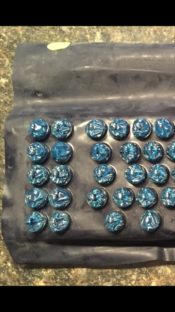

This was the best one I have ever seen (pre-cleaned) in person. The rubber was flawless, close to as I would have imagined it new, but after using the others without (and thinner replacement) barriers, I still hated it. Too thick, and made the switches heavy and thunky. I saved it, but it has been replaced

The shield on my 5251 was completely intact and came off nicely. Still left it off, it really does just completely ruin things. Lots of keys affecting other keys. I haven't had any sensing issues, though I haven't had it more than a couple of months.

Hm, but if the switches are as vulnerable to dust and crud as Parak said in his GH thread.. My main priority for my beam springs is preservation, and it does seem possible to apply plastic wrap so it won't affect the switch feel too much.

Your shield makes the keyfeel that way which is why you can toss it. Anytime you see...
you can be sure your shield is long overdue! A proper shield will not change the keyfeel at all. With all this in mind I'd say Beamspring is easily the one of the most "delicate" and elaborate keyboard constructions I have even seen. When the setup is right the payoff is phenomenal.the buttons around it get pulled towards it.
While the shield on my 5251 looked OK at first the full extent was only visible after I pulled the caps which everyone should be careful with on Beamspring. In certain areas the behaviour was exactly the same as you describe y11971alex.

You should roll without a contamination shield, you get much better feeling. Not unlike other contamination shields people wear on there plungers

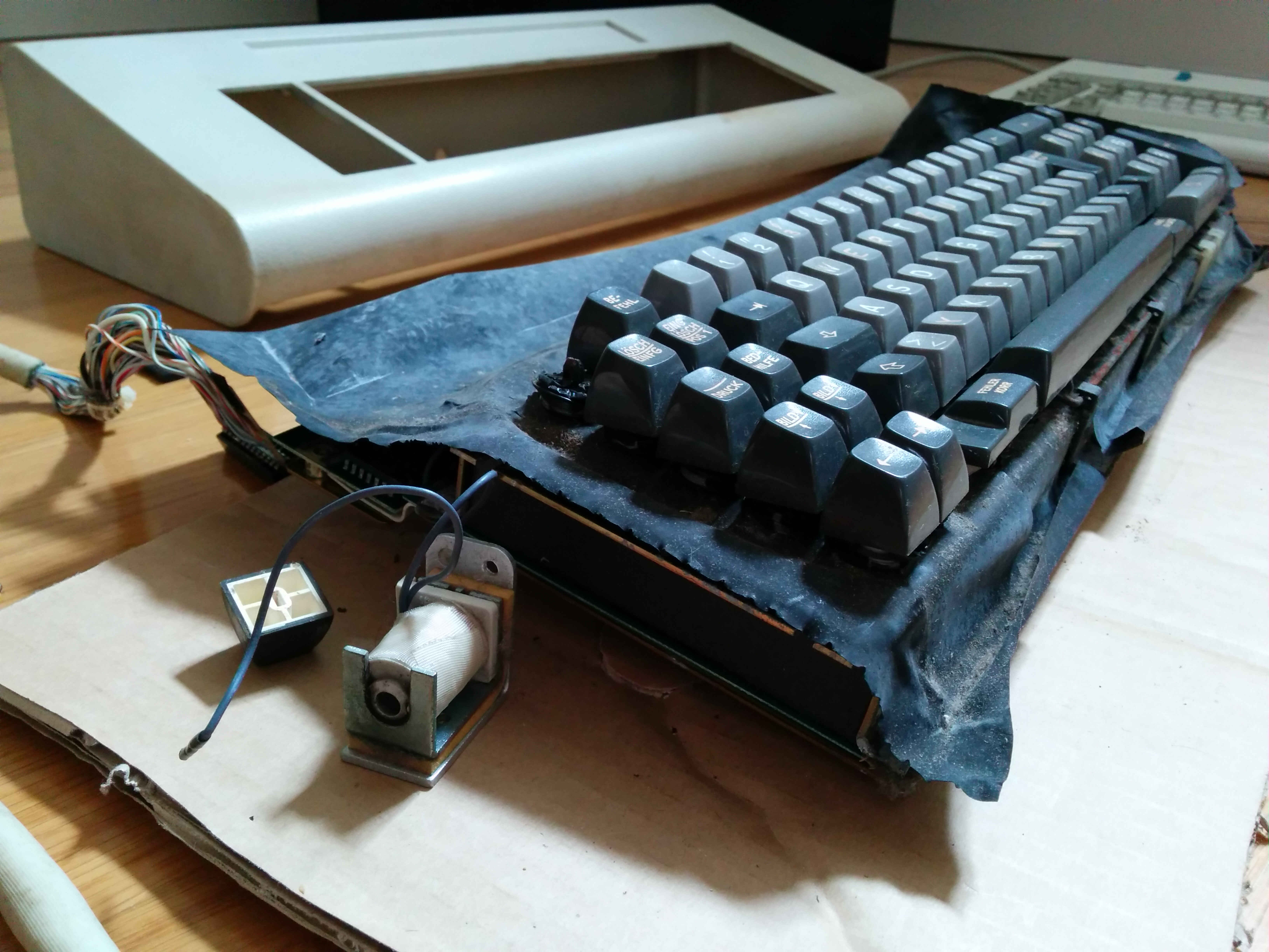

I just realized that I may have purchased the youngest of the beamsprings... Jun 15th, 1984. Its 32nd birthday is coming up! Powder coating is taking longer than expected, and I hope to assemble in good condition before that date.
- y11971alex
- Location: Toronto, ON
- Main keyboard: MacBook Air
- Main mouse: Microsoft Sculpt Comfort
- Favorite switch: buckling springs
- DT Pro Member: 0172
My keyboard's back with a little surprise! It turns out, it probably had a little cutout for the door as on chzel's board, but was subsequently welded back, for some reason. The sticker at the back mentioned that this keyboard was actually used by IBM... so perhaps it was an IBM mod or something.
I remember distinctly that I had asked for beige powder coating, but the guys that did it were either forgetful or colourblind! Here's a comparison with the Model F. Since it is now silvery grey, I guess it makes this an industrial beam spring.
And here's a comparison with my XT from another angle. It's definitely "low profile and ergonomic", like Muirium said.

Despite the wrong color, I think it looks good, maybe better. Should ask for a discount or redo though if you aren't happy.

Honestly, I think they blasted off the colour before thinking about matching the new colour. I pointed to the case and told them to match the colour of the old paint.
Interestingly, they said the case was more likely to be aluminum, given the "corrosion", which is the rectangular mark around the door. That's definitely a strange way for corrosion to spread!
