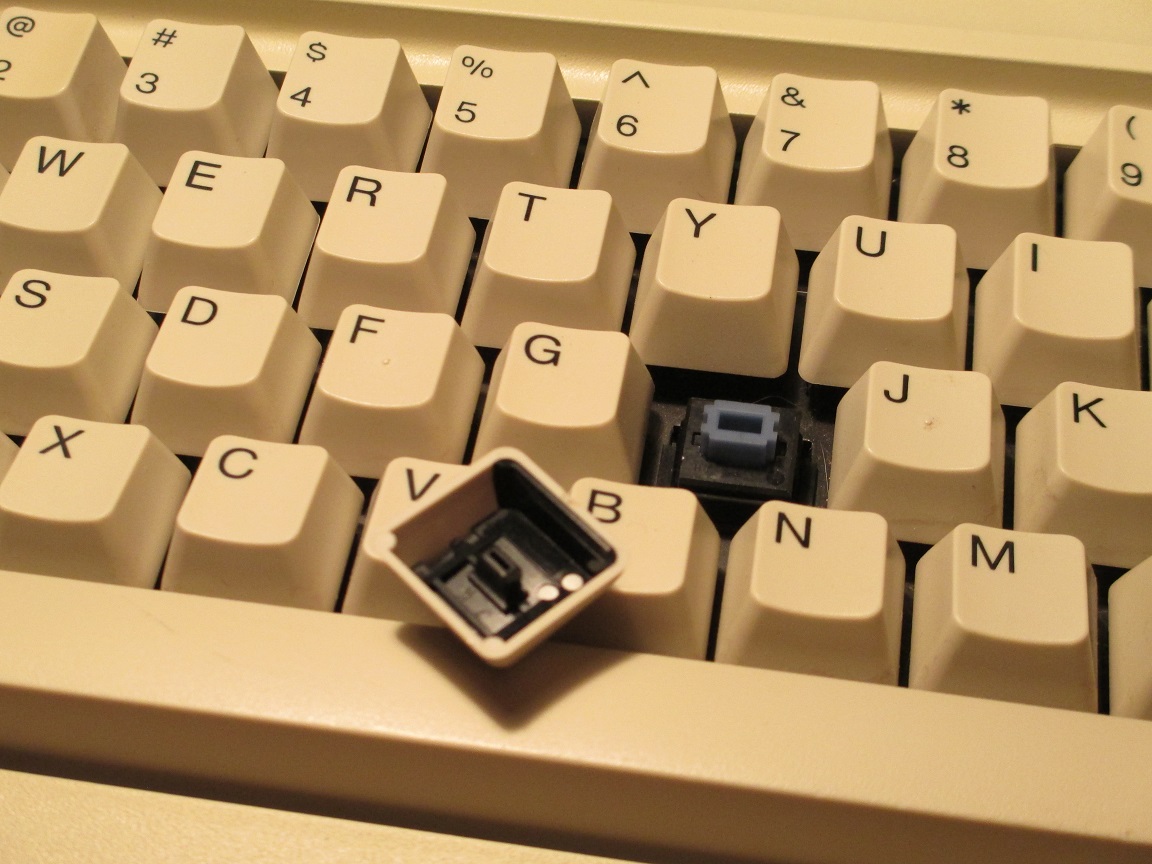

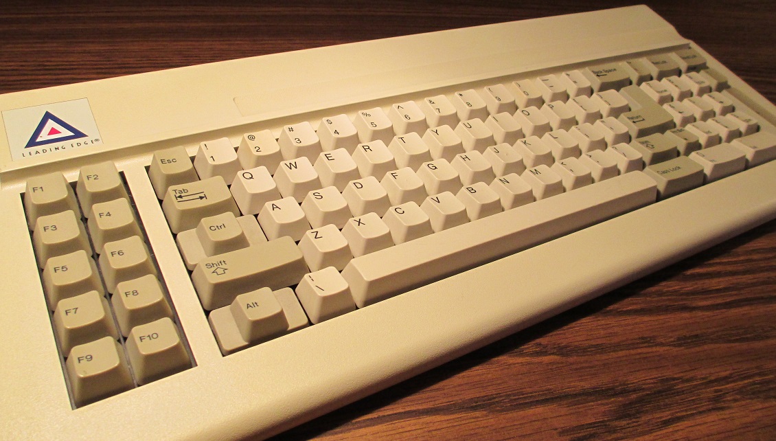

Today I unboxed a new treasure from eBay -- a Leading Edge DC-2014 keyboard with blue Alps switches and doubleshot keycaps. Here are a couple of pics of the board right out of the box. The keyboard was in excellent shape and quite clean for an eBay purchase.
This arrival was exciting for me, because it is my very first blue Alps keyboard. I have other flavors of Alps and Alps clones, but no true blue Alps.
I was able to get the board up and running with a Hagstrom converter, so that I could properly test the typing action. Now I can better understand why many people favor blue Alps above all other varieties of this switch. Blue Alps are indeed quite smooth with excellent tactile feedback. The weight of the switches also seems just about right for me -- not too heavy and not too light. The click is not overly loud and the key travel is ideal.
After gaining experience desoldering lesser switches and building one or more custom boards, I would like to take the blue Alps switches from the DC-2014 and put them into a custom 60% board. I could also use the alphanumeric caps from the DC-2014 in the custom build except for the right bracket key, which is oversized in the XT style. I have an Ortek MCK-101FX, which I think has keycaps that match those on the DC-2014 (although the switches in the Ortek are clones of white Alps).

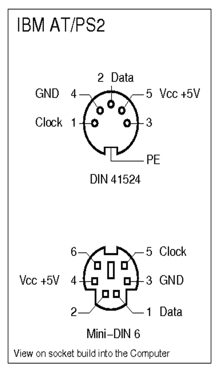

You are not killing it. Consider harvesting organs from an already-dead corpse for their 2nd life.Hypersphere wrote: Haven't killed the DC-2014 yet. I am open to suggestions on how best to convert the keyboard to USB so that it would not have to depend on the Hagstrom box. However, I recall reading that Soarer's converter does not work on the DC-2014 -- is this indeed the case? In addition, I have grown quite fond (dependent, actually) of the 60% form factor and HHKB layout. While it is a pity to destroy a classic keyboard, I would get much more use out of a custom 60% that at least employed the switches and most of the caps from the DC-2014.
You can attach the 5th wire (the previously unused #3) to PD7 on the Teensy and I think that the latest Soarer firmware will pick up on it and use it.

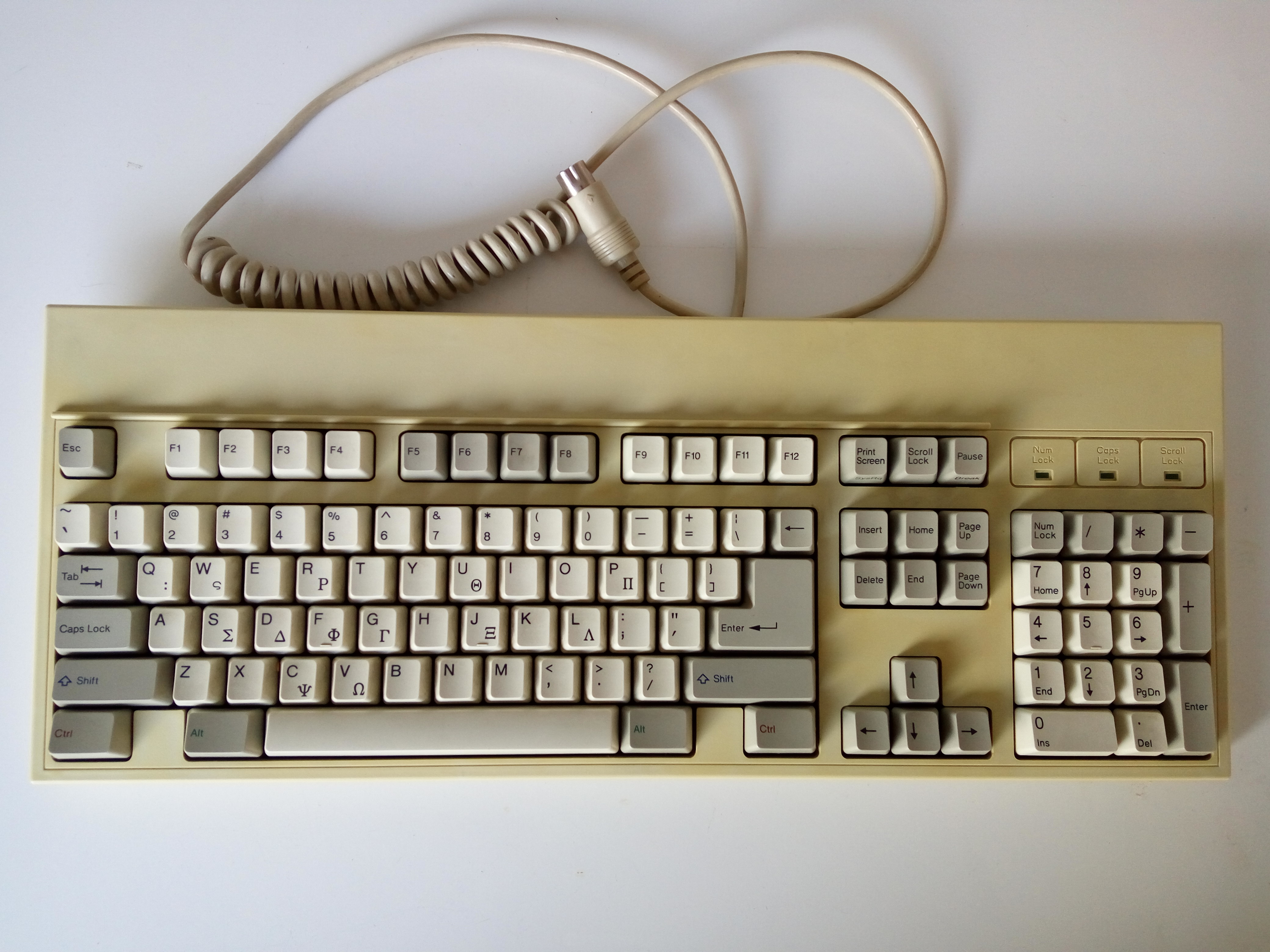

Well, my DC-2014 had yellowed key caps, and then there's photos like this one:
Off-topic: To be honest, I would also be interested in seeing the results of an acetone test for the MCK-101FX key caps.
EDIT: A quick, potato pic, but the color difference is there.
