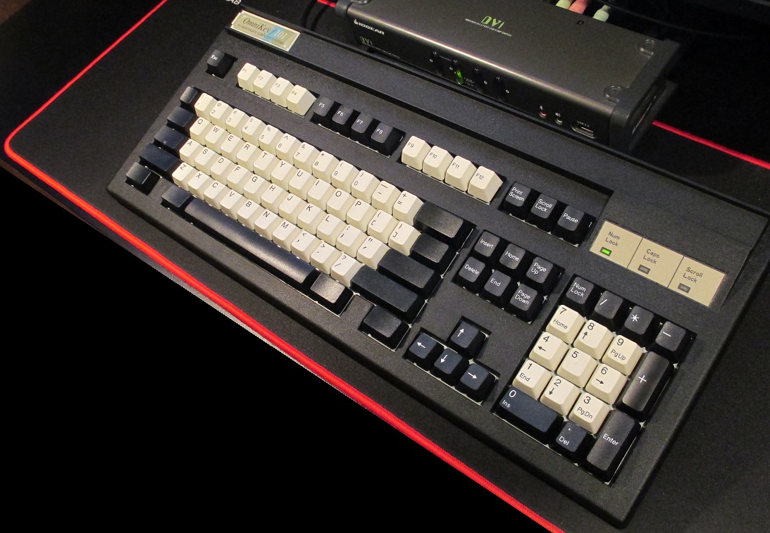

Orihalcon made some internal USB Soarer's converters for me for the Northgate Omnikey 101, and I installed one of them today. It works beautifully.
The converter has a header than connects to the pins on the keyboard's PCB:

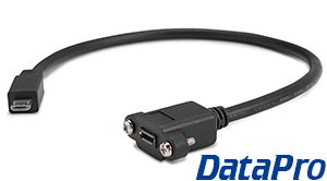

There is plenty of room in the Northgate case beneath the PCB for the converter and a DataPro micro-USB panel-mount connector with cable.
http://www.datapro.net/products/usb-mic ... e-m-f.html
The cable plugs into the converter and provides strain relief for the micro-USB connector on the converter.
The panel-mount connector aligns perfectly with the holes that are already drilled in the case for the original mini-DIN6 connector, so it is not necessary to drill new holes. The dimensions on the drawing below are in mm, and the connector is rotated 90 degrees for installation.
I use a micro-USB cable with a right-angle connector to connect the keyboard to a USB hub and KM switch. I've programmed the Orihalcon/Soarer Converter to give me some HHKB touches, such as swapping Backslash and Backspace, mapping Right Ctrl as Fn, and setting up a cursor diamond despite the redundant arrow keys. Moreover, the USB converter should take care of the hot-swap issues. Thus far, everything is working as expected. This was my easiest converter and panel-mount connector installation yet -- the Northgate chassis is a joy to work with.
The cleaned and lubed white Alps switches are smooth with just the right amount of crisp tactility and clickiness for me, and the Northgate build imparts a feeling of reassuring solidity. I really like this keyboard!
