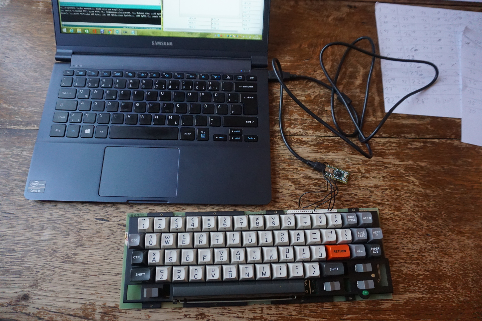

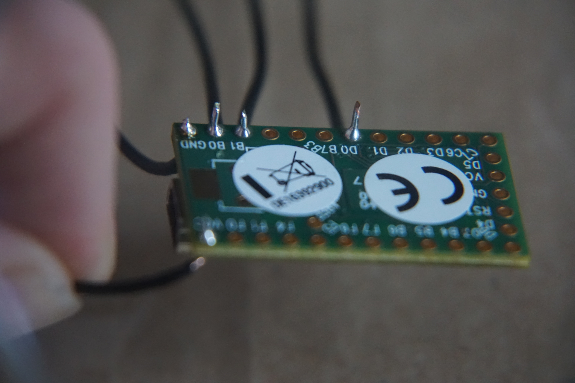

Ok, I have decided to go for the TI silent first. These have scan modules, with one input that can be pulled low and one output that will switch to low if the key is pressed AND the input is low. I completed a proof of concept today, connected two drive columns and one sense row. When you look at the keyboard from above, the pins in the connector are counted from the right:
 Board  | Teensy | Comment
  4     | VCC    |
  5     | GND    |
 12     | B1     | drive input for '1'
 17     | D0     | sense output for '1' and '9'
 18     | B0     | drive input for '9'
My first solder job ... can only get better from here :oops:

OldIsNew
23 Jan 2018, 16:25
Slom wrote: I completed a proof of concept today, connected two drive columns and one sense row...
Nice work! Great to see progress like this - hope you have time to continue with it!
Slom
23 Jan 2018, 17:18
I completed the conversion yesterday (safe for the mechanical toggle switches and the LED):
post398120.html#p398120
I will do a proper write-up once I find some time. First I have to decide where to put the source code. Another open point is checking whether the second TI Silent I have shares the same matrix and pin-out.
I should also mention that your work was a great inspiration. Thank you so much!

What is next? now that we have a keyboard confirmed to work with an output control pin, we can characterize it further. I will feed a square wave into the output control pin and see how "fast" it turns the output on/off I strongly suspect it's faster than powering/depowering the switch entirely and using this we can achieve a 100KHz scanrate (or better?) Using the power pin to control output on/off we can only reliably use a scanrate of perhaps 40 kHz or so. Also looking at the shape of the waveform as we turn the output on/off with the output control pin will be good.
But now that the underlying mechanic has been tested and verified by two people, we can start converting these keyboards to USB very easily using normal sense/scan techniques. Debouncing is likely not needed but that remains to be seen. And then "because we can" we can crank the scanrate up to 100KHz and have proper "gaming" switches from the 1970's.
I'll work on my homework today and if I get a chance, I'll solder up a quick test fixture on a switch with a pull-up resistor and post some preliminary results. Note that due to the much higher input impedance of my DMM (over 10 MΩ) a pull up resistor was not necessary to test the switch, but it is required for a 50 Ω impedance of my scope. This is why I have no scope shots for now. Discerning the switch you can "see" it rise up, but not enough for proper characterization. Then I'll write up a post and put it on GH and DT but I get better feedback here, so I might make the switch to being primarily on DT's workshop forum than GH's MST.
That's all for now. Very exciting news and many thanks to slom for reporting on this.
