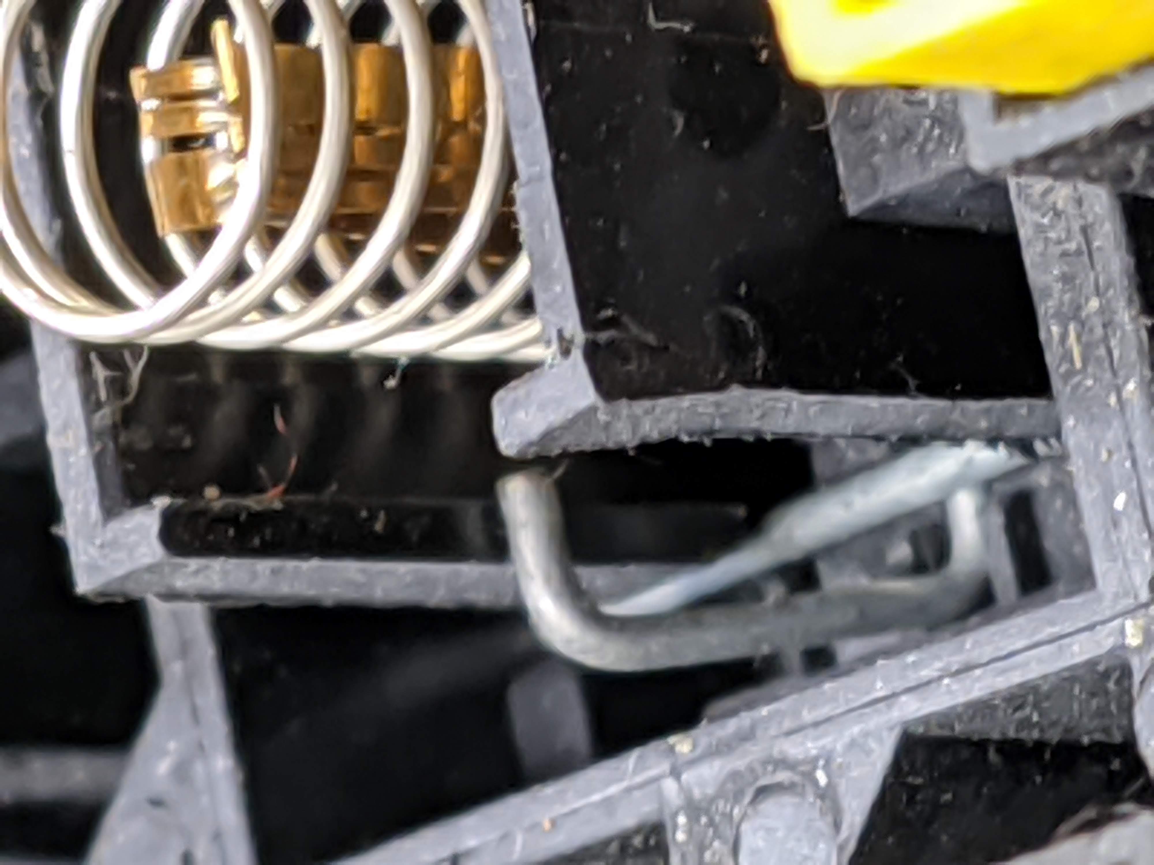

Hello everyone,
I recently got an old dumb terminal with stackpole switches. Luckily none of the stems are cracked, and all the switches work well, except for the two latching keys.
They have a little wire that interfaces with the key, and when I get it seated correctly the key will latch/unlatch once or twice, and then the wire falls up, away from the key, and the key pops out. Is there supposed to be tension on this wire piece? Is anyone familiar with this issue? I don't know much about vintage keyboards, so I'm really not sure how to fix this.

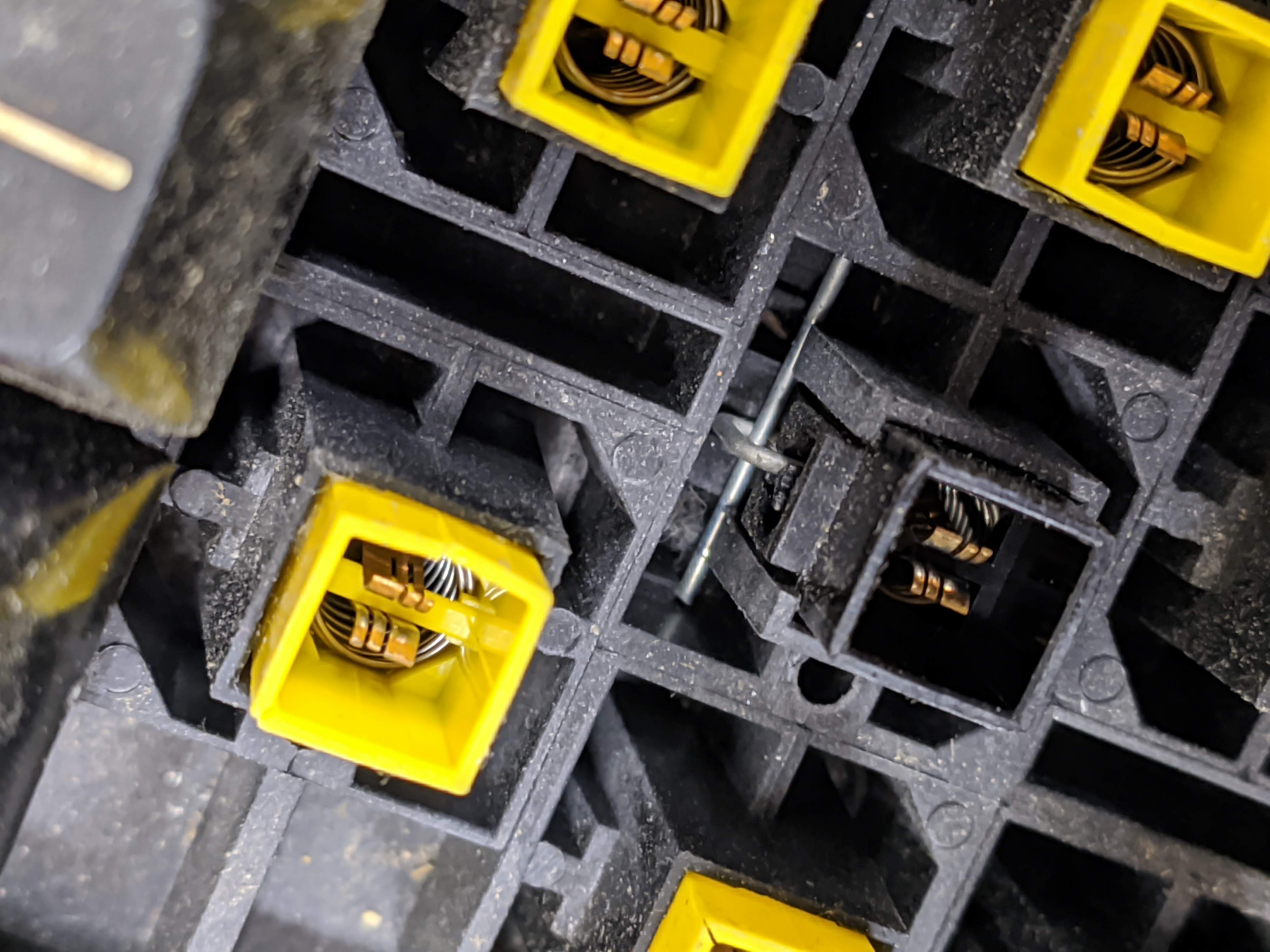

Here are a few photos showing the key and wire mechanism. (Please ignore the small piece of paper, it's just there until I resolve this issue with the key)
Thanks!

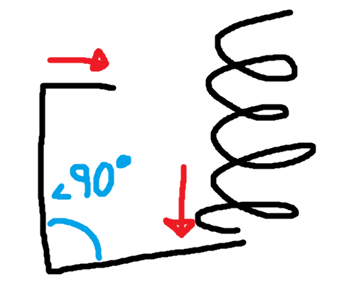

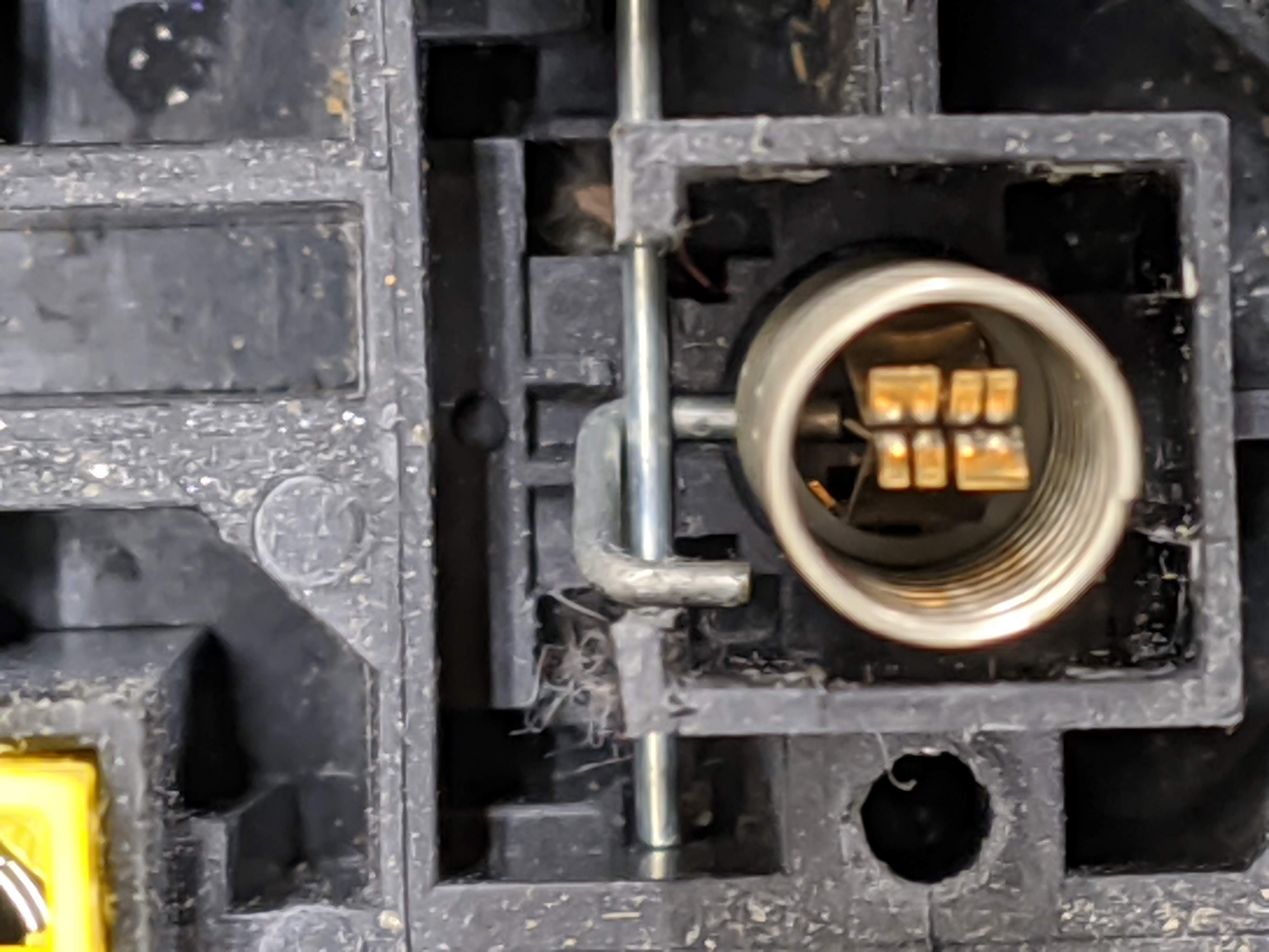

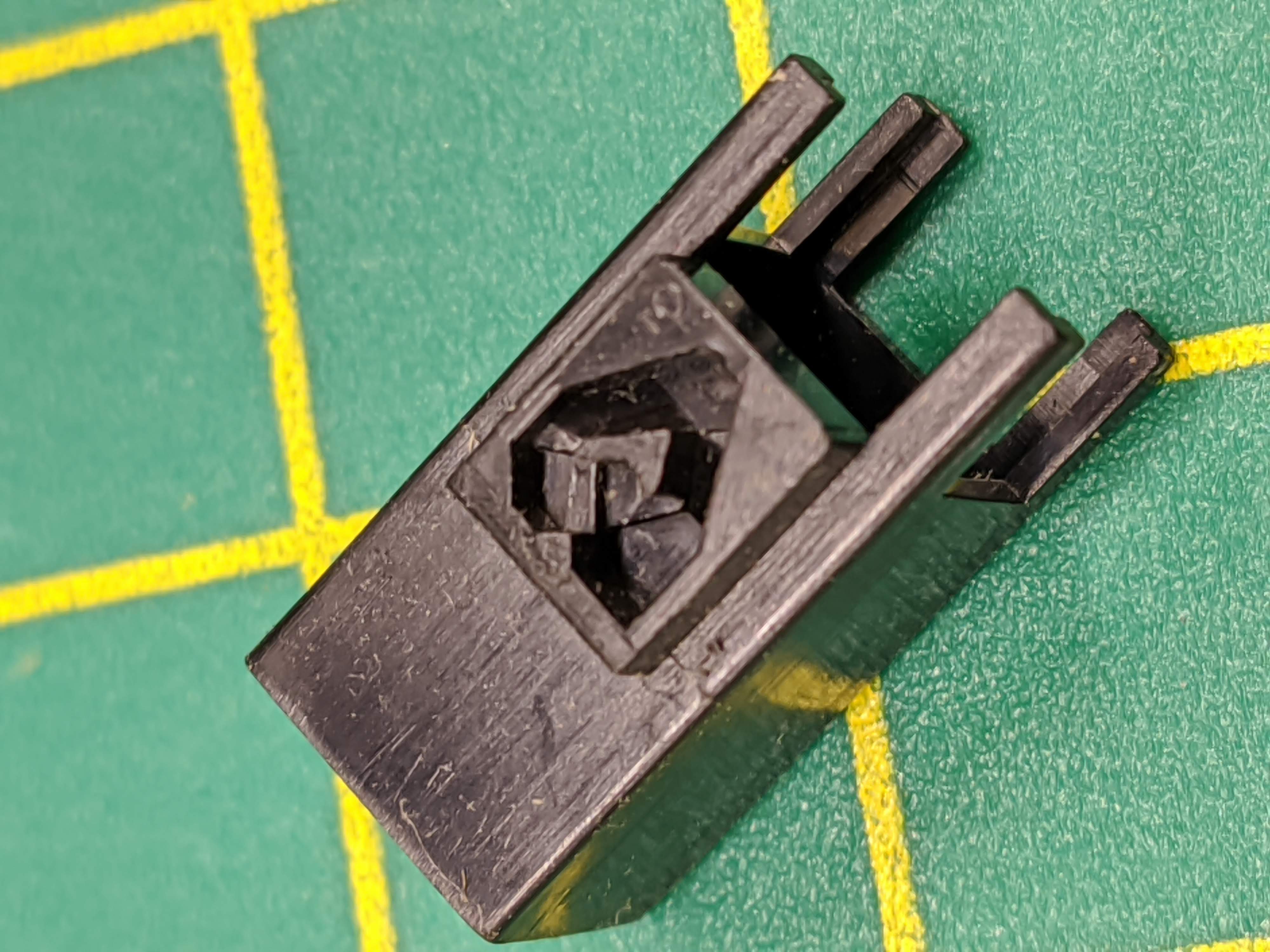

I'd bet the wire just isn't engaging the cardioid track enough. I think the spring is supposed to push the wire into the side of the slider. You might just need to bend the wire a bit to get it to bite. It also looks like there might be some crud in the track that could be kicking the wire out.
Here's a working one for reference:

Got it!! Your drawing did the trick. The spring has to be seated just right, or it doesn't tension the wire at all! Thanks so much!
It seems like the springs aren't quite strong enough to keep the wires in place 100% of the time.
