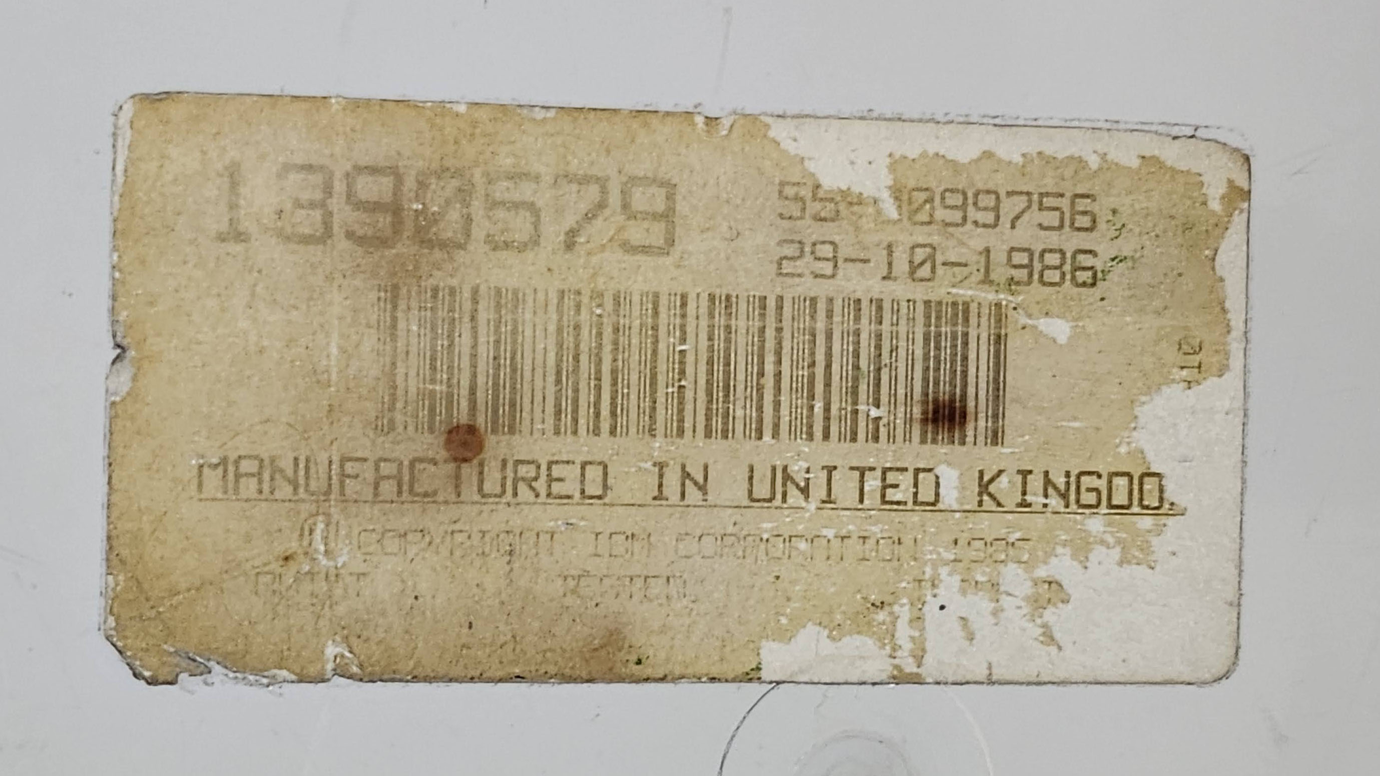

I like it, except for the blue sticker. As far as I know IBM never used stickers like that, certainly not in the eighties. It has inspection date 9 10 10. It reeks of 3rd party service company.
sharktastica
18 Jun 2024, 16:59
webwit wrote: 18 Jun 2024, 11:04 I like it, except for the blue sticker. As far as I know IBM never used stickers like that, certainly not in the eighties. It has inspection date 9 10 10. It reeks of 3rd party service company.

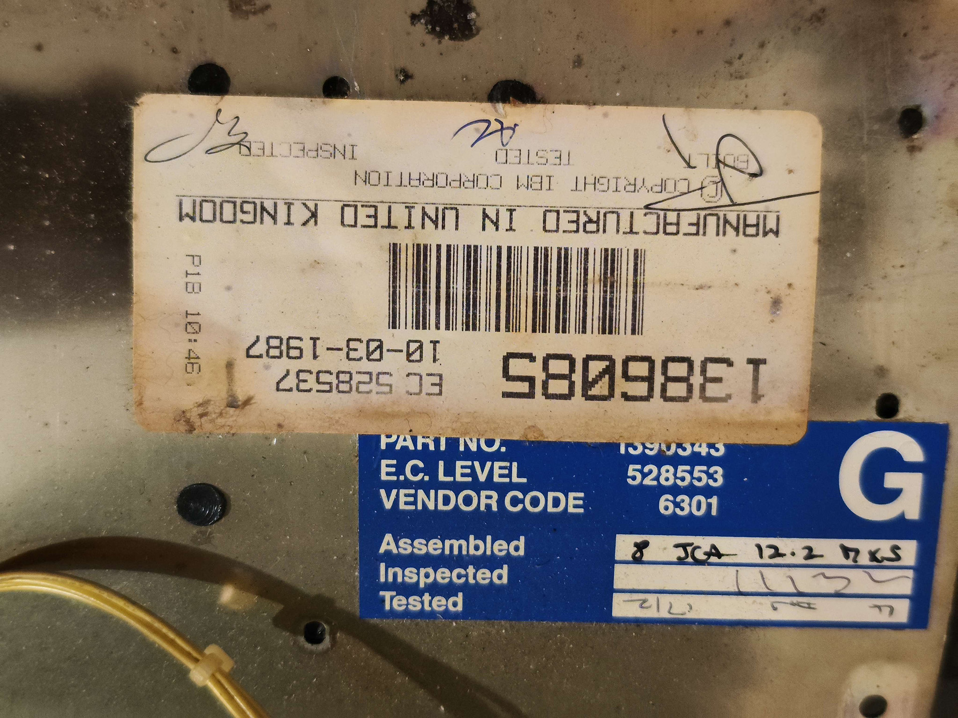

I disagree, I've seen it in quite a few 1985-1987 IBM UK made Model Ms that don't have the simpler dot-matrix style versions. When I was looking for examples during my research, their possible dates all seemed to be uncannily close to the typical rear label's date as well. If the cover set also has a stamped date, the blue sticker's ones make chronological sense of being 'newer' than that but 'older' than the typical rear label's. I've also seen the sticker applied partially under a typical rear label.
Starting with the cover photo's, IMO the numbers you're referring to look like separate days of the same month (so 9th, 9th and 10th). There are other short-form dates above and below them ("9/10" and "13-10") which seem to indicate October, which is just before the typical rear label's 1st November date.
Here's another example where part of the blue sticker is under a typical rear label. There's "12.2" and an (upside-down) "17/2", which both lead up to the typical rear label's 1st March date.
Here's another one where a part of it is covered by a typical rear label.
In this thread, you can see another that's partially covered with dates "25.2", potentially two singular "26" and "25 2" that are after the case's stamped 5th Feb date but before the typical rear label's 18th March.

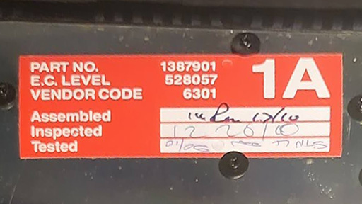

In the "1A" M122 example I have, it has dates "17/10", a singular "12", "20/10" and another (upside-down) "20/10", which are very close to the outer rear label's 29th October.

If that was the case, why is the "1A" counterpart red?
IMO, these stickers are not "suspect". The sudden change in font and style is interesting, but ultimately it's not like it's something outside of IBM's capability. Whilst not as contrasting as these, IBM U.S. keyboards could have one of several variants of rear label after all.
