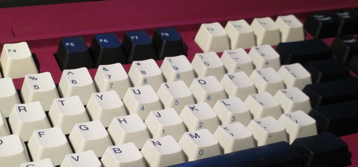

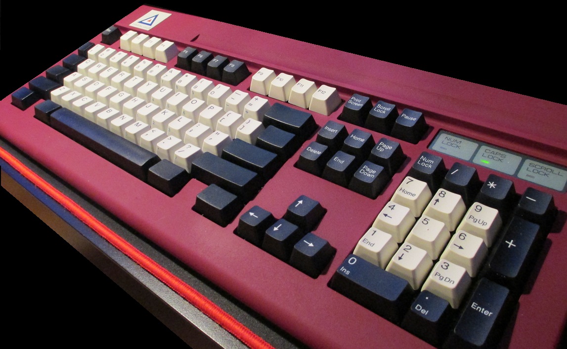

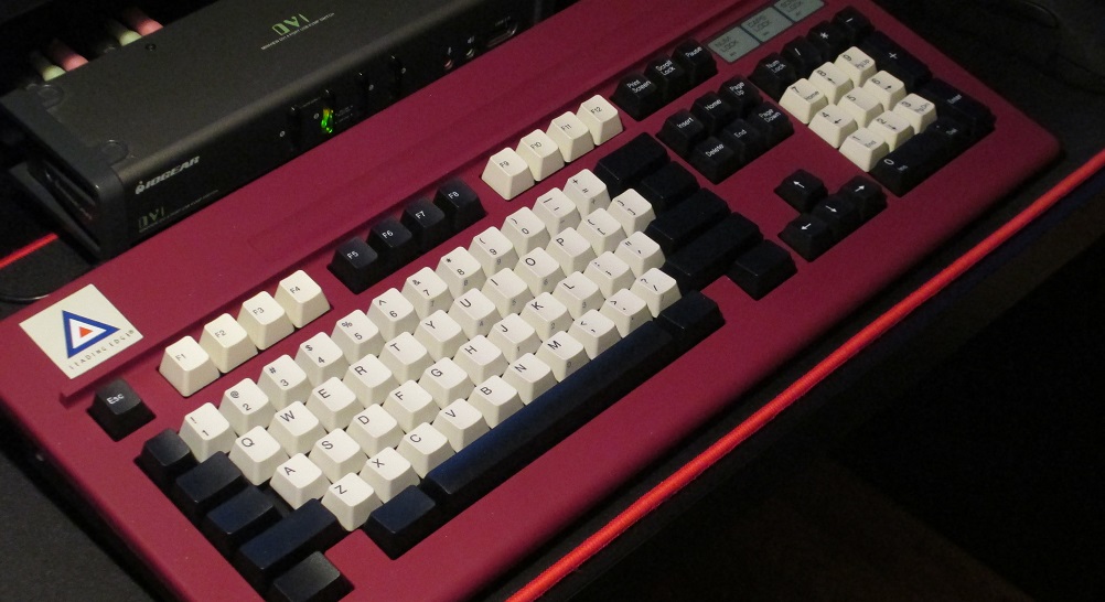

Decided to make some additional changes to one of my LE DC-3014 SKCM blue Alps keyboards. Although I like the sound and feel of the dye-sub PBT caps from the SGI Granite, I don't like the Italic font and the size and weight of the font, especially on the F-keys. Therefore, I made some changes. The alphas are now dye-sub PBT from an IBM 5140. The white F-keys and NumPad number keys are doubleshot ABS from a Northgate Omnikey 101. The WoB keys are Tai-Hao doubleshot ABS, and the blank black keys are ABS from Matias.
No further changes were made to the case colors -- the top case was painted burgundy red and the bottom case was painted flat black with Dupli-Color Vinyl & Fabric spray coating.
Previously, the LE emblem was just sitting in place and not mounted with adhesive. Now, it is mounted with "Octopus Glue" clear double-sided adhesive tape, 2 mm wide and 0.15 mm thick, available from Amazon:
https://www.amazon.com/dp/B0163JMPWM
Despite the mixed origins of the keycaps, the profiles match and the colors and textures are close enough not to be jarring to the eye, especially when in actual use rather than being scrutinized in a photo. I also don't notice the difference in keycap composition when typing because most of the time my fingers are in contact with the dye-sub PBT alpha keys. I do, however, really appreciate the dry feel of PBT when I compare this setup with another keyboard that has stock doubleshot ABS caps on all of the keys.
It can be a challenge to cover a full-size Alps-switch keyboard with keycaps to your liking, but this particular Frankenboard approach works well for me.
