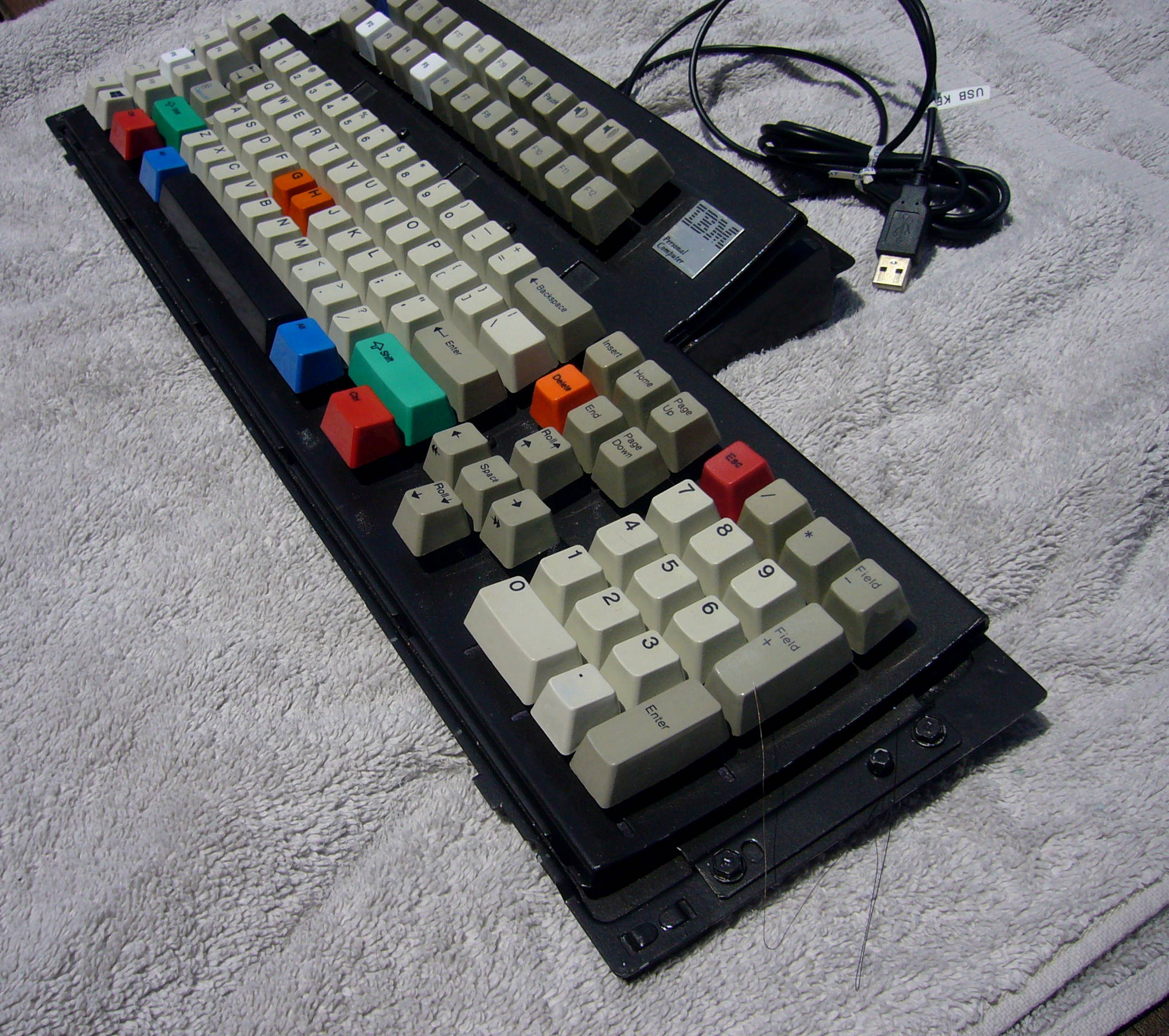

BinaryHalibut wrote: Huh, for those of us too poor to have an SSK case, two adhesive rubber feet on the bottom plus two capped bolts up top actually looks to be a pretty good system.
Looking forward to this :)
The trouble is with the controller on the bottom. You'd need some sort of shield for the controller, as well as a receptacle for the connector board, all of which basically means that you'd need the bottom of the case anyways, unless a custom part was made.
Another option, what I've done, is to cut down an M case to the SSK form factor. Unicomp sells spare M cases for pretty cheap, and all you'd need else is a dremel or saw. It isn't too tough, but requires a bit of patience with the plastic.

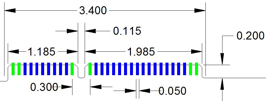

wcass
19 Sep 2016, 19:49
The original PCB has controller pins set at 0.156" pitch. Then new controller has pins set at 0.1" pitch with some notches left, right and between rows and columns. I'll post a drawing of the top of PCB later.

drevyek wrote: The trouble is with the controller on the bottom. You'd need some sort of shield for the controller, as well as a receptacle for the connector board, all of which basically means that you'd need the bottom of the case anyways, unless a custom part was made.
I mean, as long as you aren't shoving it in your backpack or something the controller should be fine hanging there. And I think the xwhatsit has a micro usb connection on it anyways, so the connector board isn't even needed if using it caseless.
That said, it's not a great option. Just an option. And the stainless steel floating-key look isn't half bad.

BinaryHalibut wrote: I mean, as long as you aren't shoving it in your backpack or something the controller should be fine hanging there. And I think the xwhatsit has a micro usb connection on it anyways, so the connector board isn't even needed if using it caseless.
No reason it wouldn't work well. It is on the same tangent as the Phase 2 "floating board" idea. There the controller would live inside the stand, with the stand being hidden from most angles.

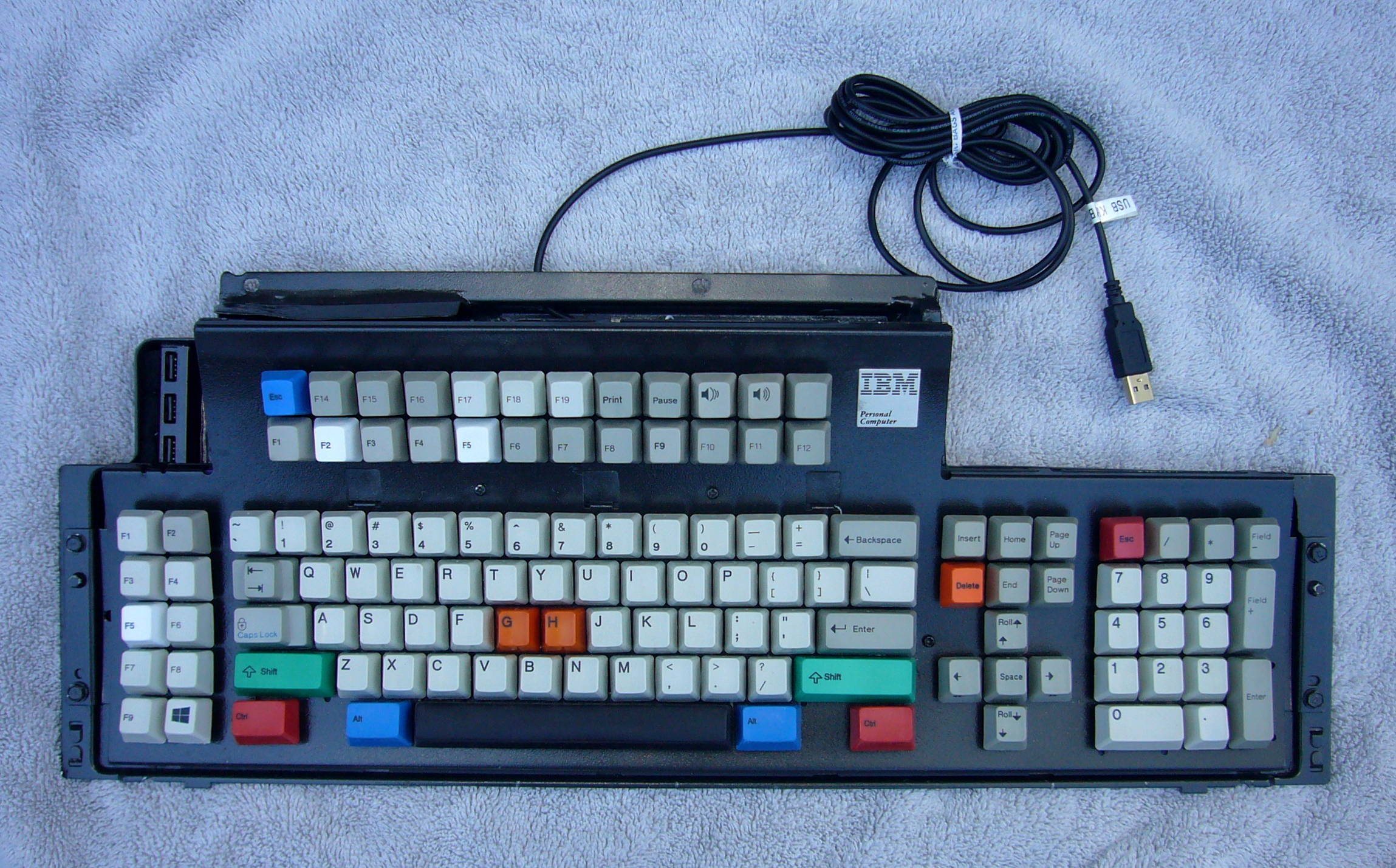

If you wanted to try your hand at designing a 3d print (or out of wood) versus just hardware parts... My suggestion would be to make a little stand at the back that covered the controller, and was secured with the two ground screws. Then make it run forwards towards the front of the board so that it lifted the front edge to the desired height. Could be very attractive if done patiently, and certainly cheaper than sourcing an SSK shell.
Lots of options, and always backwards compatible with the Model M shell. Make it your own... Why not right?!?
19 Sep 2016, 21:30
Since I created the "naked" option a couple of years ago, I use this F-122 far more than I use the ones with the cases.
A simple bottom pan would be good, and wood might offer some good qualities, too.

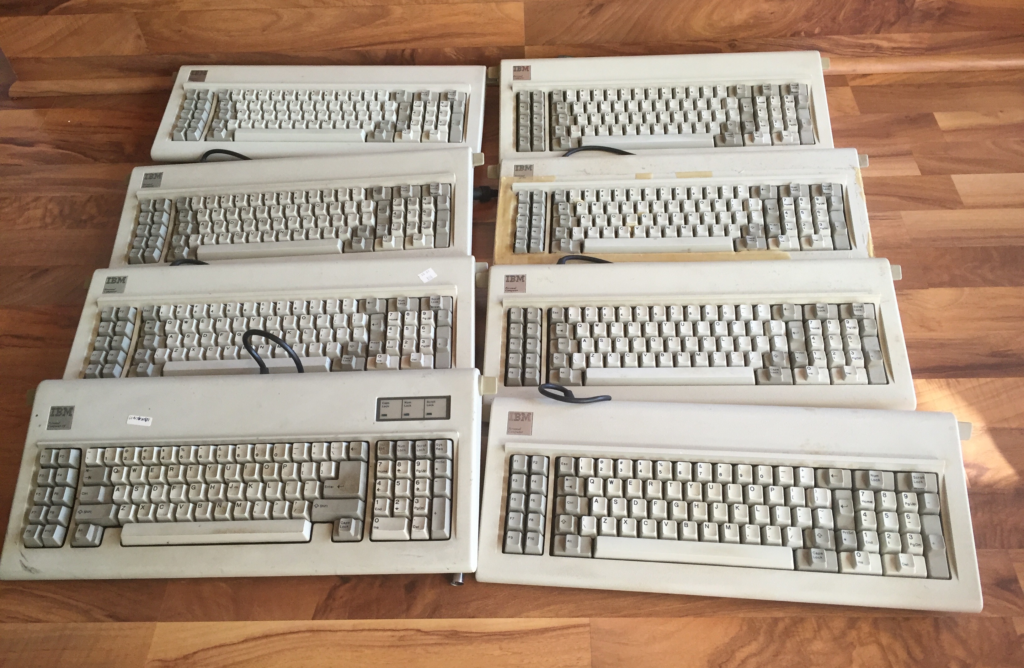

Couple of updates
  • Picking up our 8 additional XT's tonight (along with a free Selectric 1 typewriter that powers on, but doesn't function otherwise... These are typically easy fixes, and become little gifts for my journalist friends)
  • WCass... Got the caps you pictured a few posts ago. I will experiment on a few junker caps first, but think this could be very promising
  • Cindy is sending me 5ish F122s sometime this week to add to the pool, and her friend should have SEVERAL more boards for us now that they have sorted out the Blue and APL keys. We saw him selling the good stuff before and thought all was lost. He doesn't want to eBay anything not pristine and easy to flip it seems
  • I will be getting the Buckling Spring Selectric cap set any day now, and will take some better pics
wcass
20 Sep 2016, 03:07
For anyone interested, the two connectors together are 3.4" wide including the slots at the ends and between rows and columns.
controller connector.jpg (37.91 KiB) Viewed 6878 times

wcass wrote: The original PCB has controller pins set at 0.156" pitch. Then new controller has pins set at 0.1" pitch with some notches left, right and between rows and columns. I'll post a drawing of the top of PCB later.
Ah yes, I completely forgot about that. Thanks.

The spoils of yesterday. All are in pretty good shape really (though dirty), with the AT being a very pleasant surprise.
