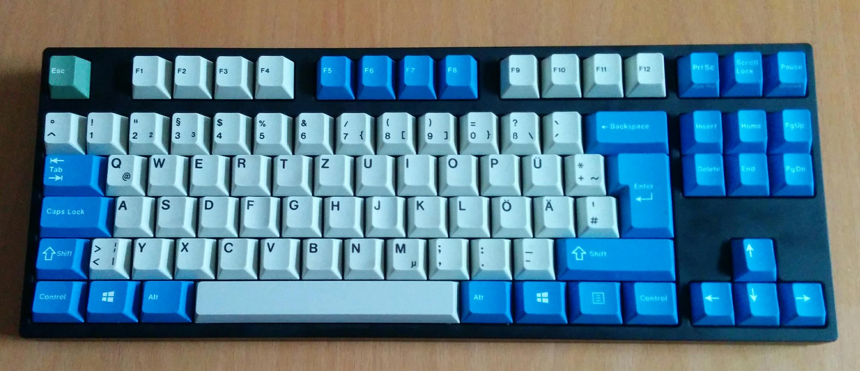

kekstee wrote: Blue mods!
Very nice! I prefere it with the dark beige mods, though. What are those Windows keys?

kekstee
04 Mar 2016, 14:21
I do like the look of the classic mod colour on this as well, but I found it hard to overlook that I mixed ISO and ANSI shift as well as using a second tab for backspace. If only photeqs GB could have made it to throw more money at the problem :mrgreen:
