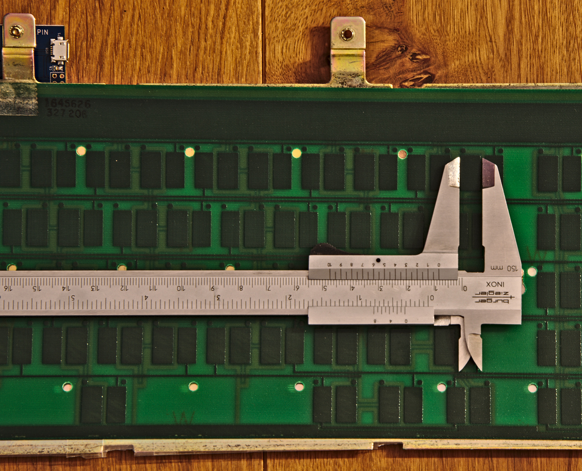

Hello,
I was working with the keyboard yesterday. I have taken some mesurements that I will post hopefully after work today
If someone is interested in mesuring any specific part, tell me. I will post it.
idollar
i$
01 Apr 2015, 18:10
I have added new sections and pictures. Let me know your comments.
If you have interest on seeing something special, ask for it!

0100010

Your PCB has quite a bit of holes in it. The PCB on my F107 only had two, one for each indexing pin on the bottom plate.

0100010 wrote: Your PCB has quite a bit of holes in it. The PCB on my F107 only had two, one for each indexing pin on the bottom plate.
The PCB that I am reparing is having 3 holes.
The back plastic cover between the PCB and the back plate was missing. I made one. This will come in future posts.
Hey, you are right. I did not notice the extra holes !
