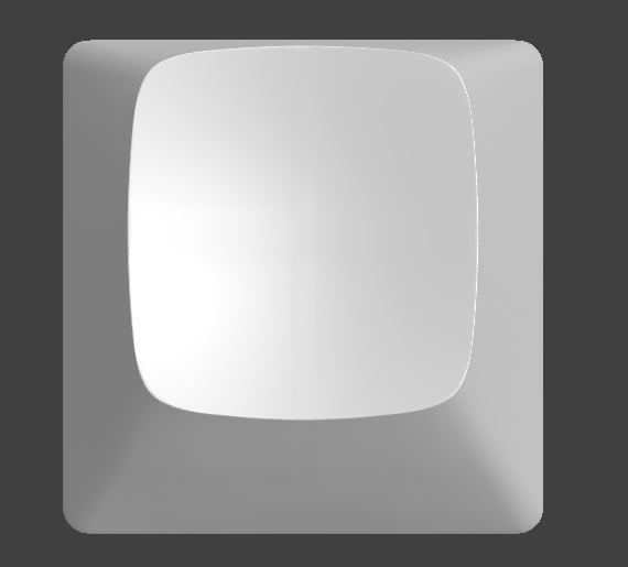

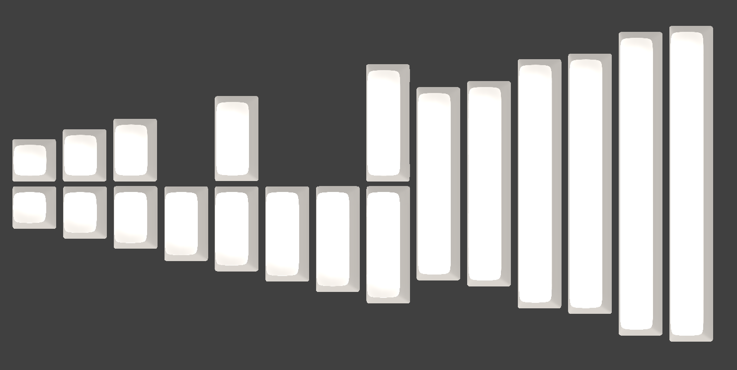

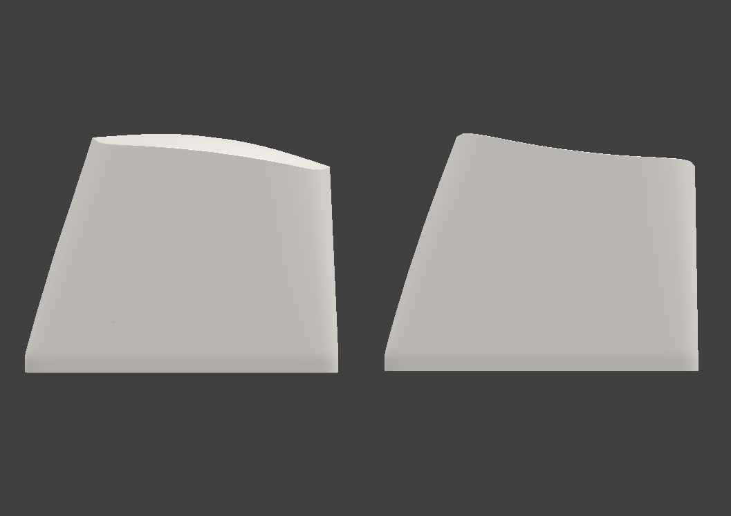

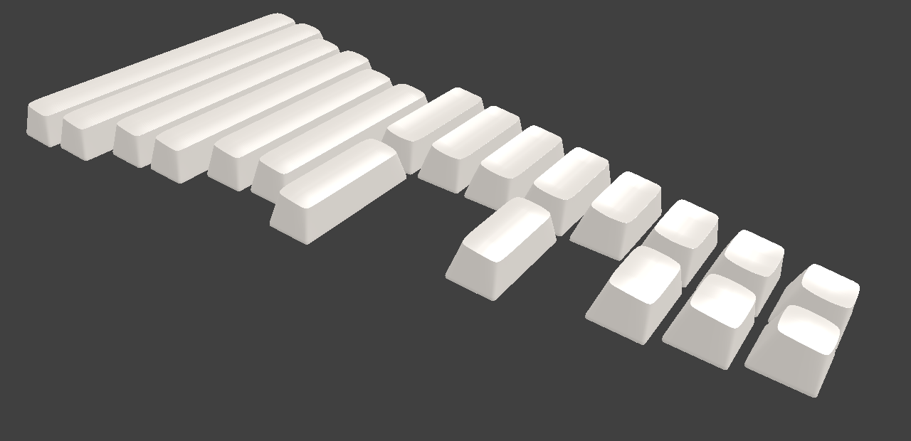

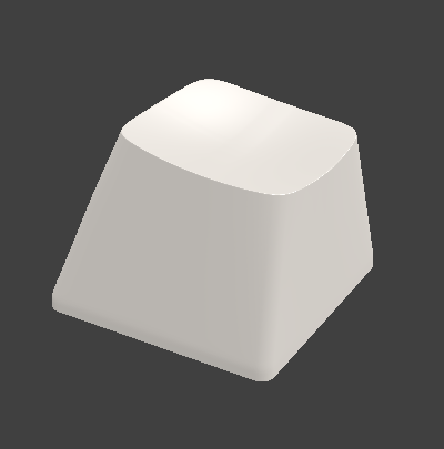

Here's a few modeling snippets to share based on the master list posted earlier.
- top-group.PNG (104.03 KiB) Viewed 8813 times
- top.PNG (66.37 KiB) Viewed 8813 times
- single.PNG (18.47 KiB) Viewed 8813 times
- profile.PNG (49.03 KiB) Viewed 8813 times
- group.PNG (124.28 KiB) Viewed 8813 times

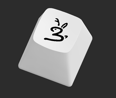

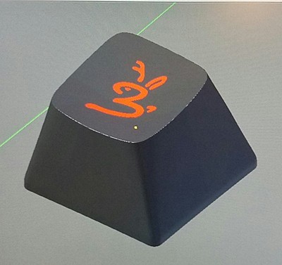

This legend showed up in a text tonight. I may be the only one who wants it, but want it I do.
- tmp_12457-123_1-1740835409.jpg (1023.56 KiB) Viewed 8672 times

Please excuse my ignorance, but what is that?rsbseb wrote:This legend showed up in a text tonight. I may be the only one who wants it, but want it I do.

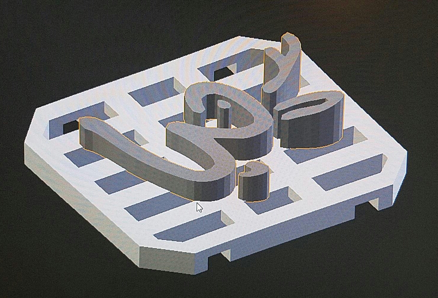

It's a model for a legend insert, the part that gets over molded with the rest of the cap material. Only the top surface of the legend remains visible after the second shot of plastic. In this instance it would be my Horned Rabbit logo.
- blk re hr.jpg (39.78 KiB) Viewed 8509 times

I saw it is your avatar logo, but first I thought it is an abstract om logorsbseb wrote:In this instance it would be my Horned Rabbit logo.

Well it may not be spiritual but it does have meaning for me on a personal level. I was raised in the inter-mountain west of the United States (home of the fabled Jackalope). For me the Jackalope has always represented innovation, creativity and wild ambition. As a designer I value those traits. I developed the logo abut 15 yrs ago and even used it commercially for a while. I suspect the Horned Rabbit will always be a part of my persona.
This one is much more appropriate..
- hrwht-blk-legend.PNG (28.03 KiB) Viewed 8411 times
