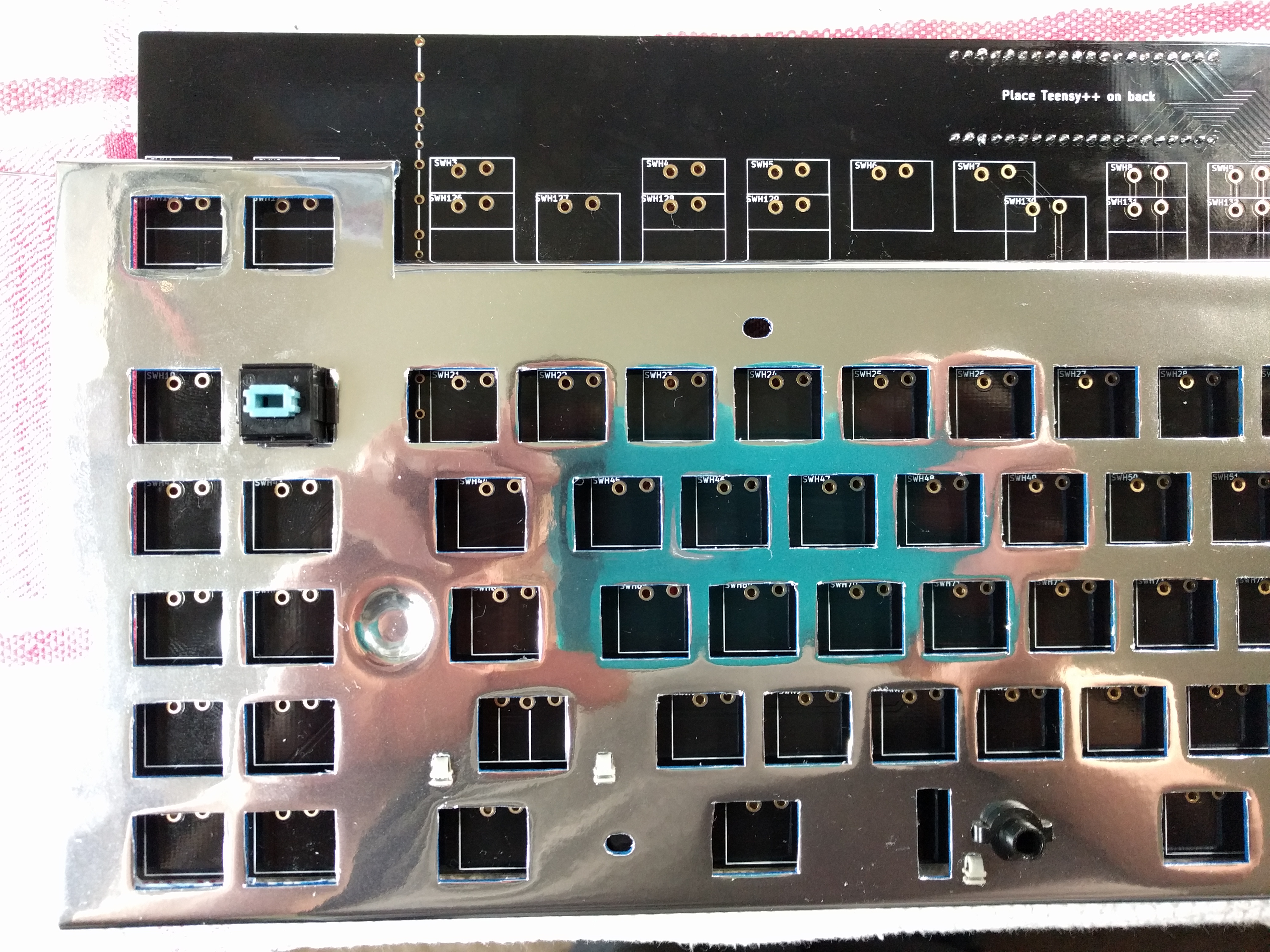

Posted: 11 May 2018, 18:16
by just_add_coffee
Am I not understanding something, or are the left side function keys about ~5mm left-of-center (or everything else is ~5mm right-of-center)?
I can line up either the function keys or everything else, but not both.
Anyone else having this issue?
Aside from that, this is one pretty PCB!
Posted: 11 May 2018, 18:56
by mike52787
just_add_coffee wrote: Am I not understanding something, or are the left side function keys about ~5mm left-of-center (or everything else is ~5mm right-of-center)?
worst case scenario it looks like you could remove the left hand f row cluser, remove some of the pcb material, and run jumper wires over to the main pcb. seems like the measurements were done wrong or something.
EDIT: just to clarify, I mean remove some material from the left hand f key block, my wording was a bit confusing.
Posted: 11 May 2018, 19:12
by just_add_coffee
mike52787 wrote: worst case scenario it looks like you could remove the left hand f row cluser, remove some of the pcb material, and run jumper wires over to the main pcb. seems like the measurements were done wrong or something.
Nah, your wording was fine to me. I understood. I was hoping for different wording though. :D
But on the bright side, I've never cut a PCB before, so I'll get to do something new. Thanks Mike!

Posted: 11 May 2018, 19:17
by martink
just_add_coffee wrote: Anyone else having this issue?
Someone on geekhack has reported the same problem.
Posted: 11 May 2018, 19:36
by just_add_coffee
Thanks. Found the thread ...
https://geekhack.org/index.php?topic=94 ... msg2597486
Posted: 12 May 2018, 05:31
by BlindAssassin111
I will reply here so people in the future can see this.
I was unaware of the different block spacing among certain models(so far the Ultra and gold label 102's are the only documented issues) which is unfortunate, the boards line up perfectly with the Ultra T and boards that don't have the connector daughter board in the case(according to the guy over on GH, haven't confirmed personally), which may affect quite a bit more boards sadly...
I recently purchased an older 102 for a whopping $61(I was very lucky on this one), hopefully this board has the issue so I can measure for myself rather than relying on others(guy on GH has been helpful but not having a response the instant I have a question slows the process down significantly, so I spent money) and will begin looking at making a new revision of the board. I am going to fix this by adding more switches on the board that are offset(which adds quite a bit of complexity) or I may need a new version for certain "generations" of the omnikeys.
If you have had this problem please post pictures. I will try and work with you on getting this issue resolved, which will happen in a round 2 GB as I can't order just 2 boards for those who have reported problems(at least so far).
