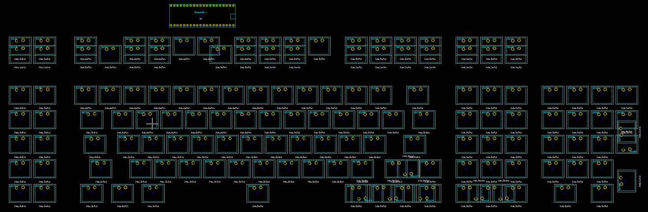

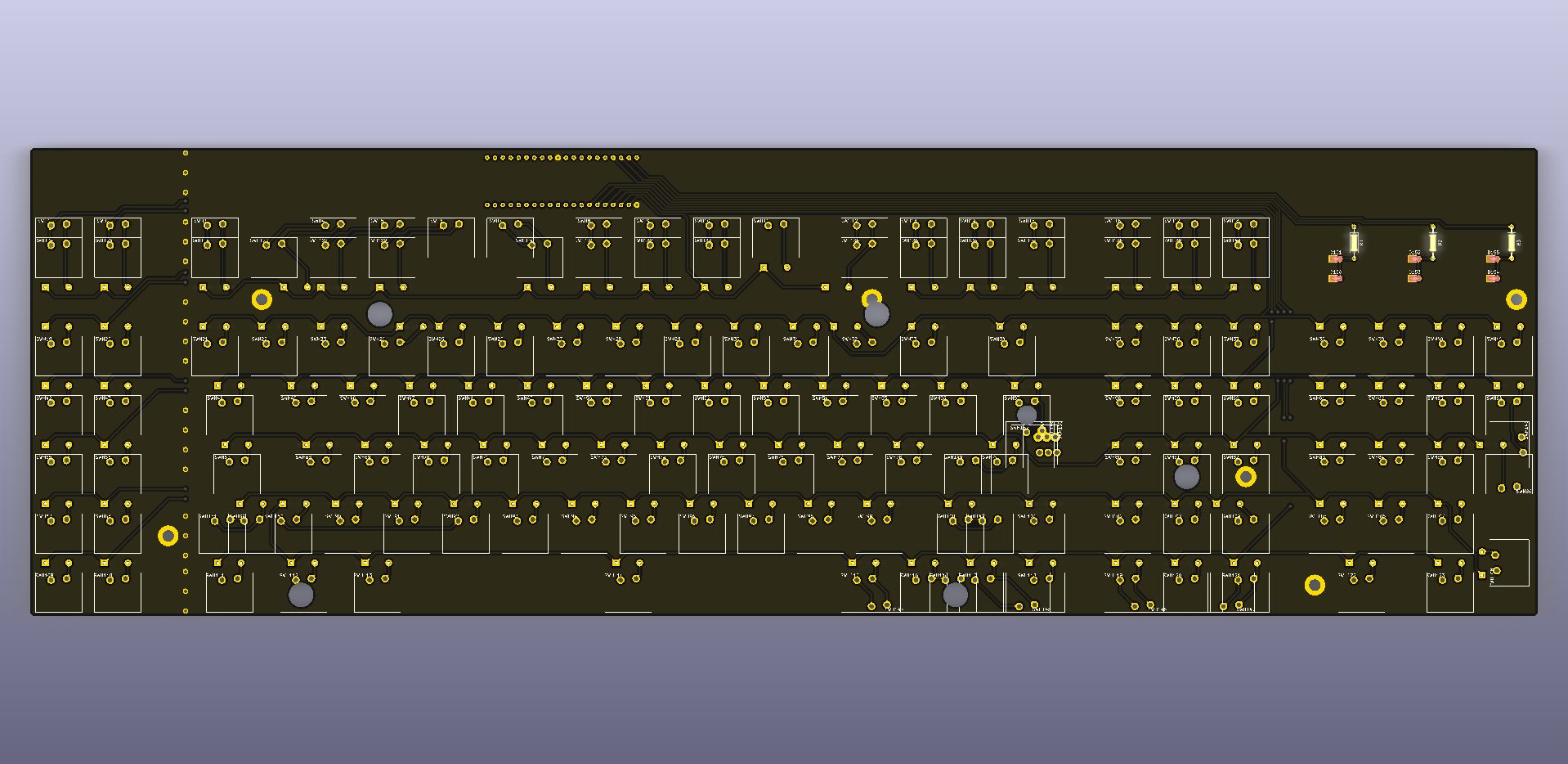

This started out checking to see if people wanted a replacement PCB for the Omnikey lineup, and later it grew to include ANSI and ISO support. On top of all of this, I also designed a plate for all the layouts(single DXF file, as there are 360+ different layouts!!) so you can make a custom fullsize or larger board using a sandwhich case, or if you wanted, even an all aluminum one.
PCB Render:
Sorry for the bad render, I don't have any better way to render PCBs.
Product Info:
The board will be black with ENIG(Gold) pads, with minimal silkscreen in white.

Yeah I knew I was forgetting something about the layouts. This is going to be a bit harder than I was initially thinking, haven't seen a Ultra in a while (have an Ultra T) and forgot about the different spacing on the top row.... Oddly enough I thought the Ultra T and Ultra used the same pcb as the Ultra T even has places to put the missing nav keys on the pcb and switch plate, but both top row layouts are not supported on the original pcbs. But it seems to be a super easy layout to run as it isn't complicated or even overlapping.

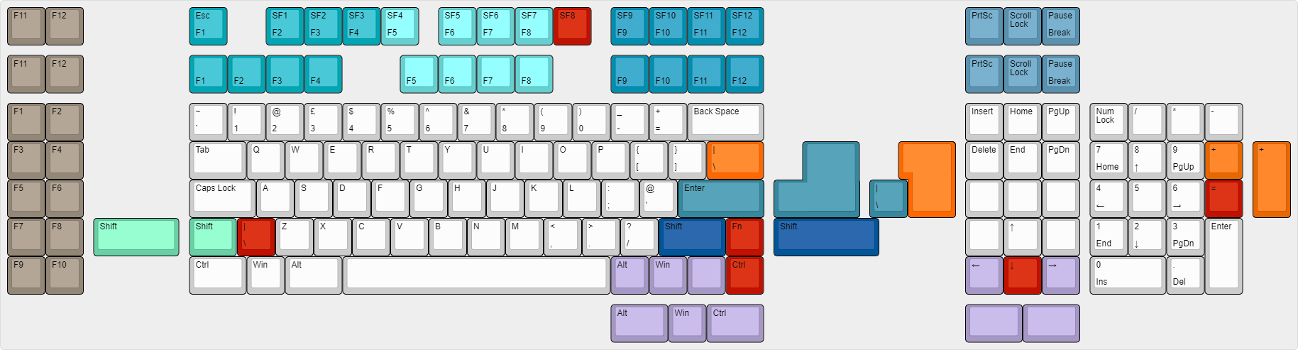

Support for:
  • • Ultra T
    • Ultra (need to check, hard part is the bottom of the nav cluster being two 1.5u instead of 3 1u, and SF row spacing)
    • Plus (same issue as above minus SF row, but will work)
    • 102
As well I will need to jump up to the Teensy++ as it is not possible to support the matrix size needed to support these layouts as I will be just over the limit for the Teensy 2.0.

The only reason at the moment I don't support the 101, is due to the smaller board size and having to have cutouts on the larger pcbs so the extra function columns can be broken off. This weakens that area a tad and makes it harder for me to route. When I start designing I will look into what I want to do in regards to the "smaller" boards.
I actually prefer the Ultra T as I love the extra switches and the split right shift is nice, but I would rather have and ansi enter...which I could do once I get this pcb in hand as the big ass enter is the same as an ansi enter as far as switch and stab location, it just replaces the \| key with a post. So this would even allow people to go to an ansi layout on the big ass enter boards.

I am pretty sure I can easily do that, I know I can support ansi enter, and backslash, right shift is the only one I need to see to make sure it doesn't get in the way of anything.

I will make these ANSI compatible for the enter, backslash and shift. I really want to ansi mod my Ultra T because the BAE tends to stick too much even after a very thorough cleaning and lubing. Plus I like ansi enters more than the BAE.

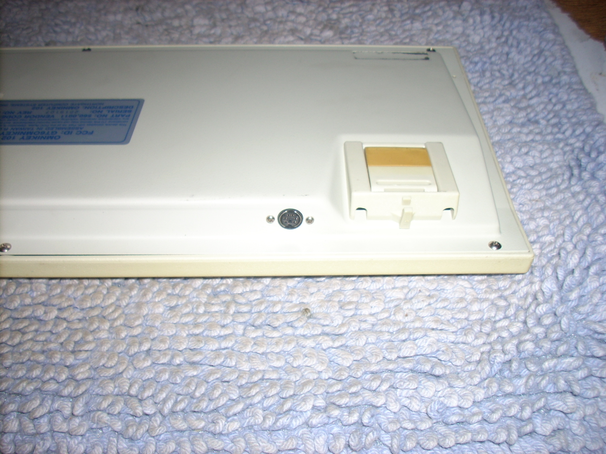

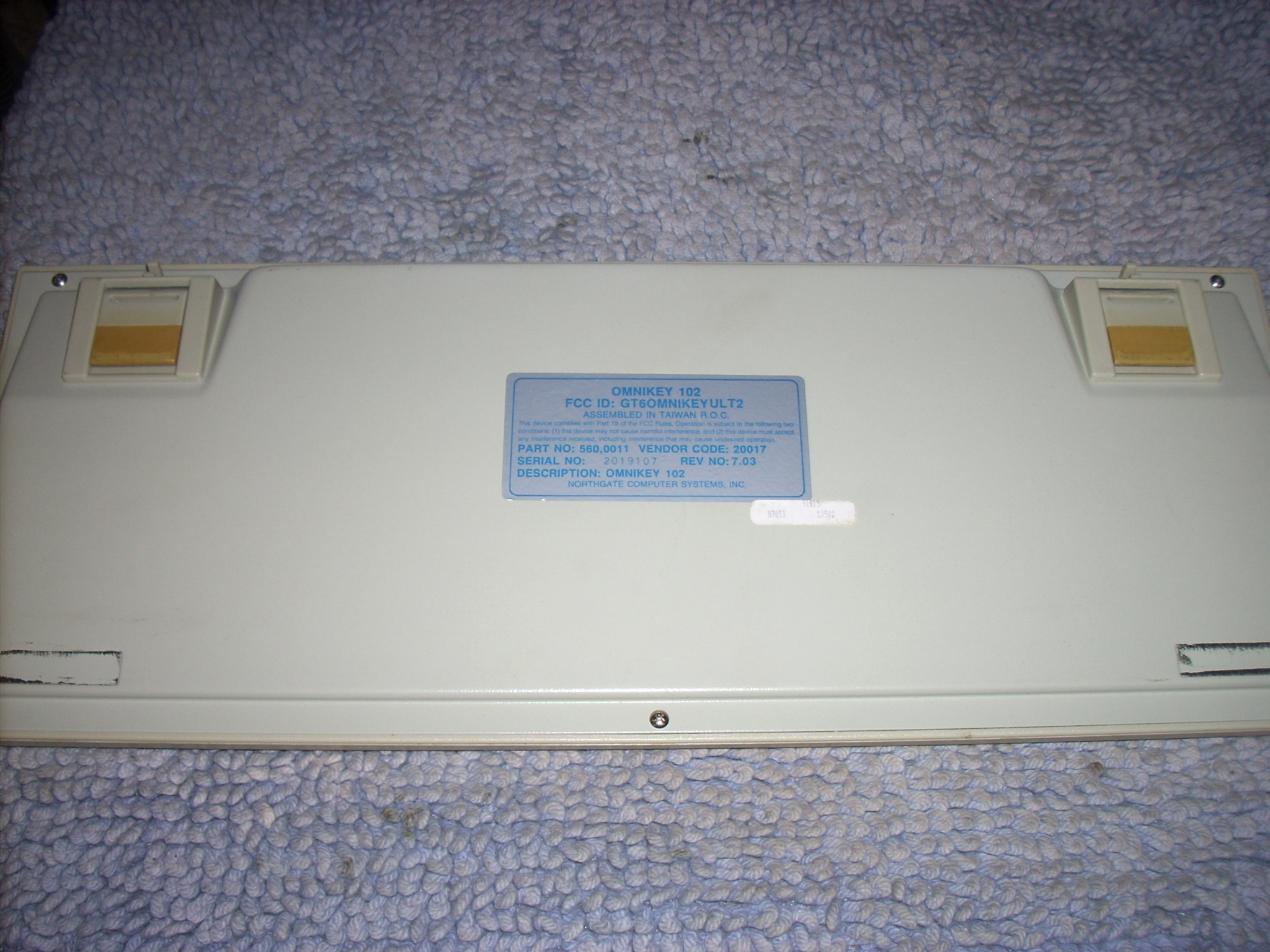

Polecat
18 Feb 2018, 21:29

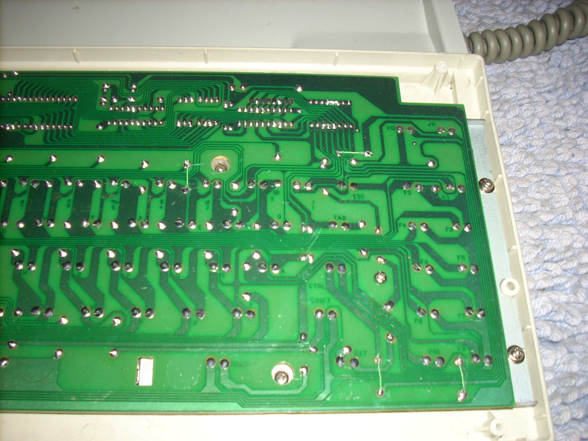

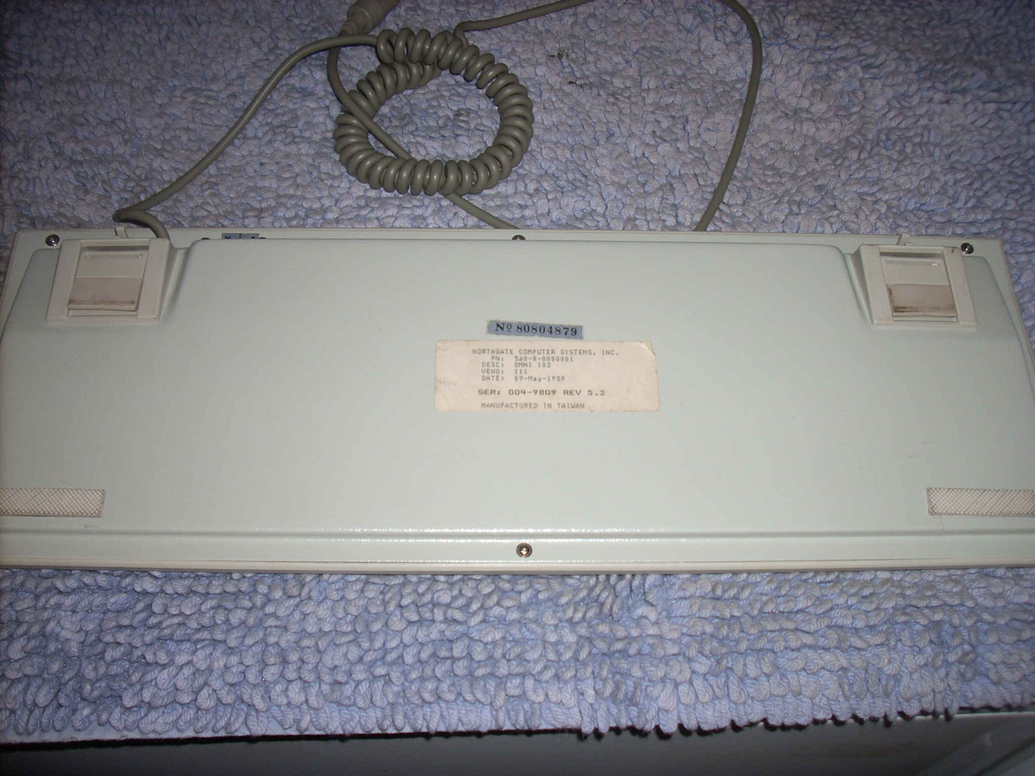

I'm going to post these in four separate replies to keep them grouped by generation. Sorry I don't have a way to put text on the photos unless I dig out my Win95 box, but I can put comments below using the editor here.

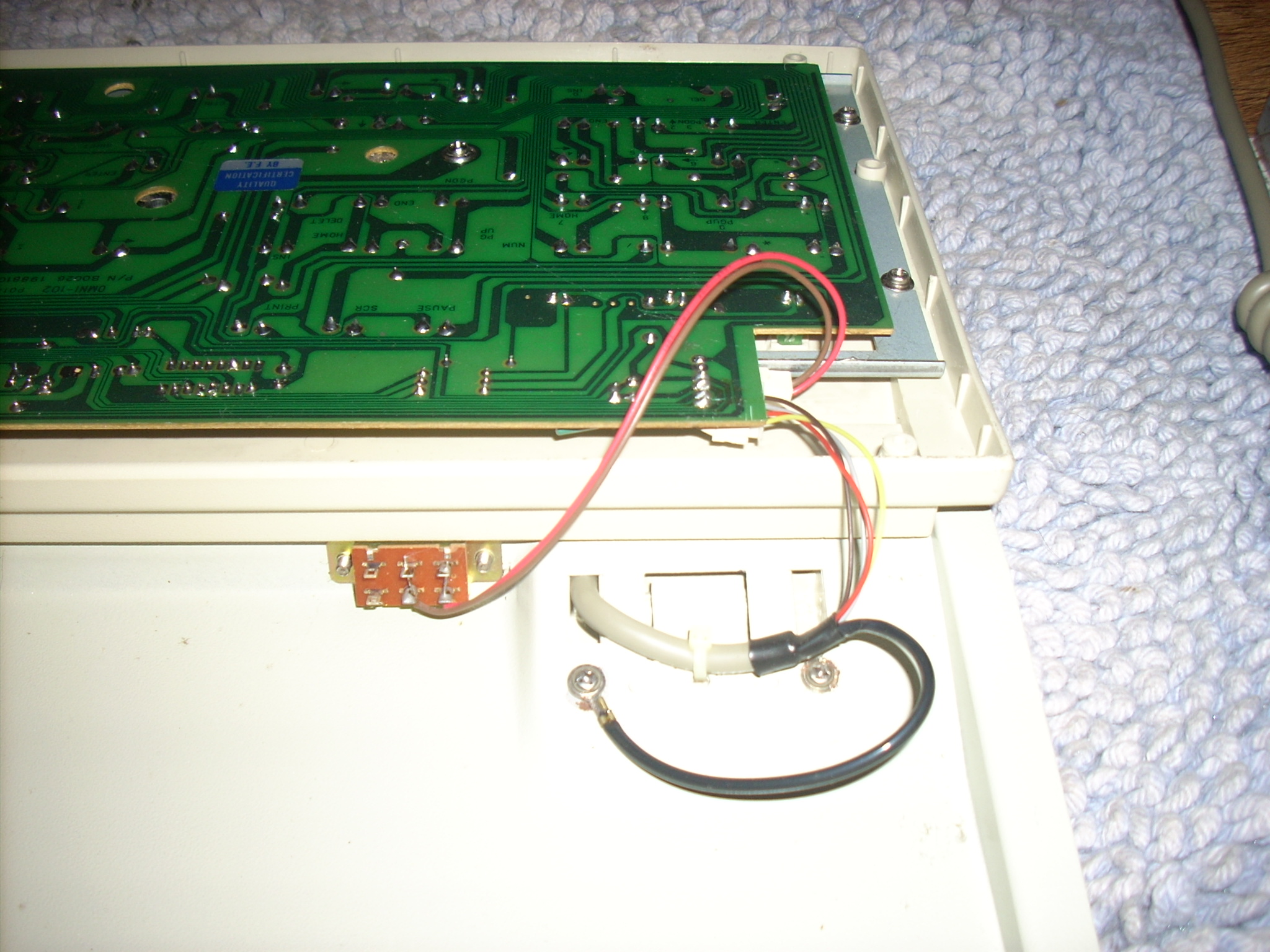

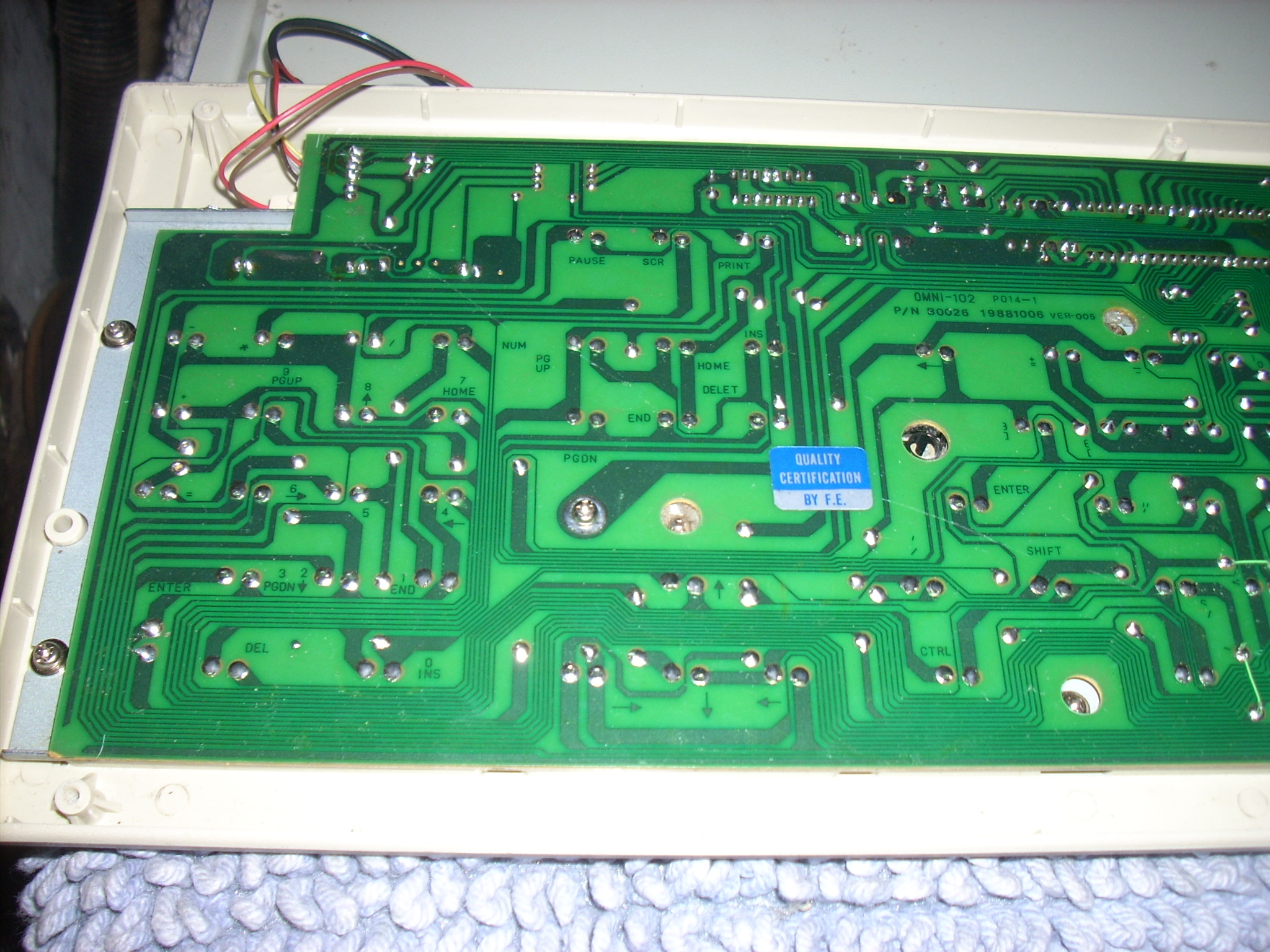

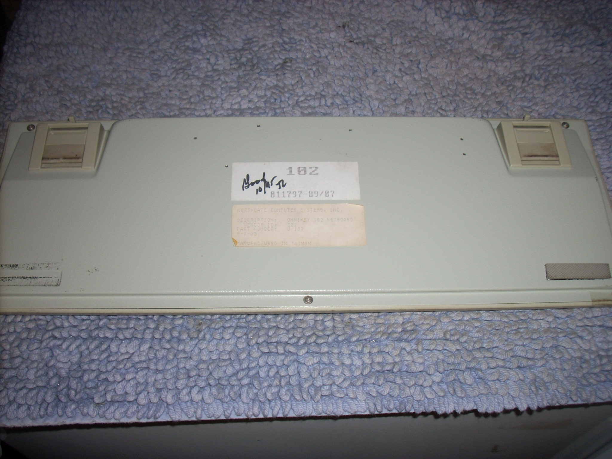

This is a Gen1 (gold label) Omnikey 102. Cord is attached, XT/AT switch on the back panel, center of switch 4-3/4" from right side of case. Four screws holding the plate to the case top at the edges, and five screws to the case top going through holes in the PC board.
Case is 20-1/4 by 7-1/4 inches. 1-1/4 inches center to center between top and next row.
Gen1, top view.
Gen1, top view.
Gen1, bottom view.
Gen1, bottom view.
Gen1 switch and cable detail.
Gen1 PC board, right side detail.
Gen1 PC board, left side detail.
Gen1 PC board, 5 screws through board to case top, four screws at edges of plate.

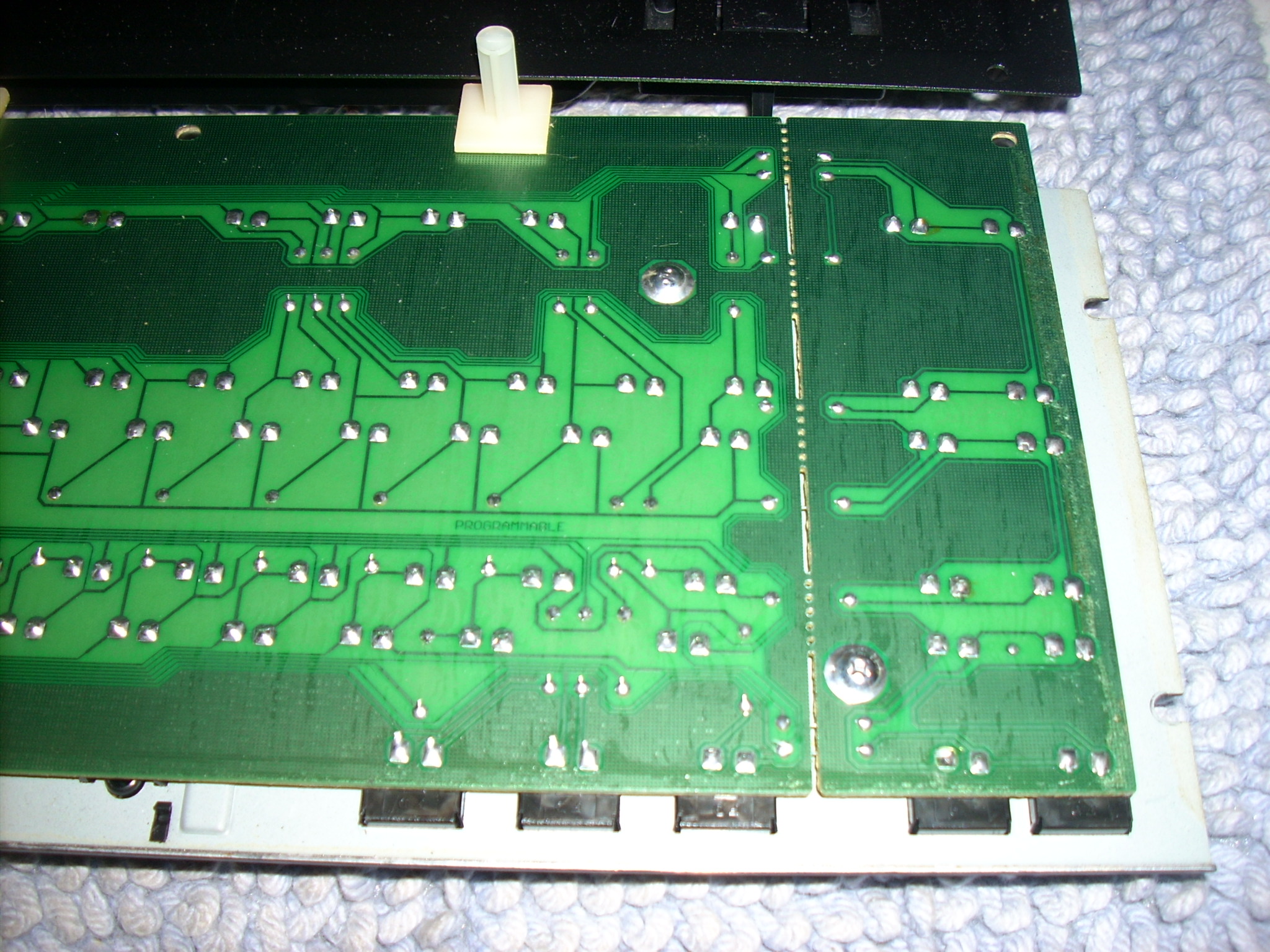

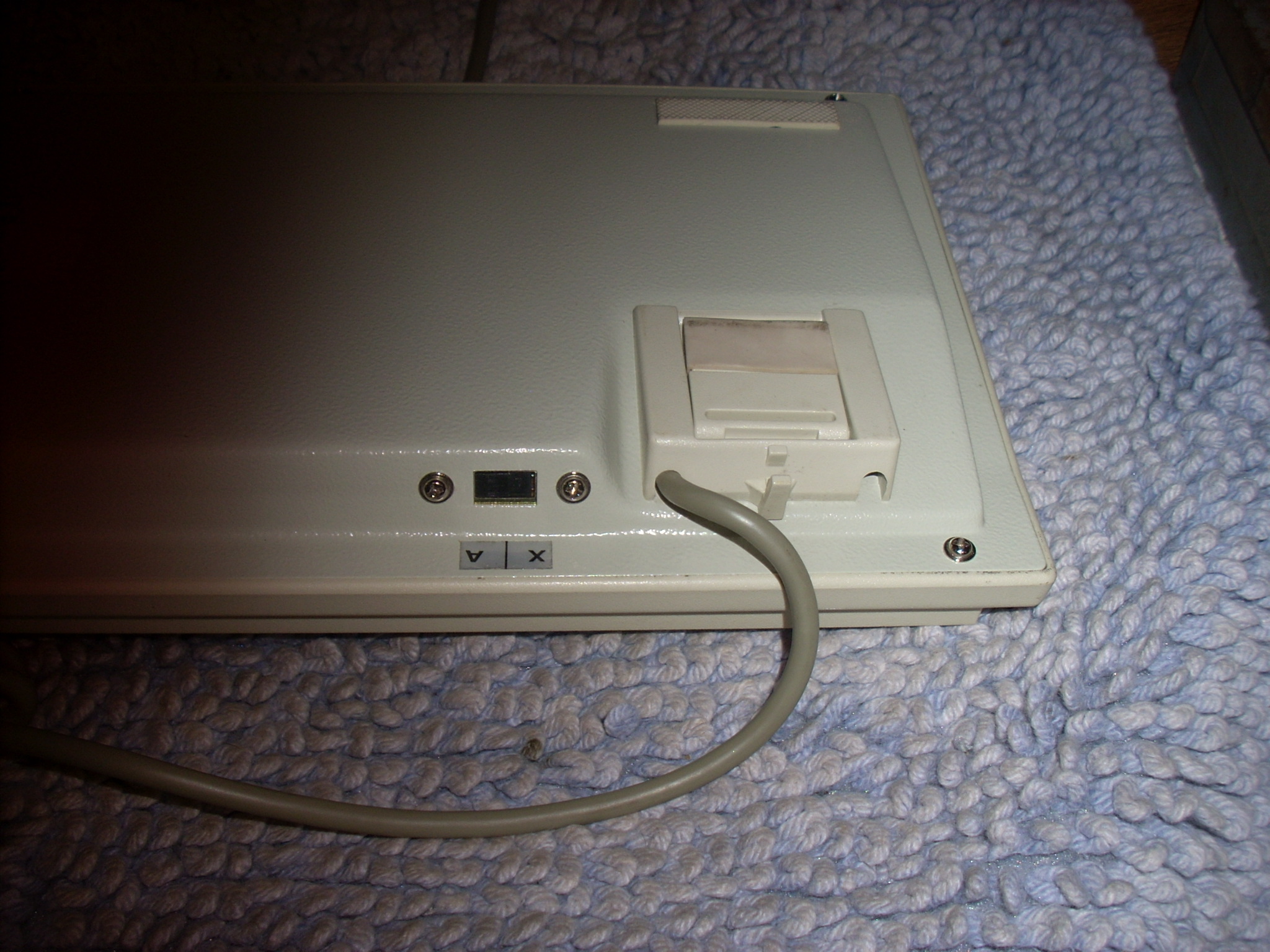

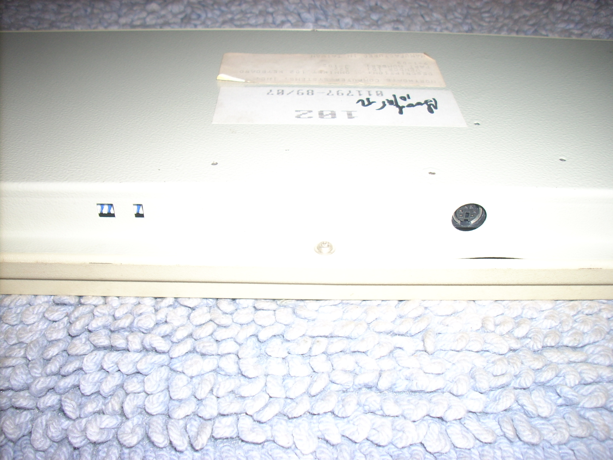

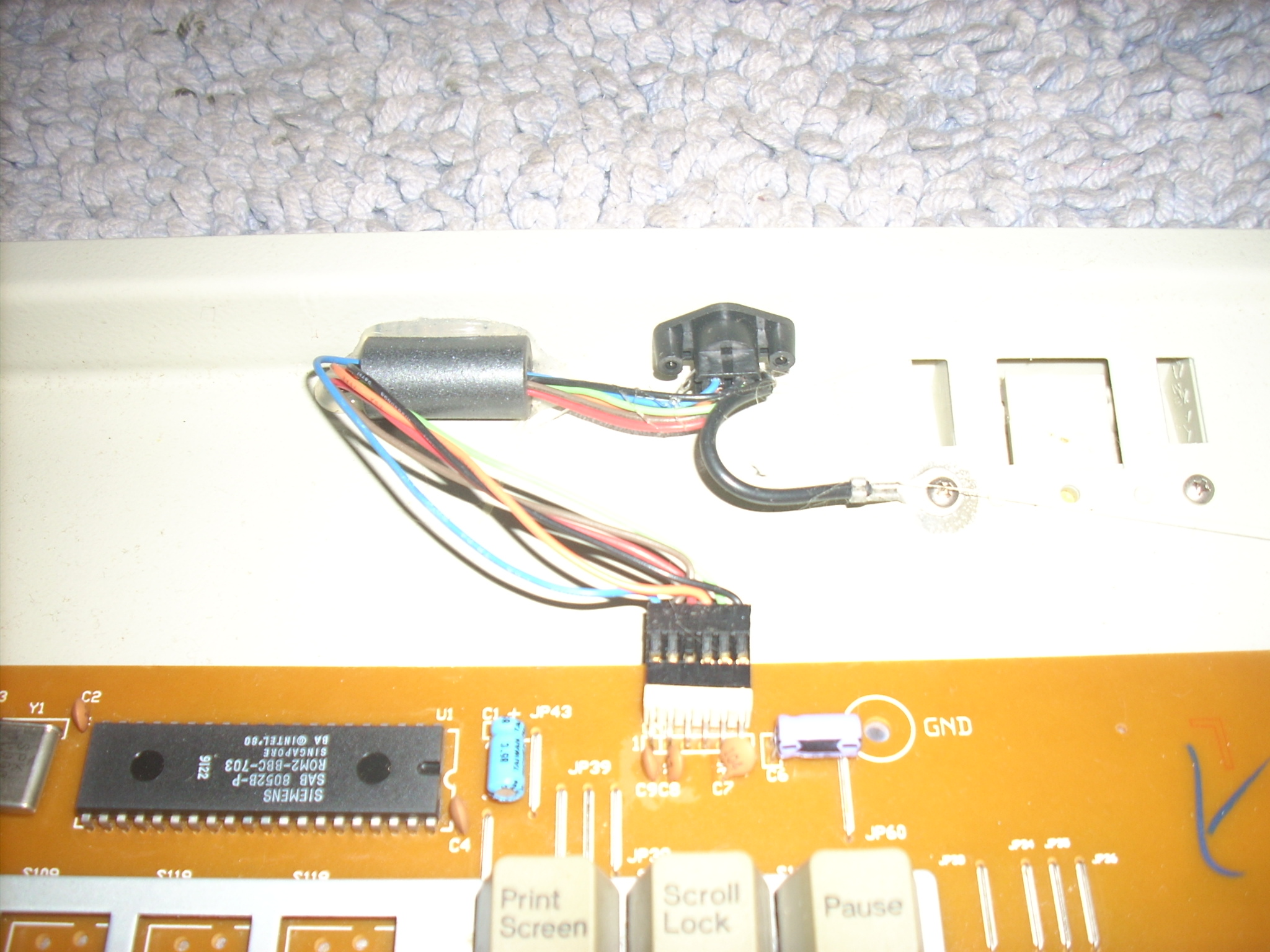

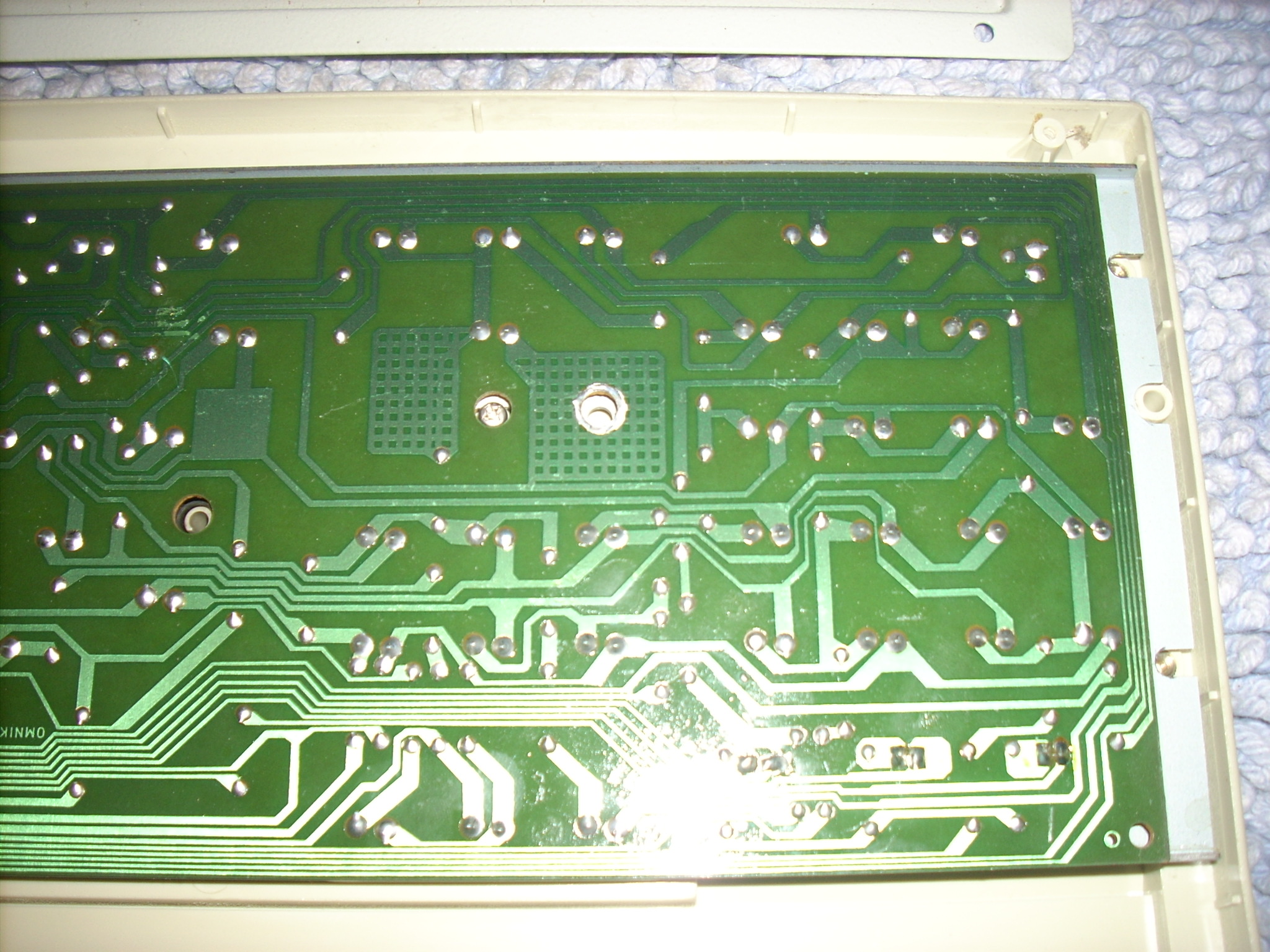

Polecat
18 Feb 2018, 21:48

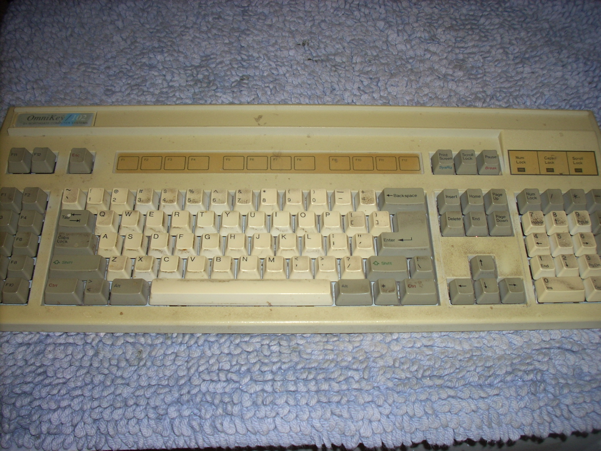

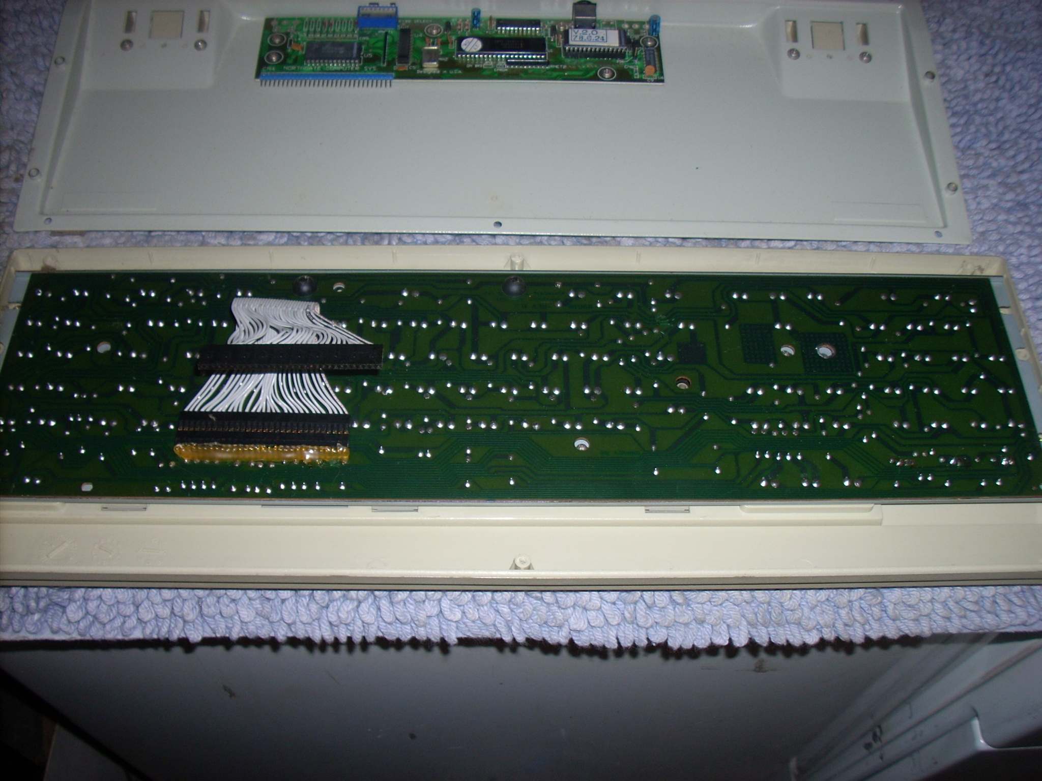

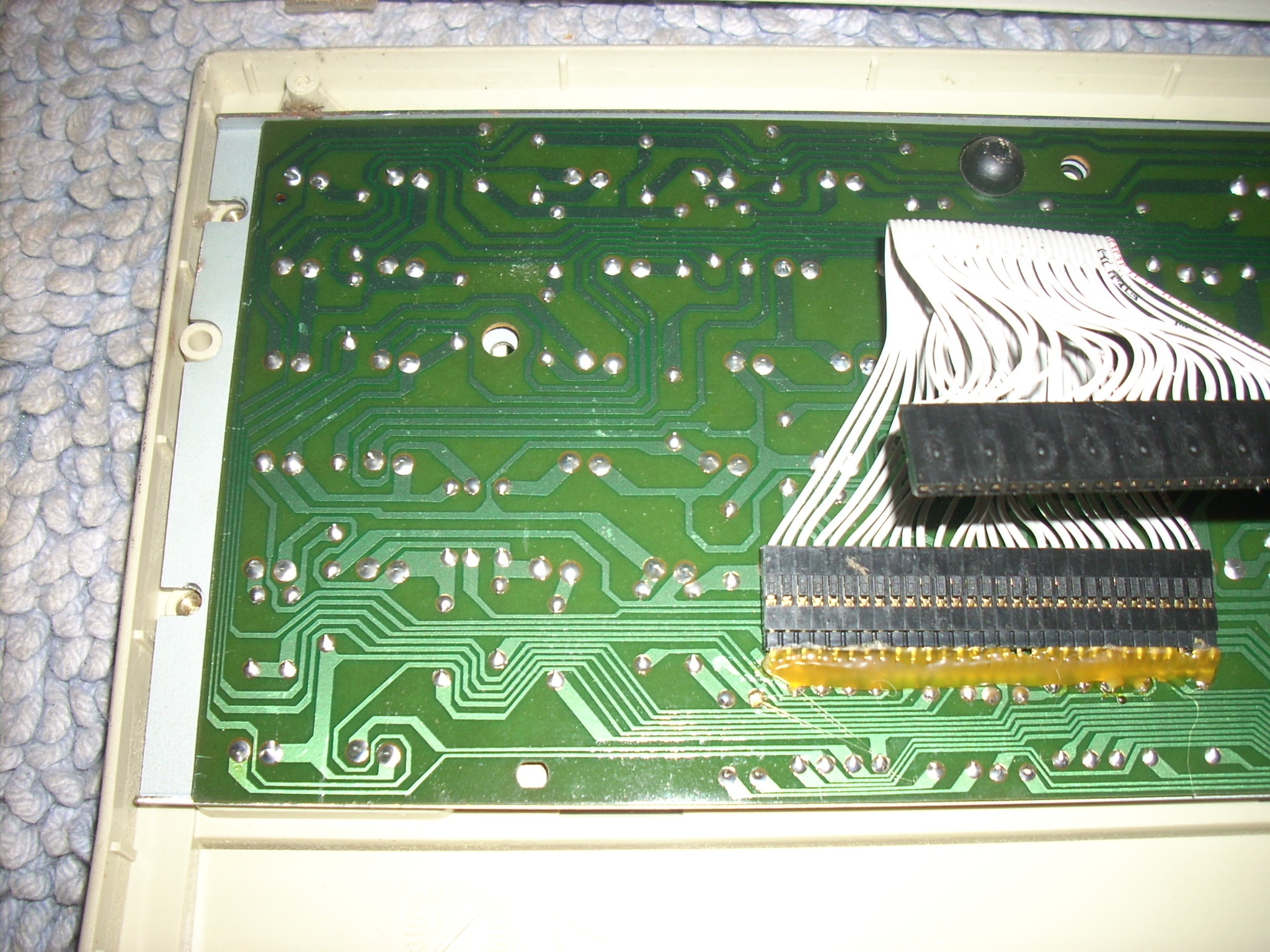

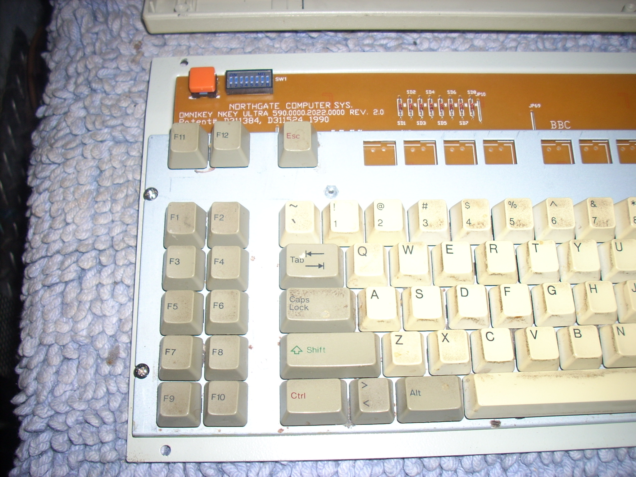

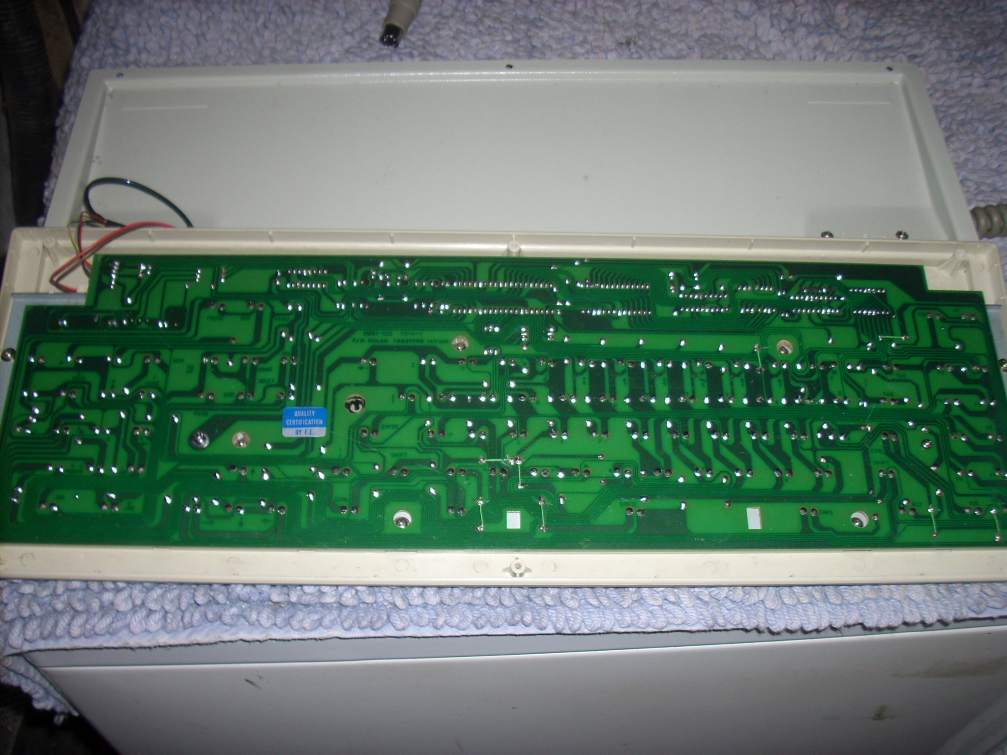

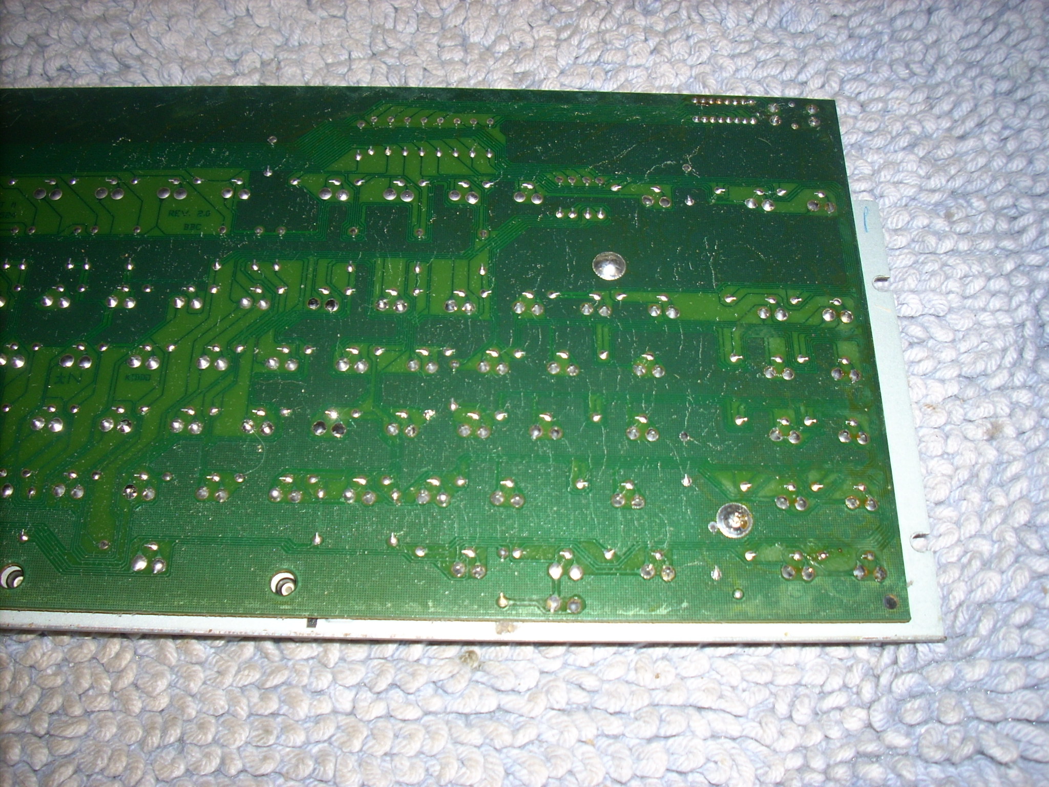

Gen2 Omnikey 102. Detachable cord, dip switches on back edge. Apologies for the dirty keyboard. (...and the bad photos; this is my good camera...)
Plate has four screws at the edges, and two screws holding the plate to the top cover going through holes in the PC board. The PC board has holes for more screws, but no bosses on the cover at those locations. Perhaps there were different case tops?

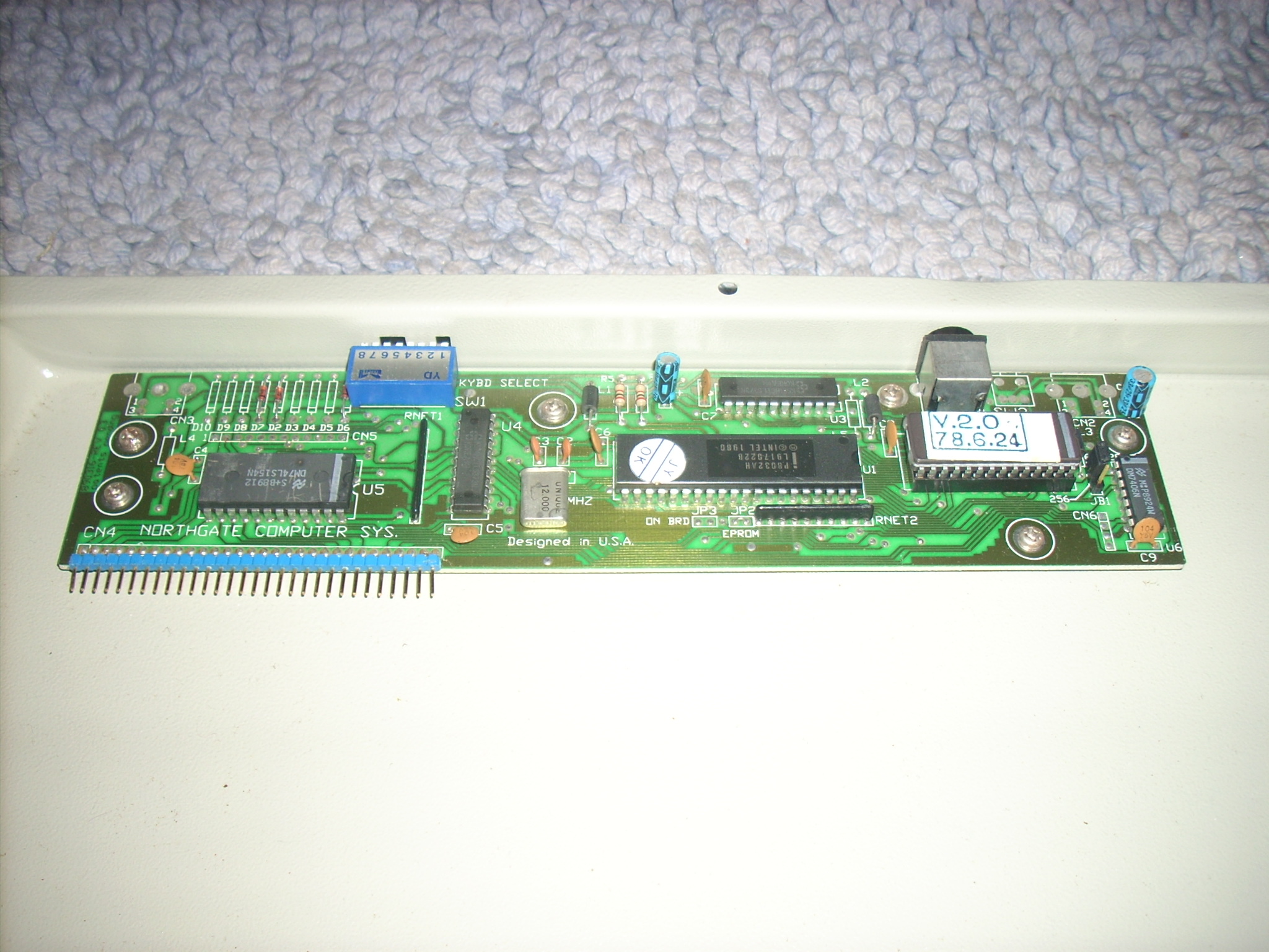

Connector is on a second PC board along with the dip switches. Only three of eight switches accessible from the outside world. Some Gen2 boards had a different connector board with two ADB connectors plus PS/2 and with all eight dip switches accessible. I'll dig one of those out later if needed; they're buried at the moment. Connector centerline is 8-3/16 inches from right edge of case.
Case size and upper row spacing same as Gen1.
Gen2 top view.
Gen2 top view.
Gen2 bottom view.
Gen2 bottom view.
Gen2 connector and dip switch detail
Gen2 connector and dip switch PC board.
Gen2 PC board.
Gen2 PC board.
Gen2 PC board detail.

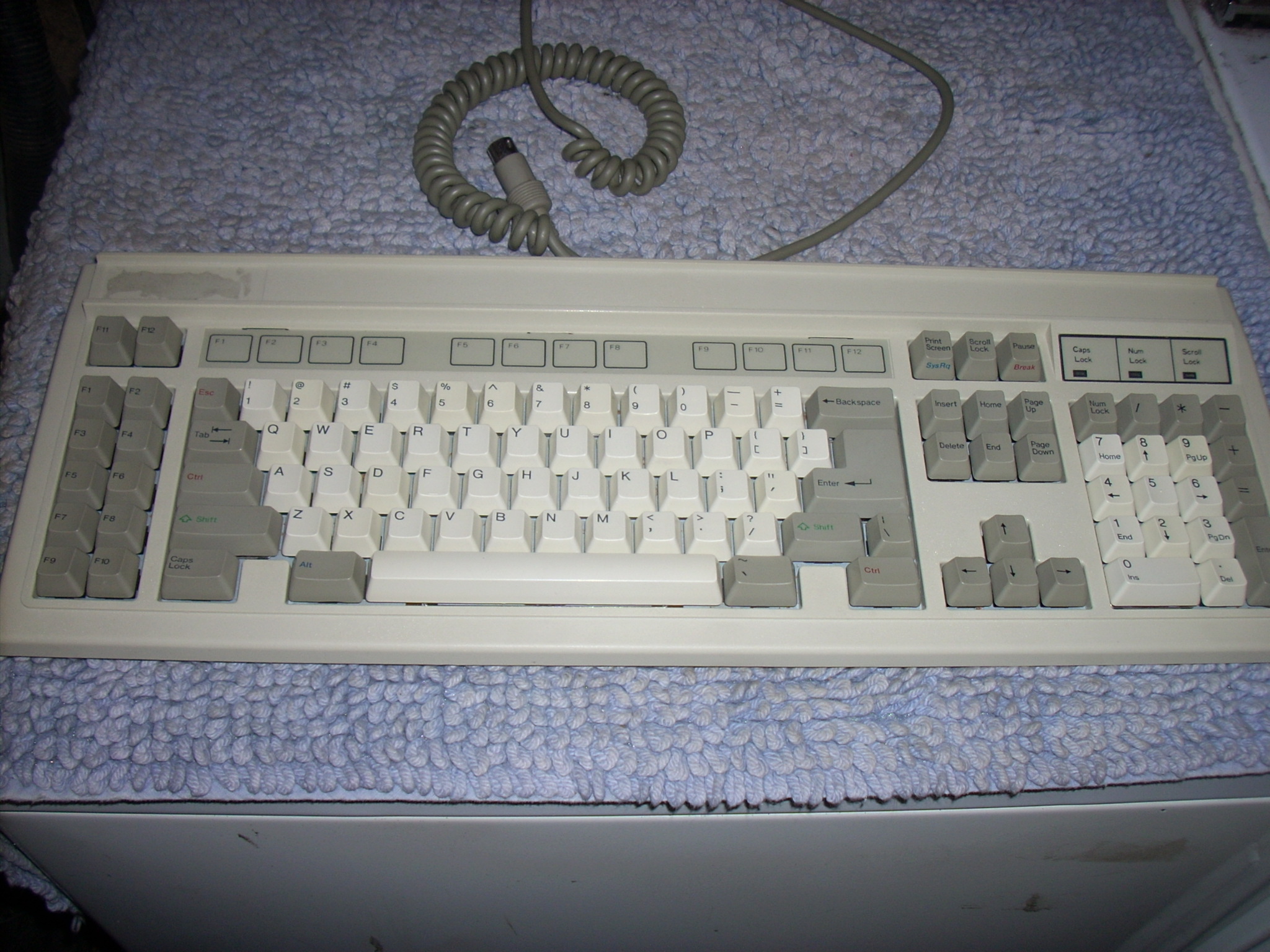

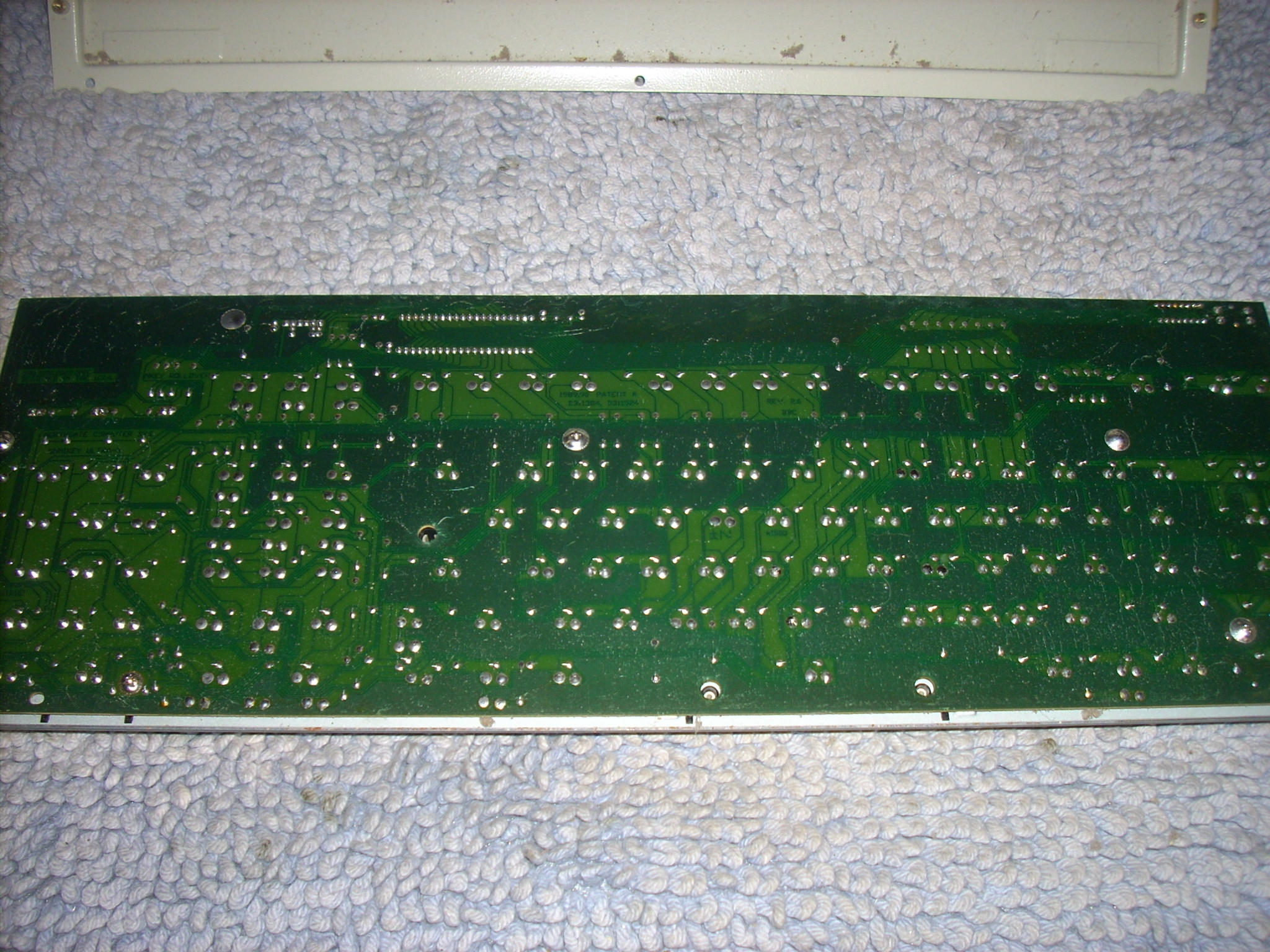

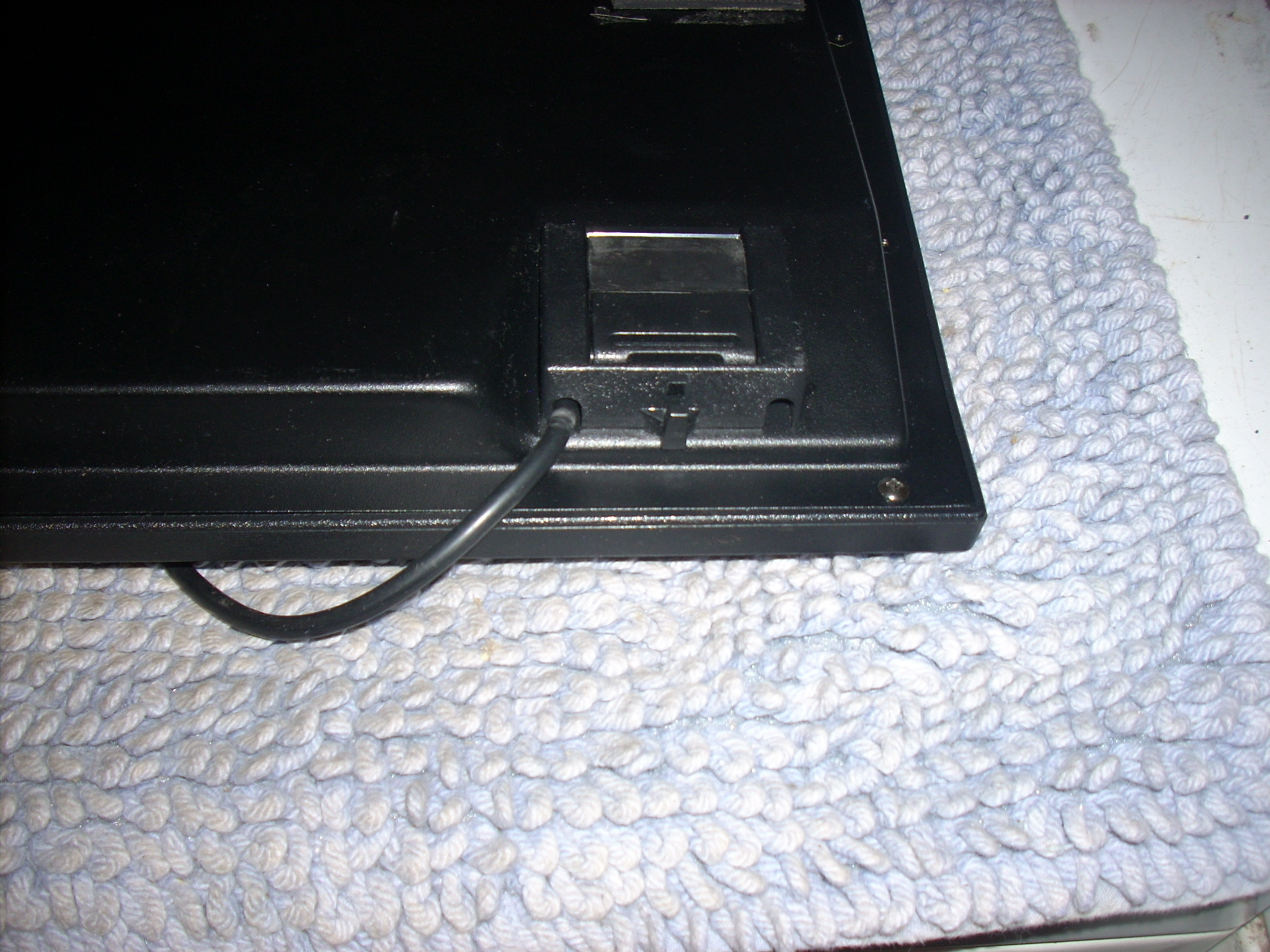

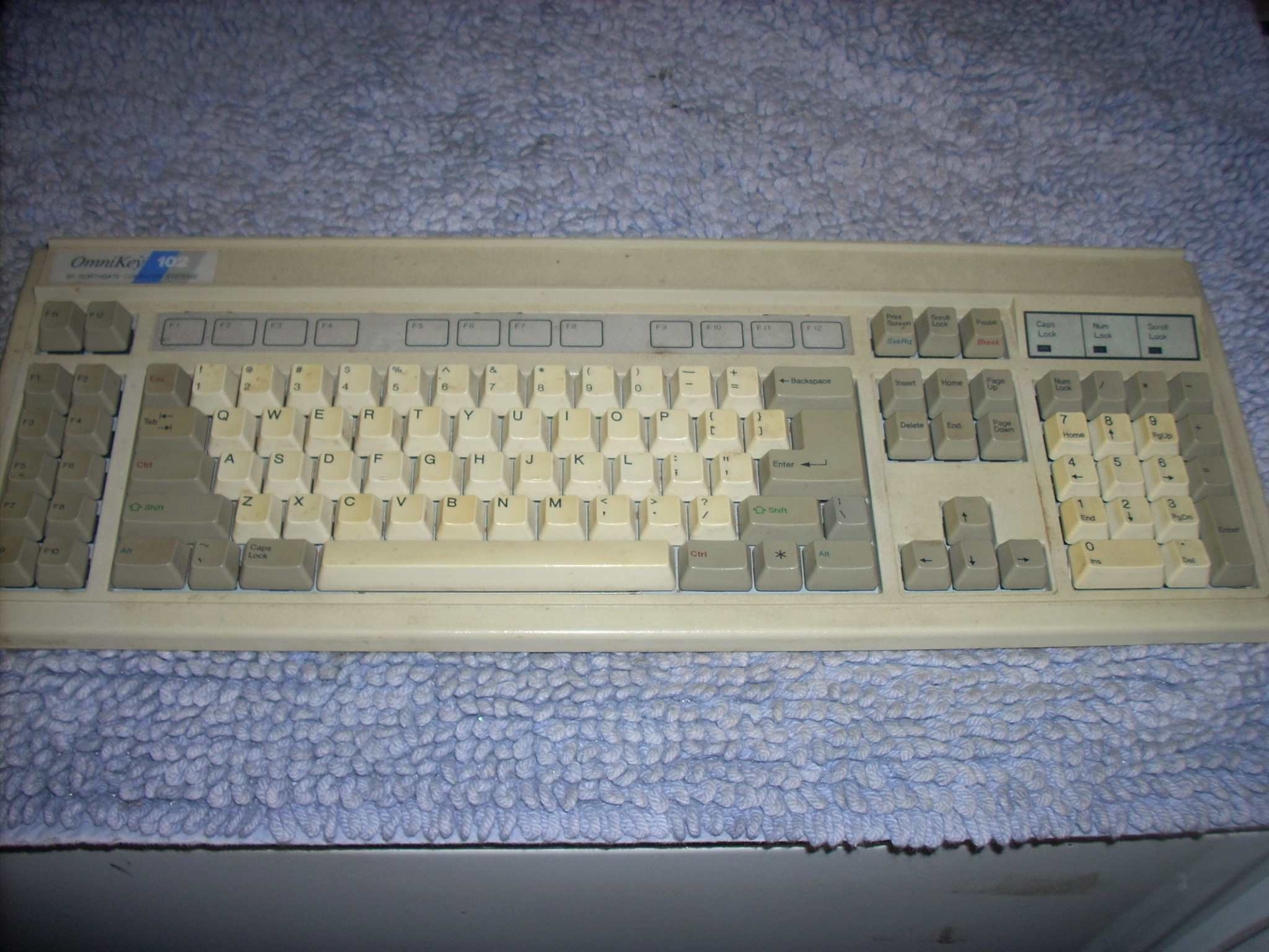

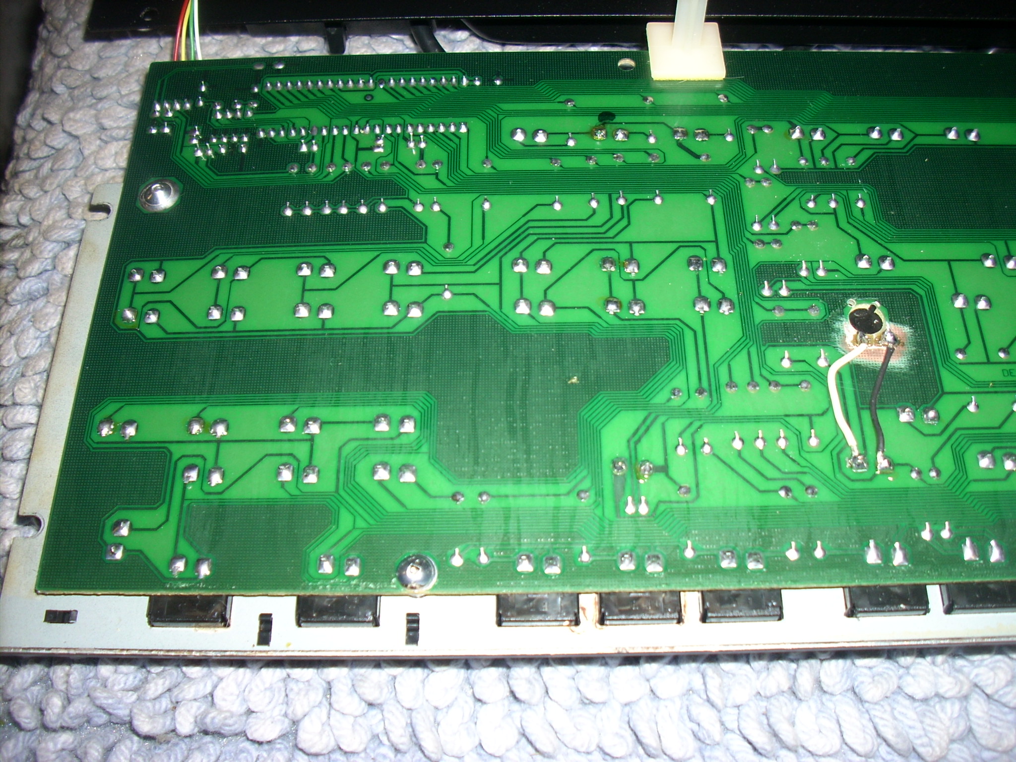

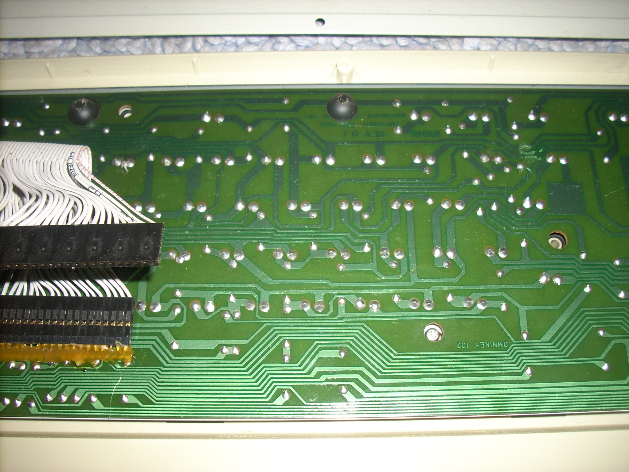

Gen3 Omnikey 102. Yep, it needs a bath. Detachable cord, dip switches under label/door on top cover, wired connector plugs into PC board. Plate mounts to base with four screws at edges. Connector centerline is 4-3/4 inches from right edge of case. There are probably more Gen3 Northgates out there than any other version.
Escape key moved to top row. Top row is 1-1/2 inches from second row (wider spacing than Gen1/2). PC board apparently shared with other models as it's labeled "Ultra". Case is bigger than Gen1/2, measures 20-1/2 by 8 inches.
Gen3 top.
Gen3 top.
Gen3 bottom.
Gen3 bottom.
Gen3 connector detail.
Gen3 plate detail.
Gen3 plate detail.
Gen3 plate detail.
Gen3 plate detail.
Gen3 PC board detail.
Gen3 PC board.
Gen3 PC board.

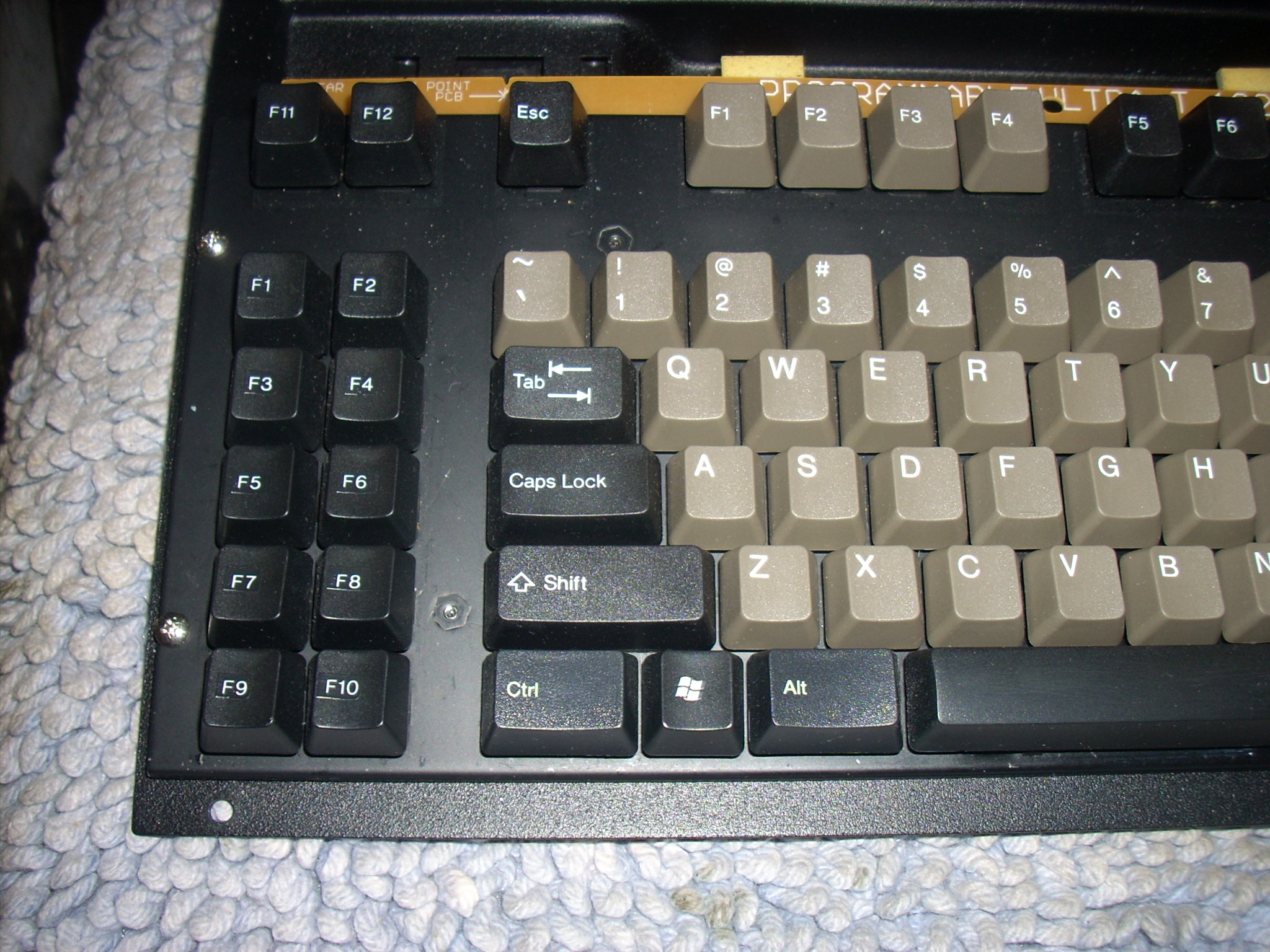

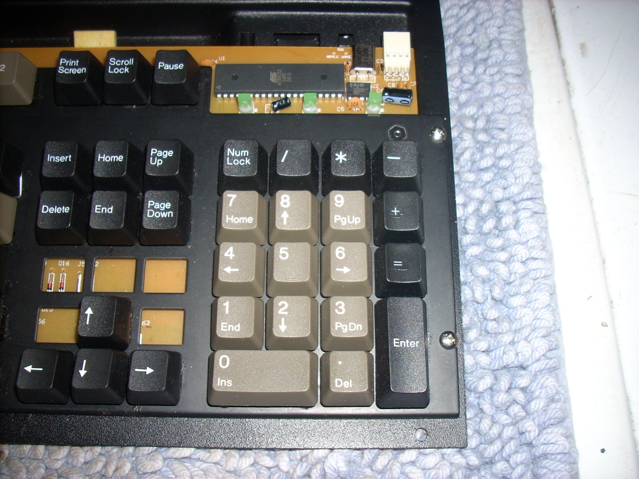

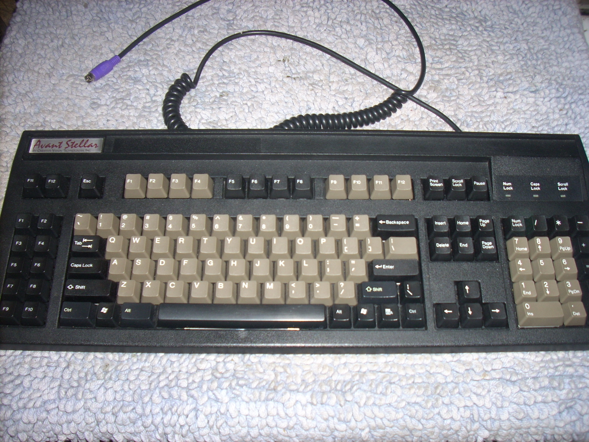

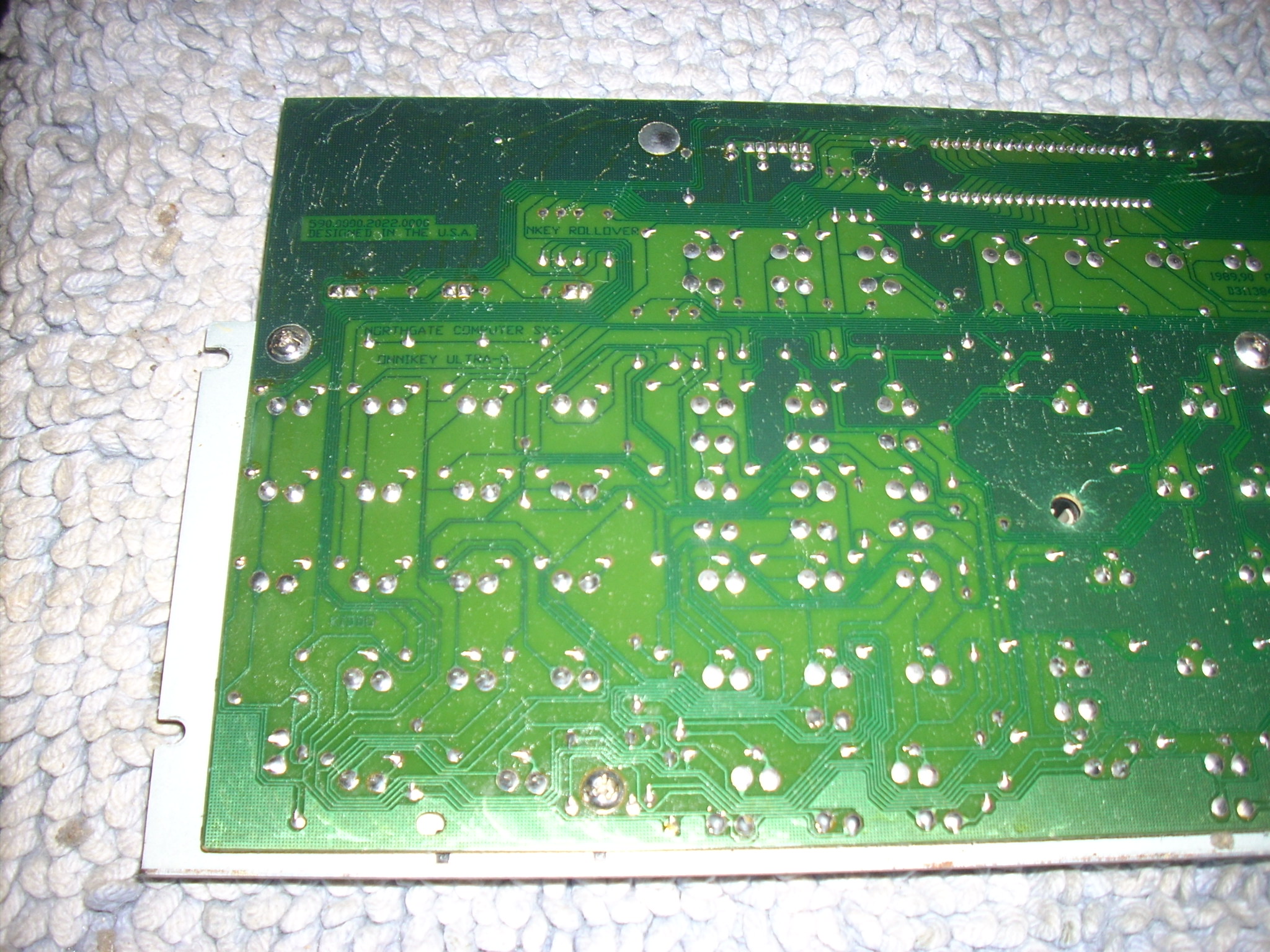

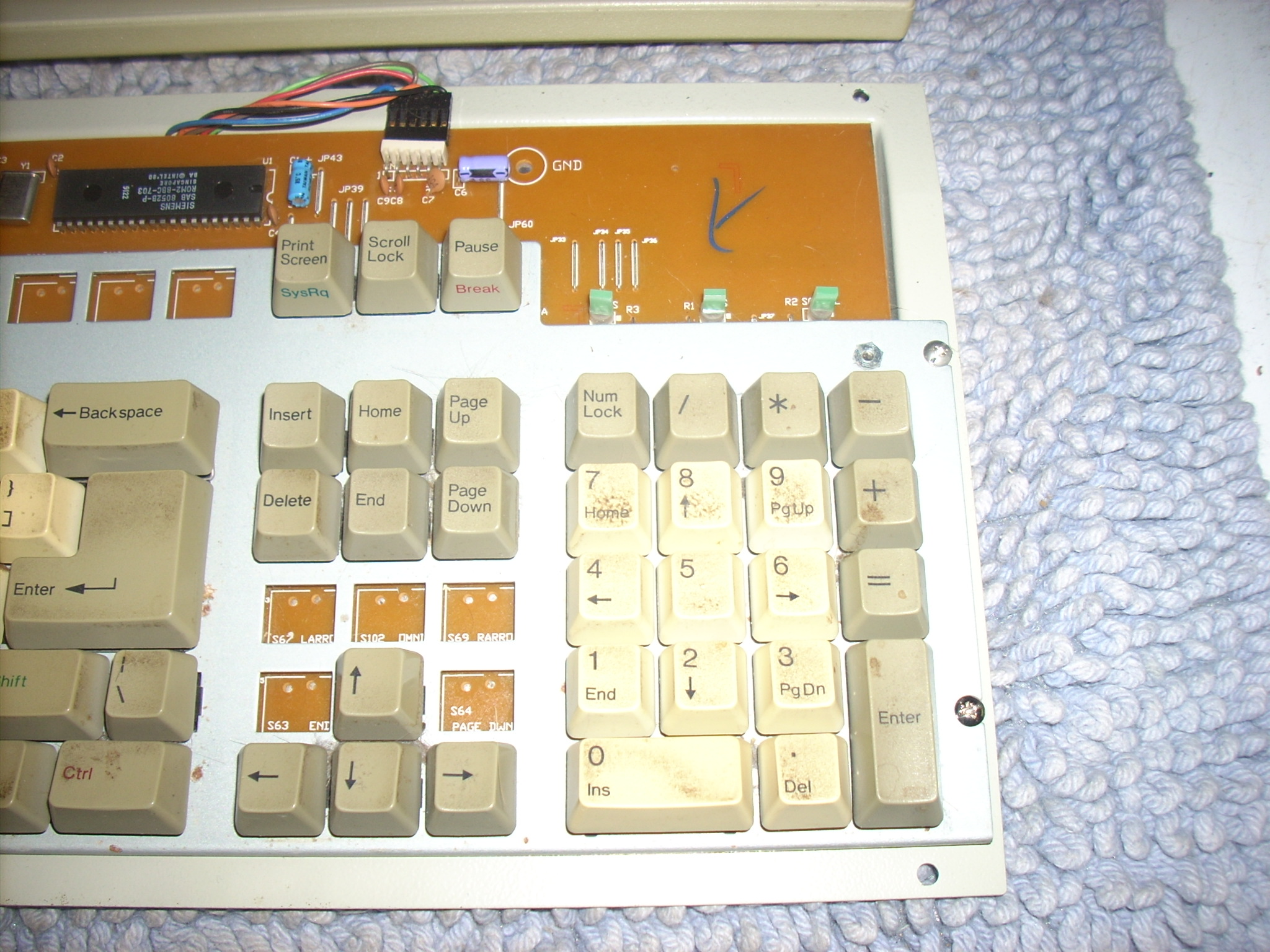

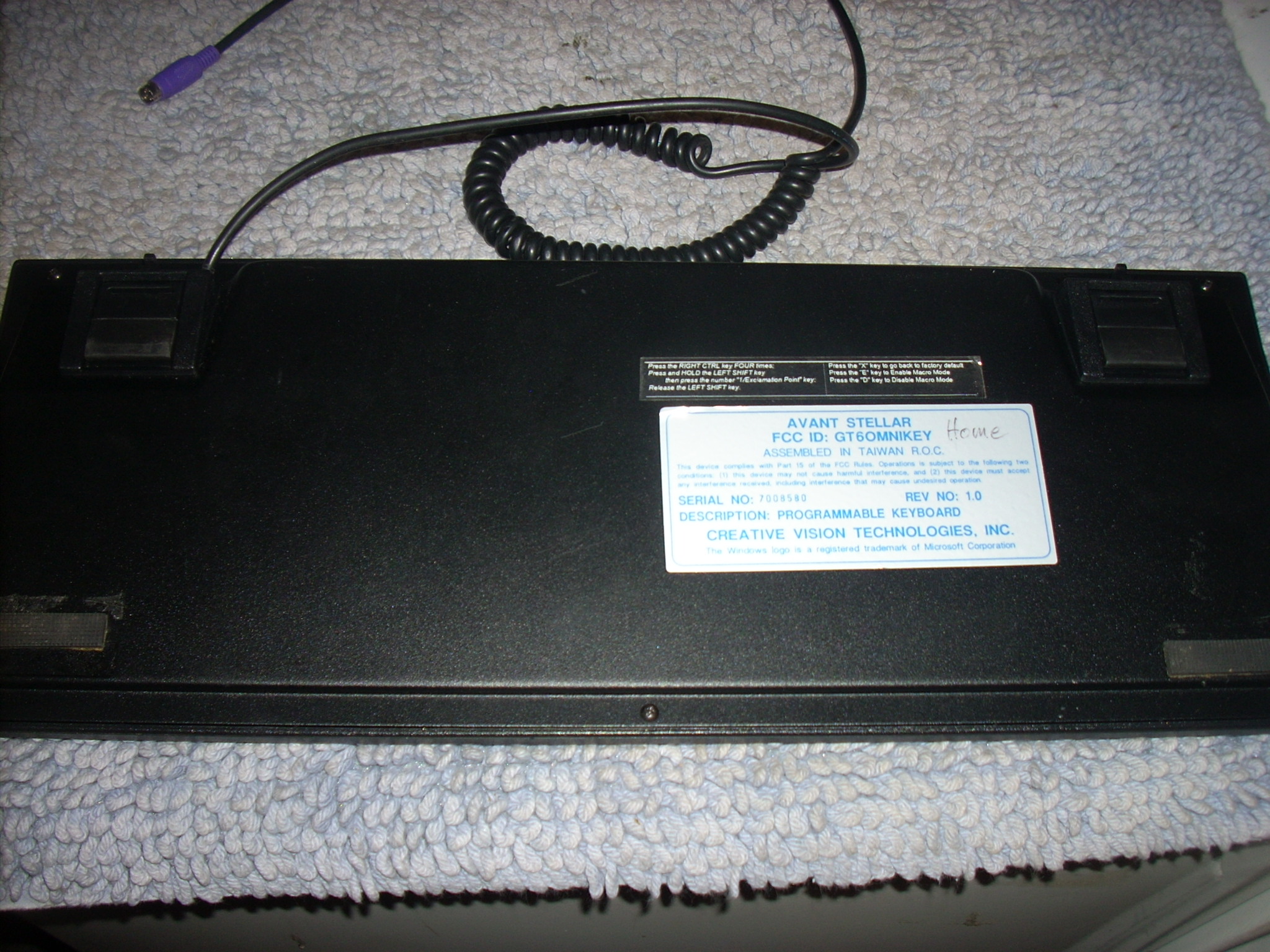

Gen4 (Avant Stellar). The programmable Northgates with Windows keys were similar. Note the PC board on this one is labeled "Ultra-T/102/101 PCB" and has a perforated breakaway section to use on a 101/Avant Prime layout. Ignore the ANSIfication and Dolch caps; it didn't come that way originally.
Case and upper row spacing are the same as Gen3. Plate mounts to the base with four screws at the edges. Cable is not detachable; it feeds in through the leg as on a Gen1. Note that Gen2 and Gen3 keyboards have the notches in the leg for a cable, and have the steel base punched so an attached cable could be used on those without modification.
Let me know if more photos or measurements are needed. I also have a small but growing database with more info on the different generations and models.
Gen4 top view.
Gen4 top view.
Gen4 bottom side.
Gen4 bottom side.

Gen4 plate detail.
Gen4 plate detail.
Gen4 plate detail.
Gen4 plate detail.
Gen4 PC board detail.

Rereading the earlier replies I have a few comments that might help.
"Ultra T is super easy and can use a panel mount extension, whereas the Ultra I think has a seperate control board that mounts to the case(which means I will have to come up with a solution for that."
This is not a difference between Ultra and Ultra-T; it's a difference between Gen2 and Gen3 Northgates. From what I can tell the Gen2 PC boards differed by model, while the Gen3 PC boards were "universal" (except for the 101). I believe all the models within a given generation used the same connector location.
In the photo I posted of the connector board on Gen2 you can see the locations for the ADB connectors, so that board was probably the same on all the Gen2 models except for the unused parts for the non-ADB version(s).
"I actually prefer the Ultra T as I love the extra switches and the split right shift is nice, but I would rather have and ansi enter...which I could do once I get this pcb in hand as the big ass enter is the same as an ansi enter as far as switch and stab location, it just replaces the \| key with a post. So this would even allow people to go to an ansi layout on the big ass enter boards."
The only issue with the ANSI enter is that the clearance hole for the stem on the BAE *almost* interferes with the pads for a backslash switch mounted there. I did the mod on the Avant, and managed to use part of the ground plane to make pads for the new backslash switch. The plate did not have to be modified for an ANSI enter, but would have to be changed to use a full sized right shift.
To make a PC board to fit the different case generations two sets of switch pads would be needed for the top row, since it's a quarter inch off between Gen1/2 and Gen3/4. Clearance holes would be needed for plate mounting screws on Gen1/2 cases where the plate mounts to the upper case. Pads for the switches would be needed for the different models/layouts, and some way to work with the different connector locations and attached or detachable cables. All of that can be done, of course, it just makes for a bit more of a design challenge.

And what is the spacing of the Gen1/Gen2 top row to the alpha cluster? I know the later ones have a 1U gap between the top row and alphas, but can't tell if it is 0.5U or 0.75U.
I believe that's correct on the Gen1/Gen2 models having the escape key in the alpha cluster, and the Gen3/Gen4 models having it in the top row. I don't know of any exceptions to that, but I can't prove there are none.
The LEDs moved up with the top row by 1/4 inch on the Gen3/Gen4 boards.
I gave the spacing above in inches, with the Gen1/2 boards measuring 1-1/4 inches center to center between the top row and the upper alpha row, and the Gen3/4 measuring 1-1/2 inches. Putting that in keycap units the Gen3/4 have 1U spacing in that gap. That would make for 2U center to center, with 2U equaling 1-1/2 inches, so that would make the Gen1/2 spacing 1-1/4 divided by 1-1/2 times 2 units, or 1-2/3 units. Subtract 1 unit and you have a space for a 2/3U cap in the gap. Now my head hurts. Pop, fizz, aaaaaahhhhh, that's better.
edit: it would probably be helpful to list the known models for each generation. So far my list shows:
Gen1 - 102
Gen2 - 102, Plus, Ultra, 101I, OmniMacUltra
Gen3 - 102, Ultra, Ultra-T, 101
Gen4 - 102P, Ultra-T, 101P, Avant Prime, Avant Stellar

Polecat wrote: 2/3U cap in the gap.
Are you sure it isn't a 0.75U spacing, seems more logical to me than 2/3U spacing. EDIT: Actually now thinking about it 2/3U makes more sense, as it evenly divides the 0.75" per Unit better...Good thing I asked as I would have messed up a part of the board thinking it was 0.75U rather than 0.667U
I have the board mostly laid out for switch locations, and trying to finalize the spacing everywhere to make sure it is correct.
Polecat
24 Feb 2018, 06:25
Please double check my thinking. On the Gen3/4 with 1-1/2 inches center to center (with 1U=3/4 inch) that gives 2U center to center. Subtract 1/2U from the upper row and 1/2U from the lower row and you get 1U (3/4 inch) between rows. On the Gen1/2 at 1-1/4 inches center to center, subtracting 2 X 1/2U (3/4 inch) from 1-1/4 inches you get 1/2 inch between rows, or 2/3U. As en engineer who has laid out PC boards in the past I tend to think in inches, and spacings center to center, but naturally the keycap units are important for fitting to the case.
BlindAssassin111
24 Feb 2018, 07:15
I am also an engineer, but I tend to prefer mm, but for keyboards it is a bitch using 19.05mm for spacing, so I have to use inches...
You are correct about the spacing, but I was thinking because keycaps go in increments of 0.25U, the spacing would also follow that, which is true for most boards, this is the first exception I have seen. So it was unexpected, but it does make sense when you think about the spacing in inches instead of units. Center to center makes sense, but for layout it is easier to see a spacing than a center to center measurement when just laying out the blocks. I use both but each one has its' pros and cons.
The switches are laid out now, so I just need the locations of the screw holes in relation to the center of some switch...as the board edge is not going to be a reliable thing to measure from. Just use the same switch for each to make my life easier, or don't...if you hate me, lol.

Okay, PCB is fully laid out minus the LEDs and still need the locations of the screw cutouts to finalize the PCB.
I made it so the left function block can be broken off for smaller boards. I may change how it is done to make it stronger than it currently is. So all variants should be supported.
Does anyone know how QMK/TMK works with LED indicators? Does it ground them out or power them? Need to know so I don't mess it up, I wasn't able to find anything when searching the wiki.

Hak Foo wrote: I could see getting one even though I don't have an Omnikey. Get a plate and sandwich case laser-ut...
Yeah I thought about making a plate for this, but it would have to be a specific layout, as alps switches have to have a certain width cutout, so I would have to make a plate for every single possible layout, which is way beyond what I can do right now.
If you want to make your own plate and case, you are welcome to, just let me know what you would need from me.
Hak Foo
25 Feb 2018, 09:10
It might be possible to build a plate using Swill's Plate Builder. If the board can be designed inside keyboard-layou- editor potential users can swap around variations easily and export the layout to Swill's Plate Builder, and end up with files they can send to Big Blue Saw, etc.
The only big deal is knowing the spacing between blocks in key units.
BlindAssassin111
25 Feb 2018, 18:38
Hak Foo wrote: It might be possible to build a plate using Swill's Plate Builder. If the board can be designed inside keyboard-layou- editor potential users can swap around variations easily and export the layout to Swill's Plate Builder, and end up with files they can send to Big Blue Saw, etc.
Forgot about Skill's builder, I can easily do that then, just give me until the GB opens, and I will have them ready.
