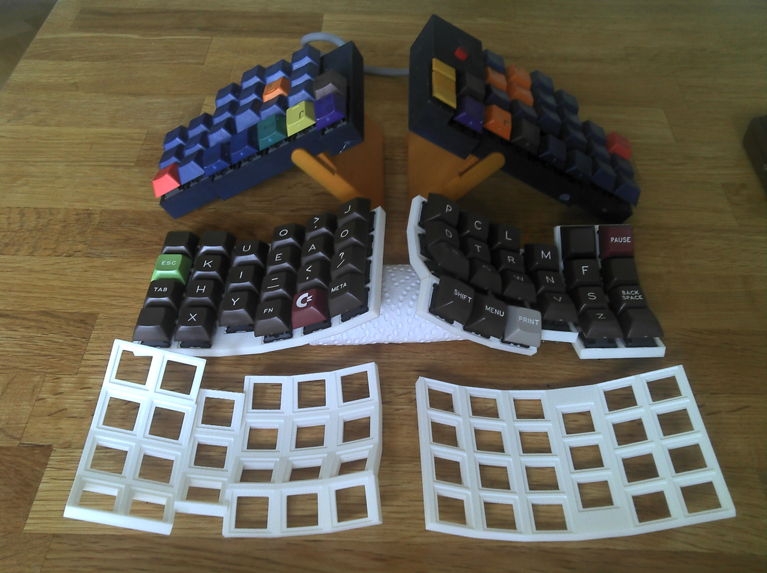

The arrival of my new Retro DSA keys prompted me to reiterate over my previous designs once more and this is the current state:
While the BlueCube has been a great daily driver for me, there are a few minor things that could be improved:
  • Outer pinky column unnecessary
  • 1mm more separation between columns would be nice
  • The tenting is great, but since I used a flat plate I need wristrests of about 5cm height to comfortably type.
  • Colours. That's what happens if you order dyes and are anxious to try them out, and all you have is a prototype board.
  • The whole case is large and blocky with lots of sharp edges. No issue, but not very portable without protection.
  • Trackpoint housing makes the case even larger, and the ML mouse buttons are not needed
BlueCube reloaded
BlueCube reloaded
So with the next round of boards, I will go for black spraypaint on the base and design a separate (interchangable) case, or use aluminum profiles for the HyperNano. The outer pinky columns might still be dropped as I do not really need the extra keys there. The thumb key symbols are mostly incorrect and just for show, but at least I'm able to finally put my layout on the board thanks to the symmetrical nature of the caps. Not that I'd need it anymore, but it answers the most curious questions about the board best I guess :D
Now I only need to decide which one I want to build: Only the simple tilted one or the full bowl shape one? I currently can not say for sure which one feels better, I guess until I figure that out I might build one of each and put the teensy into a little separate box to be able to connect any half I want.
Then again, I also do not know yet what switches to use: Blacks on the BlueCube are ok, the clears on the HyperNano feel good, too, but wanting to go lighter I might return to browns. Or reds? Questions over questions :evil:
kind of DSA, 22mm total height

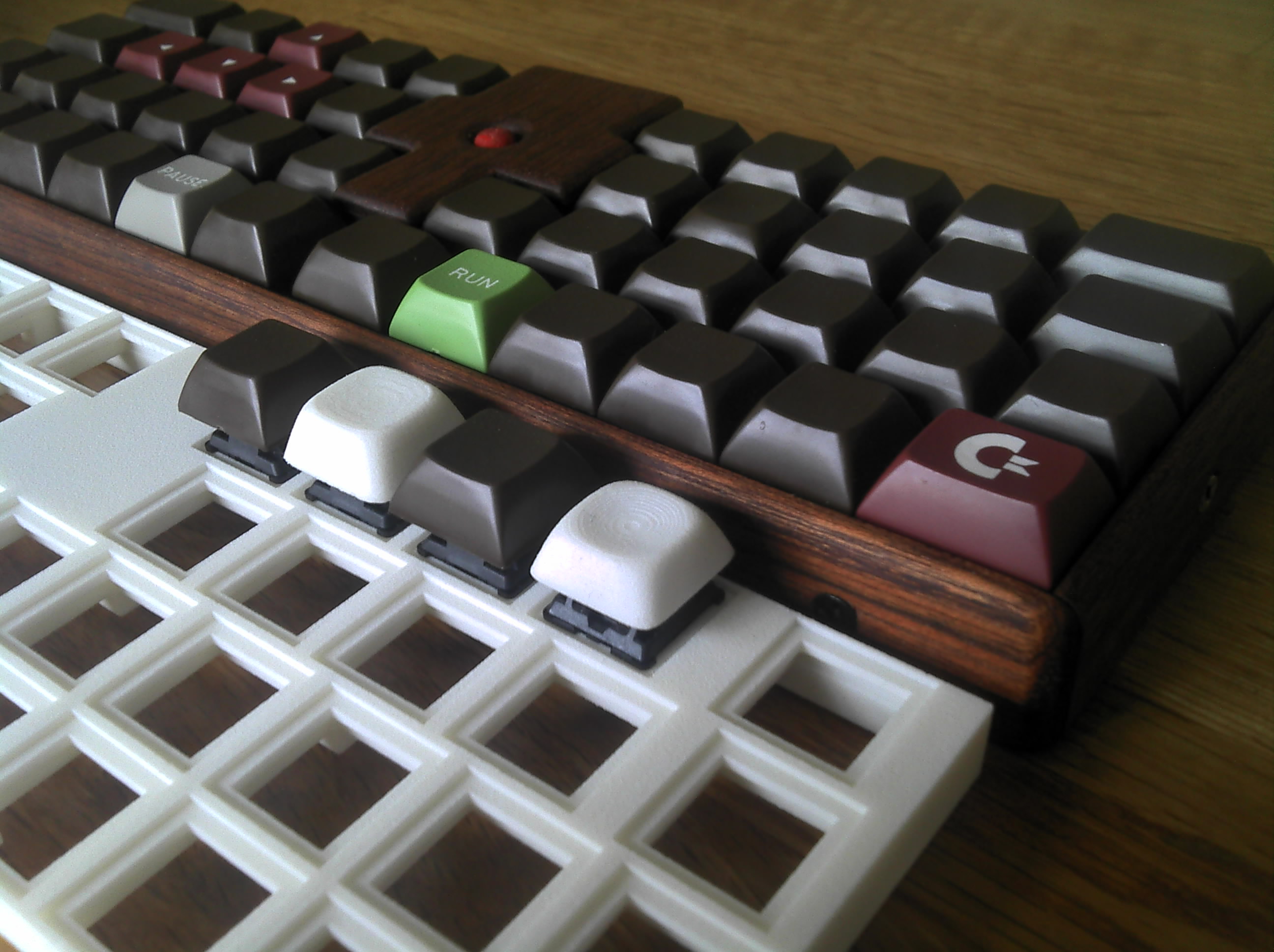

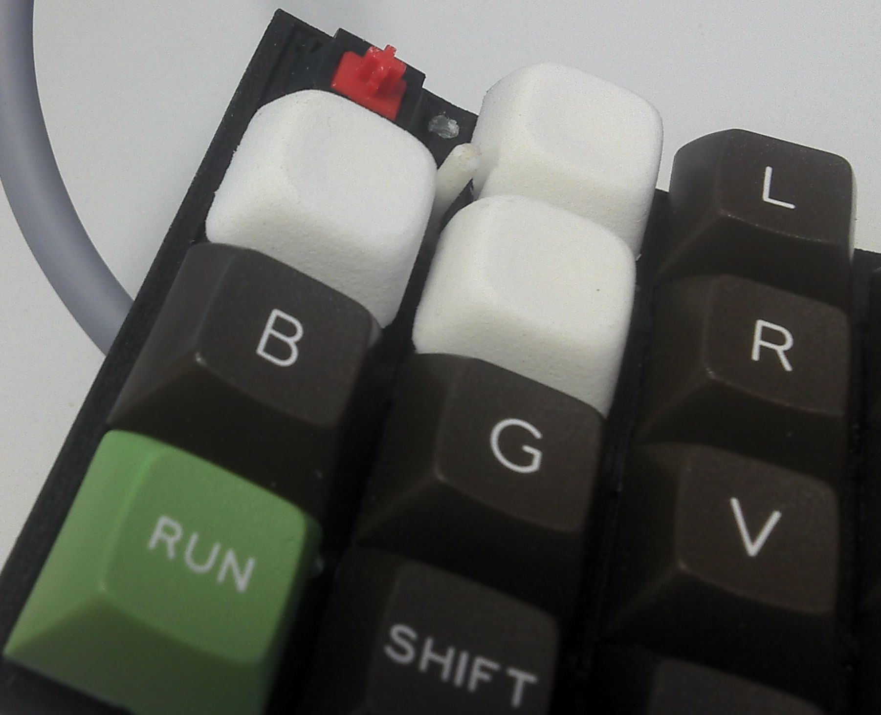

On the HyperNano side of things, I prepared a minimalistic case with added column separation and the absolute minimal height possible: Using custom keycaps inspired by the DSA profile, the entire height comes down to 22mm! Without bending the pins on the switches, less does hardly seem possible.

23 Jun 2013, 13:48
Those custom caps look quite something! The smooth white one on the right, especially. How did you get a hold of them?
suka
frobiac
24 Jun 2013, 09:30
They were laser-sintered (and not post-processed, as you can see on the stepped circles in the center). They feel pretty good already even with the rough surface, and will maybe be used in an upcoming design study I have planned :D

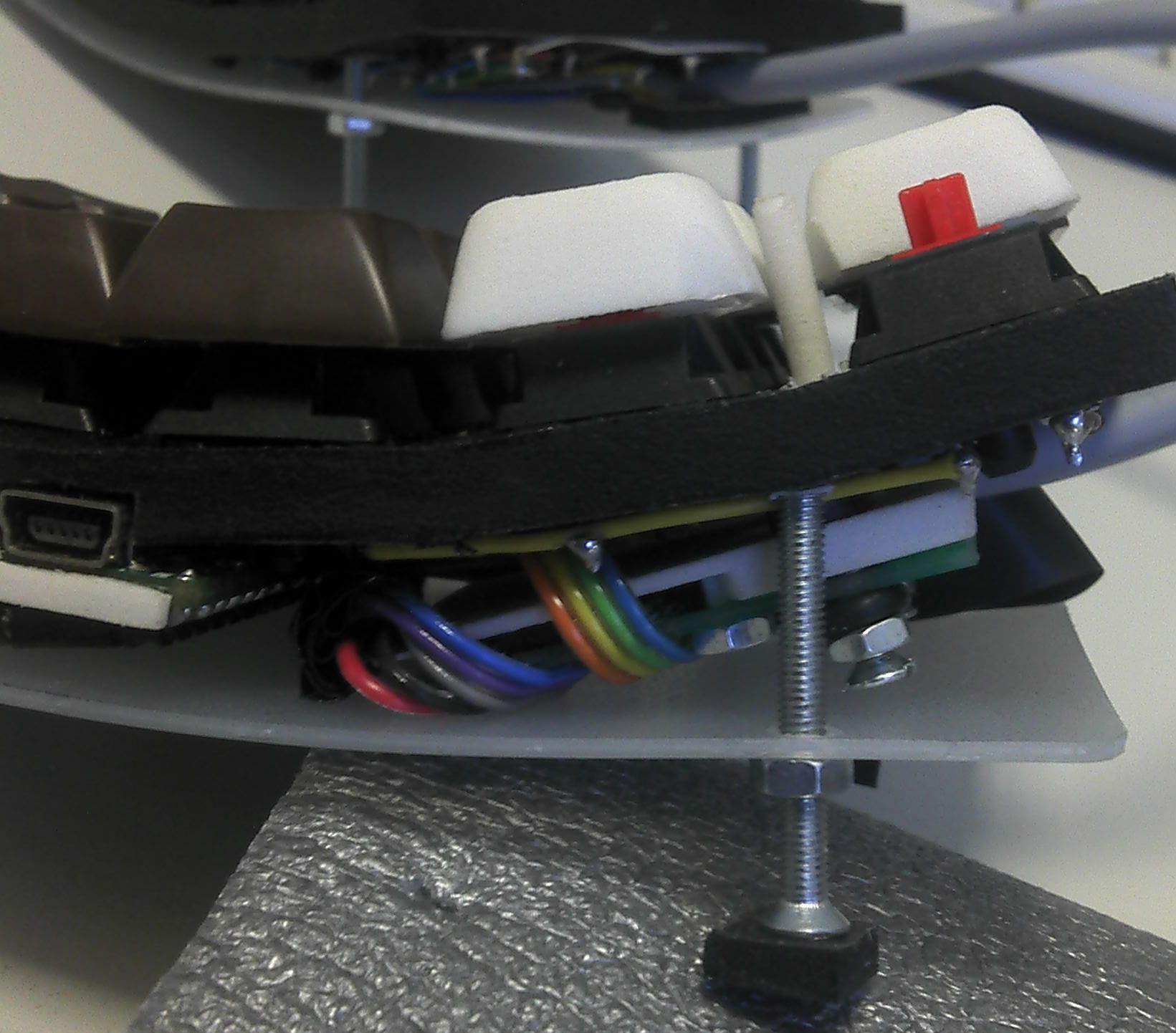

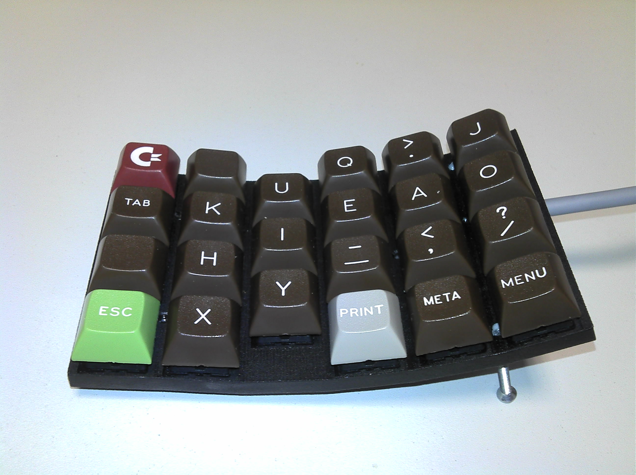

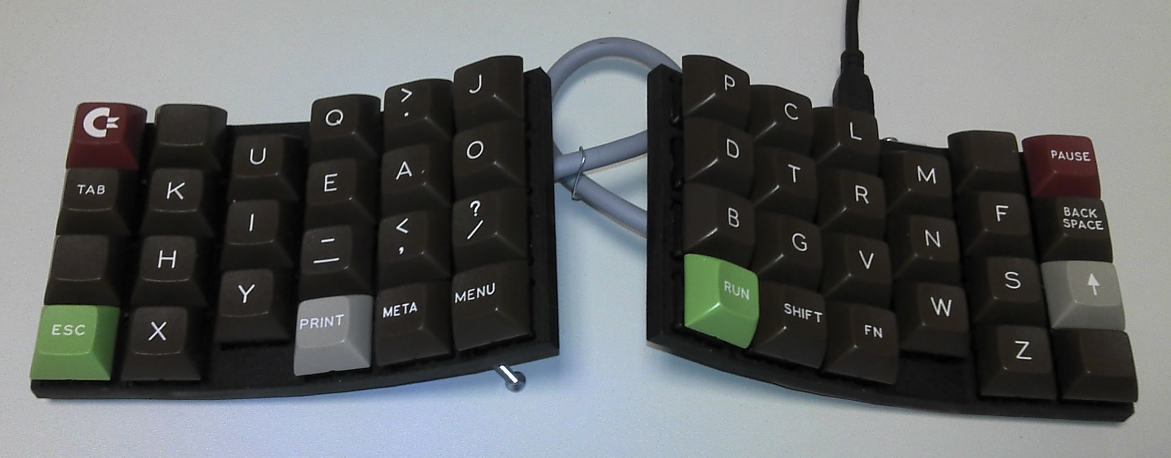

And another custom prototype - dubbed RedTilt for now - is done :-)
I used purely red MX on my flat-column/tented-rows design to feature the great retro caps I recently acquired, and must say I am quite impressed:
Compared to my relatively steep BlueCube setup with about 35° of tenting of the otherwise flat board it is curved rather conservatively, with 10° steps between the innermost 5 of the 6 columns. A major change was decreasing the overall height so | would not need such a huge wristrest anymore: Something like 26mm on the outmost columns is already near the minimum achievable without modding the switch bottoms themselves, but seeing how easy that is I might just try it on the next revision.
Also, the simplified column stagger does feel natural already (Yes, I am currently typing on this beast) : It seems to me that the difference in wrist rotation makes up for a lot of the changes, and compared to a single board like the HyperNano above the split setup allows further adjustments in distance and rotation.
Within just 10 minutes, I have been up to 90% of my previous typing speed with the same accuracy, something I was never able to do without at least a day of adjusting to a completely new board design, so that seems like a good indicator for the ergonomics (my personal ergonomics, that is) of this variant. Of course, it could also be the red switches - I haven't come to any conclusions yet, but together with o-rings the effortless typing is really interesting.
Next up is the trackpoint installation and some way to protect the bottom for transport, but that's not a real #1 priority on a prototype :D
All in all, I must say I am really satisfied with the result and think I'm on the right track to finally find my personal dream keyboard.

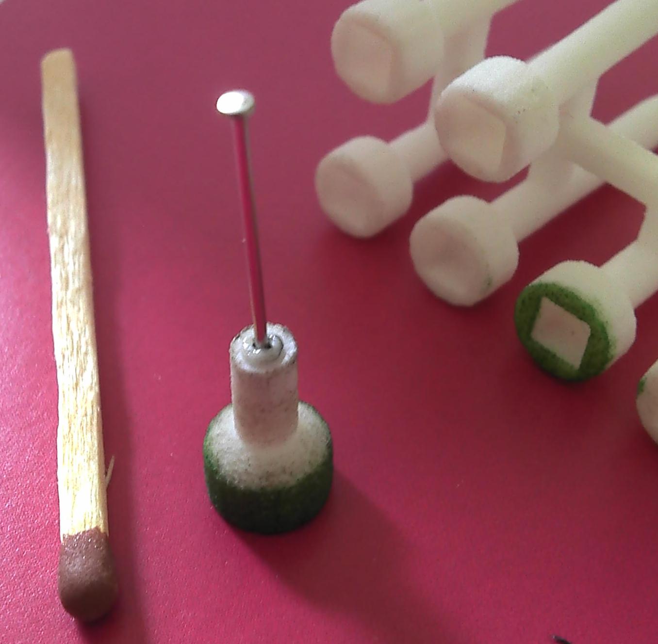

04 Jul 2013, 17:25
Can't take pictures of the keyboard now, but here is my initial try for illustration purposes: It replaces the white stick in the pictures above and fits nicely right between the keys - the lateral movement of the needle is hardly noticable. I haven't added a proper "cap" of any sort, mainly because it works great as it is and the tiny surface keeps me from exerting too much pressure automatically.
