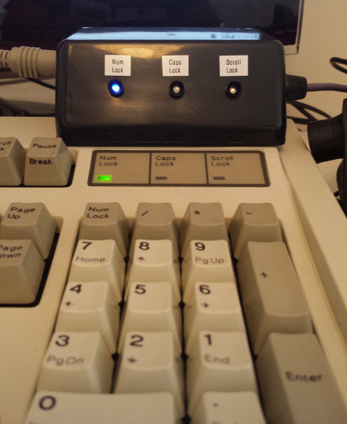

Hello Hasu,
I would prefer to add the code, after the required review and if agreed, to the mail branch. In this way I will not have to maintain my own local version.
I attach a picture of the result :-)

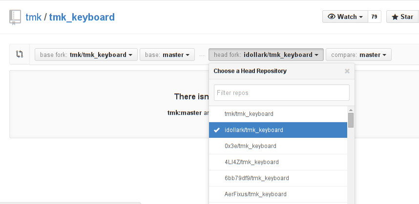

I have tried to create a pull request. The problem is that I cannot do it against my code. My local branch (the one that I have in my computer) is not in the server. I cannot push to it (refer to my previous post). I can pull the code, but I cannot push anything to the repository.
Let me be a little more verbose. We may get there :-) After my reading I came to the following conclusions:

I am actually typing with your converter AND THE CAPSLOCK LIGHTS WHEN TYPING THIS :-)

I can access the menu in github but only my fork, without my new branch is offered. That's normal, my code is not in the server.
6.- The next step would be you review my pull request and add the code to the server if agreed. (tbd)
I guess that somehow the owner of the repository shall allow me to work on it. Am I correct ?
As I said, I have only retrieved (forked) git code before. It is the first time that I use it to propose changes. I know that this is not the topic of this thread, but I guess that it is somehow interesting as other people that may want to propose changes may have the same problems.
I must admit that I also had some problems to find "useful" information about github. There is lot of documentation, but there is not simple explanation on how to do the very basic thing that we (I) am trying to do here.
Cheers
hasu
10 Nov 2014, 17:41
Nice converter setup :D
at step 4 you should push your commits into your own github repository instead of 'tmk'. Problem is that origin means tmk repository, not yours.
To change repository this will work.
$ git remote set-url origin [email protected]:idollark/tmk_keyboard.git
Then push your commits into your own repository.
$ git push
EDIT:
or your may need this to push the branch.
git push origin phys_leds:
Now you can create pull request with github menu probably...

I thought that the LED code would also be interesting for other converters/controllers. This is why I added it into under common/. I could imagine that this feature would also be needed by people using something different than a ps2.
I post the ULR just in case that someone else wants to read the proposal.
https://github.com/tmk/tmk_keyboard/pull/141/files
BTW: I have been using the converter with LEDs for more than two weeks now without any problem.
Cheers

    PAUS,INT5,  CAPS,A,   S,   D,   F,   G,   H,   J,   K,   L,   SCLN,QUOT,     NUHS,ENT,        UP,         P4,  P5,  P6,  PCMM,
    APP, INT6,  LSFT,NUBS,Z,   X,   C,   V,   B,   N,   M,   COMM,DOT, SLSH,     RO,  RSFT,  LEFT,INT2,RGHT,  P1,  P2,  P3,  PENT,
    RGUI,LGUI,  LCTL,     LALT,               SPC,                          RALT,     RCTL,       DOWN,       NO,  P0,  PDOT,NO
    // pseudo ANSI
    KEYMAP(
                     F13, F14, F15, F16, F17, F18, F19, F20, F21, F22, F23, F24,
                     F1,  F2,  F3,  F4,  F5,  F6,  F7,  F8,  F9,  F10, F11, F12,
    PSCR,ESC,   ESC, 1,   2,   3,   4,   5,   6,   7,   8,   9,   0,   MINS,EQL, NO,  BSPC,  INS, HOME,PGUP,  NLCK,PSLS,PAST,PMNS,
    SLCK,INT4,  TAB, Q,   W,   E,   R,   T,   Y,   U,   I,   O,   P,   LBRC,RBRC,     NO,    DEL, END, PGDN,  P7,  P8,  P9,  PPLS,
    PAUS,INT5,  LCTL,A,   S,   D,   F,   G,   H,   J,   K,   L,   SCLN,QUOT,     BSLS,ENT,        UP,         P4,  P5,  P6,  PCMM,
    APP, INT6,  LSFT,LSFT,Z,   X,   C,   V,   B,   N,   M,   COMM,DOT, SLSH,     NO,  RSFT,  LEFT,INT2,RGHT,  P1,  P2,  P3,  PENT,
    RGUI,LGUI,  LCTL,     LALT,               SPC,                          LGUI,     GRV,        DOWN,       NO,  P0,  PDOT,NO
Tested.
I have attached my "terminal_usb" directory to ease the understanding of the description above. You can also use these new files instead of the ones in GITHUB. I need to check how to update my code proposal in GITHUB (new challenge :-))
EDIT: I think I managed to update github also
The only thing that is left is to check the "a" key of my keyboard. It seems that is not working fine after the bold-mod ;)
Cheers
i$
terminal_usb.tar.gz
