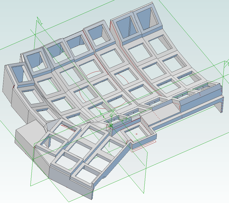

Would it make sense to tilt thumb pad more?
E.g. for the right half of the keyboard:
- keep the right edge of thumbpad same level as now
- lower the left edge of thumbpad as much as possible
I mean making a step in the direction of Oobly ergonomic keyboard:

The extra thickness from [Modification 3] might allow for
4.1) bigger tilt in thumbpad (more like Oobly ergonomic)
4.2) bigger tilt sideways and away from user (more like Microsoft Natural with a stand): http://allthingsergo.com/blog/wp-conten ... GP0152.jpg
4.2 is of course achievable with stands

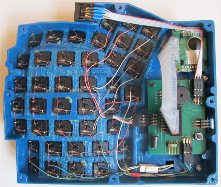

OK, if you have access to an FFF 3dPrinter then you can get models of the case here. Follow the link to share-it later on. There is enough payment options on share-it.
If you want something more then you need to be able to do a money transfer to an IBAN account in Slovakia (i.e. something like 7bit's PAYEUR option) and you must be able to receive a SEPA transfer to the account from which the you will pay. The condition to receive a SEPA transfer is there so that the money can be sent back to you if something would go wrong. UK banks must provide SEPA transfers to their clients sometimes by the September of 2016. Your bank may already provide it or may not yet. UK is special so I do not know but for most other EU countries SEPA is available for free or only a few cents.
The other things I can provide are these:
  • Two PCBs (one for the left side and one for the right side). The PCBs will have parts with reference number smaller than 10 soldered in and the bootloader and the firmware will be preloaded. Price 44 €. I can add two RJ45 jacks, some crimp housings and crimp contacts to connect to the PCBs (if you want pin headers on the PCBs instead of soldering wires directly to the PCBs), and the one IDC receptacle for LCD. This would add 10 € to the price.
  • Raw printouts of the case from an FFF 3dPrinter. These need post-processing as indicated here. The post-processing takes about 14 hours if you already have some experience with it. Price 65 €.
  • Case from an FFF 3dPrinter. The quality is poor compared to an injection molded plastic. The whole case may have a little bit bent in it (about 1-3 mm deviation from bottom plane) when it is finished. I'll compensate for this with glued rubber legs of proper height at the bottom. Price 170 €. We would do it like this: I'll make the case first and then send you detailed pictures and a measurement how big the bent is if any. Then you would decide whether you want it. The case would be sold as it is. I'm willing finish only about 2 cases like this. So this is only a limited offer for people who want to try Katy v0.7 and are too afraid to post-process raw printouts themselves.
  • If you want a pretty and true case then it needs to be pritned using an SLS 3dPrinter. I do not have access to such a printer yet (and maybe I'll never will because prices for new ones are in many tens of thousands). But you can just buy the STL model of the case from shareit and then drop me an email with your shareit order number and I'll send you STL files more suitable for an SLS 3dPrinter for free (the same license) in about 2 days (I did not make them yet). Key-part and palm-part will be merged in the STL model, therefore no need for glueing. A commercial 3dPrinting service will ask about 270 € for printing them. It should look better than the result from an FFF 3dPrinter but I do not know how much better. I did not try this yet.
You need to get yourself all the other things. At least that is the current situation. It may change but not sooner than in about half a year ... and maybe never.
Shipping: I checked few options and it is all about the same. A courier (e.g. UPS) to London would cost about 130 €. A simple post to UK is about 15 €. No tracking number here and it may get lost in post. There is an option to require your signature when delivering it, but I do not know how much this adds to the service cost yet. Requiring a signature at delivery is the only additional service available for UK.
It would be send at the beginning of January after the money transfer arrives. So if you want anything except the STL files of the case then drop me a PM so that we do not bother the general audience here.
The modifications:
Additional F1-F12/F14 keys. I do not ever intend to add these for myself. When Layer/Keypad shifts are so easily available on thumb cluster then I just do not see much point in it. This is also the reason why it has so many thumb keys.
Oobly's thumb cluster. I considered this seriously but the main reason I did not do it is that it would make the keyboard taller. And I would be probably forced to lower number of keys in the thumb cluster too.

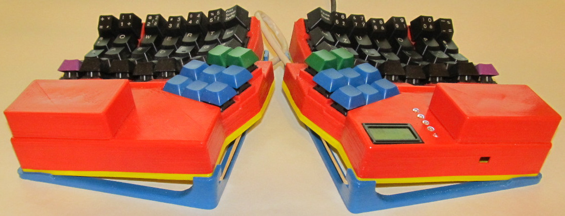

It would wobble. The bottom is only 1.6 mm thick ABS plastics. It is planar. You need to screw a flat (maybe wooden board) to the keyboard bottom first and then mount it all on your ball head. If you screw the keyboard bottom to the wooden board near the 8 screws present on the keyboard case then it should be strong enough. And I think this modification should stay separate so that people who do not want it do not get a taller bottom.
atagunov wrote: 4.1) bigger tilt in thumbpad (more like Oobly ergonomic)
Yes, I want to design special stands on which the keyboard would sit. I'm just not sure how quickly I get to it.
And I'll probably try Oogly's thumb clusters but before that I want to give a shot at a track point. That means that Oobly's thumb cluster is at least a year out.

Hi, vvp, received 0.6 prototype fully intanct! Very pleased and thx for great packaging!
Thumb cluster much better positioned than on Kinesis, also having more keys totally makes sense.
Great to have the halves split. It's a success in bettering Kinesis!

31 Jan 2016, 02:04
And for the few guys who are trying to build v0.7 themselves.
I made a simple tilting stand.
If you want it then the STL files are here.

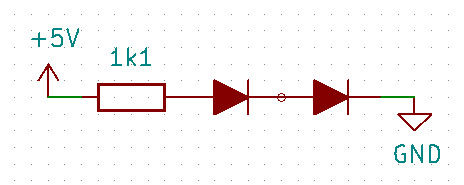

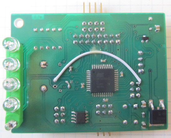

I'm being asked about adding LEDs to the keyboard. Therefore here are some notes about it.
The biggest problem with LED backlight is that we have only 100 mA of current available till the keyboard is enumerated (which happens at the start of the keyboard firmware boot). We can draw 500 mA of current after the keyboard is booted up. I'm not sure how much USB controllers in a PC or a hub would cope with a device which draws full 500 mA of power even before the enumeration is done. My guess is that it would not matter most of the time.
Katy was not designed to support back-lightning. If I would do it then it should be done properly; i.e. an ability to control brightness of each LED separately from software as it is currently possible with the 4 status LEDs. This requires a new schematic and PCB.
But there is an option to add simple LED back-light to current Katy electronics. First the simple constant colour/brightness option:
I would add a single LED into each switch. The goal is to save power as much as possible so that we have a chance to get enough light even ... hopefully within 100 mA. That means selecting high brightness LED which we will drive significantly below its maximum current and preferably LED which has forward voltage at 2 V or below. Low forward voltage allows us to connect two LEDs in series and we still get below 2+2 < 5V available from USB power lines.
An example is here: http://sk.farnell.com/vishay/tlhf42u1v2 ... dp/2251288
The LED package is T1 ... it will still fit below the standard OEM or SP DCS keycaps. A problem may be with some special low profile keycaps ... in such a case you can file the top plastic dome of the LED ... just do not file it down to the metal parts inside the plastic package :) Filling the top of the LED may be a good idea also as a way to increase light dispersion.
Low forward voltage requirement means that green/white/blue colors will not be available since these typically require about 3V ... and we would not be able to connect two LEDs in series ... and we would consume more power.
The LED luminosity is 0.7 cd at 20 mA or about 52.5 mcd at 1.5 mA. Let's assume that is enough. The power consumption will be 80 * 1.5 / 2 = 60 mA for back-lightning. Plus about 30 mA the consumption of the keyboard itself and we get below 100 mA which is very safe and will always work.
When we look at the forward current versus forward voltage of this diode then we get about 1.67 V for forward current of 1.5 mA. Therefore the resistor needed for each two LEDs in series is (5 - 2*1.67)/1.5 = 1.1kΩ
So schematic for two LEDs will be:
Lets say that we want much more brightness. If so then we need to either find more bright LED (more efficient) or break the 100 mA limit for maximum current before enumeration. Let go and break the maximum current limit. To do so I would recommend to add a mechanical switch which will allow to turn off all the backlight LEDs at once. This may be needed if the keyboard would not boot after connecting to a computer (because we are above 100 mA before enumeration). The solution would be to turn off backlight with the switch, re-connect the keyboard and after it is enumerated (i.e. working) then we can turn the back-light LEDs on.
Lets use 400 mA for back-light which is about the maximum available. For one diode we get 400/(80/2) = 10 mA. The LEDs I selected will be crazy bright at this current (0.35 cd).
When we look at the forward current versus forward voltage of this diode then we get about 1.83 V for forward current of 10 mA. Therefore the resistor needed for each two LEDs in series is (5 - 2*1.83)/1.5 = 134Ω ... well the nearest higher value on farnell is 137Ω. So that would be the one we would use.
Second option is a more complicated but it would allow to control brightness of all back-light LEDs from firmware at once. No individual LED control. This is possible to do by removing power saving features from the photo-sensor and using the freed pin to control the LED current (through a transistor). You can do this only if you have also some experience with C programming since you would need to adjust the firmware. If there is such person who is able to do a bit of C programming and wants back-light then ask and I'll post more information about this option.

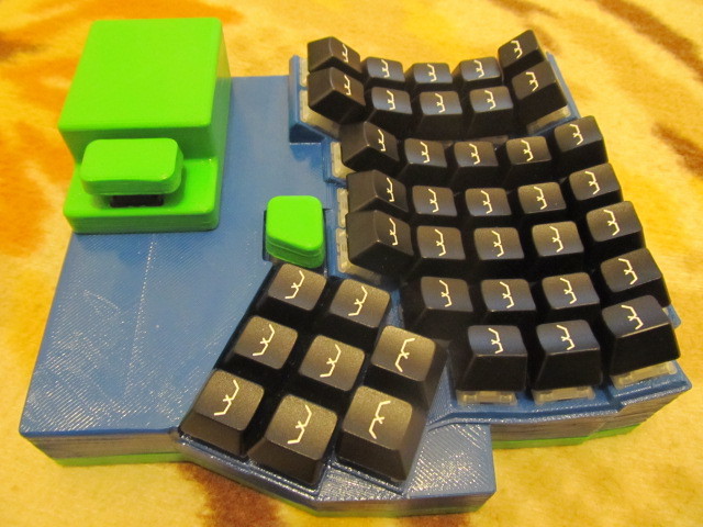

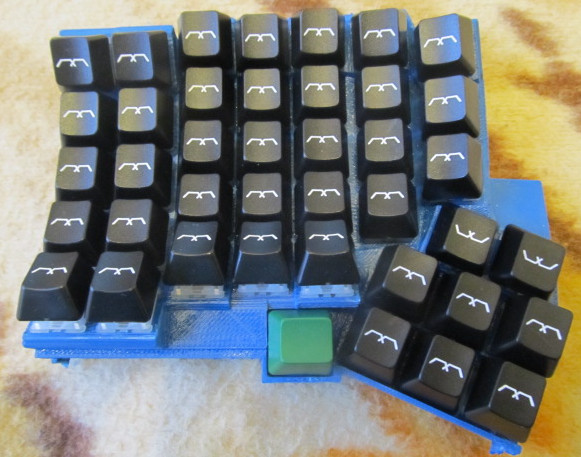

Well, I printed a mock-up of v0.8 keywell. That is the only significant thing I did from May. Looks good. I though that the new (green) layer shift key will be easier to access than the current layer shift (the key to the right of the green key). But it is about the same thanks to the fact that the current layer shift is a bit easier to reach compared to v0.7. This happened because the whole thumb cluster areas is deeper by about 5 mm now. Well, even better.
vvp
05 Nov 2016, 19:24
Proposal for the left side. The green buttons are new. I will probably finish it as it is (without changing the shape). Then I use it for few months and possibly experiment with the palm rest and the palm button shapes.
I guess I should call it K84CS now.
Yeah, I run out of the blue filament :roll:
K84CS v0.8 left side

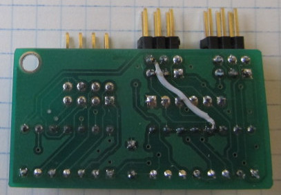

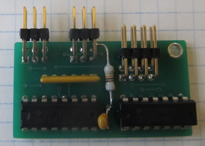

14 Dec 2016, 23:00
Here is the hack to v0.7 PCB I was talking about. This is to allow the additional 2 keys on each half. The key matrix was 8x5. It will be 7x6 now. The 8 column lines are shared with LCD so they are still taken even in v0.8. I removed the power saving feature on the light sensor and used the pin for the new - 6th row of the key matrix. This will result in a slightly bigger power consumption (at most about 5 mA on a direct sun) but mostly below 0.8 mA for bright office lightning.

vvp
17 Dec 2016, 14:04

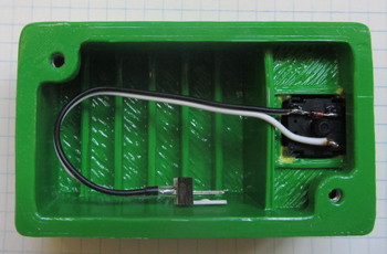

The right side is almost done. You can see the new thumb cluster key at the end of the pointing finger column. The white connector (at the end of the little finger column) connects the palm button to the key matrix. The hex slot screw head in the bottom right corner holds the palm brick. The other such screw is below the PCB (not visible here).
The picture of the inside of a palm brick with its palm button is below. This is a brick for the left side but the right side brick is just a mirror image.
The shown key well wiring is an example of how not to do it. The problem started because I soldered all the diodes on switches like in v0.7. It is better to solder enamelled wire on switches so that diode does not get thermally destroyed(*). Because of the diode orientation like in v0.7 I was forced to put the enamelled wire on rows as in v0.7 too. But it would be better to have the enameled wire on columns instead so that at the end of key well column I can easily extend it to the last thumb cluster "row" button. Because I did not have enamelled wires on columns I needed to connect the key well columns with the last thumb cluster switch using a wire with a plastic insulation which can be soldered to diodes at lower temperature. But this means stripping insulation. Which is the work which would not be needed if I would be wise enough to orient the diodes properly.
Summary: It would be much better to solder the diodes with their cathode (the black strip side) to the switch. Then I could connect rows with bare (un-insulated) wire. This would work nice since the row wires are not crossing in v0.8. Then I could connect columns with enamelled wire (directly to switch pins) and easily cross it at the end when extending it to the last button in the thumb cluster "row".
The other thing which should have been done differently is the diodes on the two bottom keys of the pinkie column and the pointing finger column. There is little space there to solder column wires. It would be better if the diodes would be positioned about 5 mm higher (more far away from the end of the columns) to provide more space for soldering.
Otherwise it looks OK.
